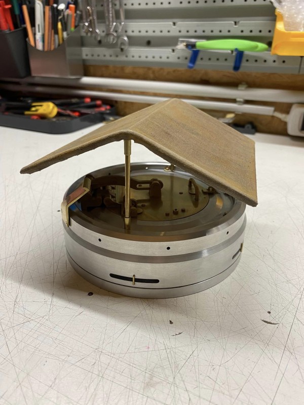

Something like this?

Thanks Riny for that photo. Is that your handiwork?

Re: Late cupola cover / umbrella
Not my work, its from Michael's fantastic Tiger 332.
I do not have the skills to do this
On the Tiger at Militracks it was cloth / canvas.Vince Cutajar wrote: βTue Jun 13, 2023 1:50 pmAnother question.

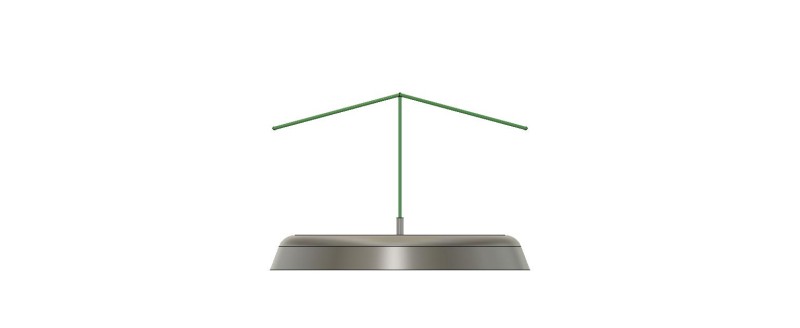

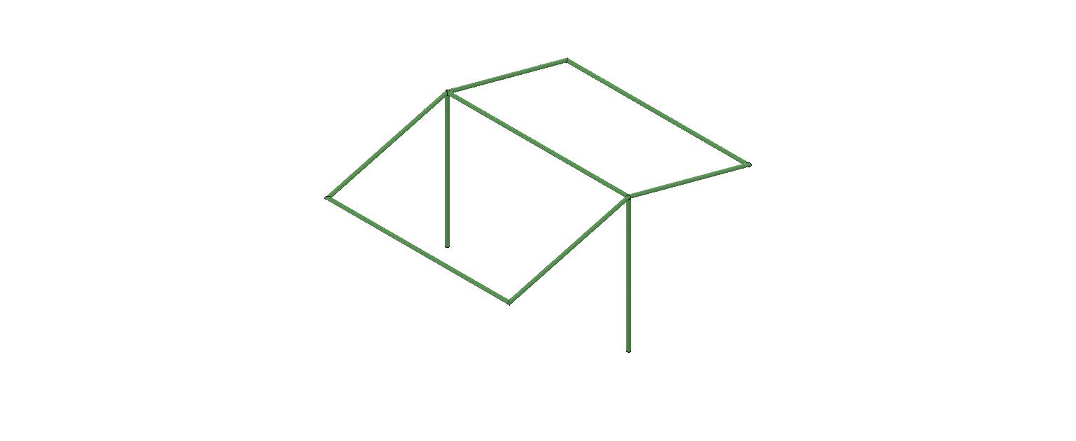

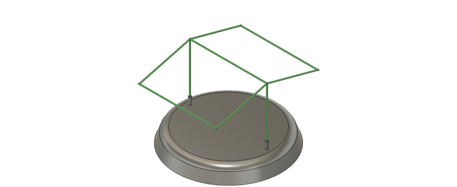

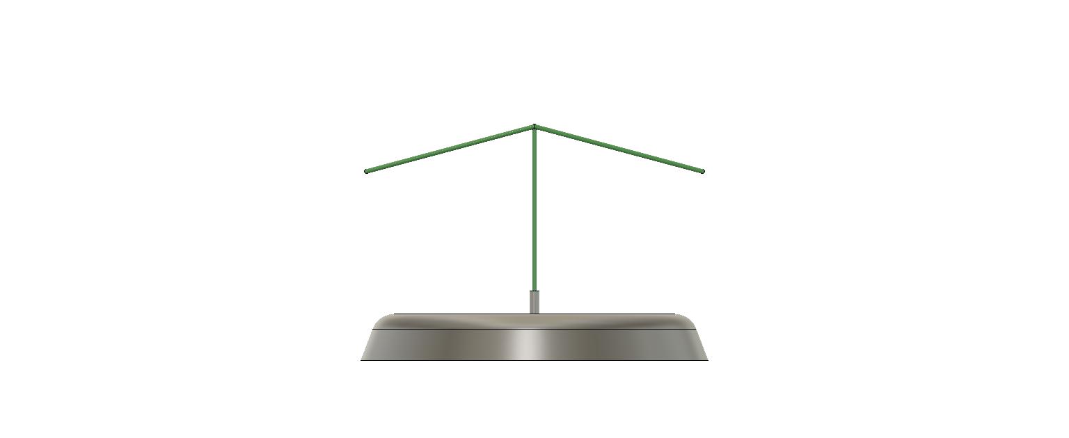

Made a rough 3D model to see what will be involved in fabricating the frame (green colour)
Frame to be made with 2mm diameter round stock. I still have to see if I have enough material for it. Trying to avoid having to buy the stock online as it has become really expensive to import things.
Hello Vince.Vince Cutajar wrote: βTue Jun 13, 2023 4:33 pmThanks Ed for the info.
That's a bit of a coincidence....
On my 2004 tiger, the cupola (the drum type) had 2 small studs/tubes on it,
Only these were more or less in front and the back of the commander.
I solved it by drilling 3 new holes in the top part of the cupola (it consists of a rop and a bottom ring),
and twisted it so these 2 mounts are now left and right of the commander.
The hatch is now at the back and also acts as a sort of shield?
I'm using 3mm brass rods for the 2 upward sections (needed to shave off about 0.4mm)
and 2mm brass rods for the rest of the frame.
Ed
