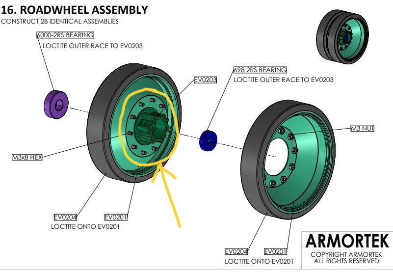

Just to be sure you assembled it properly, the hub mounts in BACK of the inner wheel, otherwise it will rub. The CAD drawing can be misleading.

Your wheels look like they have too large a gap between them. Have you assembled them as per this drawing - with the flange of EV0203 on the inside of the first wheel.

I had the flange on the wrong side, it fits perfectly now thanks! I need to look closer at the drawings.
