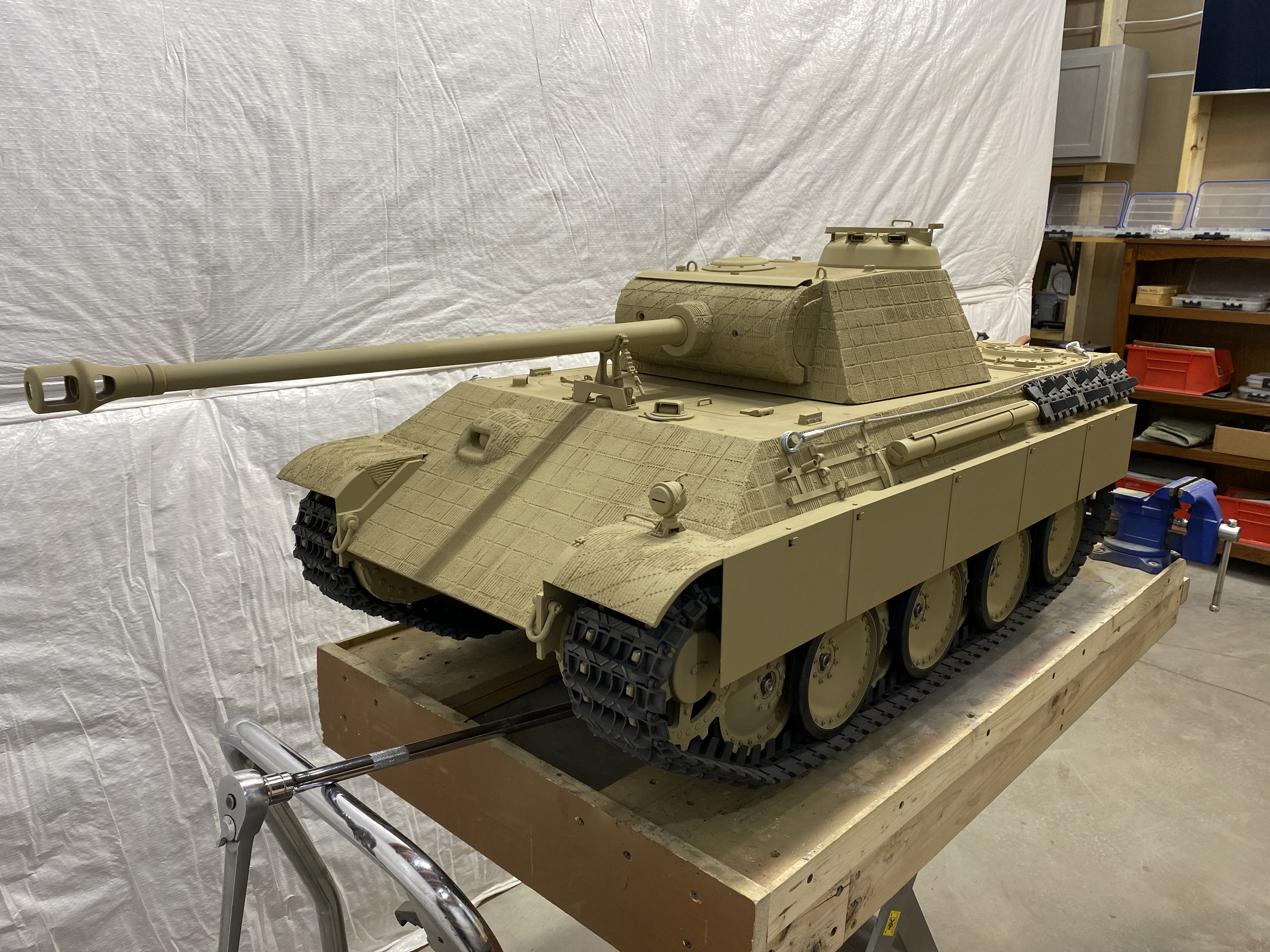

Great looking Panther G! 2022 #2 Panther G? also highly detailed and accurate zimmerit coating work :D

Thats look brilliant, please more pics!

Superb build, looks fantastic quality zimmerit.
Hat's off how you done you build so quickly is massively impressive.

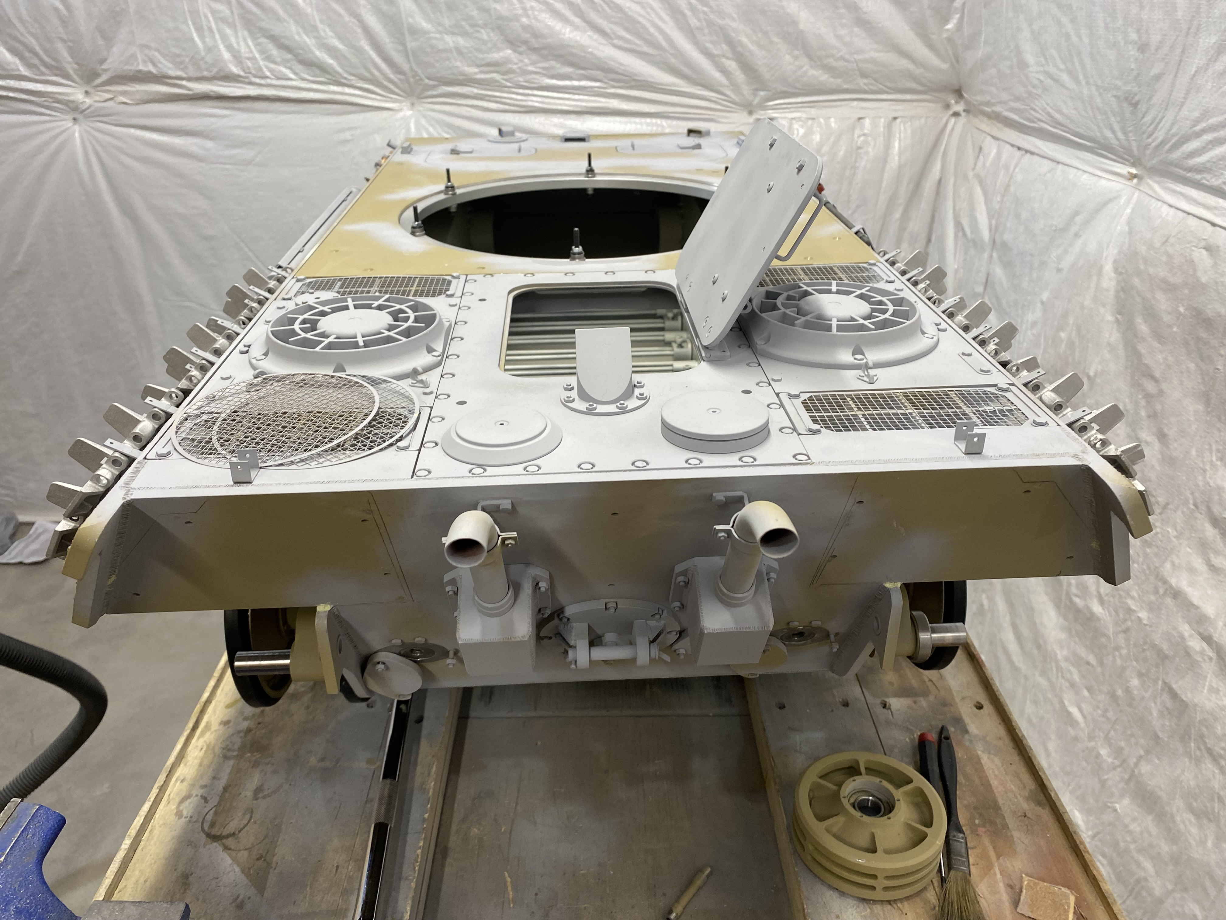

yes this is the current release Panther, installing the option packs and battery now so I can close up the top deck and roof on turret-apply welds and camo ..

I will post more pics when I get the deck welds on.

What a lovely job and the Zimmerit is superb.
What have you used and what is your method?
What you have used and what is your method?
This was my first attempt at Zim, I used wall tile grout mixed with a dilution of wood glue and water. Mix a bit firmer than tooth paste consistency and then applied with a drywall knife/putty knife. Used the set of zim tools from 6th Scale Icons FOA(which is not recommended anymore) to shape the rows in a vertical pattern. Small dowel rod with a dull point was used to then cut the horizontal and vertical rows. Don't extend yourself with area coverage as the material starts to cure in about 45 minutes. Once it has firmed to dry appearance knock down the rough rows and high points with sanding block.
