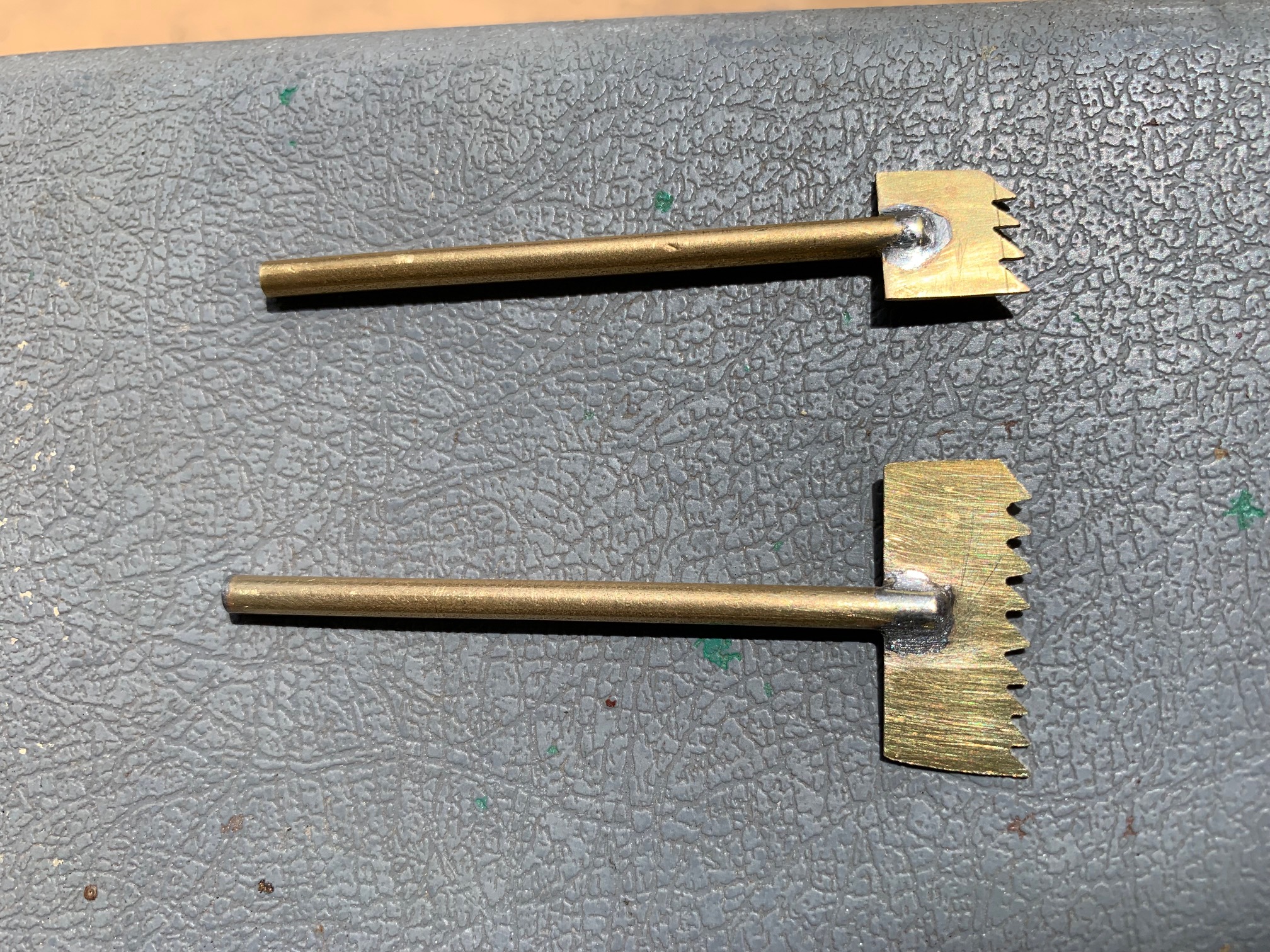

Re: Zimmerit
Hi
I made a set using 0.5mm brass with brass tube for the handles. They are quite rigid once the handle is soldered in place. I have also borrowed 3 sets of Zimmerit tools so I will be able to compare the results
Gary
Gary

Re: Zimmerit
Great hand made Zimmerit tool kit! Did you even make the pattern as well?Gary Richardson wrote: ↑Thu Jul 14, 2022 10:30 pmHi
Gary
