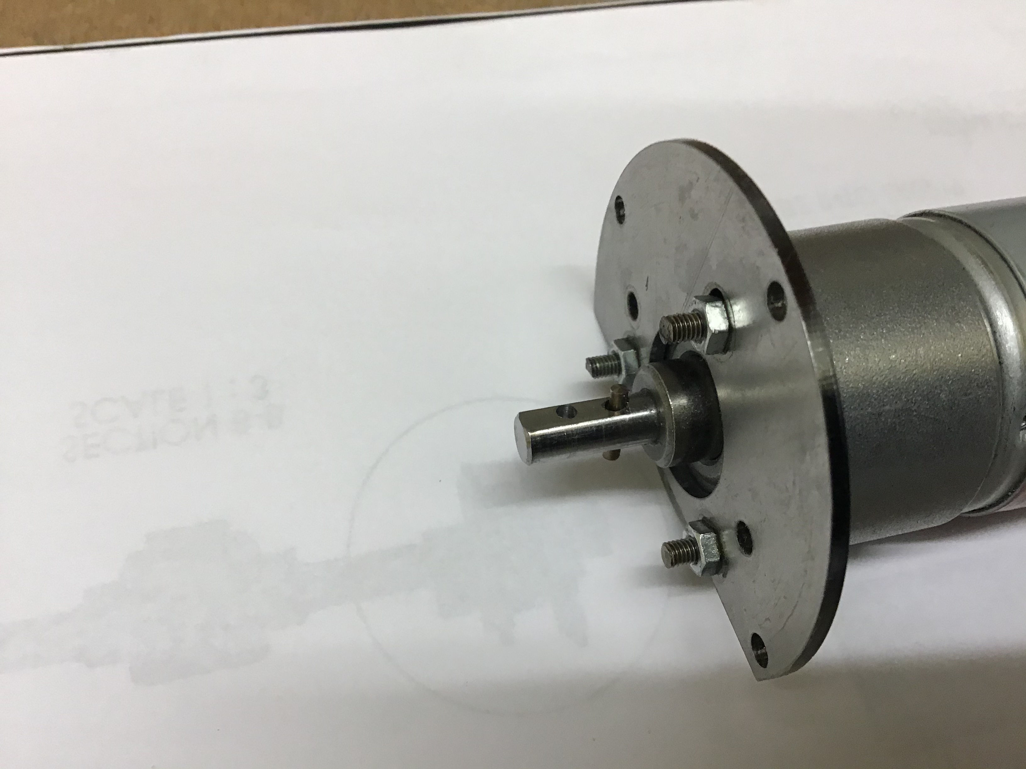

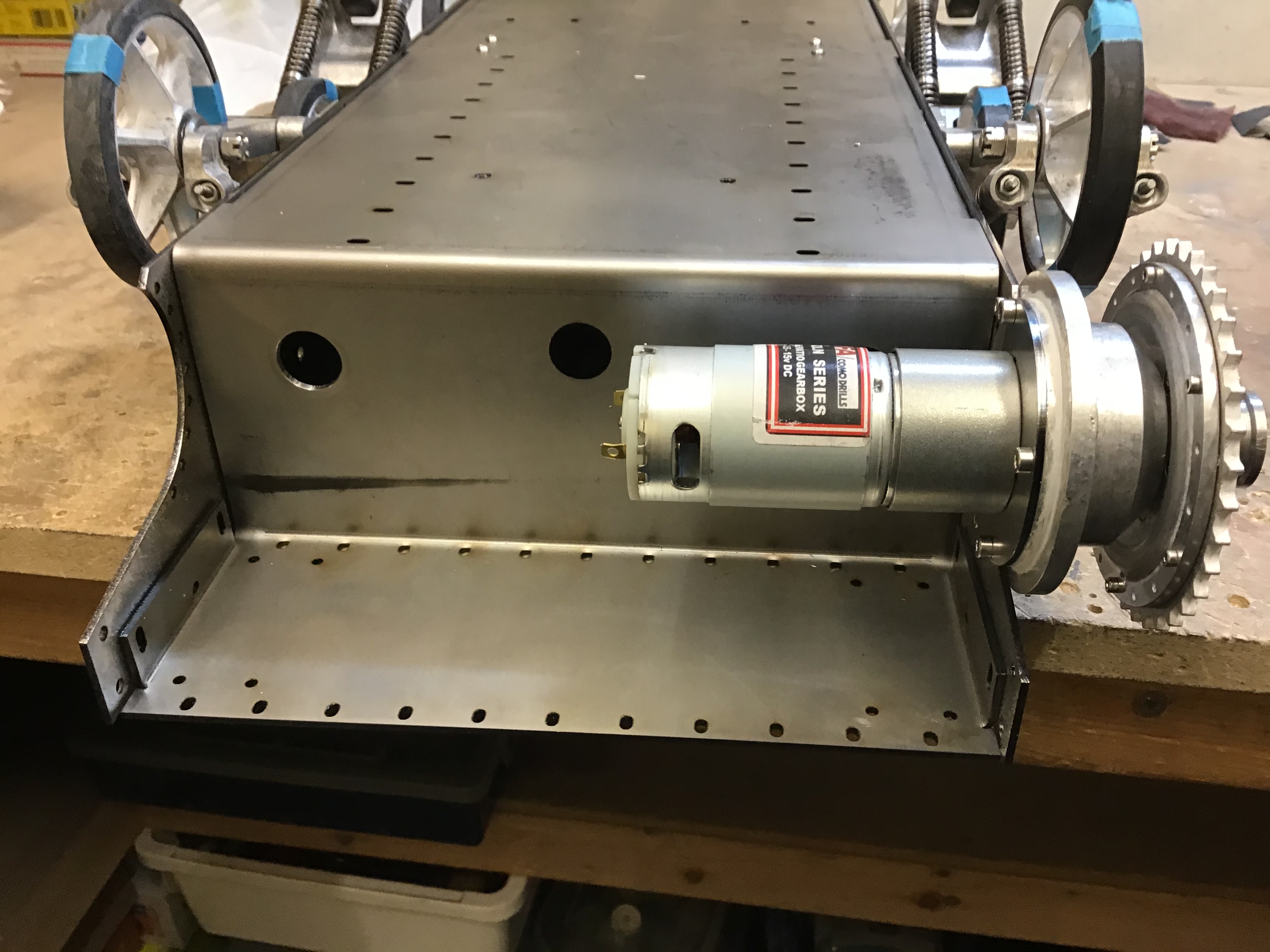

I have been following Peter Withers twin motor drive posts with interest and thought I would have a go myself.
What I have come up with is shown below but until I get the second motor I do not know how successful this will be.
When I get the second motor I will see if this set is robust enough and has the correct gear reduction. I am reasonably confident that it should be powerful enough as I am replacing a single 540 motor with 2.

Re: Steve’s UC
Steve, that looks pretty neat. I'm surprised the motors fit in the width but it looks like they ought to. What speed controller arrangement are you planning on using? Keep us posted and glad I acted as inspiration

Interesting that others are investigating alternative drive systems. Worries me a bit is that you and Peter have shortened the axle, my method keeps the axles with some machining to suit bearings. Details to follow.

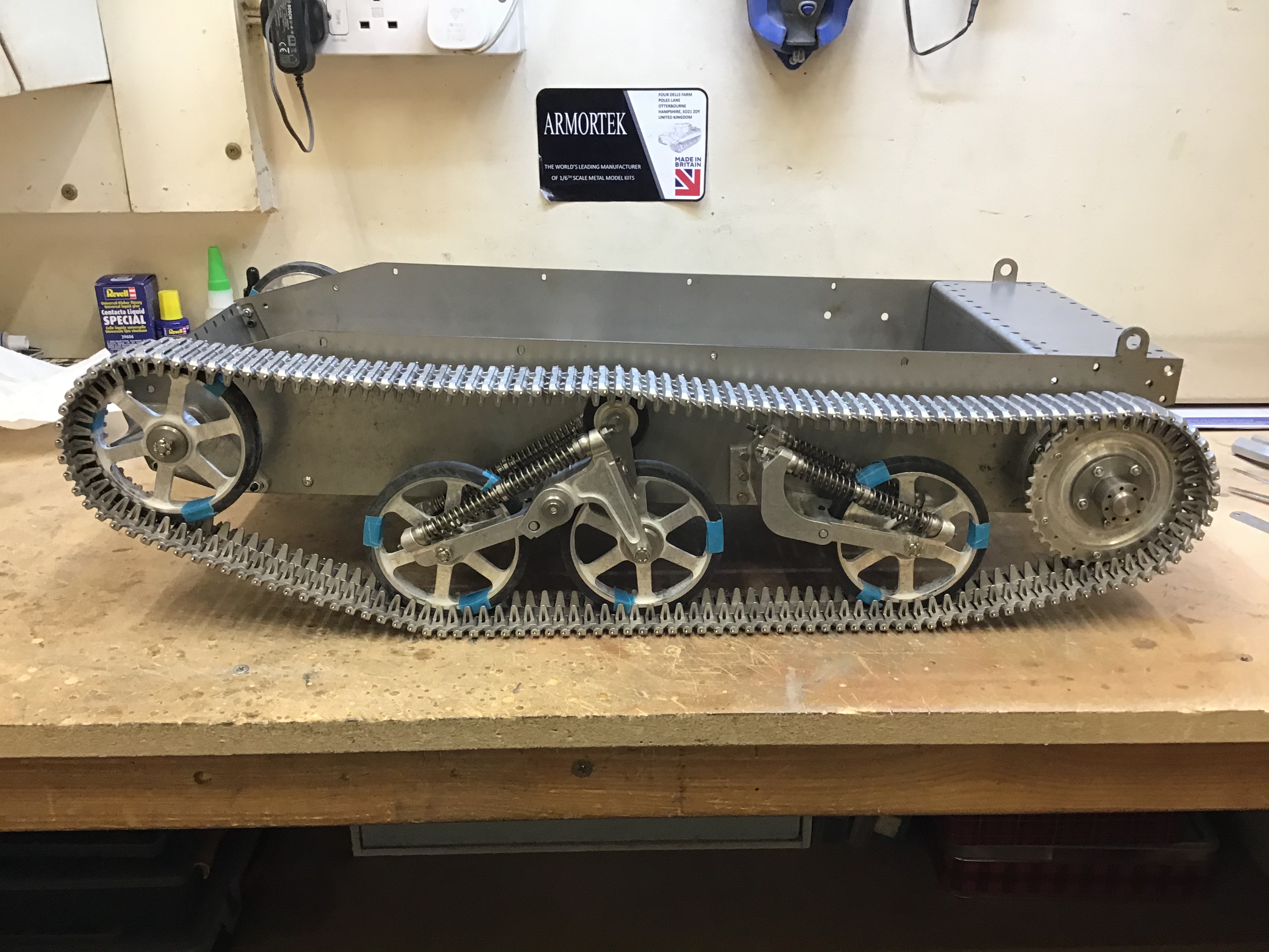

After a bit of fine tuning I with the drive and also the tracks I have got Carrier driving reasonably nicely although I am still throwing tracks occasionally. I went on line and bought two of the esc that are supplied in the motion pack to control the individual motors, by using the eleven mixing function on the Spectrum radio I am able to drive using a single stick. I will be using the sound card supplied with the audio pack so at least I will have used some of the supplied components of the motion and audio pack.
The motors etc have now been put to one side and the main build has started.
The first thing I have done is to take the edges off the swing arms and give them a more rounded look, whilst doing this I also slotted the holes that the suspension spring rods pass through to give more articulation.
Another modification was to braze the centre spring carrier to the spring rod to prevent the rod being forced fully either way when the suspension articulates.
