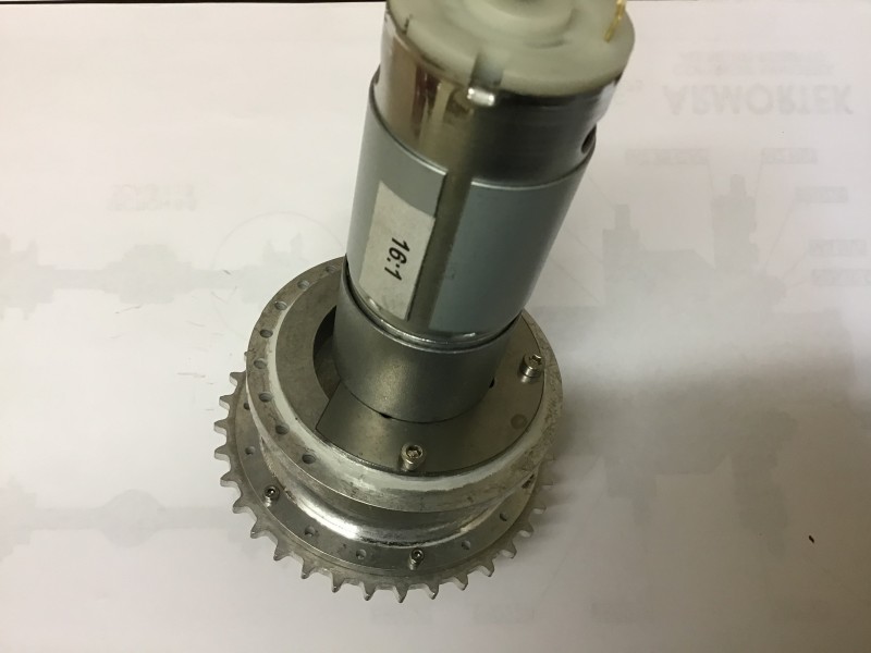

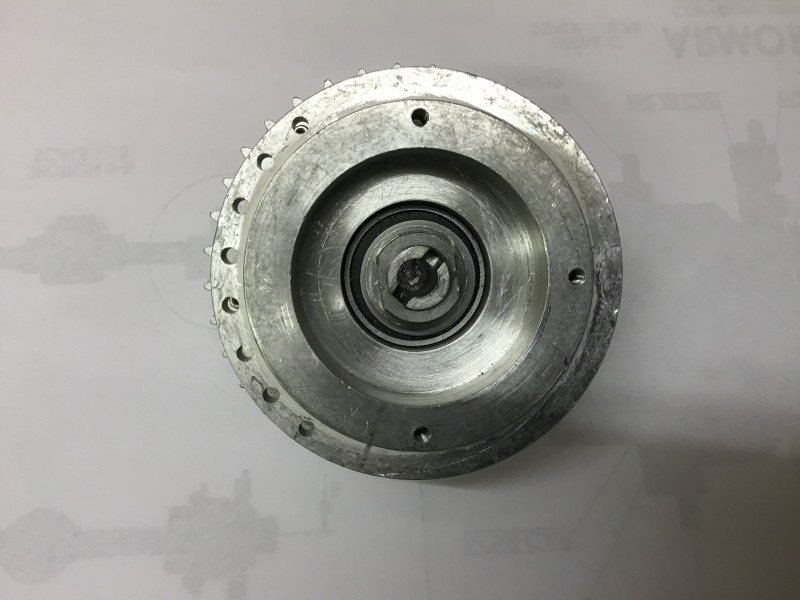

I have cut the supplied drive shafts down and drilled the centre 5mm, once drilled I slotted the shaft 2mm
I bought a Como drills 540 motor with 16 to 1 reduction gear box and attached part ER0227 to the gearbox.

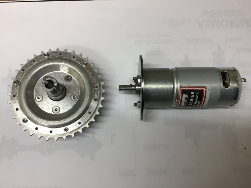

The 2 parts shown together. Note that I have drilled the gearbox output shaft 2mm and fitted a drive pin, this pin will engage with the previously cut 2mm slot in the axle.

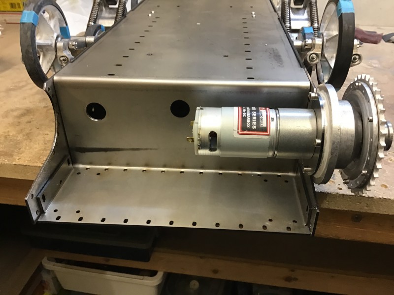

The assembled parts
The assembled parts
The motor and gearbox can be installed in the hull with no further modifications required

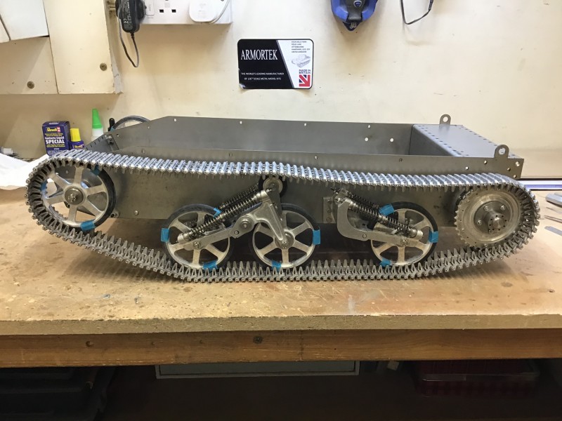

1 set of tracks installed
When I get the second motor I will see if this set is robust enough and has the correct gear reduction. I am reasonably confident that it should be powerful enough as I am replacing a single 540 motor with 2.

Steve, that looks pretty neat. I'm surprised the motors fit in the width but it looks like they ought to. What speed controller arrangement are you planning on using? Keep us posted and glad I acted as inspiration :D

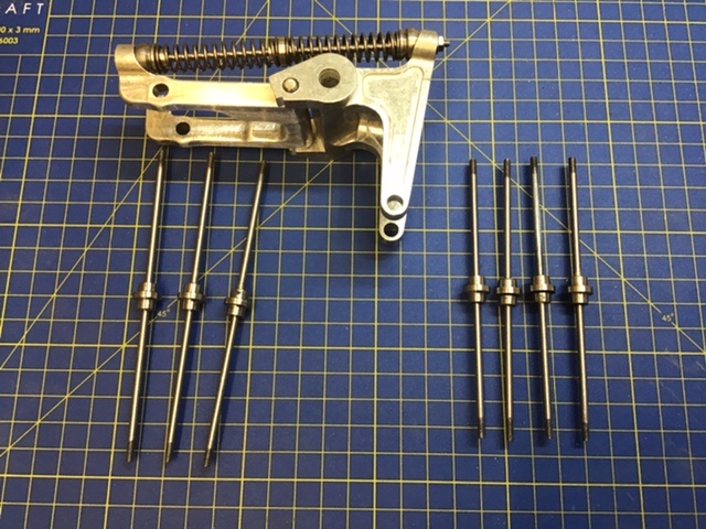

The first thing I have done is to take the edges off the swing arms and give them a more rounded look, whilst doing this I also slotted the holes that the suspension spring rods pass through to give more articulation.
Another modification was to braze the centre spring carrier to the spring rod to prevent the rod being forced fully either way when the suspension articulates.
The modified spring rods, when the suspension articulates the rod should now be displace equally in both directions
