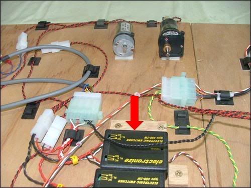

i also had a similar problem with my early sound system in the tiger1. I changed the switchers for the turret rotation, and gun elevation to esc,s and this cured the problem. In some cases the switchers give back emf ( or so i am told ) and this affects the sound system.
The later Benedini system doesnt suffer the same problems , and as Lee says its much better .
The switch units are the 2 smaller of the Electronize units. They are use to control the turret rotation and gun elevation motors. They look like the one arrowed in the picture below
