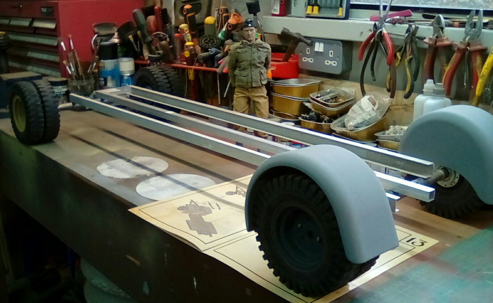

Good news as we have the green light for this thread. I've made a start with one of the most difficult parts to reproduce, the rear fenders. 8)
I won't be posting to often as correctly so, the company's builds and builders come first. Let's hope that Armortek offer a kit for sale in the future as I think it may do quite well.
I may use some flak wheels or 222 wheels not sure yet, there were a few different wheel types used..
There won't be to many printed parts as the trailer needs to be robust enough to carry the lighter panzers.

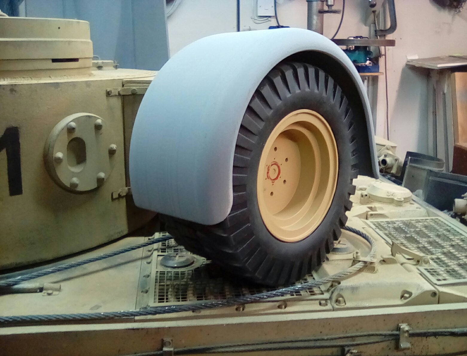

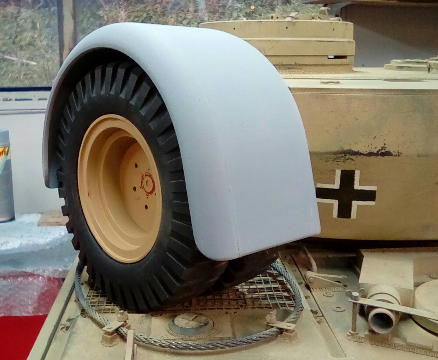

I think with Vince's help we are getting there. The fenders have taken 30hrs to print each side.

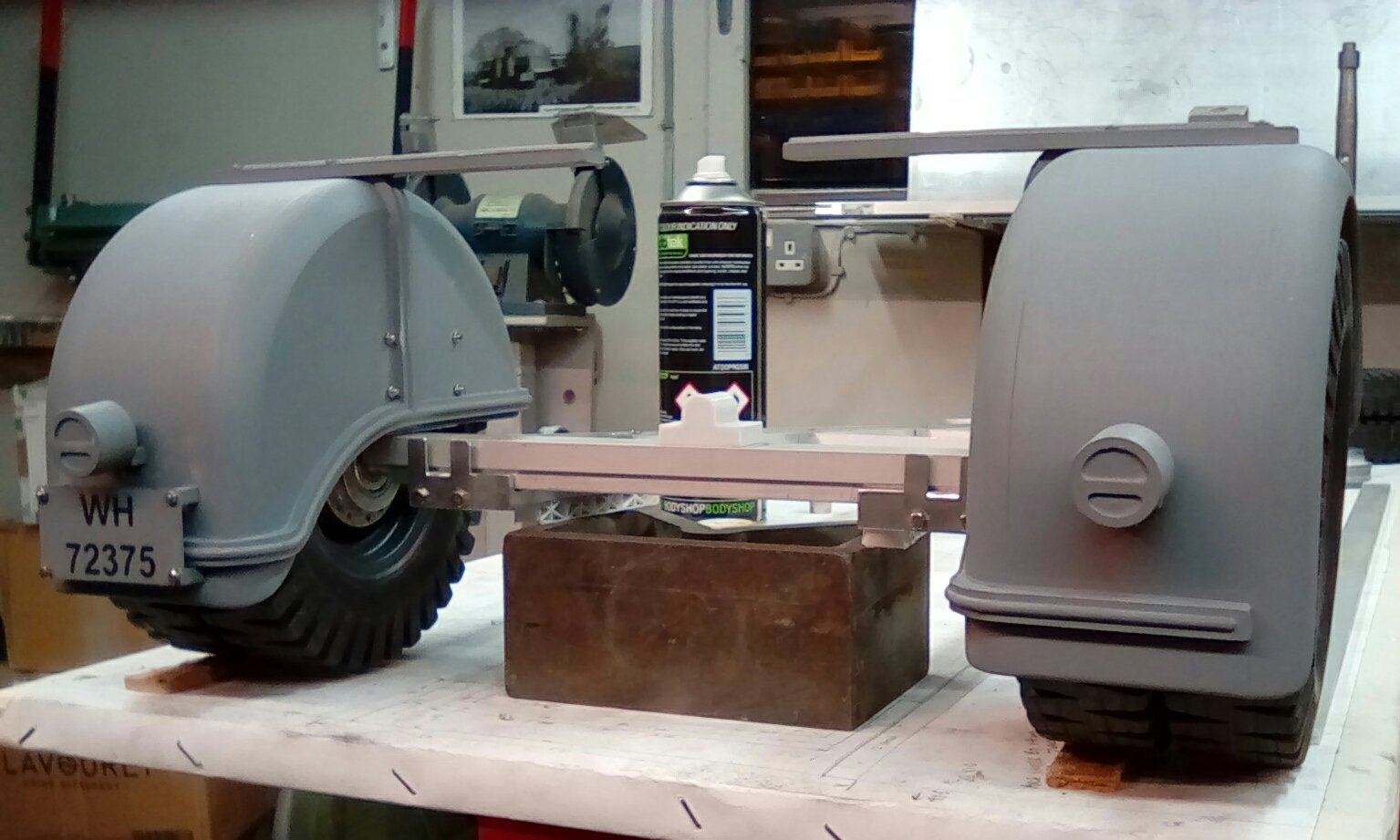

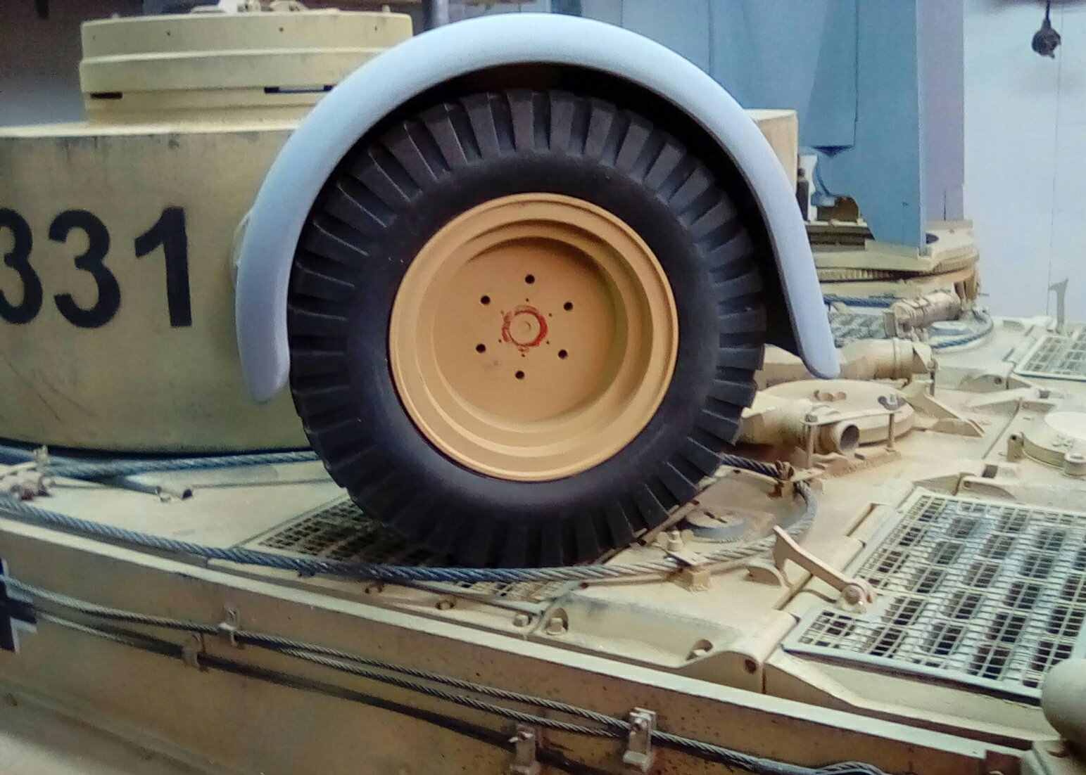

I've photographed them on the Tiger1 for scale.

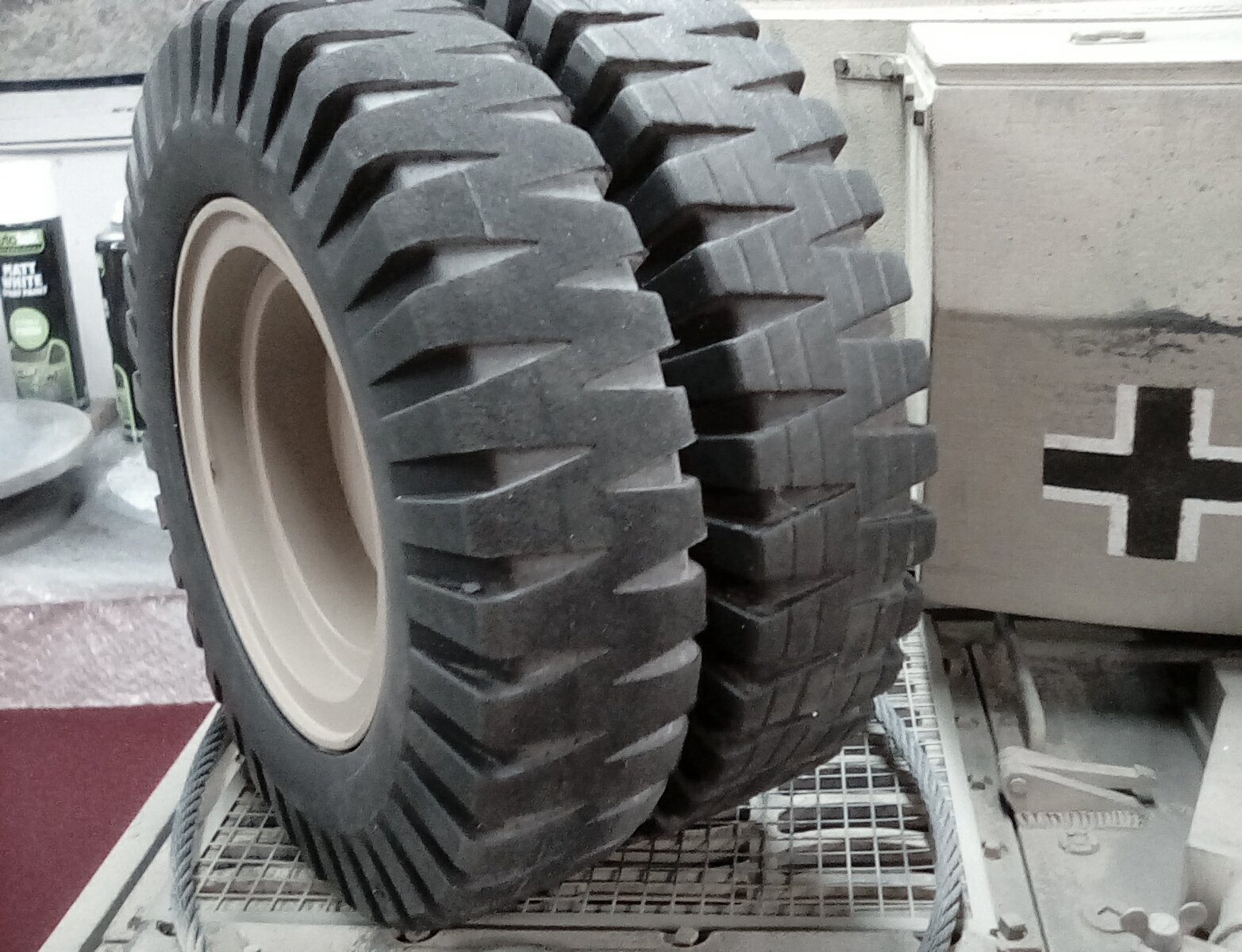

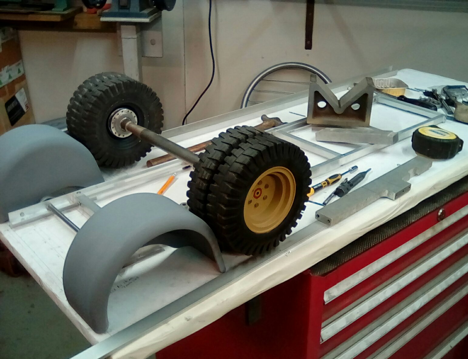

The Armortek wheels are mini works of art. You can see why I was asking for 222 wheels these being fairly close to the originals, each trailer will require a total of 9.

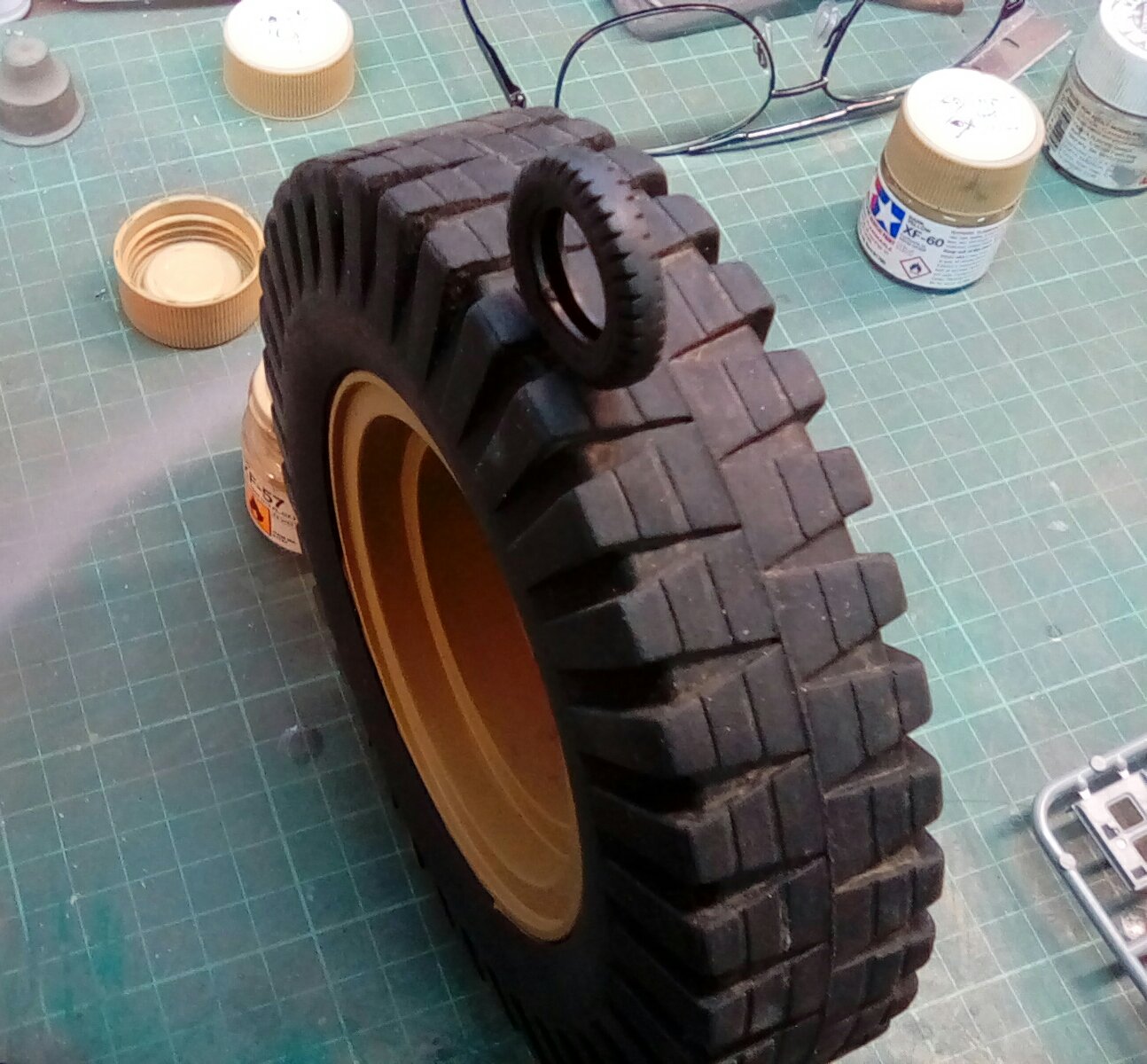

I need to make these look more like the original trailer tyre and wheel. That's the 1/35 on top for comparison, note that this version shows no tread pattern in the middle section.

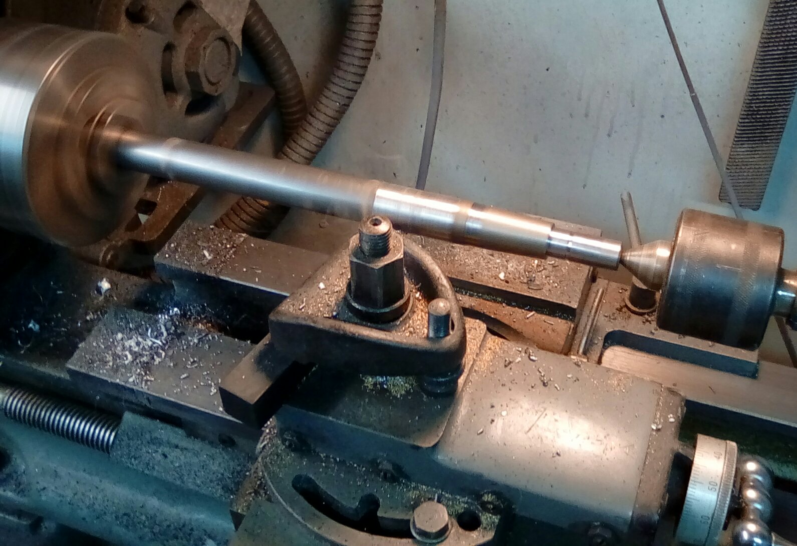

It's getting there just a bit more time on the lathe.

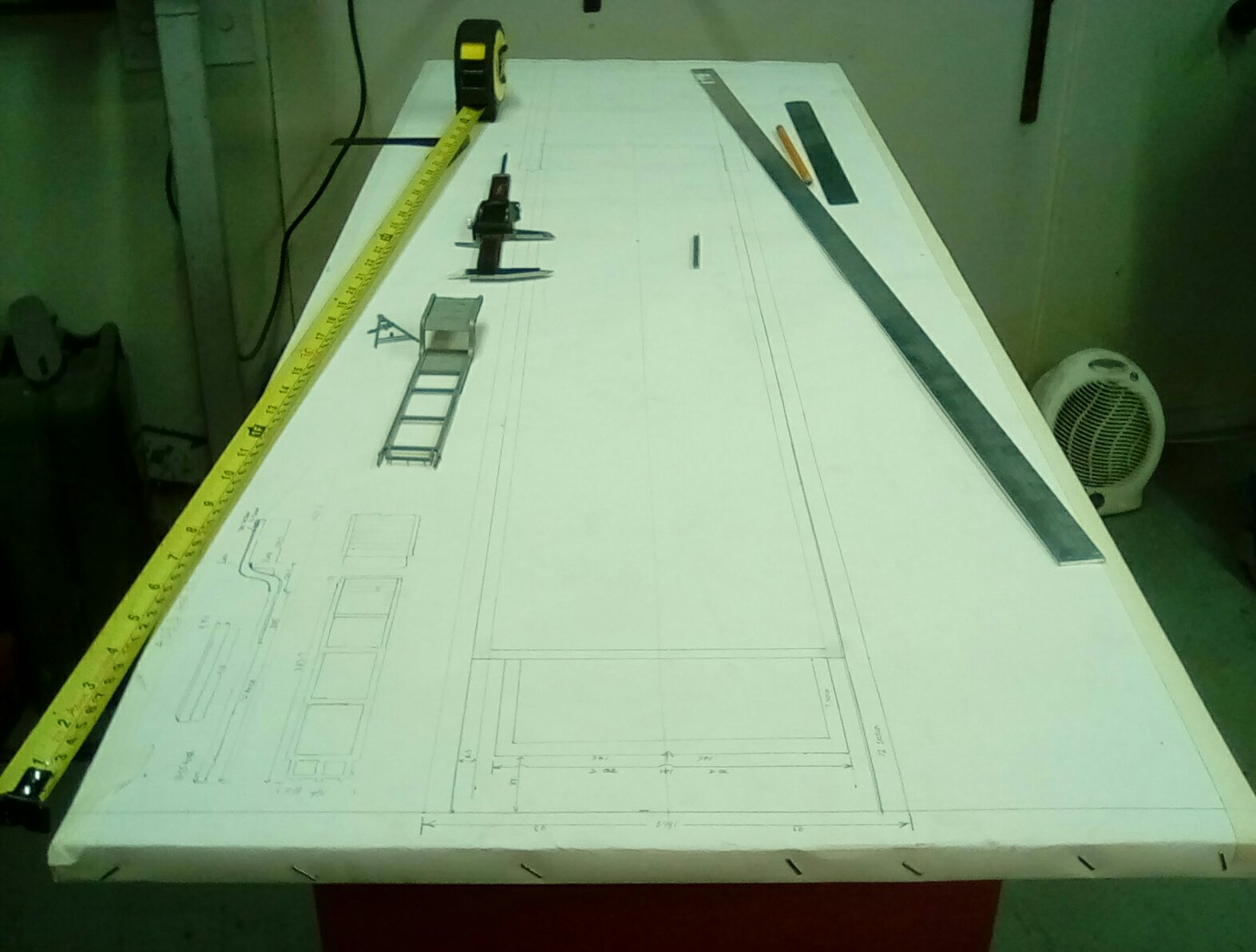

I'm making good but slow progress, as it's the first one I've built there's lots to sort out but it's coming along. 8)

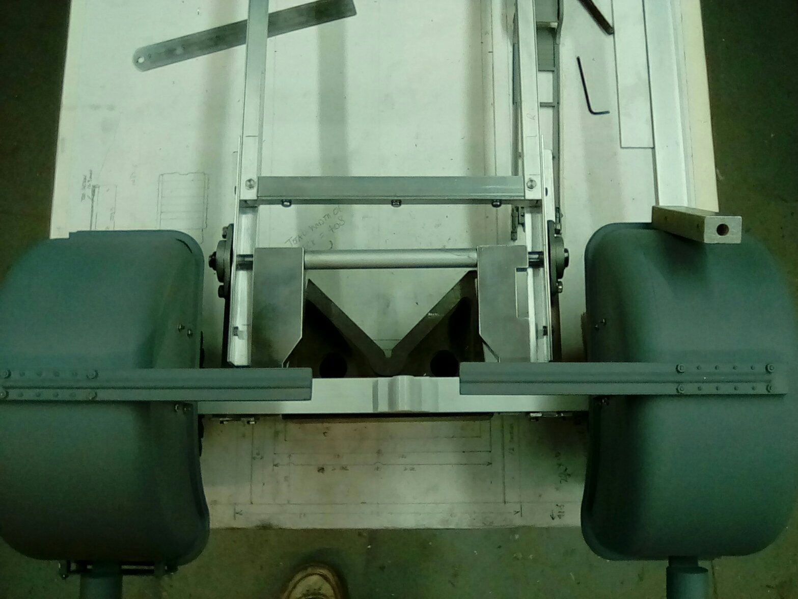

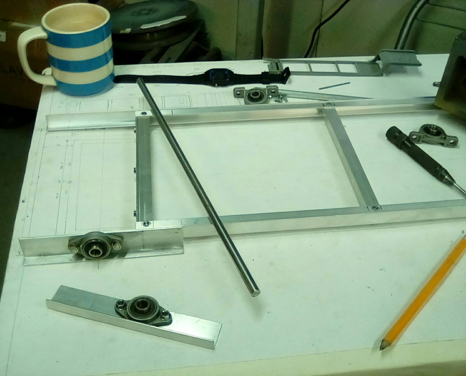

Some basic head scratching to start with.
It's awfully big, this plan table isn't quite big enough to include the drawbar and the rear axle .

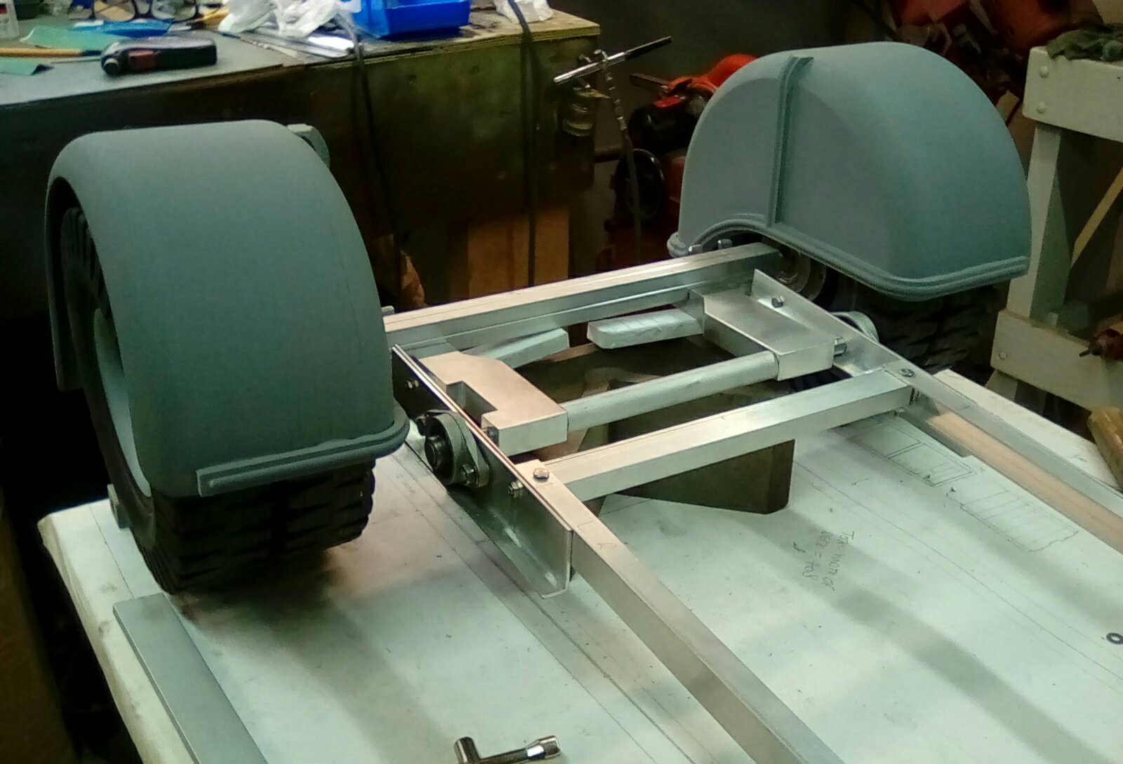

Ive got to figure out the rear axle attachment/detachment system.

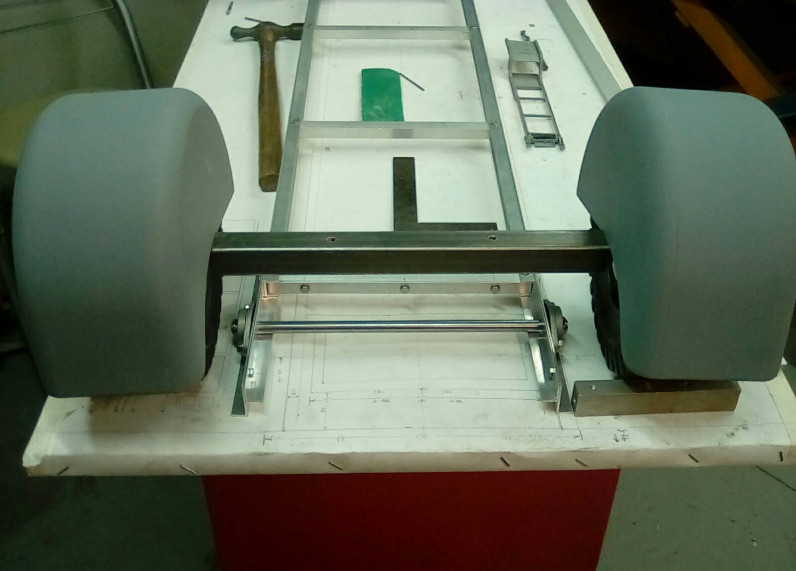

Those self centering bearings are for the rear axle pivot not for the rear axle.
Great period photo.
Great period photo.

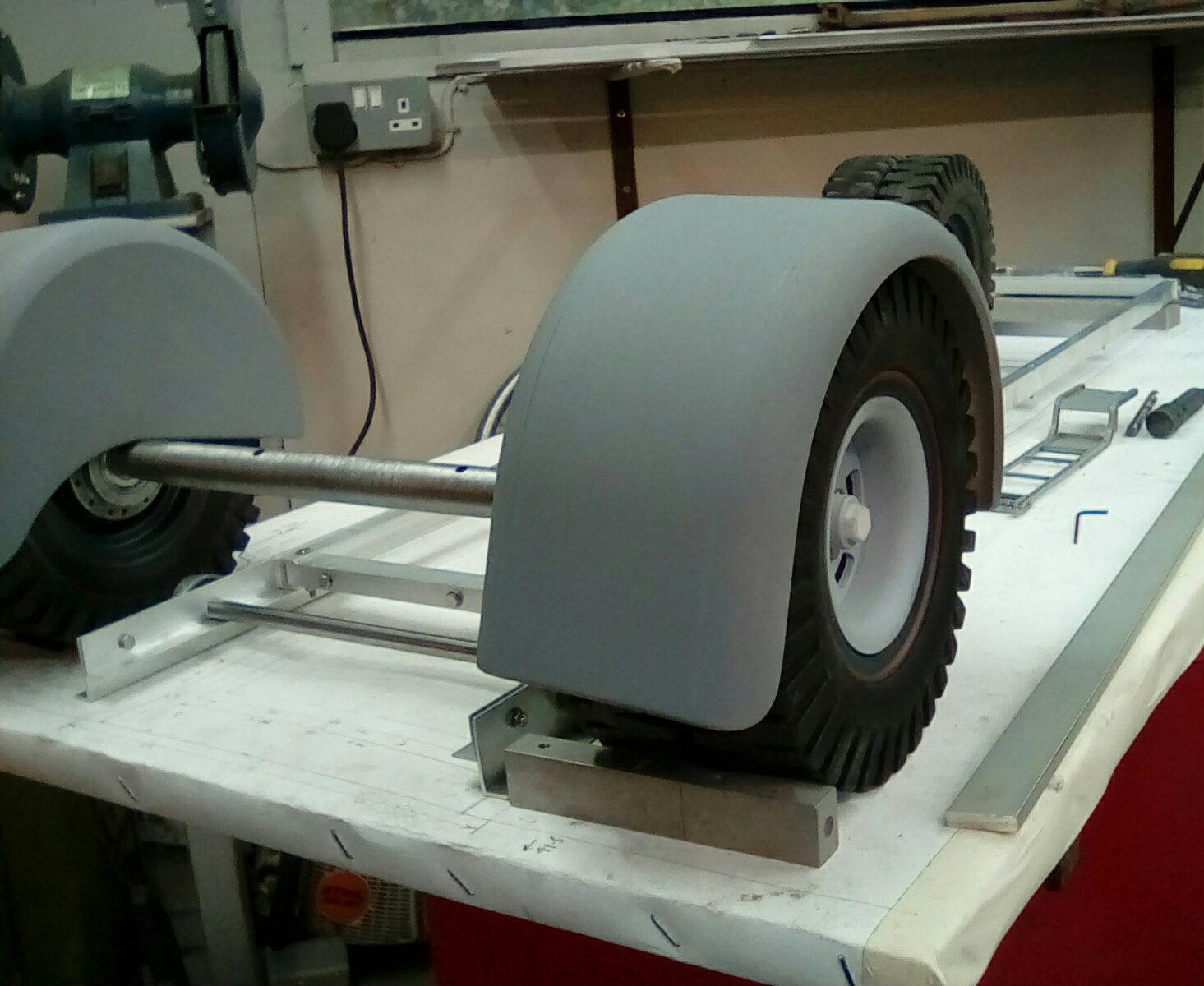

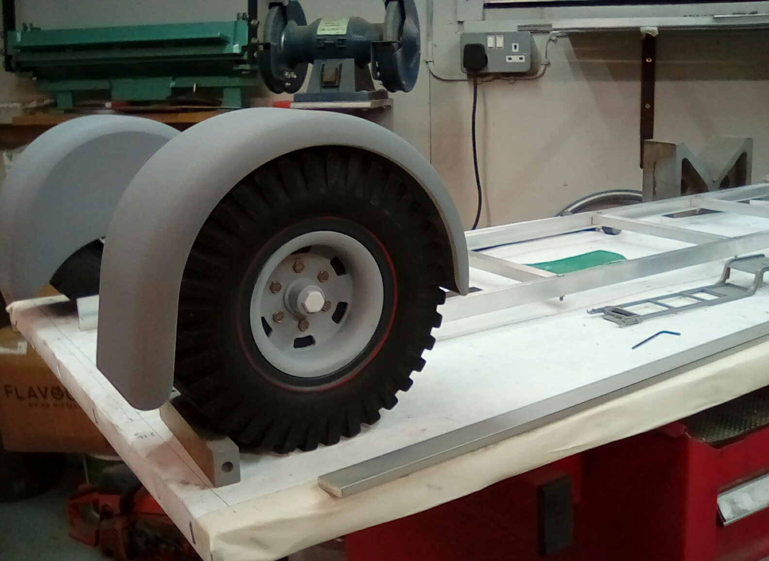

I'm reducing the diameter of the Armortek axle to fit inside the square box section which just happens to be the right dimension.
Vince those wheels look great now.
The rear axle is now square and extremely strong.

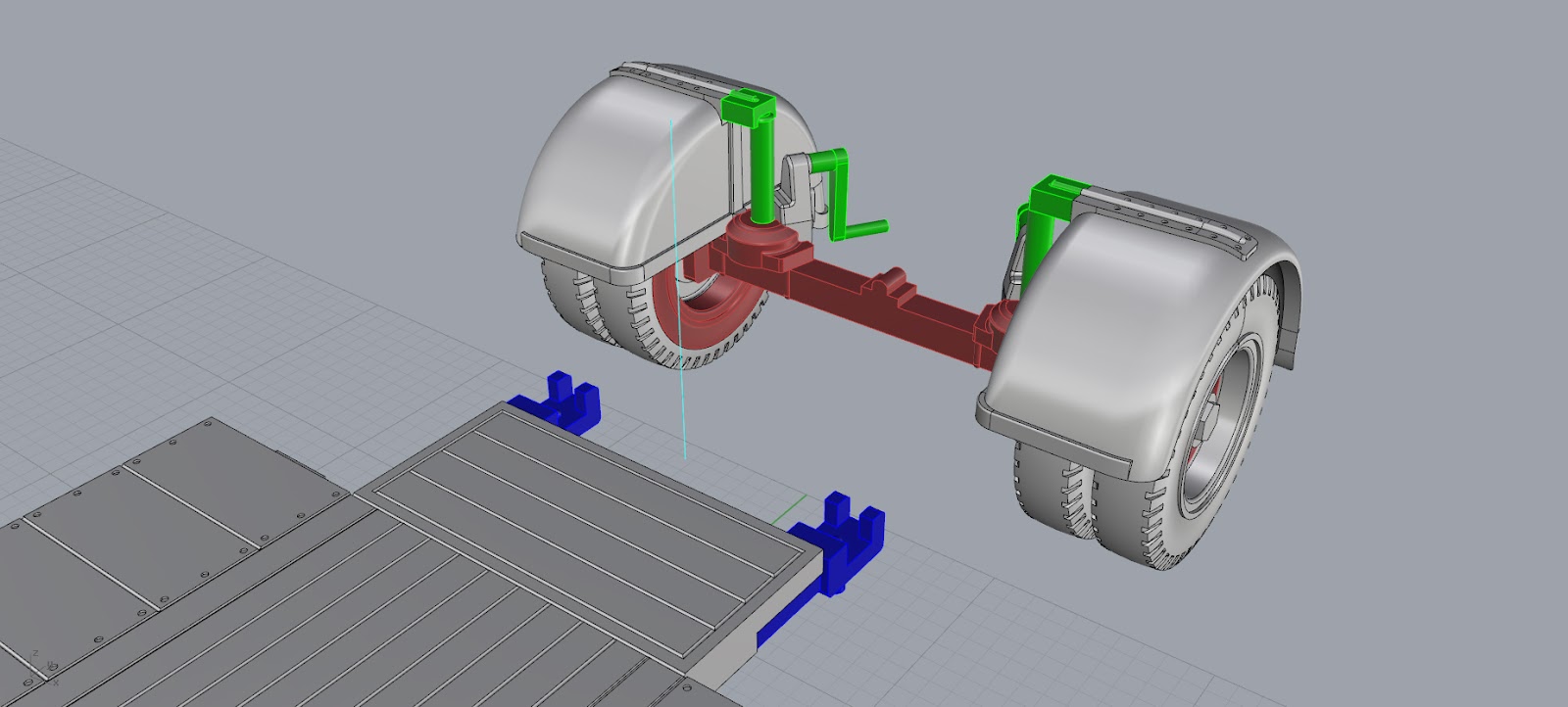

Very cool Phil! I about fell over when you said "batch of these". If I had something to pull it with - I'd take you up on one. Where did you find or make the CAD renders? Excellent!

One word, or name really, Vince! What a team!!!! 8) The wheel upgrade too.
Has liked: 792 times
Re: The Sonderanhanger 115 10 ton trailer.
Bob I think Phil misunderstood you. That render (3rd photo) is not mine.

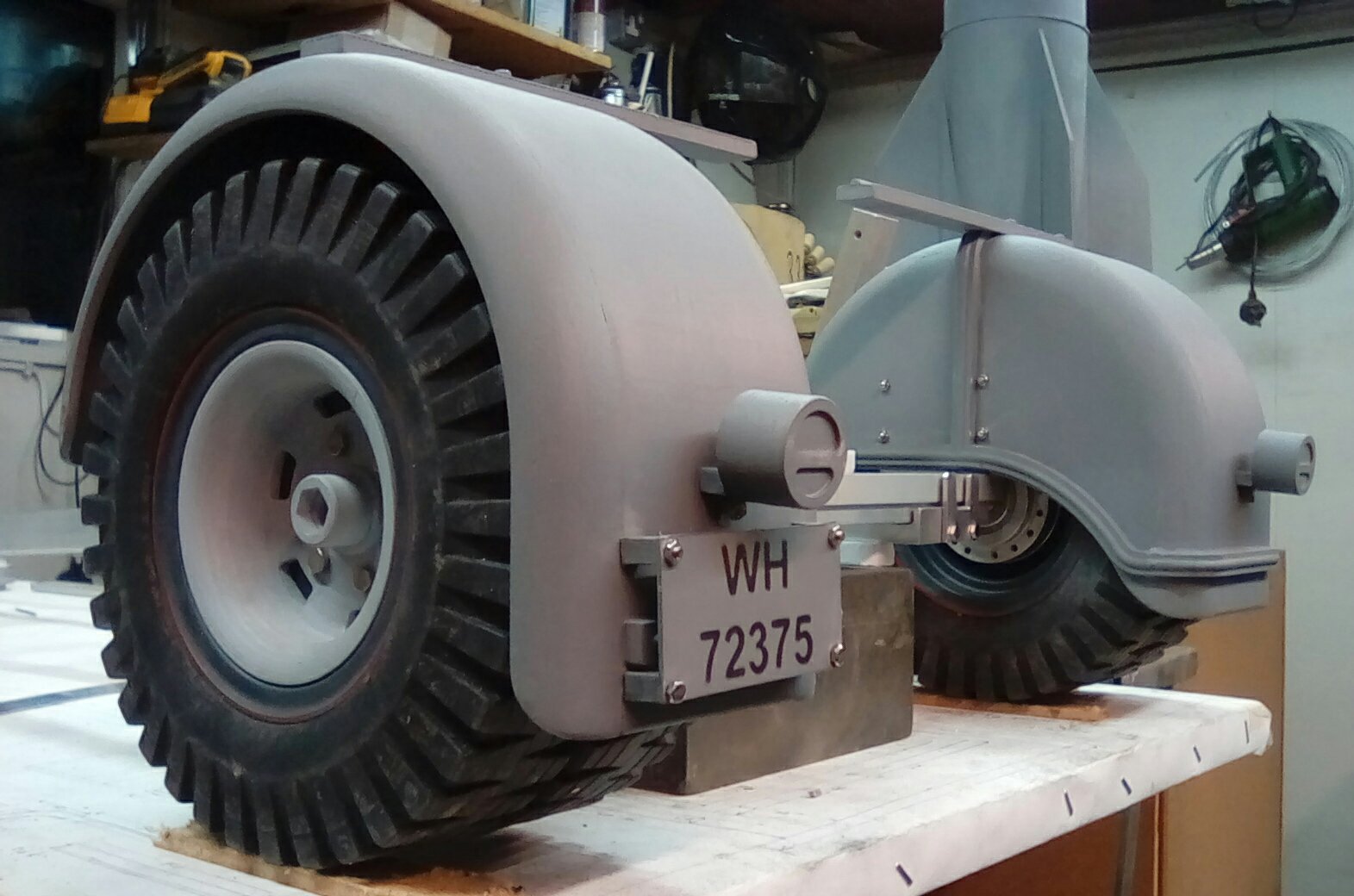

A very quick progress report. 8)
We are printing the back axle lowering jacks right now.
115 (8)_kindlephoto-8800057.jpg (18.82 KiB) Viewed 3831 times

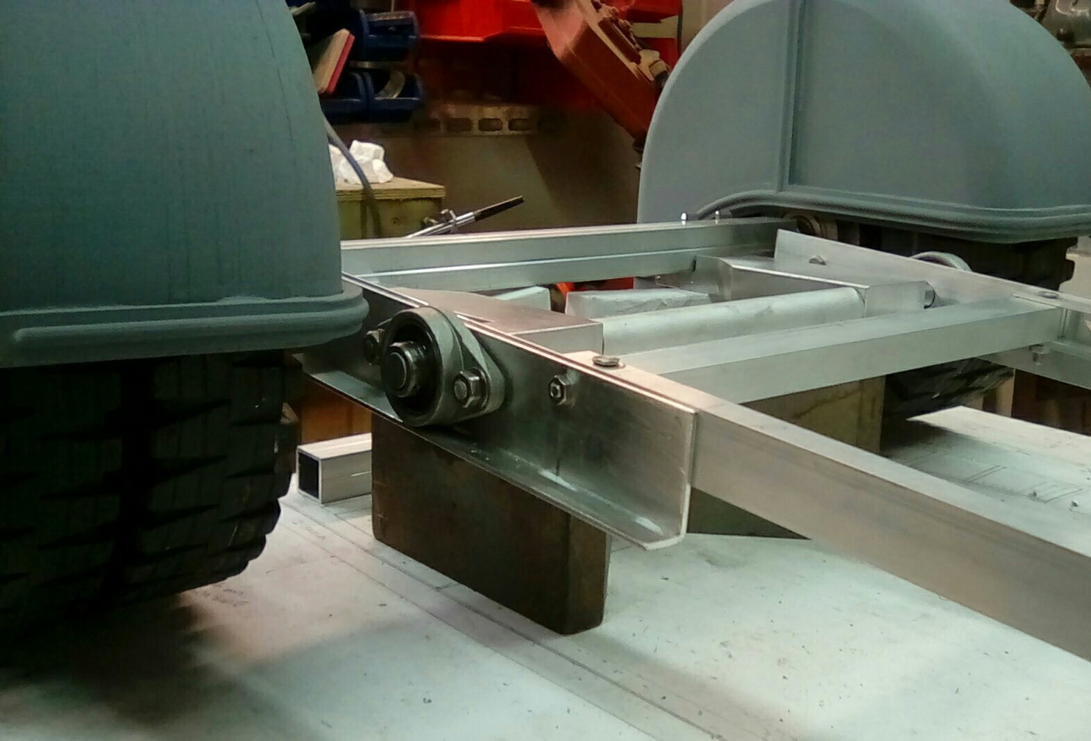

You should be able to make out the axles pivot mech from this angle.
I think she's coming along quite nicely, it's great to have the Armortek axles, wheels and tyres, also the wheel hubs are elefant road wheel hubs.
The large square swivel blocks are from the Bergepanther kit, they made up the cross bracing that the winch sat on.
