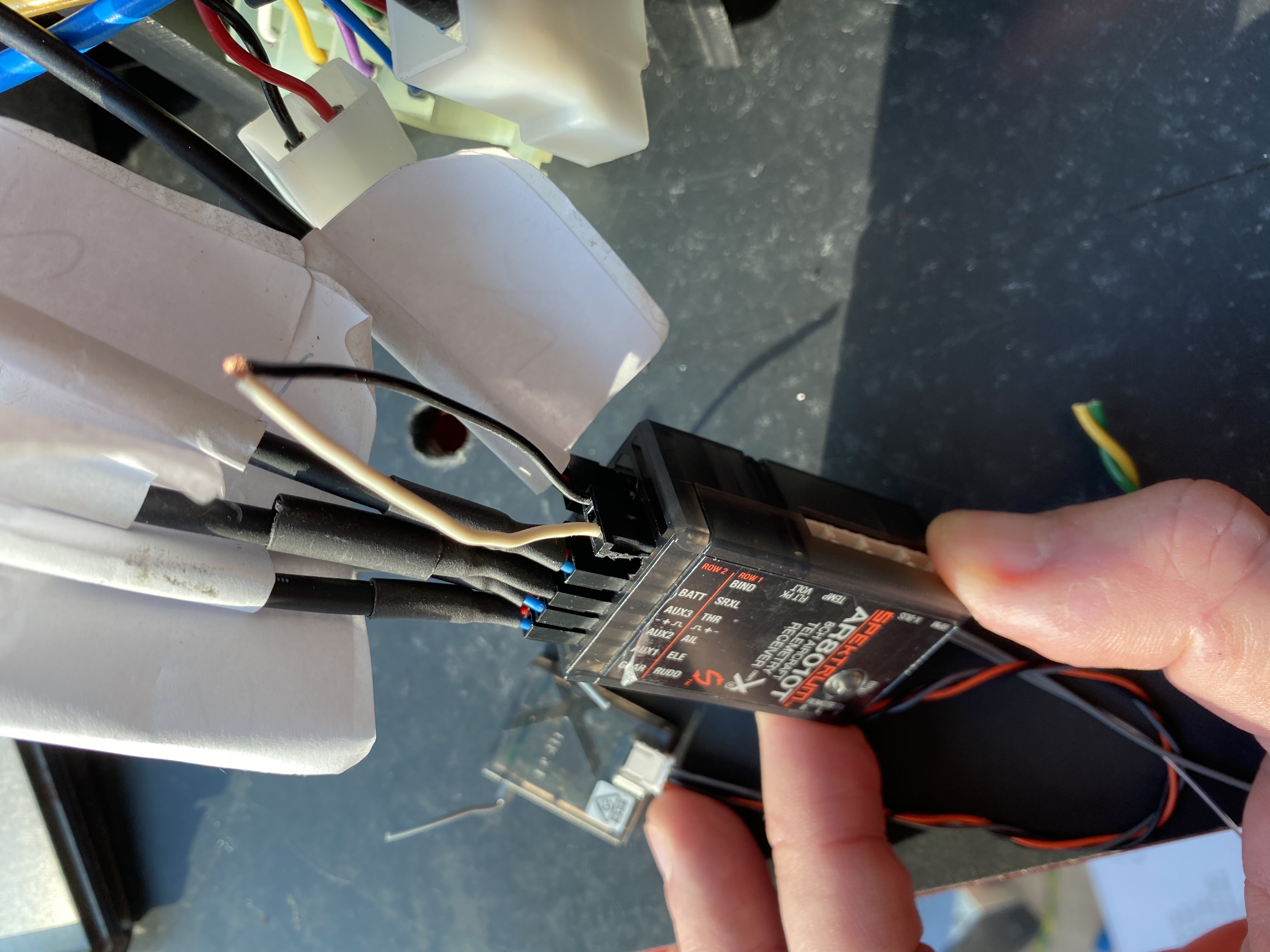

I’ve a new transmitter (tx) and receiver (rx) all plugged in as per instructions (I think!) but I can’t get the tx and rx to bind. I’ve increased the distance between the two to say 2m, I’ve set the receiver flat on the table etc, but I always get ‘bind failed’. Any ideas?

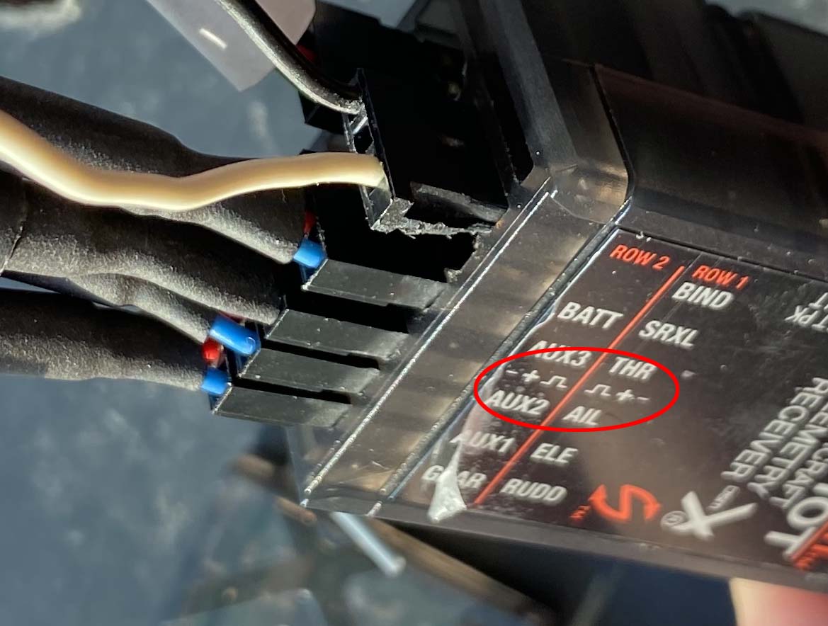

Re: Spektrum DX8G2
It's your wiring...
If you look at the picture above, with the part ringed in red, it shows that the servo plugs should be inserted into the receiver with the signal wires towards the centre of the receiver and the ground wires (-) towards the outside of the receiver.
In that sort of Armortek wiring, the green is the earth, the red is the power and the blue is the signal, so you have the plugs in the receiver the wrong way round.
Plug them in so that the blues are towards the centre of the receiver and it should work.

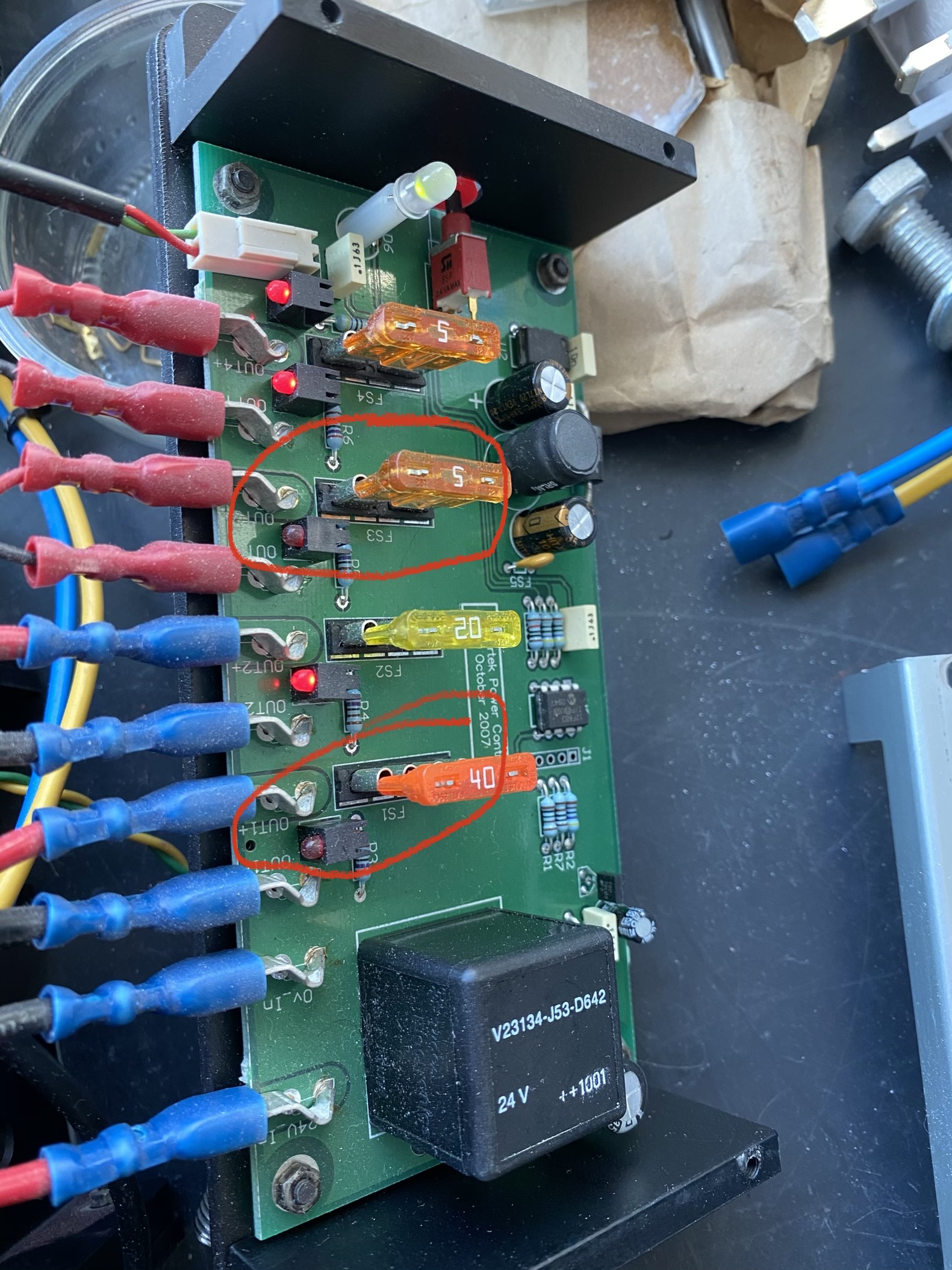

Would anyone know; why these two fuses blow? It seems triggered by the main drive motors. They don’t blow if I hold the spring loaded right hand stick back, but immediately I start to advance, they blow.
Thanks in advance!

They're blowing because you're drawing too much current
I would guess there's a short circuit somewhere.
The 5A should be powering the Amplifier Module, but I can't see how driving would blow that as there's no link between it and the Motion Control Module apart from through the receiver wiring, and that would be burning before a fuse blew.
Does the 5A still blow if you remove the 40A fuse in place ? And vice-versa ?
You need to go through the wiring and isolate the fault.
I'm also curious as why you have to hold the spring loaded stick back ? It's normal to have them centered when the tank is not moving, in both single stick and dual stick mode.

Thanks for the reply. I was holding the stick back because the transmitter was warning me “Throttle High!” But of course you’re right, they should be centred for a tank.
I don’t know why I’d be drawing too much current, it’s a bench test, with no load on anything.
I’ll have to experiment with fuses. How do you find a short circuit? Sorry for the idiot questions, I don’t know anything about electrics!
Cheers.
