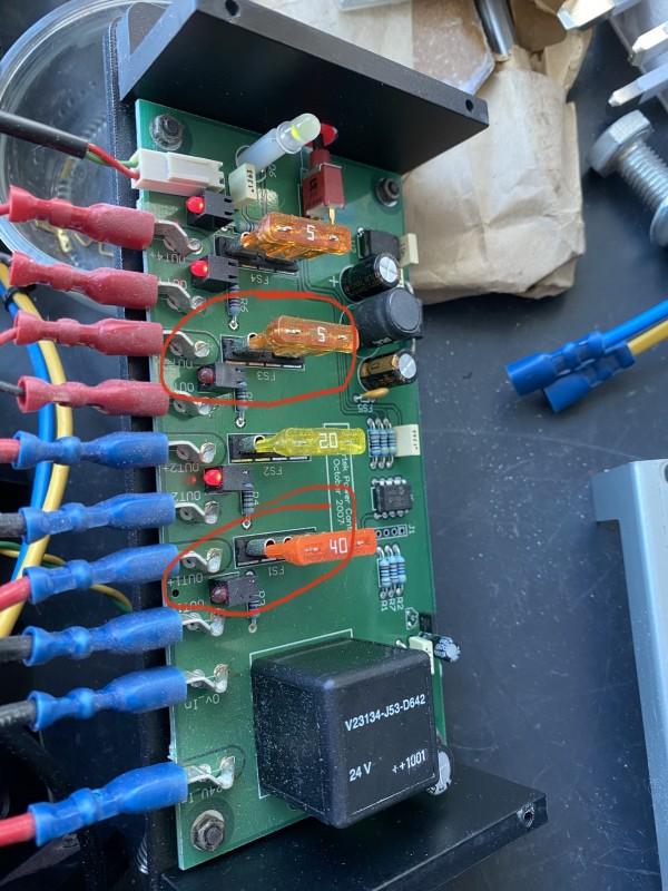

Would anyone know; why these two fuses blow? It seems triggered by the main drive motors. They don’t blow if I hold the spring loaded right hand stick back, but immediately I start to advance, they blow.
Thanks in advance!

They're blowing because you're drawing too much current :D
I would guess there's a short circuit somewhere.
The 5A should be powering the Amplifier Module, but I can't see how driving would blow that as there's no link between it and the Motion Control Module apart from through the receiver wiring, and that would be burning before a fuse blew.
Does the 5A still blow if you remove the 40A fuse in place ? And vice-versa ?
You need to go through the wiring and isolate the fault.
I'm also curious as why you have to hold the spring loaded stick back ? It's normal to have them centered when the tank is not moving, in both single stick and dual stick mode.

Hi Adrian,
Thanks for the reply. I was holding the stick back because the transmitter was warning me “Throttle High!” But of course you’re right, they should be centred for a tank.
I don’t know why I’d be drawing too much current, it’s a bench test, with no load on anything.
I’ll have to experiment with fuses. How do you find a short circuit? Sorry for the idiot questions, I don’t know anything about electrics!
Cheers.
