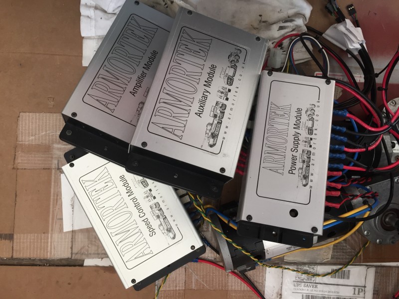

Not really what I’m good at! I have the older set up from 2010/11, but one of the newer motion control modules. Can I use that with the one/some of the (amplifier) older modules? What radio transmitter would you recommend? Thanks in advance!

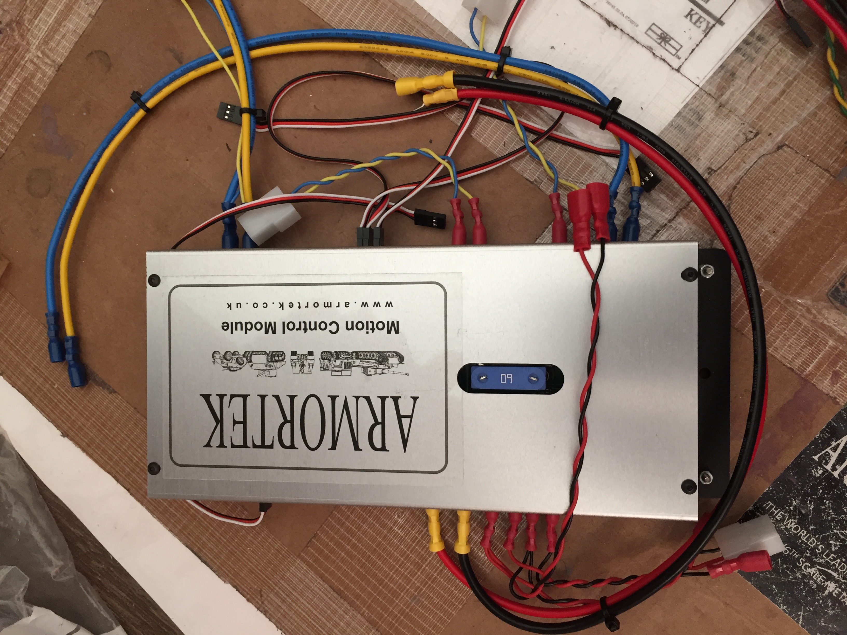

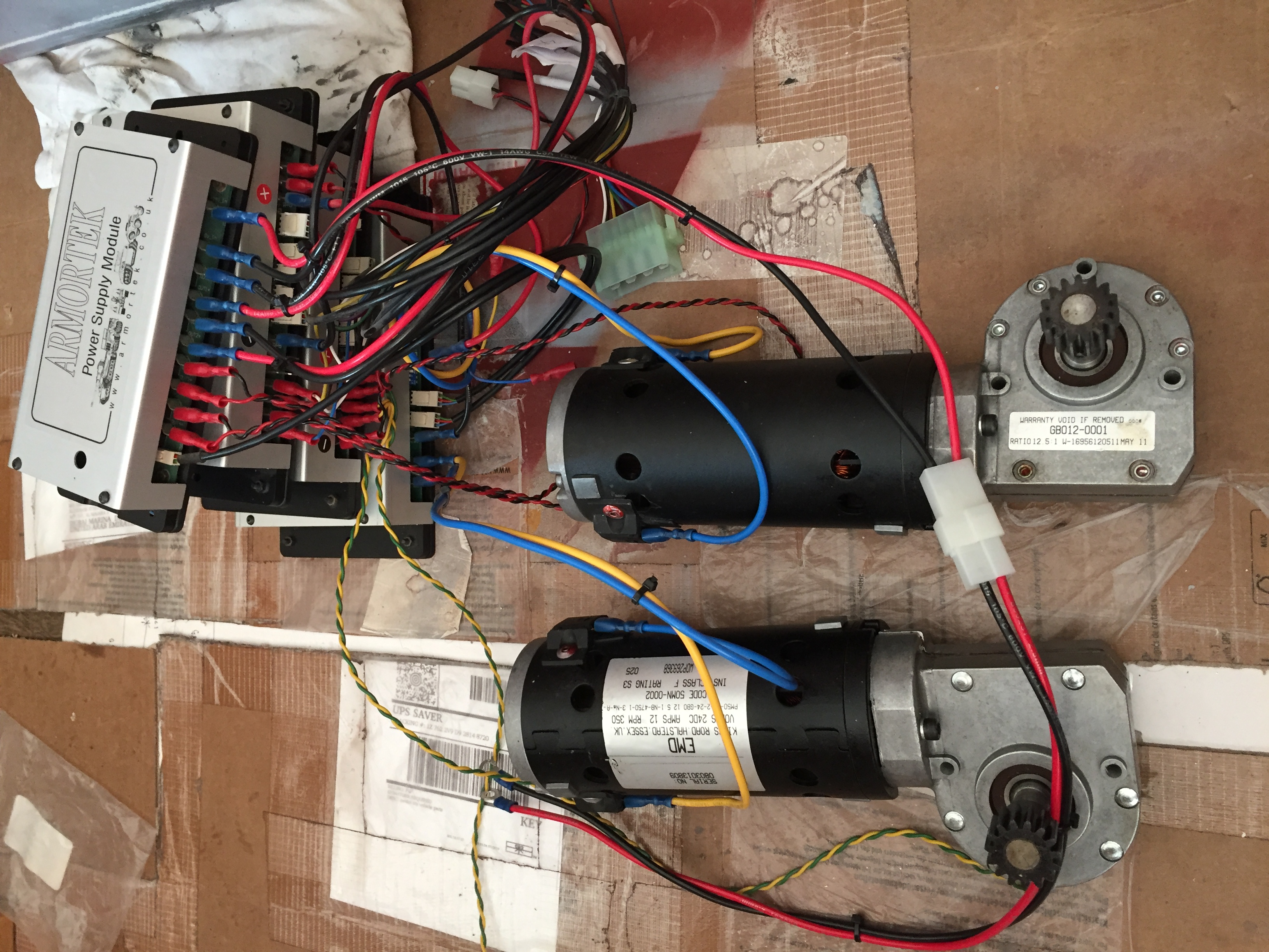

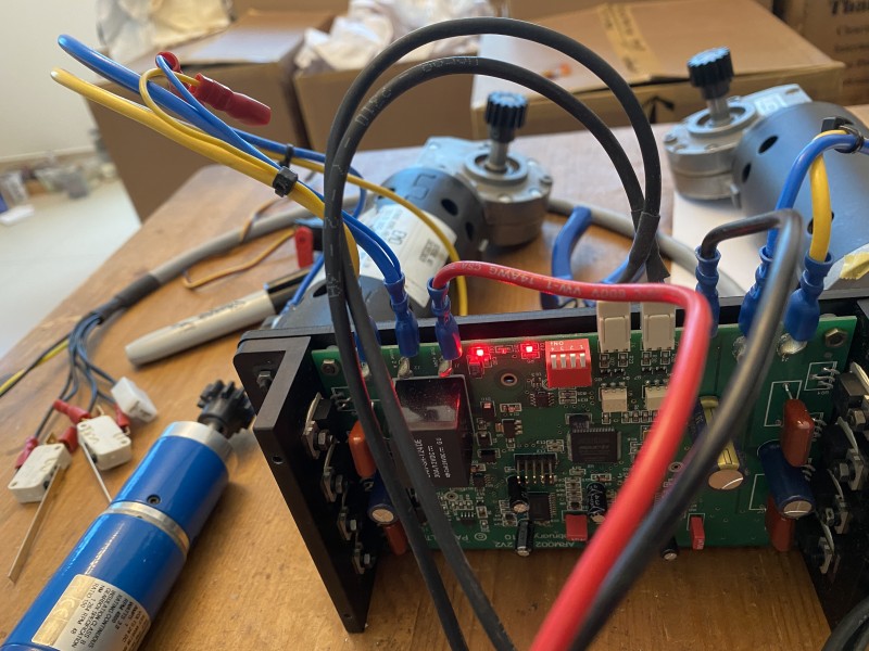

Dear All. Bench testing: everything works, except the main drive motors don’t respond. I’ve plugged them all different ways and no luck. I’ve and tried them direct to battery and they turn, so motors are ok. Any thoughts? Cheers!

Check the spade connectors the motor wires plug on too are soldered in the board correctly.
On more than one occasion I have had dry joints where the pins are through the board.

Do the LEDs change brightness when you move the sticks ?
It looks like you have the older style connection cables. Which way round have you got them in the receiver ?
Earth - Armortek = Green Futaba = Black JR/Spektrum = Brown
Power - Armortek = Red Futaba = Red JR/Spektrum = Red
Signal - Armortek = Blue Futaba = White JR/Spektrum = Orange
There should be a diagram on the receiver to show which way round the plugs go in.

Thanks Derek, that’s interesting, I’ll check that tomorrow! Odd that both motor connections would be dry though!?
Hi Adrian, yes brightness changes. I have two identical setups, the other works faultlessly.

Does the relay click when you move the sticks ?
Does it behave the same as the working one ?

Yes, relay clicks. The sound, gun elevation turret rotation motors work same as the other one.

I notice one of the RH drivers is missing it's nut, and is sitting away from the heatsink, which may have resulted in it suffering heat damage.
Or the loose nut may have shorted something on the PCB.
I've repaired a few of these but I don't think I've ever had one which was dead on both sides.

Adrian, thank you, very observant! Nut replaced. These units were all originally plugged together by Armortek at my request. Not sure if they were ever test run. I’ve not had it switched on long enough to build up any kind of heat. As for the nut shorting something, I can’t say for sure. How would I check it? Thanks again.
