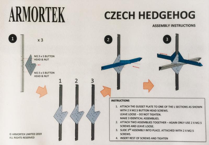

Received the little hedgehog kit this morning. Looks a nice little “weekend” kit.Bought just the one for now to see what it’s like.
I’ll be finishing mine in the very dark blue as often used in the east rather than the beach brown.
Filling in the button head bolts with putty will be a bit tedious. Some experimenting to do texturing the finish and adding some rust on some scrap angle section.

Assenbled and I think I’ve got the bolt pattern right.
Also tested the textured paint on some scrap. Will look good once the final colour is applied and rusted a bit.

The bolt patterns do seem to vary a lot. Found a photo of two sitting side by side and they had been bolted together differently. May make some minor changes and will be fitting a few hex head bolts as again found photos where a few hex head bolts had been used.
Two sections were fastened together in the factory and the third fitted in the field which would explain the differences.
