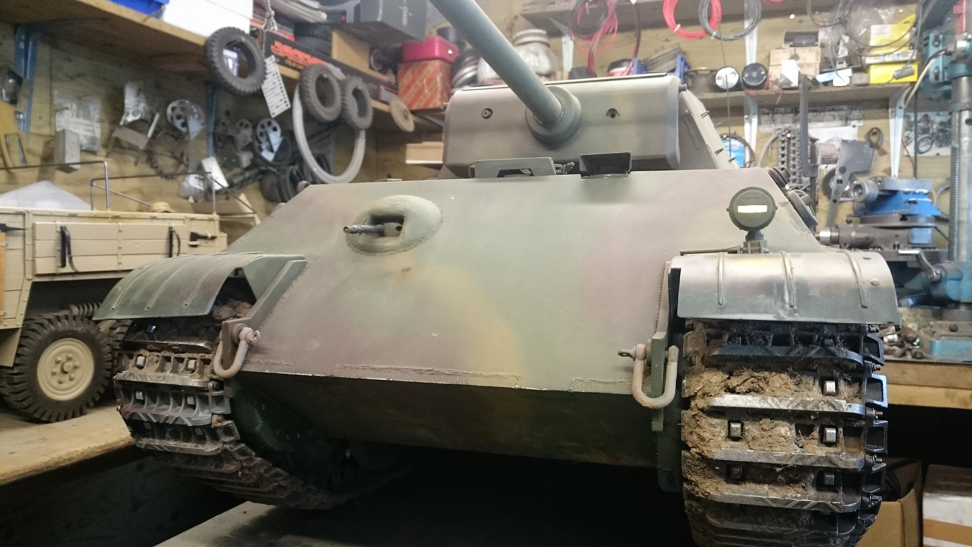

My recently acquired Panther turret number 112 (thank you Chris) When I get a minuet I will be upgrading the electrics, there's a problem with the off side rear idler and the turret traverse is not working.
My plan is to address the above issues, it's very high spec with an 8 channel radio and was refurbished a while ago by one of the best builders on this forum.
I will add new speakers, the latest panther sounds, a high pressure smoker and a dedicated esc for the turret traverse motor, plus a few more bits and pieces I expect.
The Panther will be towed by the new Famo, recreating many of the photos that we have come to love with lots of video to (roll on the spring and summer of next year). I have already filmed the Panther returning from the battle field coming under small arms and mortar fire, this I shall post to Youtube as soon as the editing is complete.

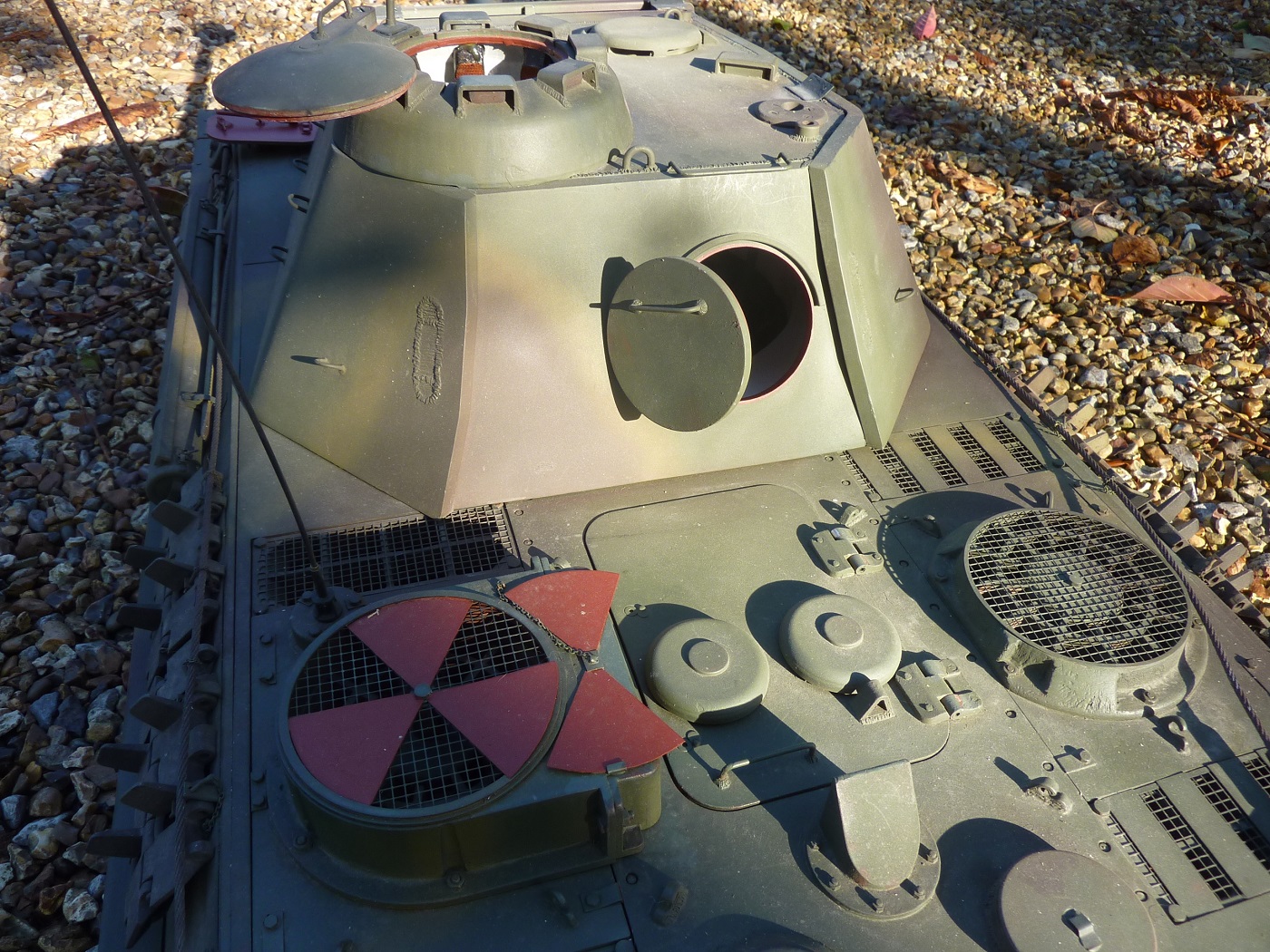

Some stills of the VT and how she looks right now.

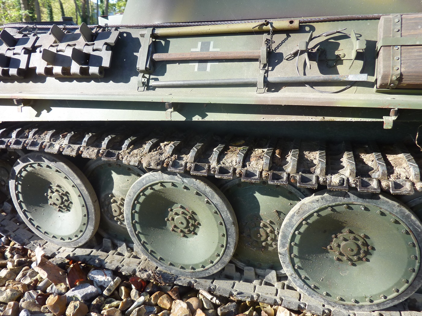

The mud on the tracks looks great and the 'misty' morning is atmospheric!

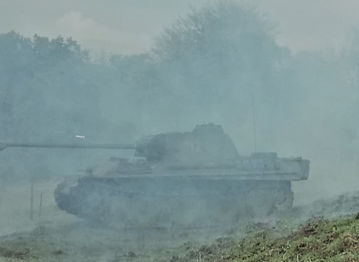

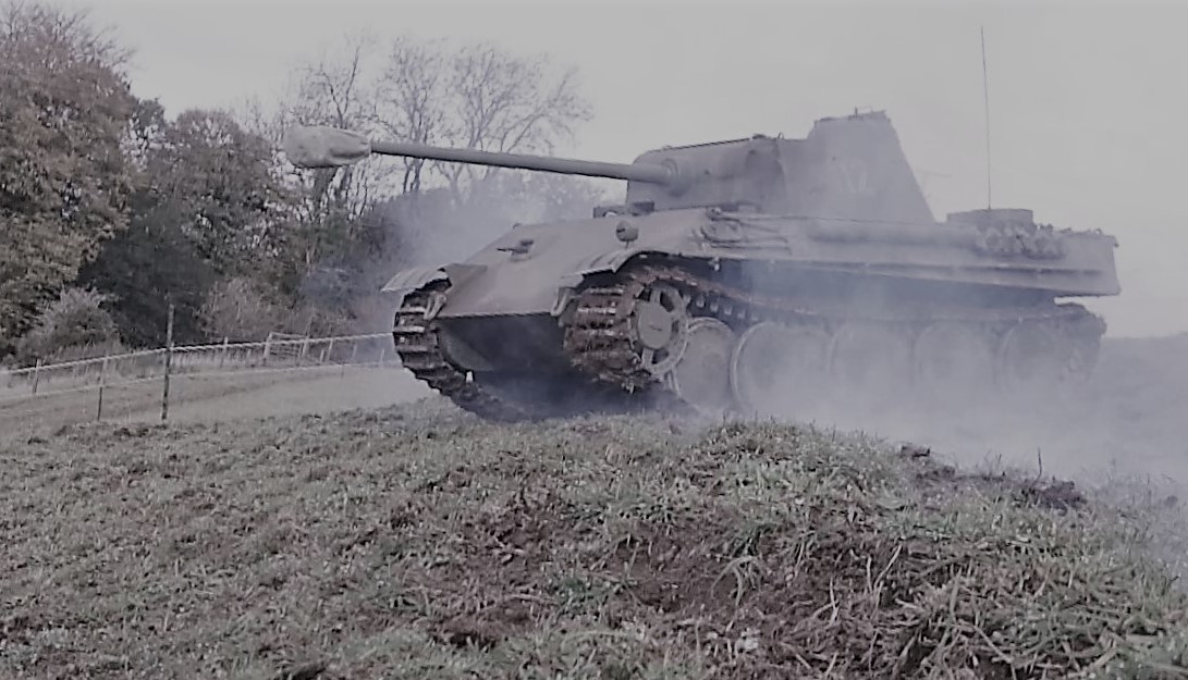

Stills from the video.
Re: Panther 112

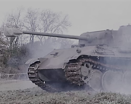

The video.

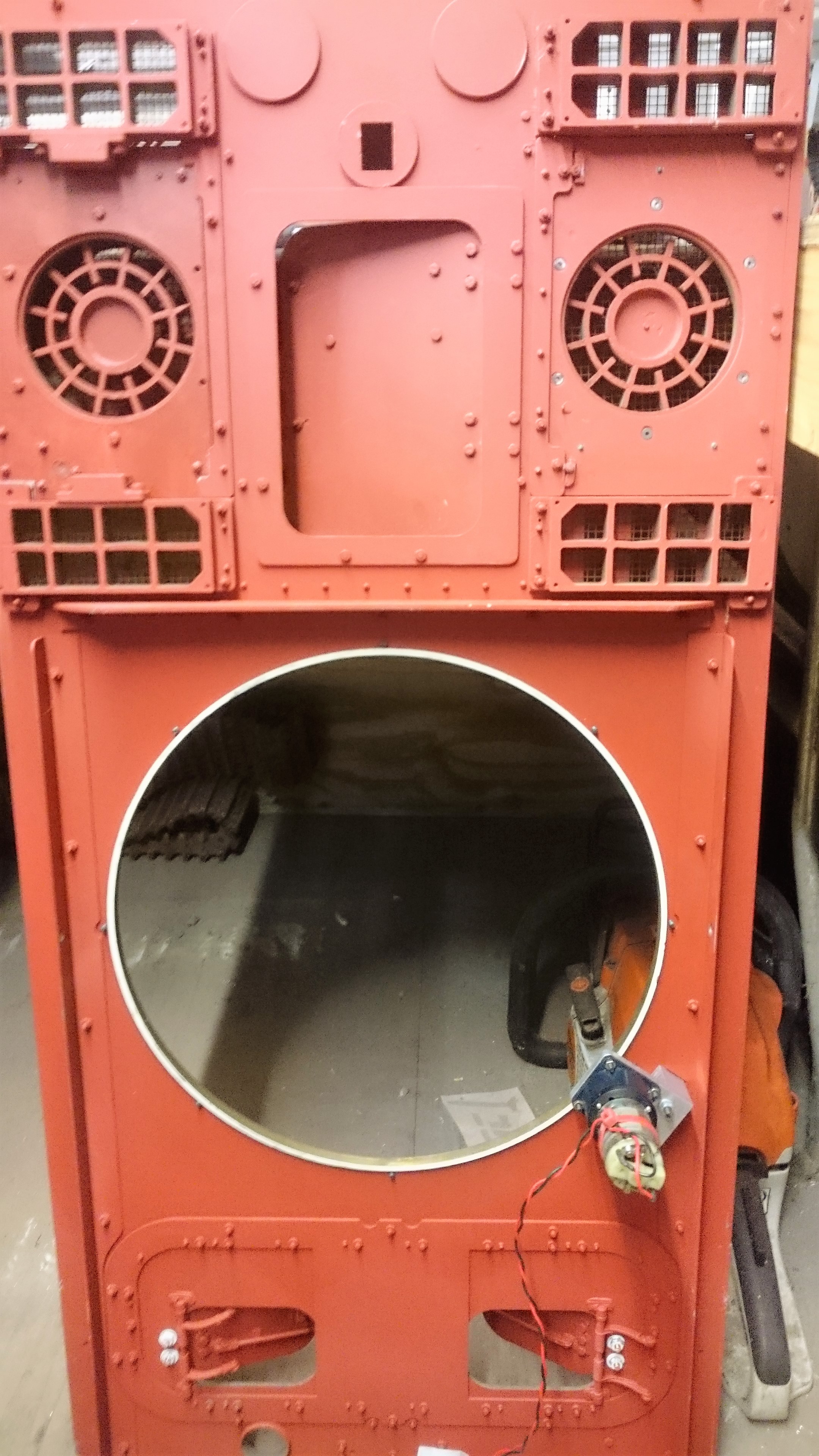

I've made a start on 112, greasing the final drives and general maintenance. this gives me an opportunity to look over the vehicle.
Lovely condition with an excellent patina. The last thing you want to do is clean it, so just the area to be worked on needs a clean before disassembly to keep the dust away from the oily bits.

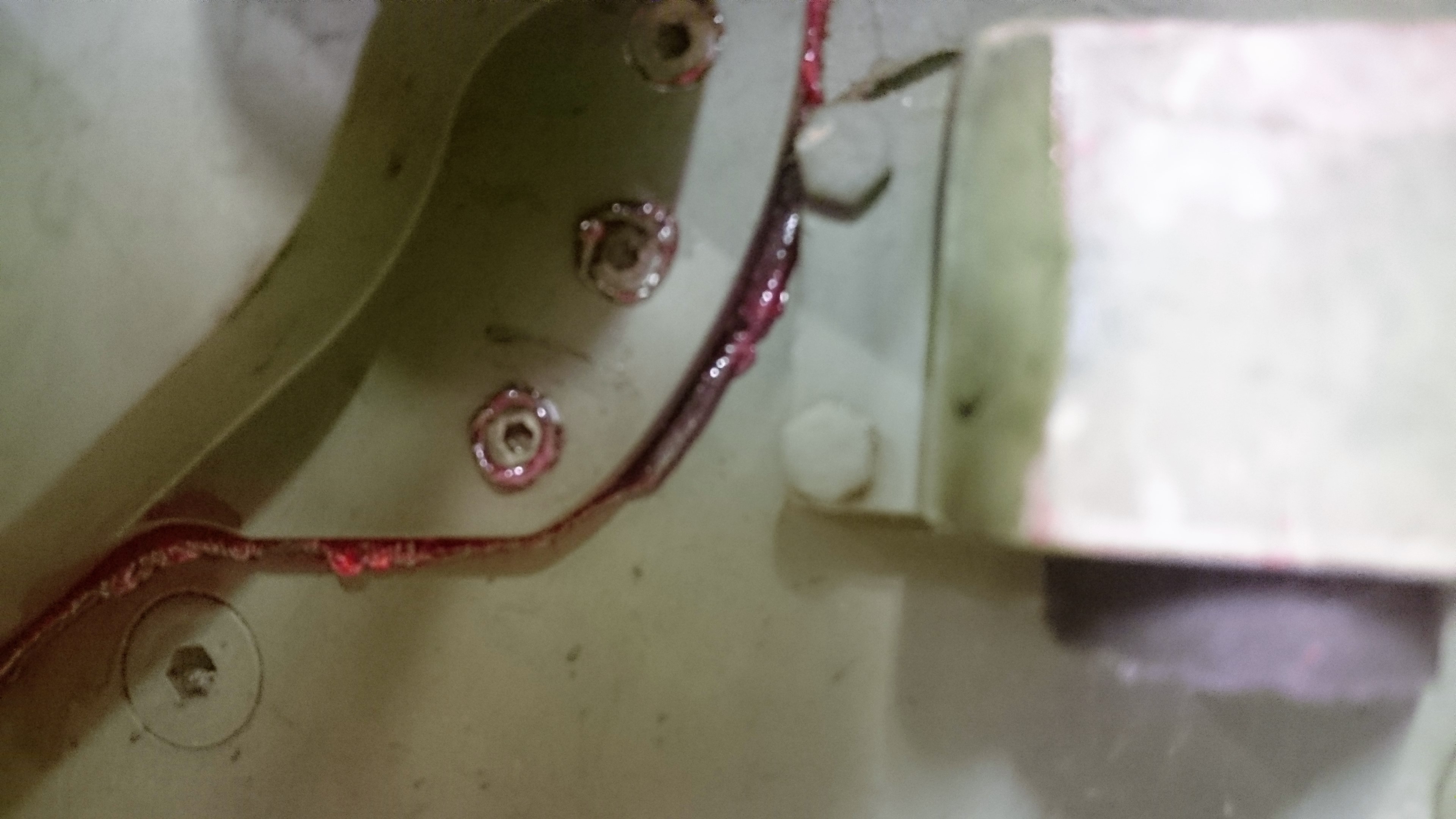

As usual cable ties required on the smaller motors, I see the lack of these all the time, it's such a simple job to do and as I said it's stops the cable breaking off at the soldered joint.

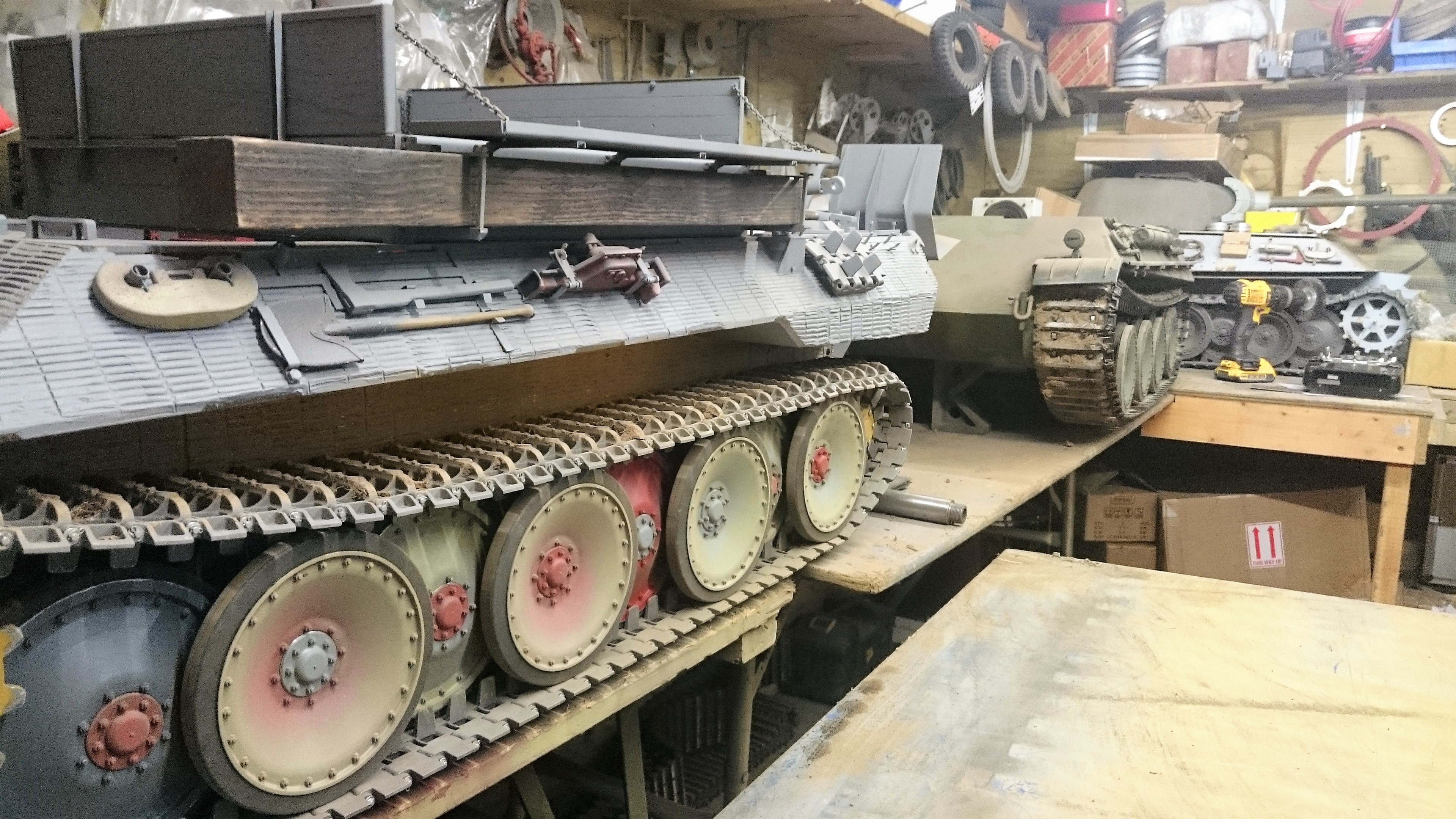

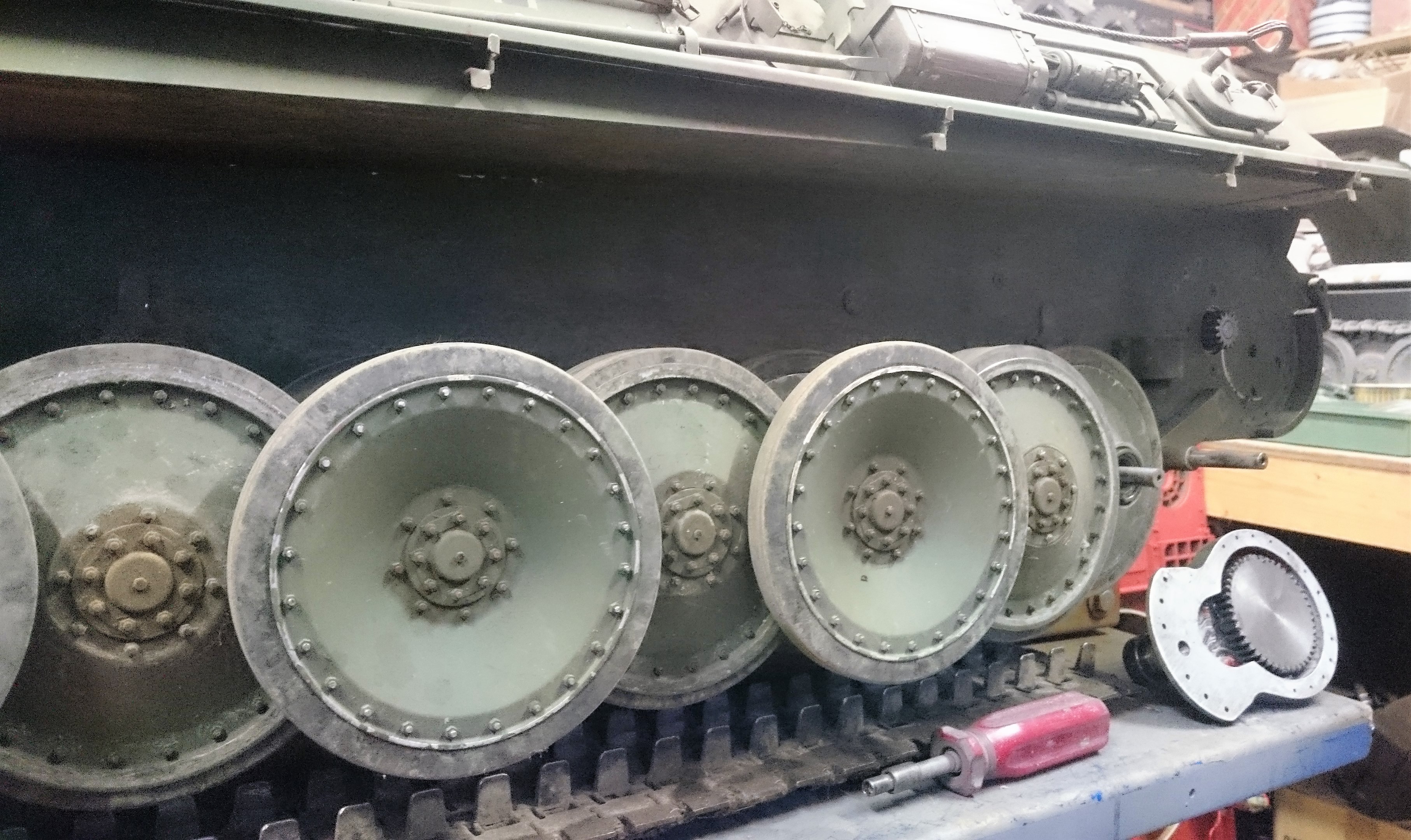

As the weather is not good I'm in the tank shop working on the Panther running gear.
A busy tank shop is just heaven for me!

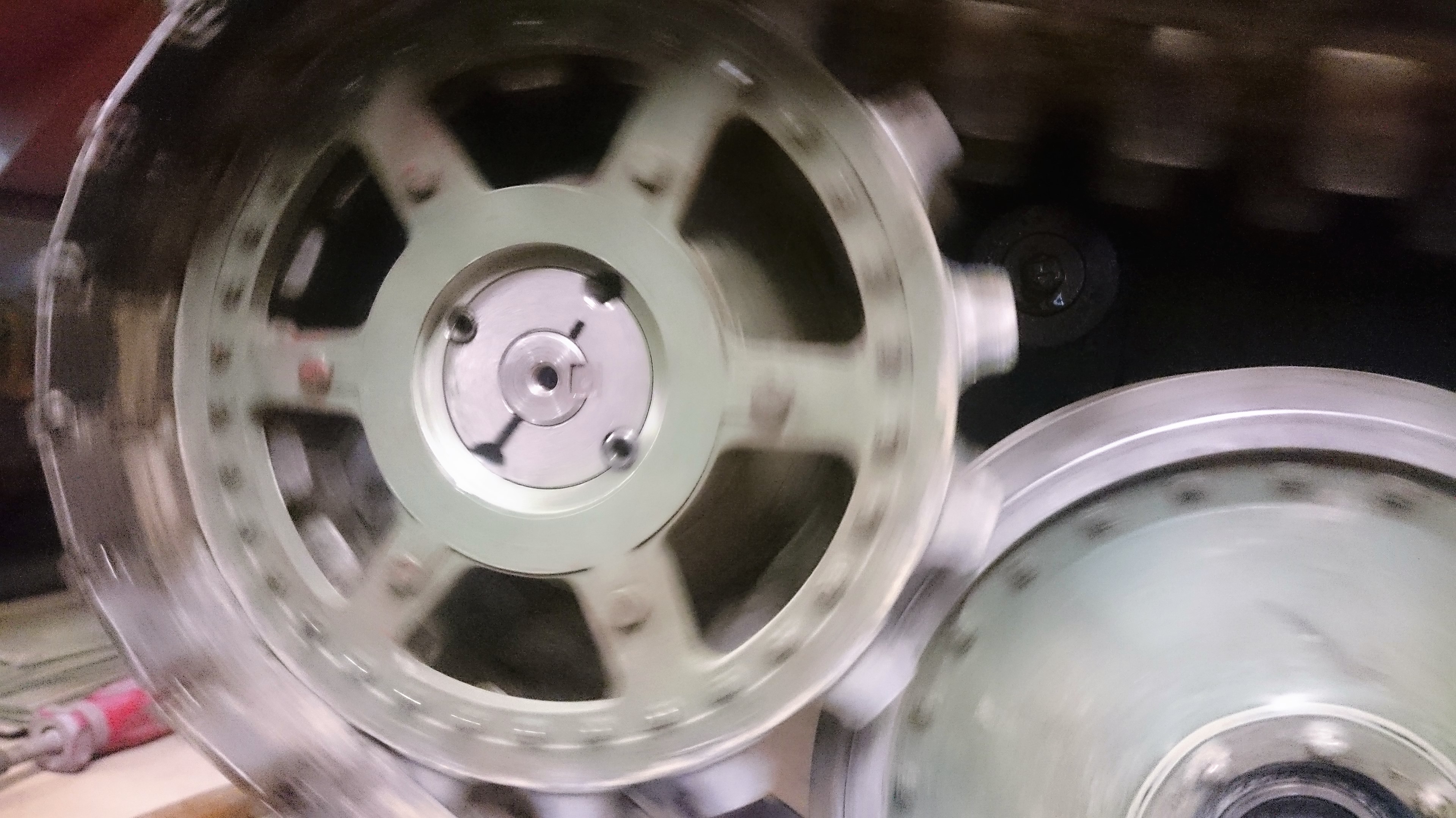

The final drive cases all greased up and sealed against the dust and water, just wipe away the excess grease after tightening.

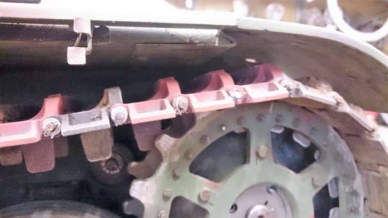

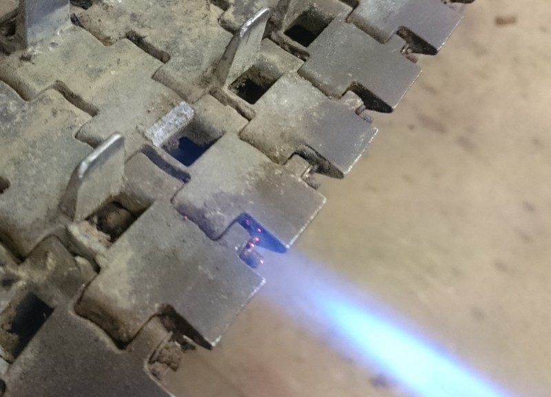

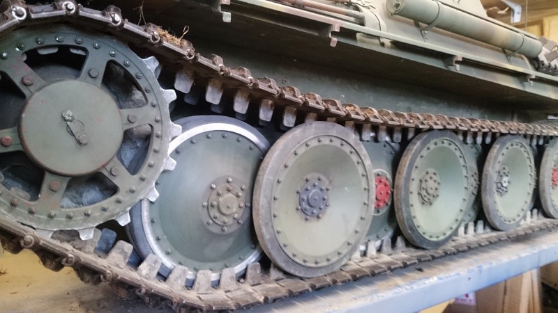

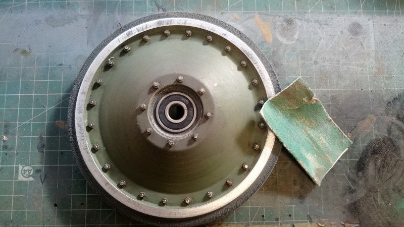

A tip, apply a little heat to the split pins if they are a bit stubborn to get them to move, same goes for the track pins. Then use a brass drift to start to move the pin, then use an old track pin to push all the way out.

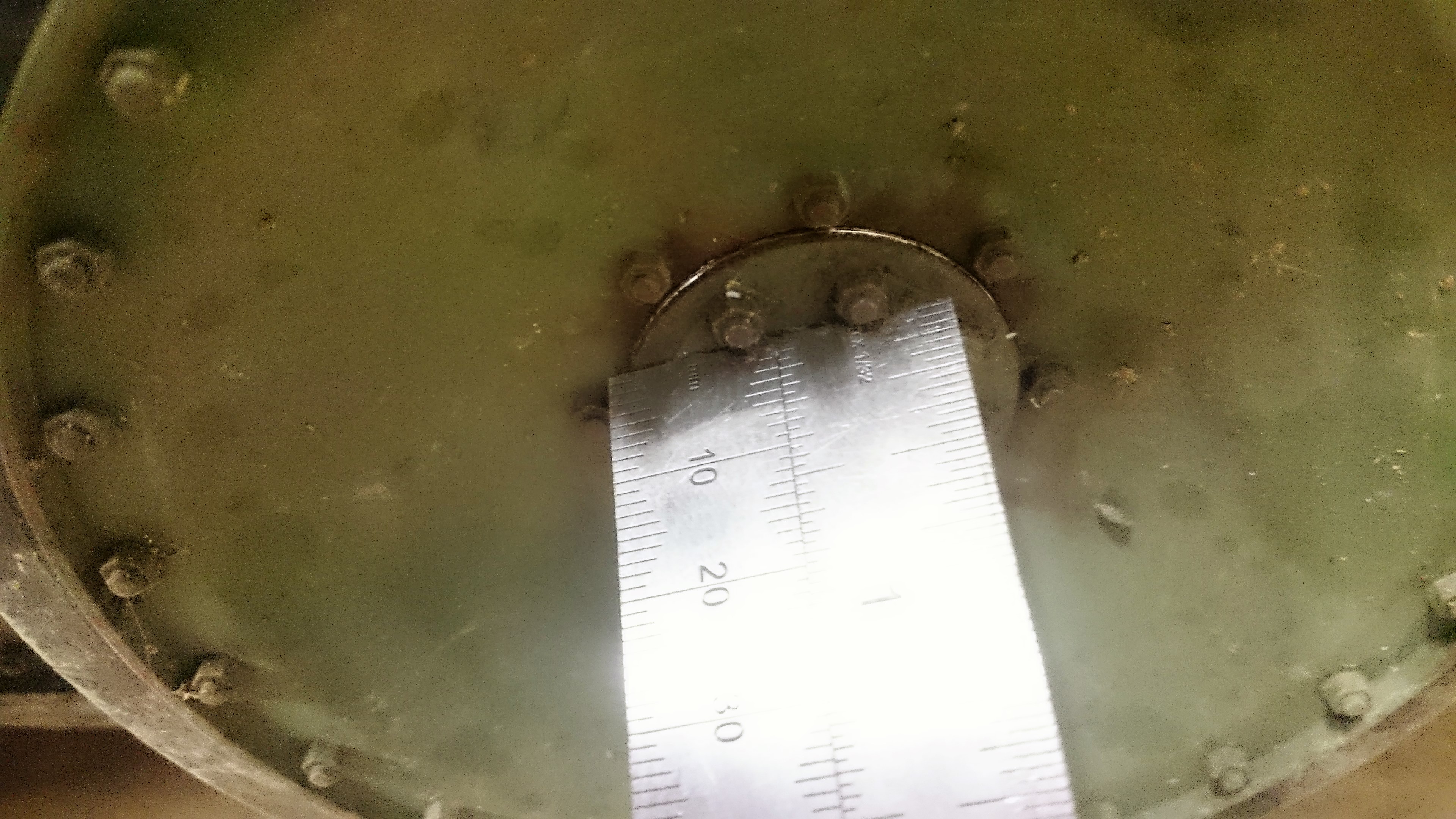

Here's a useful tip, use your Rabone Chesterman steel rule to to turn the threaded wheel centers, it fits just great as not much else does.

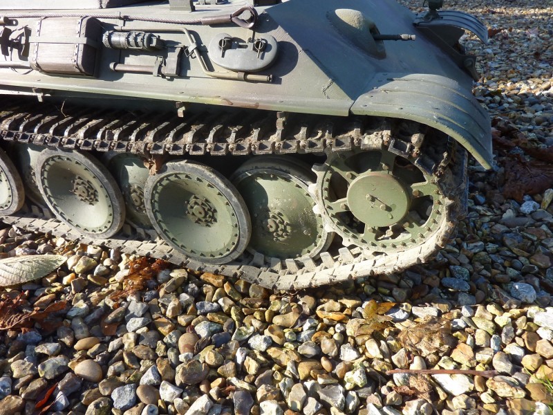

New track links fitted as several had horns missing probably due to drive way gravel stones getting caught, a good reason to avoid drive way gravel altogether.

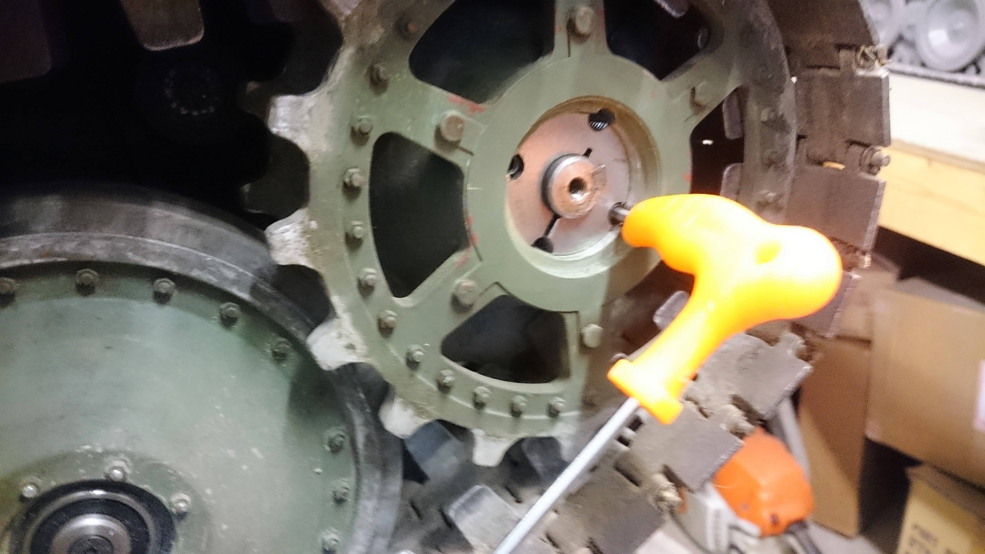

On this side the sprocket is happy at this position on the final drive shaft, so here it will stay as the wheels are equally between the track horns and it sounds just fine as it all goes around, in fact it makes the unmistakable track clatter that only a Panther does.
Setting up the sprocket position, basically as i have said before, leave the taper lock lose and gently run the tracks around slowly and let the sprocket find it's own comfortable position, (within reason of course if it has a serious fault then fix that first) then tighten the taper lock but just check those last two road wheels are sitting equally between the track horns.

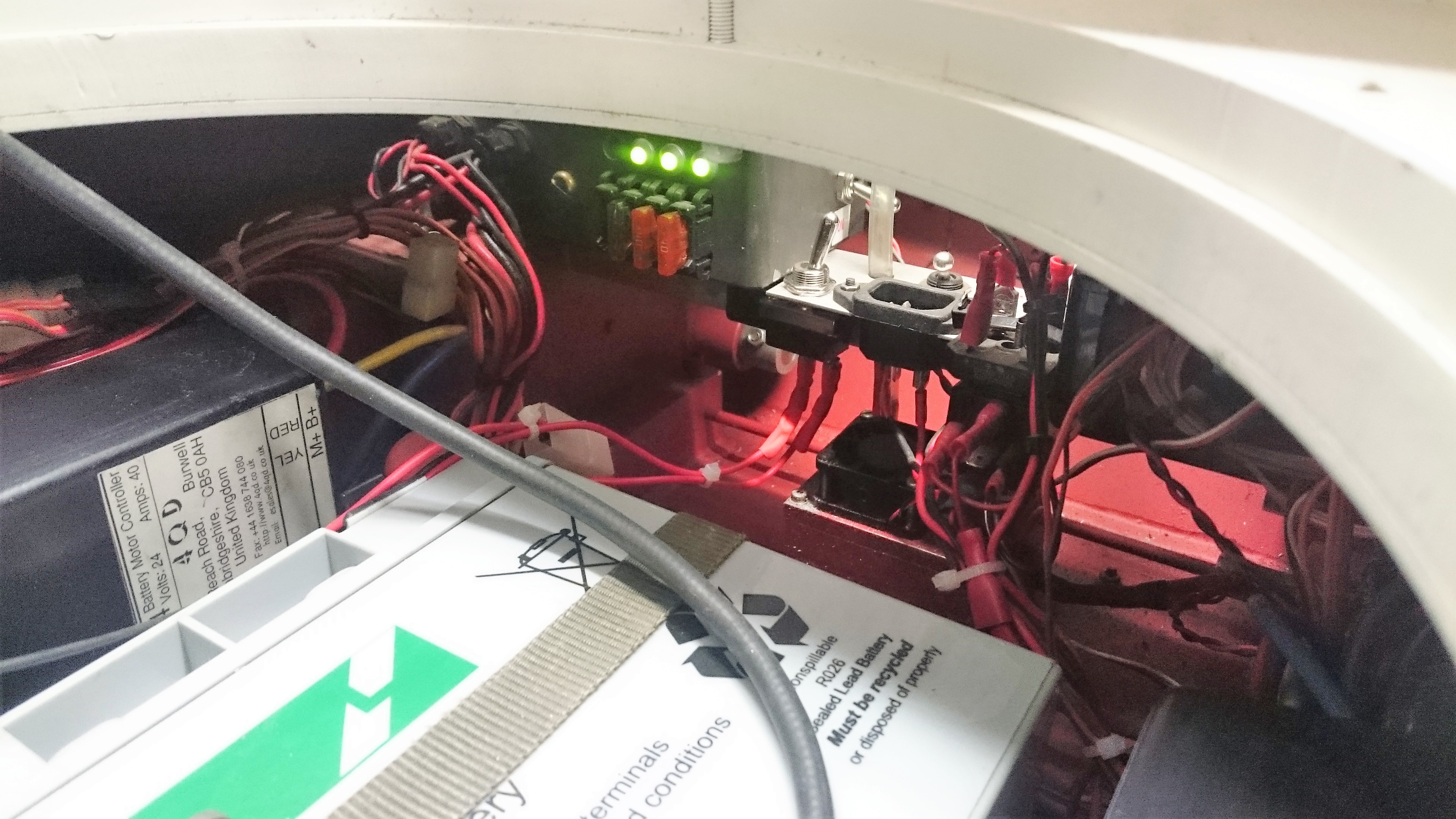

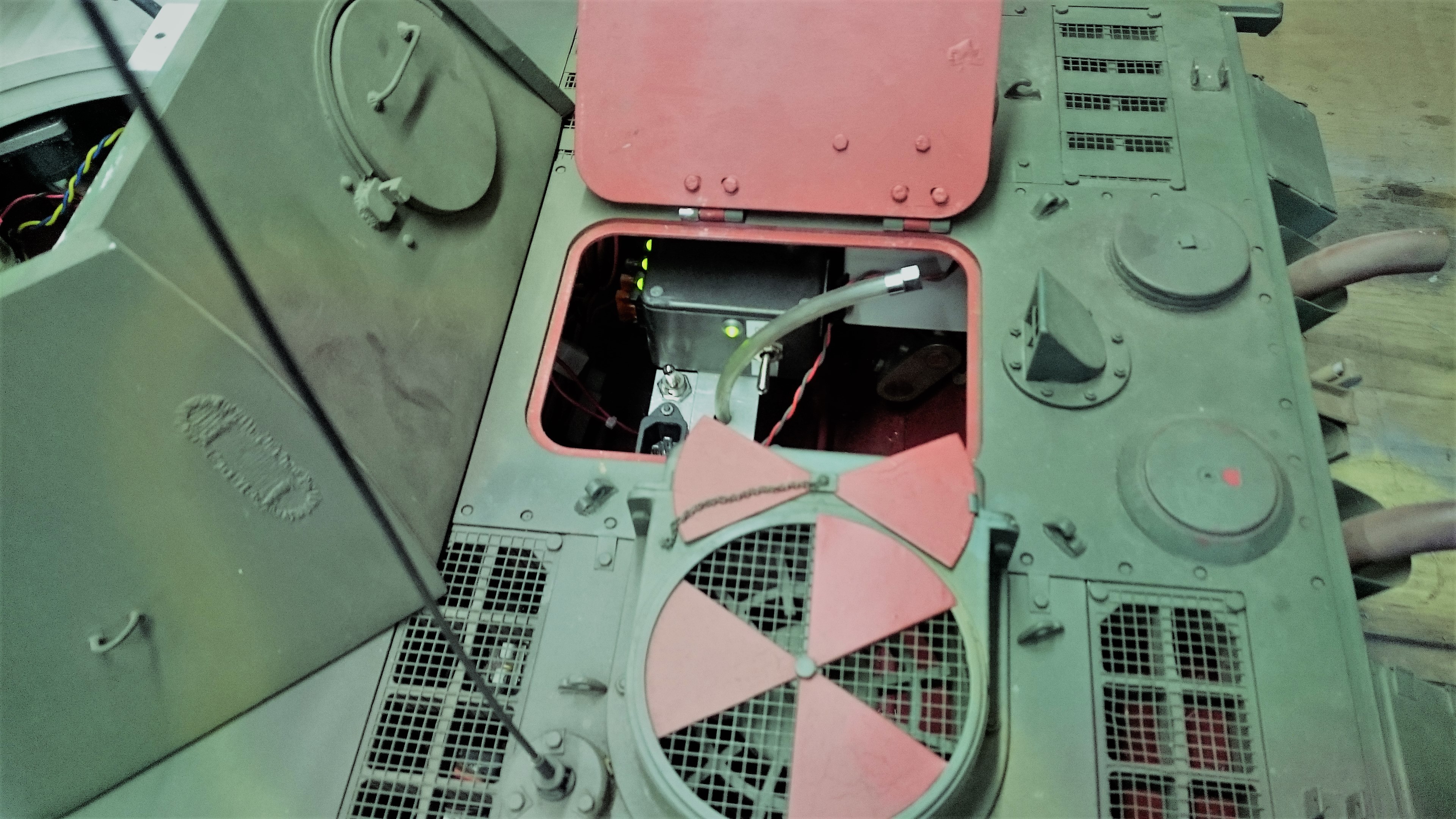

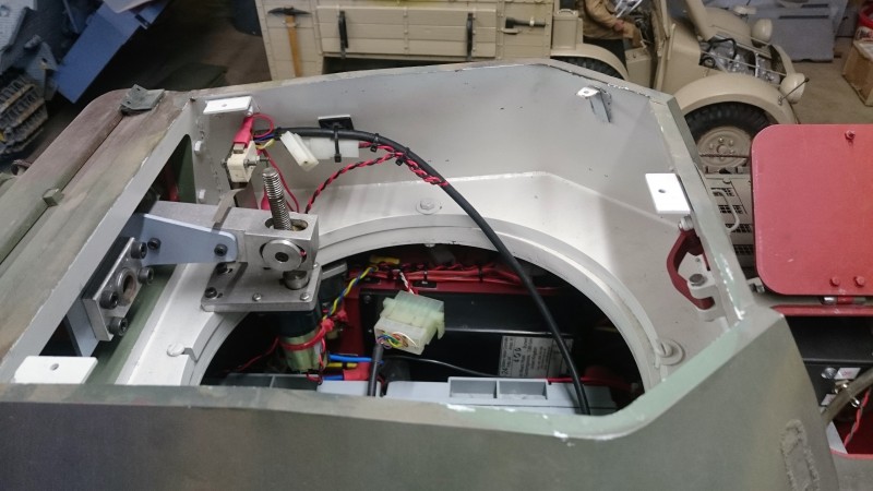

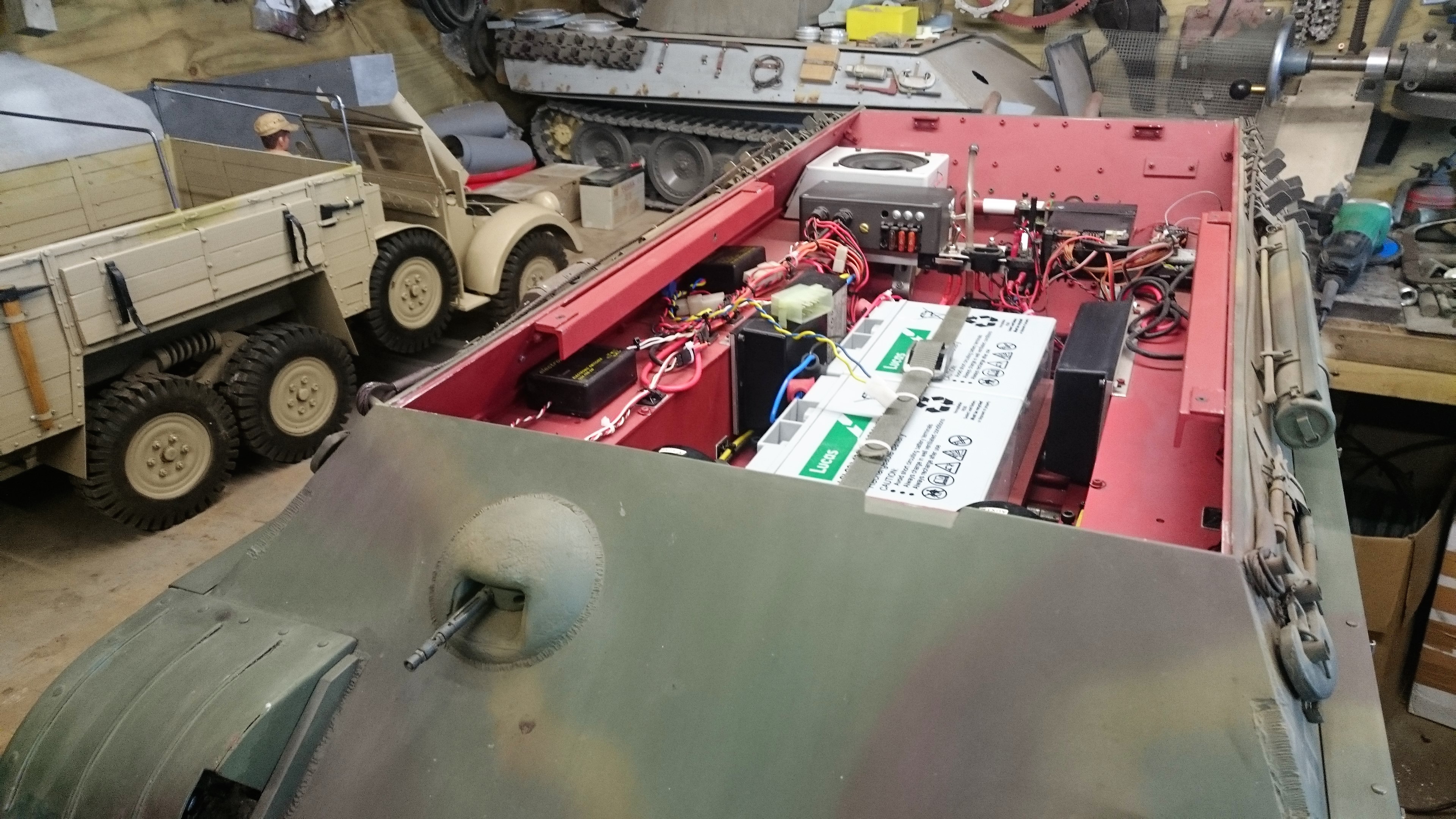

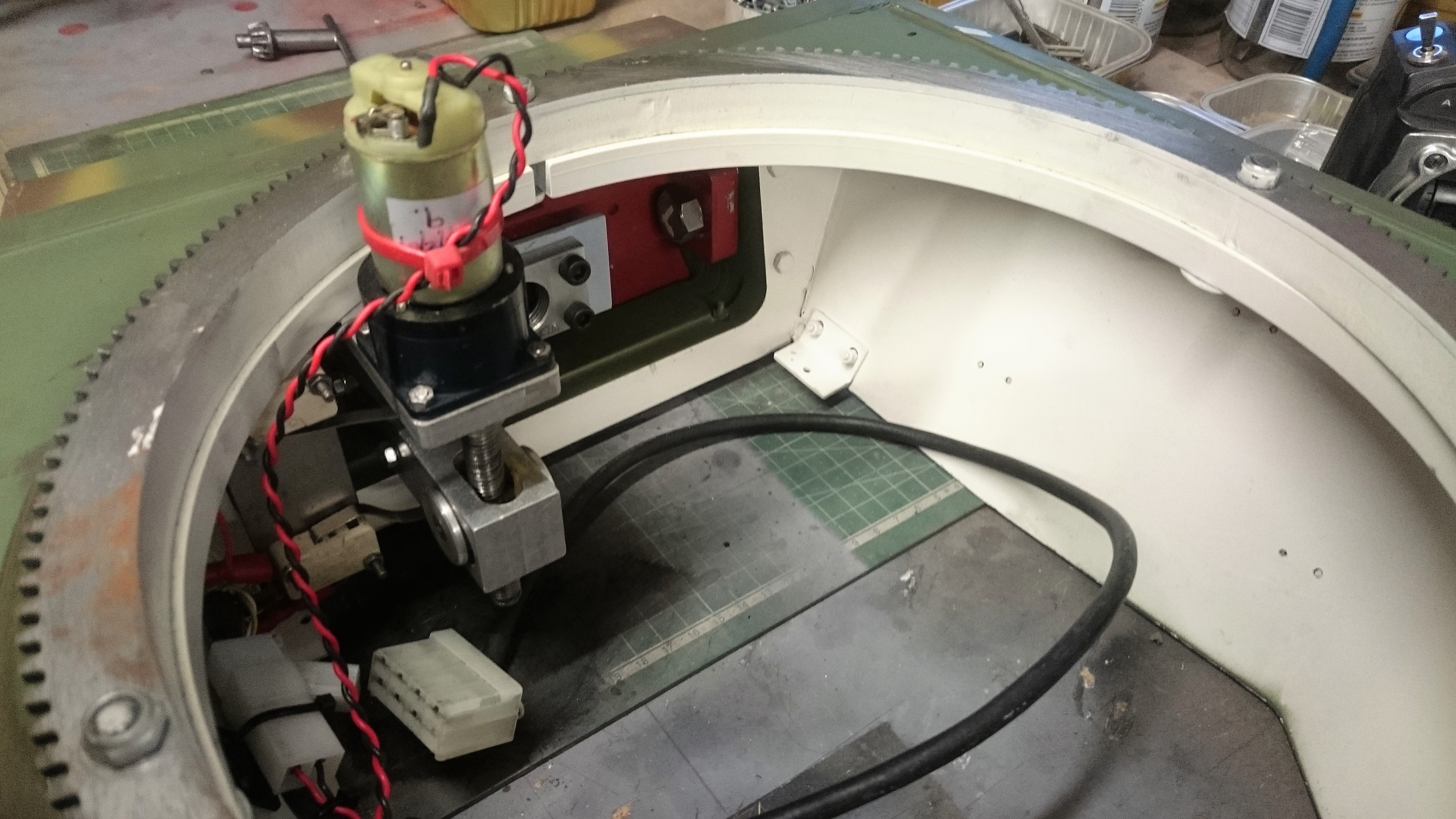

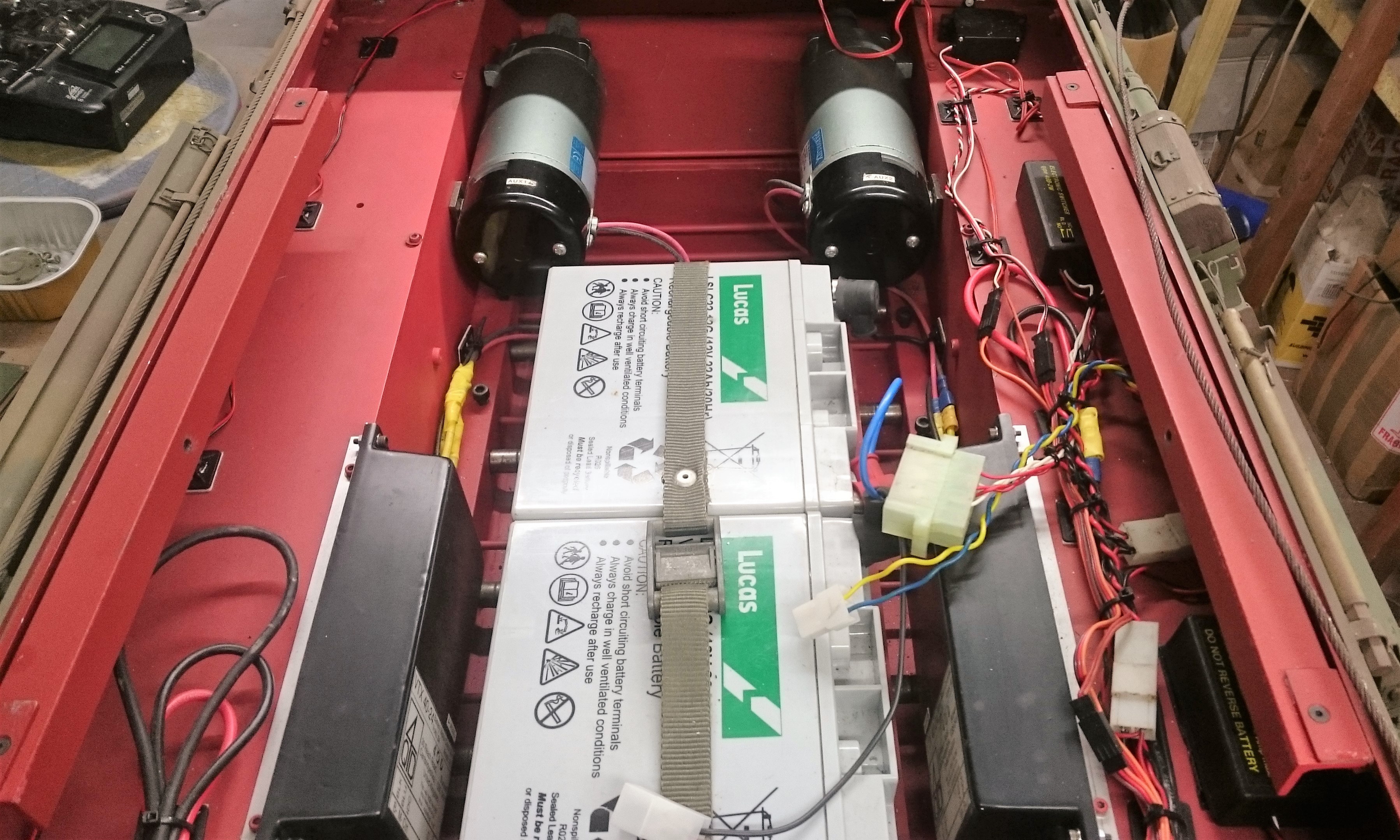

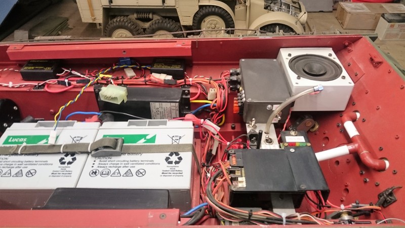

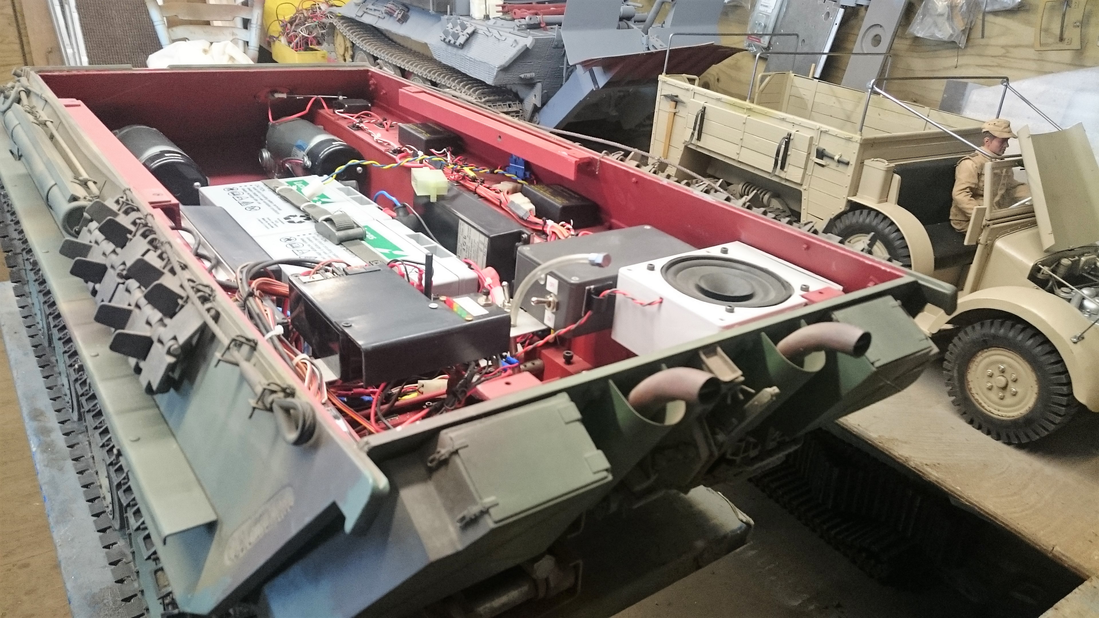

This little beauty is just about ready, I have tidied the wiring, added heat shrink where necessary, it now has fully proportional turret traverse, some new track links here and there, the oily bits are oiled, the final drives have been packed with grease,all the lights are now working,all in all a very well put together late war Panther which now runs and drives perfectly
I will post on the for sale and wanted very soon, I need to drive it around for a while with a big smile on my face first! :D Regards Phil.
Nicely set out interior, very neat and tidy.
There's a lot going on in there, really i have not had to do that much so that will reflect in the asking price.
It's spotless in there
The electrics are a bit old school and in a way easier to understand.

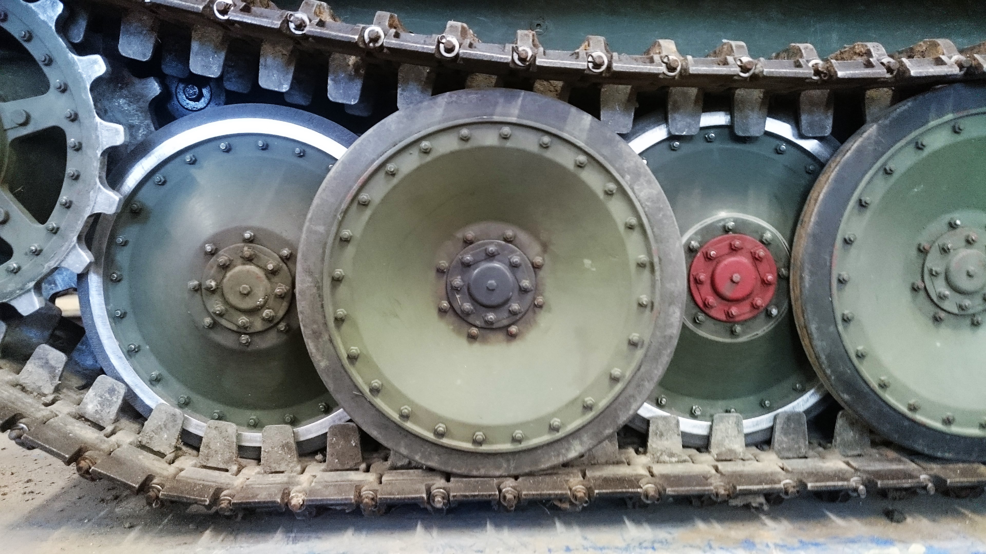

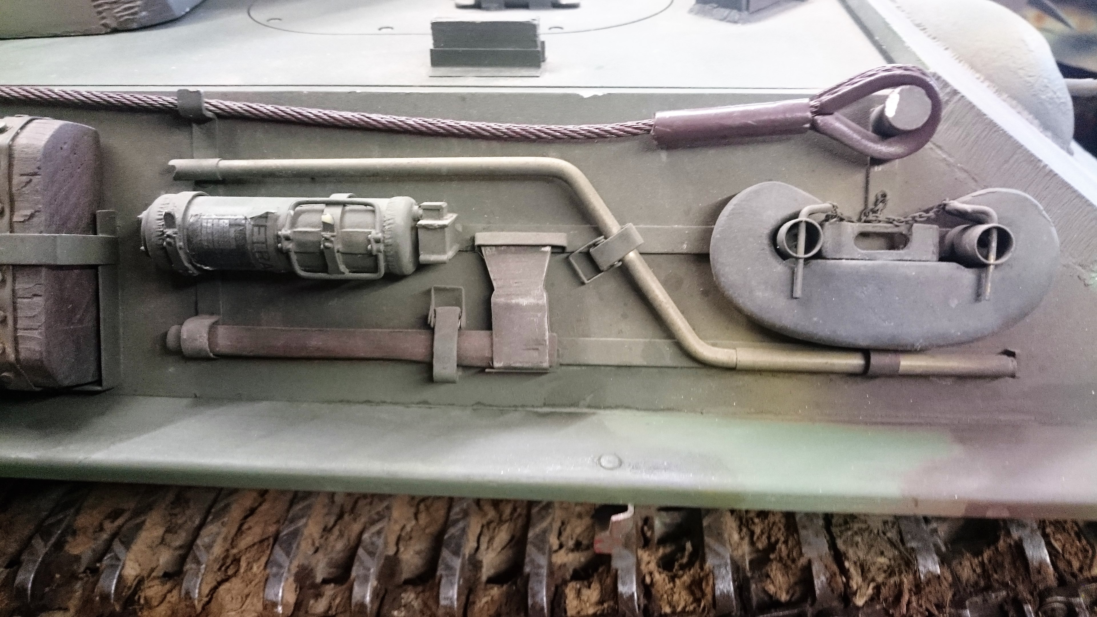

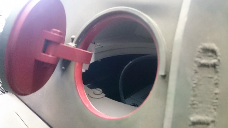

Some more photos. Panther film showing the polished middle wheel rims, don't paint or polish every one, be random.

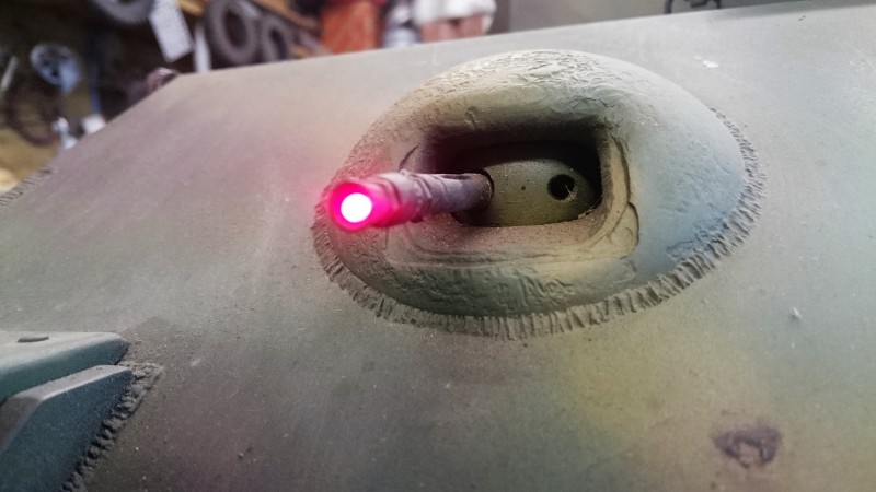

Working steel barrel travel lock

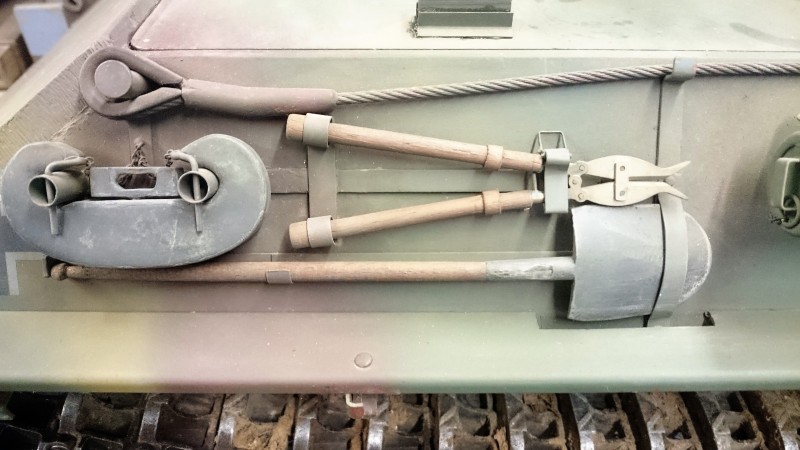

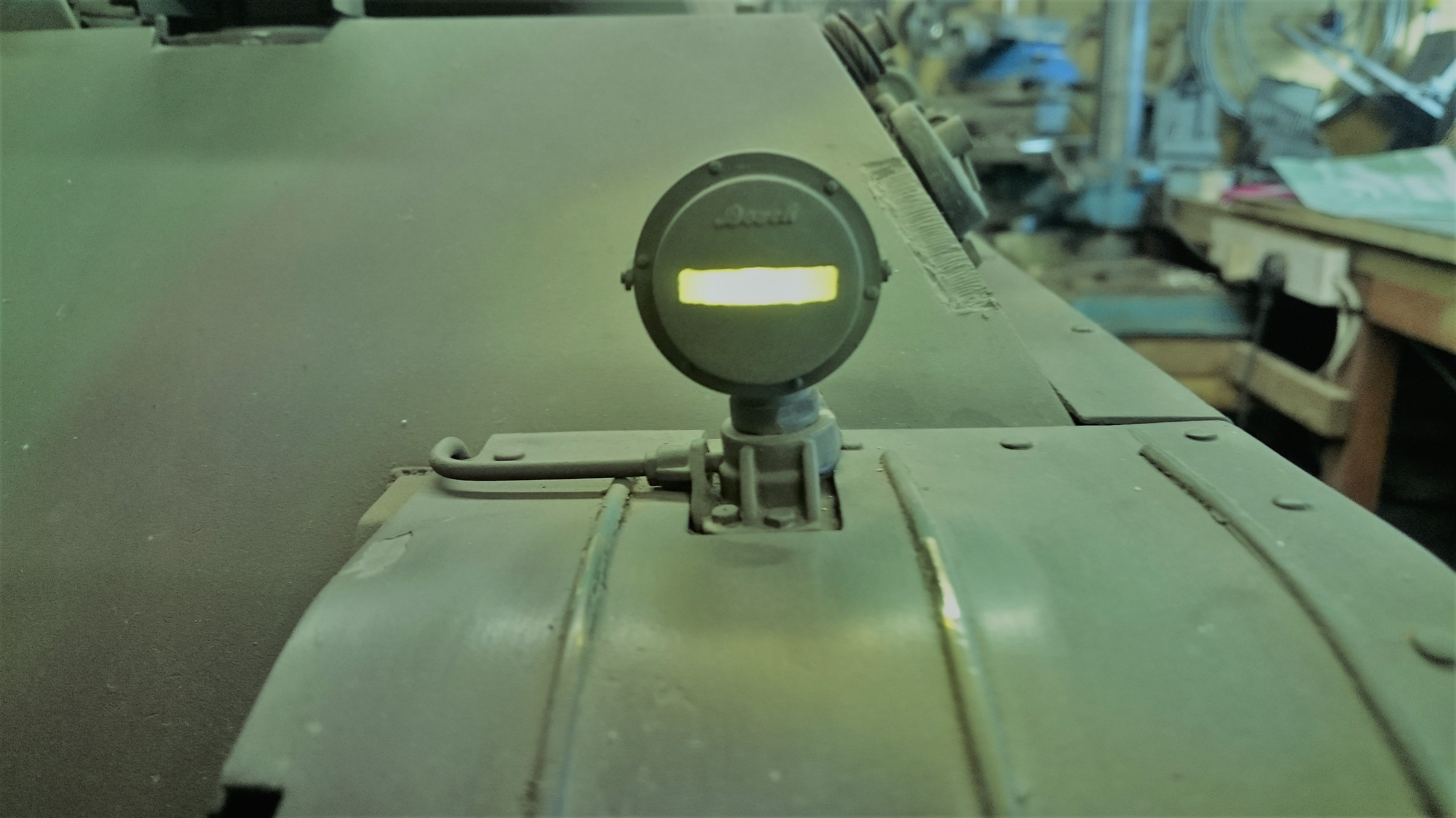

Working wire cutters with wooden handles, many other gucci parts dotted all over.

The Panther is headed my way! I can’t wait to get my hands on it.

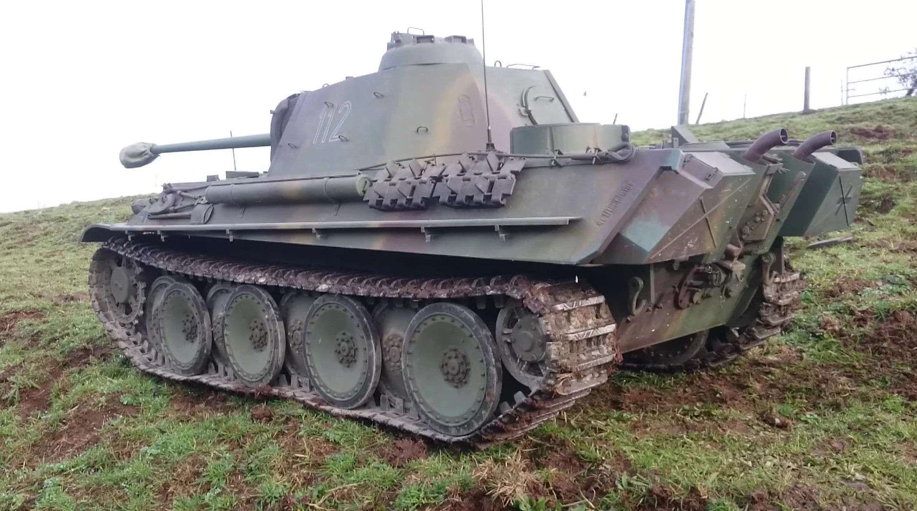

Does anyone know if these exhaust pipes are accurate. Or should it have spark arresting mufflers to be more accurate?
Steve Norris
Posts: 1231
Location: Manchester
Has liked: 8 times
Been liked: 701 times
Re: Panther 112
Post by Steve Norris »
Hi Brian
Congratulations on your purchase, it should be in really good condition after Phil has worked his magic on it.
The exhausts on late war Panthers varied, I think it was a matter of what was available in the parts bin at the factory when they were assembled. No need to change them but if you prefer the flame damping type you could put those on and it would still be correct.

When I owned 112 it was definitely my intention to fit the flammenvernichter. It's been built with some very late (March - April 1945) adaptions, so I felt the exhaust guards would be 'right'. It's a personal choice thing though and, as Steve rightly says, there's a world of difference between what the textbooks say and Real Life ......
Another thing I was considering was swapping the rear wheels for the all-steel versions as used on the late Tiger 1. Another very late War adaption.
