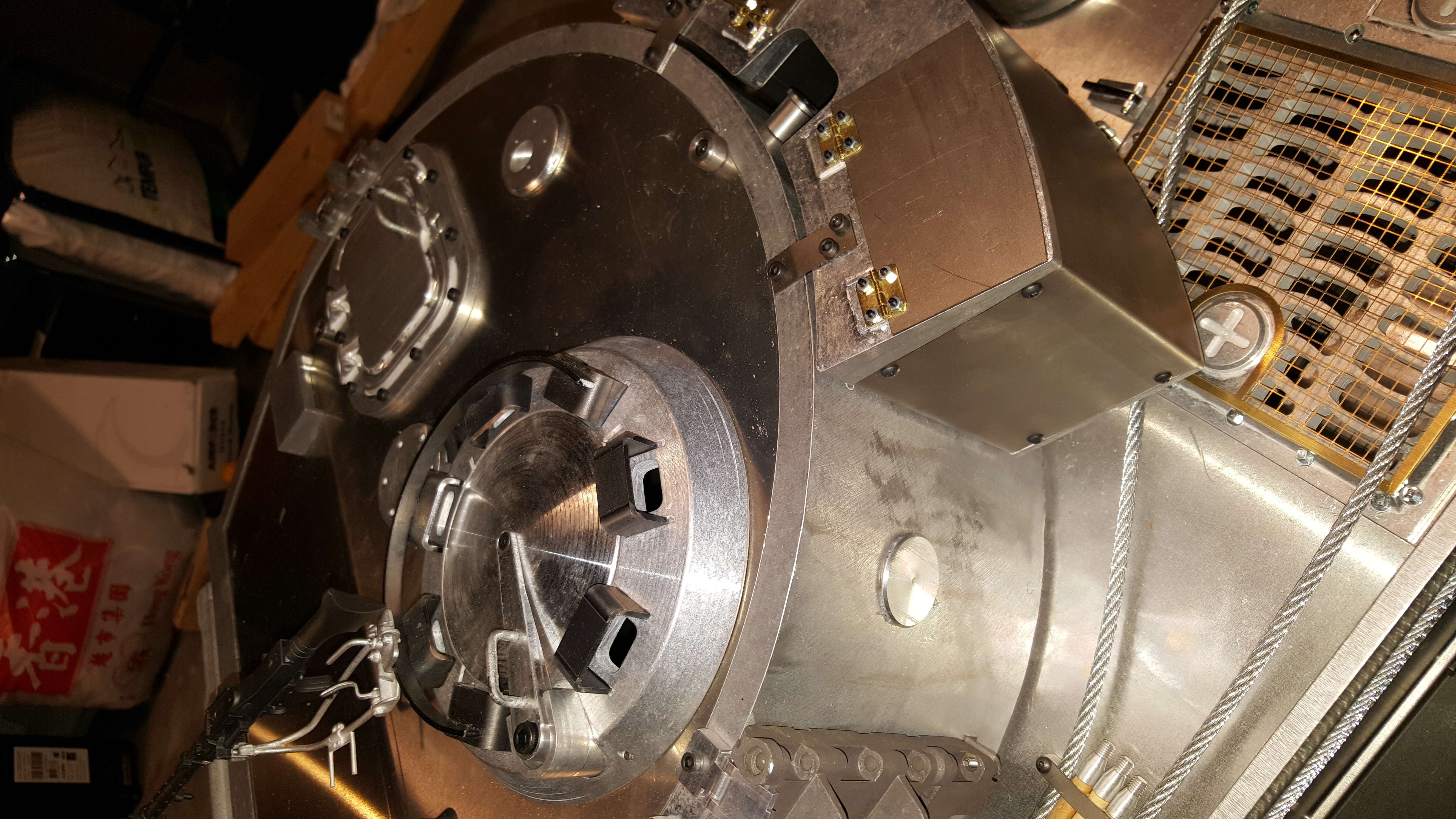

Hi John,
I am from USA. I just basically put all parts together. There several things which have be careful. This is just my first tiger 1. I cannot say I am good, but just would like to share my experiences.
For the suspension, I didn't assemble the suspension arm, axle, suspension shaft, torsion bar and fixed end in one piece to fit into the suspension bar. It was because I had to make sure the suspension's fixed end have good contact with the shakeproof washer. Because of the motion of the suspension is clockwise, it just can make it loose. I didn't have to make extra screws to tighten the fixed end as someone did. They stay well. I Just put the torsion bar into the fixed end far enough for 2 grubs to fasten it. I didn't attack the other end until the final step to have the 35 degrees angle.
For the turret, it seems quite hard to turn. Instead of adding transfer ball bearing, I just put magic sliders things to make it turn smoother.
The front guards, I bought 2mm screws to attach them rather then pins.
For those turrets' hatches, i just bent some nails to make handles.
I added a sliding bolt lock($3) inside the escape hatch to lock it.
My build is not great, but I love it
