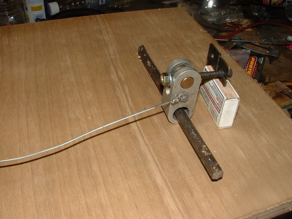

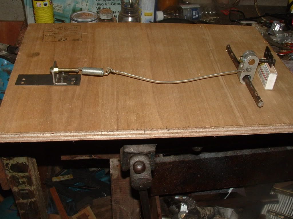

Below are some pictures of the general arrangement of the spring tensioners I have made.
I hope it is fairly self explanatory. First I made the retainer to hold the cap head adjusting bolt in the rear hull plate. The thread in the brass insert in the Armortek adjusting arm is drilled as a clearance hole for the bolt. The steel cable is a push bile brake cable and the spring is from a cheap folding garden chair. Since taking these pictures I have moved the bowden cable anchor screw up into the brass insert to get more leverage as I was surprised at the pull on the tracks when turning on grass as it was orginally pulling the tensioner during turns.

Allen How well does it work? The spring does not look like it would be strong enough. I was thinking something like what you have, without the cable.
I have a hanging scale, like a fish scale that I was going to try to get a measurment with. Im thinking maybe in the 20 pound range,(for the spring) the track is a little heavy. I dont know how well I will be able to test it since I have no motors yet. I suppose I could tow it with my Panzer 4.

The spring on my system has almost a 10:1 mechanical advantage caused by the geometry on the Tiger idler axle adjustment, I would think that the tracks can pull in the region of 150-200lbs on the actual idler during a turn on a grippy surface. Also the spring holds the idler tension against the nut on the end of the bolt so it is against a hard stop, the idler does not float on the spring tension.
I have tried making the idler on one of my 1/16th scale tanks float on two springs and it has not been very successful as the force on the idler varies with manoeuvering and hence the track tension varies continually causing poor performance, especially in turns.
The tension in the spring on my Tiger is set such that the idler does not normally move, it only moves in extreme circumstances when something jams it the track, and it only really matters when something jams between the rear idler and the track. The dual track horns on the Tigers tracks trap small stones which doesn't matter untill the stones get to the idler which grabs them and jams them between the idler and track, this causes the track to over tension and snap. The motors are so powerful that they don't stop, the first you know of it is the track breaking. This has happened to me several times and I have broken about 10 links. With the spring fitted the idler now moves forward enough to prevent the track breaking and the stone then normally falls out.
I agree with Mark that this problem doesn't probably happen very frequently, but where I live in north Kent the ground is full of small stones ideally sized to get in the tracks. I also agree with Marks views on floating the tracks on spring tension, my system is more of a safety device than a tension device.
