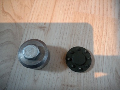

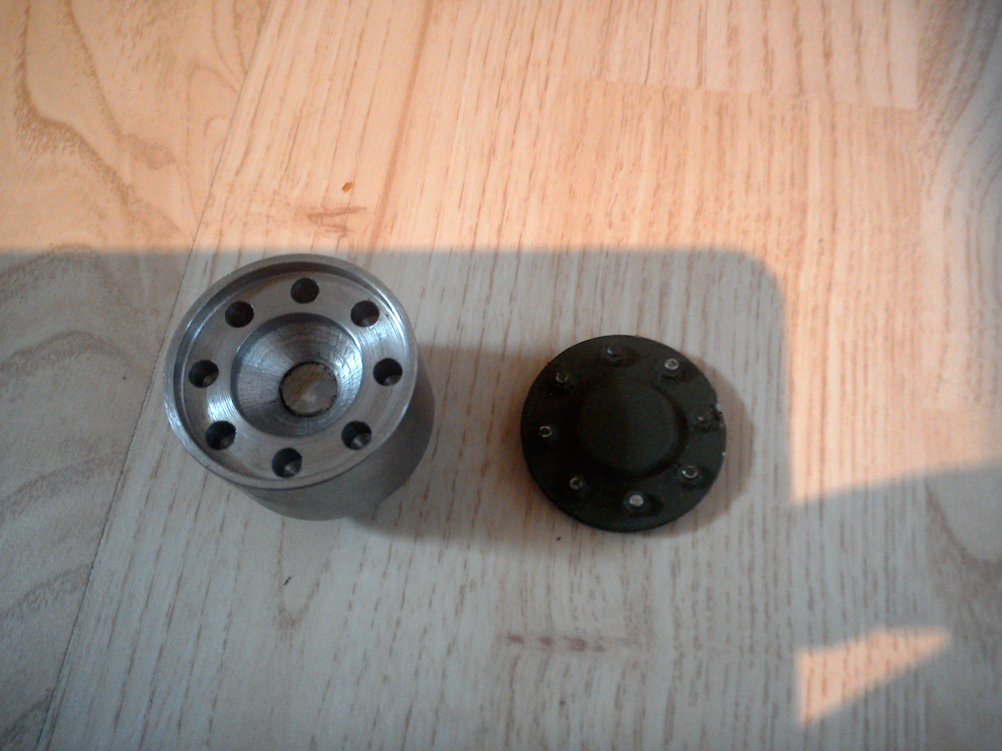

thanks for the advice.some of the roadwheels are loose which I suspect to be the bearings.
attached is a picture of one roadwheel where you can see that the bearing is rusty.
also a picture of my home made wheel cap unscrewer 8)
cheers
Steen

Post by dennypatterson »
:lol: you may find that you need a washer between bearing and cap to stop the wheel moving side to side,it looks as though you have been driving through the sea!!!!!also i forgot to mention do,nt use grub screws on the torsion bars, its better to use cap heads, you can get more purchase on them, i think that a tank like yours , looks better its used, and not put in a glass case, or as i call them wilton, axminster carpet tanks , only used in the lounge,,,,, i had a cap removal tool made very good.. denny,
p.s armourtek, havent got any uprated suspensions, at the moment, but i belive going to make some soon, so get your name down..
