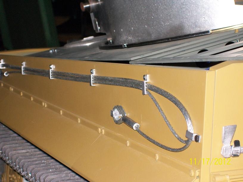

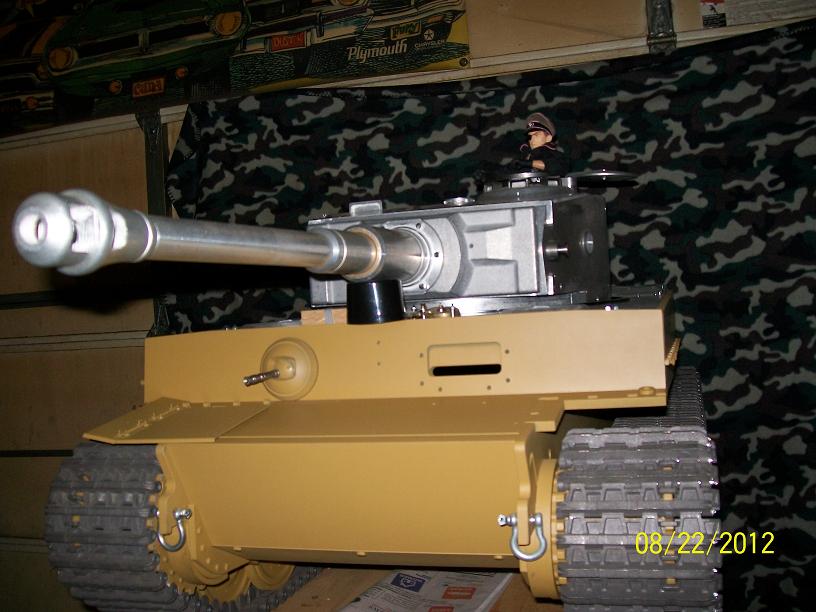

Hi all . I think I can supply pictures now . I have never been real picture taking crazy , so I did not take any at the beginning . Sorry for that . I know you all already known the excitment of the boxes arriving !
As I said mine is an out of the box build for now . I had all of the usual small fitment issues as most others , but for me that is all part of the fun . if this works , I will post more . Steve .

Looks like your pictures are working - though they are quite large when opened up
Good to see another recent Tiger joining the ranks here

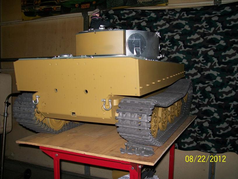

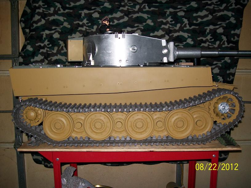

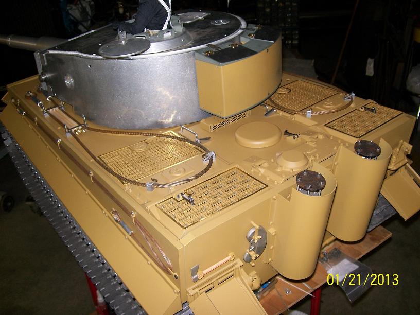

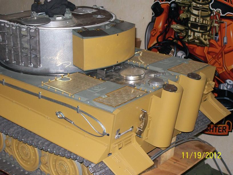

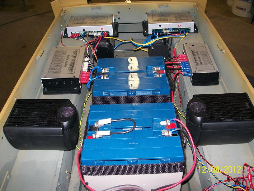

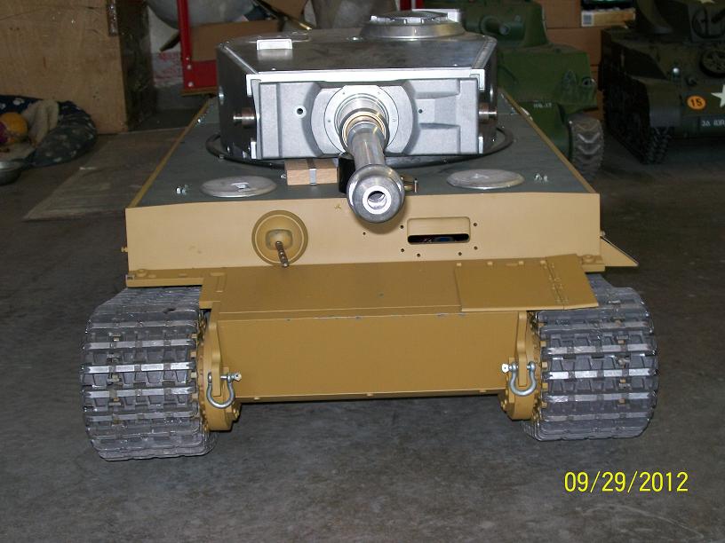

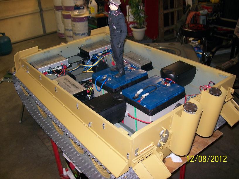

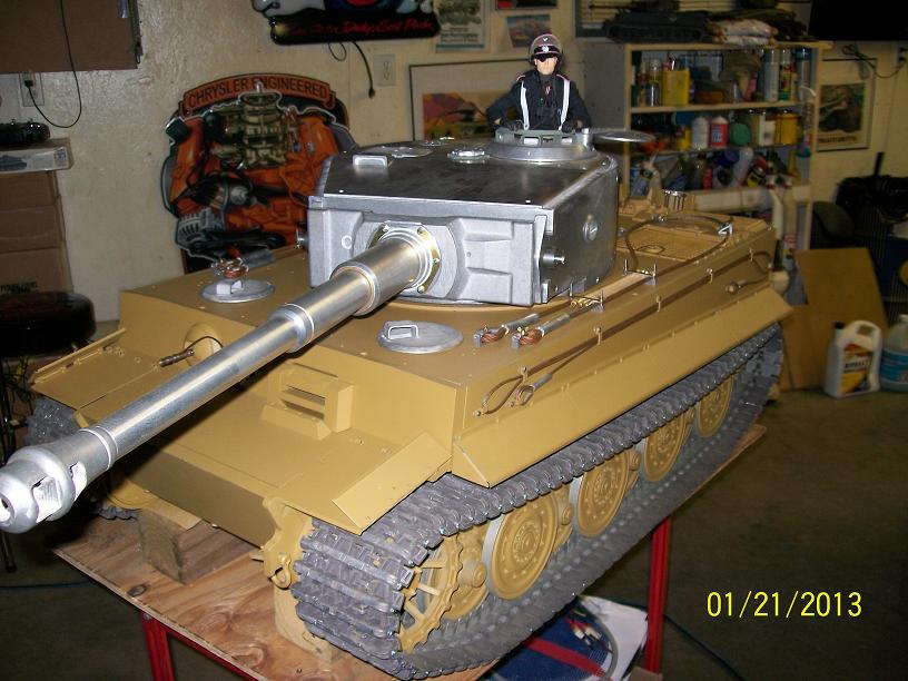

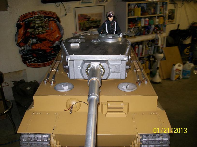

Hi all . Posting a few more pics , to catch up to where I am at on the build . I think I have them sized properly now . The color is Testors afrika yellow as I was unable to get dark yellow from a source I trusted . I believe since it is model paint and probably not very uv resistant , it will likely fade in the sunlight . I also plan a blocky red/brown dark green camo pattern . Even though I'm not detailing to the same degree as other builds , there is much more to do . FUN !

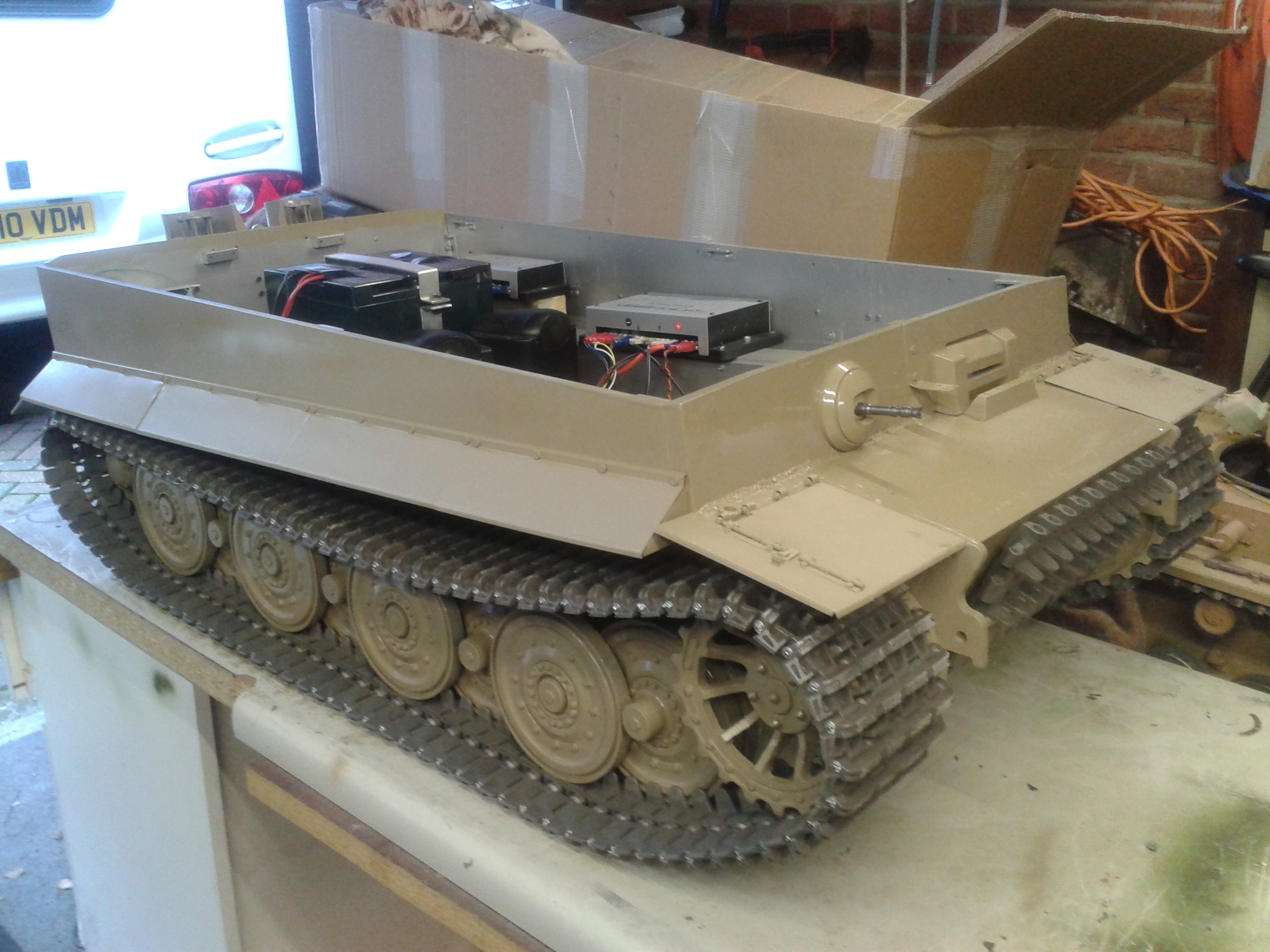

Hi Steve,
I found I had to take out 5 links from the recommended 98 links in the build manual, backed the adj right off so have plenty of adj to take up should the need arise. I have run the Tiger and tracks seemed about right. I think the correct adj is the track should rest on the top of the 3rd wheel back from the front.

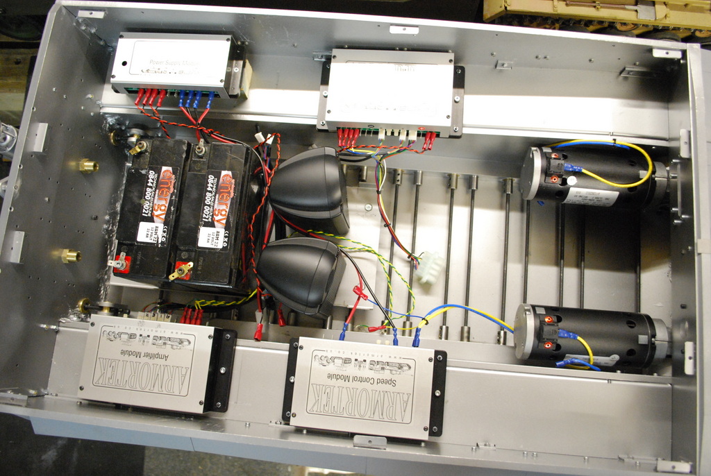

As a matter of interest how are you going to turn the power on/off when the deck is in place as I notice the power supply module is under the deck ?
Dennis.

Your Tiger looks great,I like the colour and your neat arrangement in the Hull

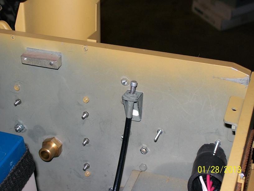

Hi Dennis and Phil . On the track links I started with 97 had to remove 4 that put it where it needed to be after running it with batteries and motion pack installed . on the on switch , I plan to make a remote push button using a bicycle brake cable . will post pic when completed . Also plan remote volume control using flexible tubing attached to the volume knob . On paint fade . probably still fade some with clear coat as automotive paint fades to some degree , and they have been base coat/clear coat for some time . Here are 5 more pics I meant to post last time as I did not know of the 10 attachment limit .

That's why I put my Amp module and Power supply at the back so switch and vol control are accessible through rear hatches. I have in the past on my Panzer extended the on/off swtich but you have to be handy with a soldering iron.

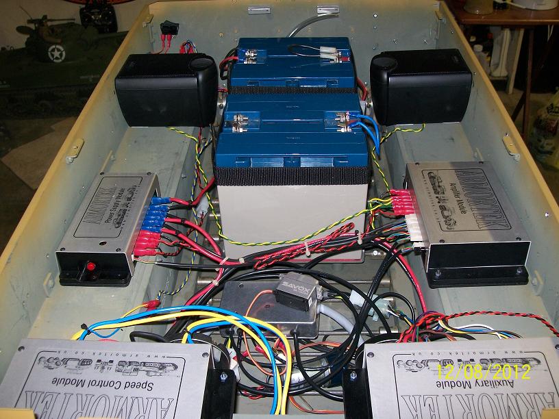

Hi Christoffer . I wanted to get as much battery fitted as I could , for run time . I do not know how much I'll get yet as I have not did a full charge and complete run down .I know that heating element uses a lot of amps . As far as detailing goes , my tank will always be a work in progress .And fun to the end . thanks for the comments . Steve .

Hi Dennis . I am skilled with a soldering iron and did consider modifying the module , but really did not want to alter it for fear of messing it up and voiding any warranty that may apply . And I really wanted the speakers under the grills . I tried several lay outs , and this is what I decided on for now . I do appreciate your suggestions and comments . Thanks , Steve .

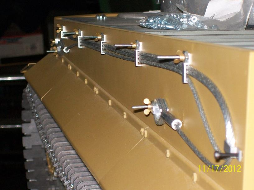

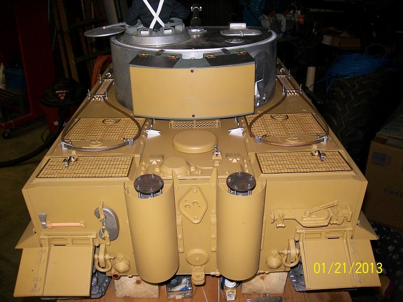

Hi all . These are the last 5 pics I have for now . These bring photos up to where I'm at on the build . The cables have been aged by soaking in vinegar as I read somewhere here on the forum . Thanks everyone , Steve .

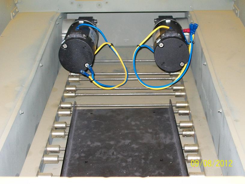

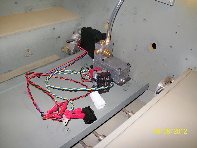

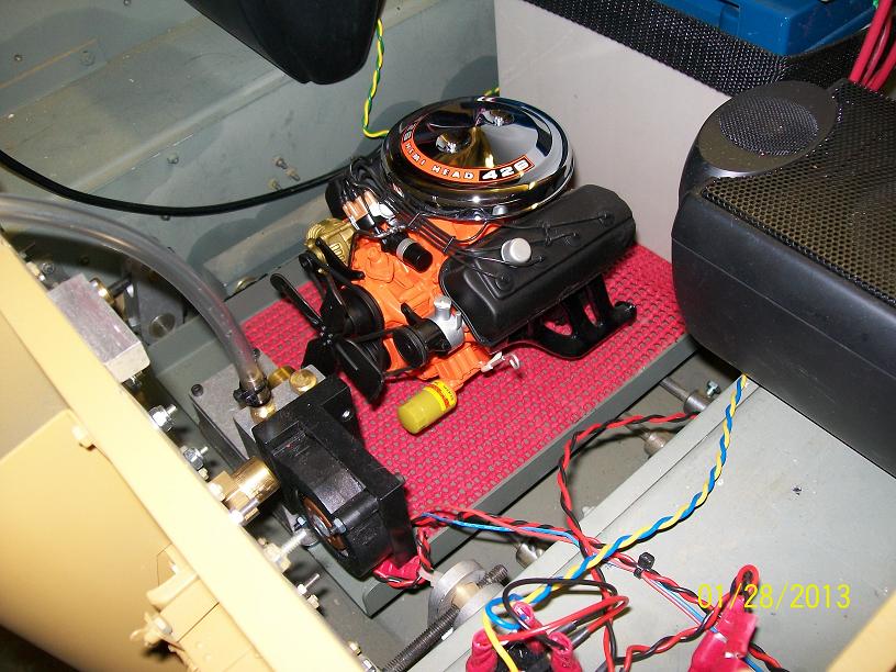

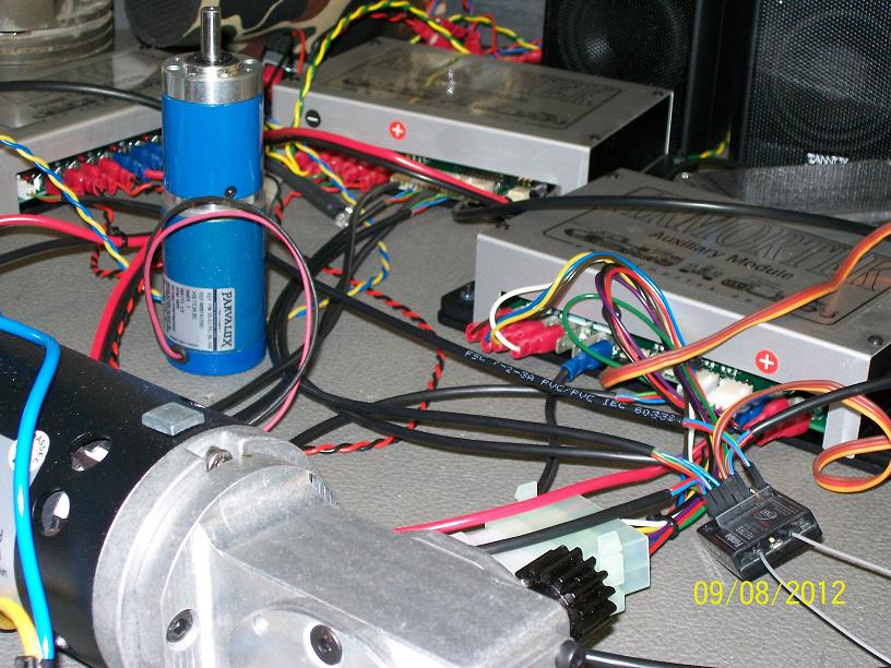

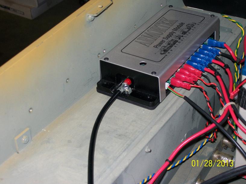

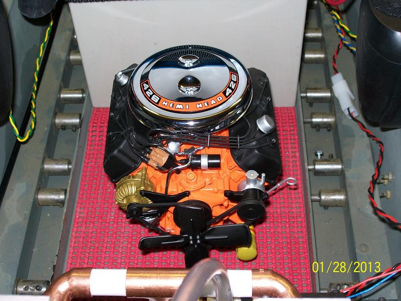

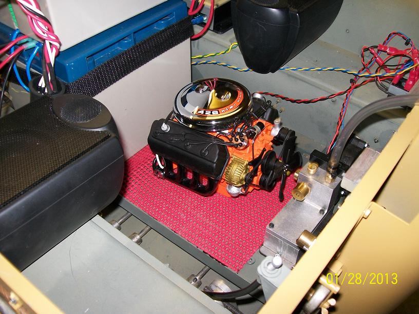

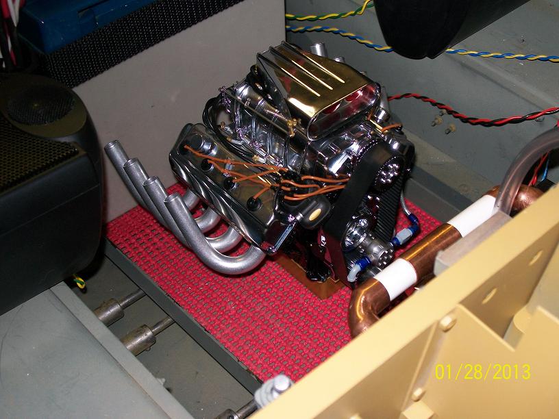

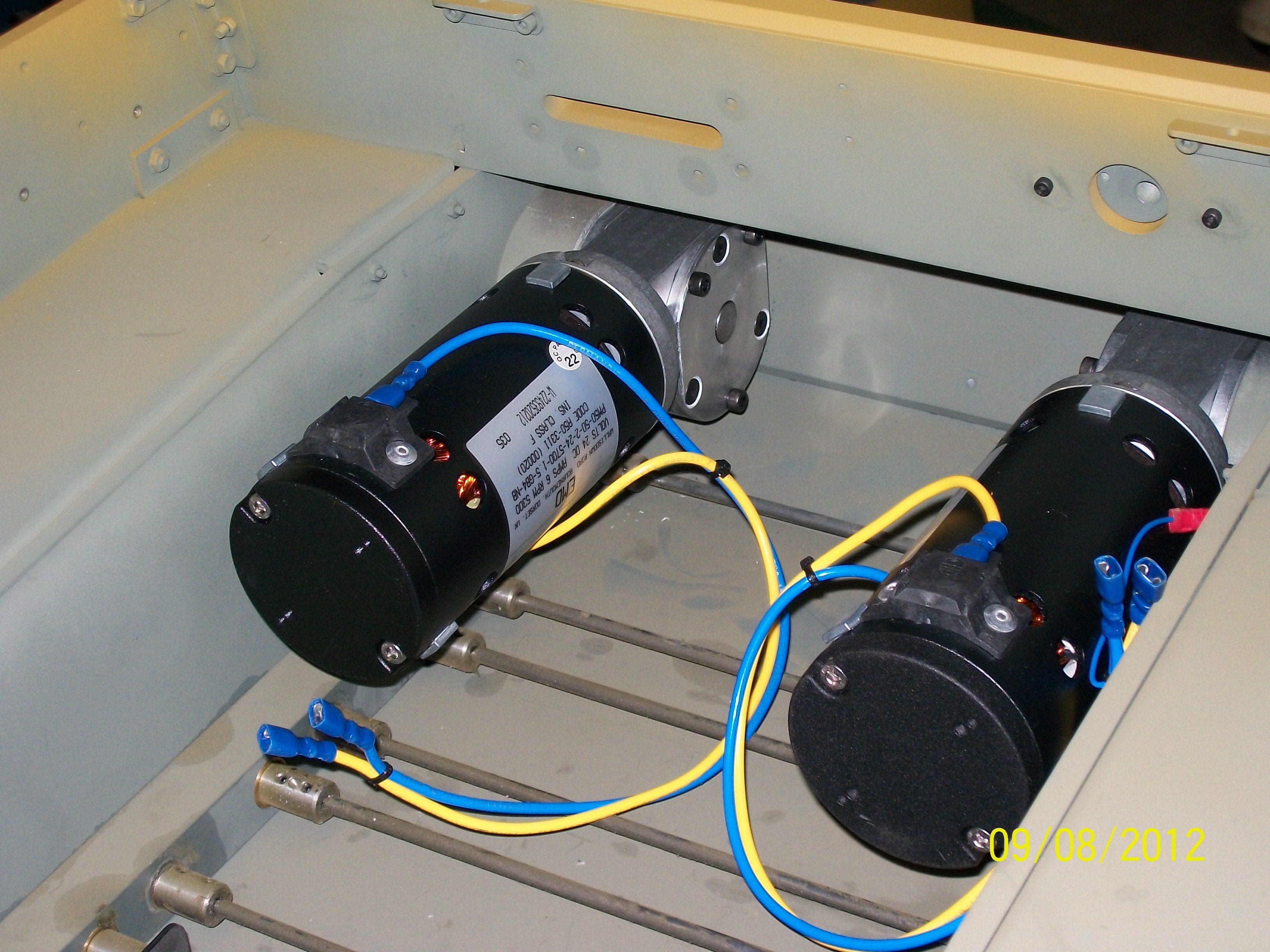

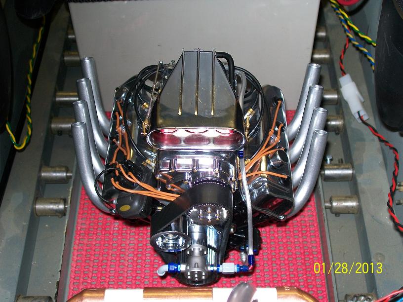

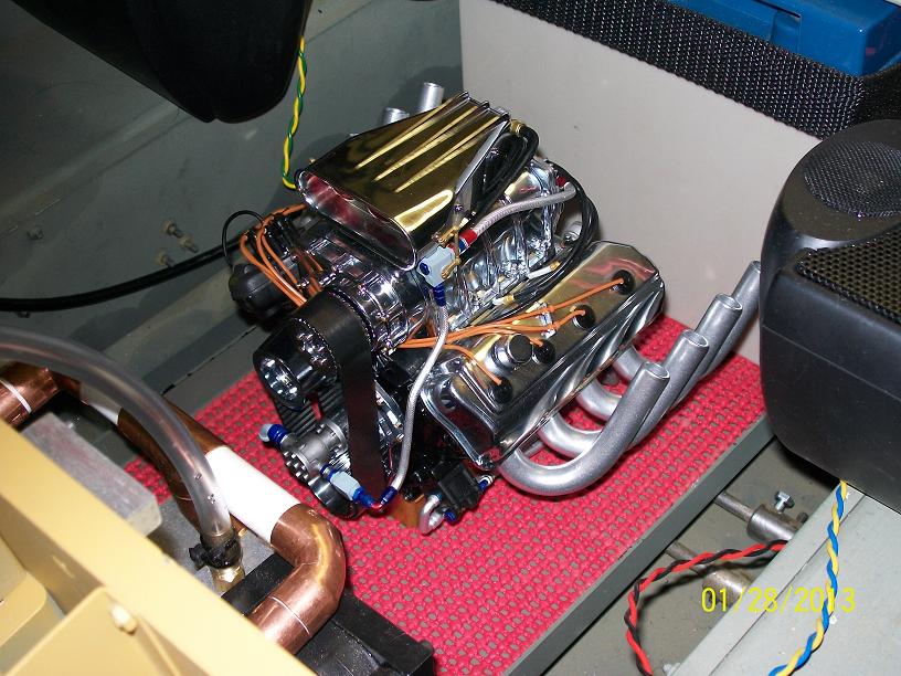

Hi all . Here are a few more pics . Two show my remote start button . Nothing fancy , just made of bits and pieces from around the garage .But it works as intended . The others show alternate motorvation I was contemplating .
That's all for now . Cheers/Steve .
