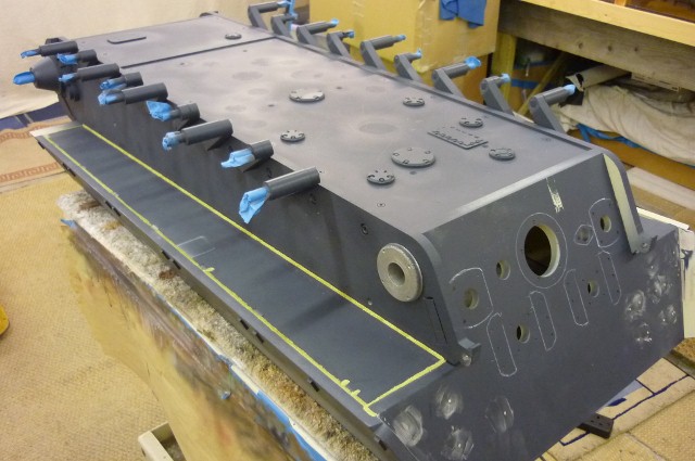

- Posts: 2061
- Been liked: 1767 times
Re: King Tiger Porsche Turret Build

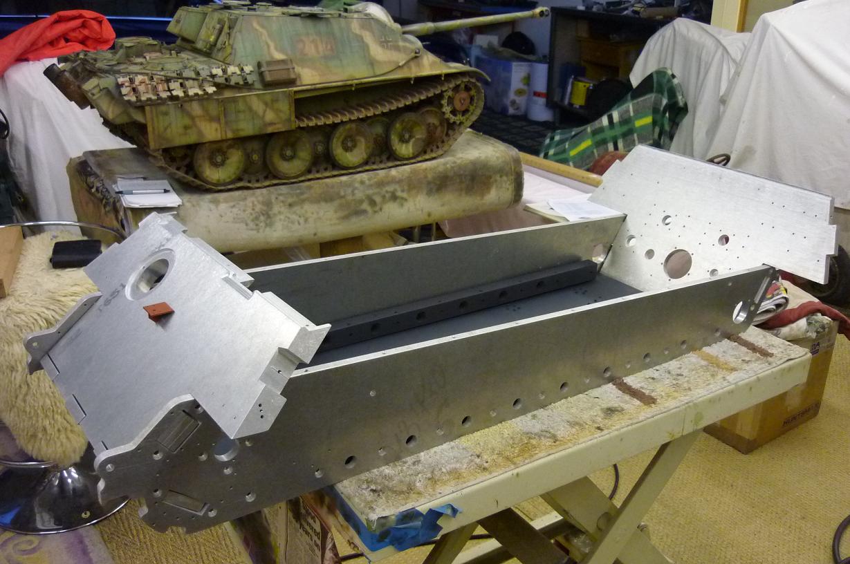

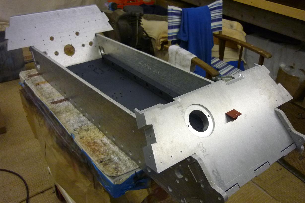

i know we have seen this stage of build before, but the fit of this kit is superb, the rear hull plate is already angled at the top edge, so no adjustment there, having built one before some filing was required, this one just falls together, i am looking forward to the zimmerit and the challenge of scale detail, anything of interest i will post, but we have seen most of the basic stuff on earlier builds, regards simon.

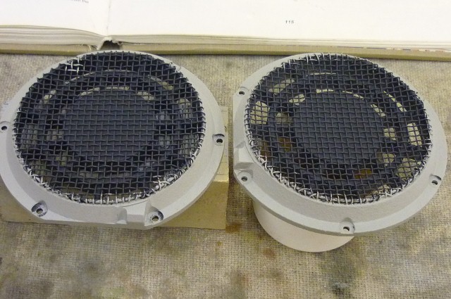

- Posts: 2061

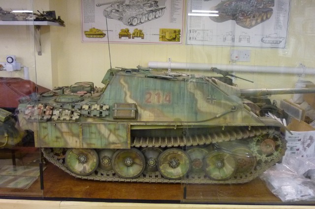

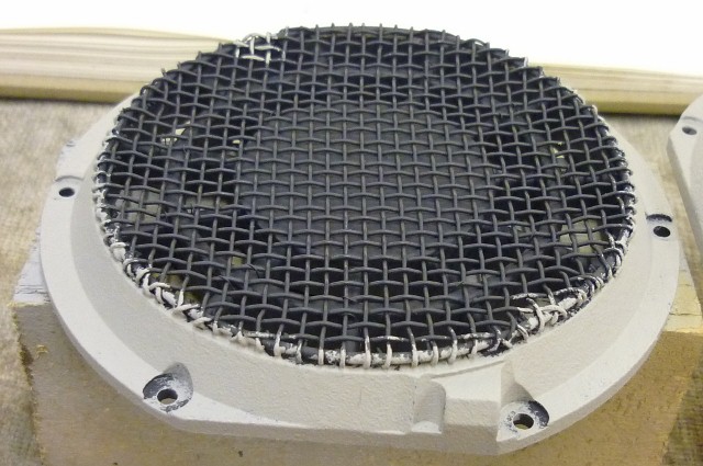

slowly working away on the build. also fitted the aerial on the jagdpanther, made some alterations on the air vents to square the corners off and round the profile,fitted mike stannards grills, welds and cast numbers to add, regards simon.

- Posts: 2061
thanks steve, i did make my own on the jagdpanther both fan and heater grills,the mesh i used was slightly finer and seemed to look o.k., i had these two already so used them, regards simon.

ps: the jagdpanther looks very beautiful, nice paintwork Simon.

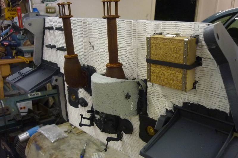

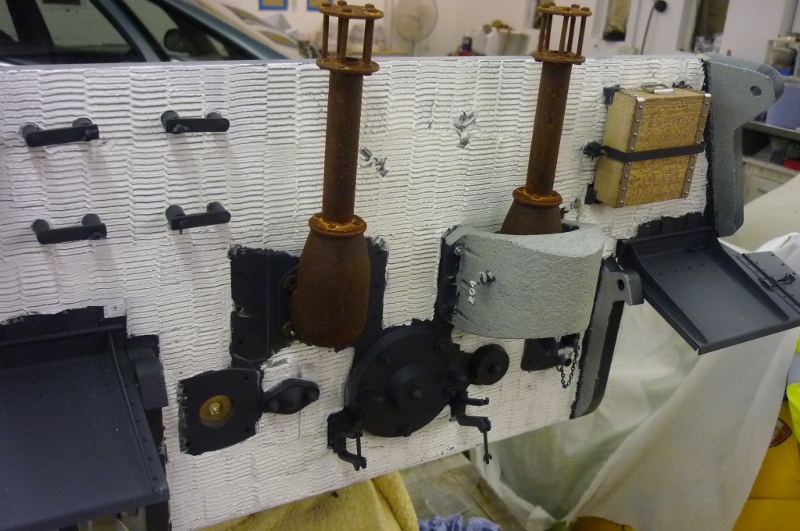

- Posts: 2061

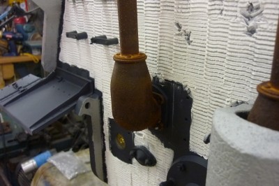

not much to report on my build at the moment, just a few photos of progress, early stages of zimmerit application, i reworked the armortek exhaust kit parts to this stage using files and mr dremmel, the zim paste is wall tile adhesive with added pva glue, the mike stannard application tools are a must, makes the job much easier, all the best simon manning.

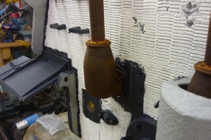

Hello Simon,
I must say it looks very good and you must´ve worked hard at the exhaust pipe base as this is different to Armortek´s - could you show us how you did it?
I hope you´ll bring this Tiger II finished to Open day for all of us to enjoy.
/Per
/Per

- Posts: 2061
nice to hear from you both, per its hard to describe without pictures but basically i cut a groove to act as the flange that bolts to the tank and worked backwards away from it, shaping with hand files and the dremmel, there is enough metal on the kit part to do this, i made the extra oval flanges from sheet alloy, what gave me the idea was freddies post and pictures of his exhaust, i printed them off and had a go, not as good as yours or accurate but a representation, if confused, i will see you at the open day, the tiger will not be with me, i am on a go slow due to house repairs etc, many thanks simon.
