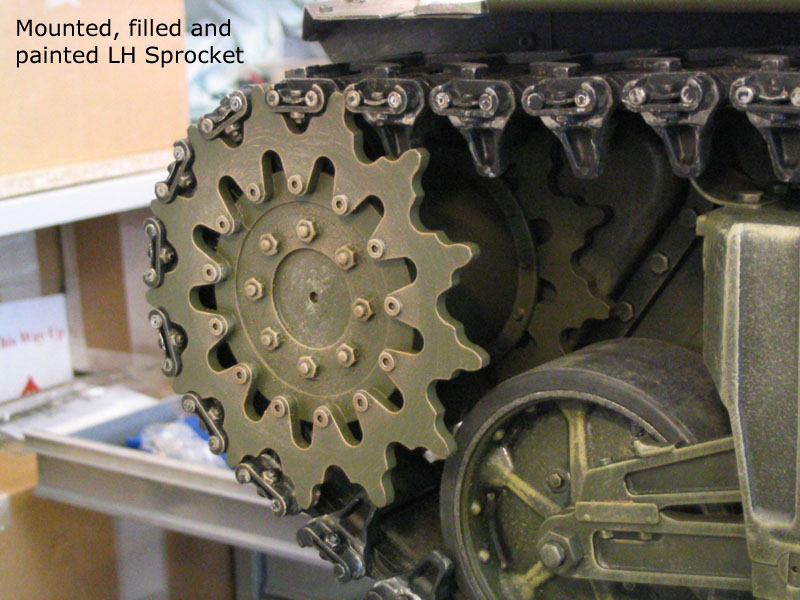

Just a small addendum to above post this is it the sprocket fitted filled and painted:
I plan on doing a detailed retrospective build account when I finish her!
Cgheers, Fabrice

Too true - I have pictures of it from the 2009 Armortek Open Day, to which I still refer
Yours looks a good compromise for these fixings. The only way I can see to truly replicate them would be grub screws but the only way that would work would be to thread the sprocket gear and centre at the same time, so the thread was continuous. I'm still amazed at how small the full scale parts are, given the forces imposed upon them by the tightness of the Sherman tracks when turning and cornering.

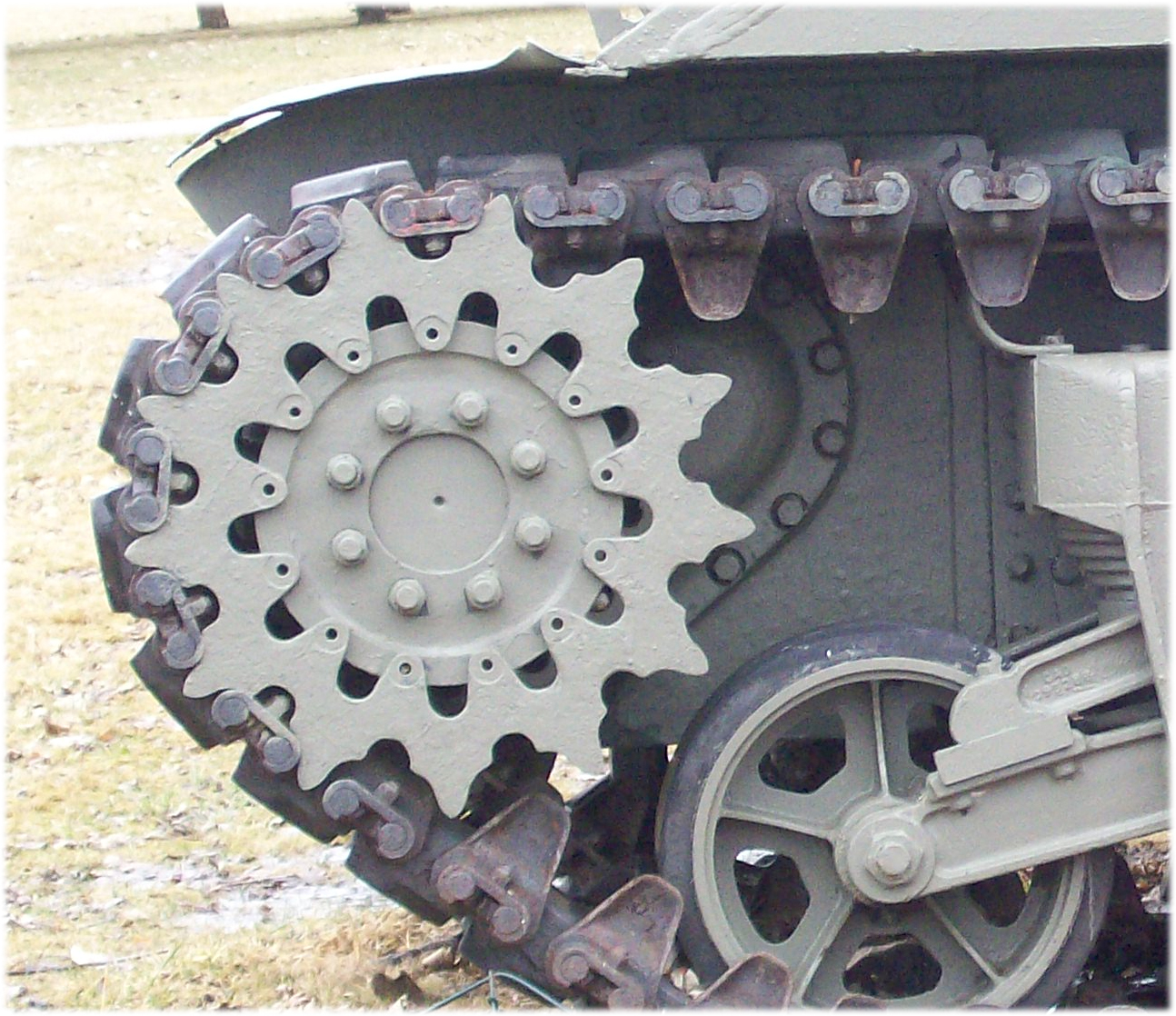

This is the type of sprocket I was modelling.. there does seem to be small variations even between Shermans of the same mark though. Hope you enjoy the show if you make it.
cheers, Fabrice

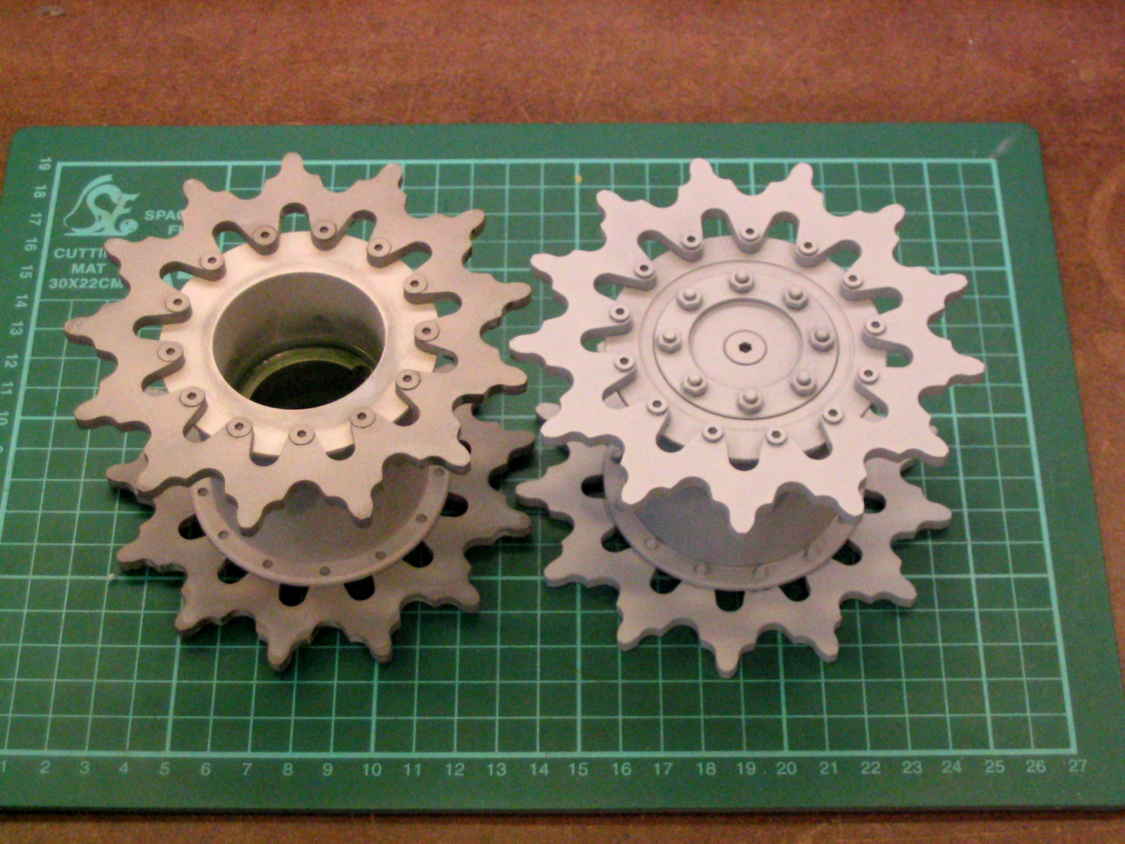

hi all
is it me or does it look like theirs a plate / locking tab behind each set of two bolts on the sprocket centre hub ?
colin
colin

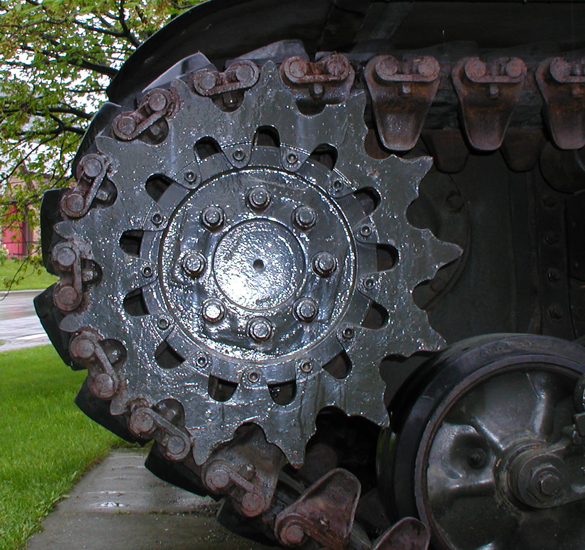

Re: Bizarre event with a Sherman
Hi Colin,
Agreed. I had to take a second look before uploading that shot. Rich did the photoshoot in the rain a few years ago. The photos all show exaggerated texture as a result of glint. The flash makes it even more pronounced. In another shot of the same sprocket, slightly out of focus, you can't see anything definate. I came to the conclusion that the rectangular marks are not something rusted into the surface, but some artifact of the casting process.

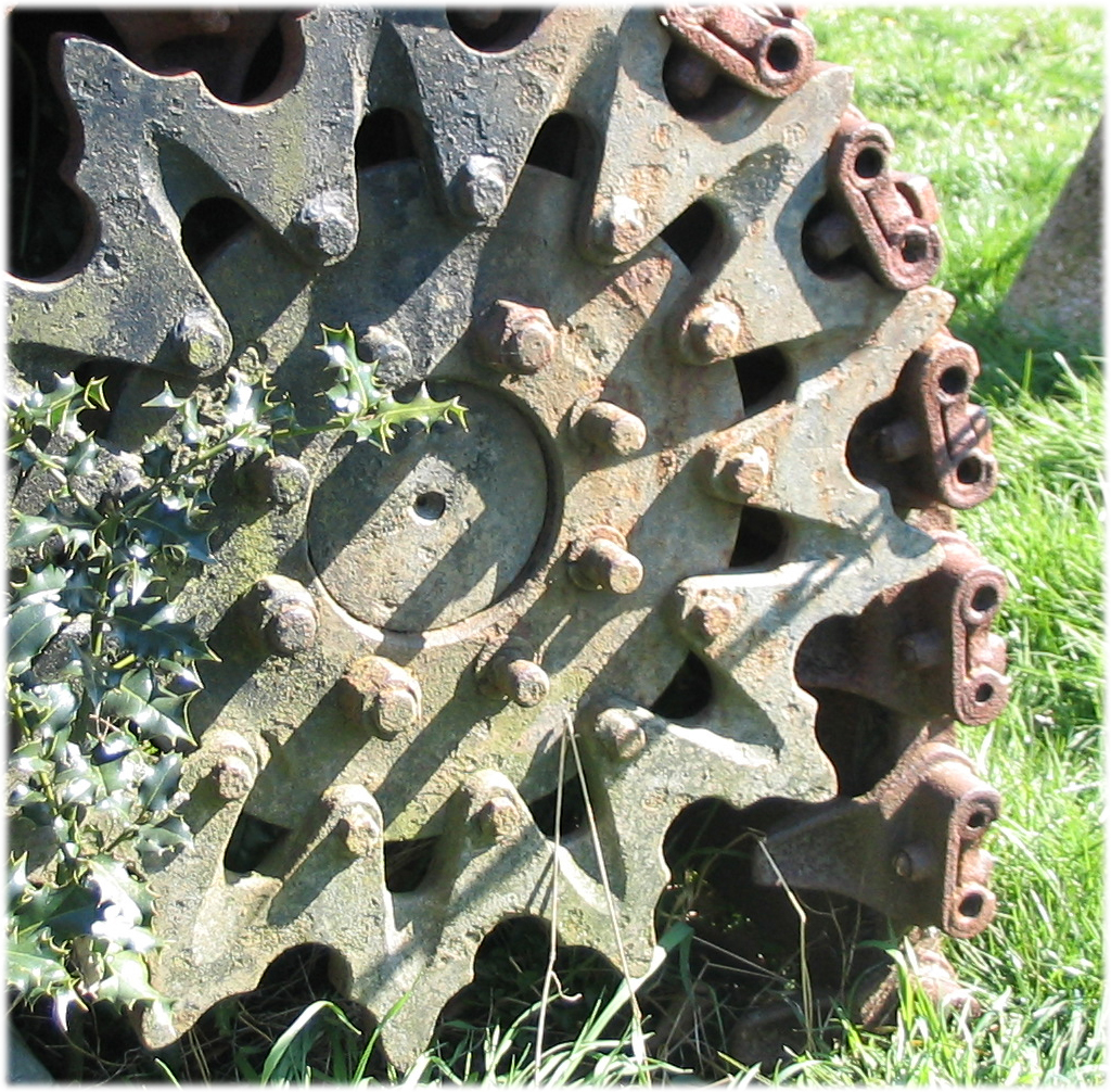

This pic, taken at the Cobbaton collection, in slanting direct sunlight, shows that the nuts on the centre ring of studs were locked with spring washers. At least at the end of this vehicle's service life! Just to confuse things further I found a single photo of a Sherman type sprocket with the outer small bolts linked in pairs Panther style! Weird.
cheers Fabrice

Came across this on the G104 Sherman Group site. Looks like you don't need to worry about sprocket nuts at all, just model seventy years of rust and paint!
They are in for a nasty surprise if they ever try and move the old girl...
cheers Fabrice

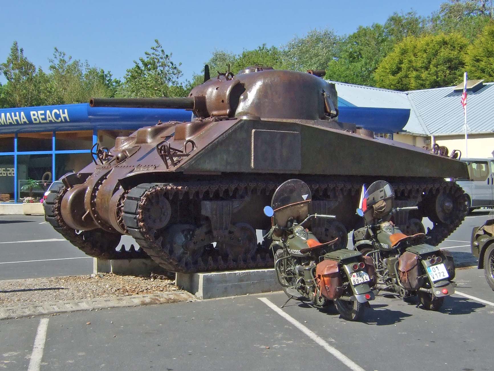

If they do move it, it'll look like this M4A4 at the Omaha Beach Museum:
Sorry it's a bit "false", I had to Photoshop it to get rid of the shadows.
All joking aside, that one you posted looks exactly like I would expect if you could completely countersink the M3 bolts round the edge. Not sure there would be enough meat in the sprocket ring though
