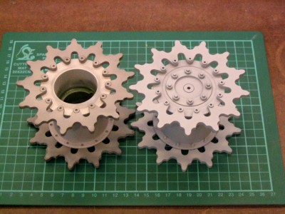

FWIW When I detailed my M32 sprockets some years ago (The oxen are slow but the Earth is patient!) I put a small counter sink into each 3mm hole in the laser cut steel sprocket ring, but slightly deeper on the inboard ring. I considered that this would serve to centre and lock each bolt in position, preventing "creep", much as the chamfered edge of the wheel bolts on a car wheel does. I used good quality countersunk hex socket M3 bolts and fitted each with studlock adhesive. The inboard ring therfore cleared the final drive housing without further modification. The outboard ring with the shallower countersink allowed me to turn down the edge of the bolts by 0.5mm to give the appearence of scale cap screws as used on the M4A3. I added some other details based on Rich Stinchcomb's super photo ref CD (never bettered) and this is the result: I have run this for some 3-4 hours with no problem but I wish to emphasise this mod was not approved by Armortek and anyone copying this does so at their own risk! If you plan on playing hard with with your model, stick with the designed tolerances and components.
Cheers, Fabrice

Just a small addendum to above post this is it the sprocket fitted filled and painted:
I plan on doing a detailed retrospective build account when I finish her!
Cgheers, Fabrice

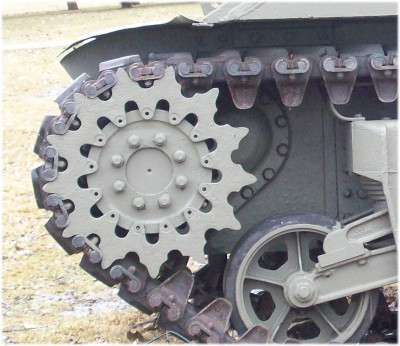

Re: Bizarre event with a Sherman
Hi Colin,
Agreed. I had to take a second look before uploading that shot. Rich did the photoshoot in the rain a few years ago. The photos all show exaggerated texture as a result of glint. The flash makes it even more pronounced. In another shot of the same sprocket, slightly out of focus, you can't see anything definate. I came to the conclusion that the rectangular marks are not something rusted into the surface, but some artifact of the casting process.
This pic, taken at the Cobbaton collection, in slanting direct sunlight, shows that the nuts on the centre ring of studs were locked with spring washers. At least at the end of this vehicle's service life! Just to confuse things further I found a single photo of a Sherman type sprocket with the outer small bolts linked in pairs Panther style! Weird.
cheers Fabrice

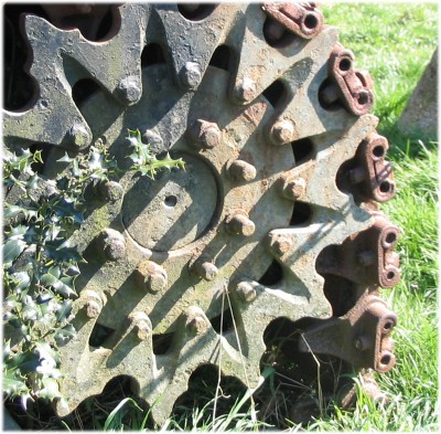

Came across this on the G104 Sherman Group site. Looks like you don't need to worry about sprocket nuts at all, just model seventy years of rust and paint!
They are in for a nasty surprise if they ever try and move the old girl...

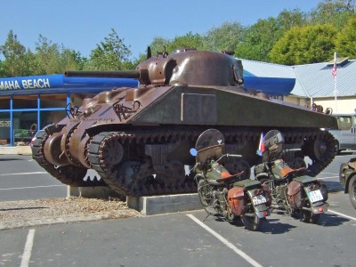

If they do move it, it'll look like this M4A4 at the Omaha Beach Museum:
Sorry it's a bit "false", I had to Photoshop it to get rid of the shadows.
All joking aside, that one you posted looks exactly like I would expect if you could completely countersink the M3 bolts round the edge. Not sure there would be enough meat in the sprocket ring though
