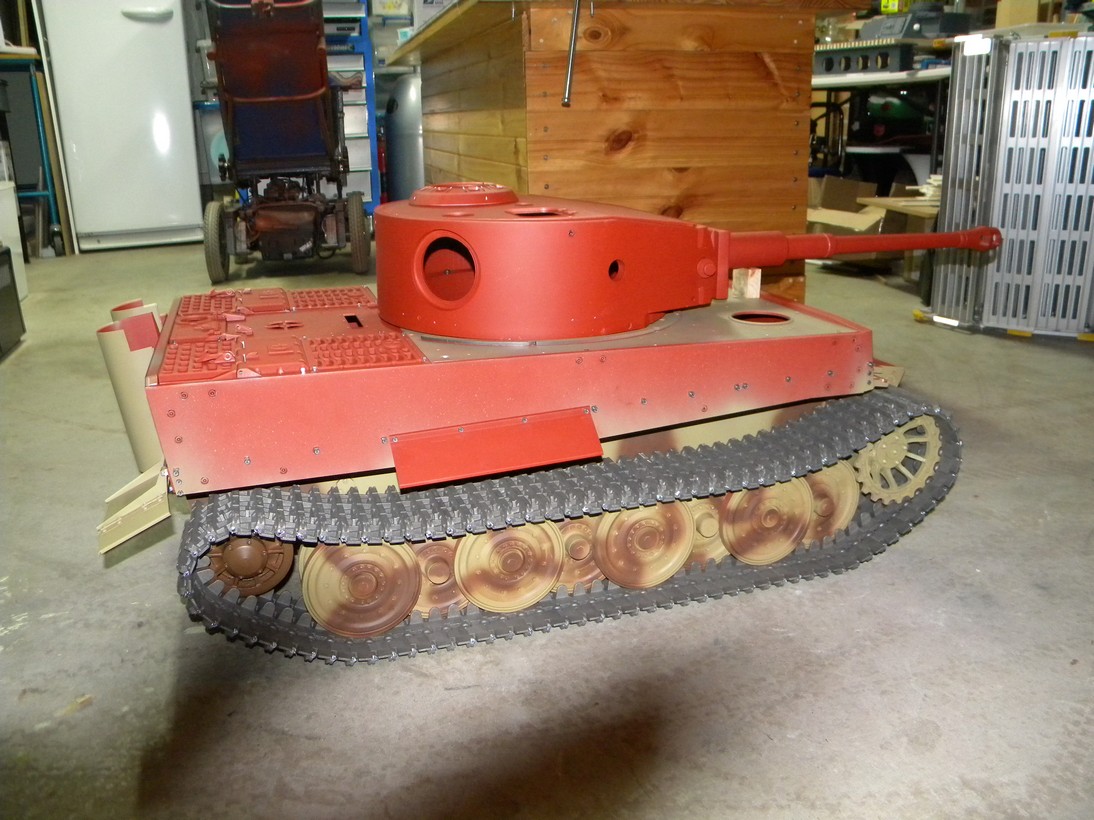

G'day all. I've put together the track as per instructions of 97 and fitted them. I have tightened the tensioner but they still look very loose. Sorry no pictures yet. Does 97 seem right. How slack should track be given it will stretch.

The 97 figure is just a best guess starting point. If they look slack, take out one or two links. As a guide, the top run of track should have enough tension to lift clear of the second or third road wheel.

I started on my tiger 1 with 94 track links.

Just got me worried as I had read 94 also but thought they might be a little tight. Think I had copied someone else on the forum. Checked mine and yes 94. Just put extra on and they are way too loose. Doubt it would even drive. Mine slackened off with a little use and full weight of batteries and motors.
So try 94 with idler fully in but I did find joining them up difficult at first.

G'day Guys. Went with 94 link. Cheers Ray

Actually on recount I have 93. But with extra link looks like yours. Yves has the mid tiger so could be an extra link as i think the idler is bigger ont the mid. It ran smoothly on 93.
Any body else have a count on the late tiger? I think 93 looks right.

I have also 93 links on my late Tiger

There you go Ray. 93 links confirmed. I think the late model is different to the early or mid. Mine were tight at first the loosened up nicely. Did you pin the control arms on the suspension. Worth doing. take a link out and adjust until tracks are just touching the second road wheel.

I'm leaving it at 94 link and will adjust the idler.
