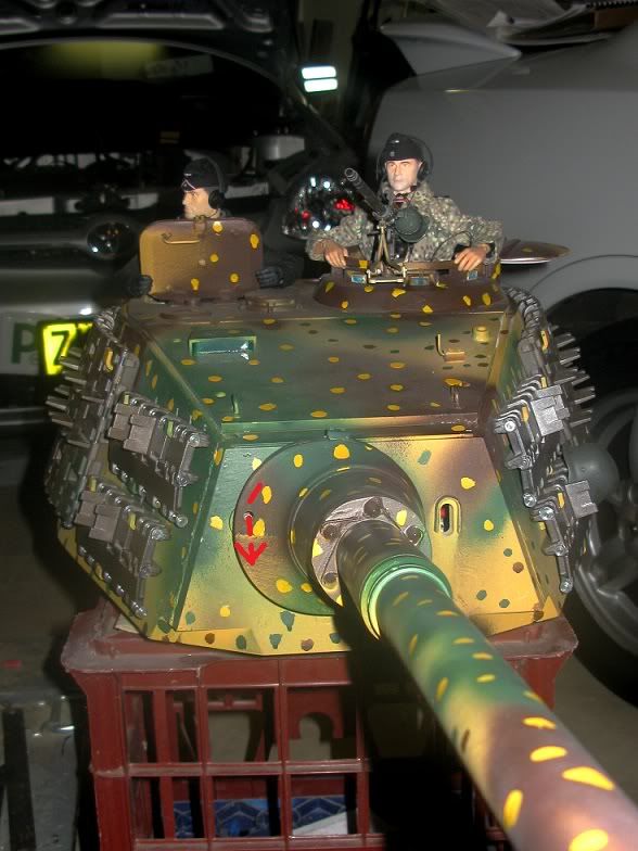

Hi guys,
Is it only mine or more of our KTs have the little issue that the saukopf mantlet will dropped-down a little bit (as the red arrow indicated) during her moving? If yes, how did you fix it?

Hello Lerh
Drill and tap a hole underneath the mantlet and the use a grub screw to fix to the barrel. Simples :wink:

Hi Lerh and Lee.
Ditto ...I did exactly the same :)

Hello Conrad . I did the same thing to my KT .. Just buy a 2.5mm drill bit plus a M3 tape .. Scribe a centre line on the underside of the mantlet drill the 2.5 mm hole . I then drill a 3.5mm clearance hole only about half way through the hole , then tape the last half with the M3 tape then add your M3 crub screw . Dale

Hi Conrad .., I don't have my KT with me to take a photo maybe the other guys can post a photo . The grub screw stops the mantlet from sliding off centre ... Dale

The grub screw works in the same manner as the the ones you fitted into your torson bar sytem, all it has to do in this case is "nip" the rear of the gun tube as Dale says to stop it from slipping. So you are not drilling a hole in the turret but in the large casting that the gun tube slides into see Lerh's photo.
