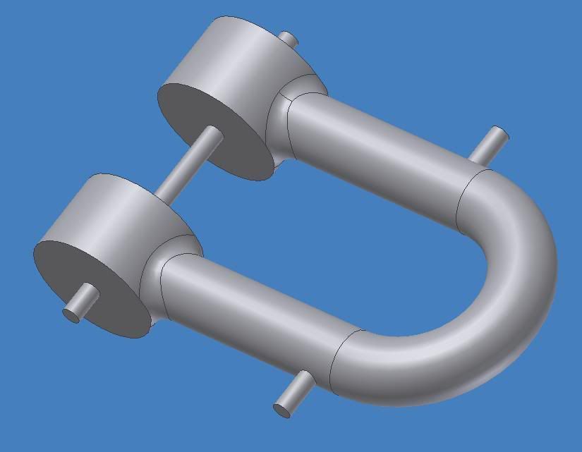

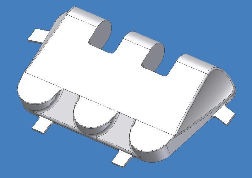

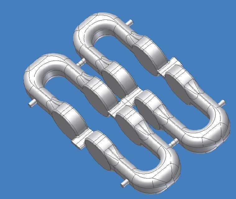

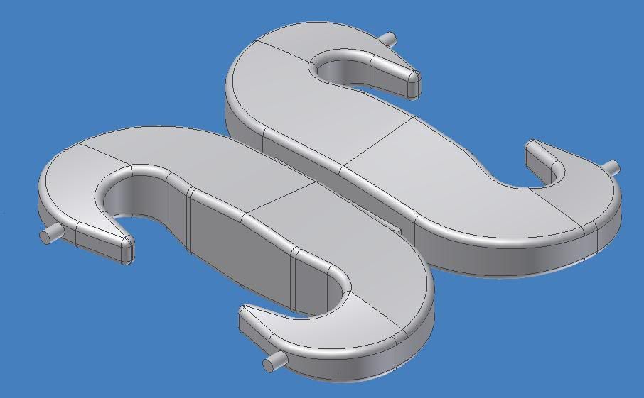

With the U bolt, did you make the wax piece as a trial or as a casting master ?
Also, do you have to add the fixing stubs for the pieces or does the CNC system know it has to leave some material ?
Posts: 2349
Adrian,
Great questions. The wax was a prototype project to teach myself the ins and outs when I first got started. It could be used as an investment casting pattern though, in fact my jewelers do exactly that. They machine the pattern in wax and then investment cast the part in precious metal. If you want another of the same pattern - you just machine another one! Pretty cool idea I thought. But when first starting out in CNC and whenever you are unsure a program will run correctly - its a good idea to machine a "soft" material like wax or foam before going to metal. I feel comfortable going straight to metal machining now.
The holding tabs I add to the CAD model. Some CAM (Computer aided machining) programs will help you put the tabs in, but I found they don't always put them where I want them. So I just add them to the CAD model of the part. See photos below of CAD models with holding tabs.
-Bob
