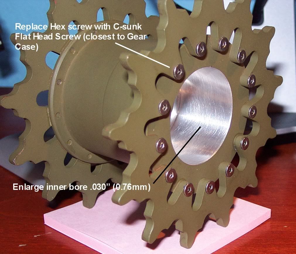

Do you have to worry about heat distortion when using the braze rod? It looks like nice material to work with. The rust on the track shoes looks great! No so much on the end connectors! Thats going to be a job to get those parts separated without damage. Maybe soak the whole track in kerosine?
I replaced the hex nuts on the inner sprockets with flat head screws to prevent such a problem with my gear cases. My shermy is a production model so maybe its not an issue, but this is additional insurance. I had problems with the sprocket inner bore rubbing the boss of the gear case, so I relieved the inner diameter of the sprocket a bit.
I think this is a must.
There are witness marks on one of the casing hubs from where the sprocket has loosened and rubbed. I may ease out the inners as well, to give more clearance, though if I can't get the seven broken screws out of one of the sprocket centres, I may end up turning new ones from scratch. :shock:
