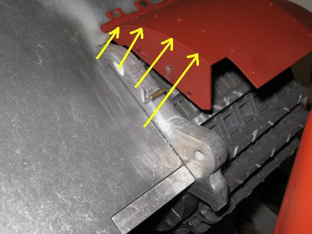

I have been asked to put some of my KT build photos up, but that’s been done already, so here are some of my modification/alterations. Hope you like, and criticism is welcome as long as it’s constructive!!
if you want to see more, there are lot more photos on my web page.
Paul :wink: .

Second all of the above mate, i like the mudguard comparison shot, see you have already done the mod on the hatch we spoke about the other night looks good too :lol: now what am i going to do with this turned woodscrew ha ha.

Post by Chang »
Hi Paul,
Your KT is beautiful! Some added details make it more like real thing than a scaled model.
I like your idea, to let the front fillet (CK0636) attached with the front mudguard, instead of being screwed with the hull side. (See your photo)
How did it attach with the mudguard? by super glue, or welding?:?:
Thanks!
Lerh Chang
Paul Wills
Posts: 1043
Location: The Lake District
Has liked: 646 times
Been liked: 143 times
Post by Paul Wills »
Hi Lerh Chang,
I used silver solder to attach the fillet to the mudguard, you could braze it or spot weld it if you have the equipment.
Paul :wink: .
