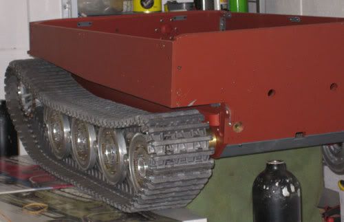

G'day Fellows

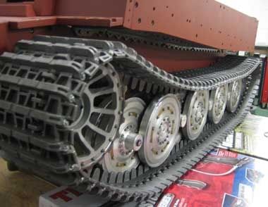

Finally I have got my left side track on, putting the track links together for the right hand side.
Going at this rate they will send me to the Russian front :!:
Thanks to all for posting their pictures and answering questions

Nice work, its really starting to take shape. I can rememer assembling my tracks, you be happy when there done.
Keep the pics coming, Jim
Posts: 2351
Been liked: 831 times
Tim,
Getting the tracks on is a really big day - even if its only temporary. I remember the day I put tracks on my panther. It felt like wow that is a real tank now! The tracks are a very impressive part of the kit. I wish the late T1 tracks had the ice cleats on them but none the less are very cool. Your Tiger looks great. Are you going to add zimmerit? I can't wait to see your camo scheme.

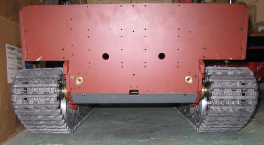

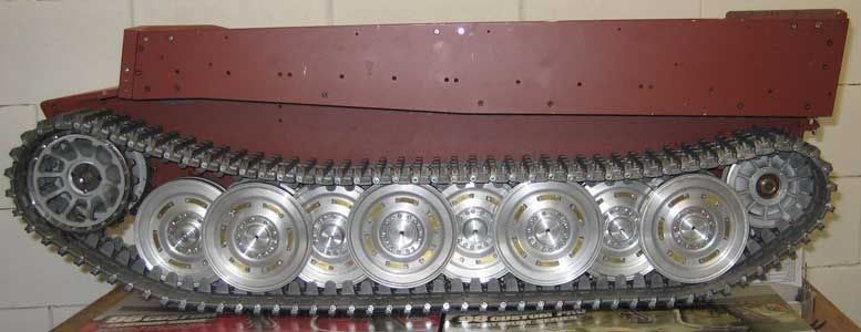

G'day Fellows
Jim and Bob your right in saying that it is a great experience when those tracks go on. Mark my hat off to you for making these beasts!
So the Right hand tracks are on "praise the lord" and she has been put on the floor!

Very nice Tim!
As Bob said, once the tracks are one it really is a great feeling and the model takes on a whole new look. I love that side view picture!
Keep the pictures coming!!

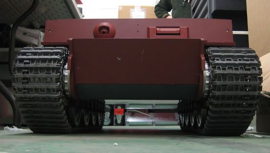

After getting the beast on the ground we stated to roll it backwards and forwards it was running so good we ended up further apart and shoving with our foot like a bazaar game of soccer.
Then I tried to take one or so links out a side then it went all down hill from their.
The track felt a bit loose but take one out to tight, so for the last few hours I have been adjusting track length, found the front sprocket wasn't tighten up in the right place, found some of the axle end caps were a bit loose lucky I can adjust them thru the Hub cap.
To be honest it’s been great learning a lot.
It’s running 95 links driver side and 94 on the other
Next week time permitting I would like to get the engines in and run it.

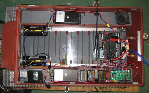

Electrical Setup
Post by Tim McCarthy »
G’Day Fellows
Here is the Electrical Layout. So far has tested positive
Still requires a bit of a tidy up but the object at the moment is get everything operational
Tim Bowman
Posts: 1762
Location: Northern California
Been liked: 177 times
Post by Tim Bowman »
Hi Tim
Looks excellent. Your wiring sure is cleaner then mine. :oops:
Congratulations.

Finished tiding the wiring

Great job on the build so far Tim. That internal layout looks really tidy. I can't believe how much room there is inside these Tigers.
I've just noticed you've said "It’s running 95 links driver side and 94 on the other" earlier in the thread.
I'd be interested to know if that makes it slew slightly as it's driving in a straight line :?:
