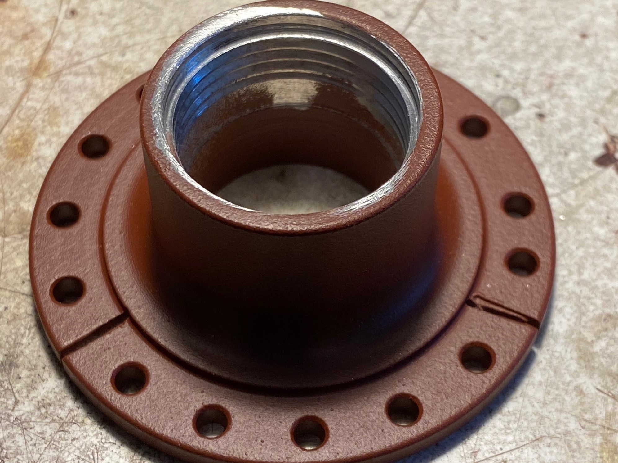

Now i am starting a new project: I think one of the last Sturmtiger out of the box.
The first photos are from the hub caps and the sprockets with the rings. The next are coming.
Regards Martin

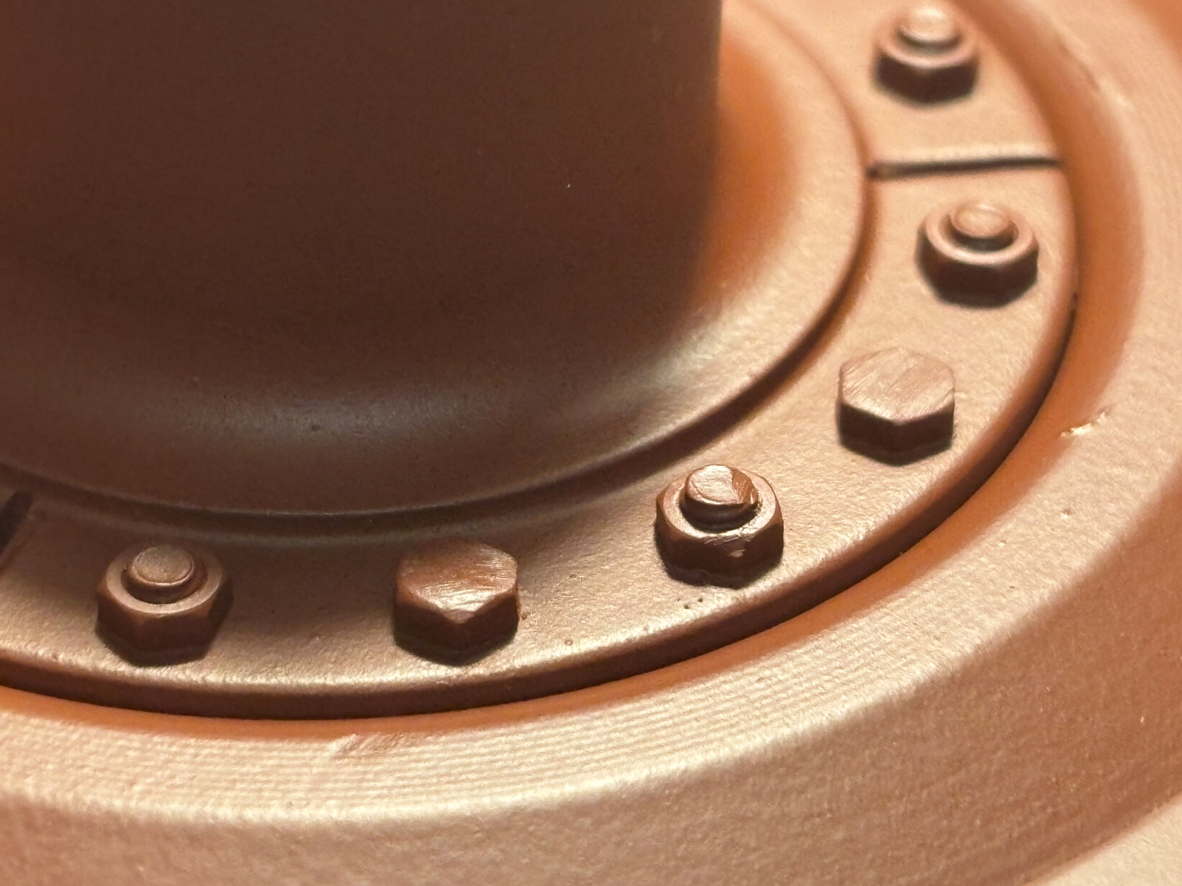

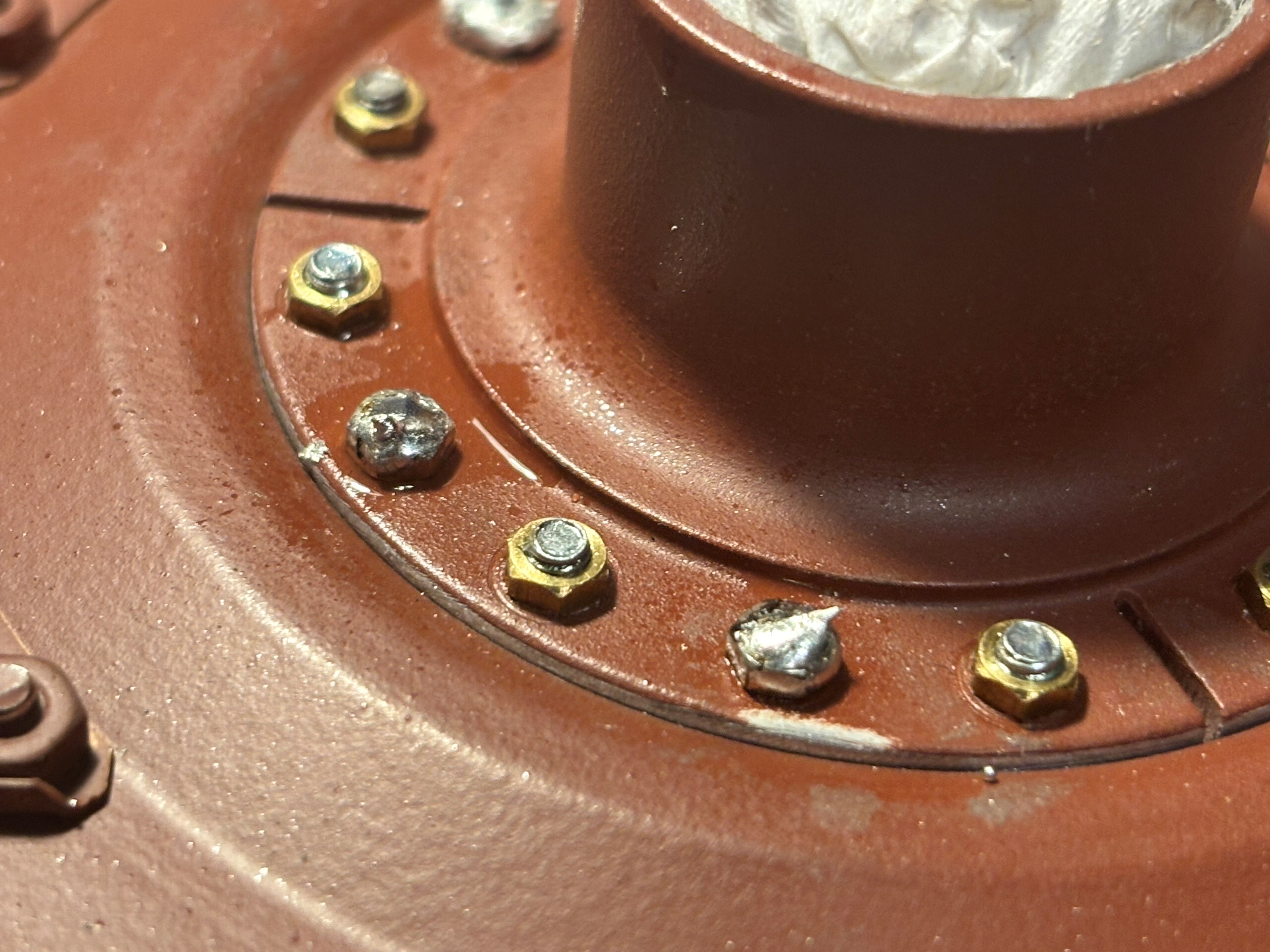

here are the next photos of the road wheels. On the last photos you can see, that the screw 2 and 4 of every 5 screws are soldered to simulate a screw and not a nut.
Regards Martin

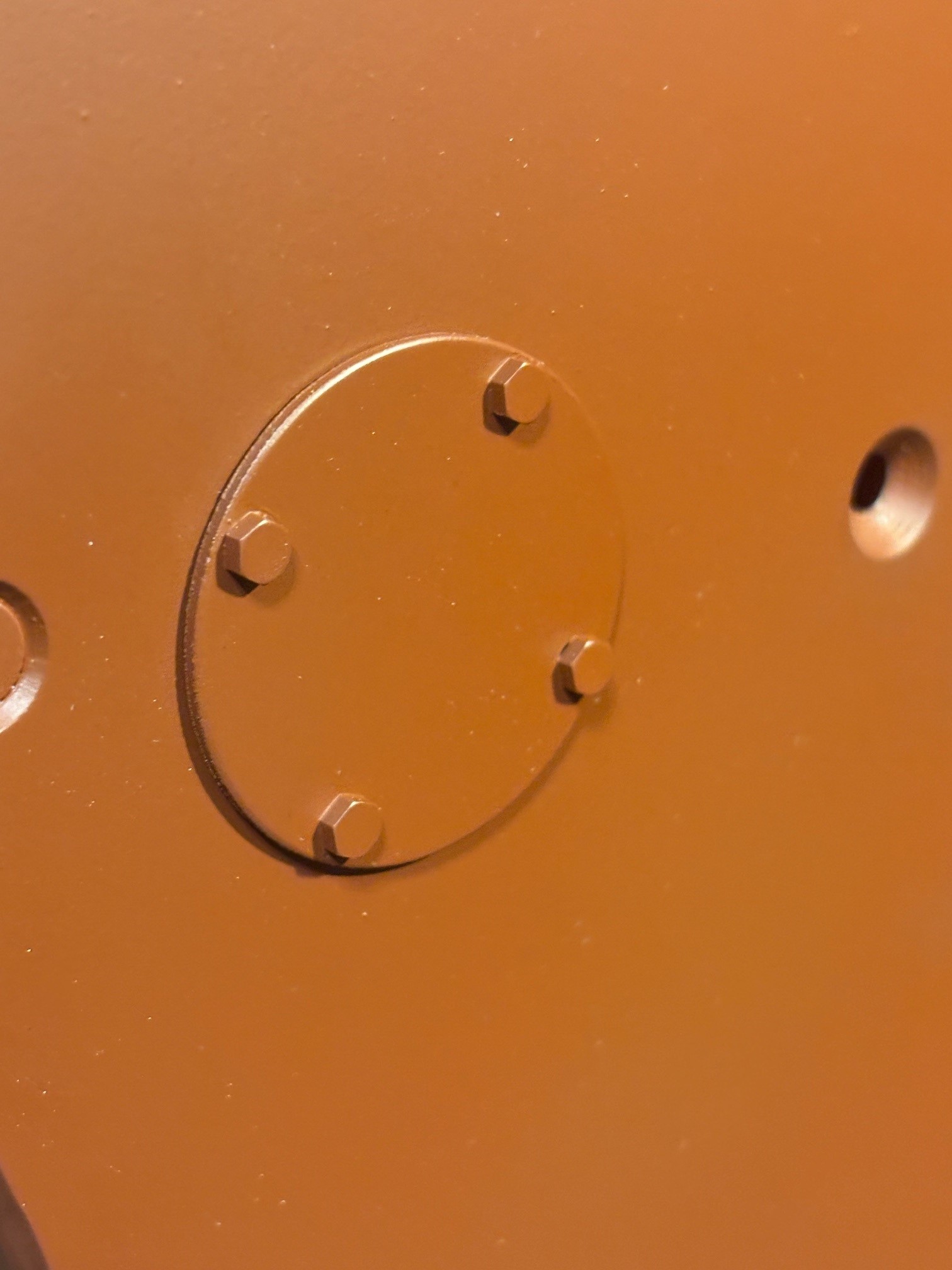

thank you so much for your nice words. But i was to early with mounting the Aluminium sprocket rings from Armortek. In the meantime i ordered the beautiful tracks from Liam and his sprocket rings made of steel. The absolut best tracks for a Tiger 1 i ever saw!!!
So i had to dismount the alu rings and mounted again with the steel rings. Also the road wheels and the swing arms are ready and primed.
Regards Martin

Martin the detail work on the road wheels was superb. The smaller m2.5 nuts on the hub look fantastic and the faux bolt heads look perfect, especially with the larger m2.5 rim nuts. Did you use m2.5 nuts from MVD? That was where I was going to source mine for my KT wheels.

Mark: i used nuts from company Knupfer here in germany they are called: Modellbaumutter. They have a smaller key width than the DIN nuts!

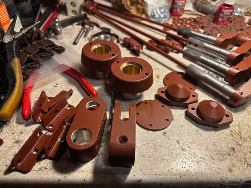

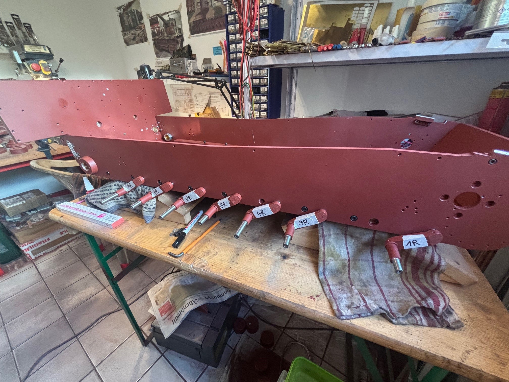

Here are some more progress on the parts of the chassis. The axles are glued into the arms with LOCTITE 2701 and after this the swing arms are drilled and pinned with spring dowel sleeves like all my tanks.
Regards Martin

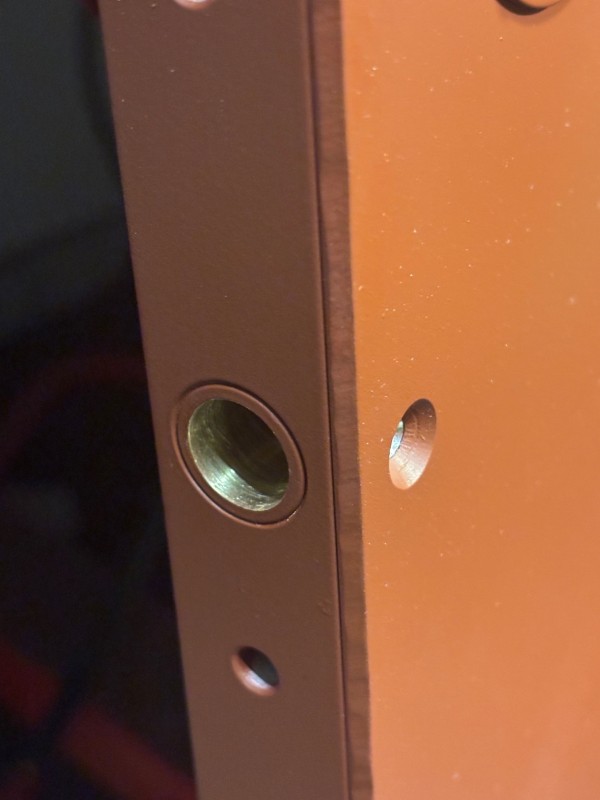

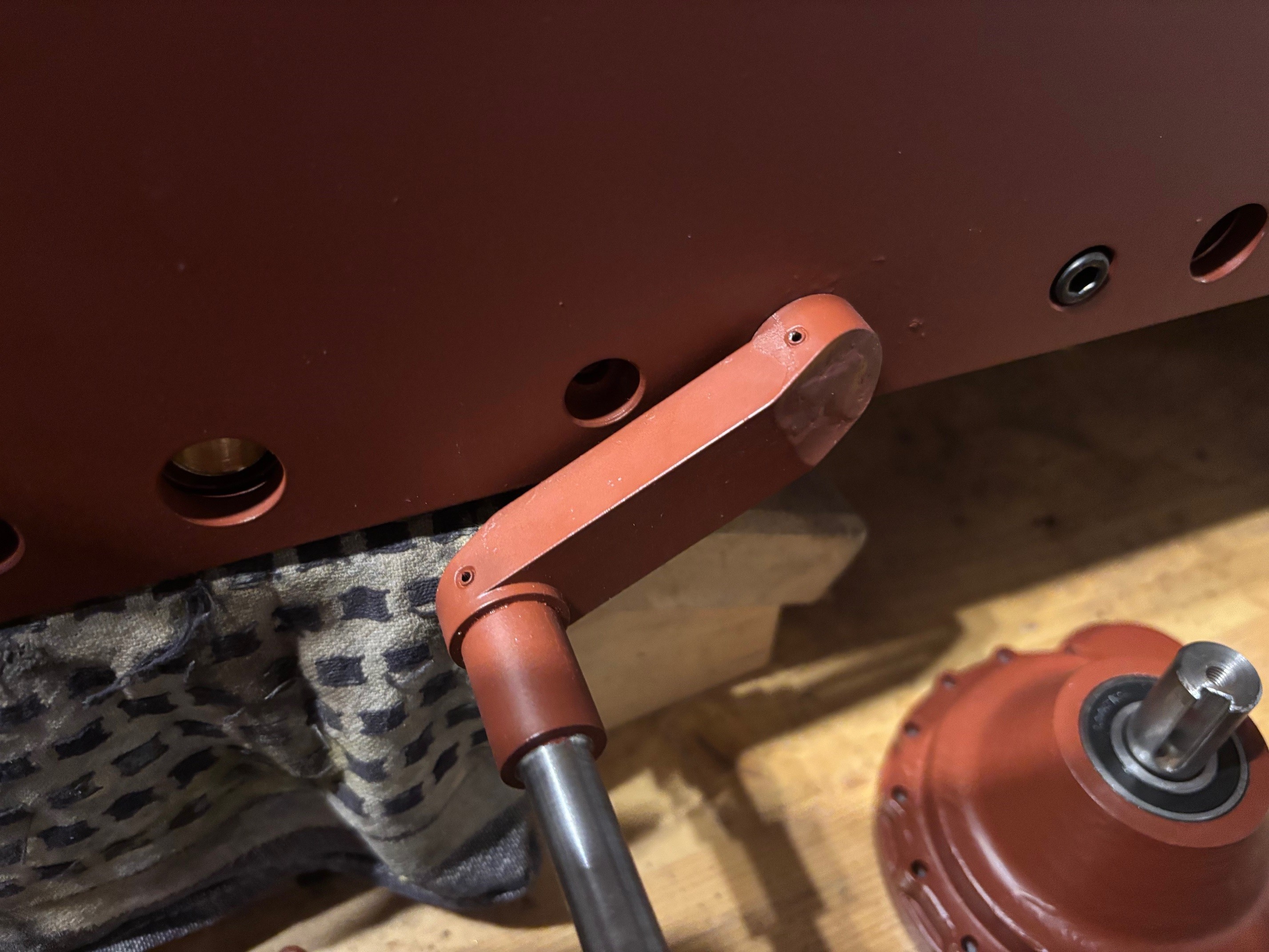

In the meantime i made some more progress with the hull and also with the final drive.
Regards Martin

Now there is a small update with the shortened axles of the swing arms.
Regards Martin
