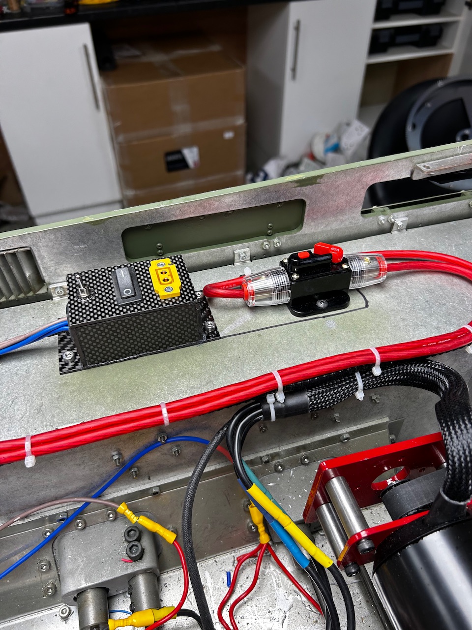

Post by Martin Donnison »
Hi Chris,
I fitted a remote charging lead and socket to the batteries so I don’t have to remove the deck to charge the batteries.

Re: Turret-on battery charging wiring diagram??
Hi, as long as you isolate the breaker no voltage will get to the power control unit so it will be safe.
I use a 24v charger so all I do is power off the unit and plug in the charger.

ok... Is the 'bullet shaped thing' in your pic a breaker? how does this fit into the scheme of things?
does it sit between the batteries and the power module? on the + or the - side?
(electrics is definitely not my strong point!?)
cheers,
C
