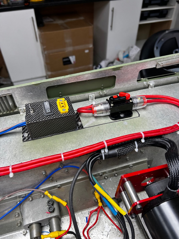

Hi, as long as you isolate the breaker no voltage will get to the power control unit so it will be safe.
I use a 24v charger so all I do is power off the unit and plug in the charger.

Re: Turret-on battery charging wiring diagram??
ok... Is the 'bullet shaped thing' in your pic a breaker? how does this fit into the scheme of things?Martin Donnison wrote: ↑Wed Nov 06, 2024 9:55 pmHi, as long as you isolate the breaker no voltage will get to the power control unit so it will be safe.
does it sit between the batteries and the power module? on the + or the - side?
