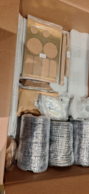

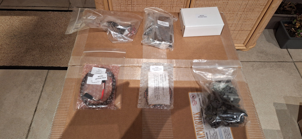

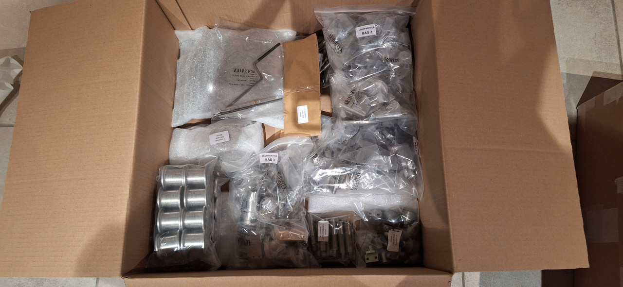

Hello,

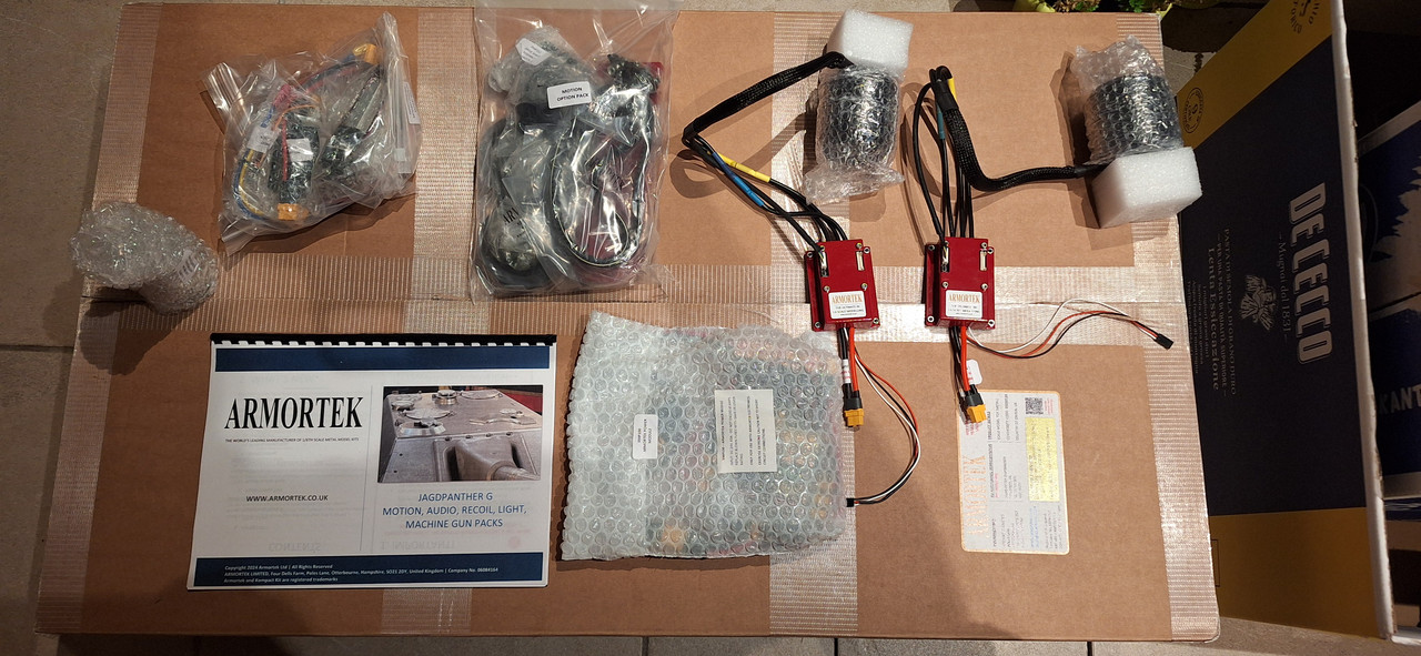

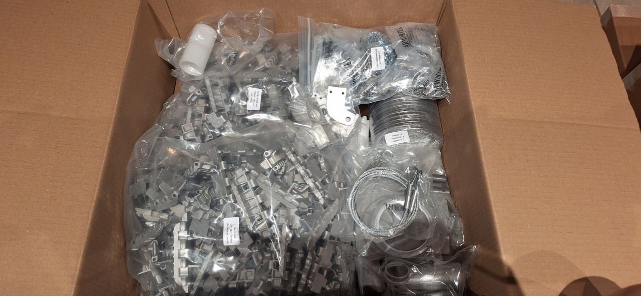

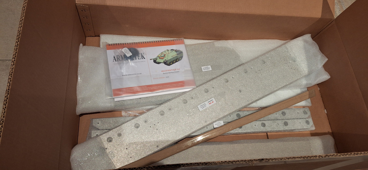

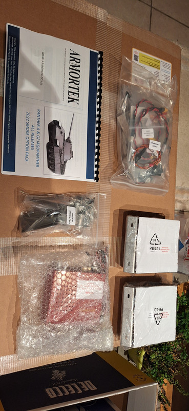

On monday i did collect the jagdpanther and all the optionpaks from the Armortek factory.
Today i open the 4 boxes.
Best regards Yves
Best regards Yves

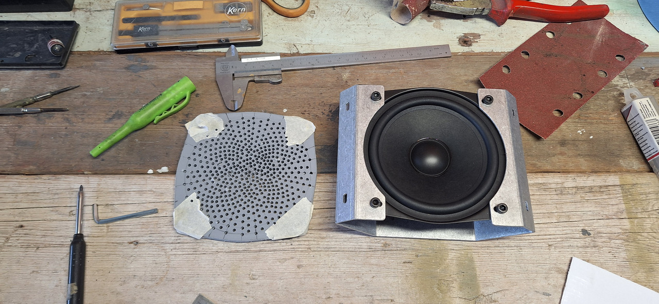

Smoker fixt
Did make two speaker plates for protection.

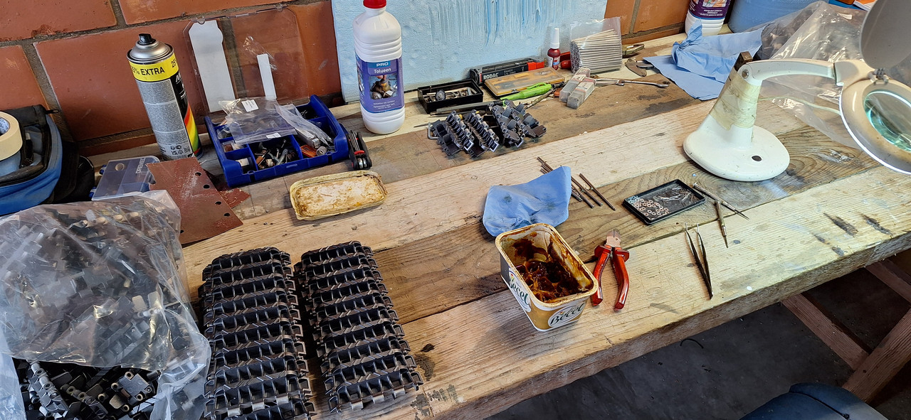

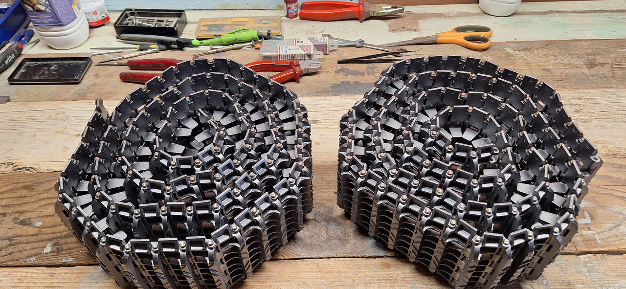

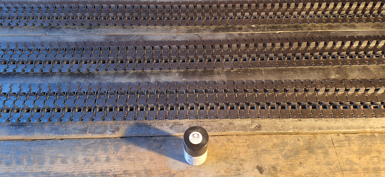

Painting the tracklinks with Tamiya gun metal
Now a big therapy session

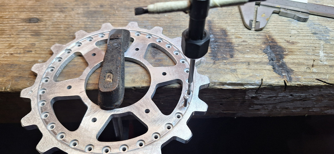

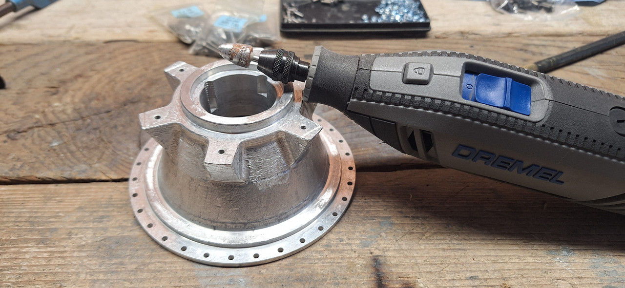

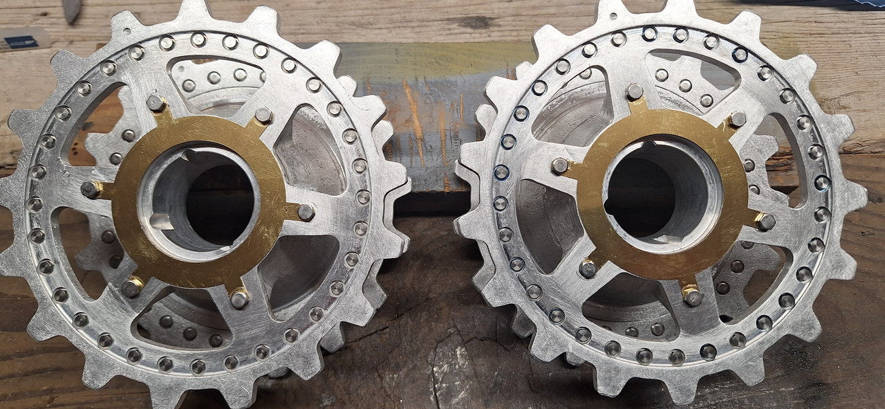

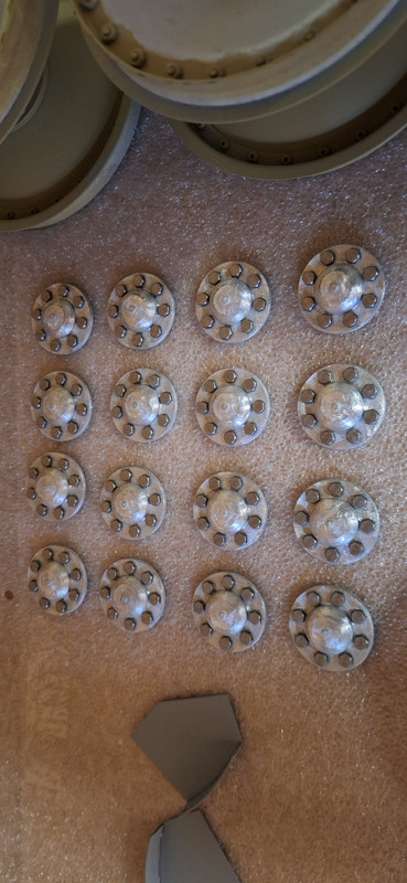

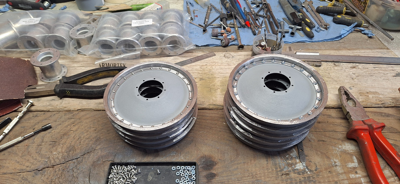

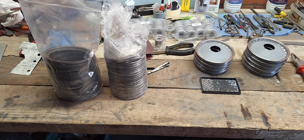

Started also on the sprockets,
i change the bolts on the outer sprocket rings with bolts with a smaller hex head
and put thread in the holes.
That's all for the moment, tomorrow go the my job again
Best regards Yves

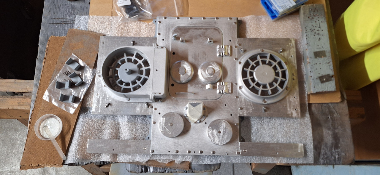

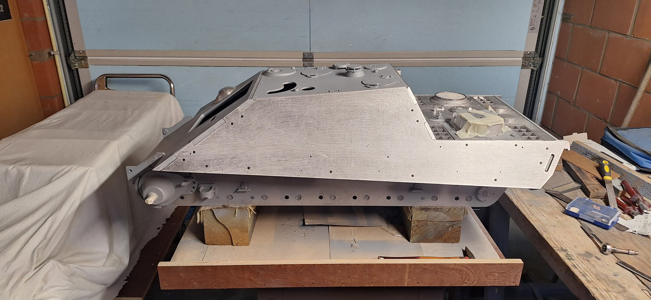

a little update of what i have done these days.

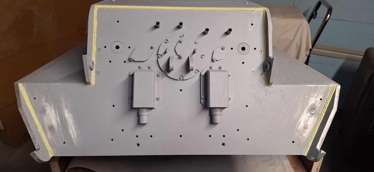

Working on the rear hatch details
Best regards Yves

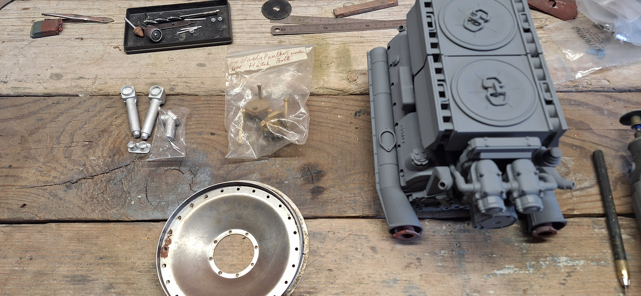

Nice update

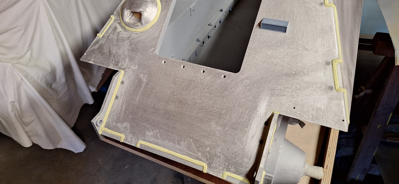

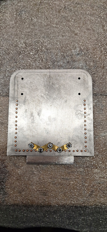

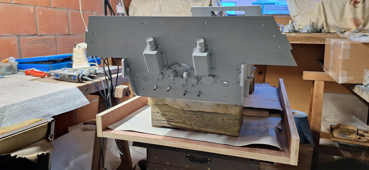

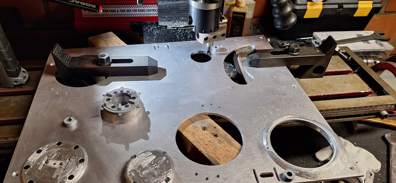

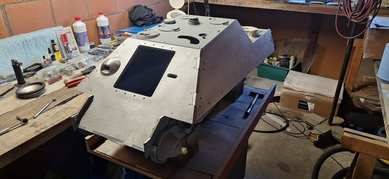

On the first pic in late tread, what are you doing with the mill? And why?
At the Jagdpanther roof.
Have a nice day
Robert T

Hello Robert
I mill out the hole a little bit more to move the grenade launcher with a servo,
I also make the scopes movable
Best regards Yves
Best regards Yves

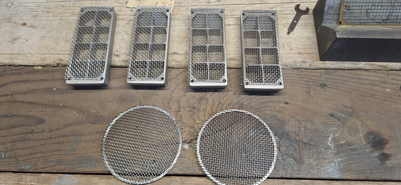

Change the grills mesh,
Started also on the wheels
Best regards Yves

Here a little update.

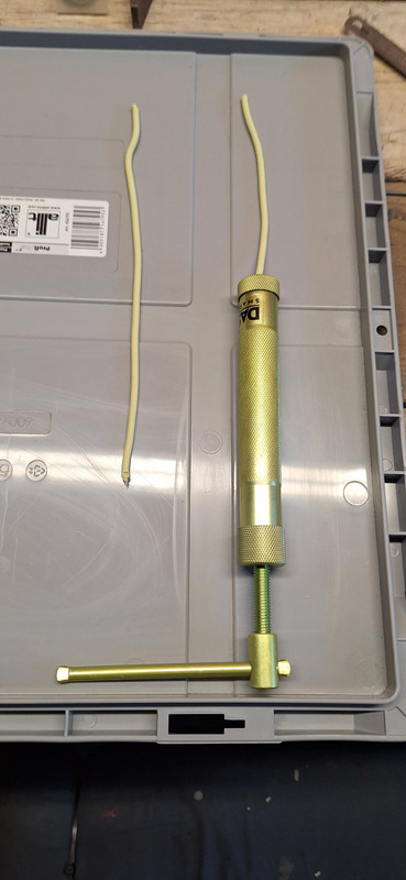

Use mr surfacer 500 for the metal wheel look
Put some welds on the jagd with a special tool ( thanks to Chris )
Best regards Yves

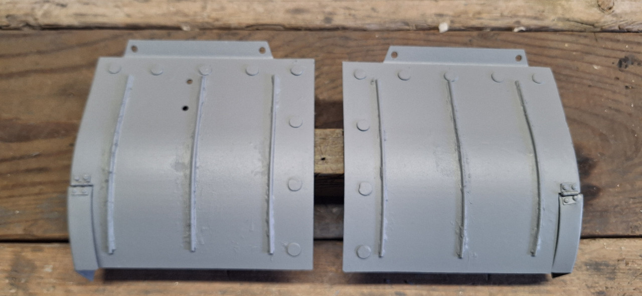

Did some work on the front mudguards.

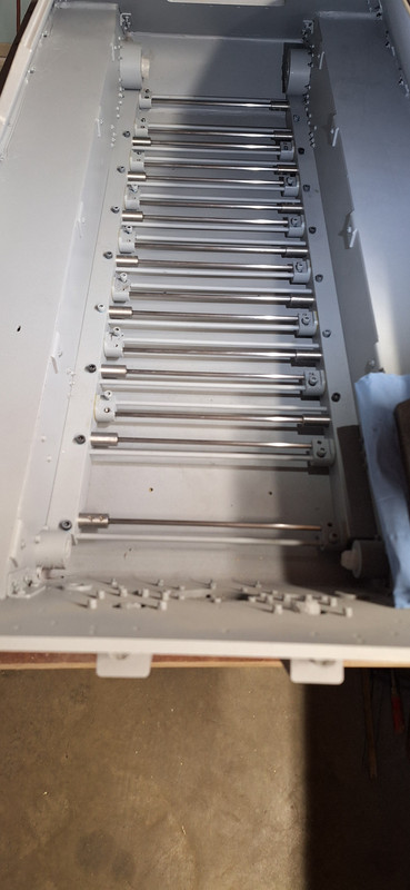

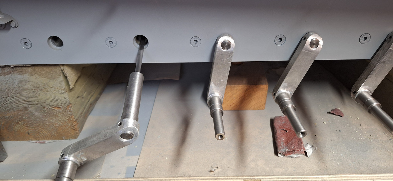

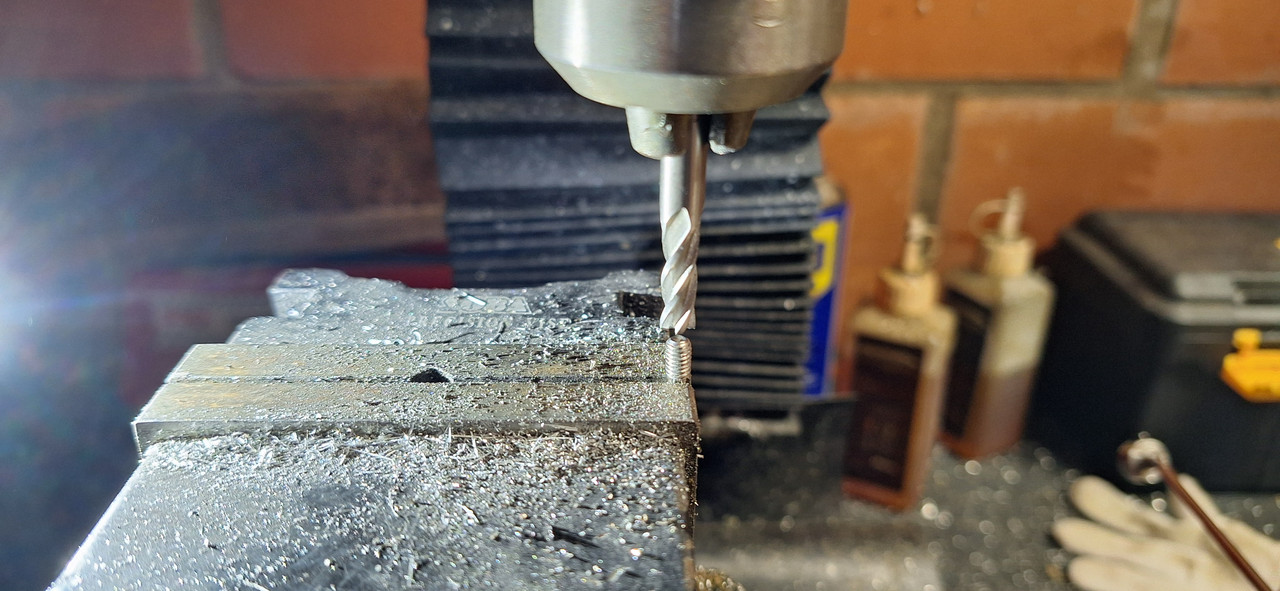

Working on the suspension arms and torsionbars.

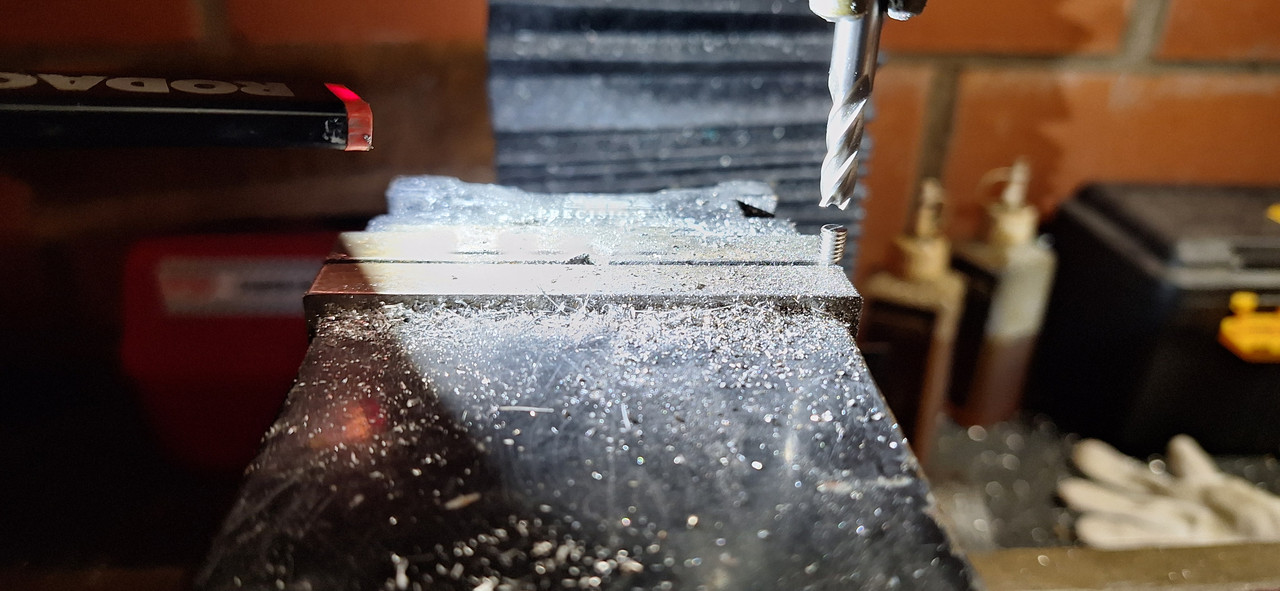

I mill down the 8mm M4 grubs so i can put the fixt torsionbars from the outside into the belly
of the jagd ( also easy take out for maintenance ) so i dont need to unscrew the grubs to take out the suspensionbars.
I did this modification on all my tanks.
Best regards Yves
