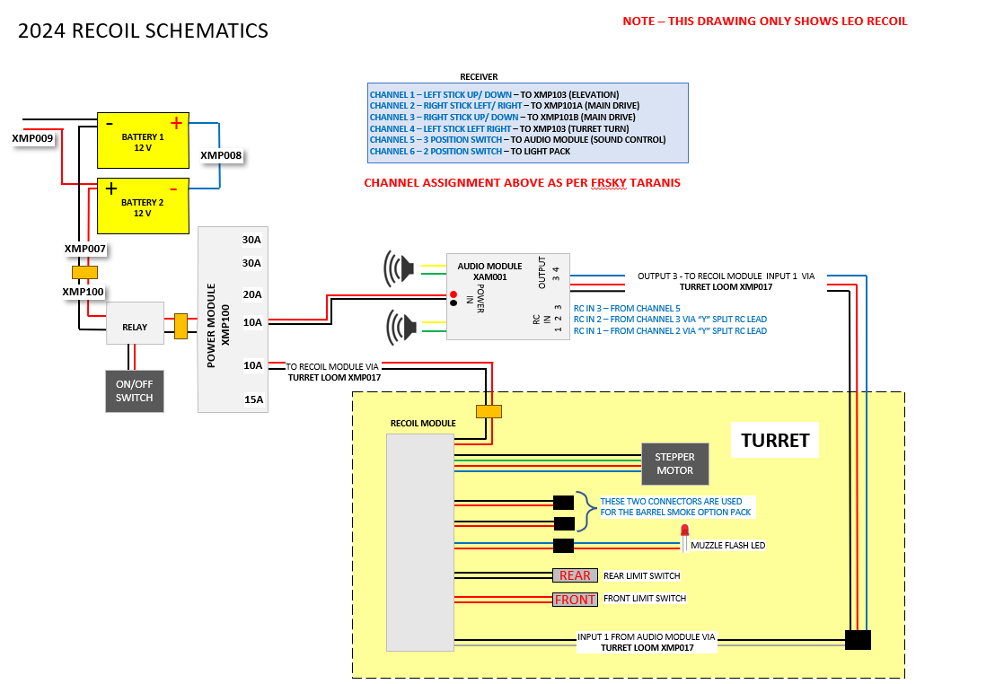

Sneak preview of the wiring for the 2024 Recoil System.
Shipping is scheduled to start this week for the Leo but in very low quantities.
