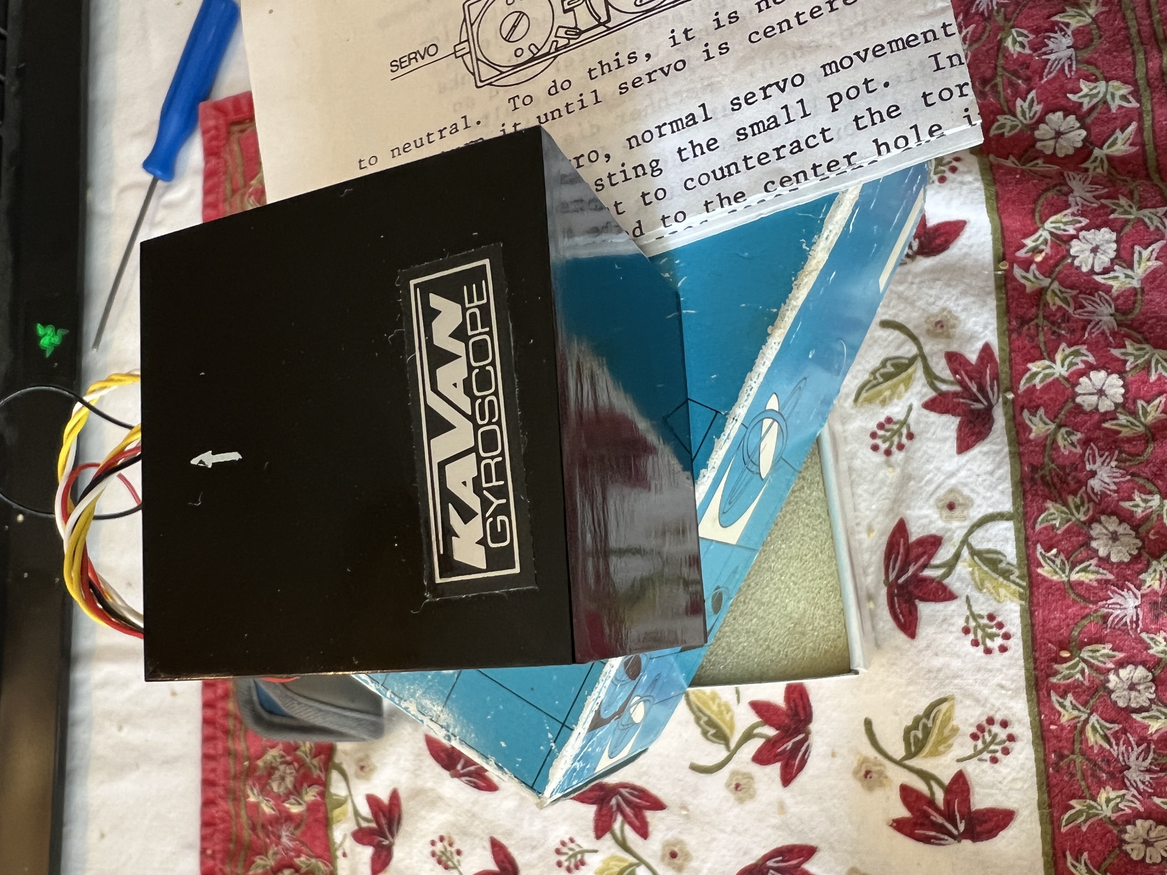

I still have old (antique!) gyro stabilizers from the 1970s from Kavan and Sankyo; true motor driven things. the Kavan black box version always let you know when you started it- it sounded so cool! Having a gyro stabilizer in my Kavan Alouette was the only way I could fly it successfully...otherwise it was terrible.
