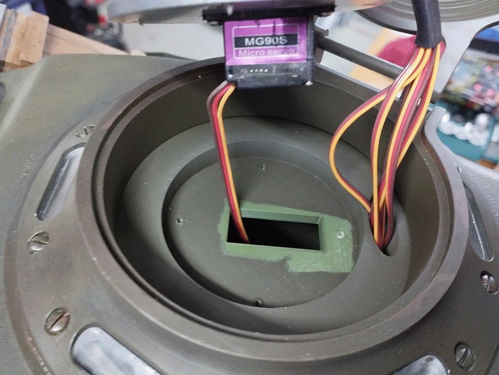

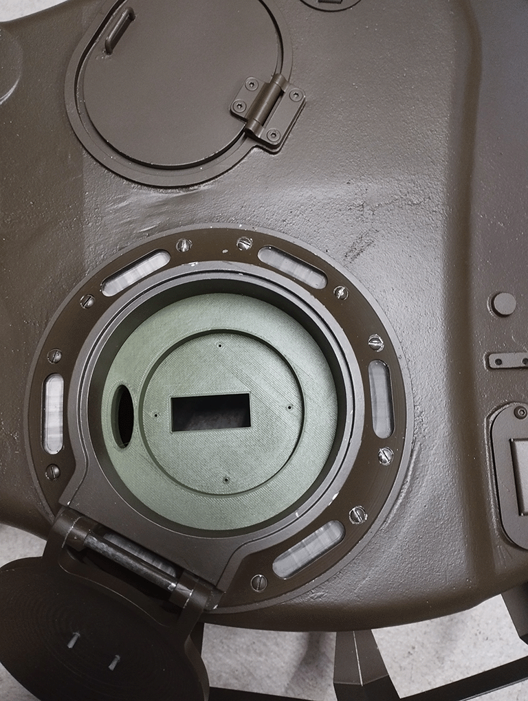

I am still finalizing and detailing my Pershing and I am working on the positioning of my figurines. My commander is a 3D printed powered by 6 micros servos (animatronics). I bought it on cults3d.com (https://cults3d.com/fr/mod%C3%A8le-3d/d ... -figure-v2)

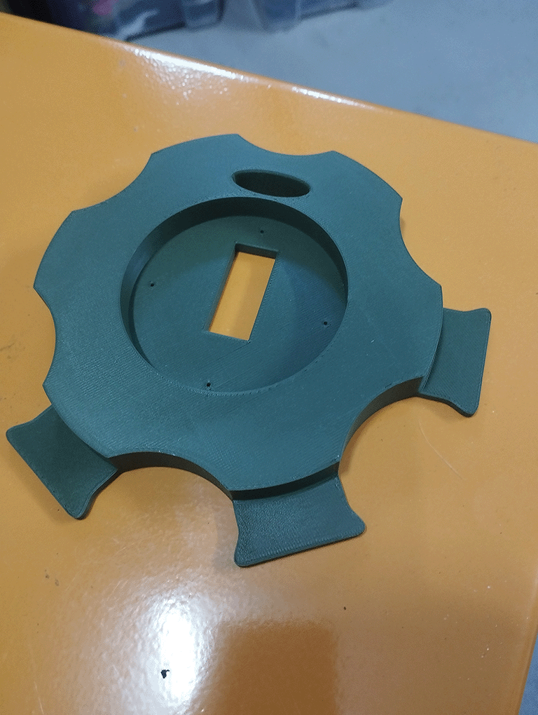

For its positioning in the turret, I modeled a plate that I printed in 3D. It is fixed from the inside using existing 3x40 screws which secure the upper part of the commander hatch.
  • The round central part allows to fix the figurine on the plate with 4 3x8 screws.
      The lower servo passes through. The plate is fixed from the interior of the turret with the original screw in 3 places (3 times 2 screws). It is sufficient and very stable.
    Purists would have made the part in aluminum but I am more comfortable with 3D modeling and printing :wink:
    I am ready to share the stl file for those of you who may be interested.
