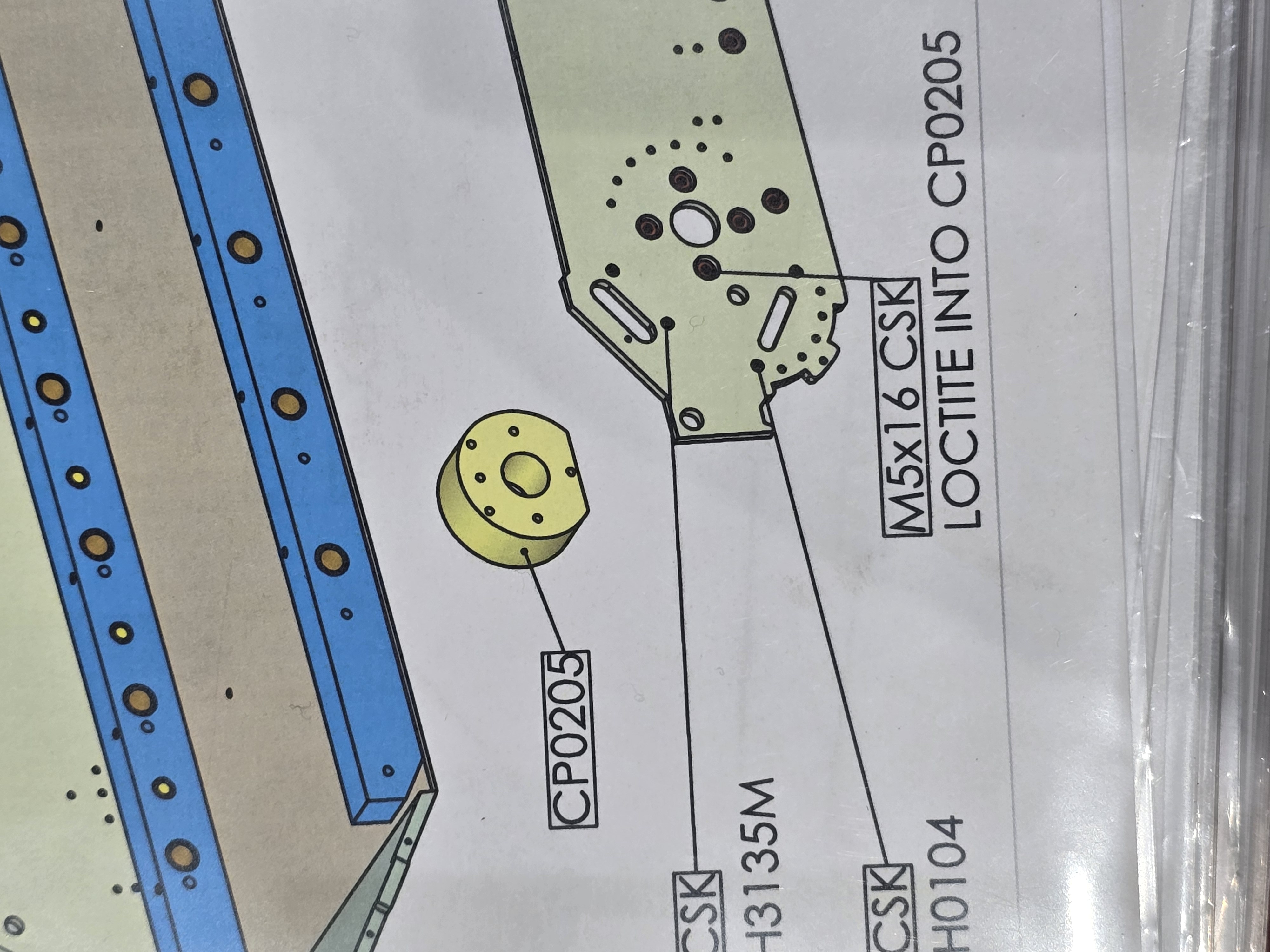

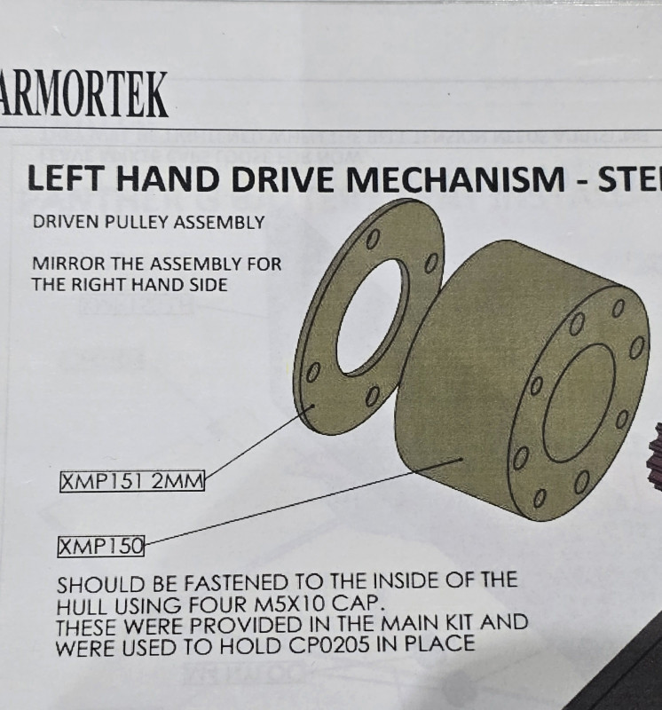

Has anyone fitted the new drive motors to a Panther G yet.
If so does part CPO205 need to be replaced with XMP150.

Re: Panther G with New Drive Motors
Yes. CP0205 is the motor mount for the brushed motor, XMP150 is the mount for the new system.
Thanks Adrian,
Unfortuntally I thought that may be the case. My Kit arrived in January, my option packs did not arrive till June.
As I could see no mention in the manual that there was a diffrent part for the motor mount, with the new motors, I continued to build the kit.
Lower hull completed with tracks fitted ready for options. So now looks like have to take apart again. To make matters worst I mistakenly used loctite 638 on the motor mounts
, so any advice how to get the fixings out would be appericated.
