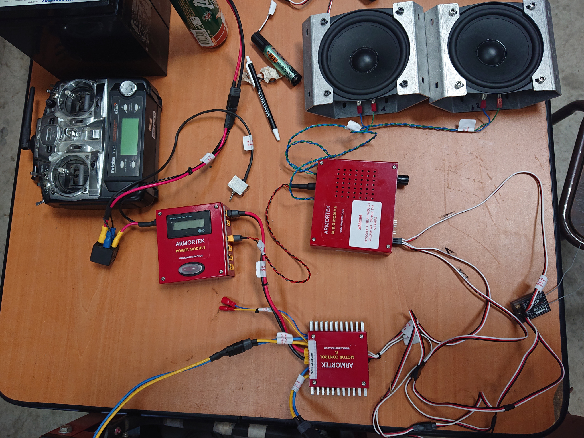

Hello.
I have an issue tImagerying to set up audio pack red box, bought "a certain time ago" for updating my comet (early red boxes as per design of the main power box)
installed as per the book (using Y cable to distribute motors signal to 1&2, + 3way switch on position 3)
No sound when switching on the system
not possible to get a "beep" when pressing programming button.
Anyhow, i'v' tried to perform the set up as per instructions but without result (i've also tried moving the 3 way button opposte direction in case my schwitch was reverted)
transmitter is futaba T7c, working on former silver boxes,
3 way switch being on channel 5 (as formerly)
set up on power module done without issue just before, and batteries are "full"
Any idea ?
regards
Didier

Shaun Hunt
Posts: 21
Joined: Mon Sep 14, 2015 8:24 am
Been liked: 10 times
Re: no set up possible
Post by Shaun Hunt »
Hi Didier
Looking at your photo it looks as though one of the cables is not connected correctly it looks reversed to me. Same colour should be on both sides
The very bottom one on your photo
I cannot tell about the others it may be worth checking all are correct
Regards Shaun
Screenshot 2024-07-26 182306.jpg (33.88 KiB) Viewed 1795 times

Shaun Hunt wrote:
Fri Jul 26, 2024 6:32 pm
Hi Didier
Regards Shaun
Hello Shaun
i will check, but for me all plugs were correctly fitted
Didier
Posts: 5126
Has liked: 1480 times
Been liked: 1685 times
If that plug is reversed then that will shut down the sound card.
Post by Didier Molard »
Hello
OOOps just saw (on picture) the plug was connected reversed !?
Normally, it should not be possible ?
Will check this afternoon, and tell you.
Didier
So
Checked the plugs, seems pictures was made and error corrected earlier, as everything was ok
Finaly manage to see the Green blinking Green (fast place)
But still no no hissle nor humps on speakers nor sound when switching on...
Didier
