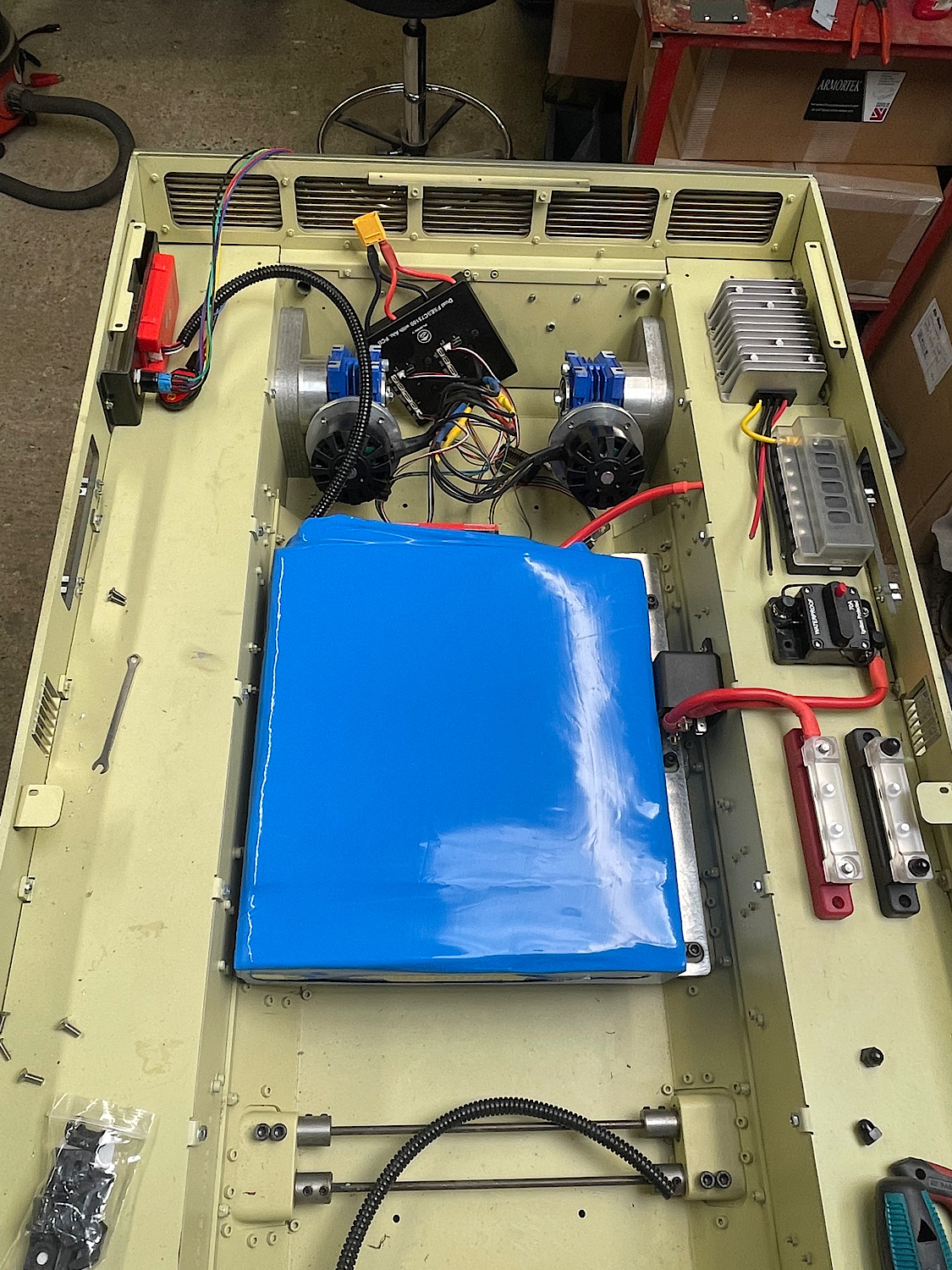

Good morning,
has anyone dealt with the batteries? Number of AH and dimensions?
Where will the suitable location of the batteries be?
Location for speed controller and sound module?
Technical layout?
Technical layout?

I have designed and fitted a 24v 52ah lifepo4 pack to fit in the leopard using 8x 3.2v eve prismatic cells.
It’s probable overkill for most, but we will be heavy and running a lot so it should be good for me.
Its low profile works great for me.

Hello Paul,
Thank you very much for your opinion. I haven't received any electronic parts from ARMORTEK yet, so I can't make any plans. I also have no idea what the parts look like or their dimensions.
Thank you again for your answer.
I would also be interested in other variants......

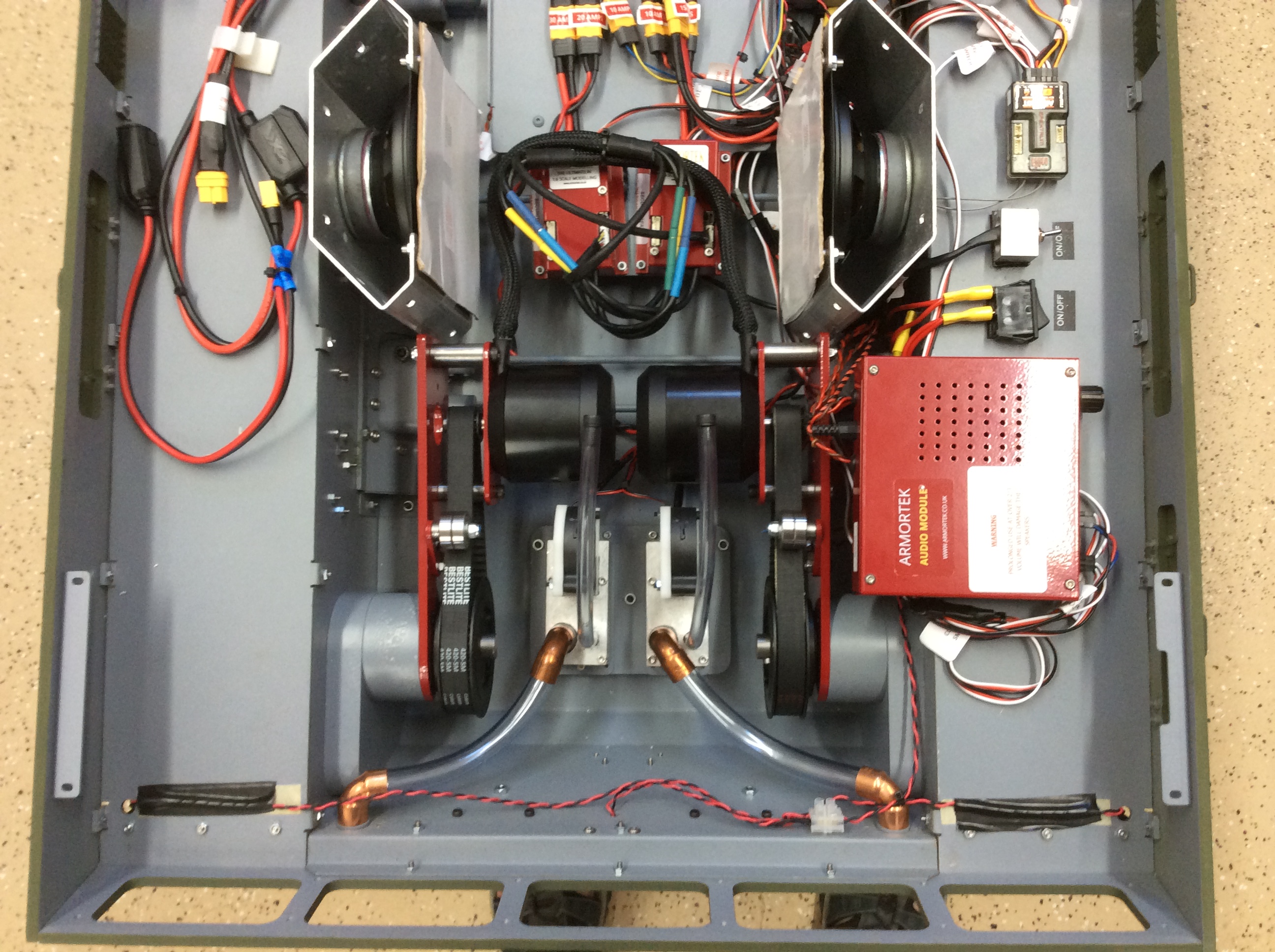

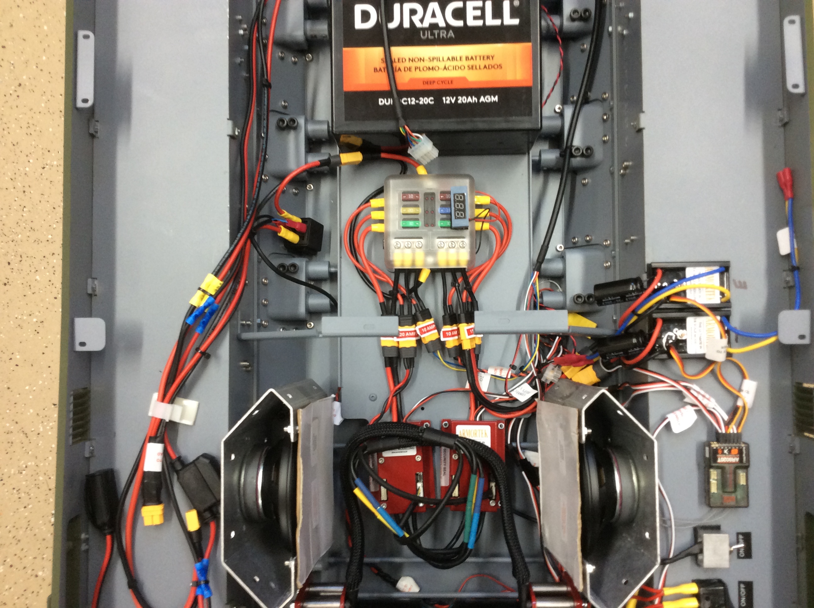

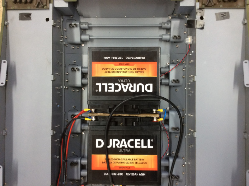

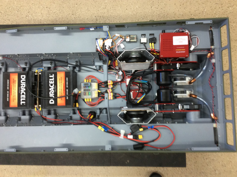

Hello,
Here are a couple pics of the way I layed out my electronics.
The batteries and speakers are held in place with 10lb velcro strips.
Everything else is held in place with 3 lb velcro.
The battery disconnect plug and battery charging lead will be accessable from the left hand rear access door on the deck place.
The volume control, smoke on/off switch, electronics on/off switch and receiver will accessable from the right hand rear access door on the deck plate.
The smoke refill tubes will be accessable from the small access door directly above them on the rear deck plate.

Hi Rolf
Nice layout.
What current is the panel mounted XT60 socket rated at? 30Amps?
Nice layout.
