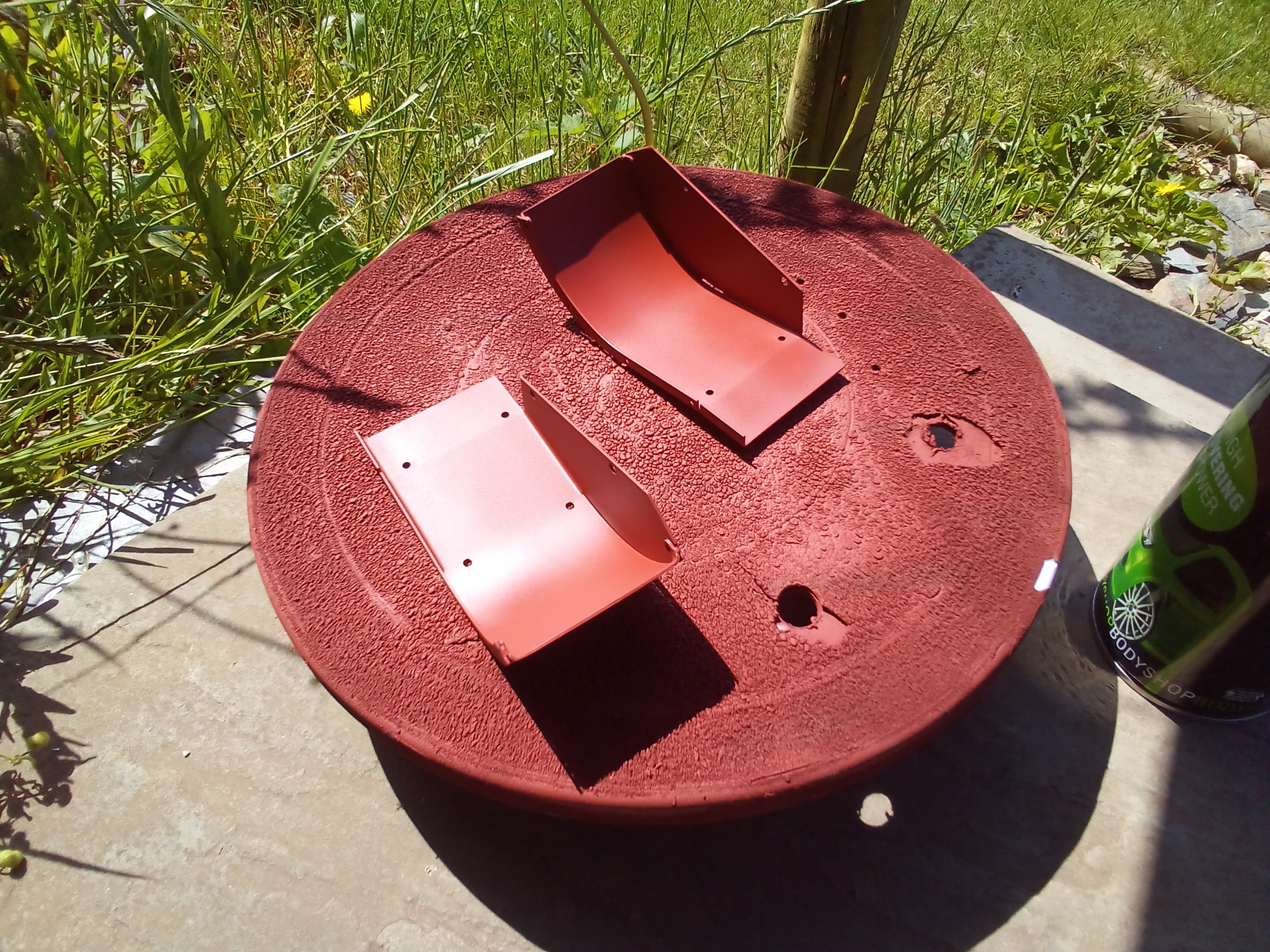

A question guys, are these fitting heat shields for the twin exhausts? Also shouldn't they be at a slight angle?

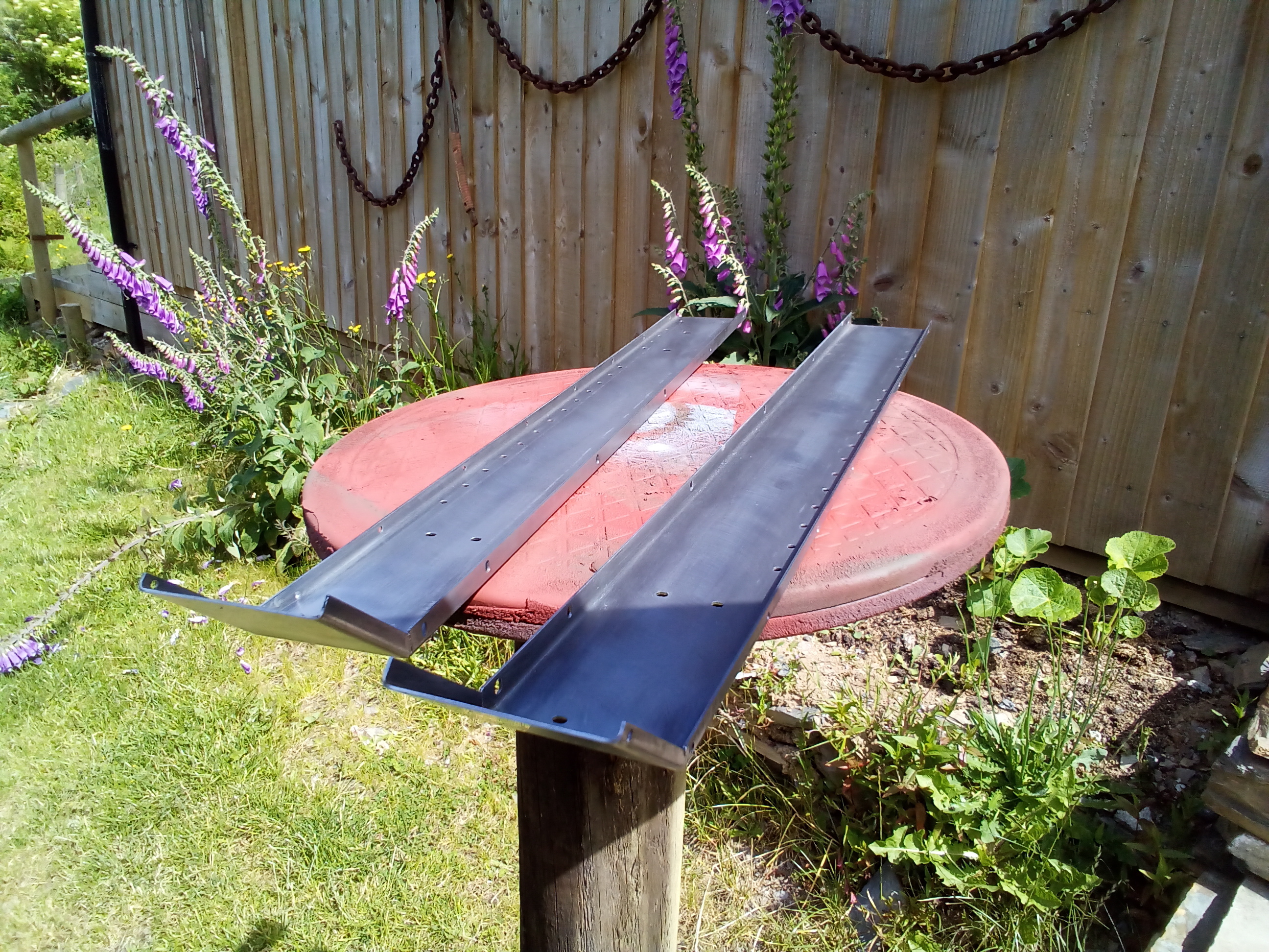

The journals almost done

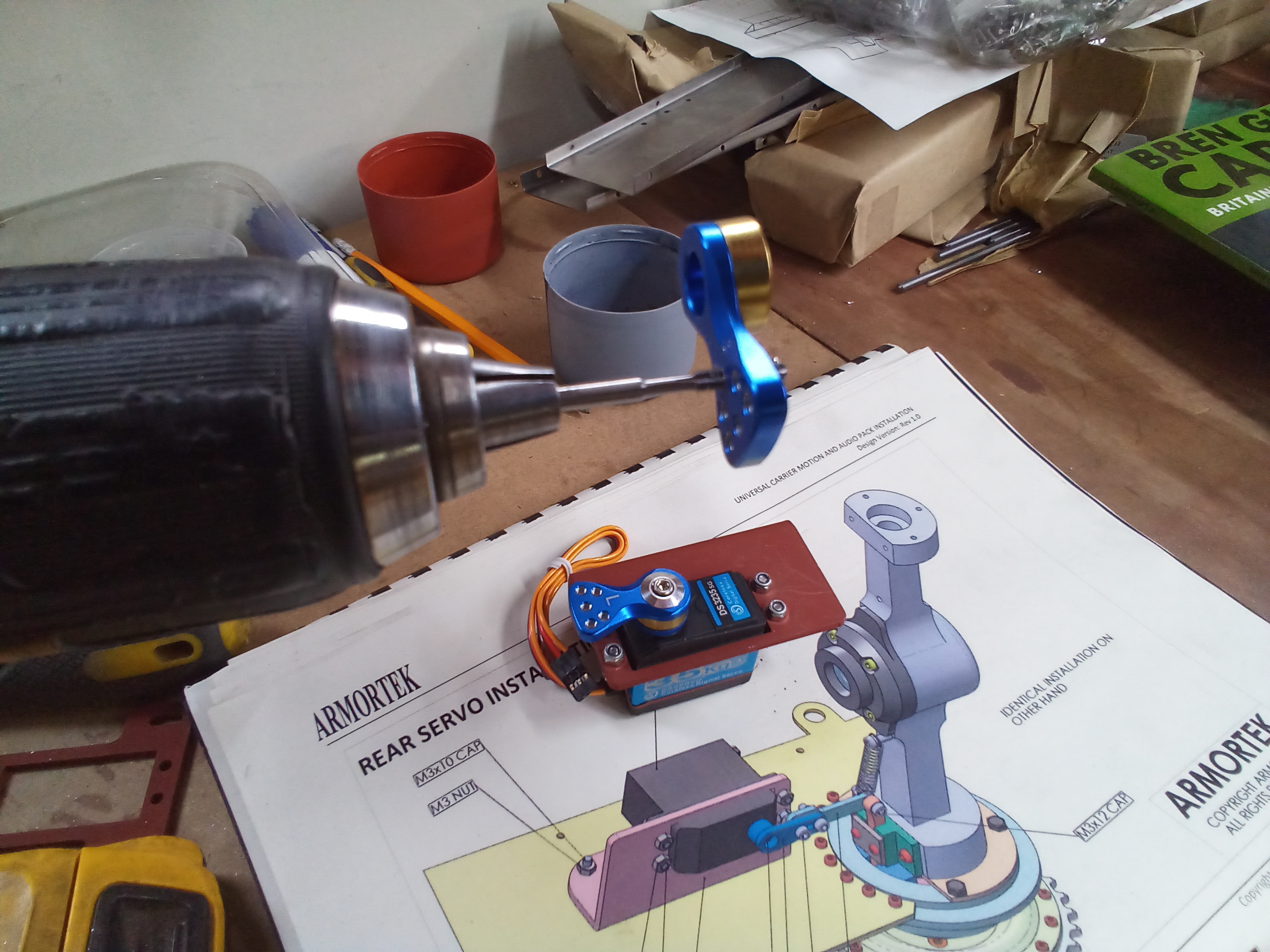

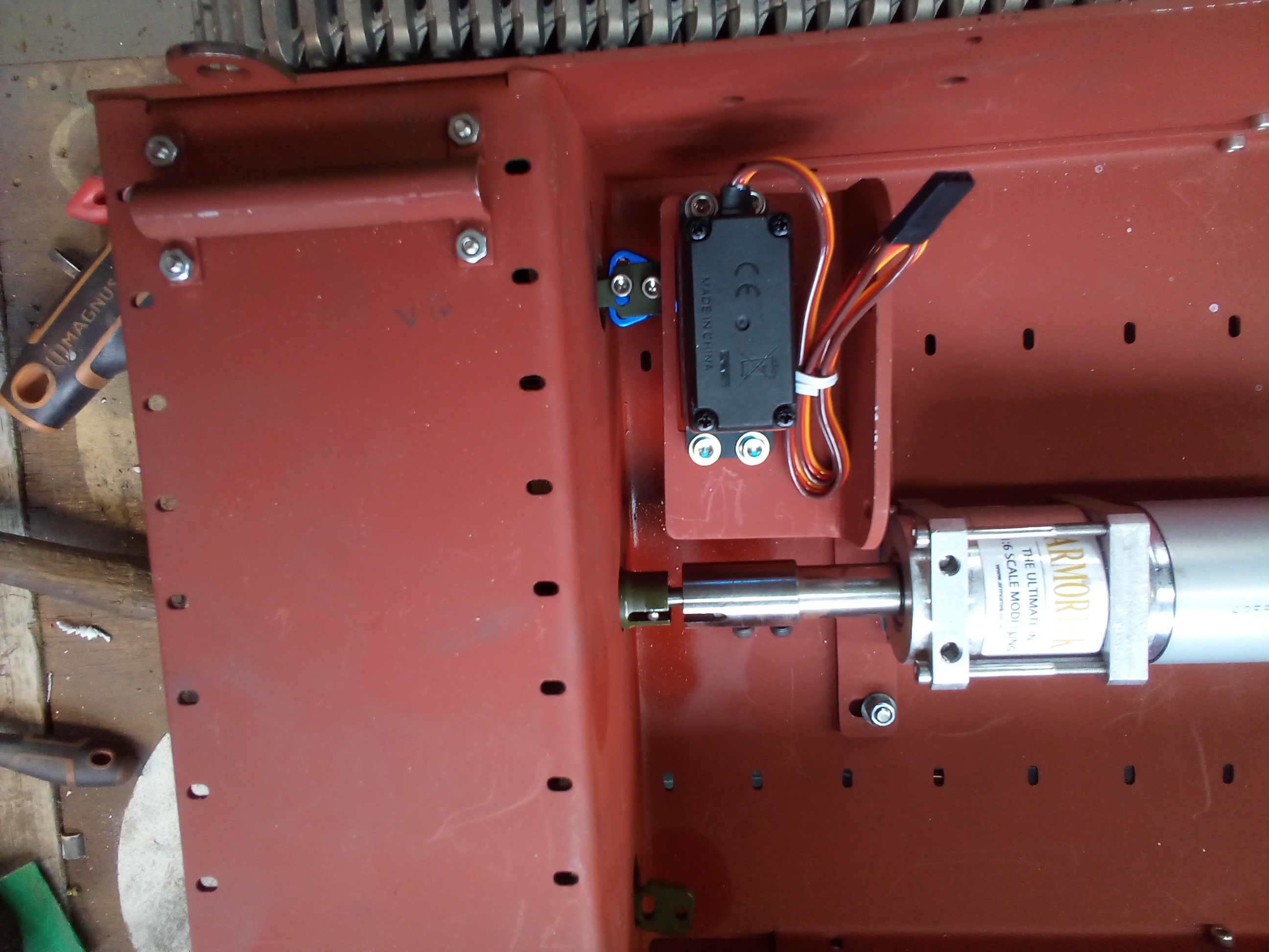

The servo saver needed the second m3 fixing drilling and tapping.
The servo steering brakes.

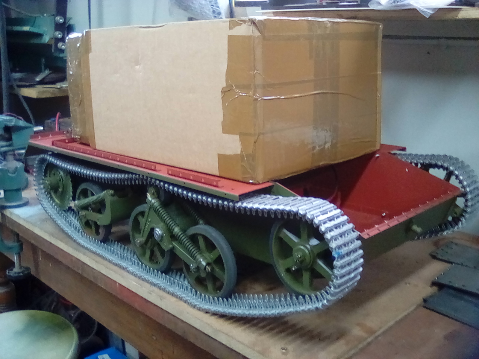

Both tracks fetled and mounted and running in.
