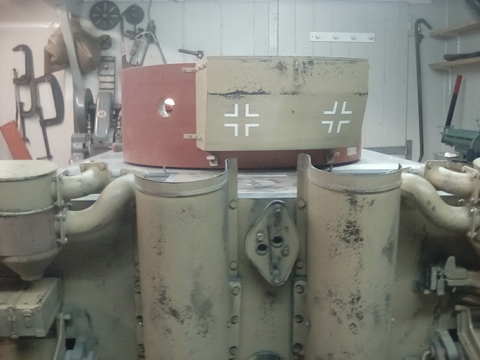

Hope the hole is in the correct position. Sending you the file.

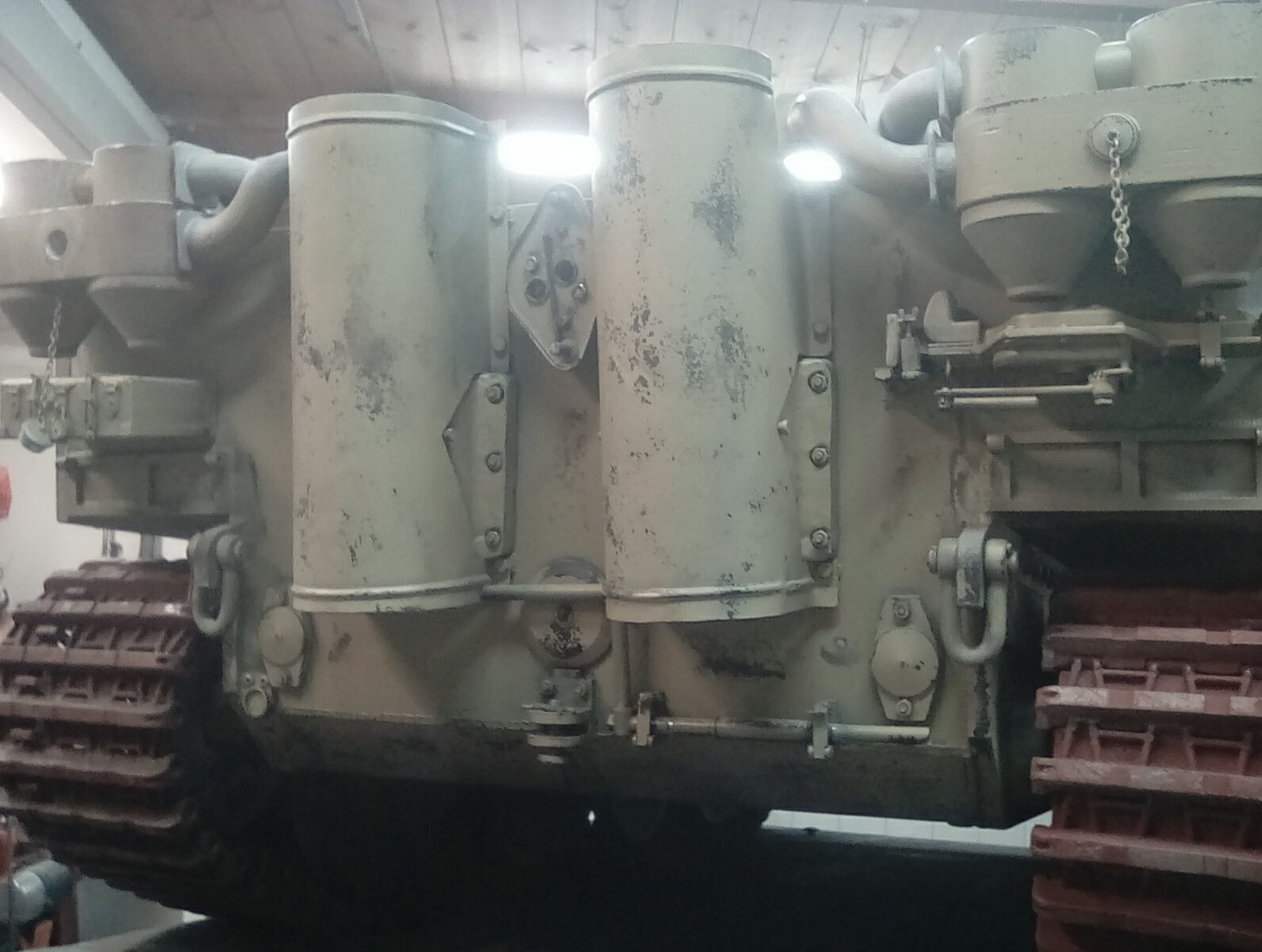

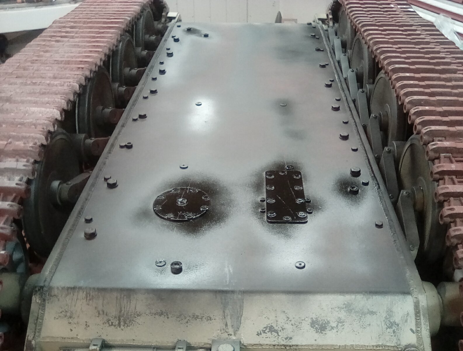

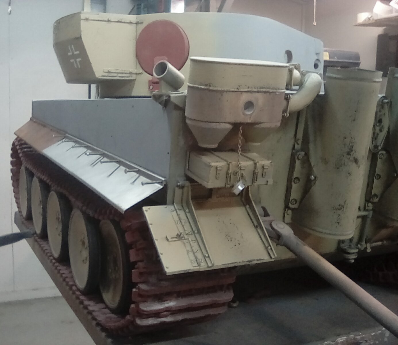

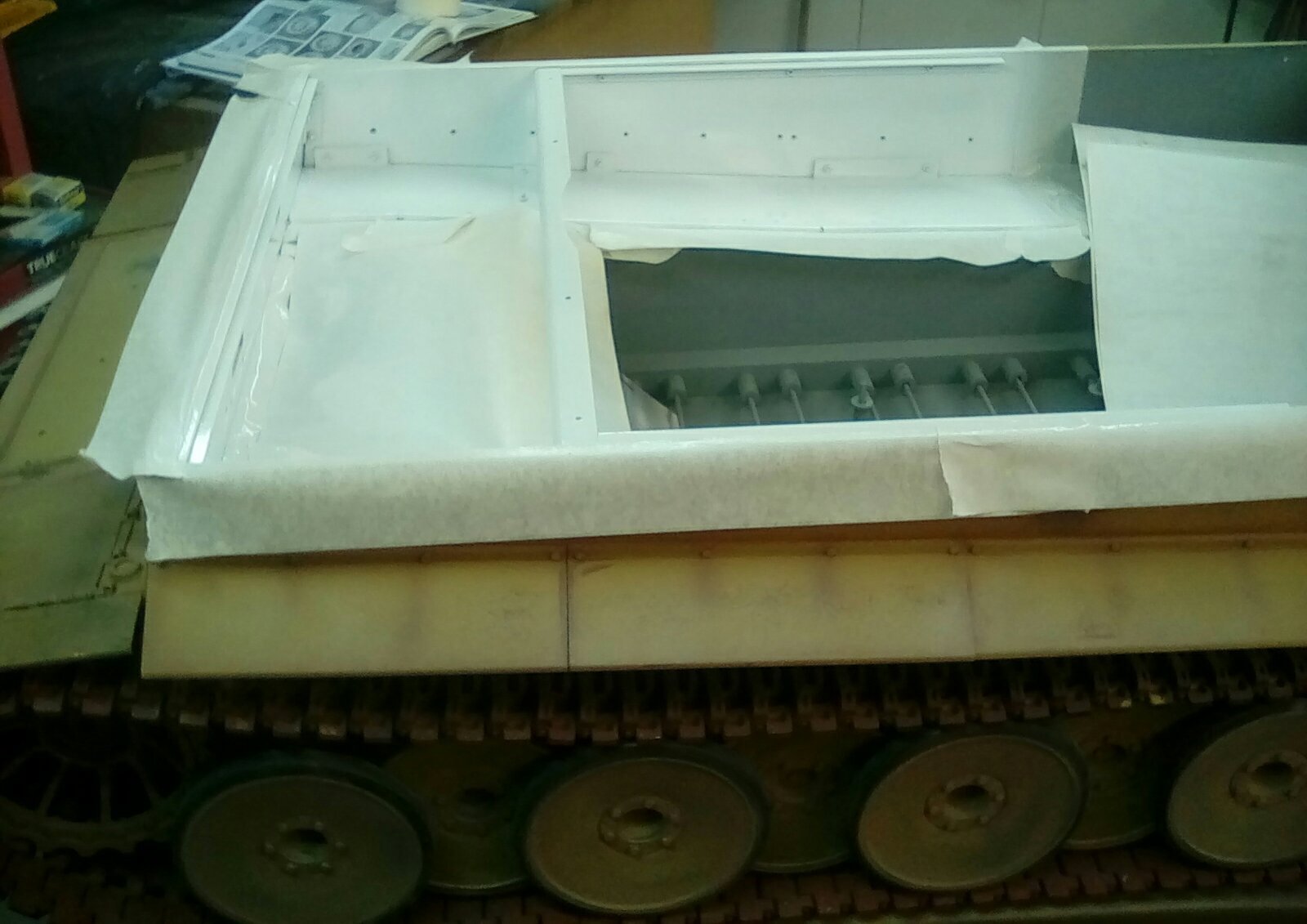

Cor its been a busy day in the workshop 8) Vince the feifel covers are printing away nicely and will take 12hrs to cook. 8)

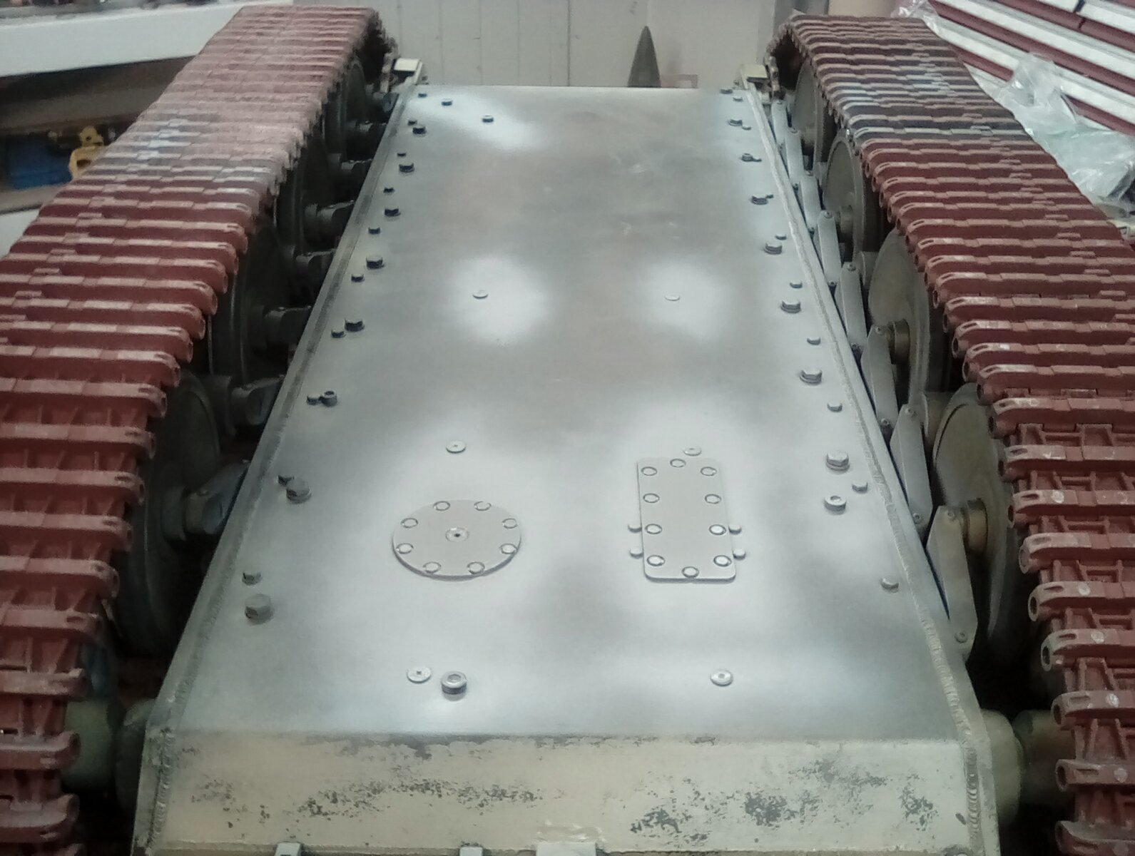

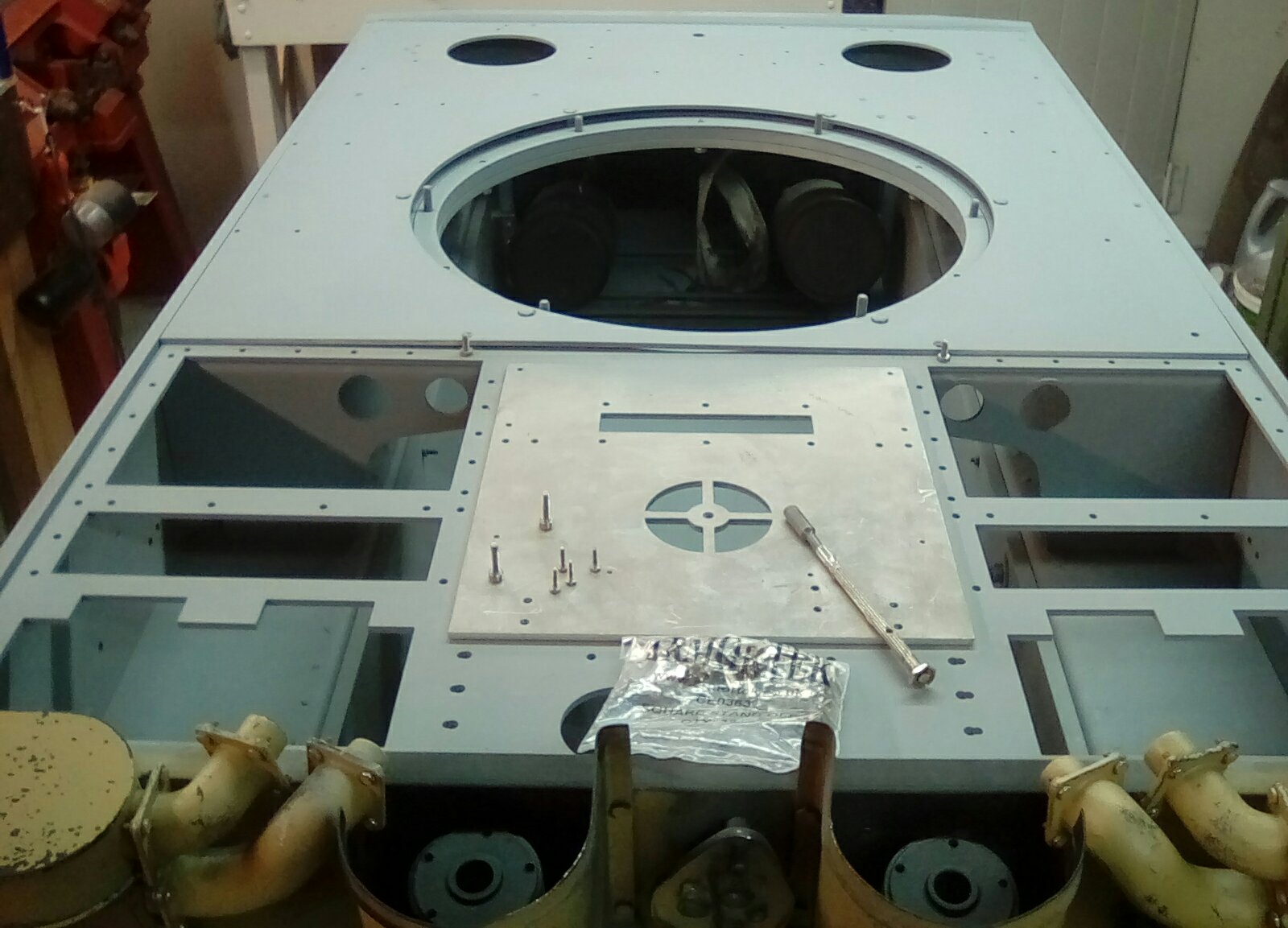

Made and fitted the hull engine access covers
Made and fitted the drain plugs, you may notice all the big hex bolts, I won't compromise with these as keeping that aluminum hull along with the suspension mounting stiff is paramount, so I just live with it.

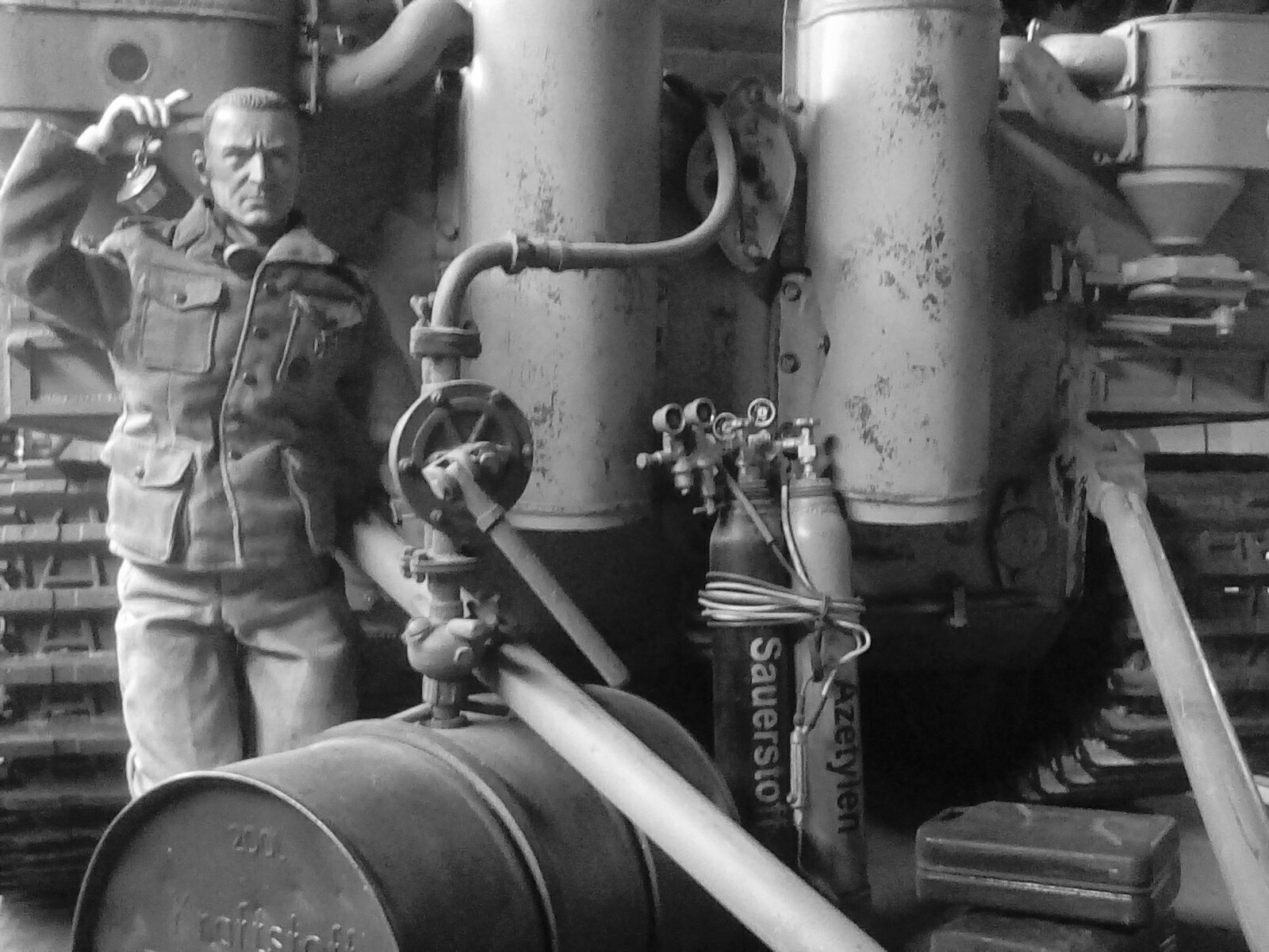

Nice and oily and grotty just like the thing was in service.

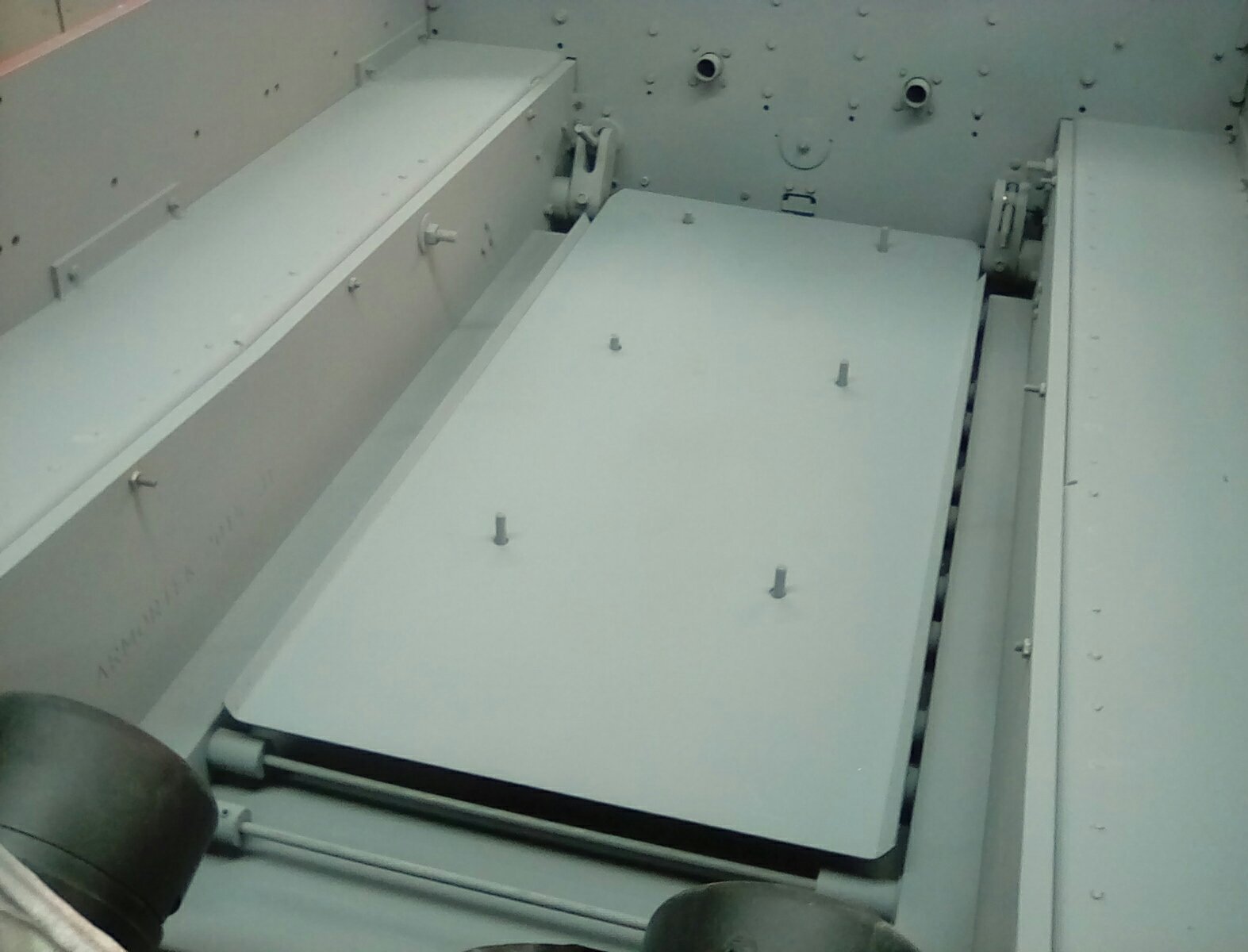

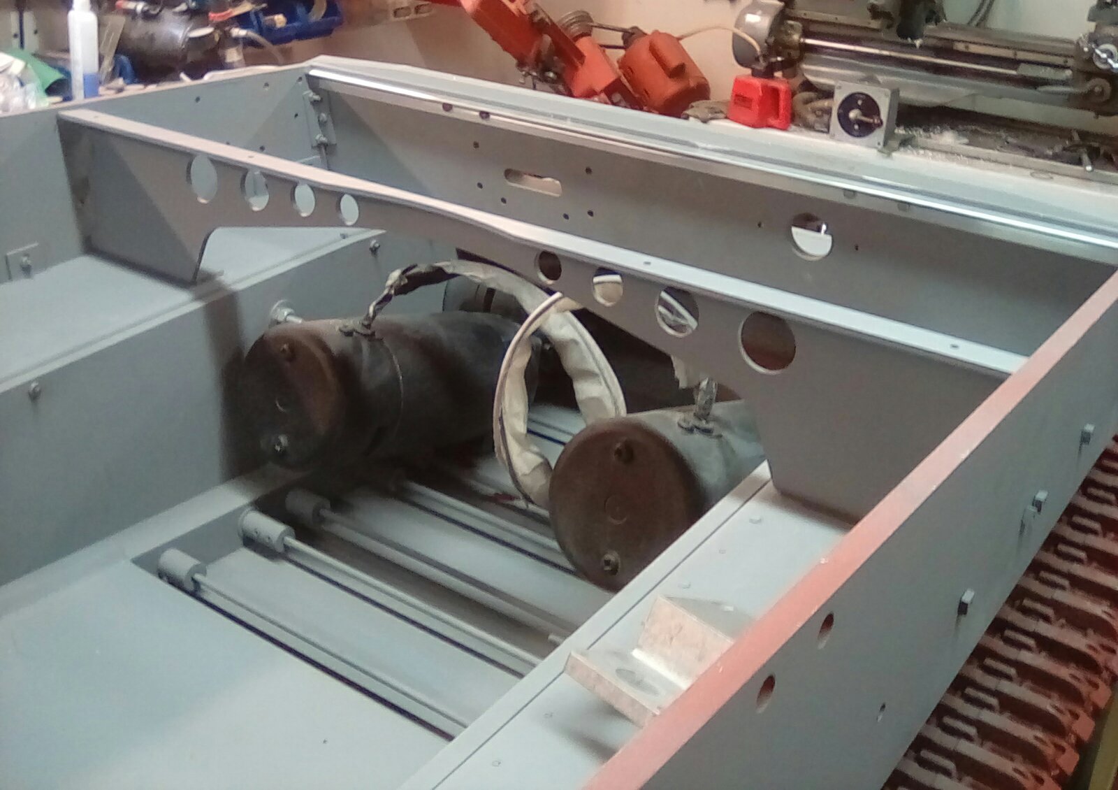

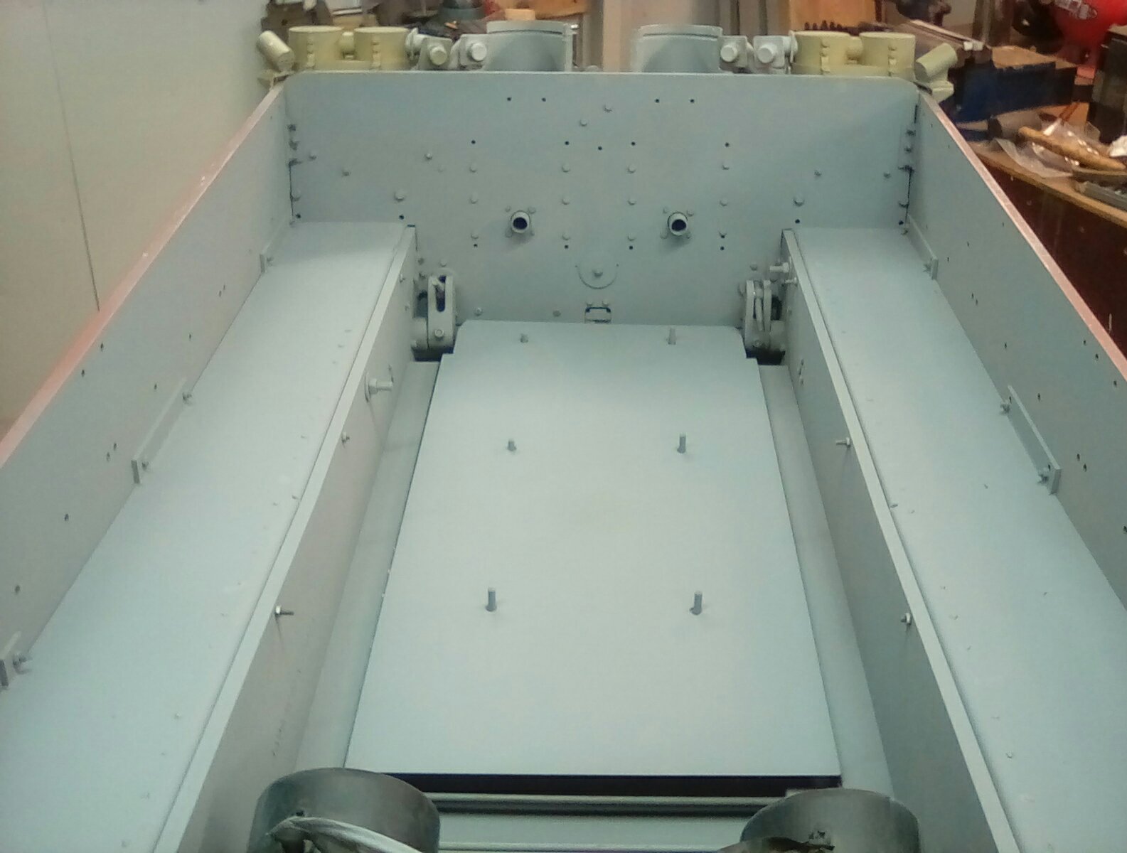

The battery tray mounts all ready.
The bespoke battery tray before the sides are bent up.
Nice and big for all the internal gubinz to sit on.

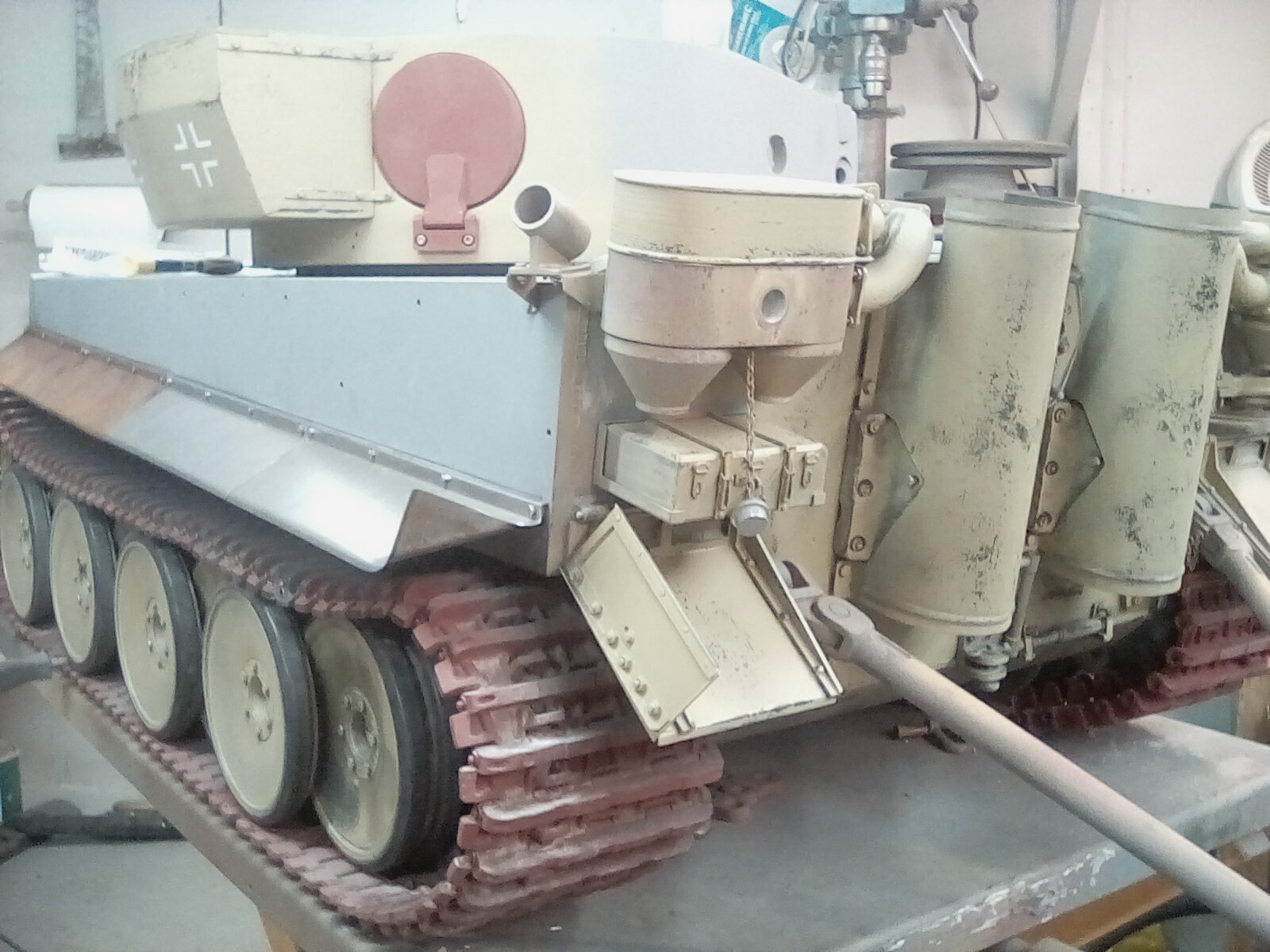

I'm having the afternoon off but have got a fair bit done this morning, as for the rear end of the tiger, well that's just about finished. I still have weathering like scratches, dents, small arms damage, soot, oil, rust, mud and dust to add but that will evolve as I go. 8)
The cover was a perfect fit Vince!
Now the feifels look the part.
Was really worried about that hole.

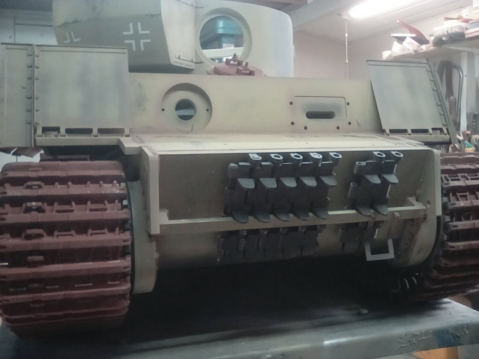

Interesting spare link arrangement on the side of the turret!
Posts: 4279
Has liked: 2280 times
Been liked: 7192 times
Re: Early or mid ? Tiger 1 build by Phil Woollard
You are quite right Christoffer, I've never seen the spare track links stowed in that fashion before. 8)

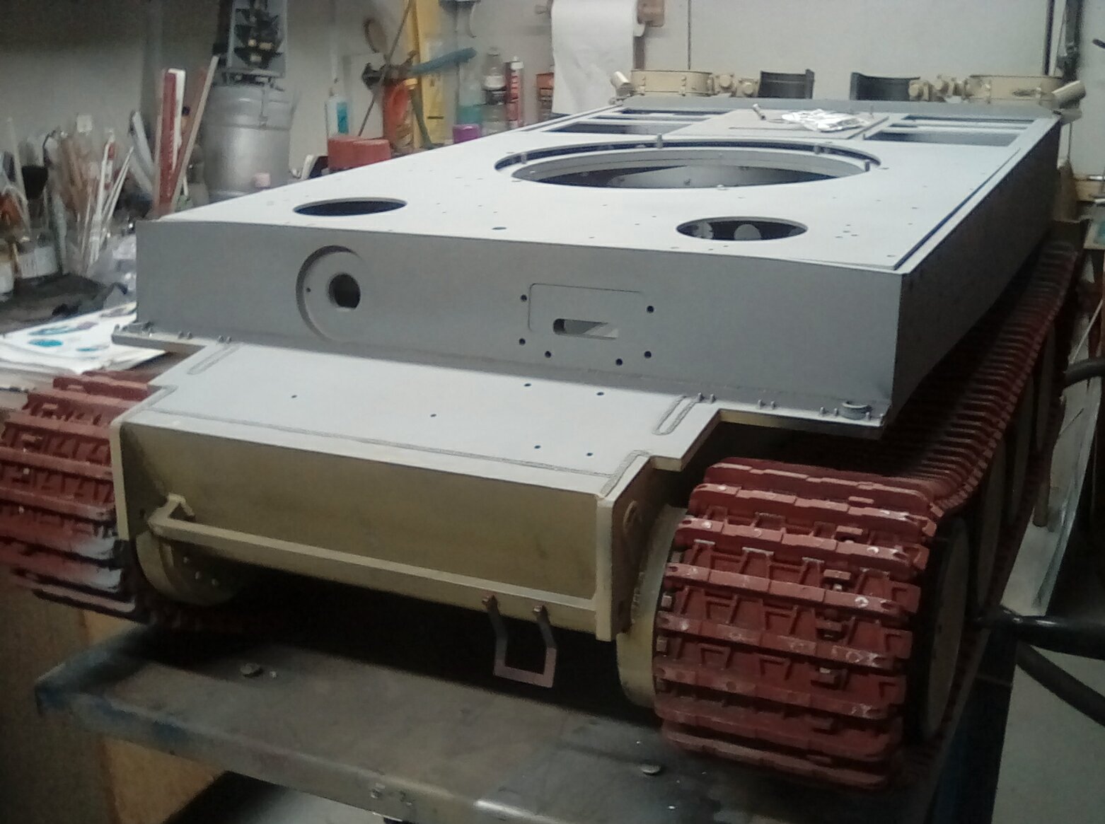

Getting on with it. 8)

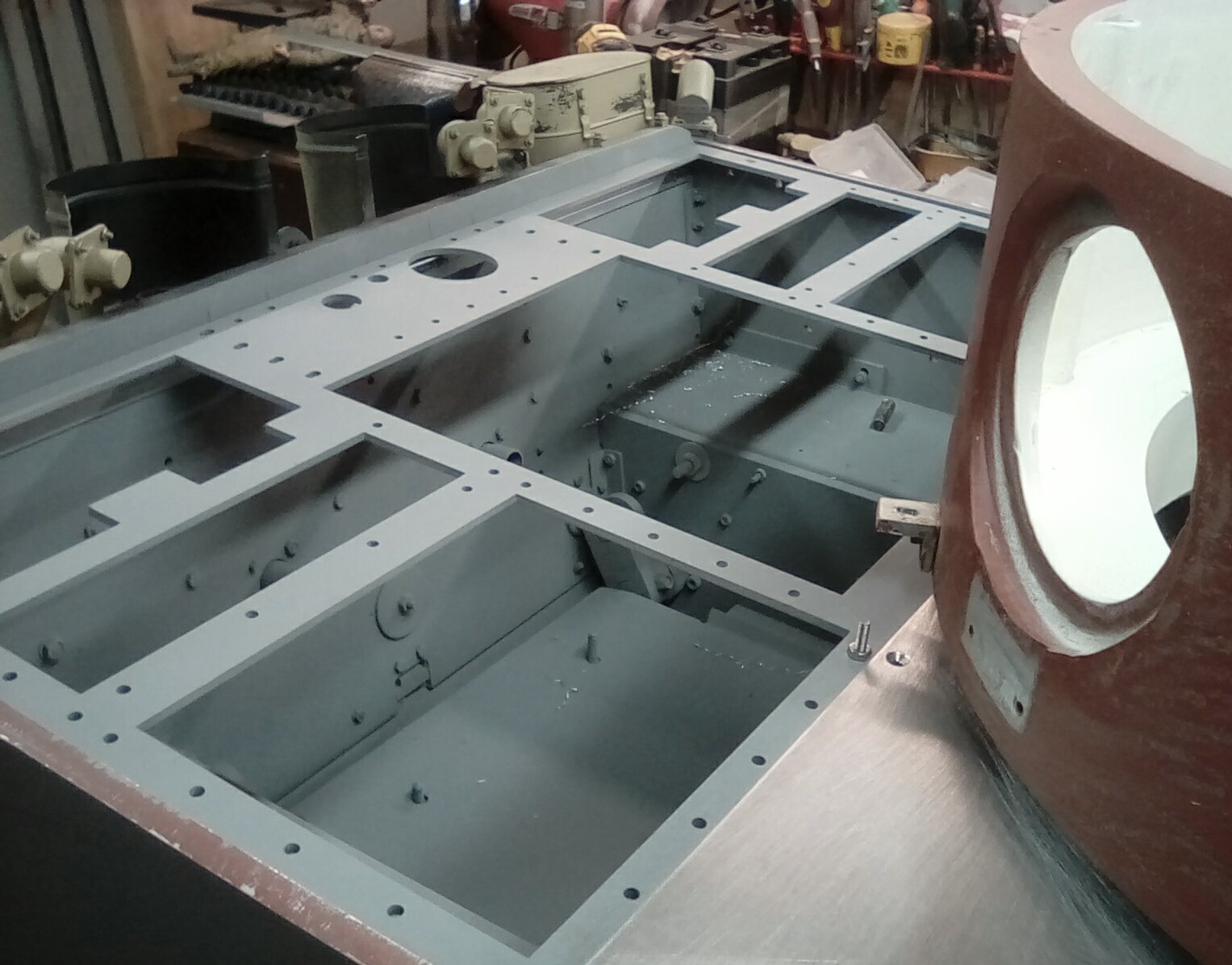

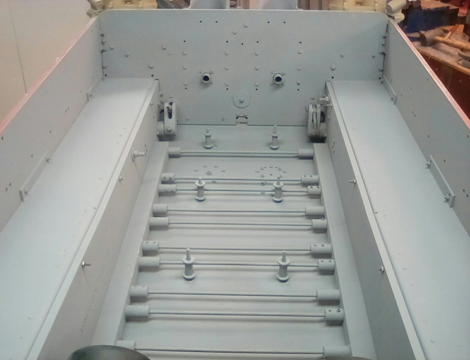

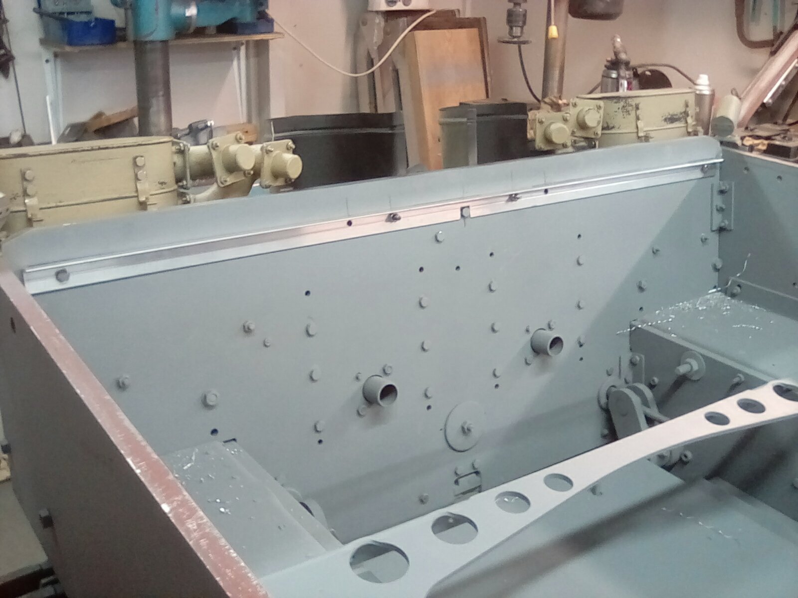

Continuous hull supports all the way around.
Forward bulkhead and the continuous hull support.

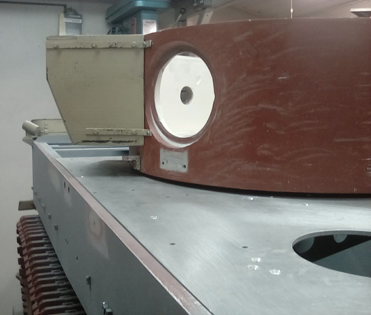

I'm using one of the heavy cast turrets, why, because I have several in stock.
Test fitting everything and fetling  as I go.
Love that look.
Love that look.
Thanks Bob!
Thanks Bob!

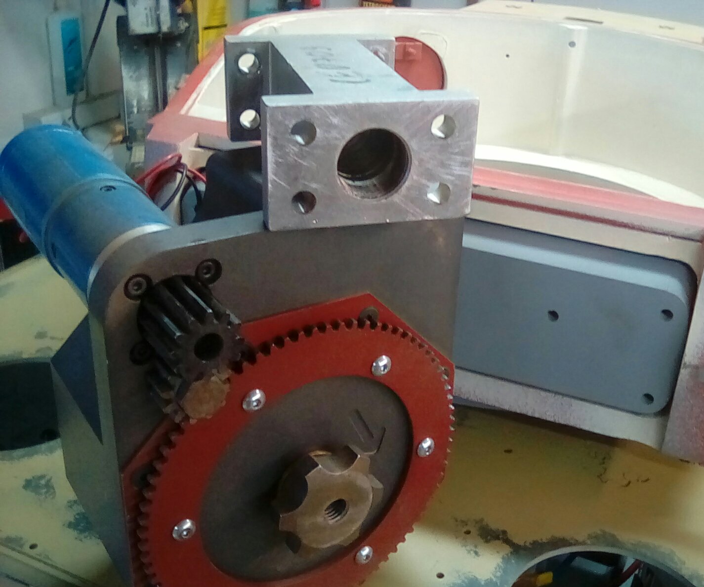

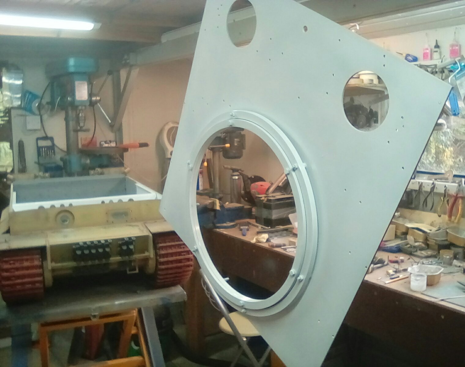

Although I'm fitting the one piece cast turret she still gets the lazy Susan bearing upgrade.

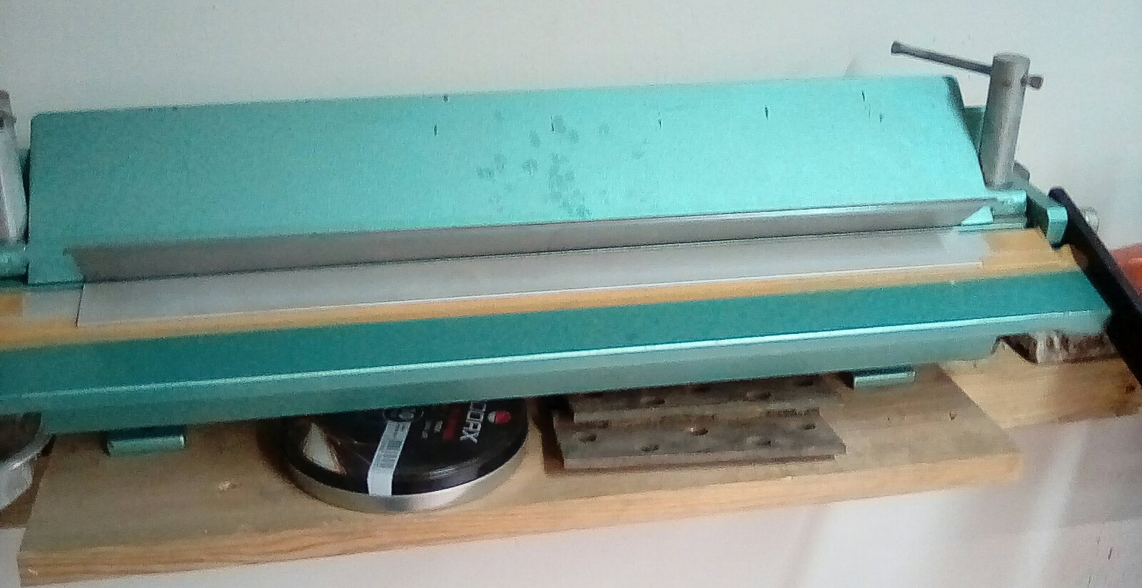

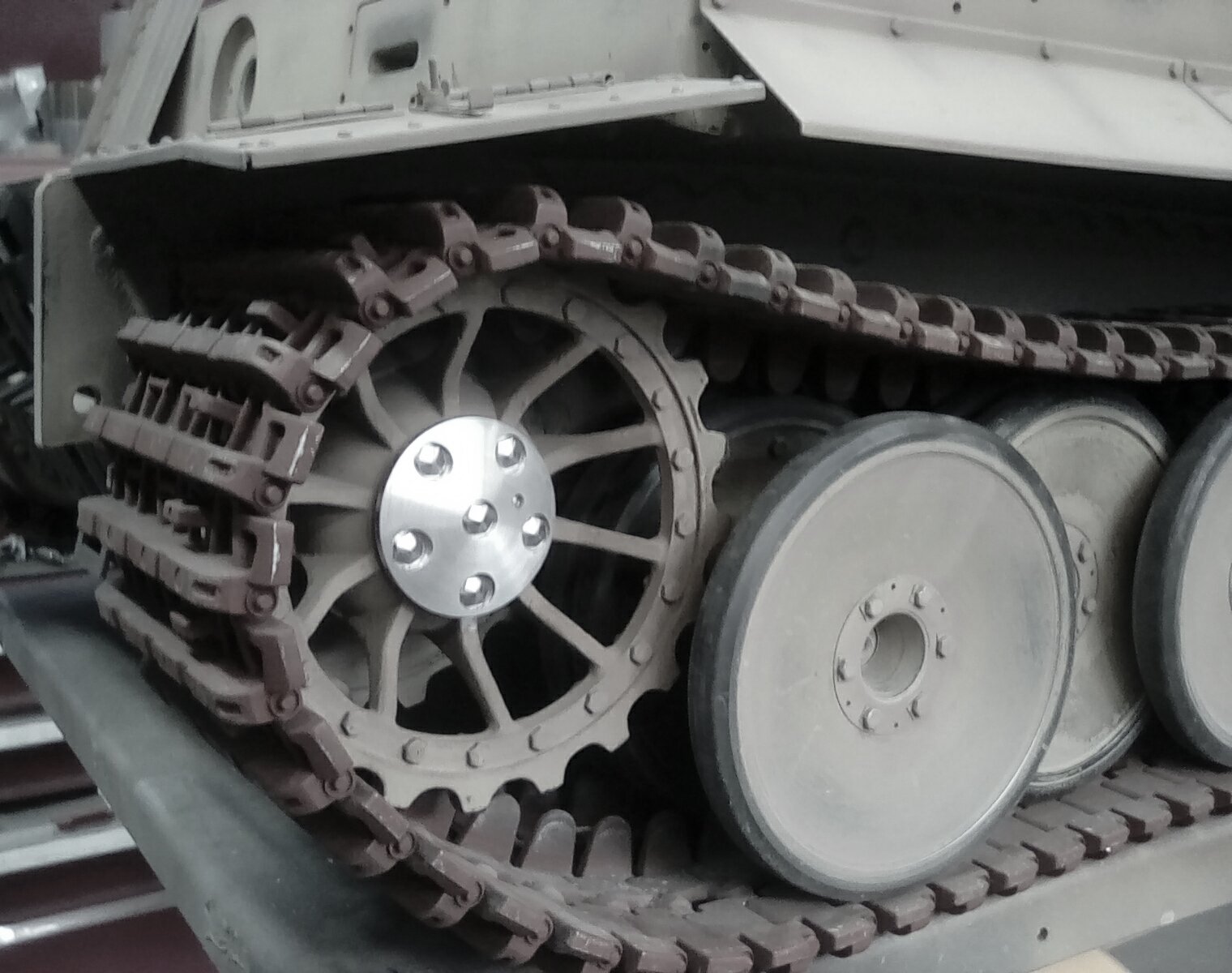

I folded the long fenders as one piece and then cut the pieces to length.
Folding the fenders from stock sheet, I used .75 gauge as opposed to the kit 1 mm stock as I want it to bend easily so I can replicate the damage on 331.
I think I need to make the end fillet supports although the early vehicles didn't have them.

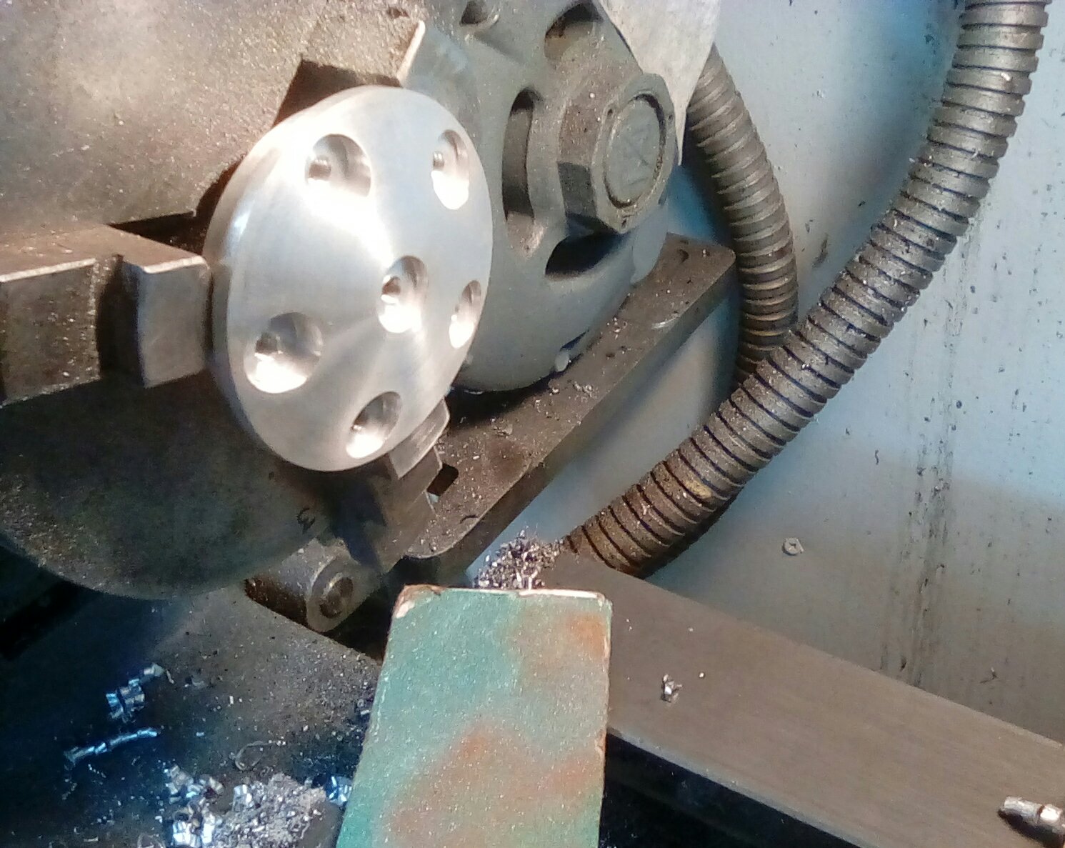

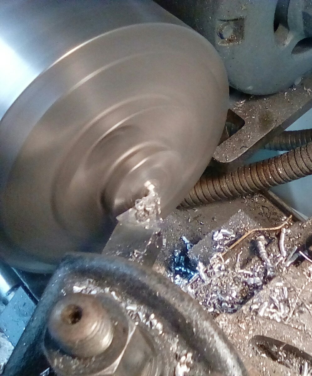

Turning up the reduced head fixings is a pain but what are you going to do!
Nice newly made long fenders.

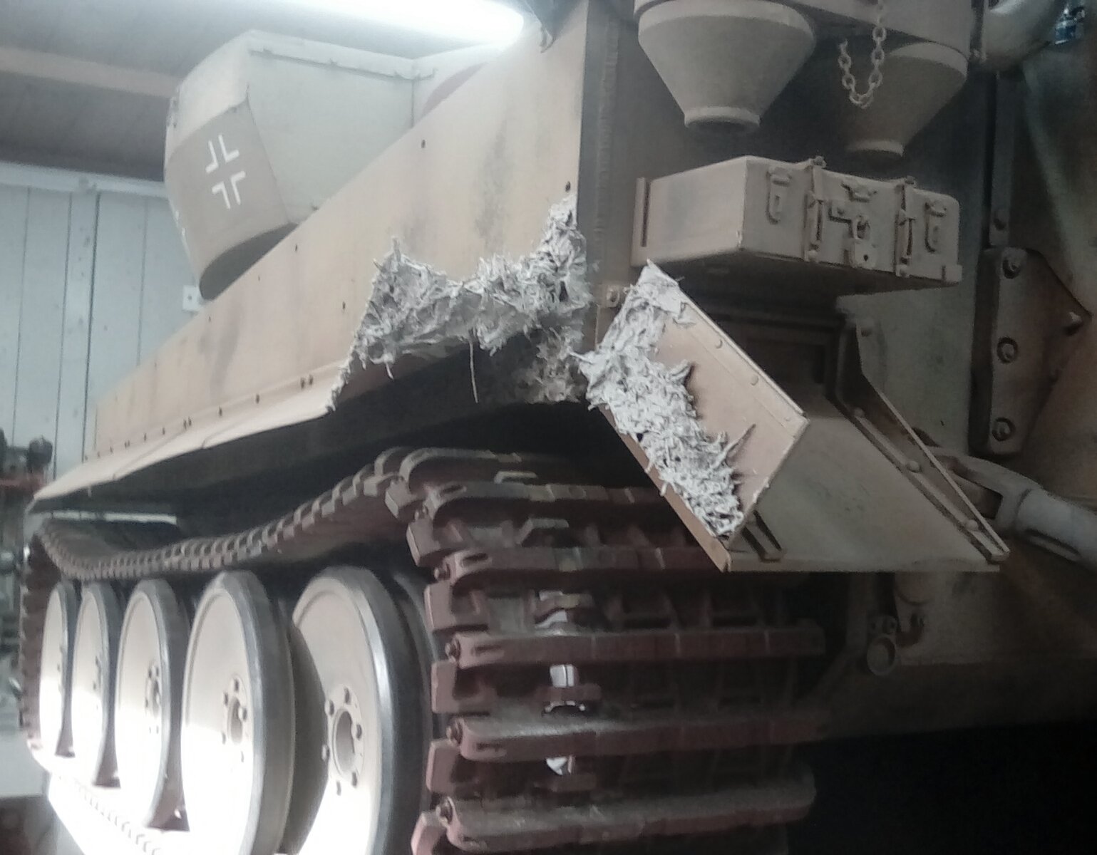

Trying to replicate the fender damage in a tasteful way as it could look total pants, I can just remove the outer rear fold up fender to get that look.

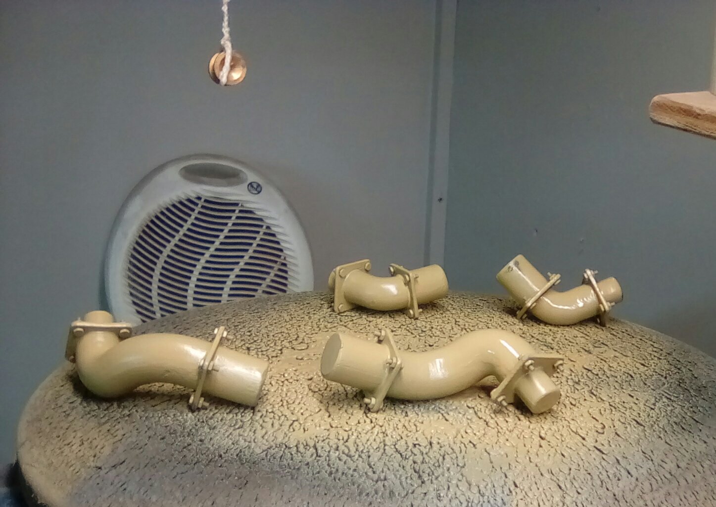

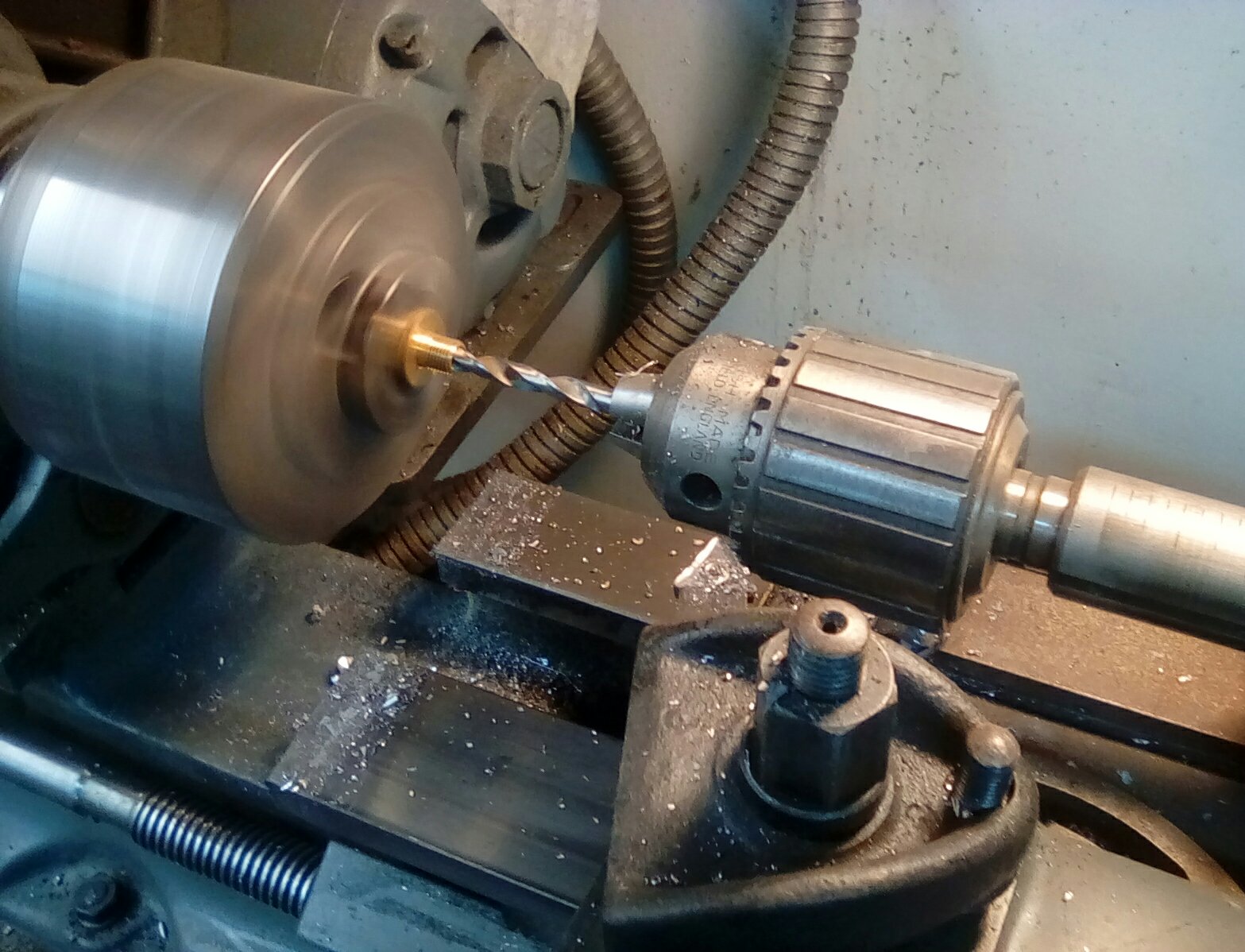

Drilled out the feifel pipework in case I want to display it without the flexible pipework.

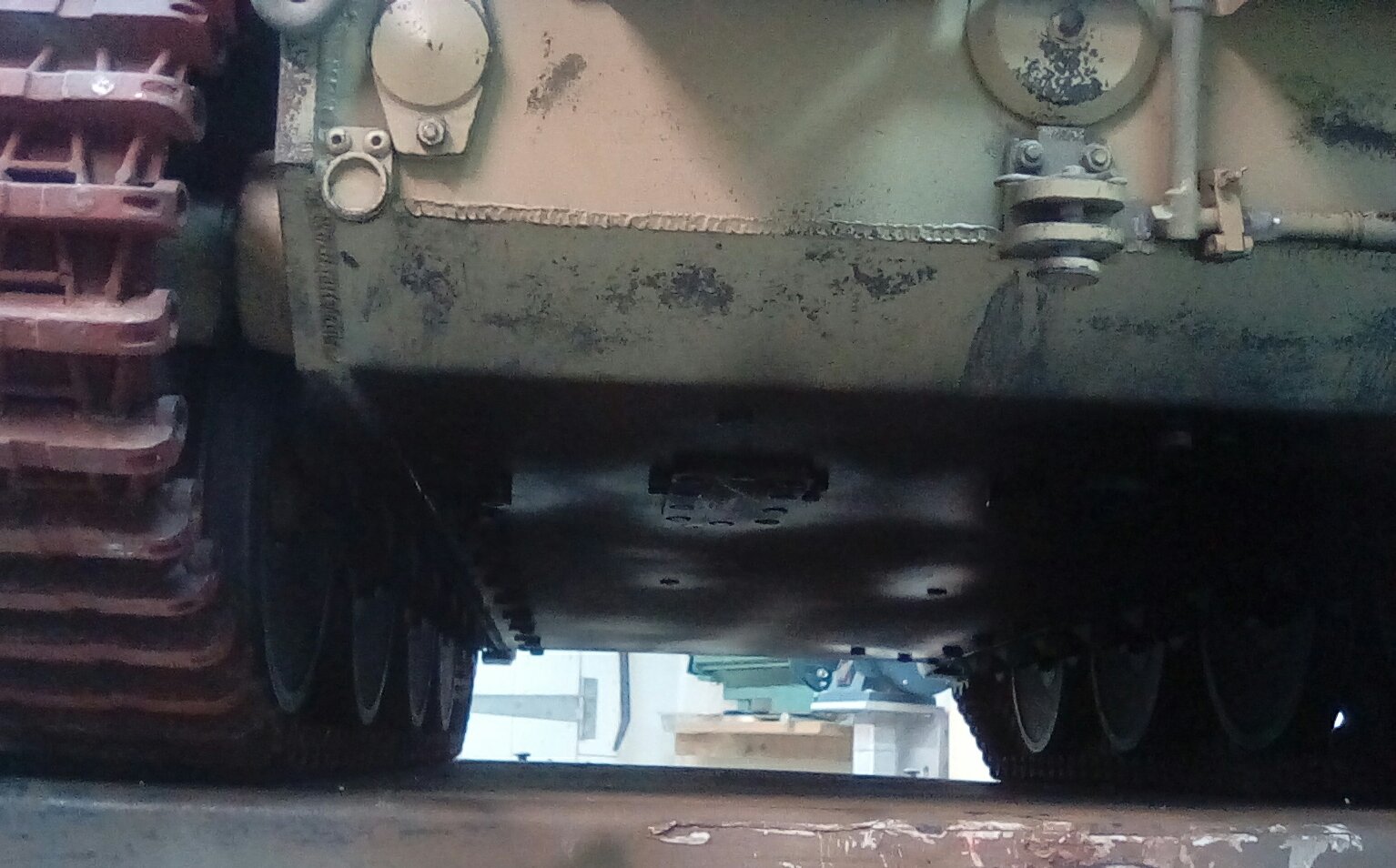

I'm having ago at all the mud that was deposited on the rear fender, this was probably due to a mine or a shell bending the fender or when the vehicle was bogged down and was pulled out squashing the rear fender against the track and deforming the side fender?

Better get the interior crew compartment paint out of the way now.
Just needs weathering.

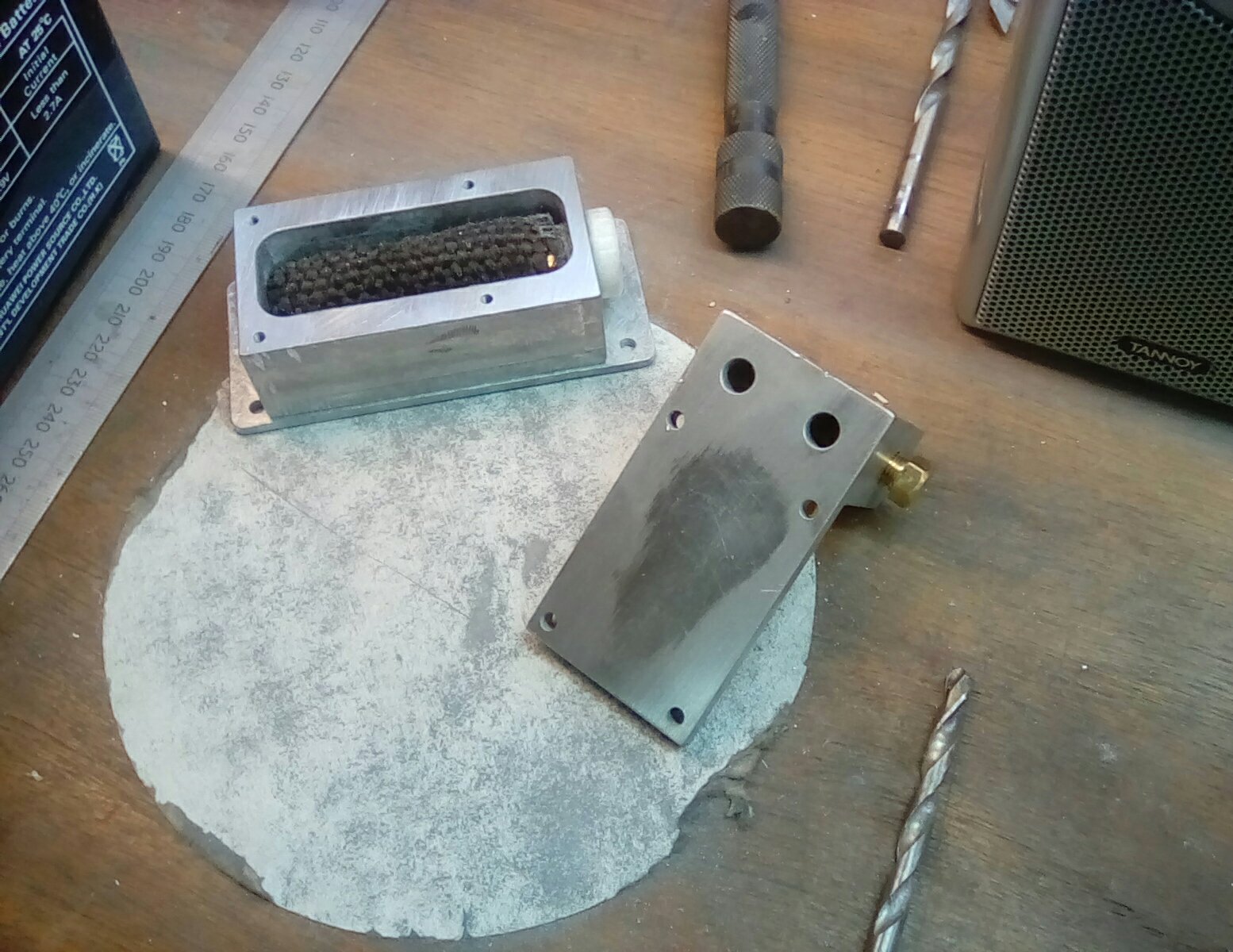

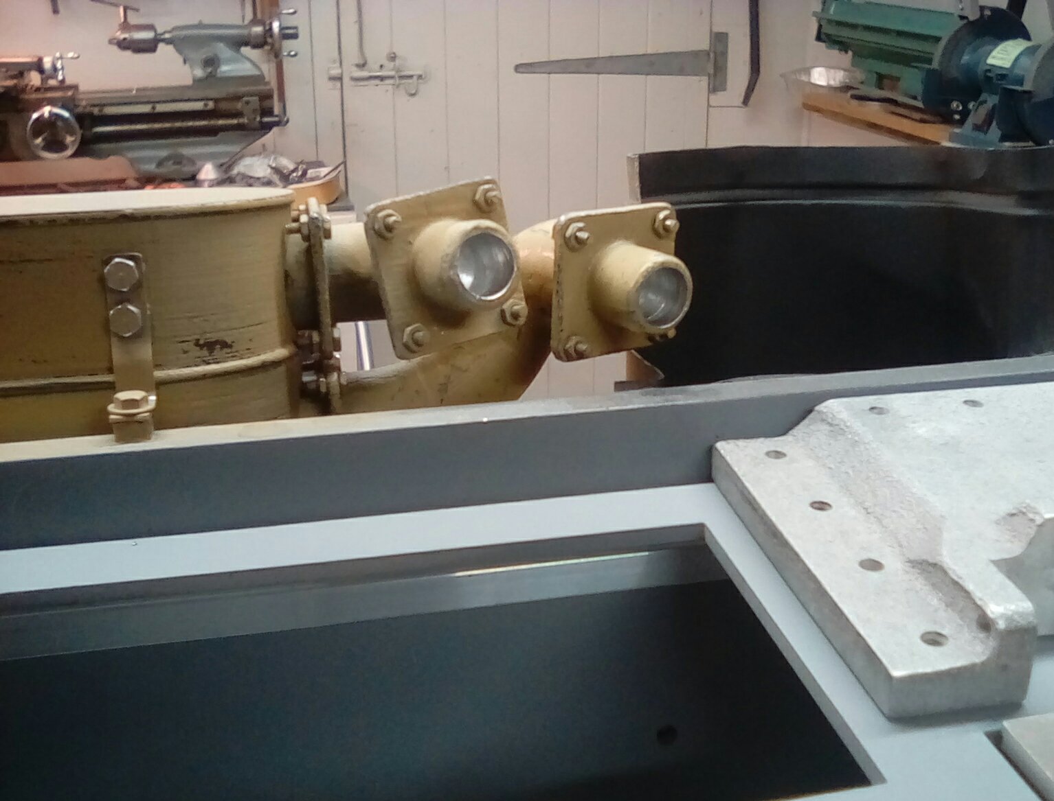

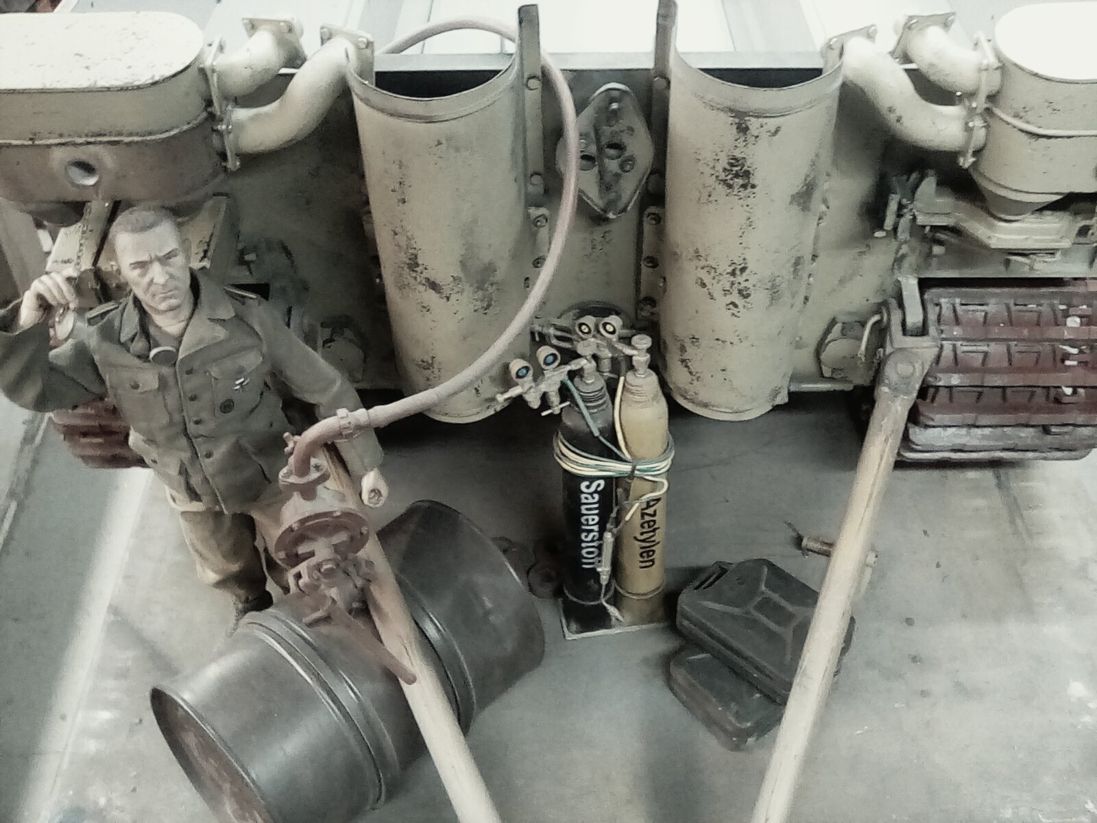

Whilst I'm waiting for parts from Armortek ( they are super busy with the stug and I keep adding more parts to my final parts list, sorry Monique), I've decided to get some of the motion installed and the high pressure smoker ready for its first outing with a Tiger1. 8)
Opening up the fittings where I can.
Lapping all the joints for a very necessary perfect seal.
I'm not going into detail but the standard smoker needs lots of modifications so I will leave this photo fuzzy.

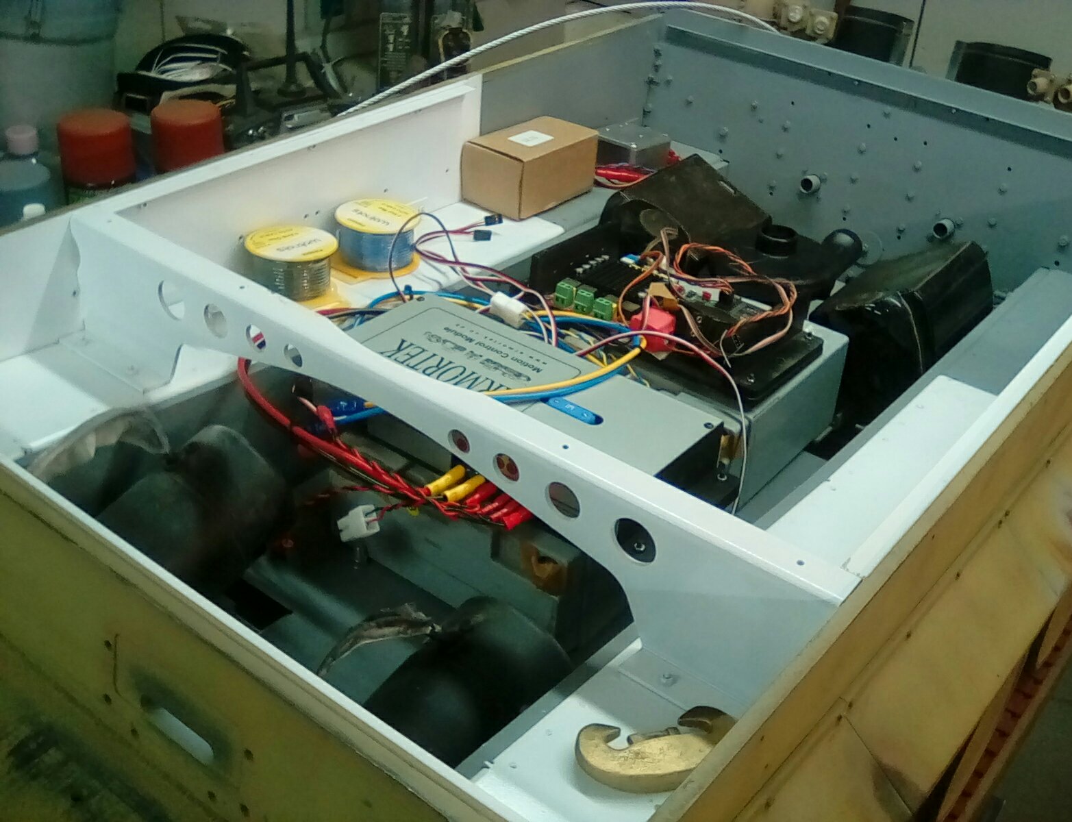

Finding a place for everything, this tiger is going to be about the outside detail and not so much the inside detail.

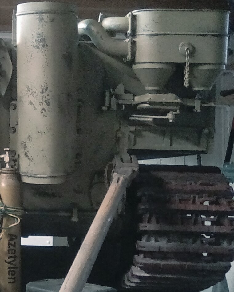

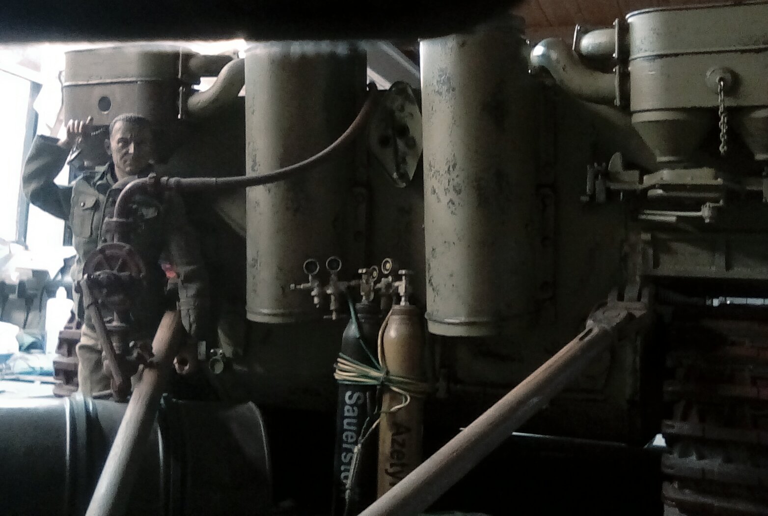

Each exhaust stack has its own outlet as the engine was basically two engines being a v12, this often producing very different smoke signatures for each stack, all will become clear later.

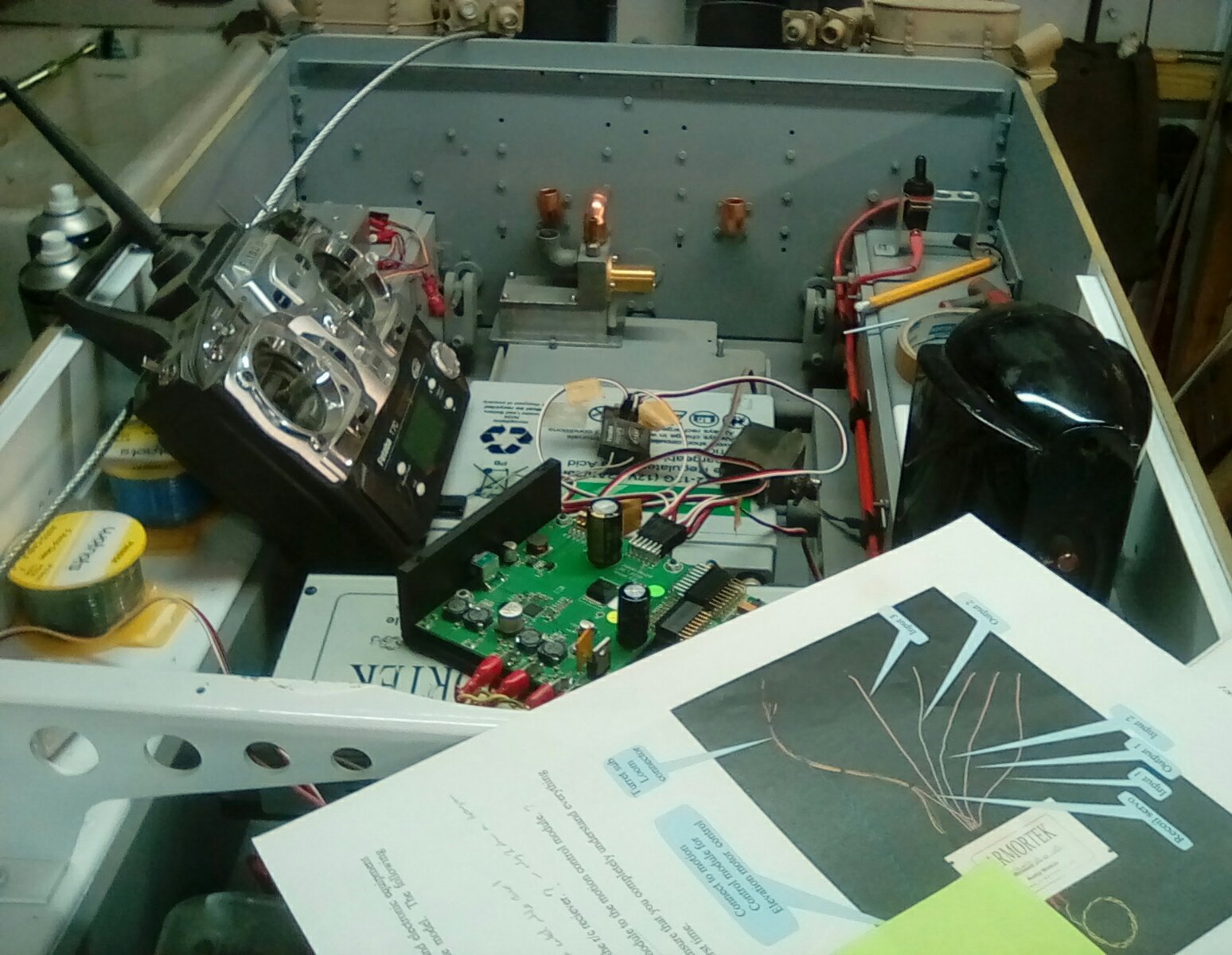

She runs, I'm experimenting with different sound cards.

Phil Young
Posts: 78
Joined: Wed Jun 27, 2018 8:55 am
Location: Gloucestershire
Has liked: 40 times
Been liked: 59 times
Post by Phil Young »
Hi Phil,
I’m following your smoker unit “mods” with interest. I did a lot of work on mine.... opening the bore of the outlet adaptors, aligning the ports and “gas flowing” them, if you know what I mean?
The results are quite impressive, the increase in flow resulting in a “proper job” smoke screen! In fact I think just one smoke unit in my KT would now suffice!
Phil.

Hi Phil, you keep going as there's so much to it. More smoke is not the object, two smokers are not the solution as you have found out!
8)

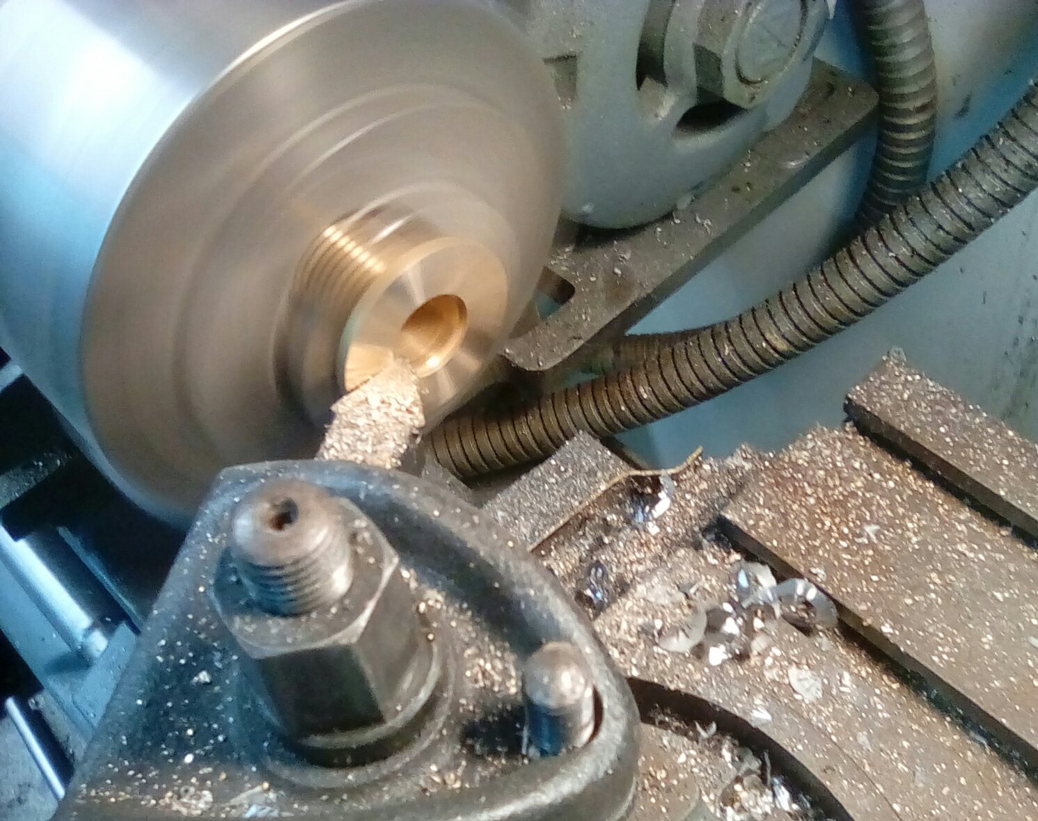

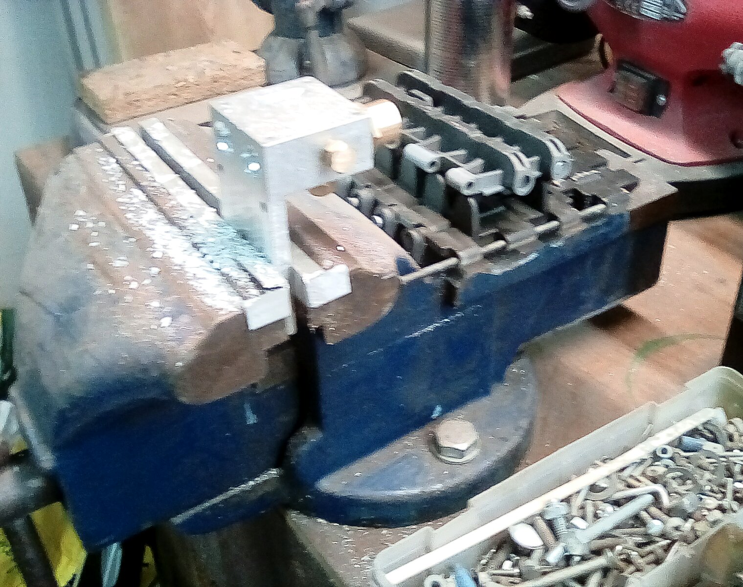

Would any of you lovely people out there have the double threaded pipe fitting that goes between the firing device and connects to the barrel they could sell me? it's just basically a piece of pipe. I could turn one up but would rather have the original for safety reasons. 8)
Now I have a good reason to use the firing device, number one I have a licence for this kind of thing, and number two I have been asked by a certain book author to provide photos of a early Tiger1 firing, so as I designed the thing I felt I should use it! I don't recommend you guys using it as it has had issues in the past, this due to incorrect maintenance and possibly incorrect blanks being used.
Early days.
Early days.
It screws into the square piece and then into the barrel.
