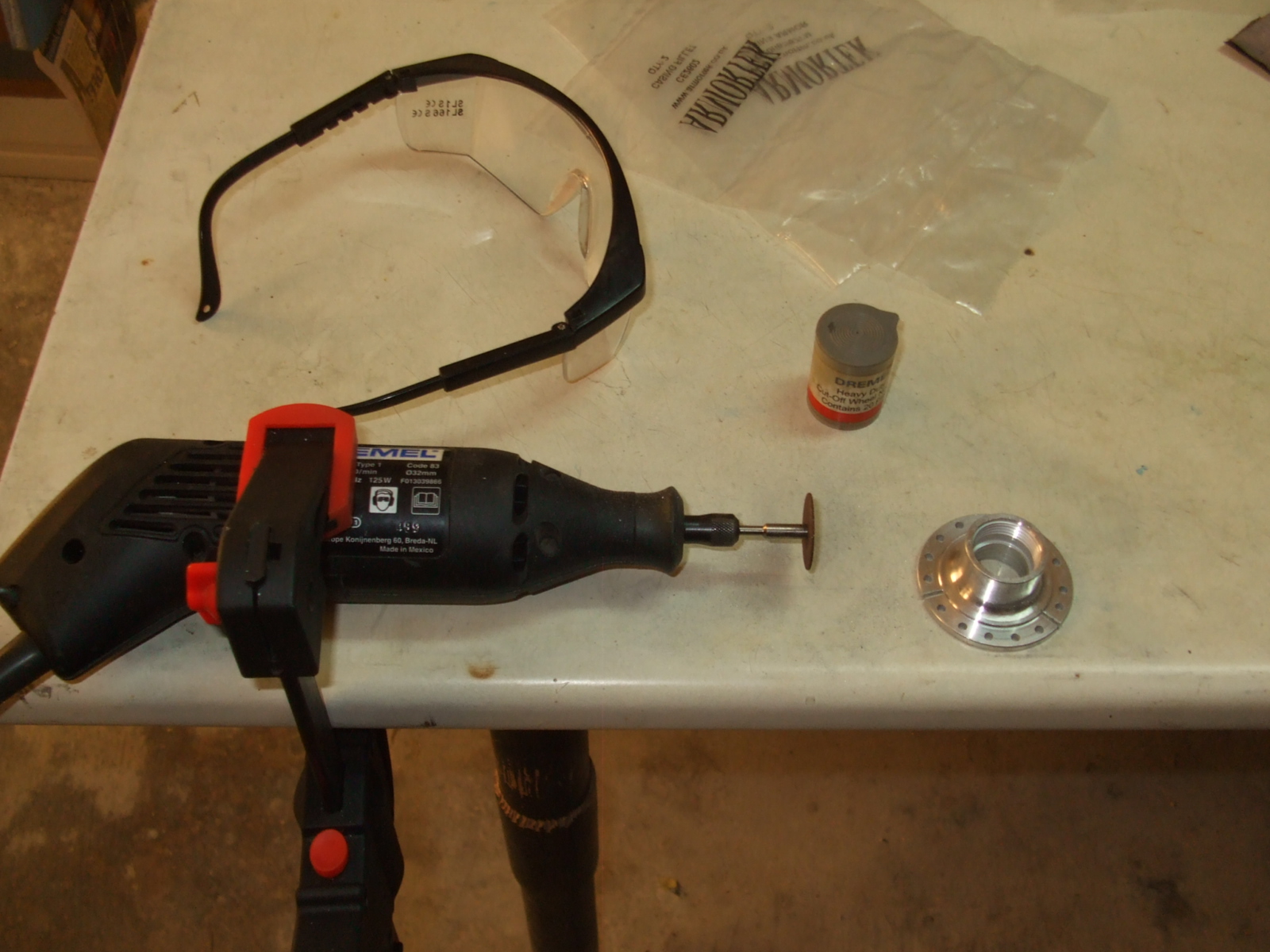

Decided to cut the slots in the hub caps after all. It took me more time to think of how to do it then actually doing them. Used a hacksaw to initially cut the slot and then used a Dremel with a heavy duty cut-off wheel to open the hacksaw cut a little, clean it up and straighten any wobbly hacksaw cuts.
Dremel clamped to table

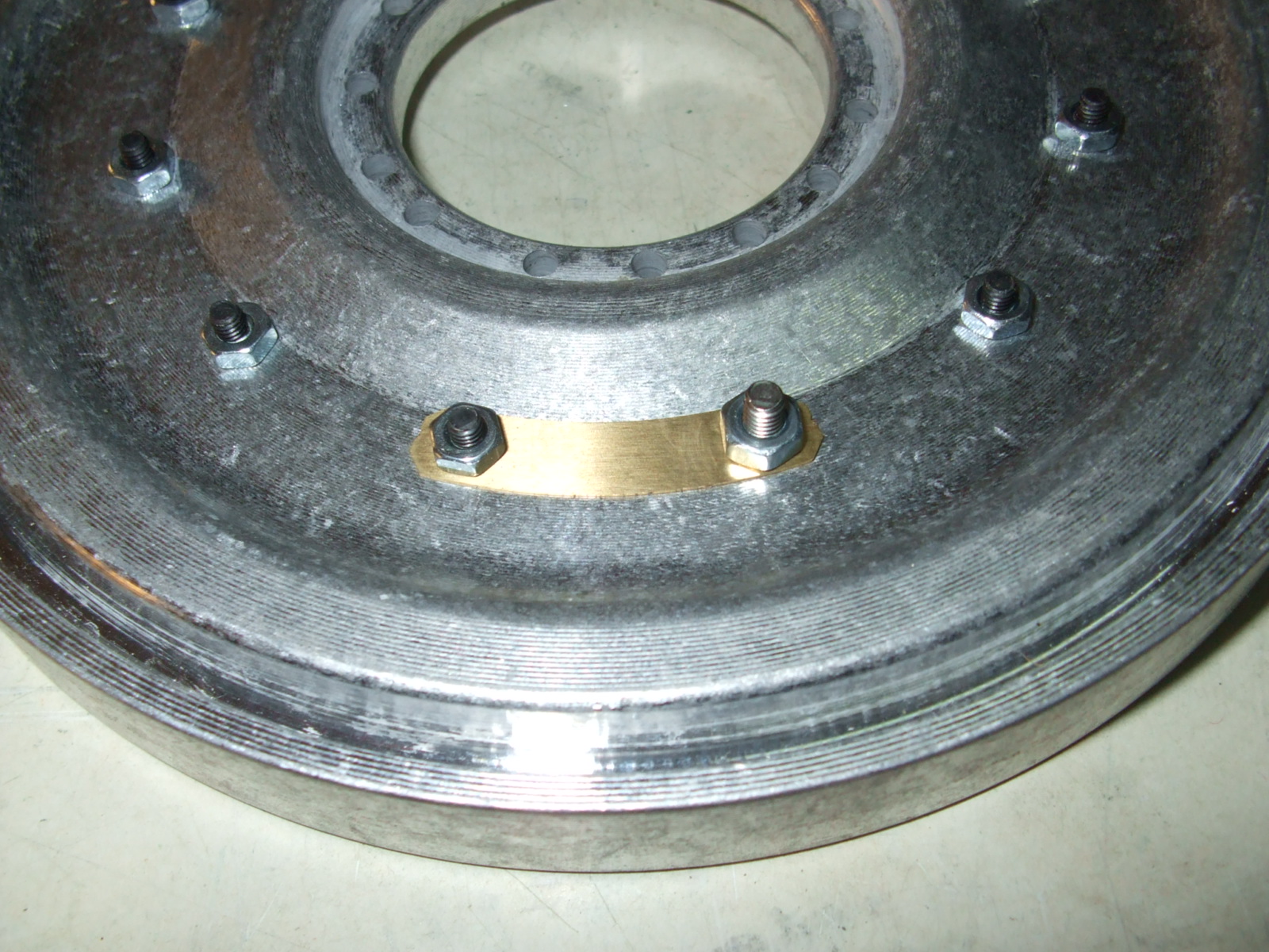

Removed the machining marks on the hub covers and did an experiment with one of the road wheels. Yesterday, looking at a photo of a steel road wheel I noticed that the nuts used over the locking tabs look slightly larger than the nuts used on the hub. At first I thought of using one size smaller hardware on the hubs but I think then they will look too small (plus being a costly exercise). So then I thought, how about increasing the size of the hardware which has the locking tabs from 2.5mm to 3mm?
Right hardware is 3mm
Obviously, this means opening up all the holes in the wheel and tabs to accommodate the 3mm hardware. I was more concerned in opening up the holes in the thin brass tabs. For this I used a tapered 3mm round needle file. I think I will use this solution unless somebody tells me that I am wrong and all the nuts on the road wheel are the same.

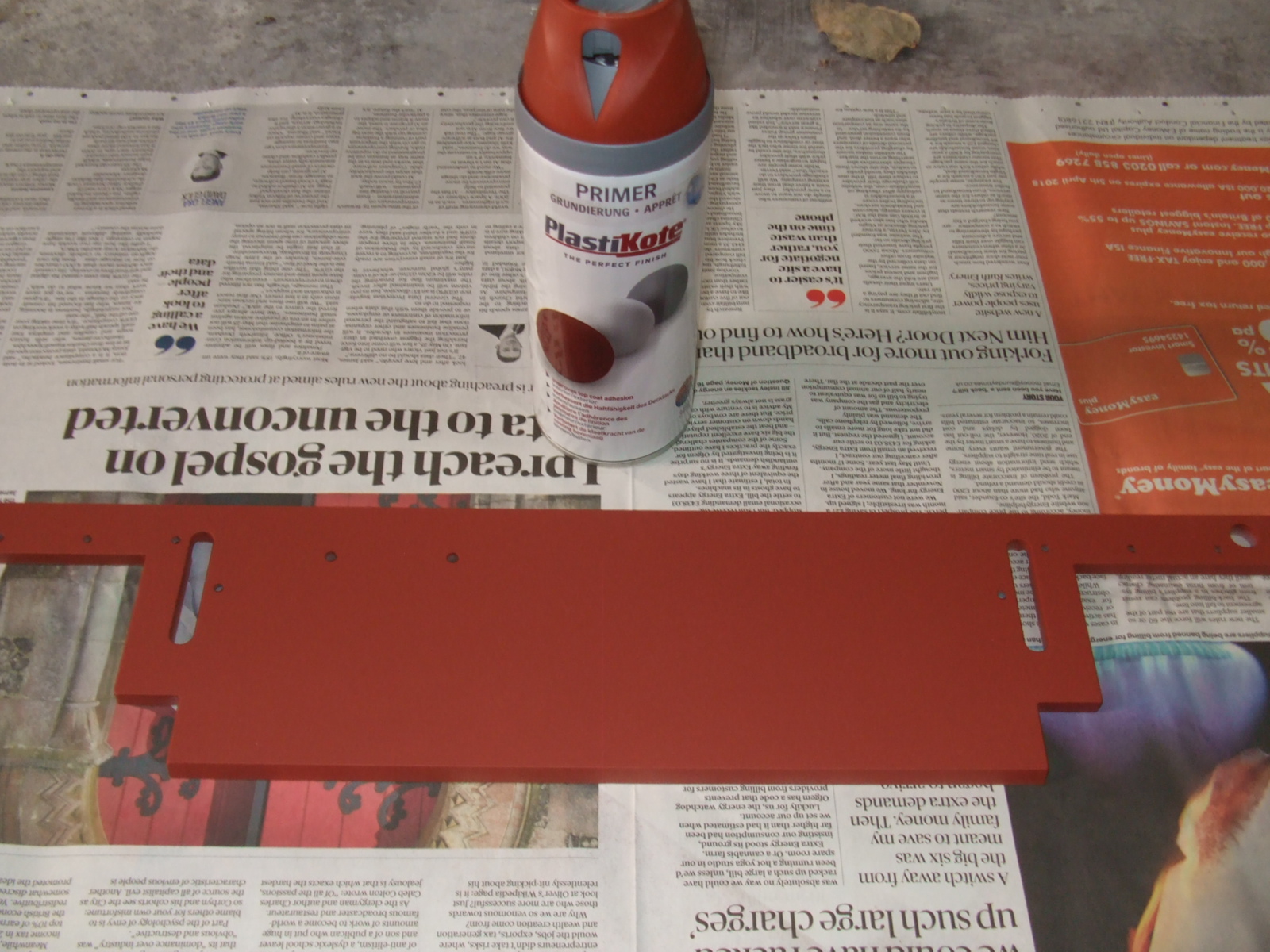

Also, a couple of days ago, I got a can of reddish primer to experiment with. At first I was going to spray the floor of the hull with it to see how it looks, but then used another smaller part of the model which was already etch primed as well.
How does it look?

That's the Johnson Vince, :) they were all painted in red oxide of varying shades inside and out and yours looks very good indeed. Will you paint the outside in red oxide also ready for the weathering of the top coat? ......Regards Phil.

Actually Phil, I was going to spray the red primer over the etch primer on the outside only. Not bothering with the red primer on the inside. Weathering? Well that's another story. Never done it before so I doubt I will risk it on such an expensive model. I was thinking that my Tiger just came off the production line.
How about the difference in size of the road wheel nuts? Are my eyes deceiving me?

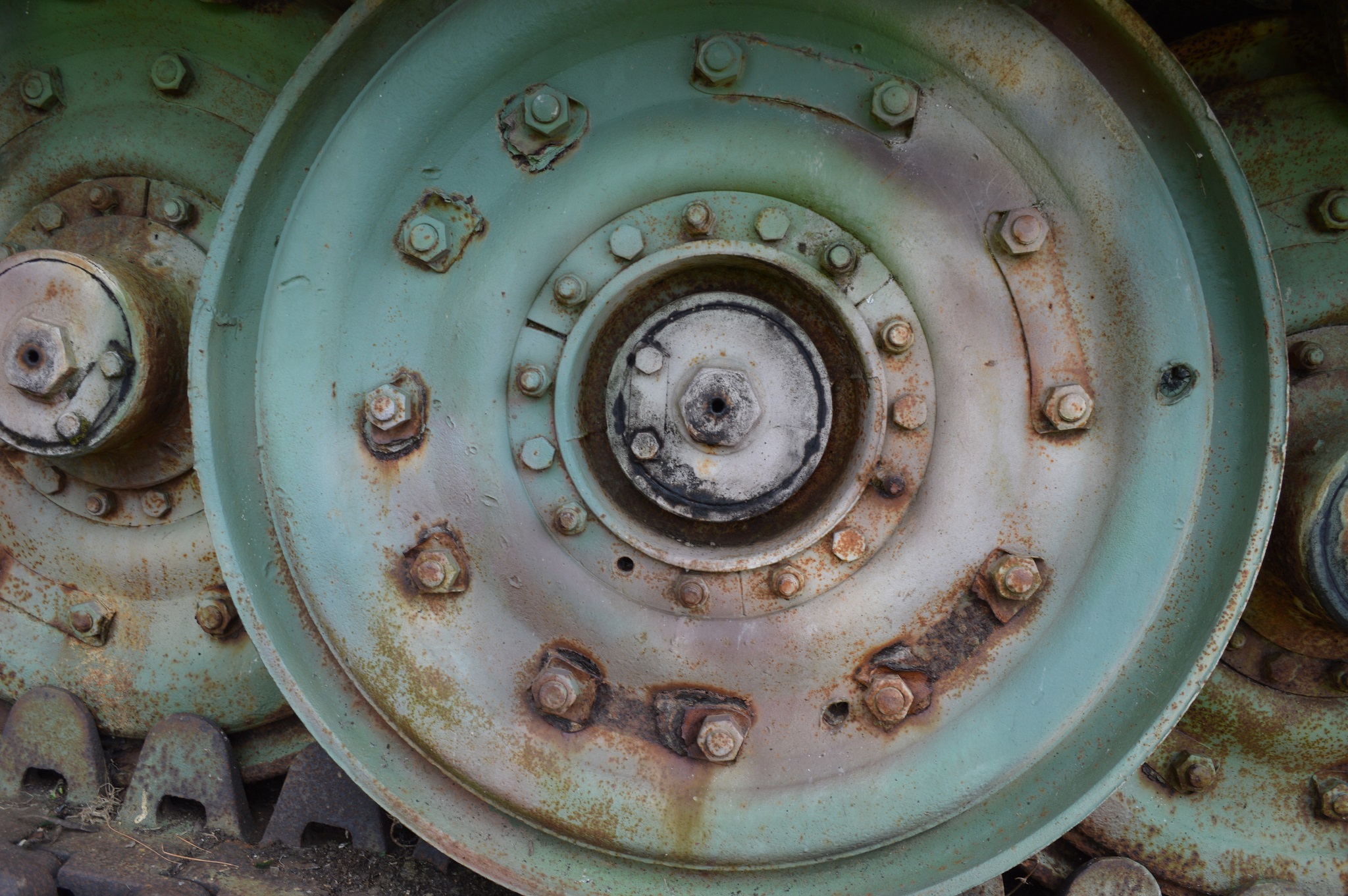

Re the steel roadwheel nuts, yes, definitely a difference in size. Obvious in these photos (King Tiger, Bovington, same wheel as Tiger):

The 1/1 Vit Tiger late road wheel nuts are defo larger on the wheels compared to the hub assemblies ...Phil.

Thanks Adrian. The size of the nuts are different.

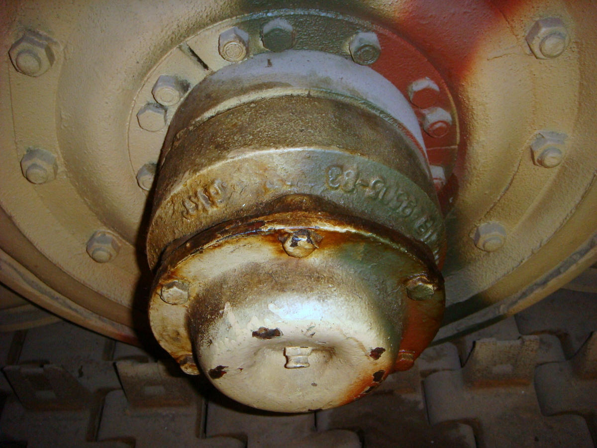

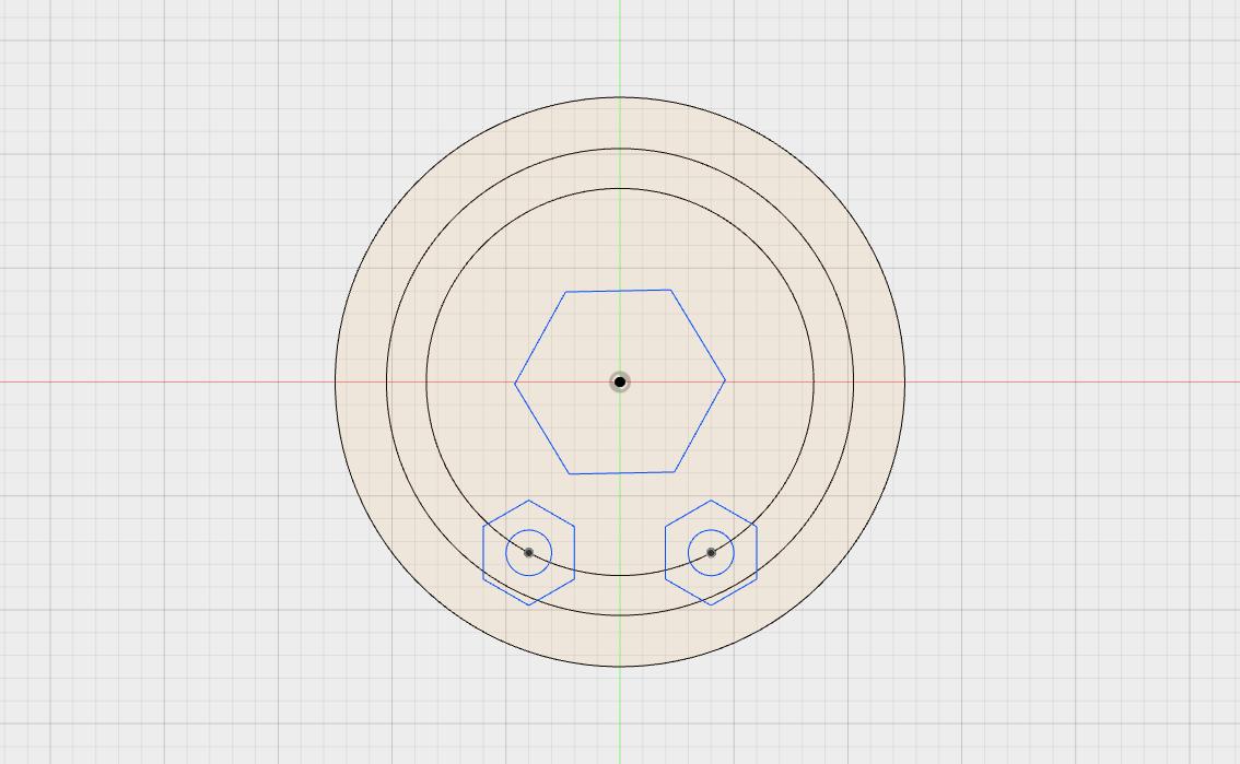

Yesterday I drew in CAD the hub cap cover so that I could draw the position of the two small bolts.
At first I was going to machine a template from the drawing so that I could drill the holes but then I remembered that I can actually find out the X and Y co-ordinates of the location of the bolts from the CAD drawing. And that's what I did this morning. Having a DRO on the milling machine made life easy to locate the positions on the actual cover. At first I was going to just drill holes with the intention of later on gluing the bolts in the holes but at the last moment drilled and tapped for the bolts.
I also added what might be a grease nipple to the centre of the cover. How does it look?
Does anybody know of where I could make a small batch of photo-etched brass tabs for these two bolts?
