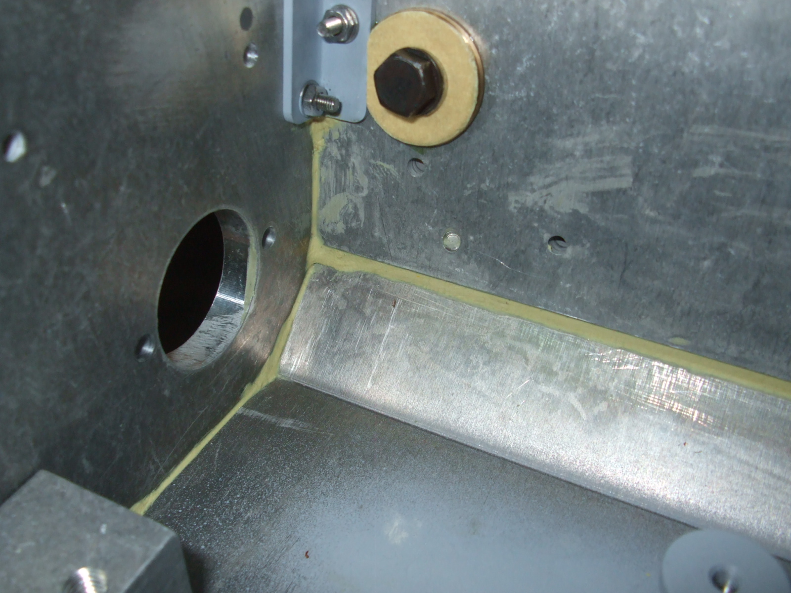

Finally had some time to play with Milliput. As this was the first time using this product, I thought I would do something easy first. So I filled some straight gaps on the inside of the lower hull.
Managed to get the hang of it. Also glued the idler tension cups to the rear plate. Masked them also as I will be etch priming the inside of the lower hull.

Looking good Vince, I find a good quality semi stiff makeup brush about 8 to 10mm head helps when placing the Milliput rolls into position. Use it like another non sticky finger, just keep it wet and use it to push the Milliput into the joint, then more water to smooth out but remember the Milliput sausage will stretch as you apply pressure, so start at one end and expect it to get a little longer!
Then when your happy with the thickness and evenness (trim the edges with a steel rule) press your weld pattern tool ( Allen wrench, small tube, that makeup brush handle tip) into the material and "bobs your uncle" a weld is made.

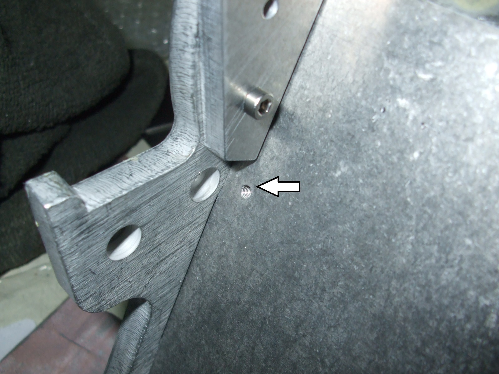

As I had some spare time to play about started re-profiling the casing fillets (CE2602) to make them look like the originals. I got the idea from a forum post but can't remember who it was that did the post (maybe Steve Norris).
Can anybody tell me what this threaded hole is used for?

That threaded hole could be for the spare track hanger bracket but I'm not sure.

I suspect you could be right. That mystery threaded hole (and there is another one on the other side) could be for the spare track holder. Only thing is that a spare track holder is not part of the kit.

A spare track hanger is not part of the kit, but if you want to add one, those holes will make the job a whole lot easier. Typically, these are added as details late in the process and that is when you wish you had thought of how to fasten them earlier...

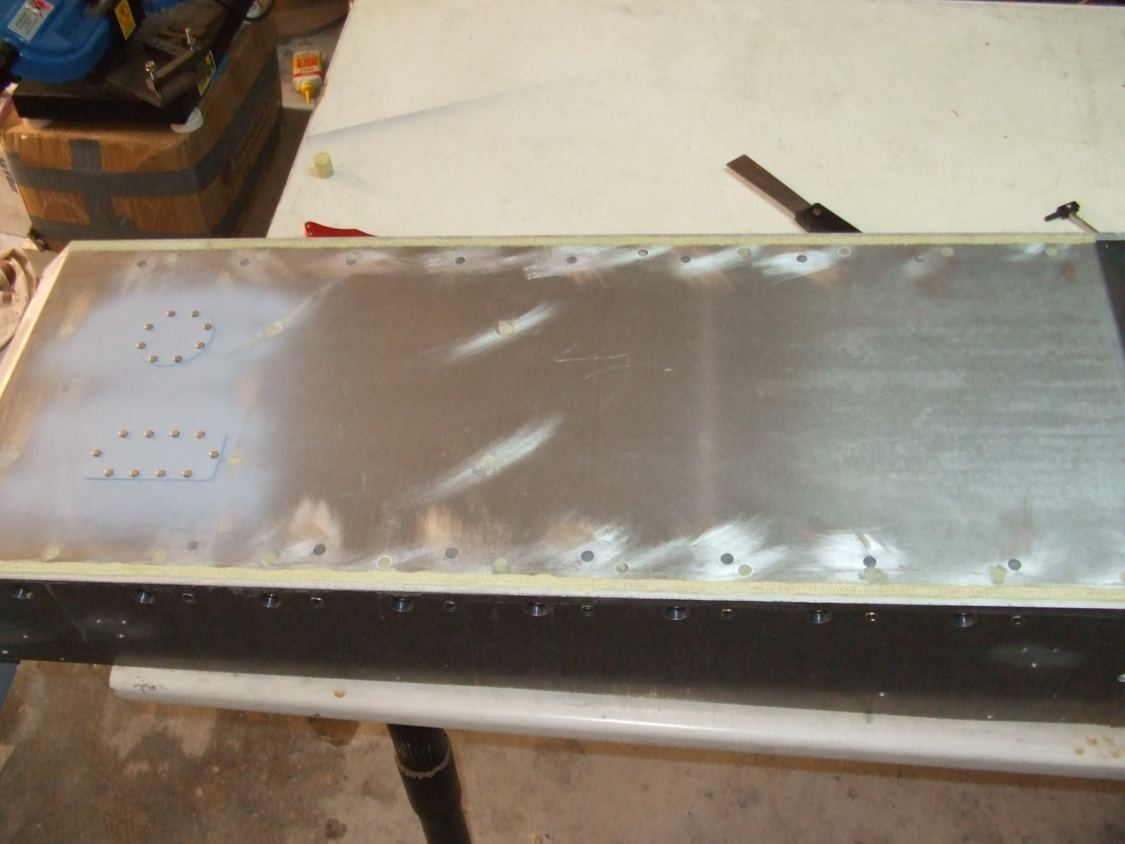

Finished off the weld seams on the hull floor. Today I felt more confident about it. I got that "sausage extruder" for less than a fiver and it's worth every penny.

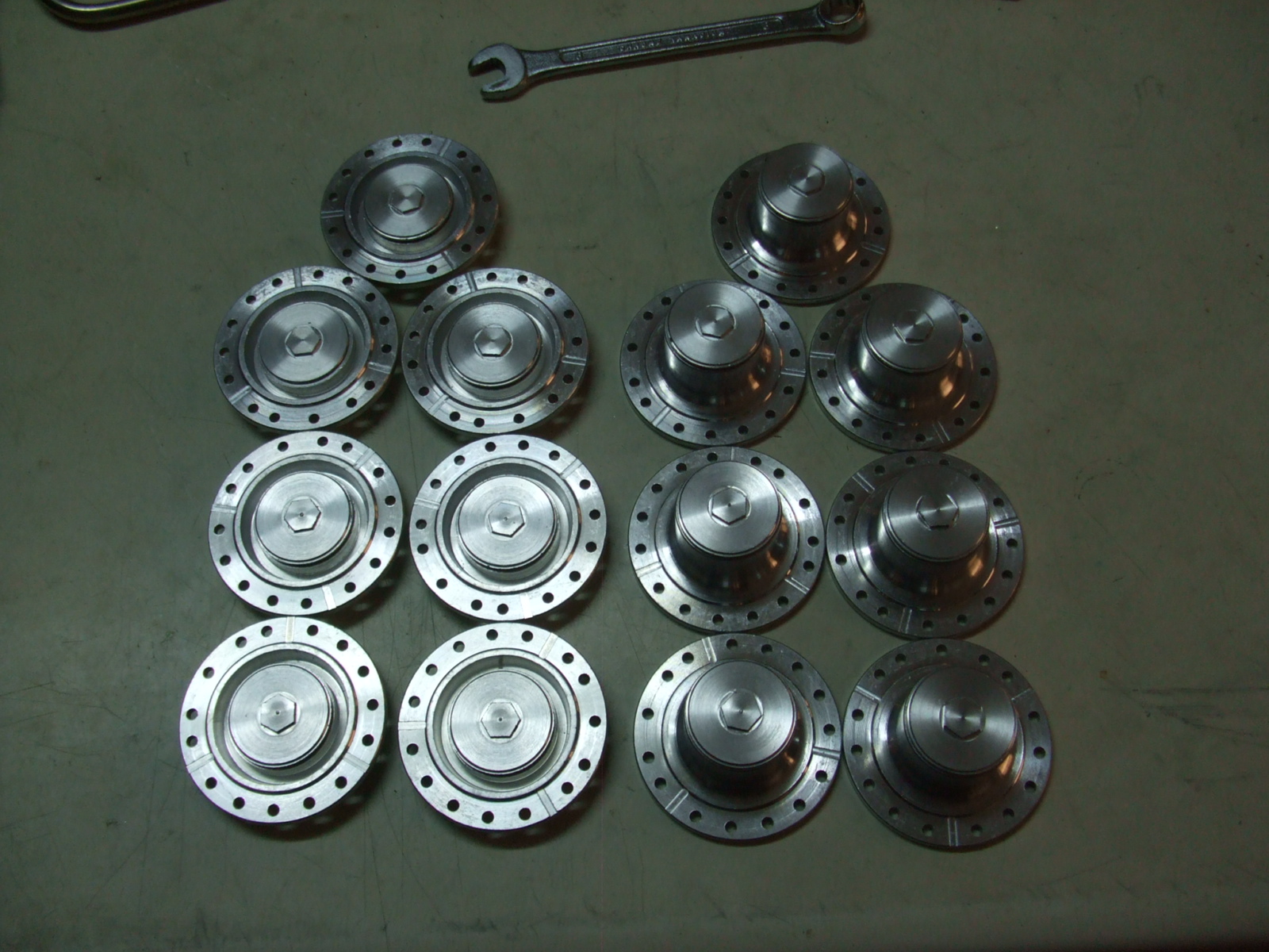

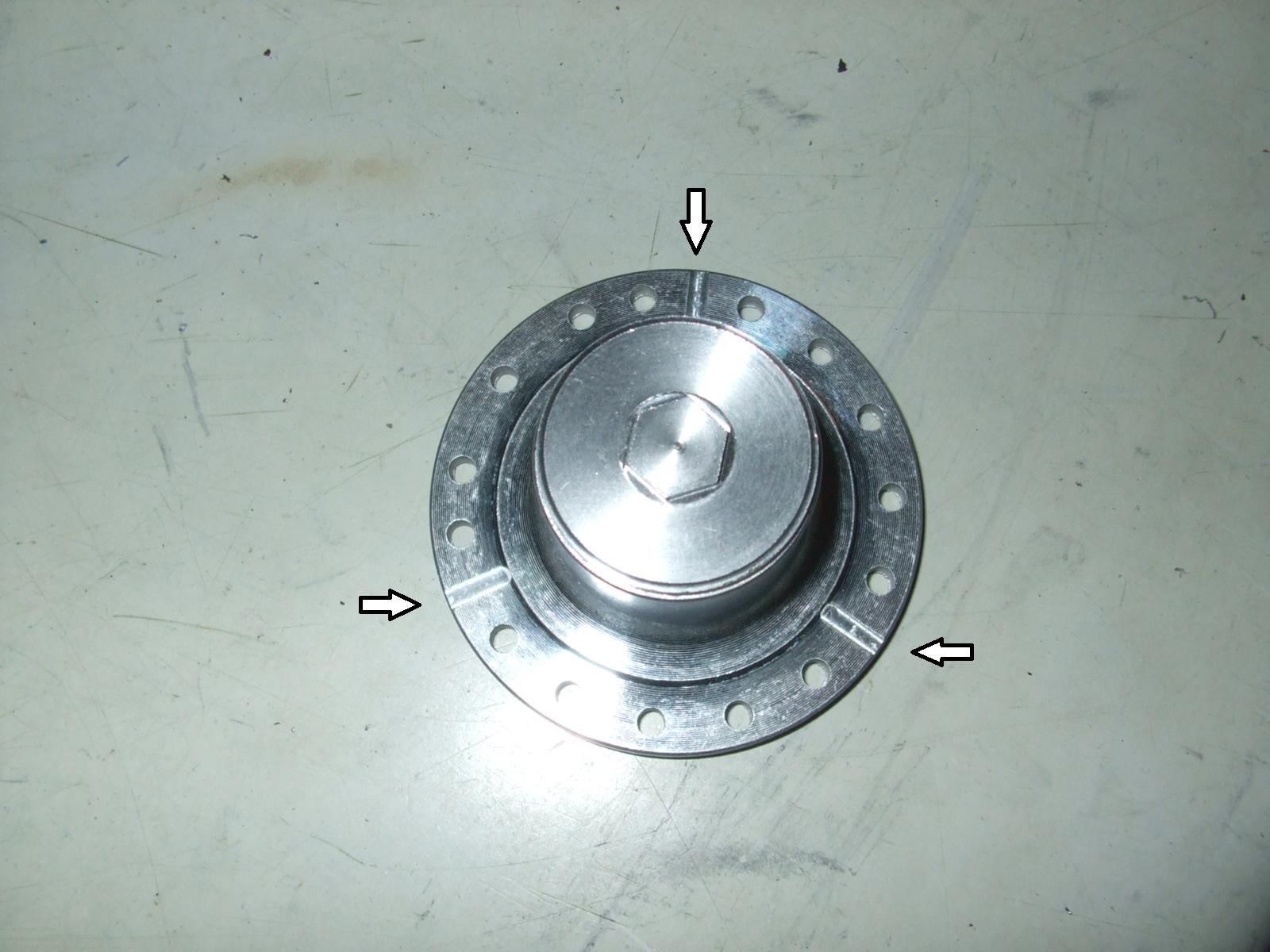

Last week when I did the trial assembly of both types of road wheels, I had a minor problem when screwing the inner cap to one of the hub caps. So as I had some time to play around I thought I would clean and check all hub caps and inner caps.
When threading an aluminium component into another aluminium component I am always careful as there is a good chance of galling and once the parts jam you basically had it. So first I inspected both female and male threads for machining debris. Most of the debris was noticed to be on the male thread. I cleaned these up with a wooden tooth pick. One could also use a blast of compressed air (using safety googles!). I only had a problem with three or four parts. Most of the time the problem was on the female thread. So I back it off and try hand tightening again until I feel the obstruction, then using an 8mm spanner carefully try to go beyond the obstruction which most of the time solves the problem. When I felt that gently using the spanner this was not going to help, an inspection of the threads with a magnifying glass always finds the problem which in my case was solved by using the metal point of a smaller divider to either remove a burr or fix a slightly deformed thread.
I wonder if I should cut the slots in the hub caps (marked by arrows).

Not much done today except etch prime the hull floor and the paniers. Still haven't decided yet if I should give it the reddish/brown primer over the etch primer.
