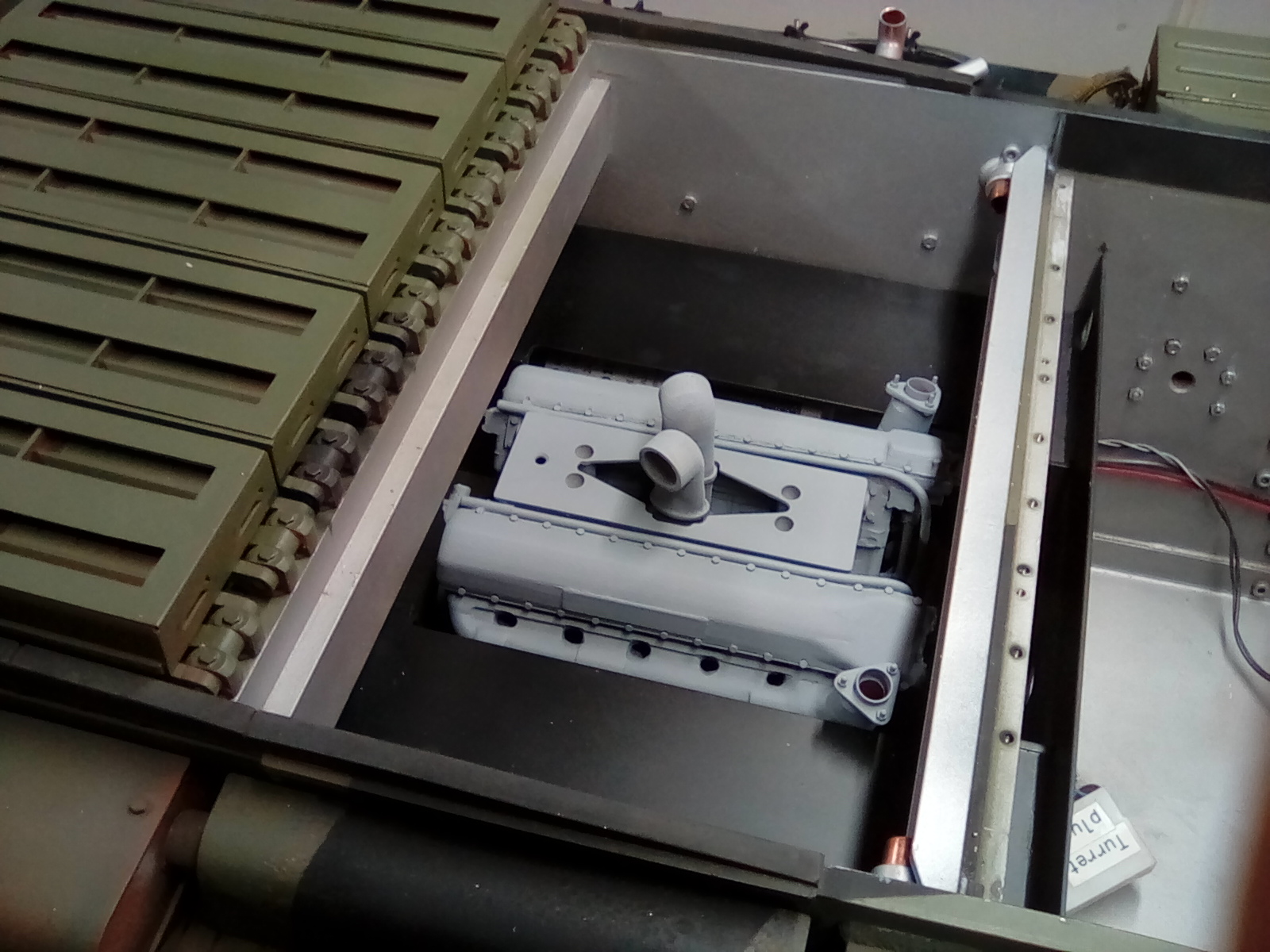

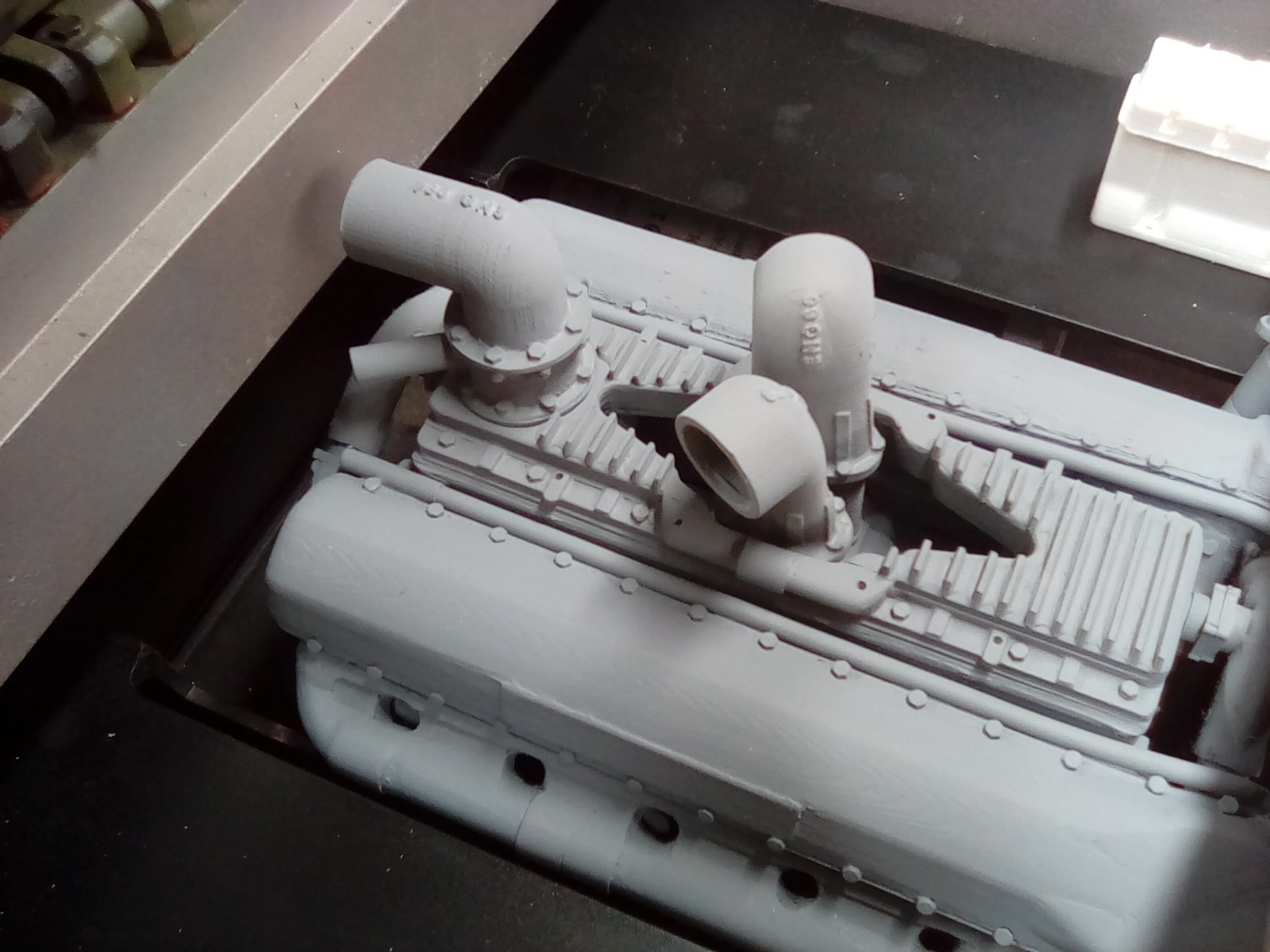

These intakes have proved problematic but I think I'm there now but for maybe a slight reduction in height once I'm sure of the air cleaner pipe work heights

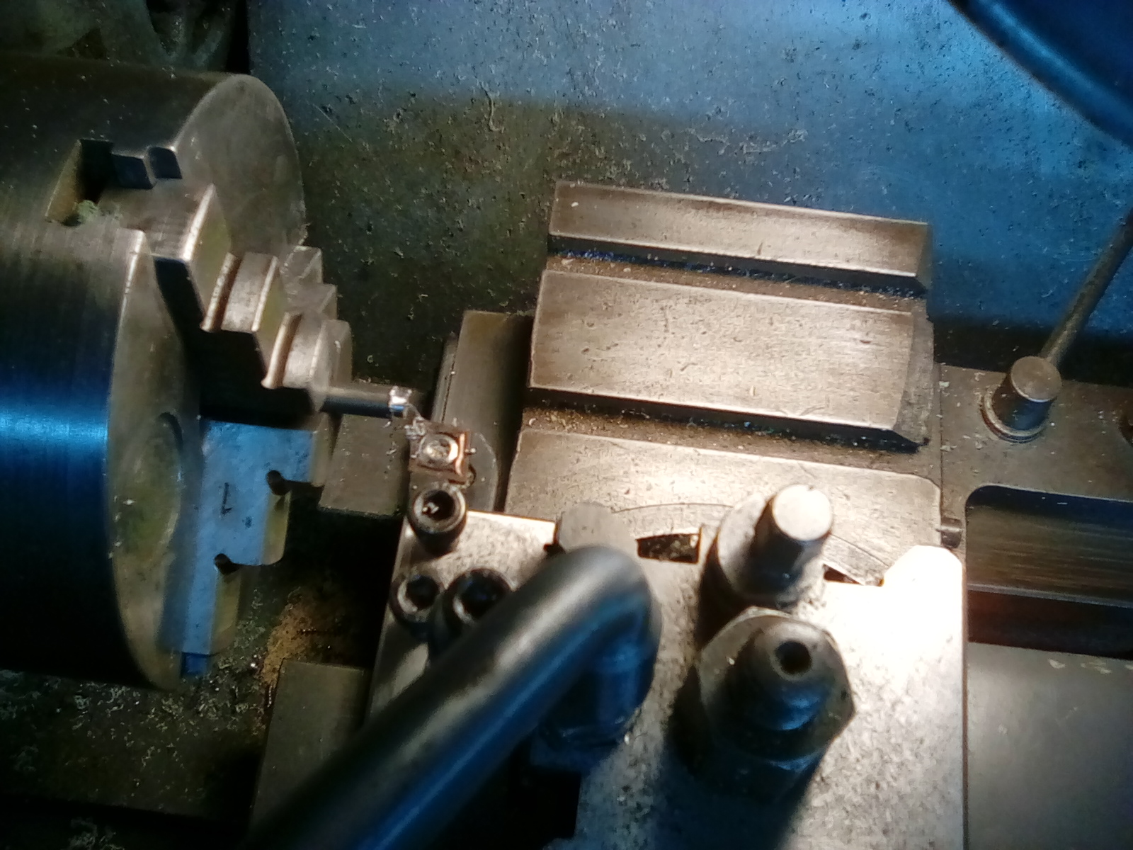

Printing and turning small parts, and I will be for sometime
I may have to lower the air intakes but not sure yet as I have no dimensions to cross reference, it's all guess work and if it looks right then maybe it is right

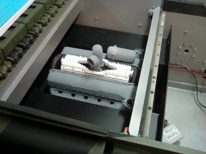

Once the engine bay cassette is in place everything above the rockers must be demountable, I have to build it all on the bench, dismantle and reassemble, once the engine is slotted in for the last time it can all be bolted in place.

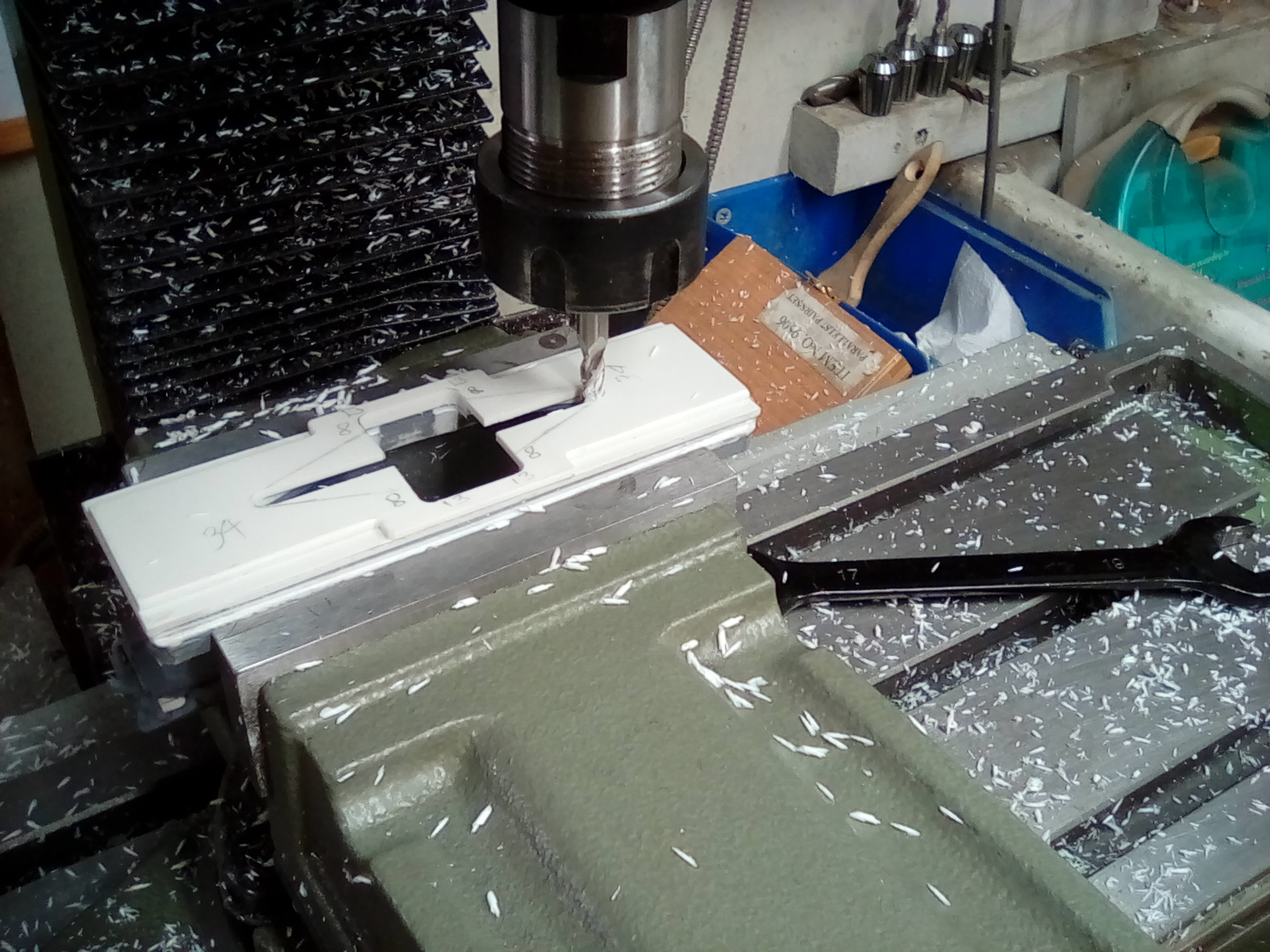

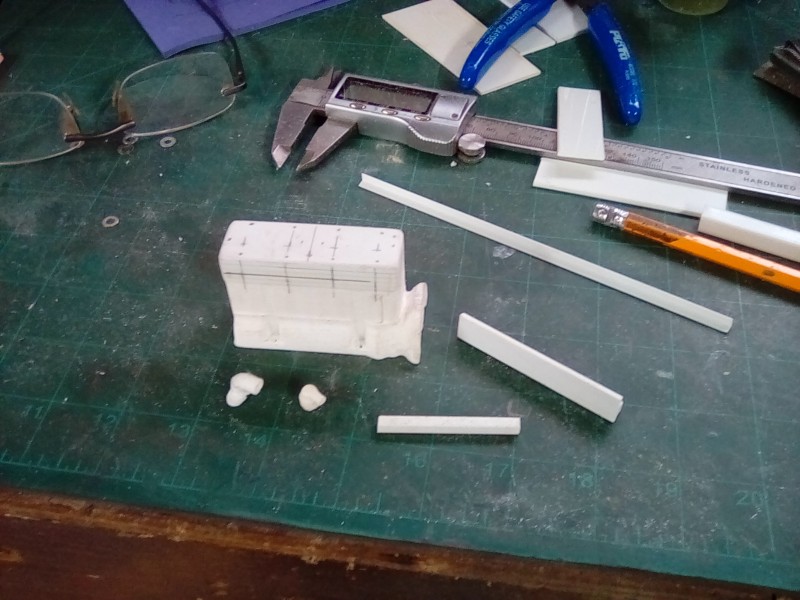

And another layer to mill
The carburetors do show
Maybe a long winded way to make up the manifold but it works in my mind

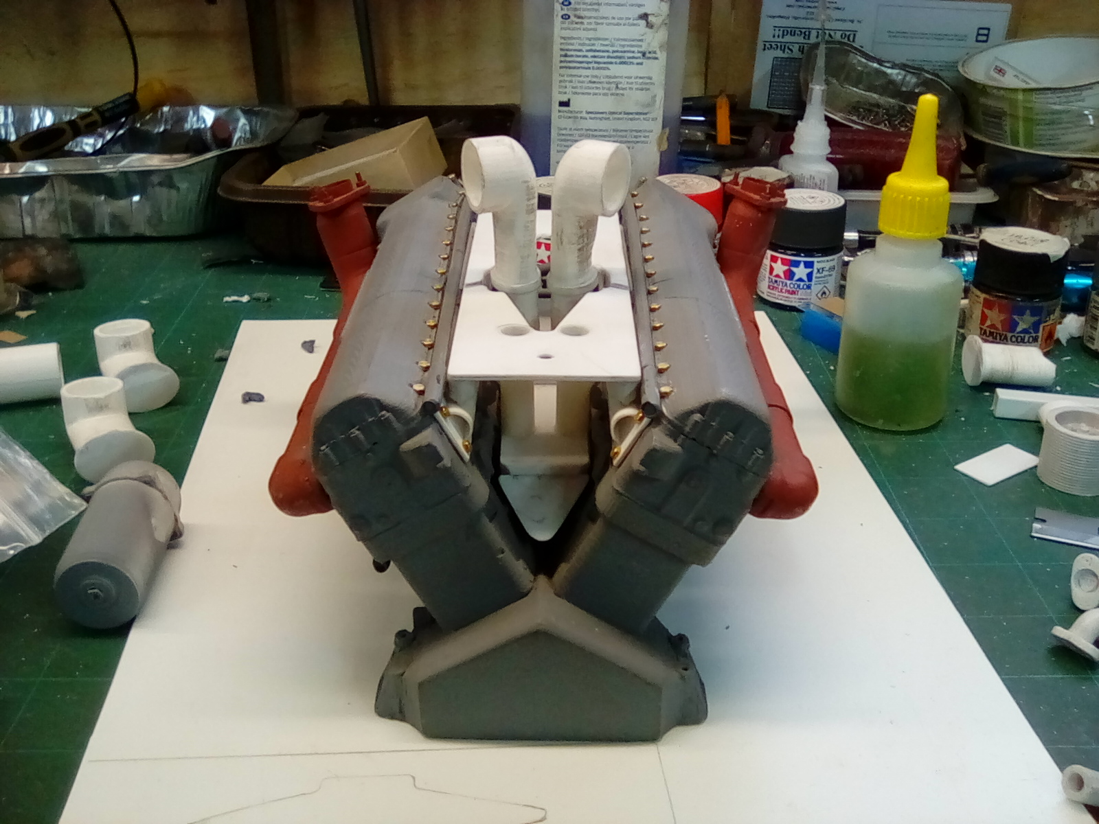

It's starting to get some depth now
I shall mill the cooling ribs from a separate piece of material

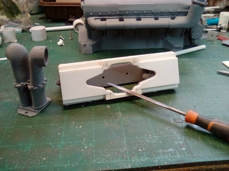

Lots of hand filing
Lots of hand filing

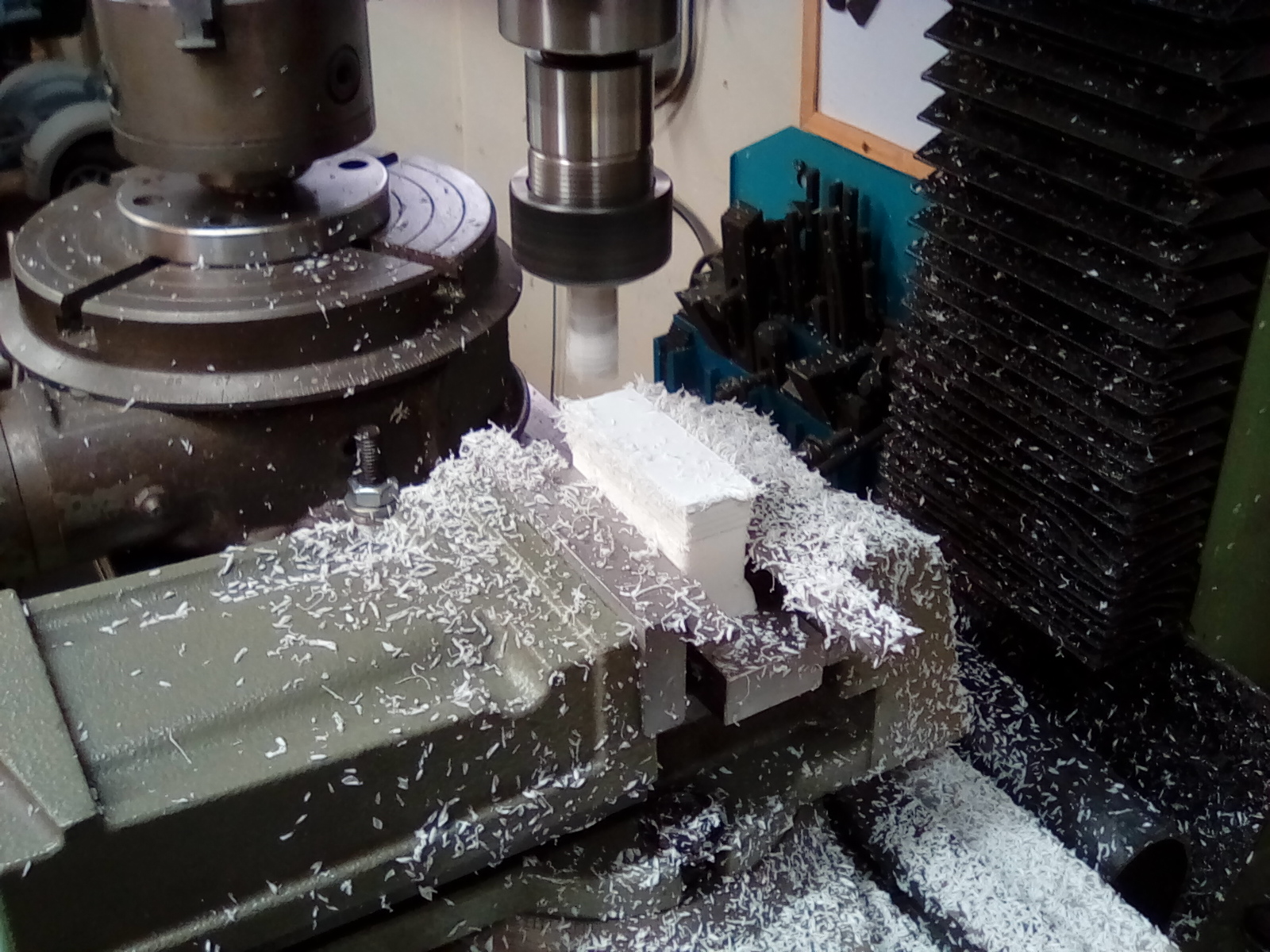

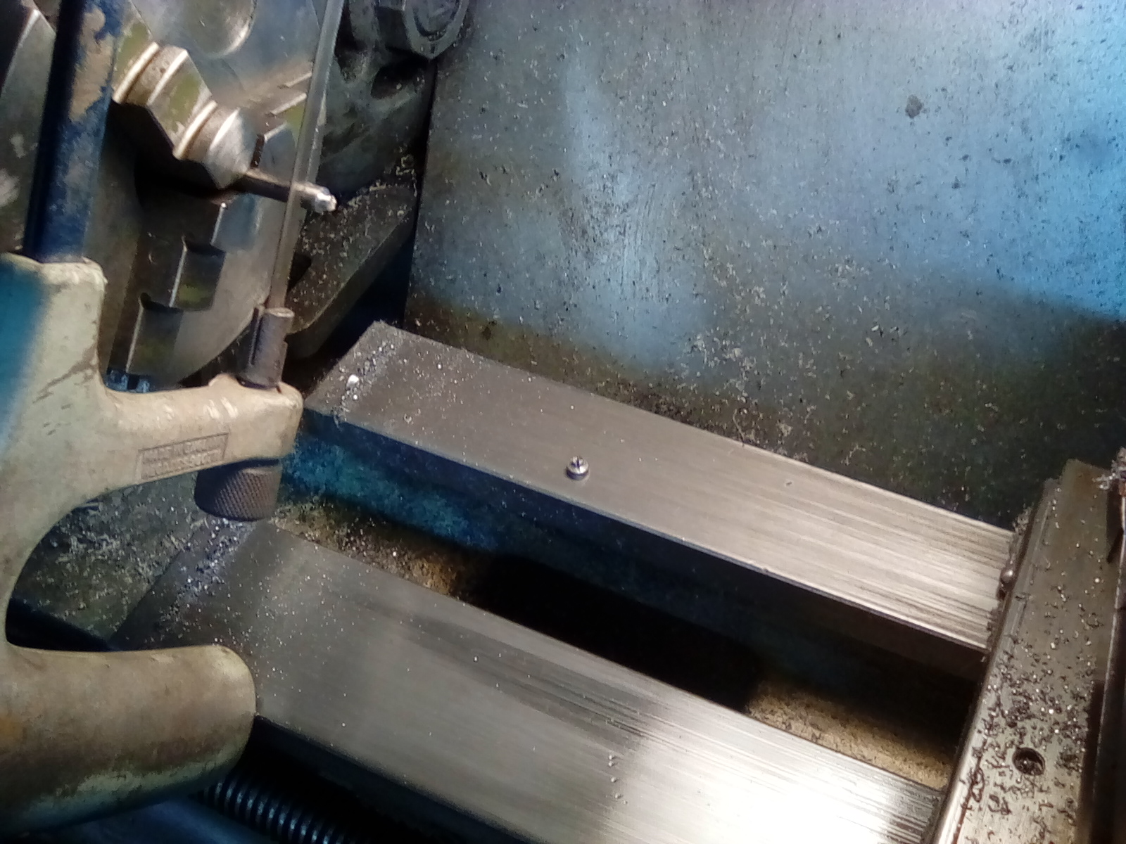

This material sure does mess up the machines

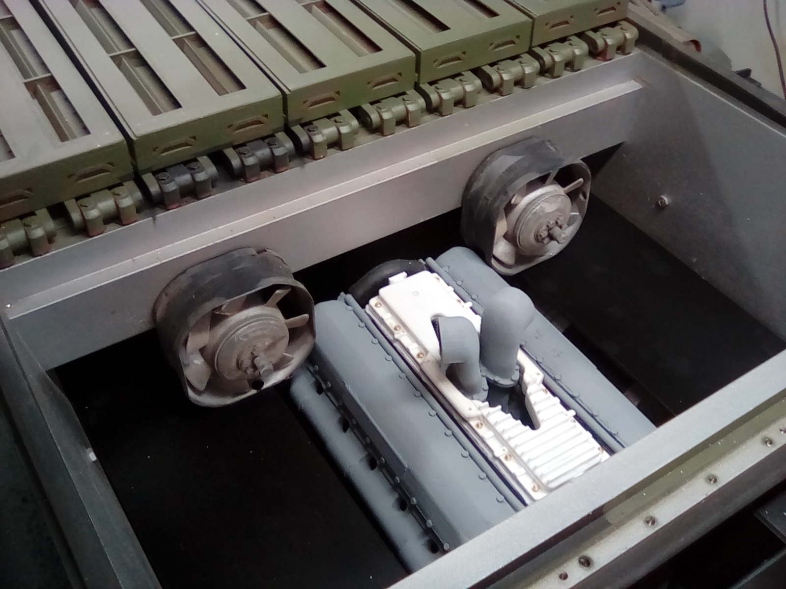

Now can I get a portion of those fans to fit?

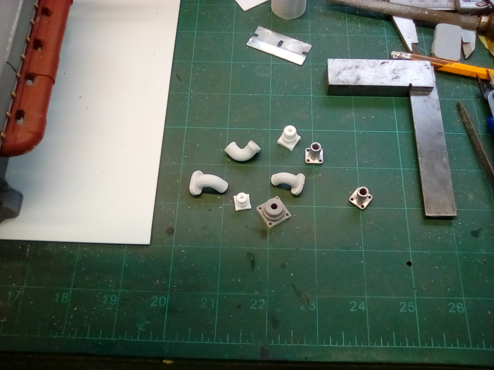

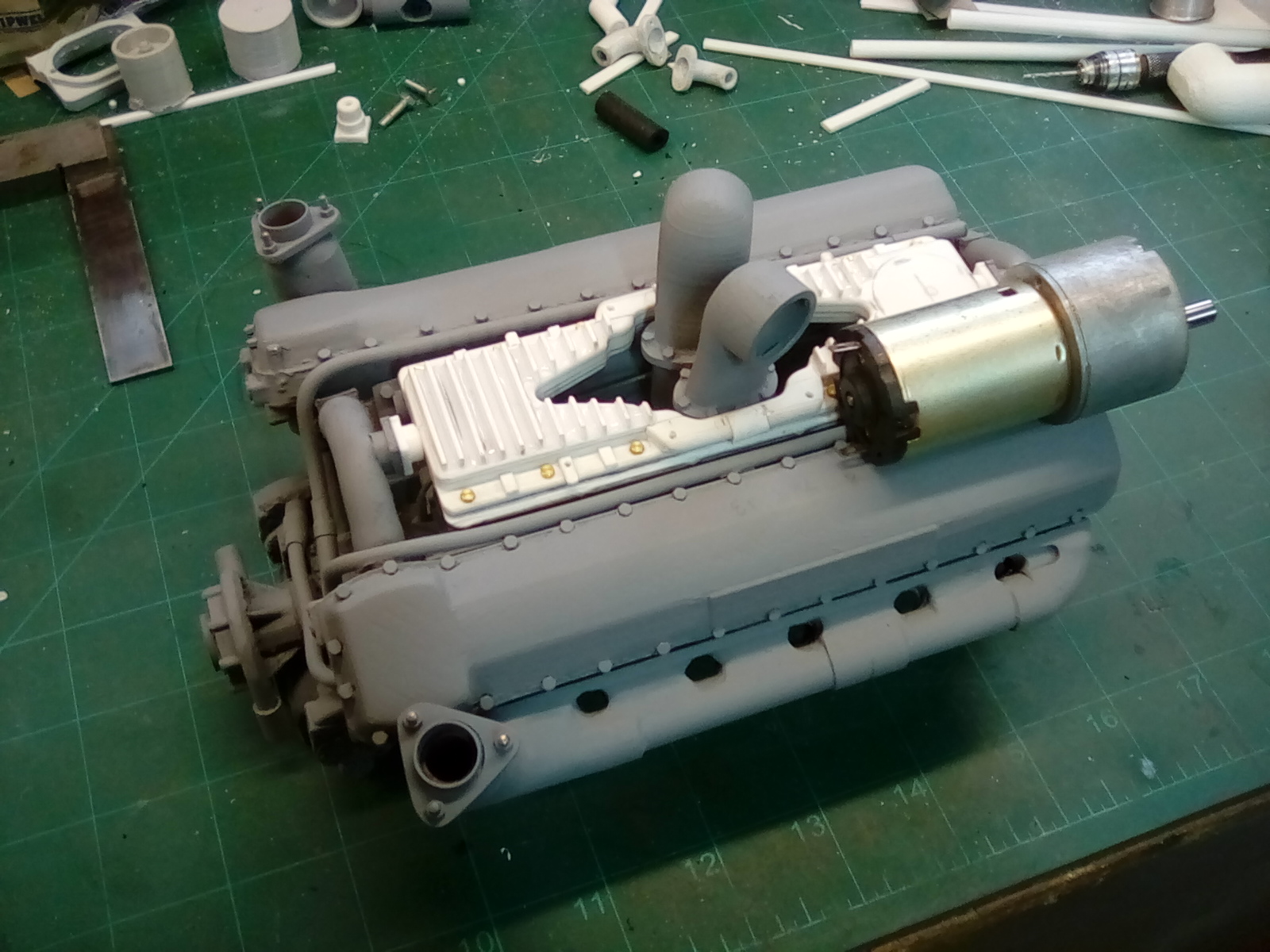

Editing the elbow file until it will fit this will link the top hose to the radiator
Water pipe union being printed

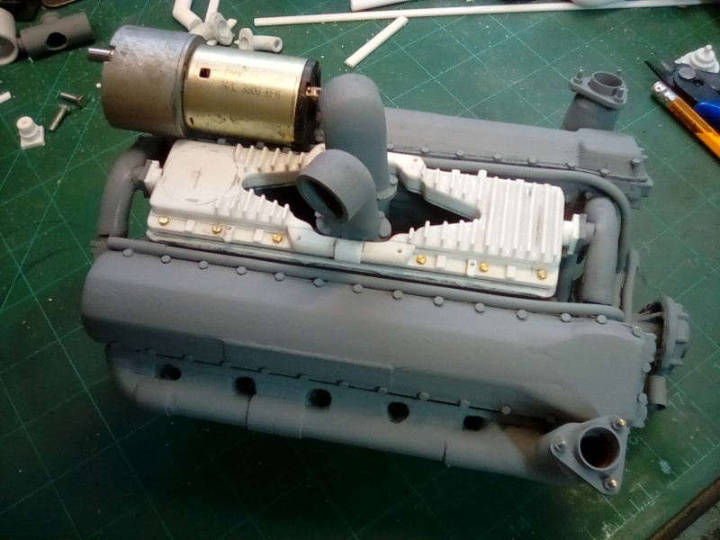

I'm hoping I can get the generator running and turning the fan pullies but not sure there's enough room just yet

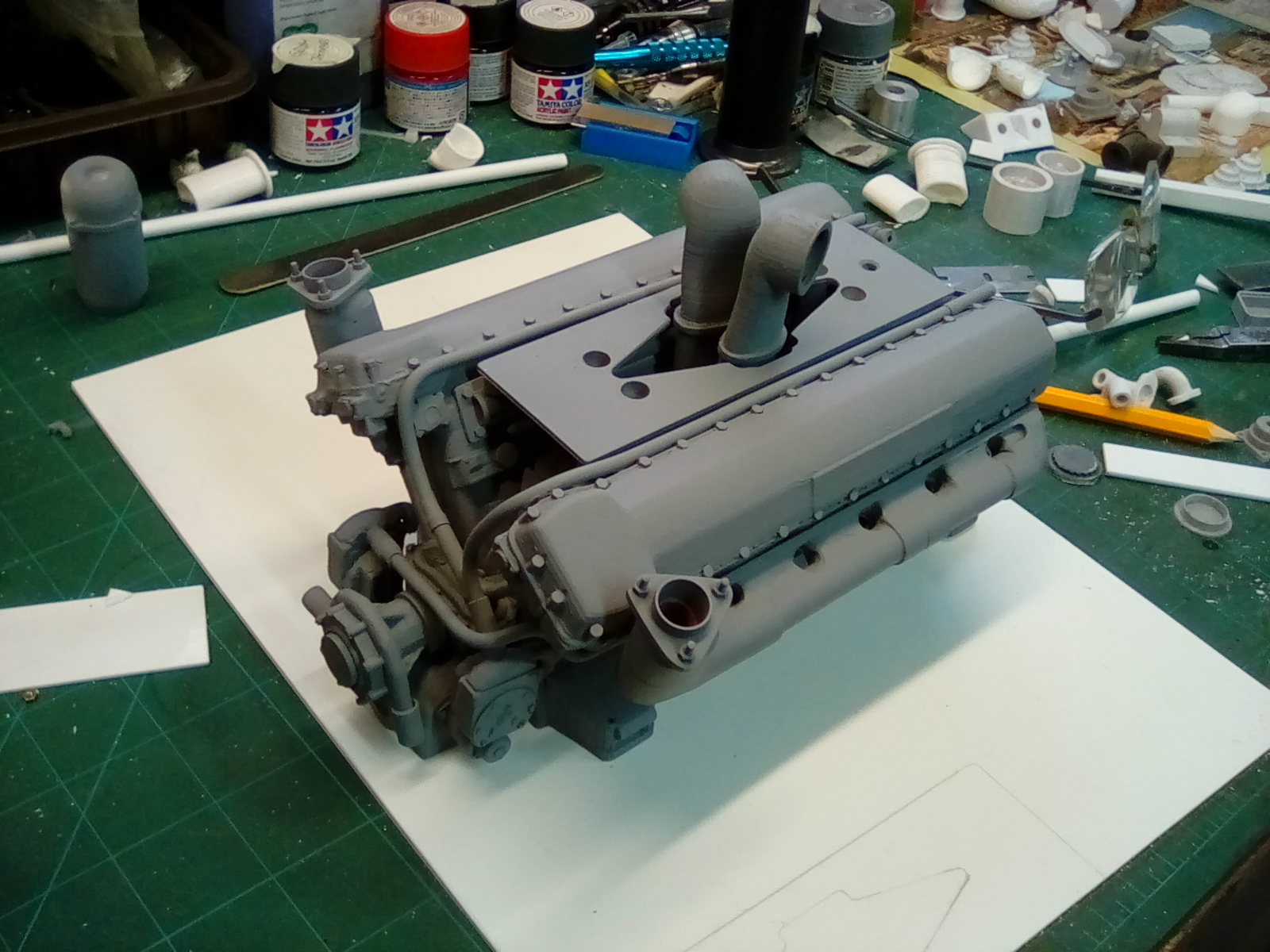

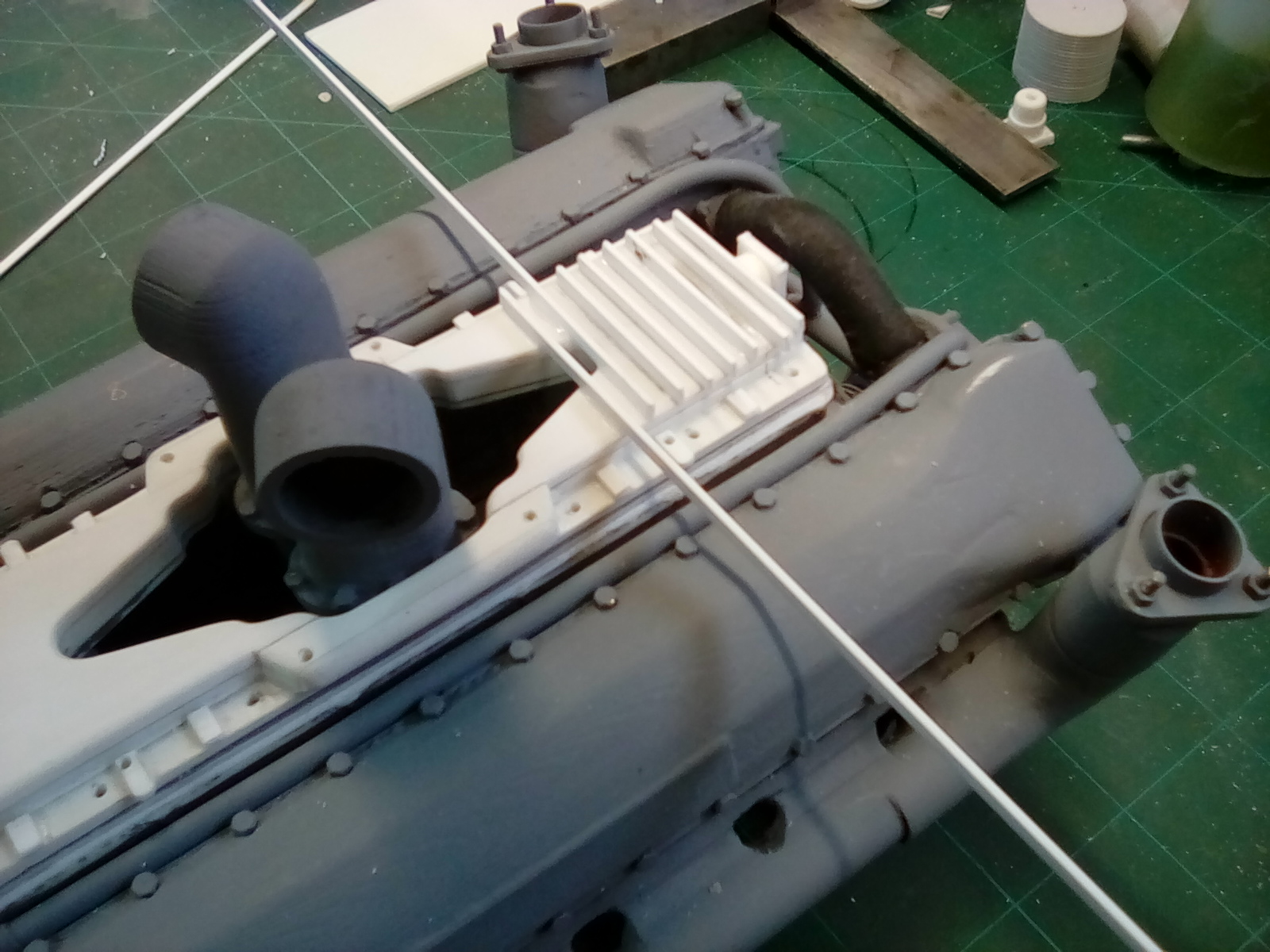

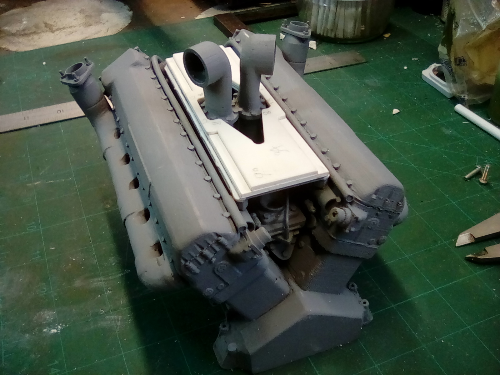

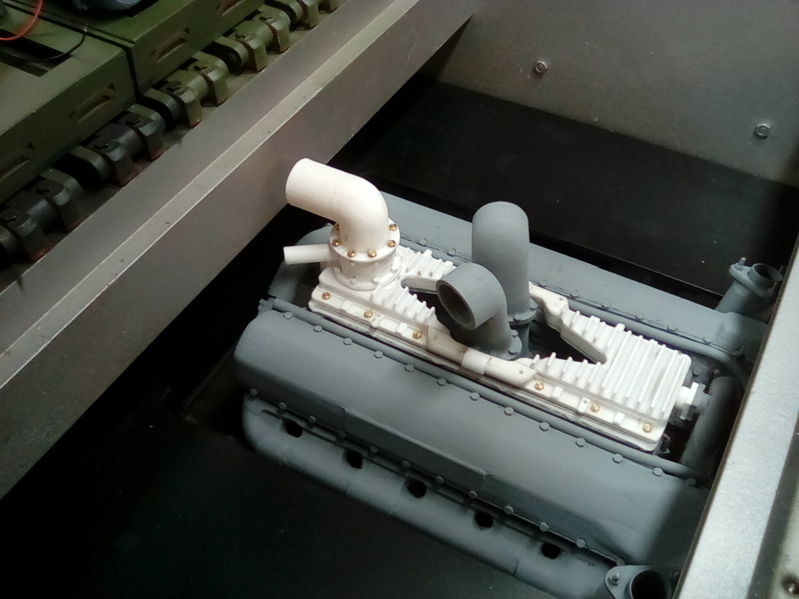

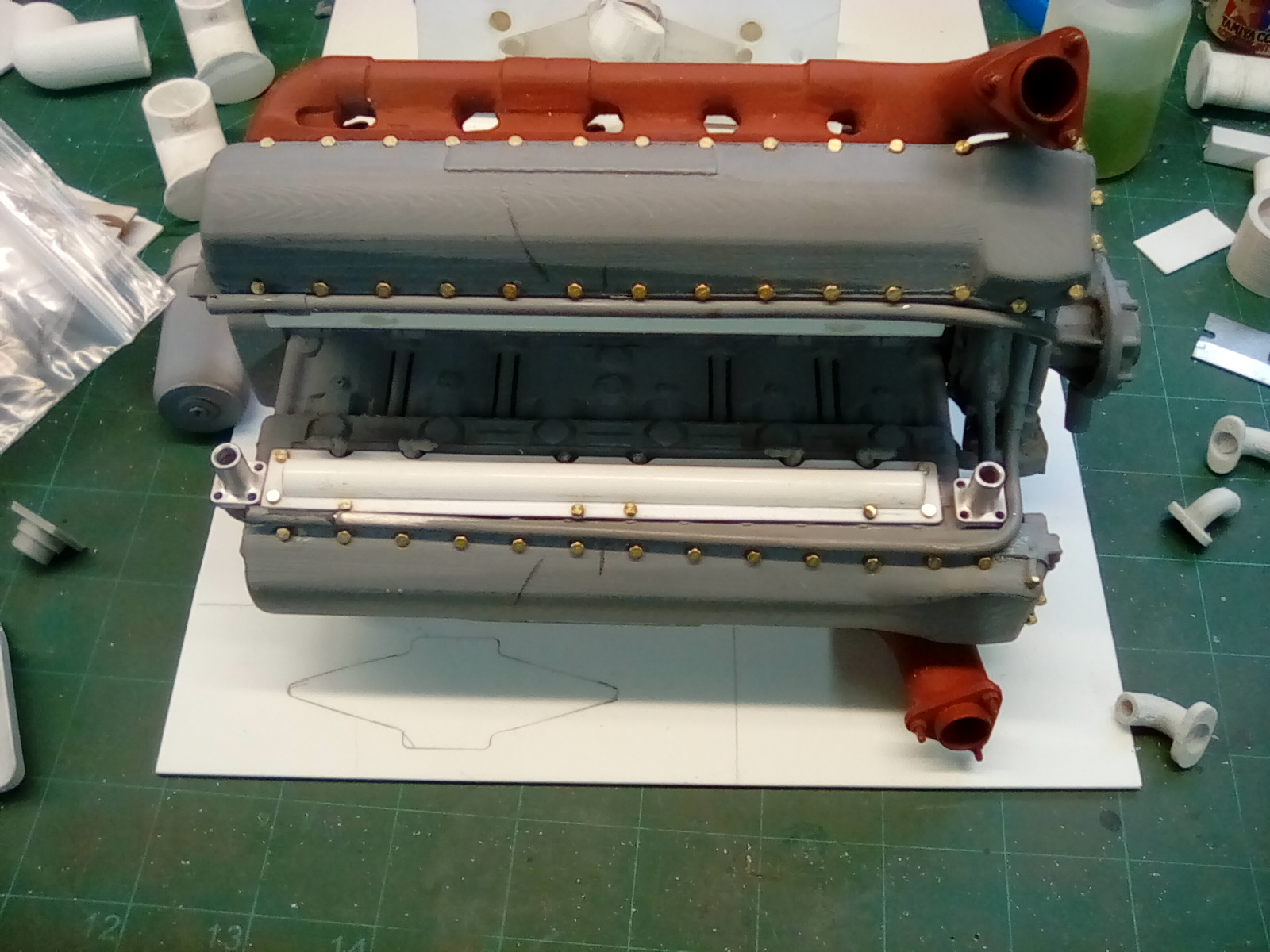

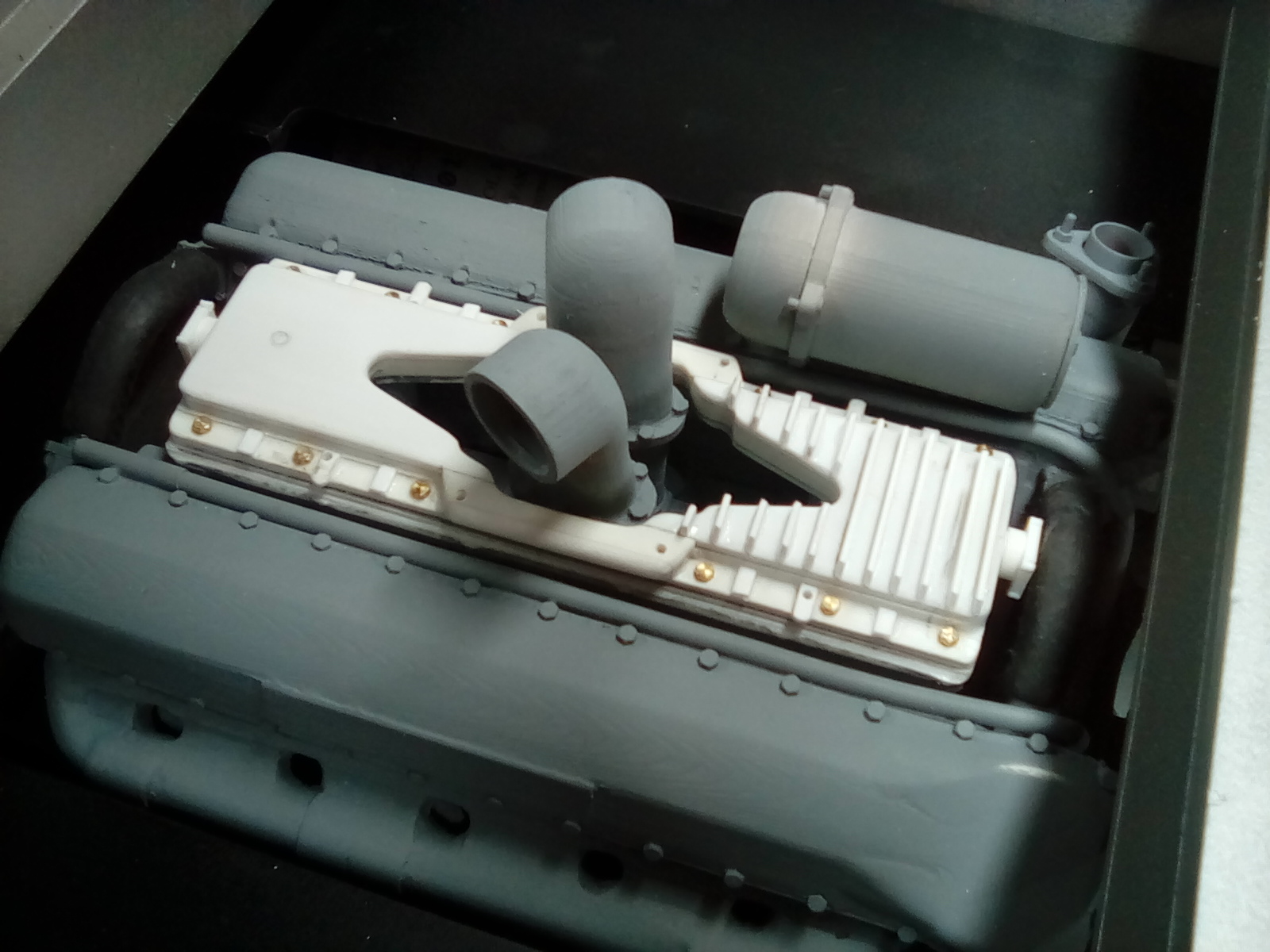

All the ribs are now done and the inlet manifold water pipes are now in place, although they look fixed there not, and it can all be lifted out

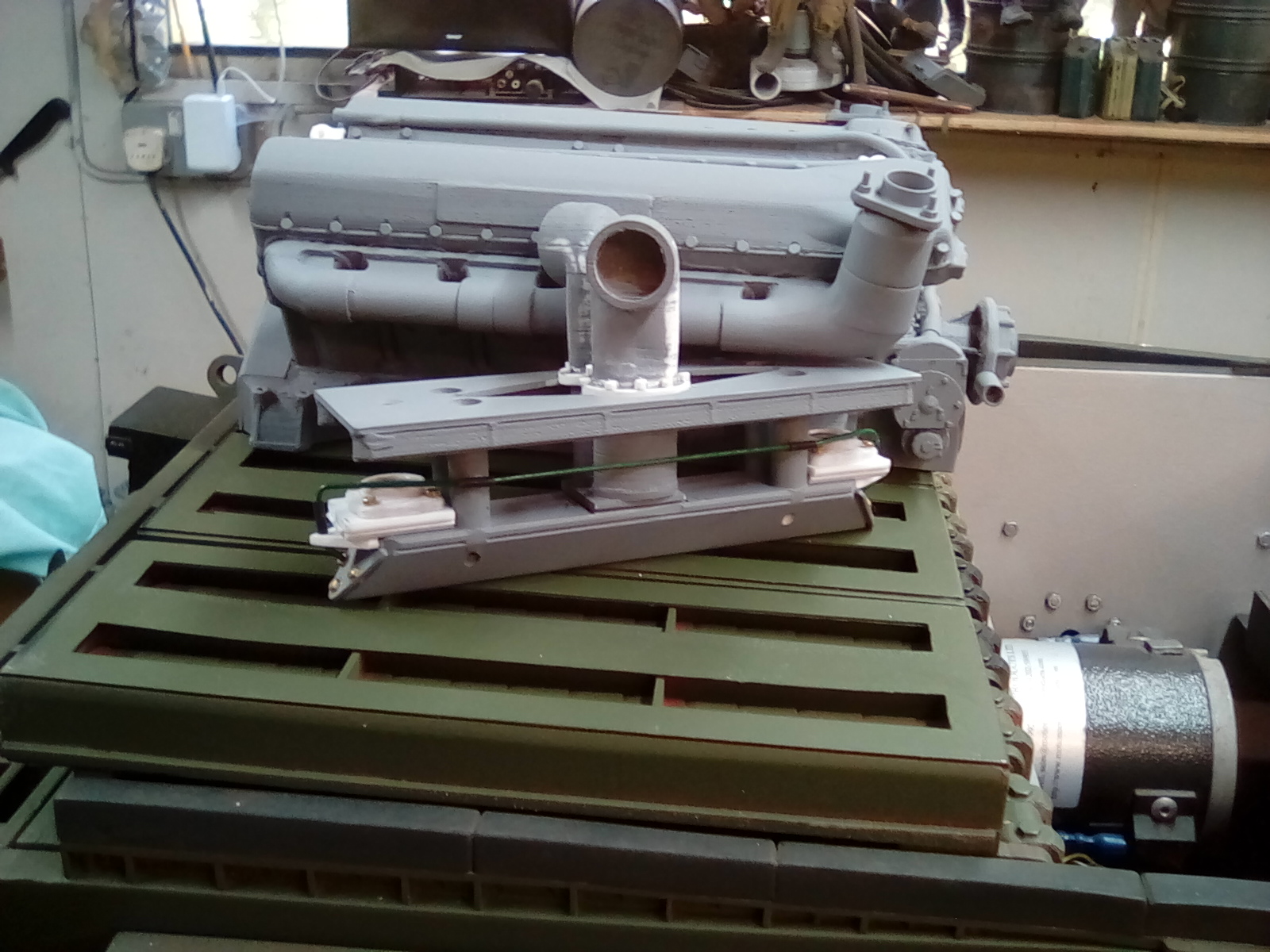

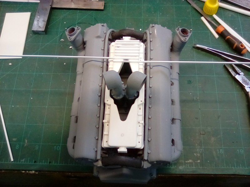

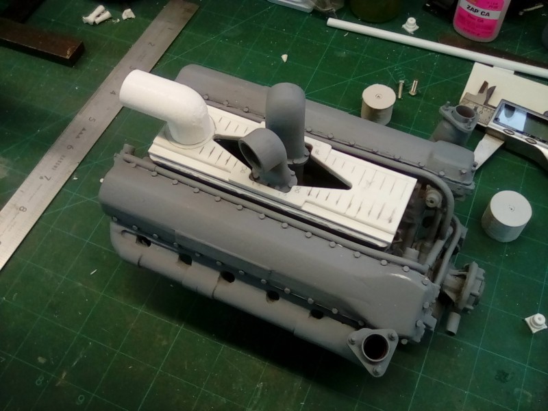

A quick set out using similar size items to give me an idea of what goes where

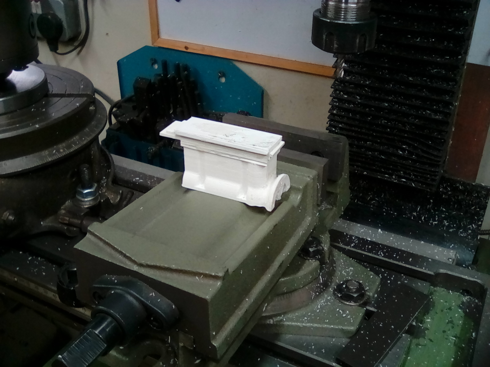

Milling required to get that look I want

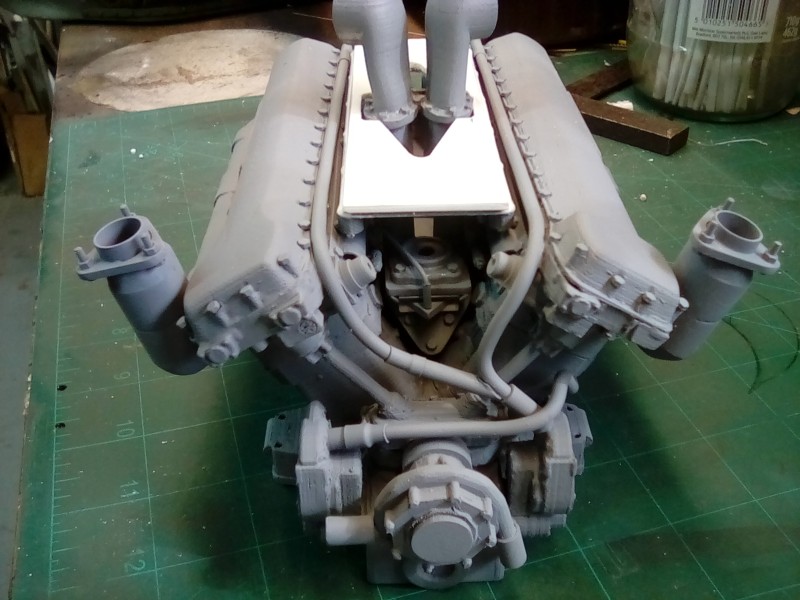

Rear engine water pipe assembly now made and installed, again all these pipe fittings need to be removable

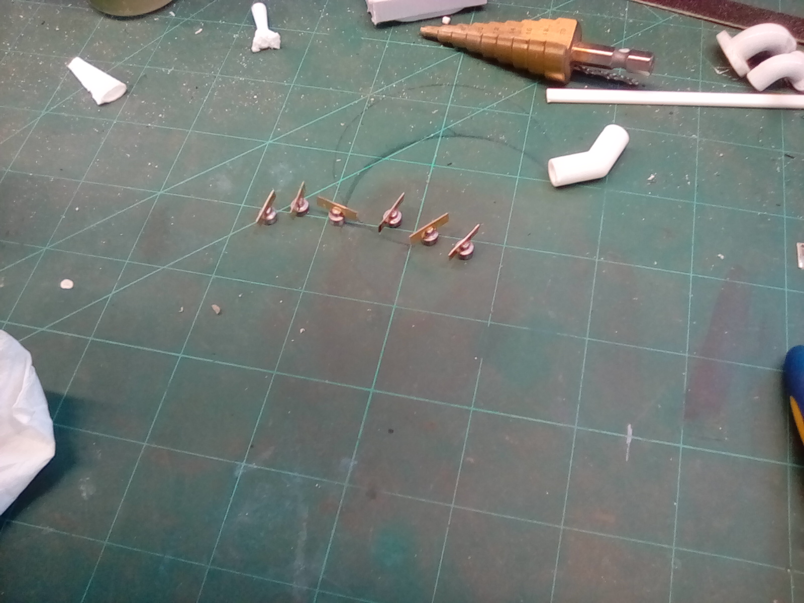

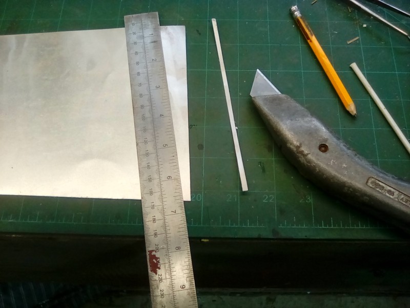

Very thin ali sheet can be cut with a craft knife, great for fuel pipe " p" clips

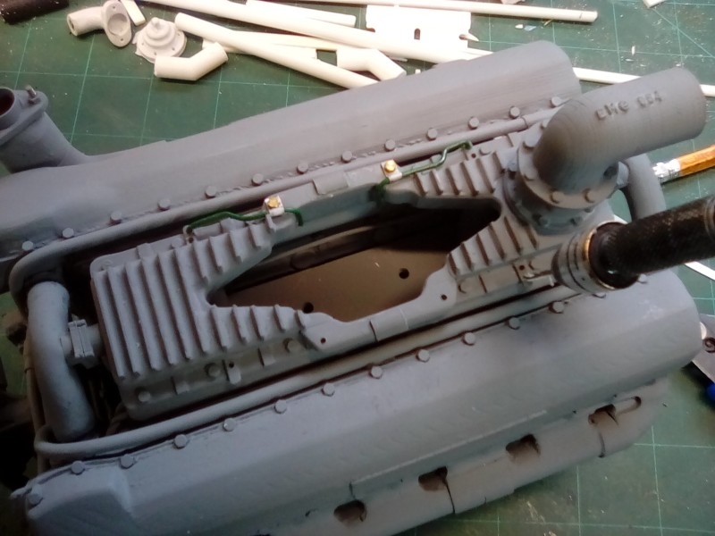

Very small casting/parts numbers added, I don't think that you can get any smaller than these
The tiny casting letters are a bugger being this small but they add to the overall effect

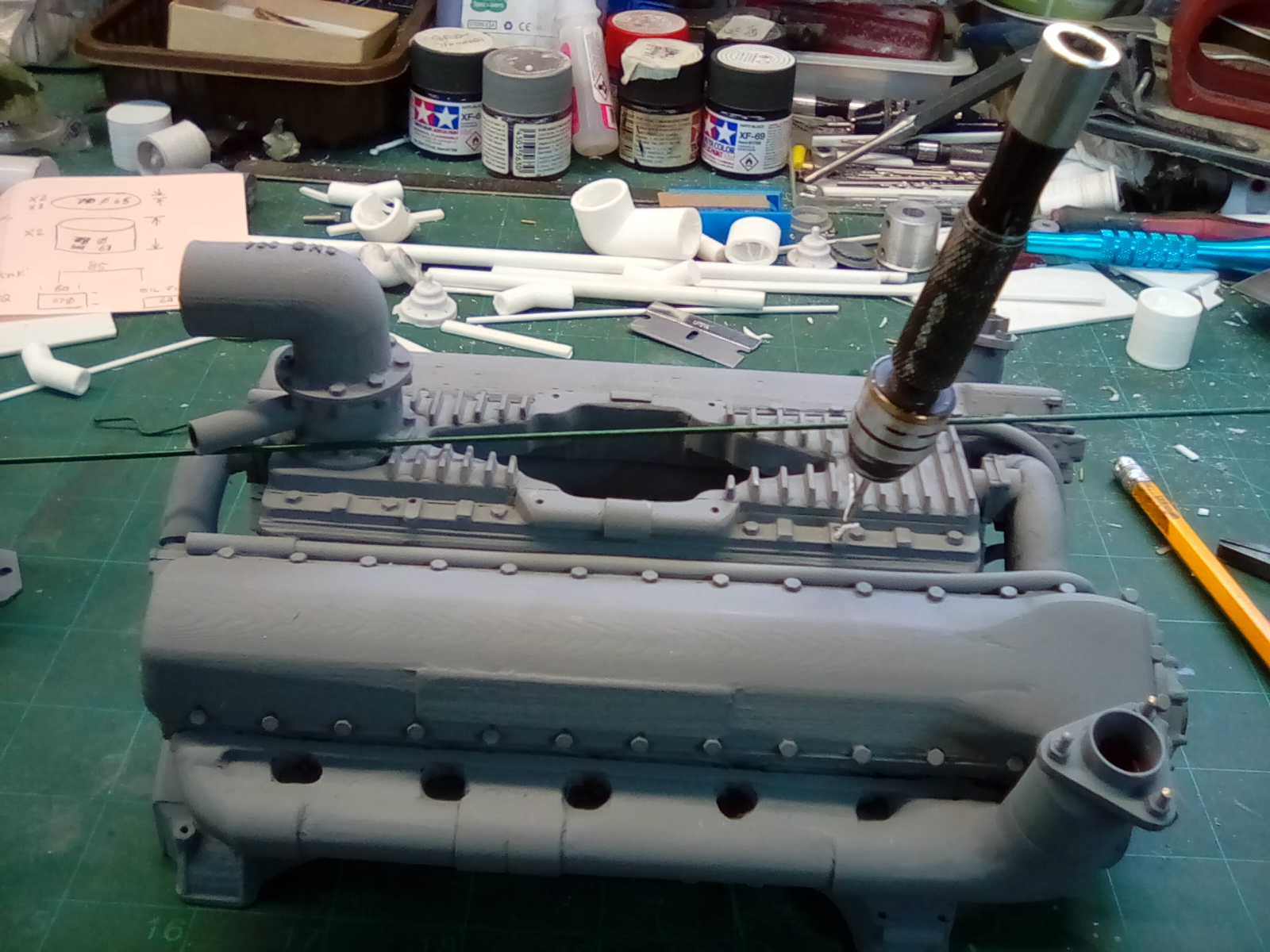

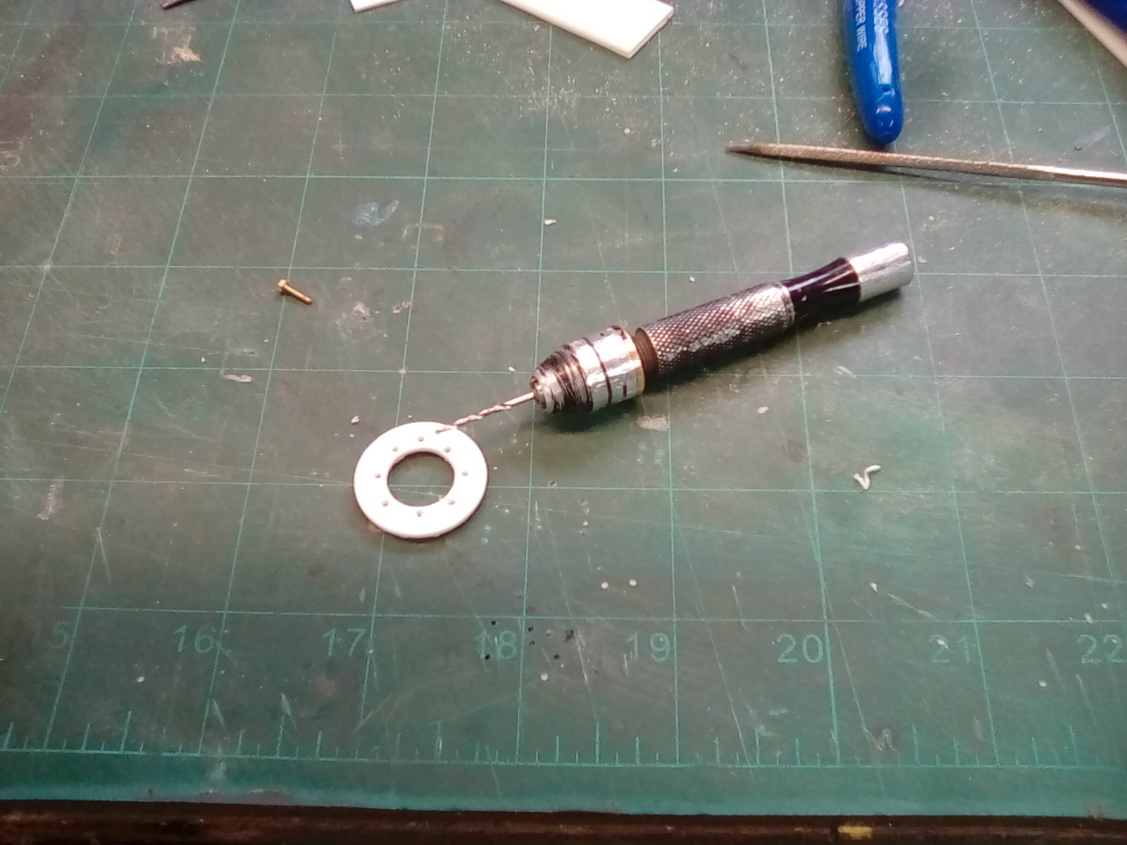

Always pin drilling
Always pin drilling

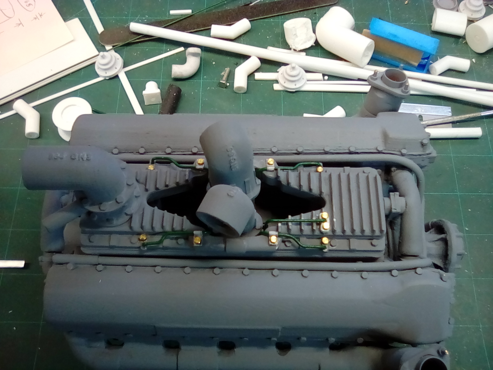

Fuel pipes and "p" clips

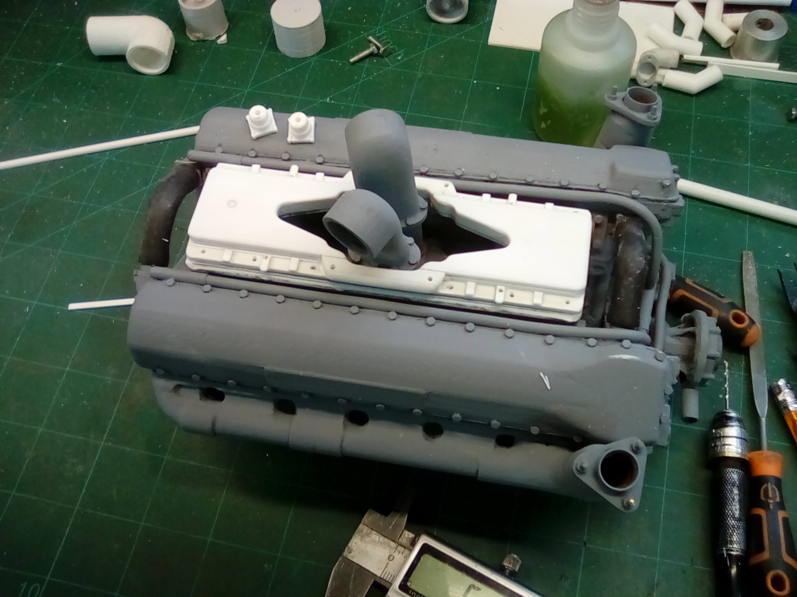

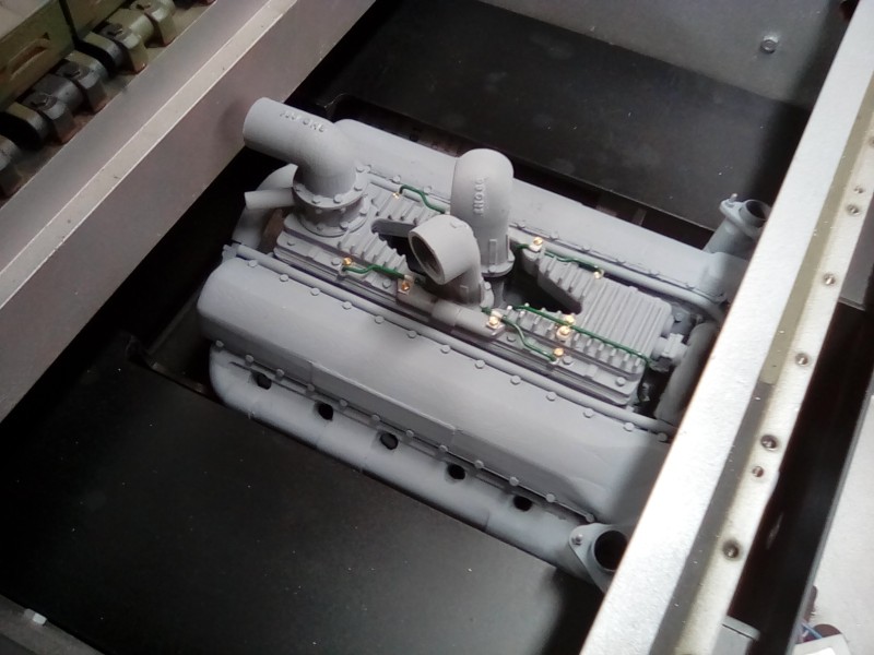

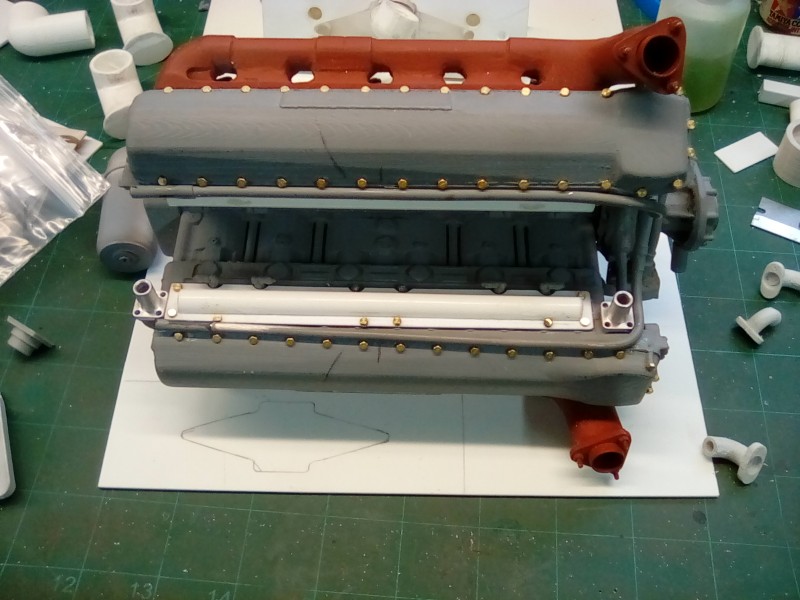

I'm nearly done with this manifold

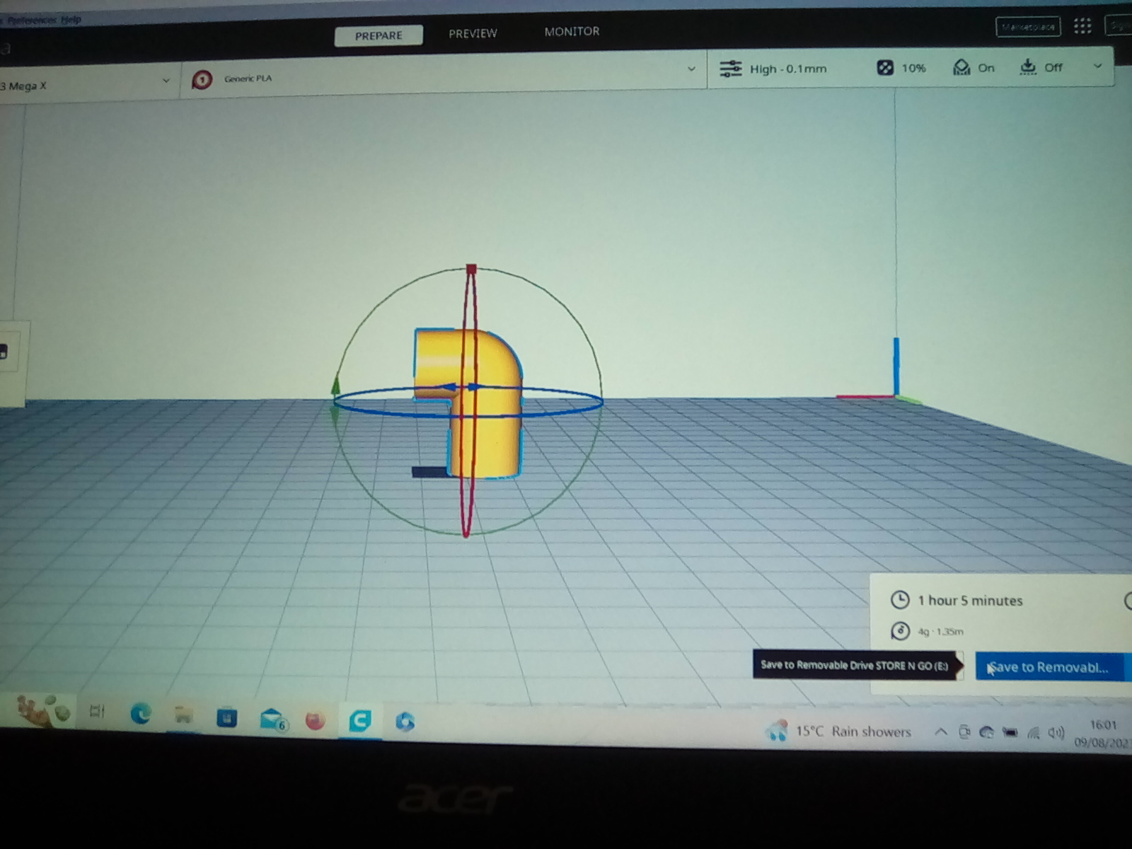

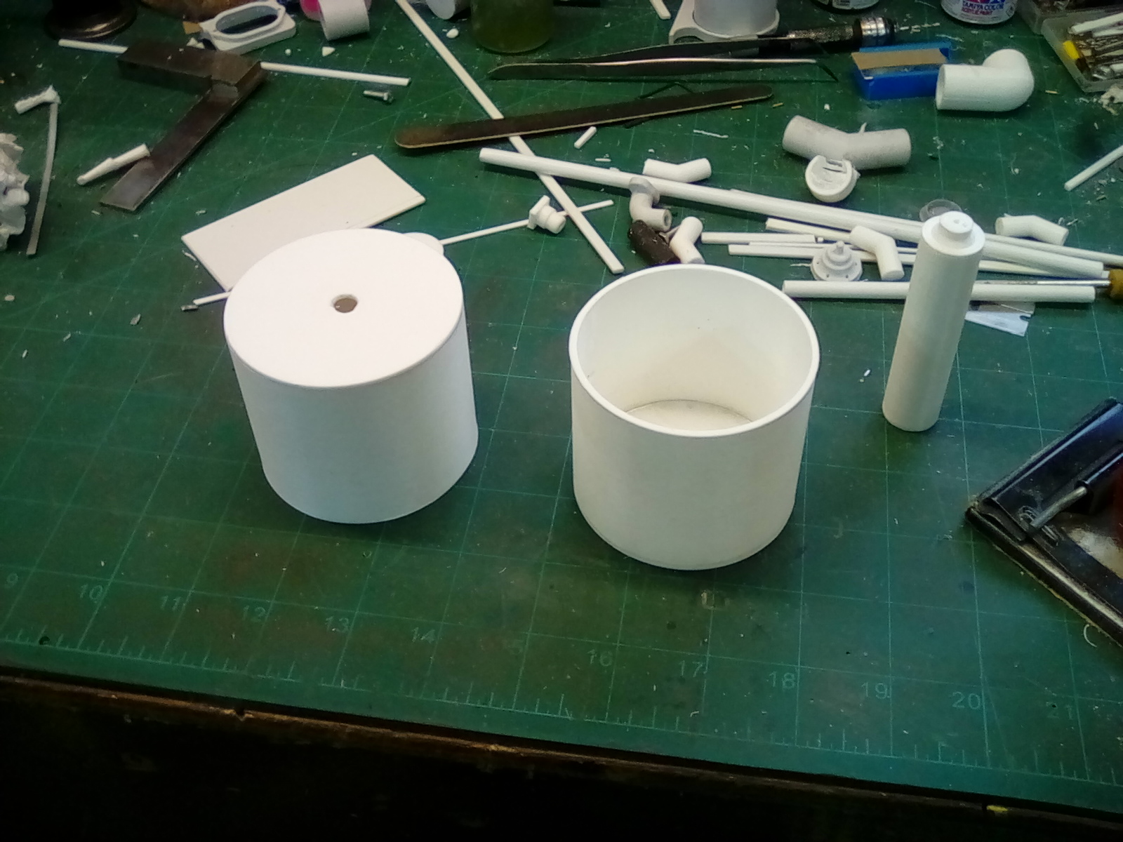

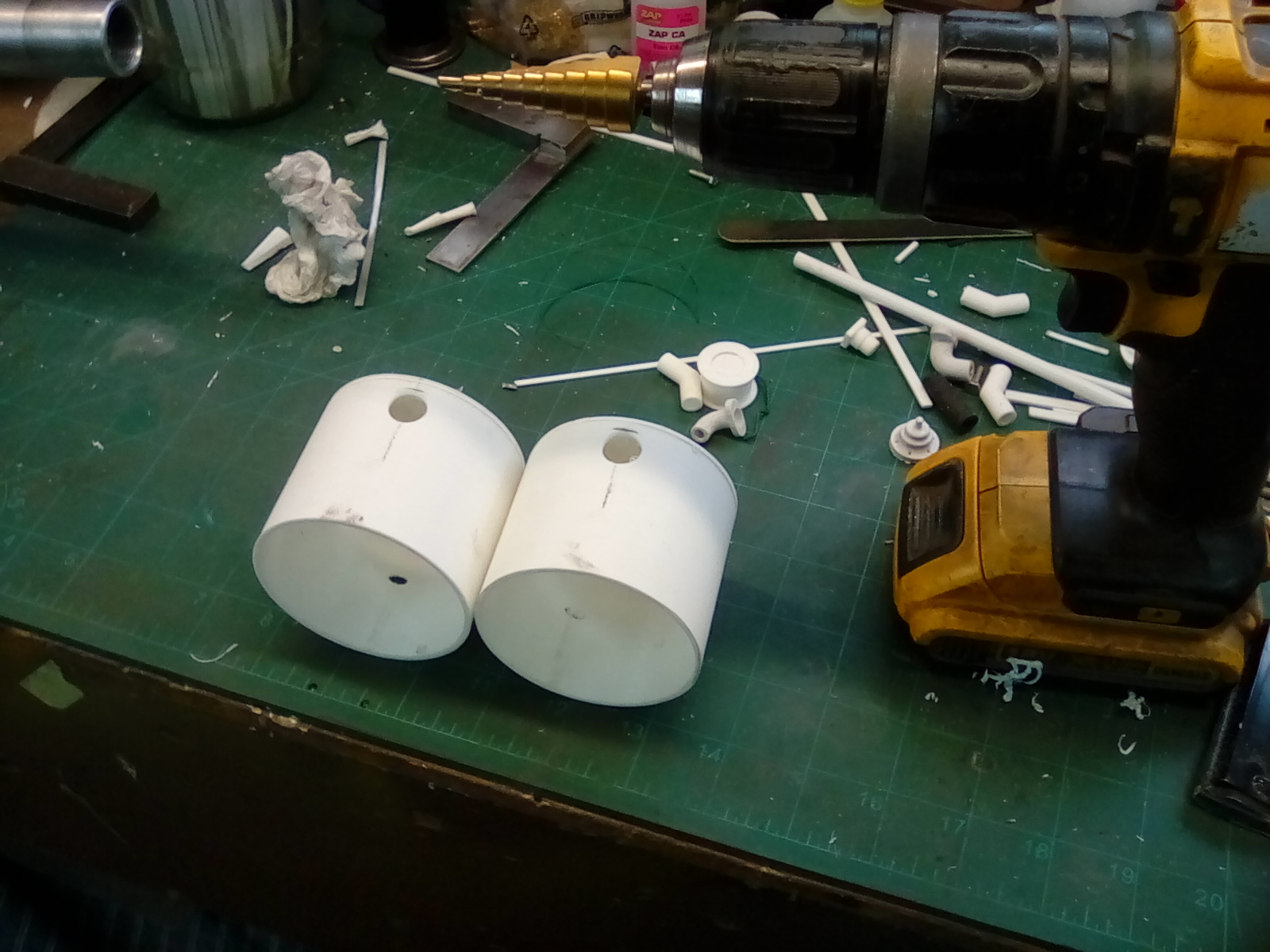

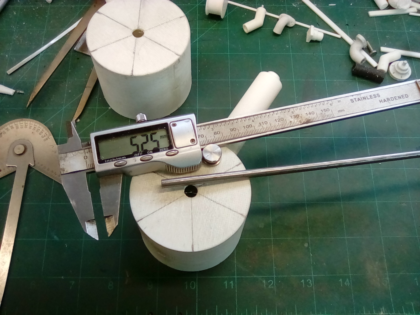

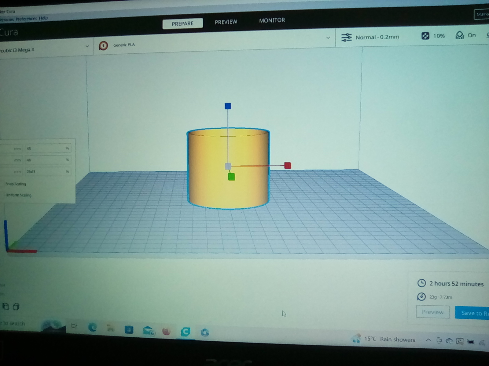

Editing in cura and printing the air cleaner drums and drum tops today.
A tip for those like me that are not familiar with creating stl files from engineers drawings, collect basic stl files from the various sites on the internet which are often free, simple objects like cylinders, discs, square boxes, rods and anything that looks interesting, then using your imagination and Cura edit those objects , you will need to join pieces together to make more complex parts like engine blocks and pipe fittings ect.
Cyno offers a very strong adhesive for pla, once bonded you will have difficulty separating those parts. Drilling and tapping works well to.
The base of that right angled water fitting that I made yesterday is actually the thermostat housing. That's what the bypass pipe is for.

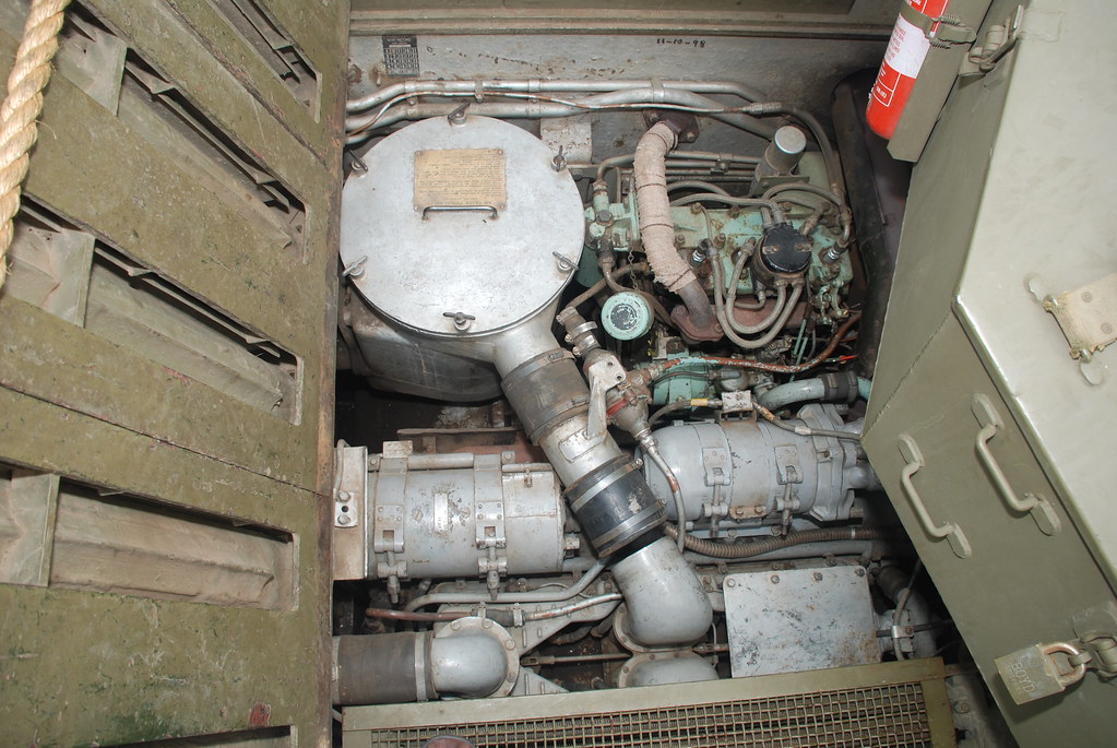

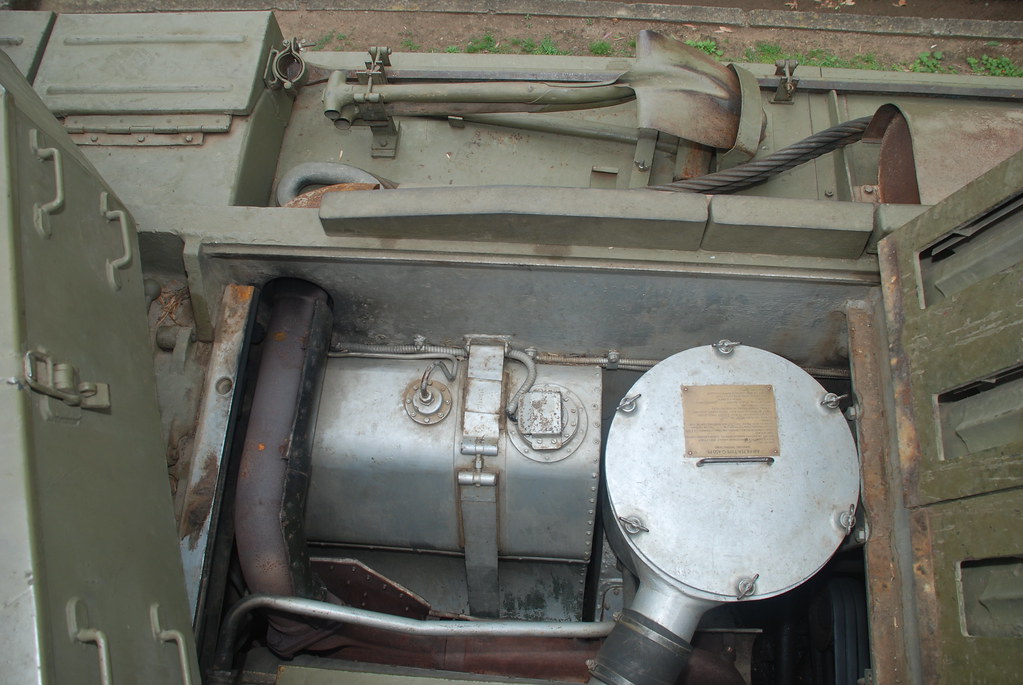

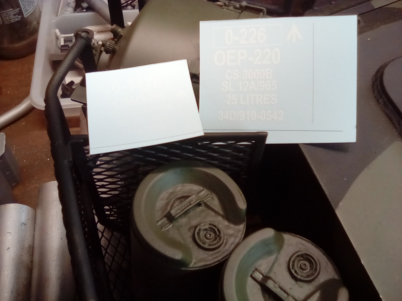

Anyone know what the air cleaner plate says?

This file started life as the main body for a 1/4 scale oil drum. It will now be the sliced body for our Centurion air cleaner

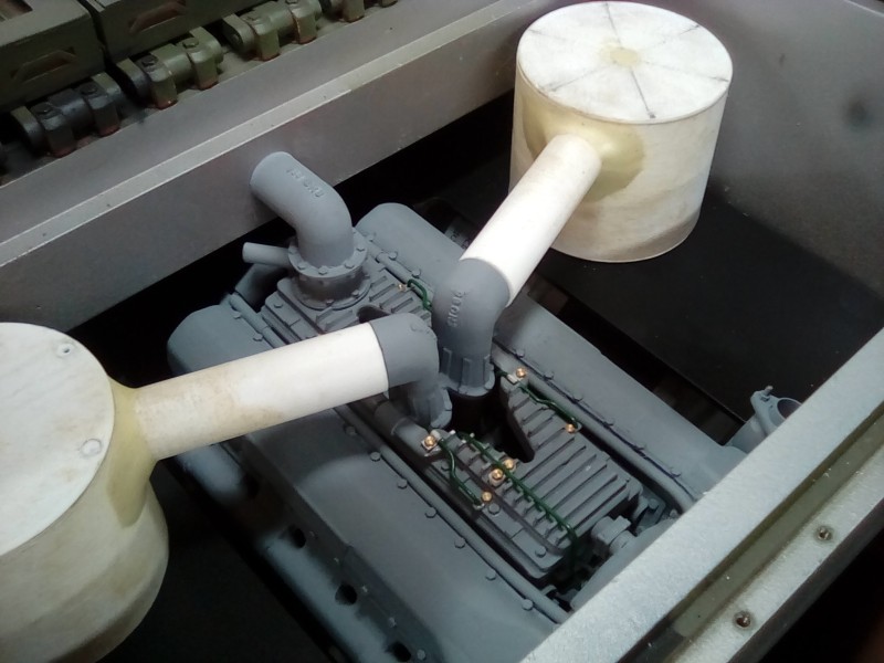

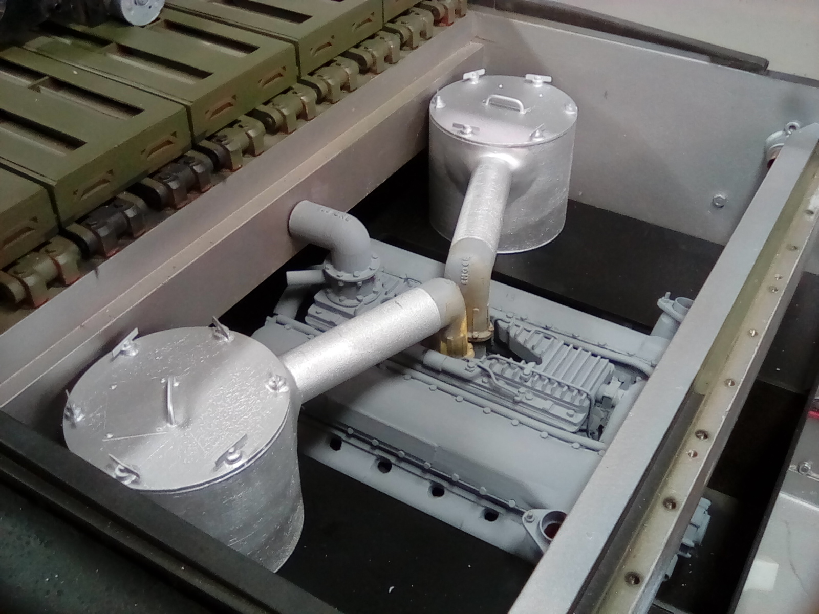

Re: Mr Dawe's Centurion.

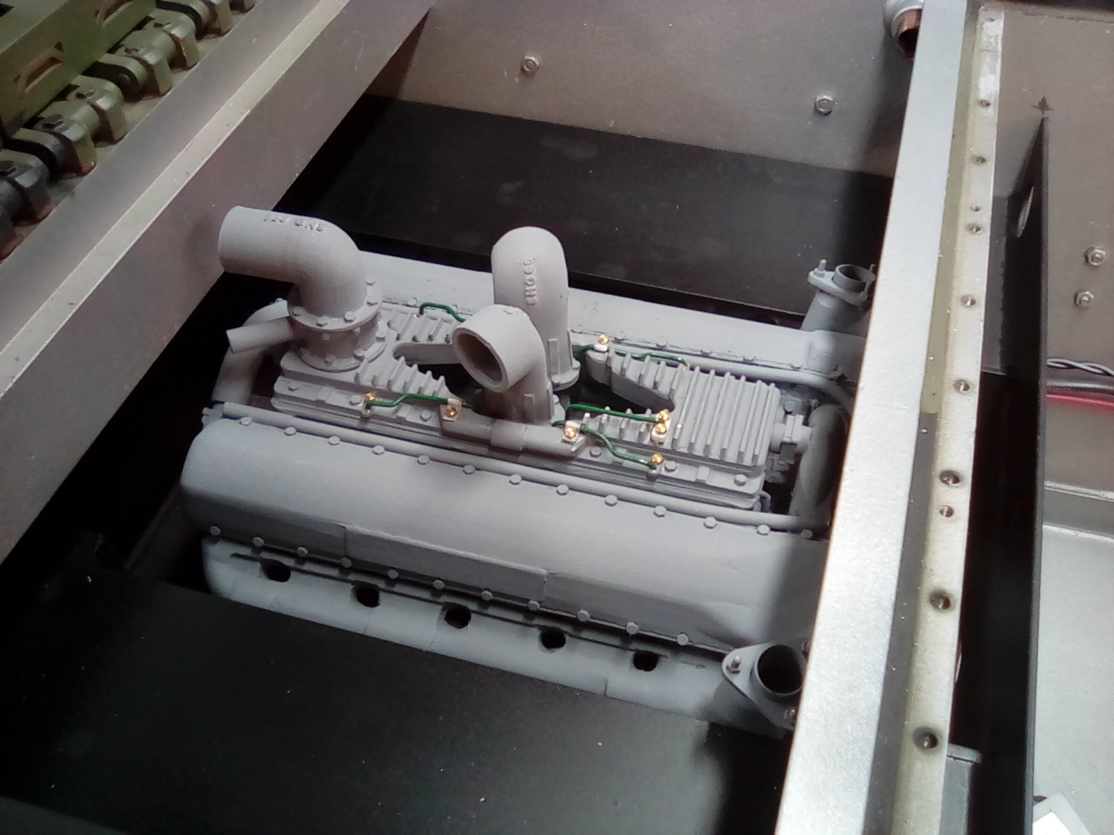

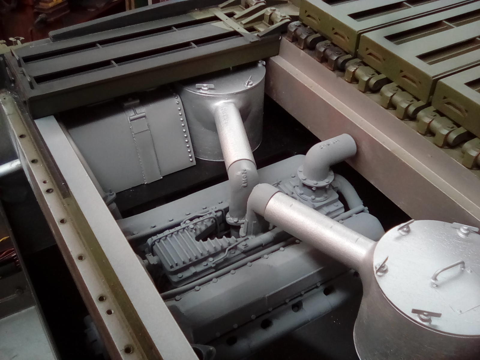

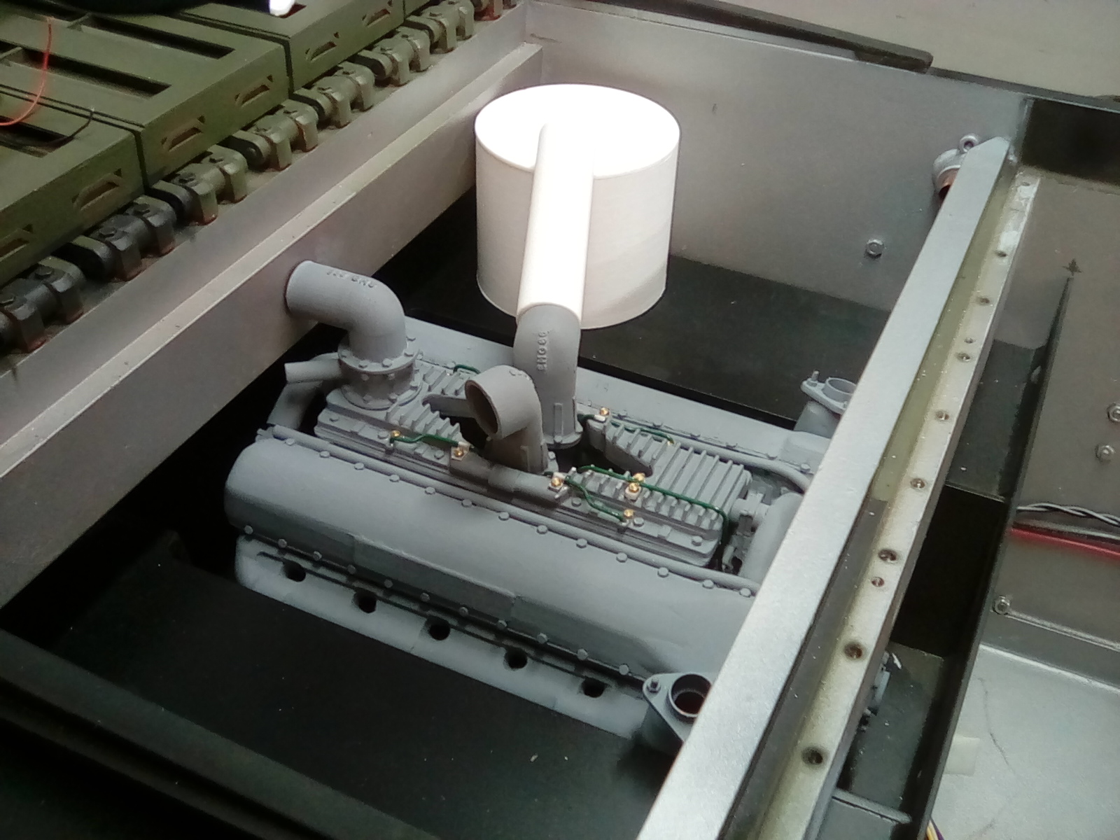

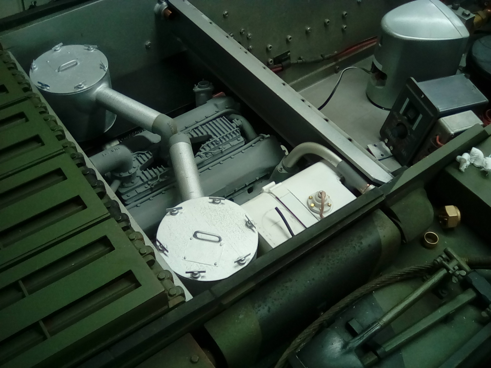

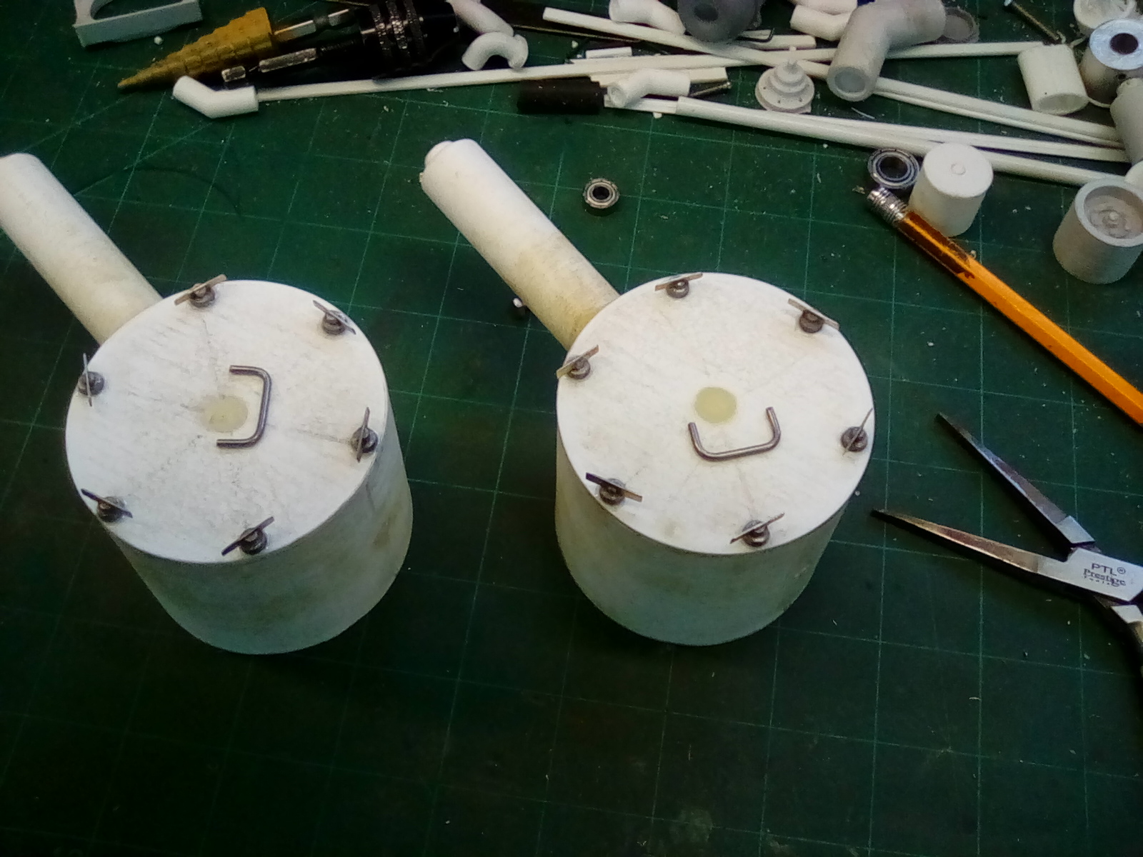

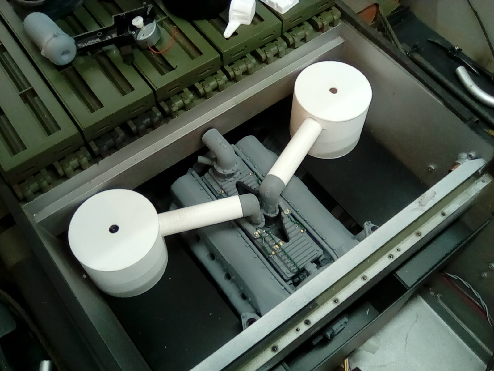

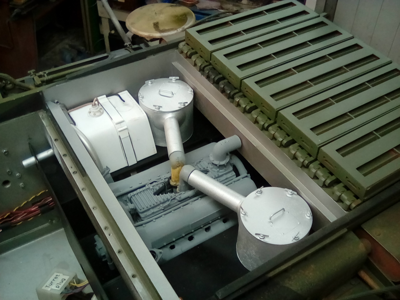

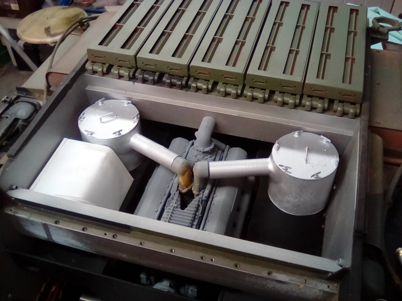

The air filters are coming along

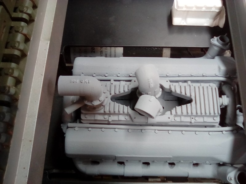

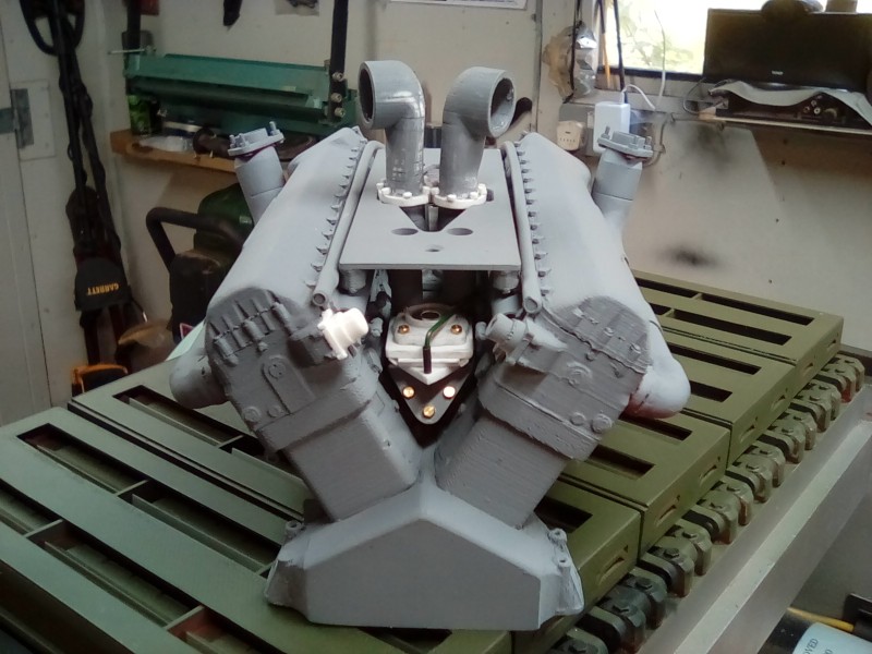

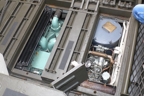

Some may remember my Chieftain's engine bay

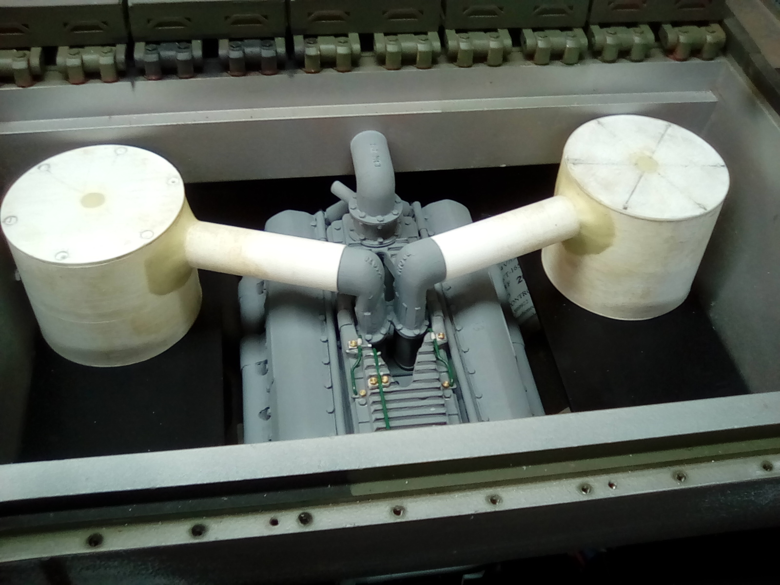

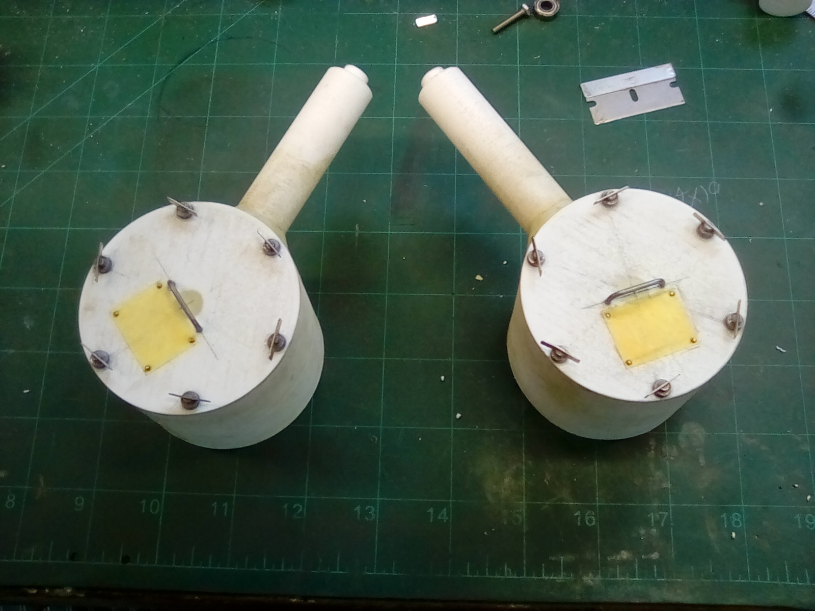

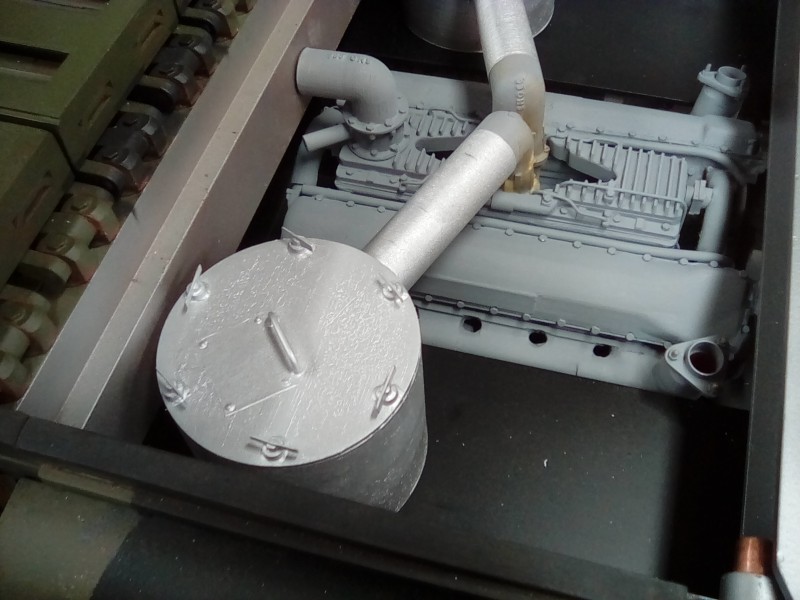

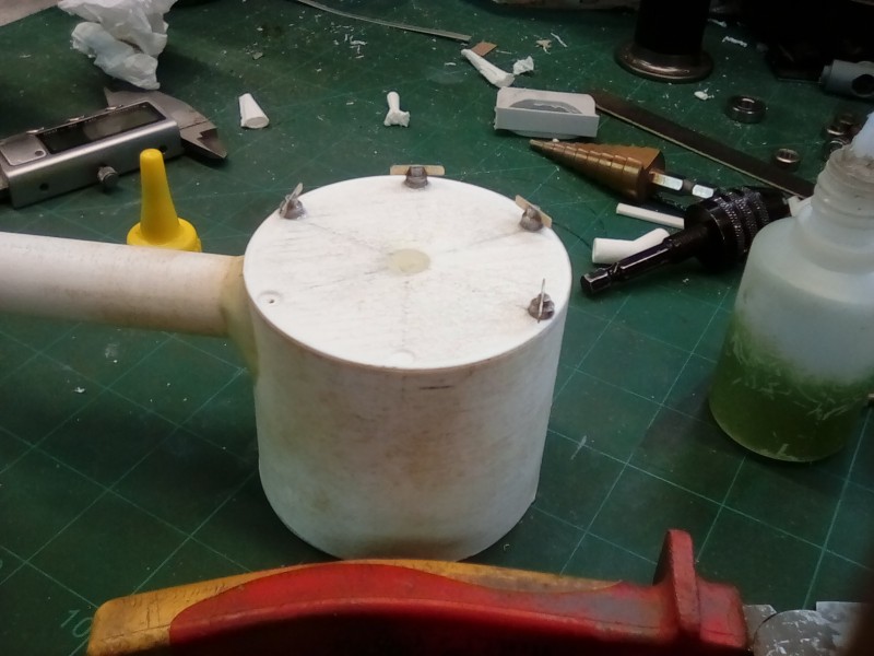

The air filter bins all printed and the tops cleaned up and bonded in place

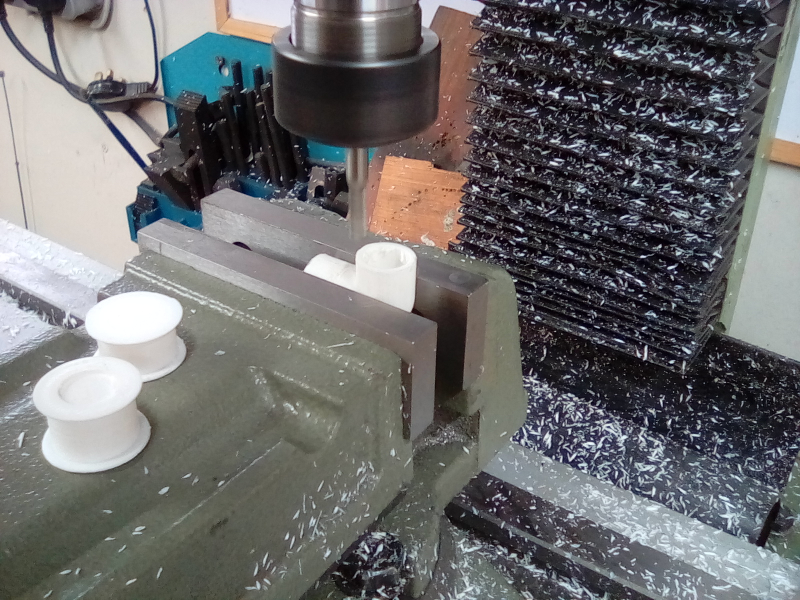

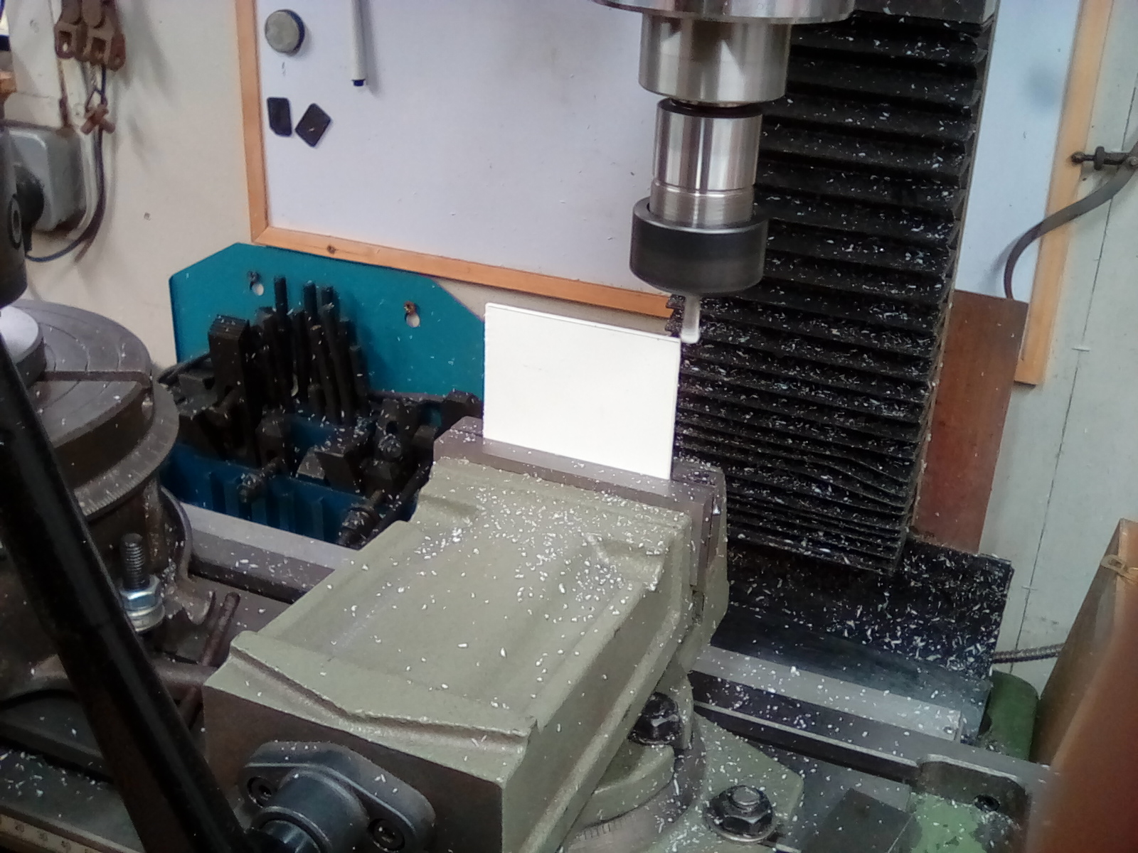

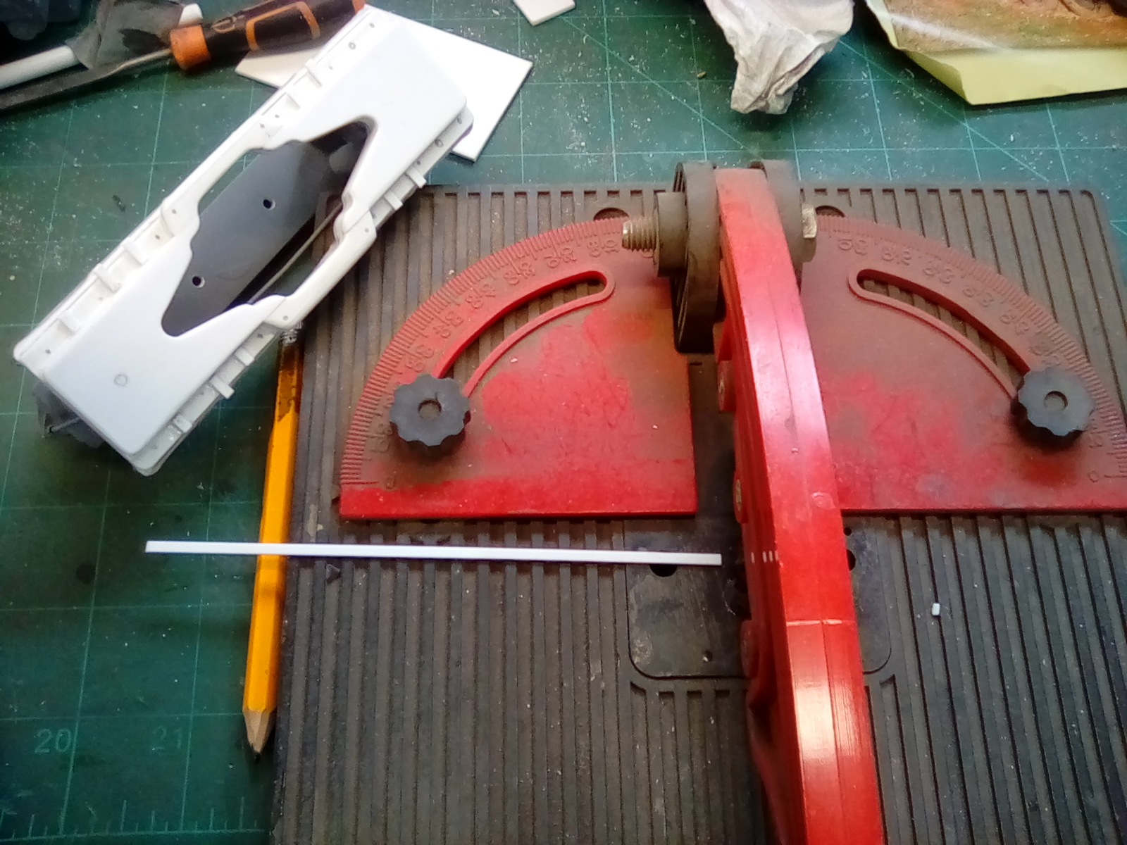

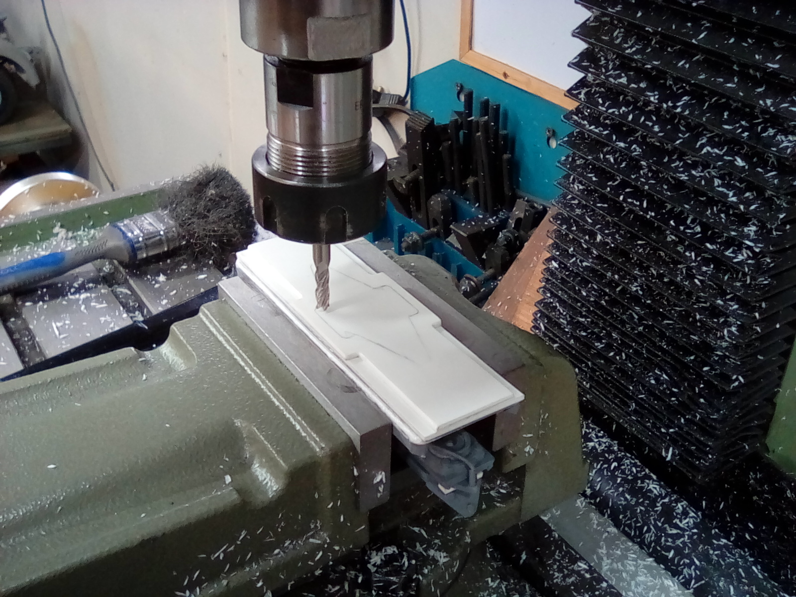

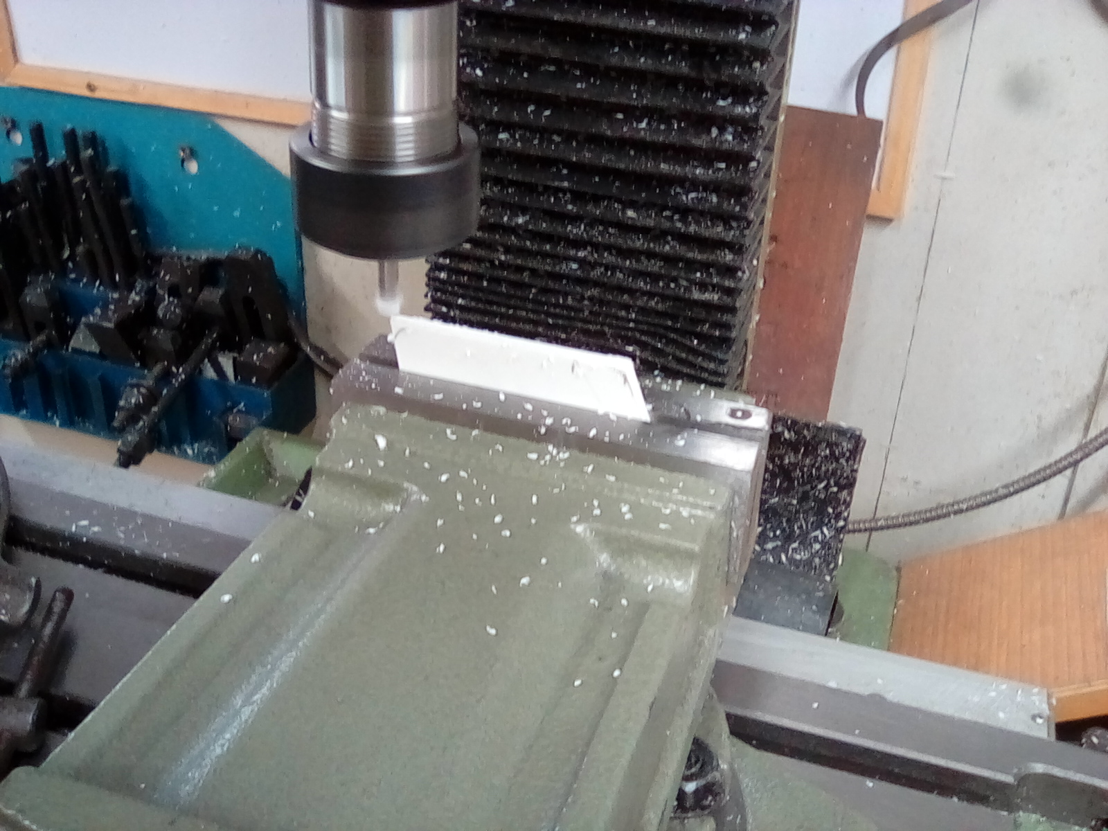

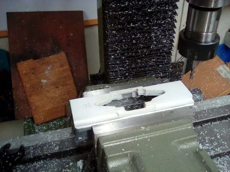

I think I will cut these on the mill

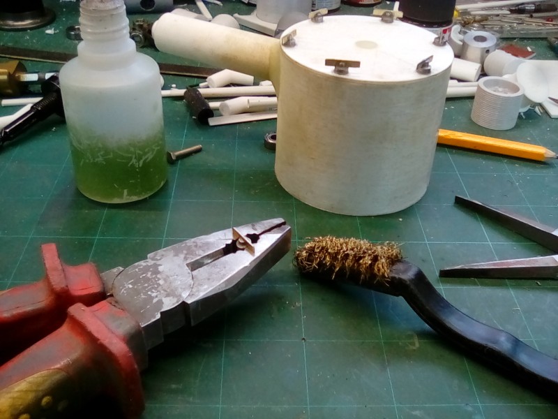

Leaving the joints loose helps get the perfect fit, once in place and I'm happy cyno can be applied
The tiny thumb screws x 12 needed

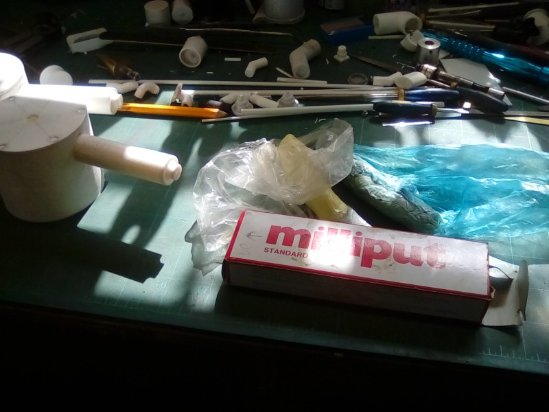

Milliput required to replicate the cast ali joint fillet
While this lot cures I shall be turning the thumb screws in steel and brass
Ugly things right now, milliput will give us the look we are after

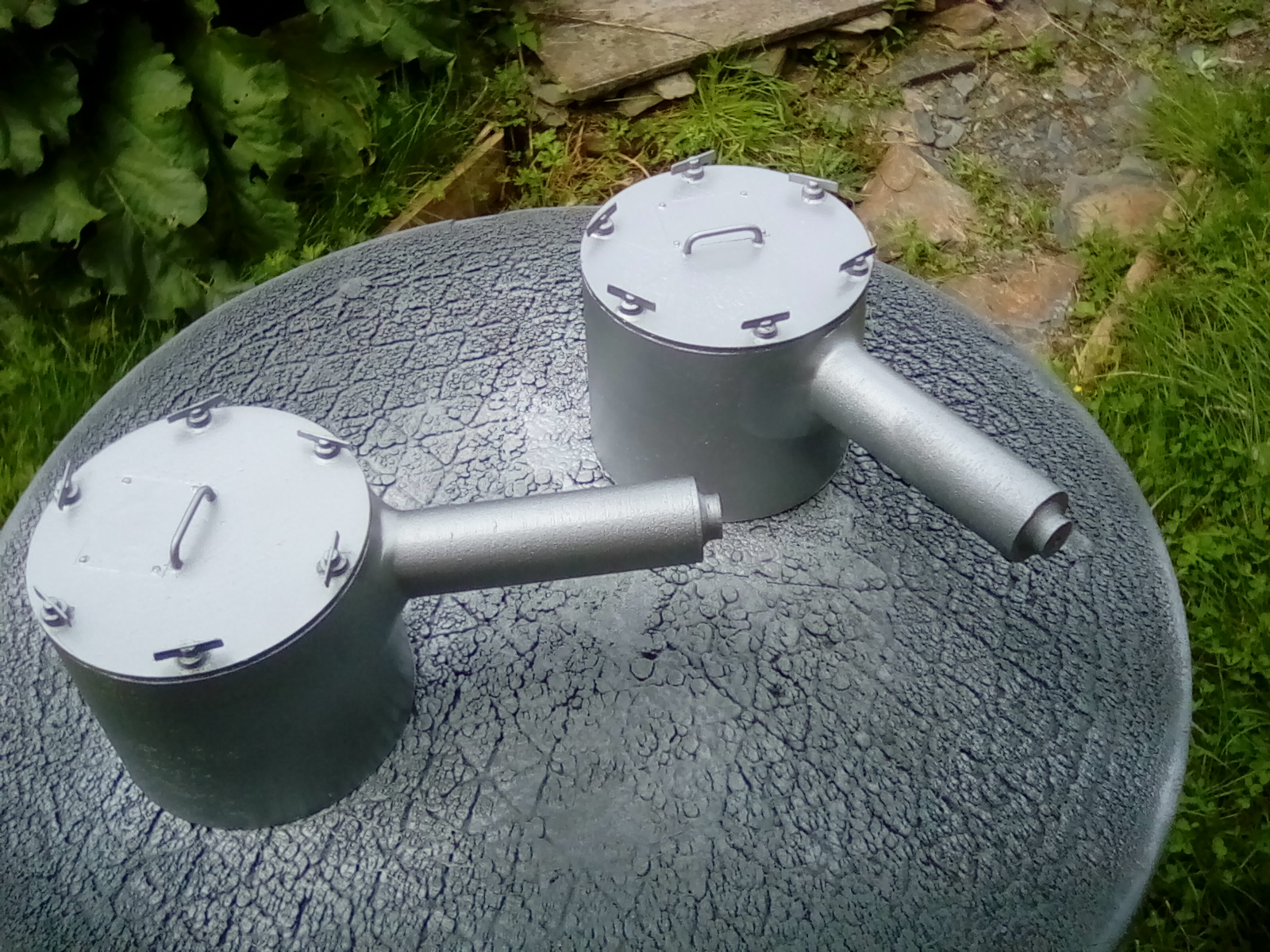

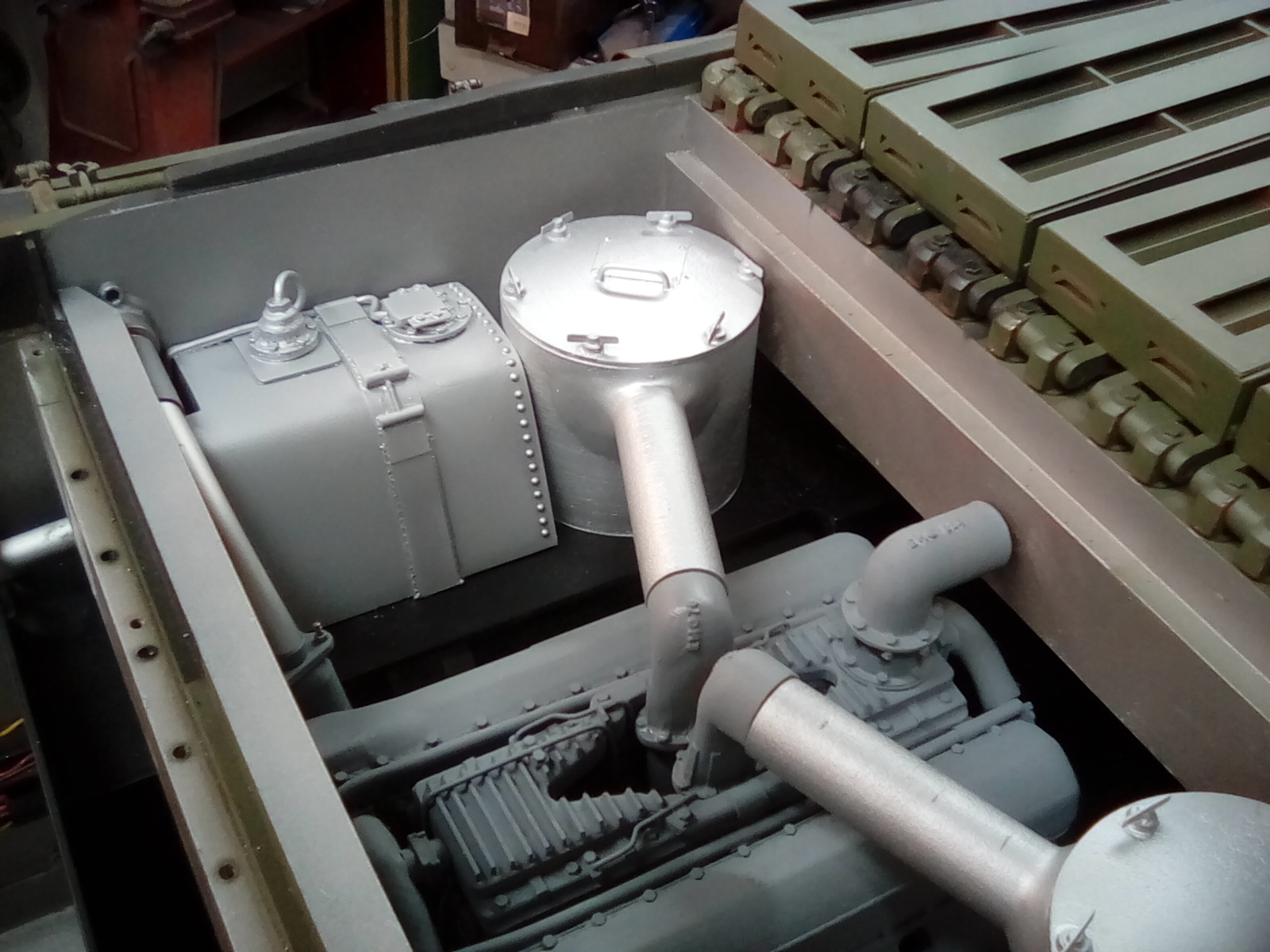

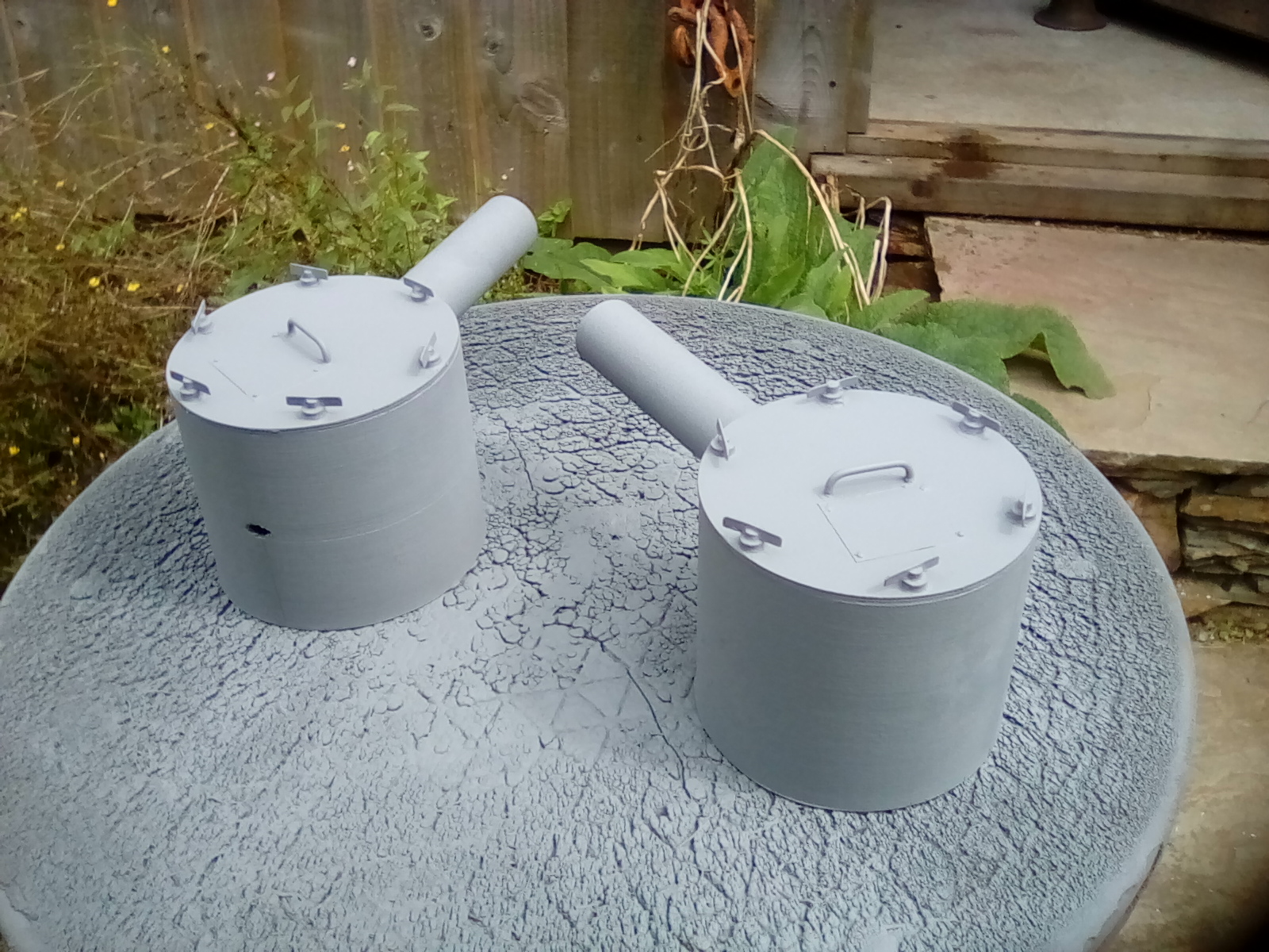

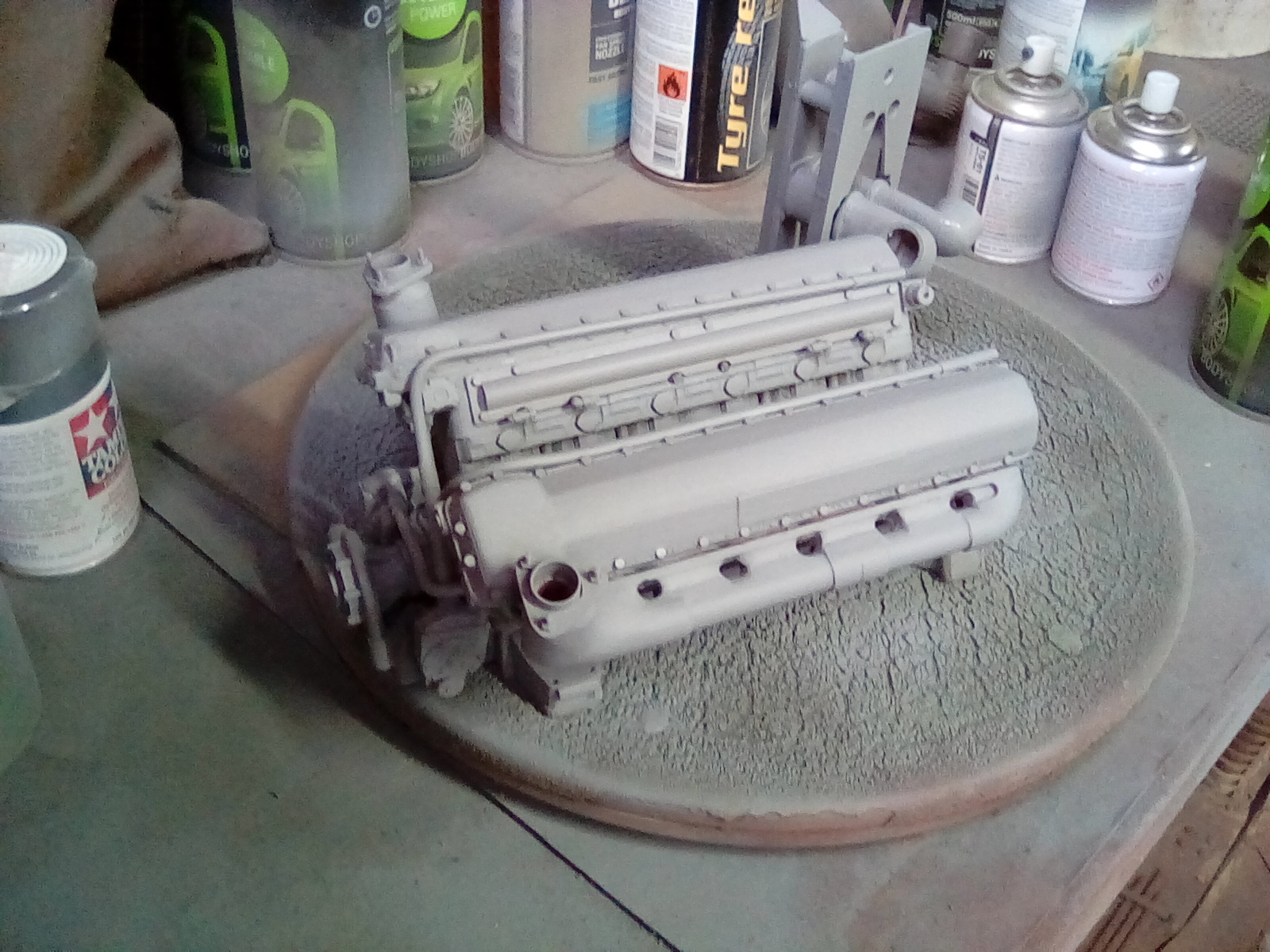

Grey primer
Grey primer
Aluminum paint
Aluminum paint
I quite like the cast ali texture

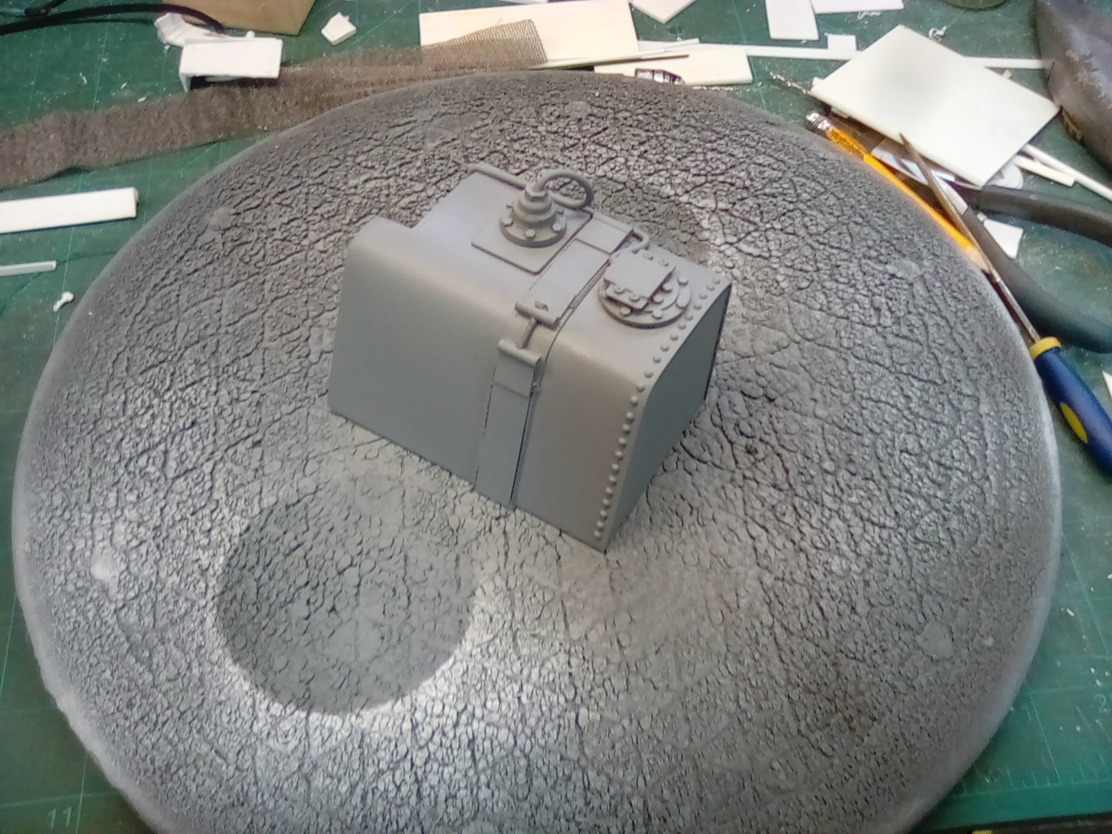

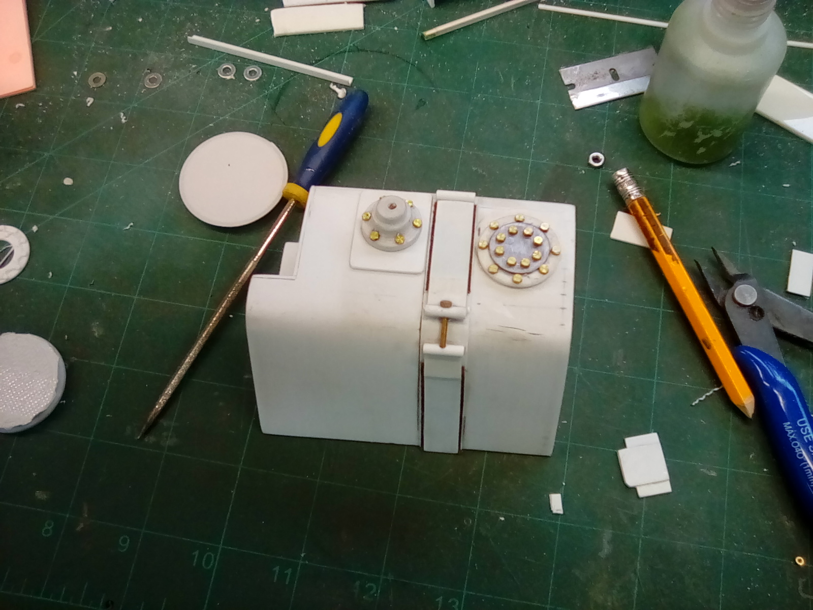

Moving on to the nr side fuel tank and that dinky engine for a bit.
More printed parts
More printed parts
Not very exciting but all necessary work
I actually hold the bigger pieces with carefully placed fingers

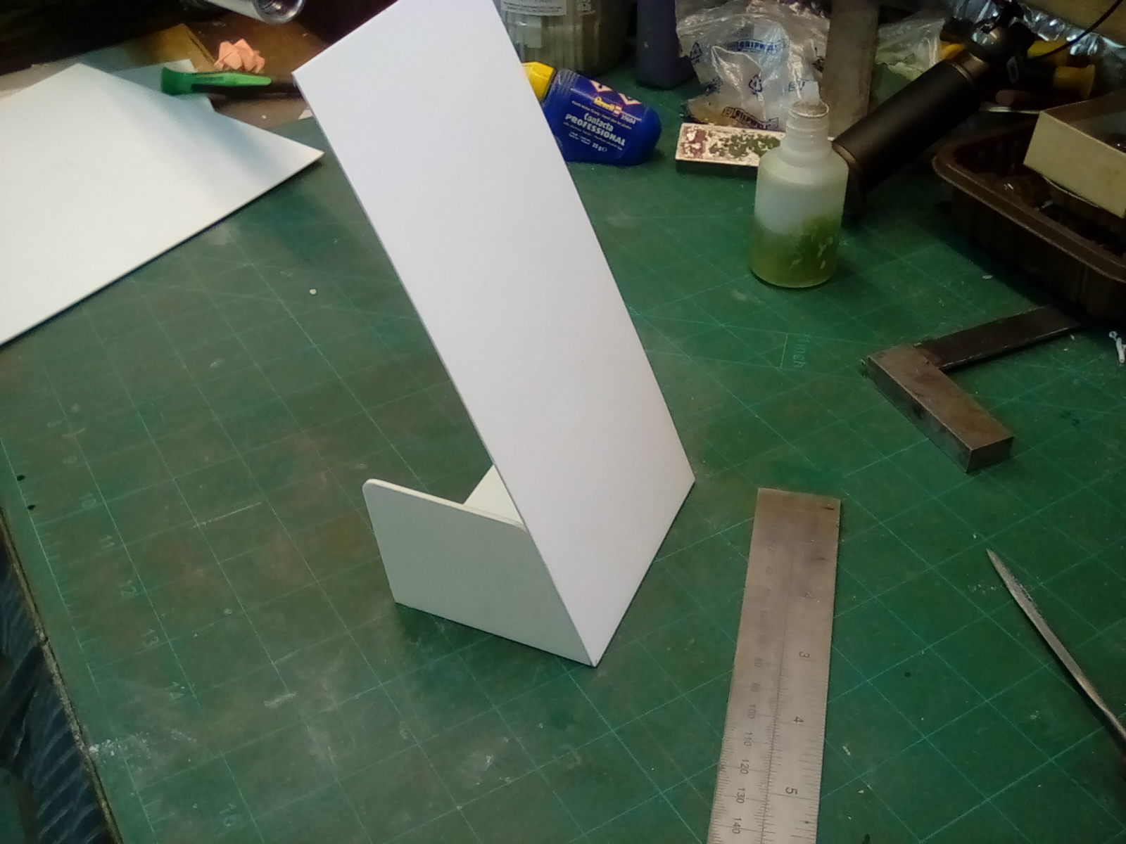

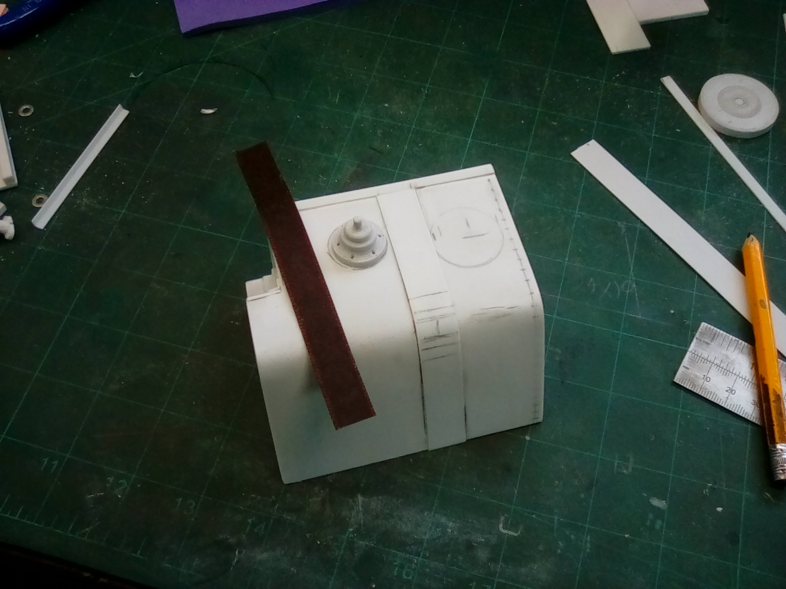

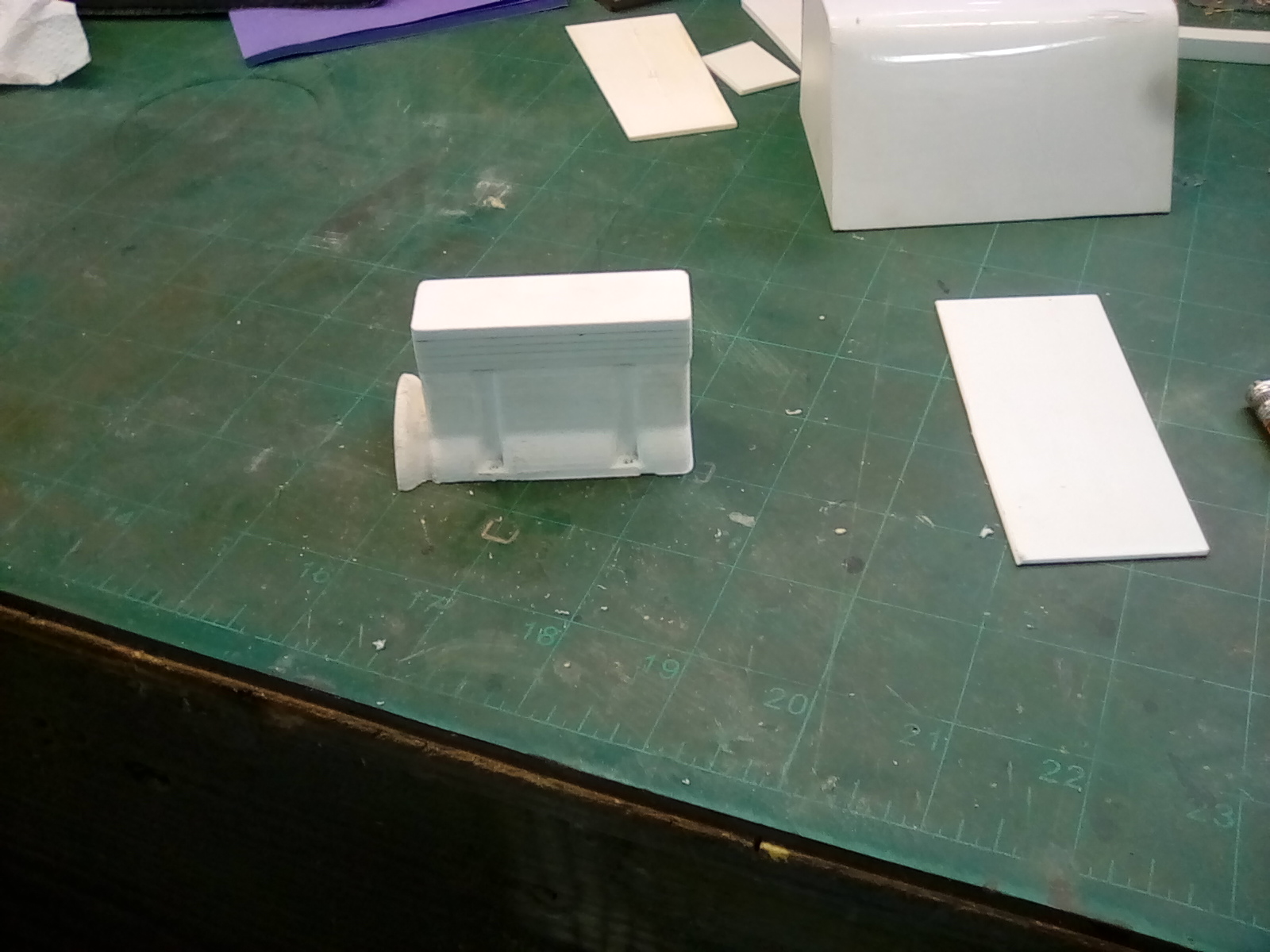

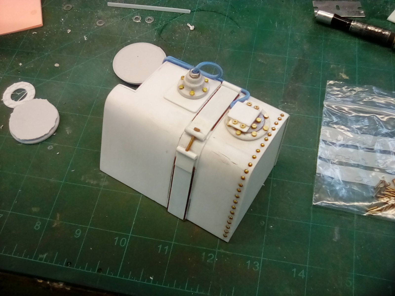

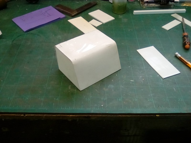

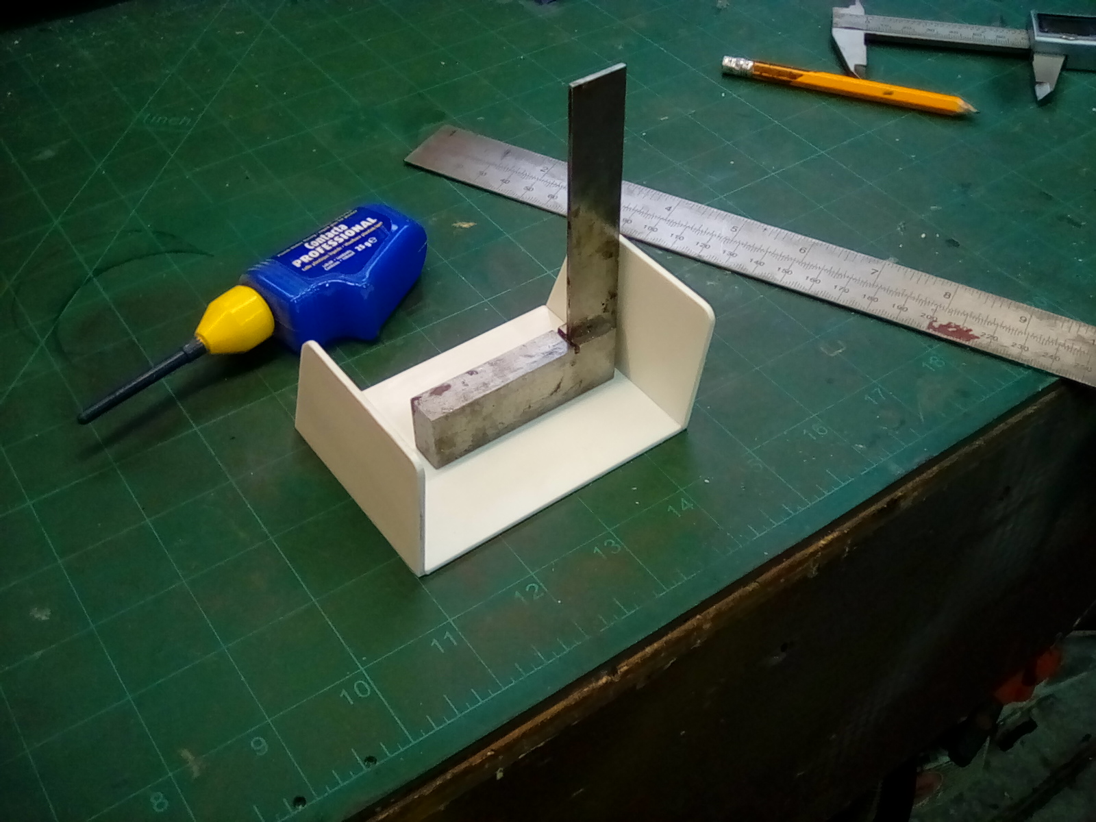

Bottom and sides of our sliced down fuel tank bonded nice and square
One stage at a time or it will ping appart

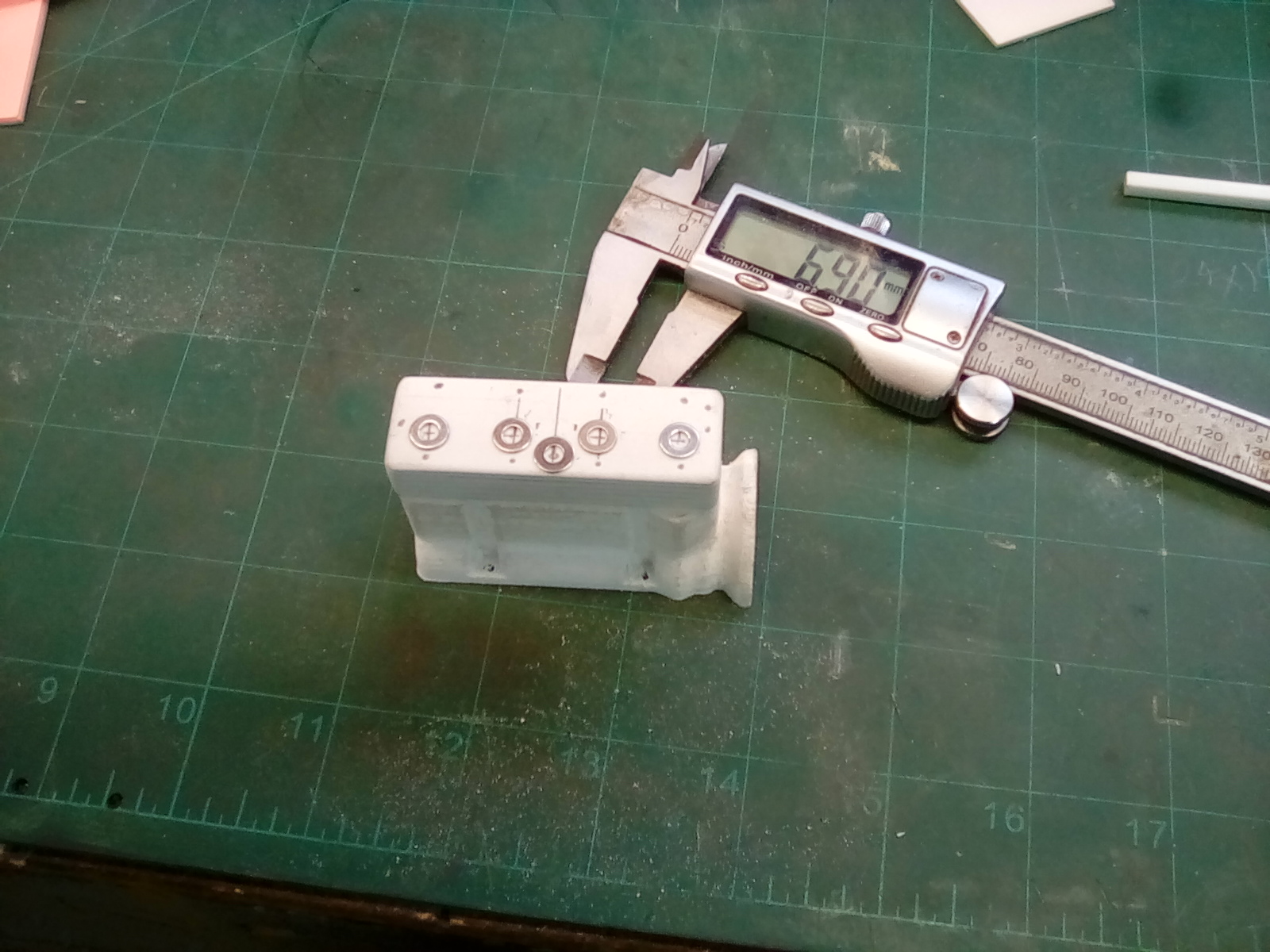

I need to make the block taller

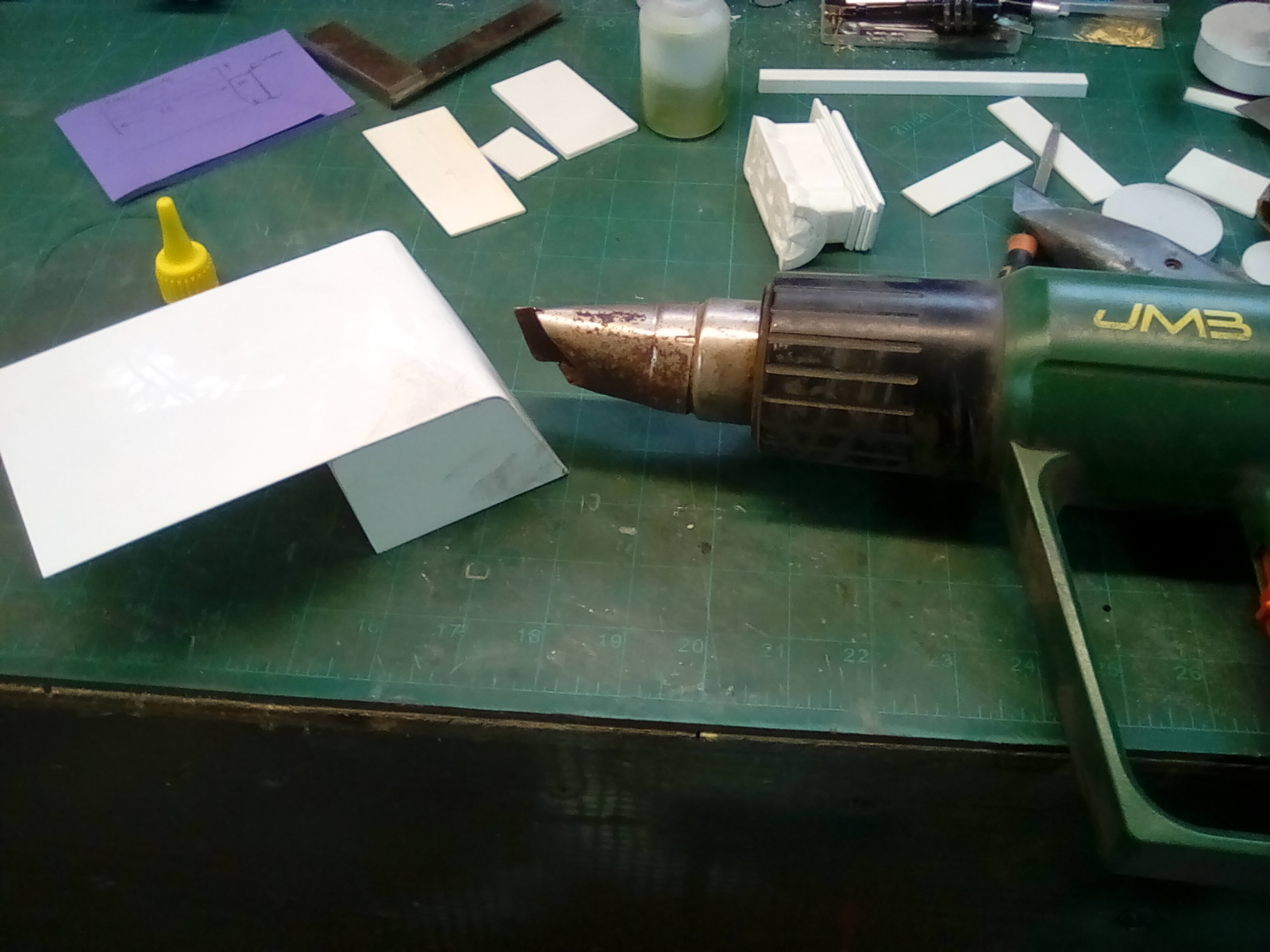

A little gentle heat will help relax and shape the outer fuel tank skin

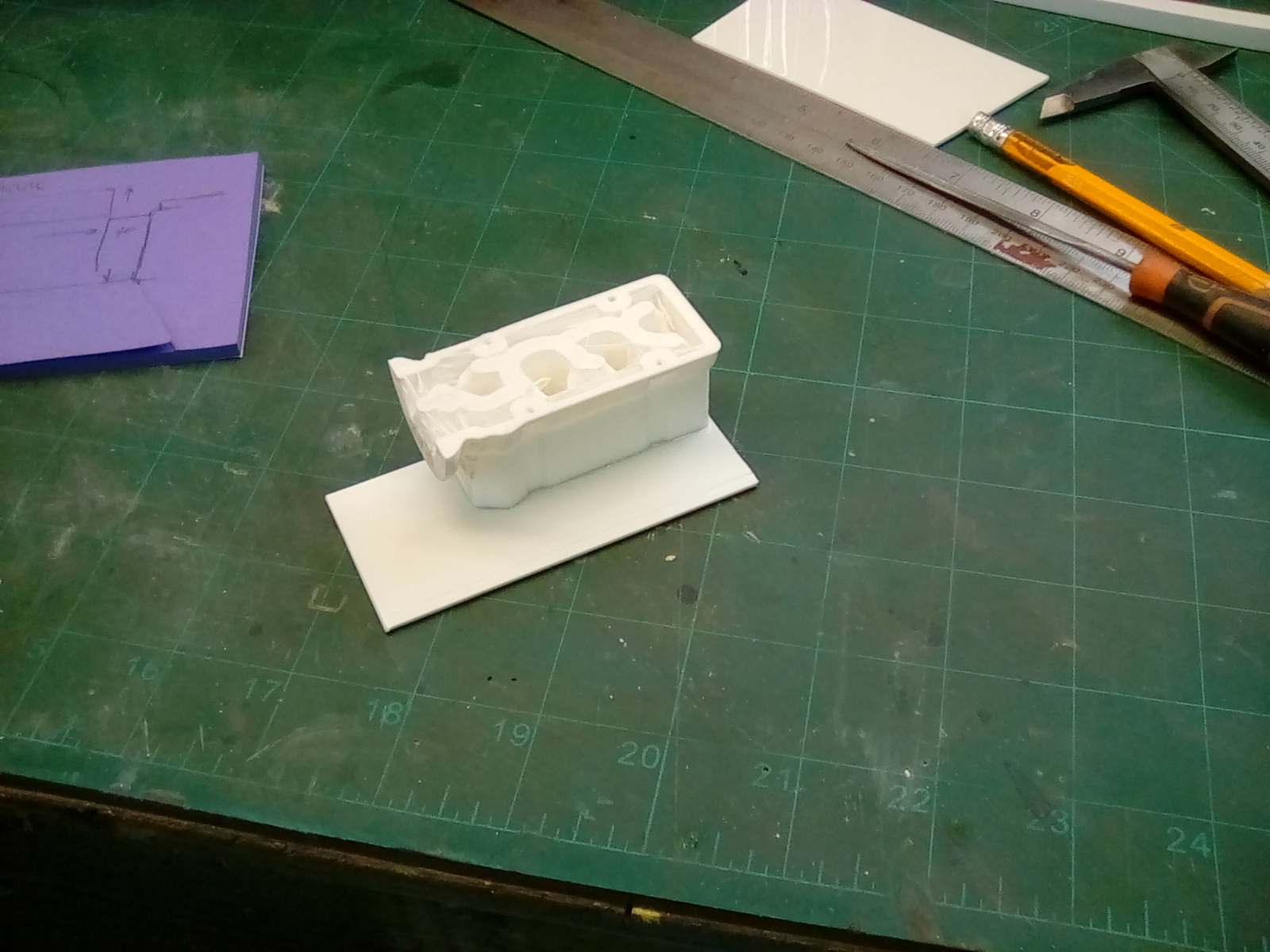

Lots of off cuts used to make up the head
Now I just need to be patient and let it cure for a bit so I will carry on with the gue
That's more like the profile

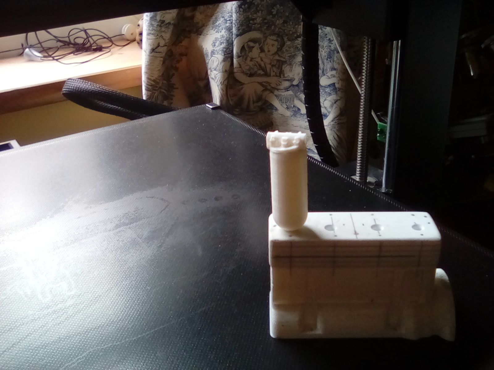

Setting out the spark plug positions

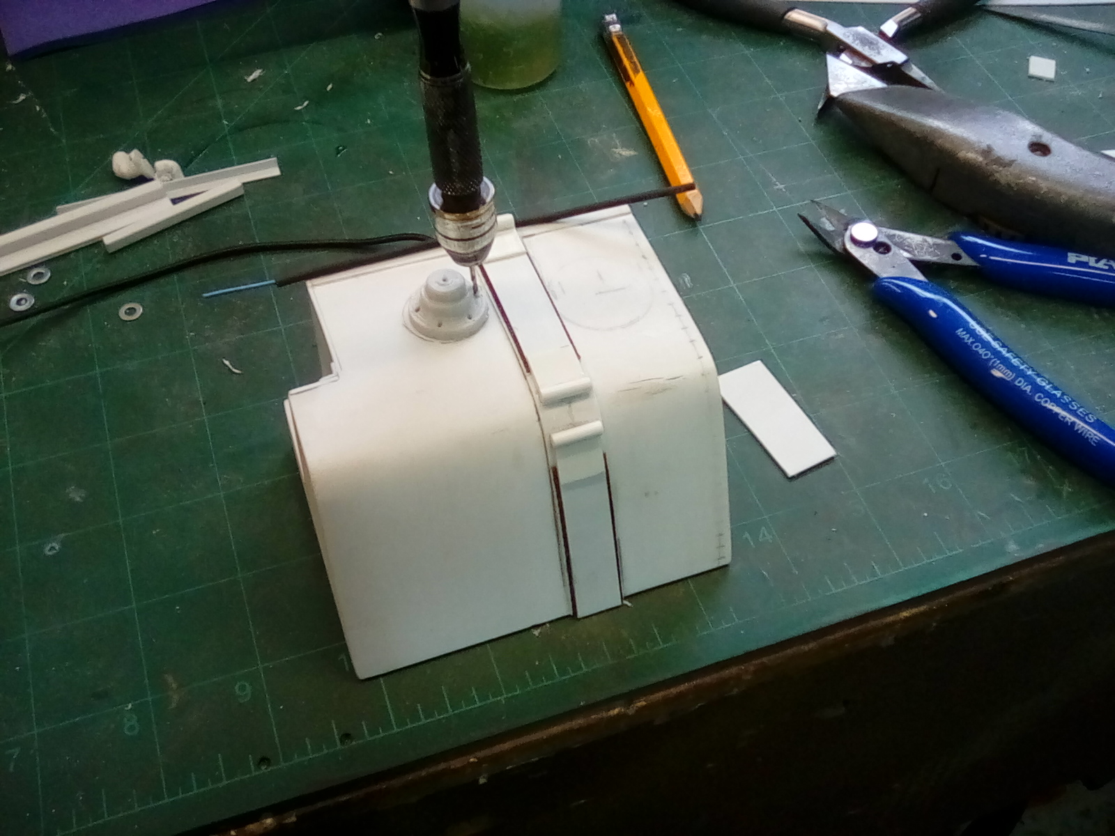

I need to let one corner of the fuel tank in so that it misses the exhaust tee piece
There's a lot of tiny parts involved in this gue

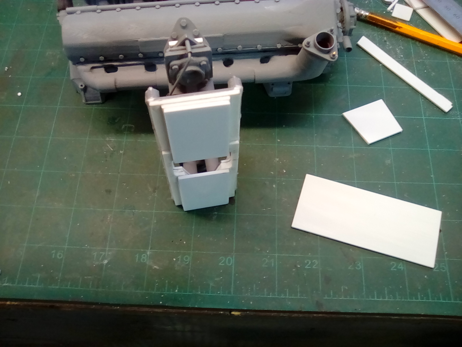

Your daily update , I would normally spend around just 3 hrs a day in the workshop , sometimes am sometimes pm what ever my spine will allow but today was a full day.

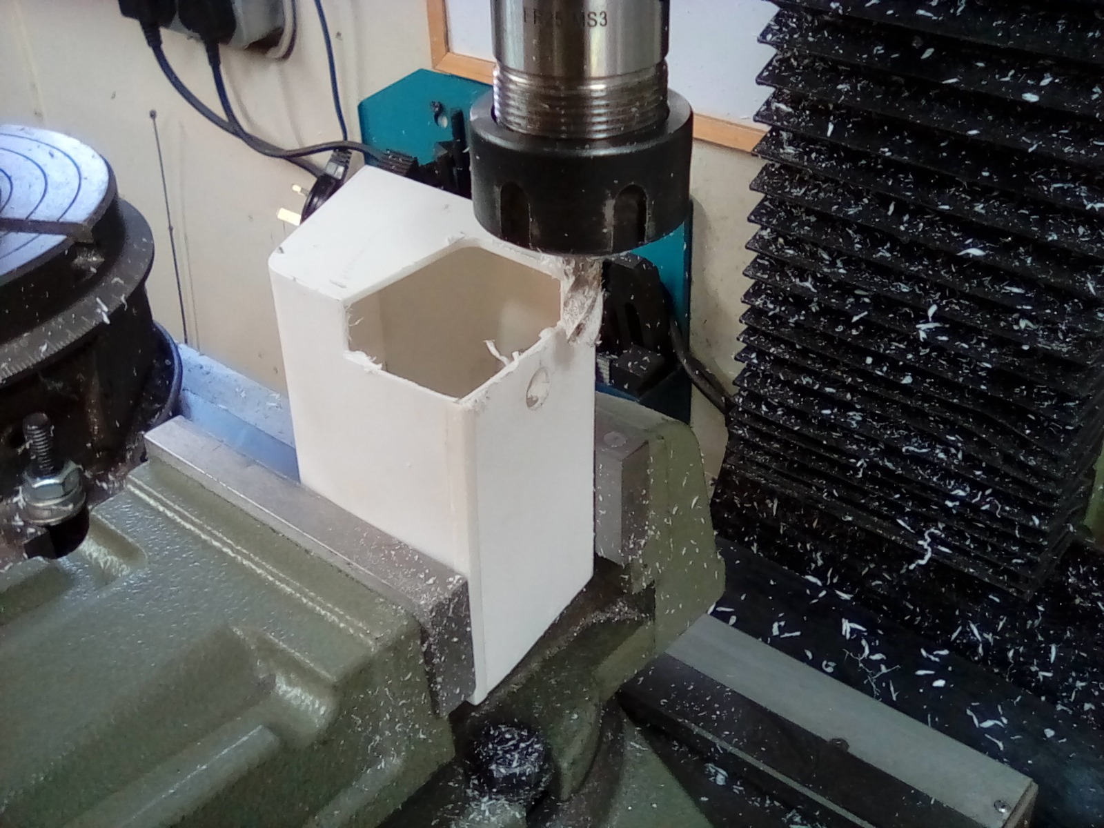

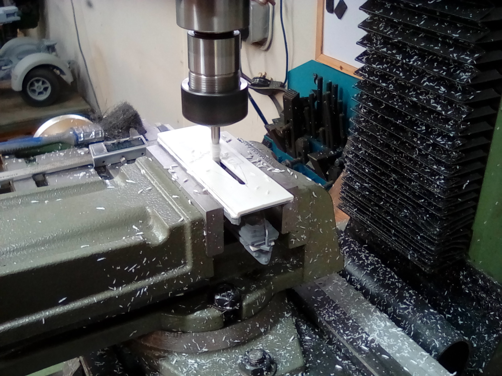

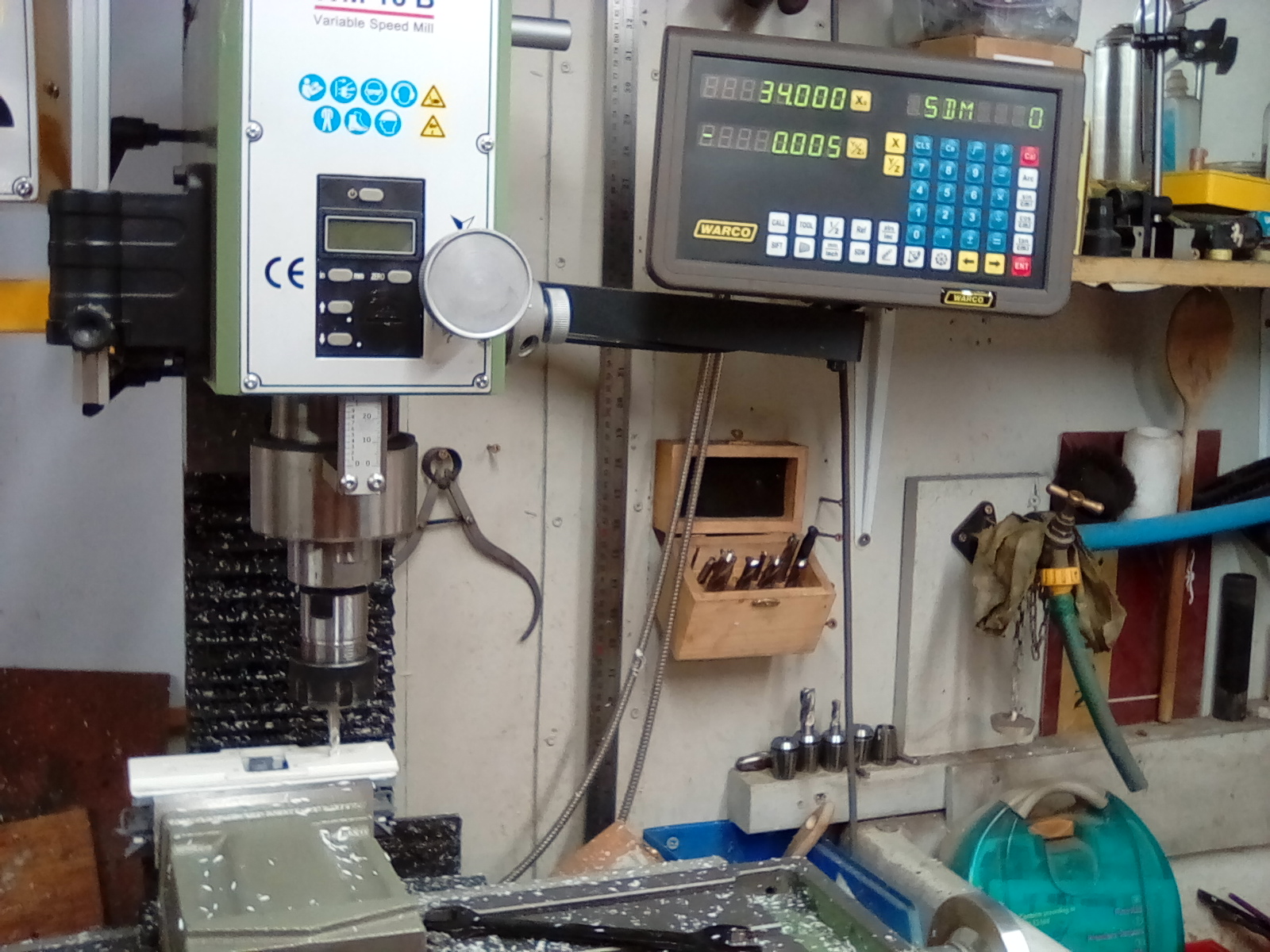

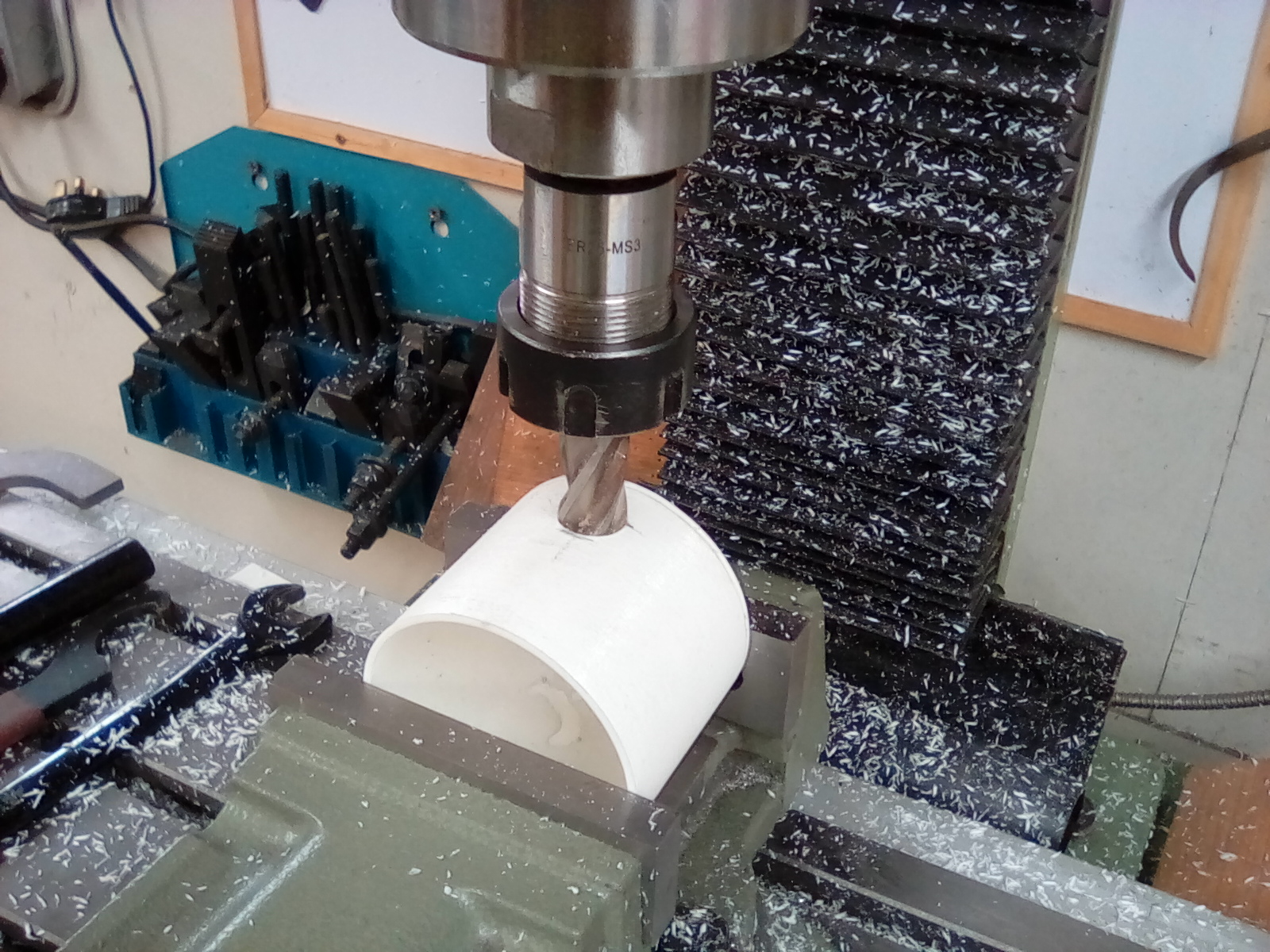

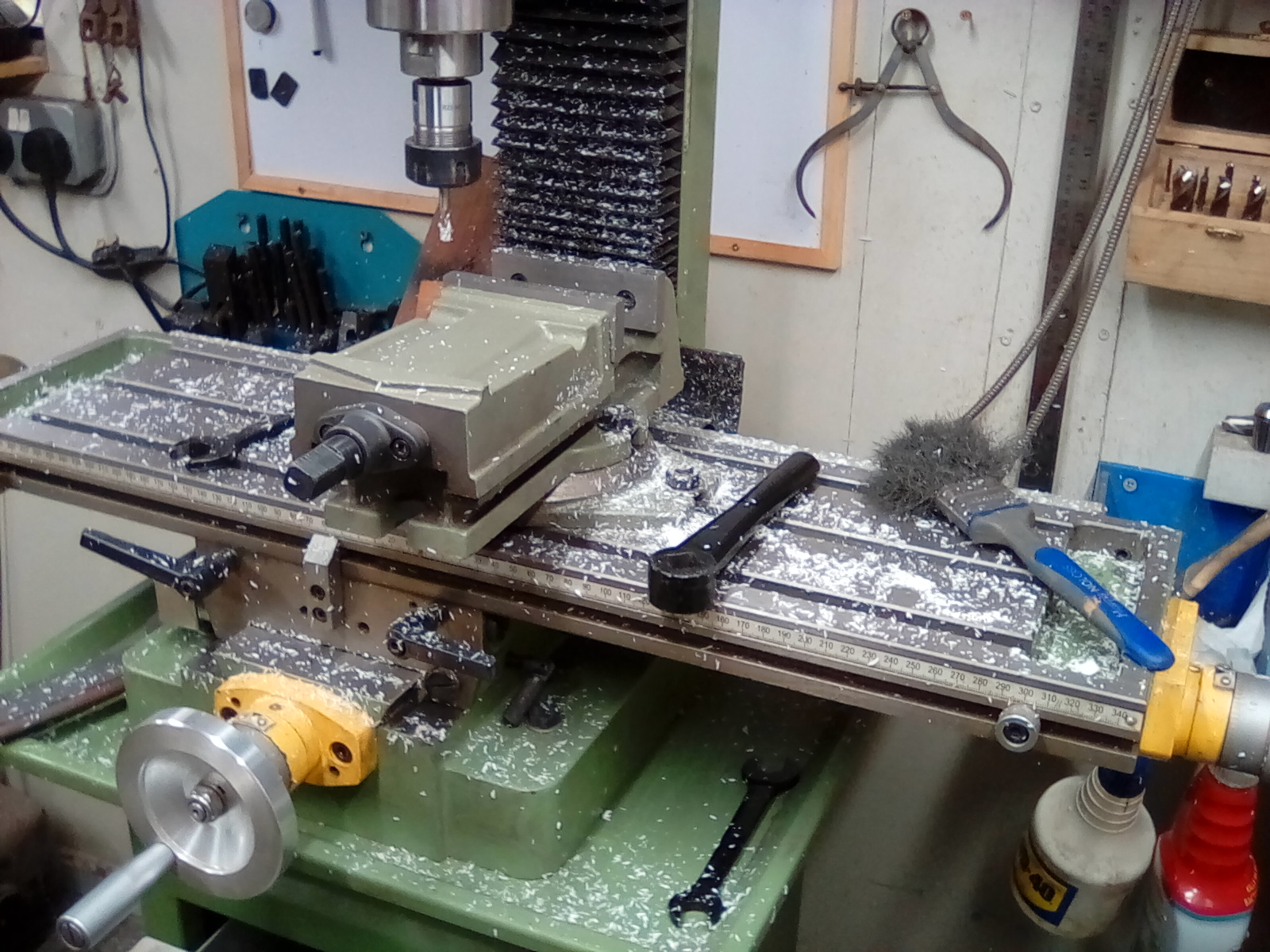

Just as well use the mill
Setting out the fittings
The exhaust cut out done
Fluffy stuff under the fuel tank restraining strap, I suppose this stopped any chaffing?

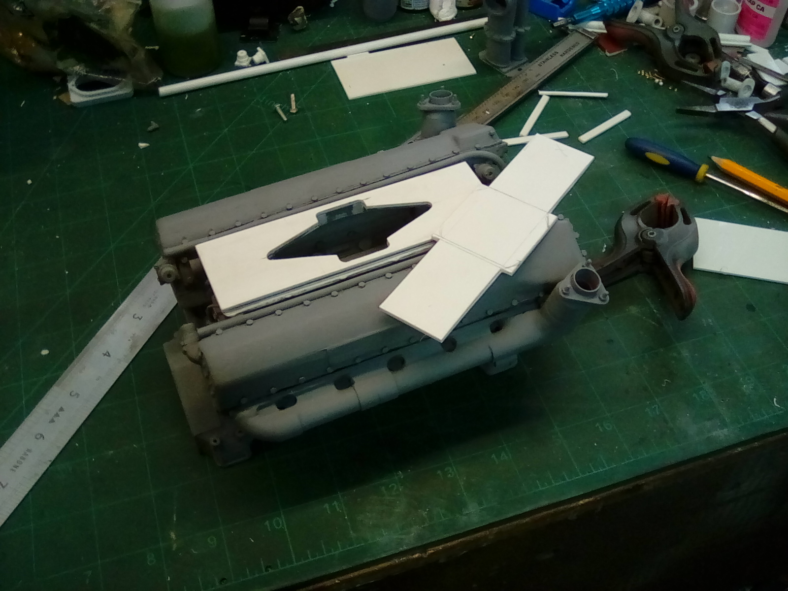

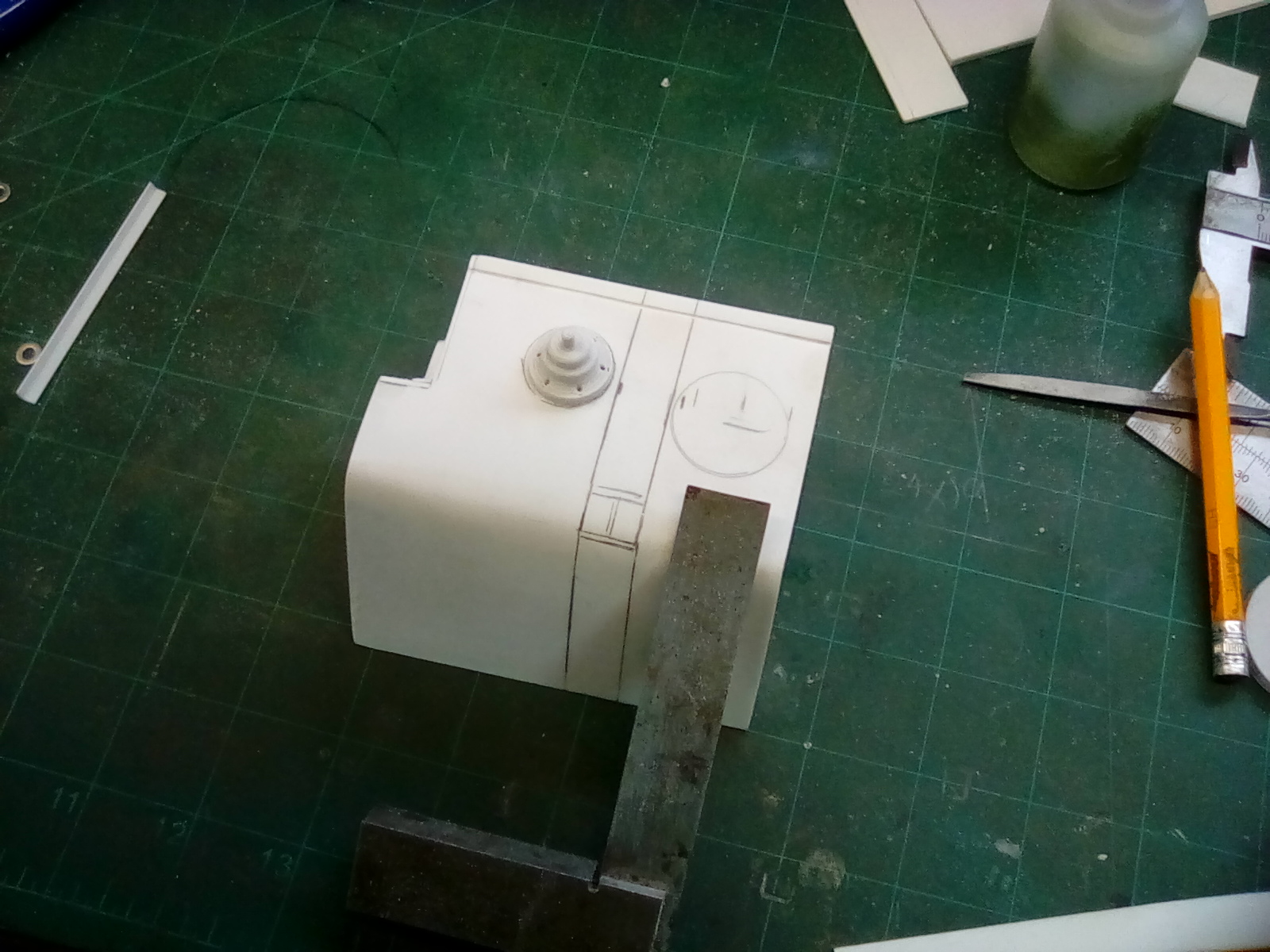

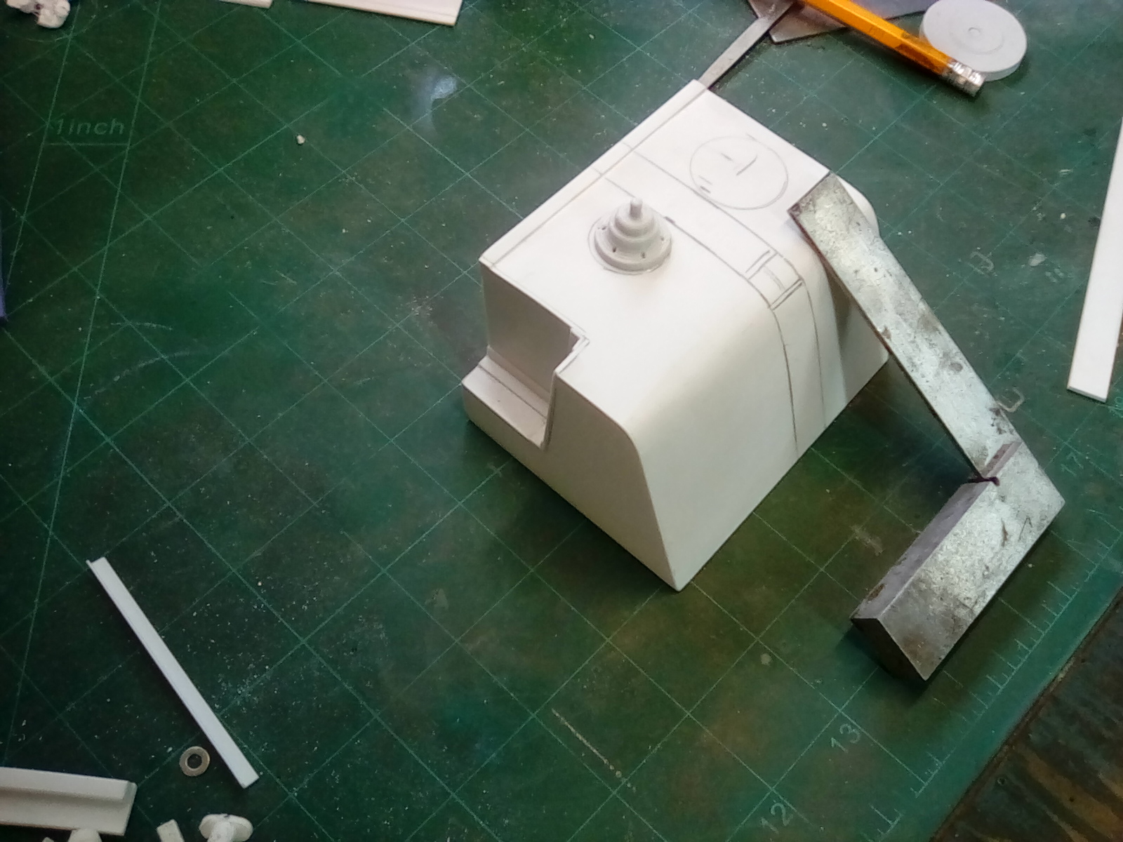

I'm not happy with the scaled depth so I'm going to remove 10 mm from the rear
I printed this at lunch time
Fuel pipe and fuel level sender next
Those are expensive rivets

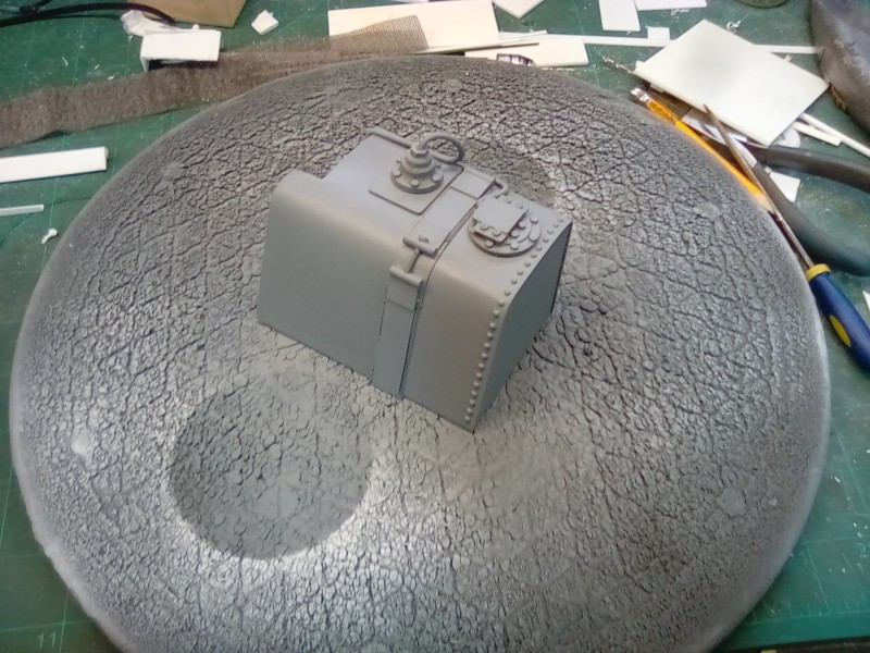

All done for now, this fuel tank would have been twice as long and twice as deep as this slice but we just don't have the room.

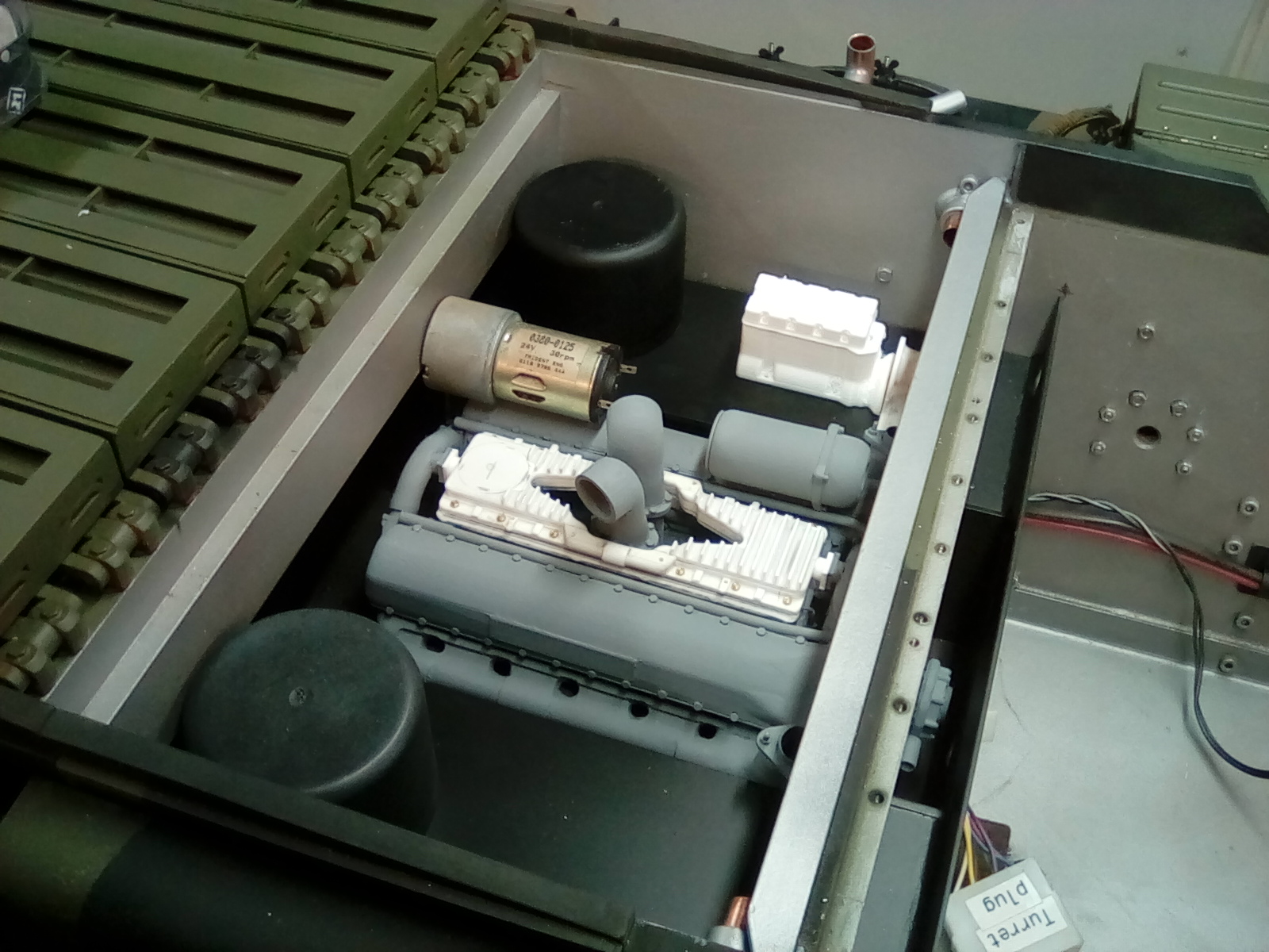

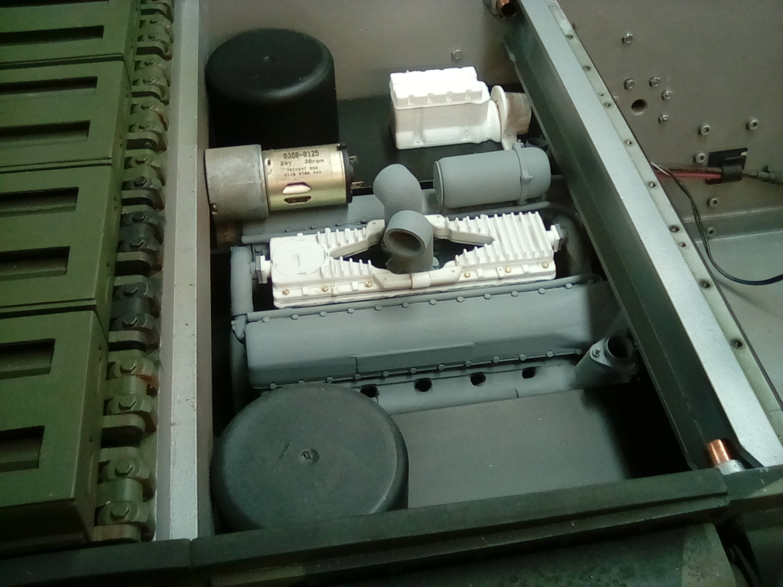

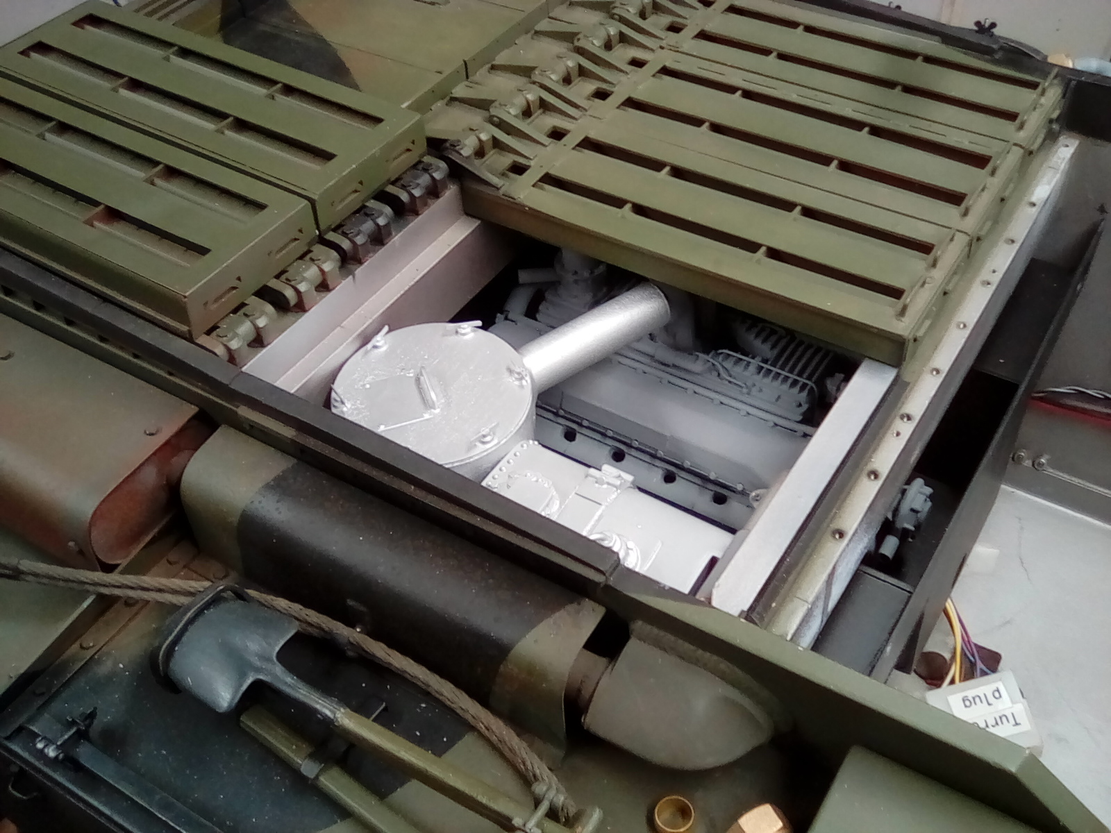

Checking for ceiling height
It's starting to fill up in there

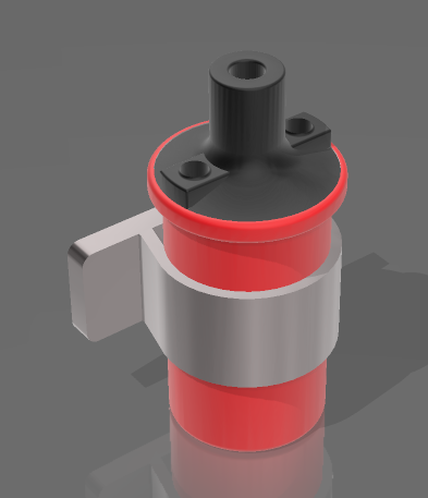

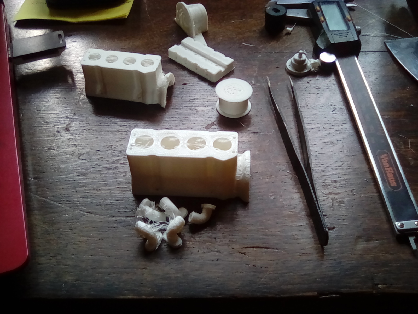

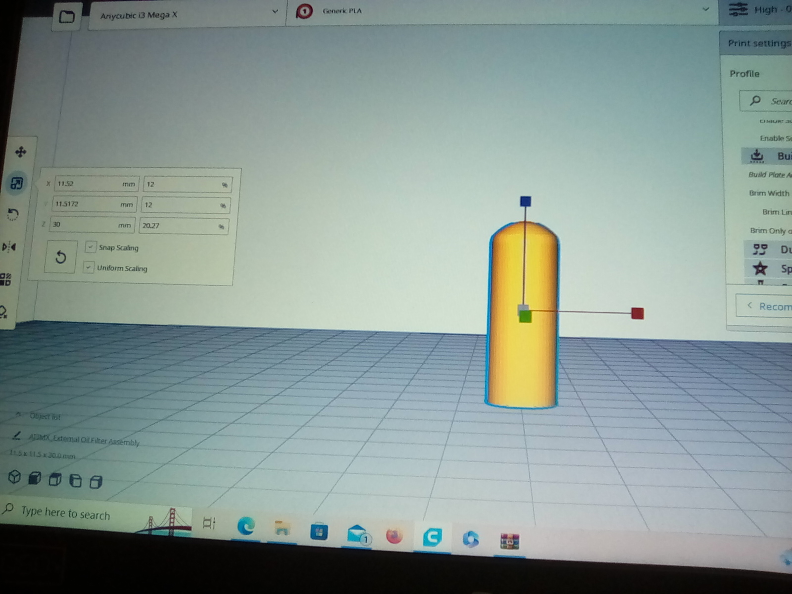

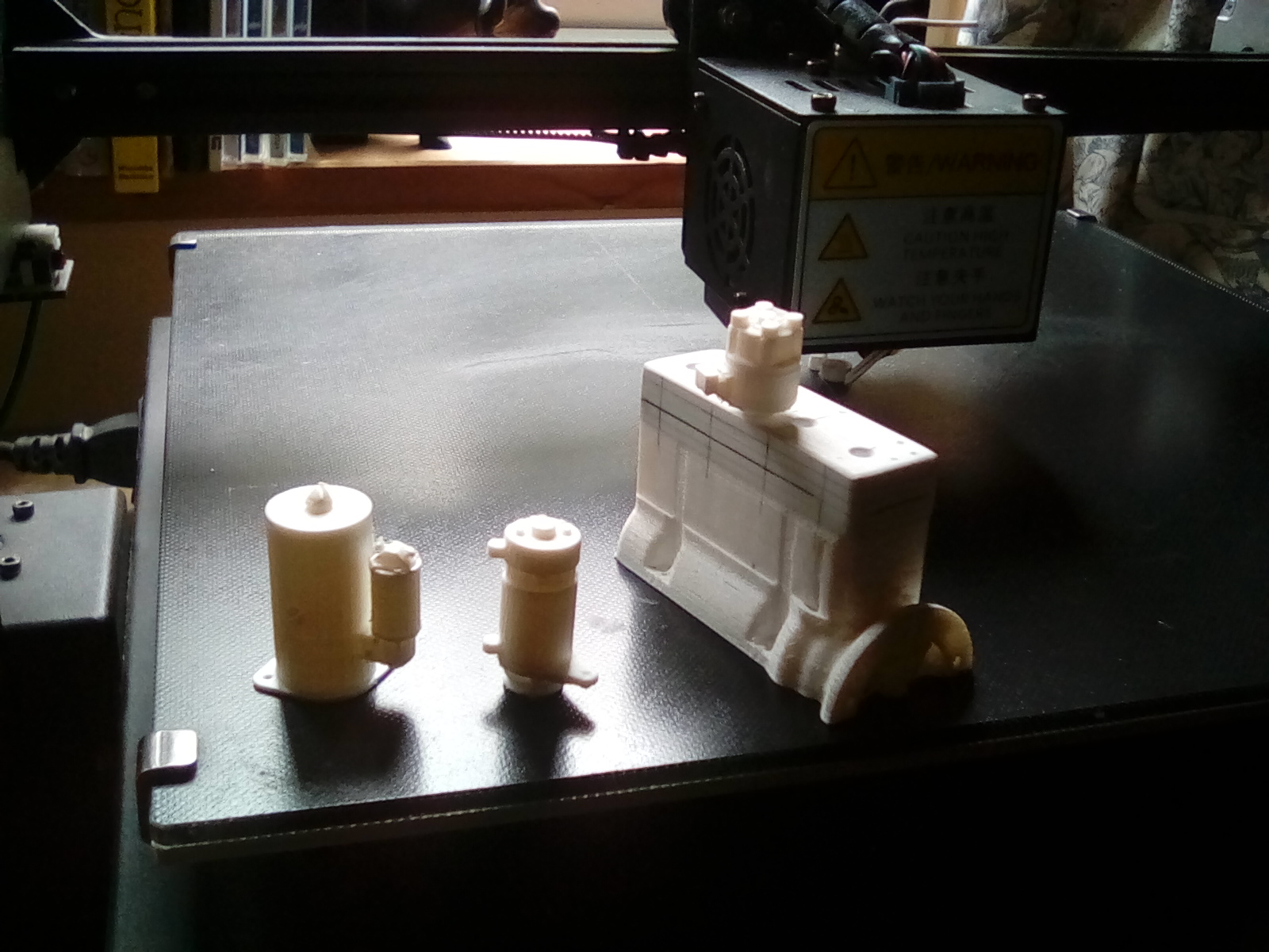

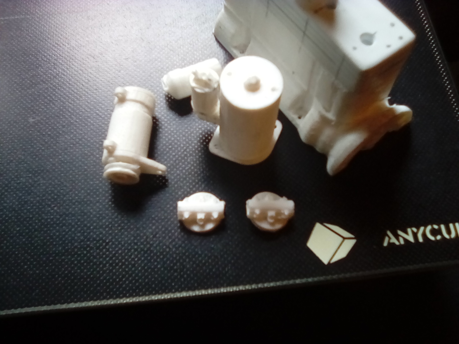

Been 3d printing parts for the Morris side valve gue engine today

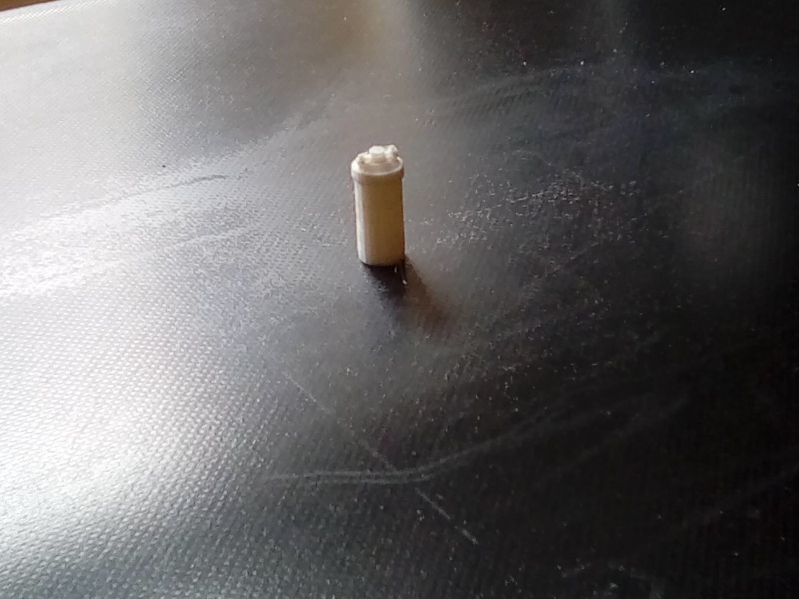

Did try printing the spark plugs but no luck

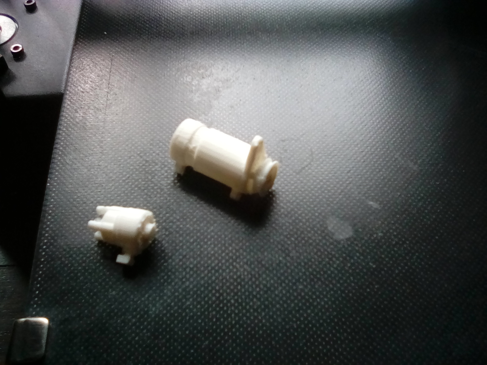

Dynamo and distributor
The distributor will need changing from vertical outlets to the horizontal exits
