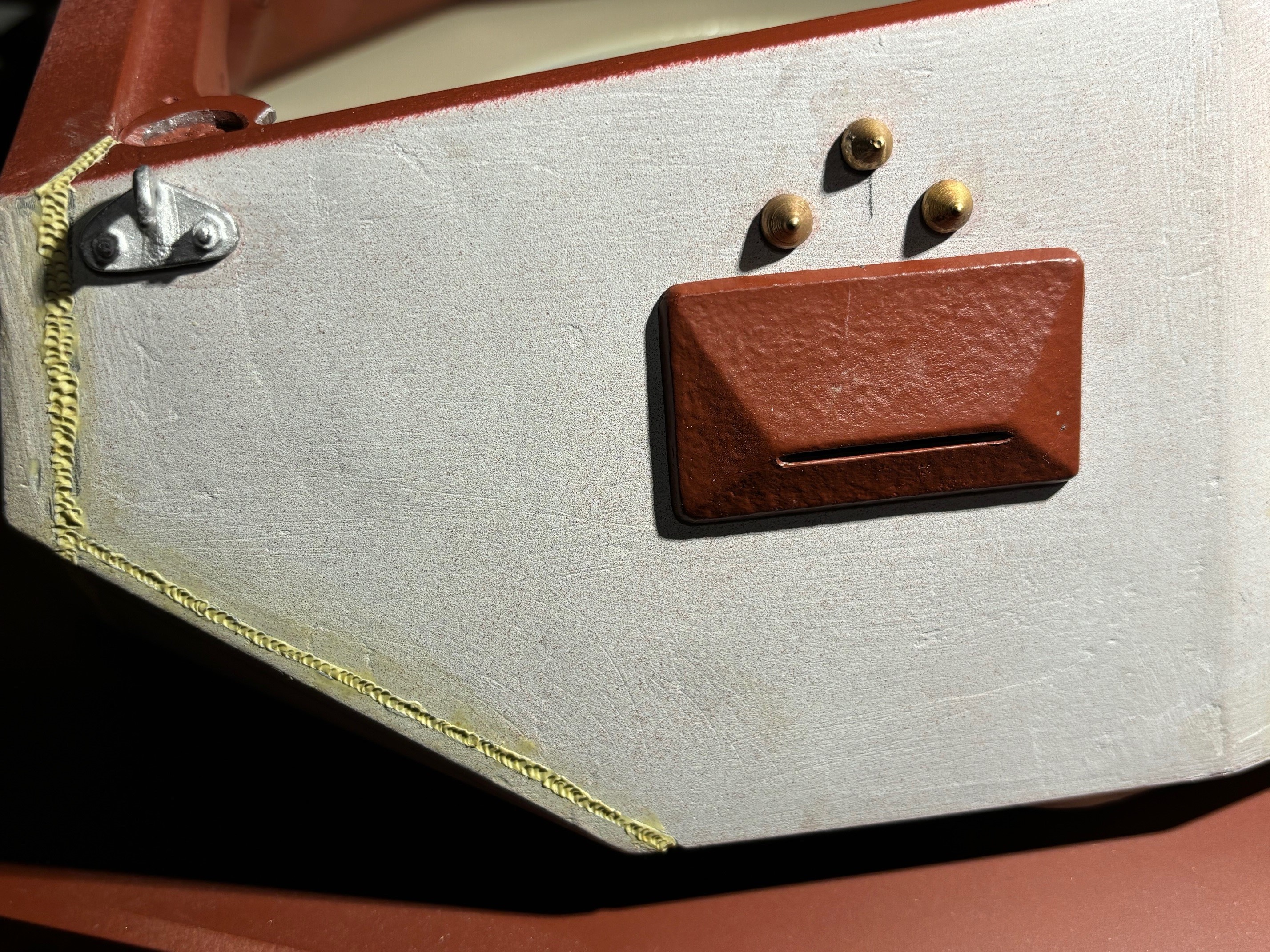

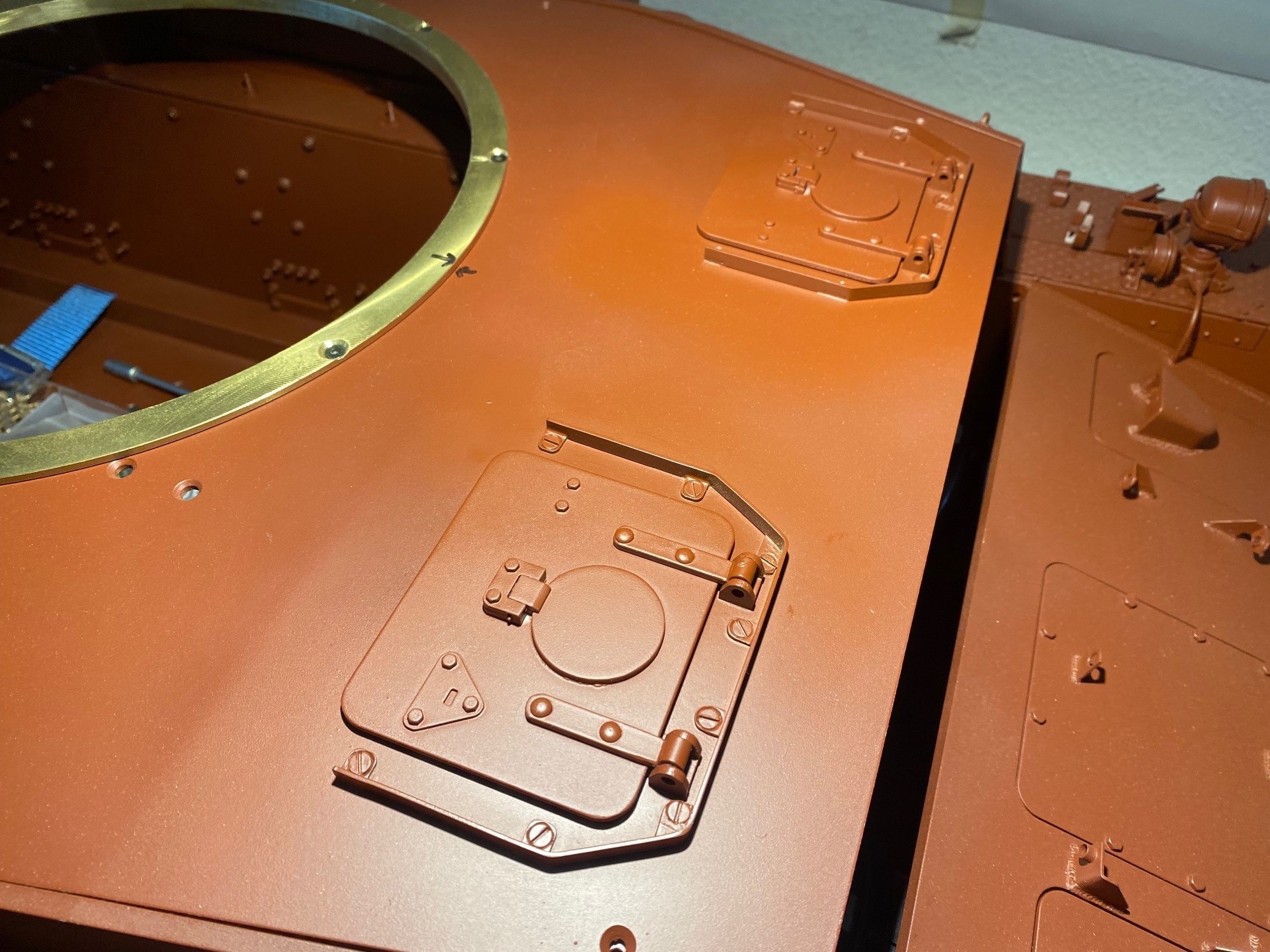

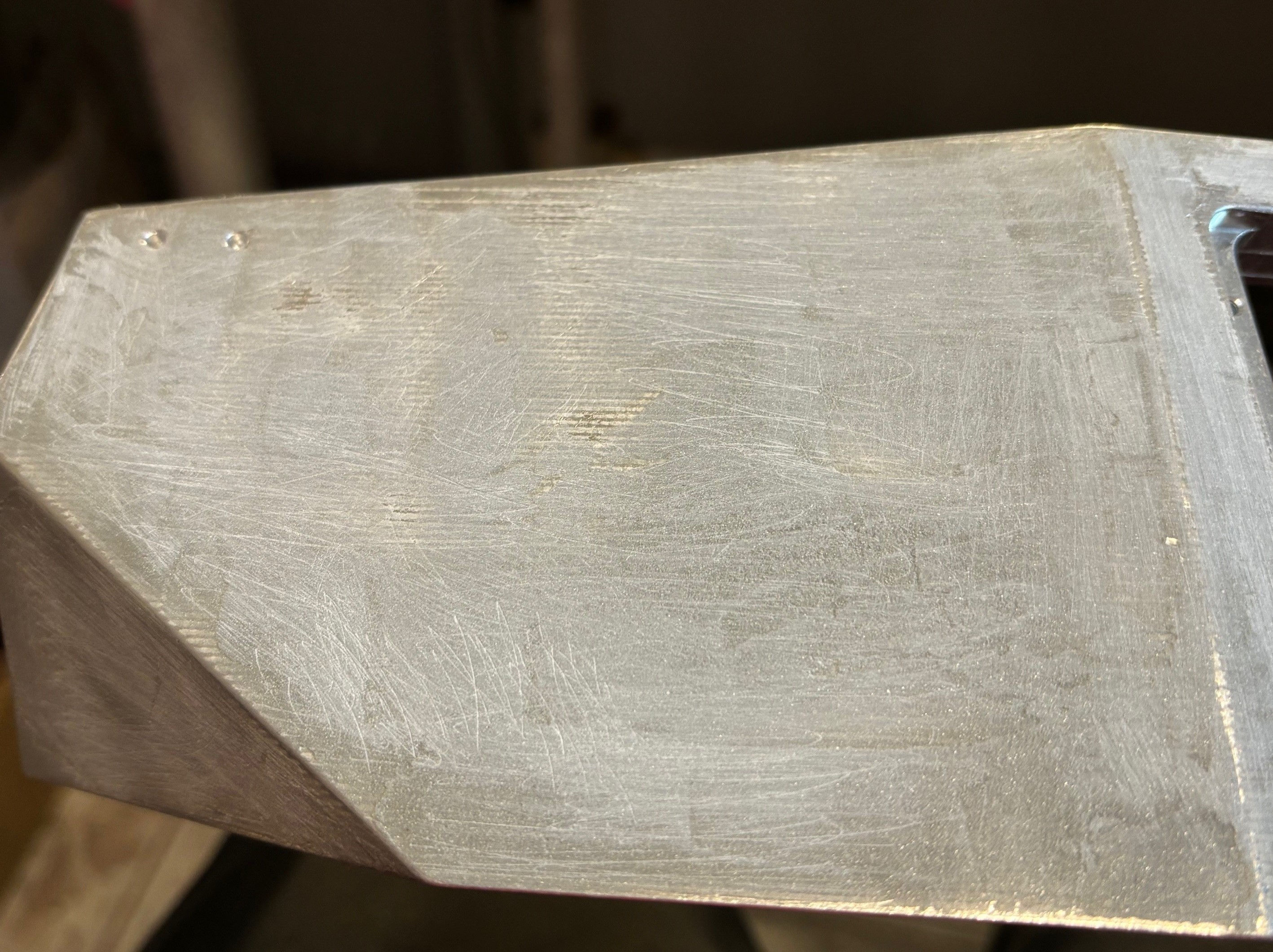

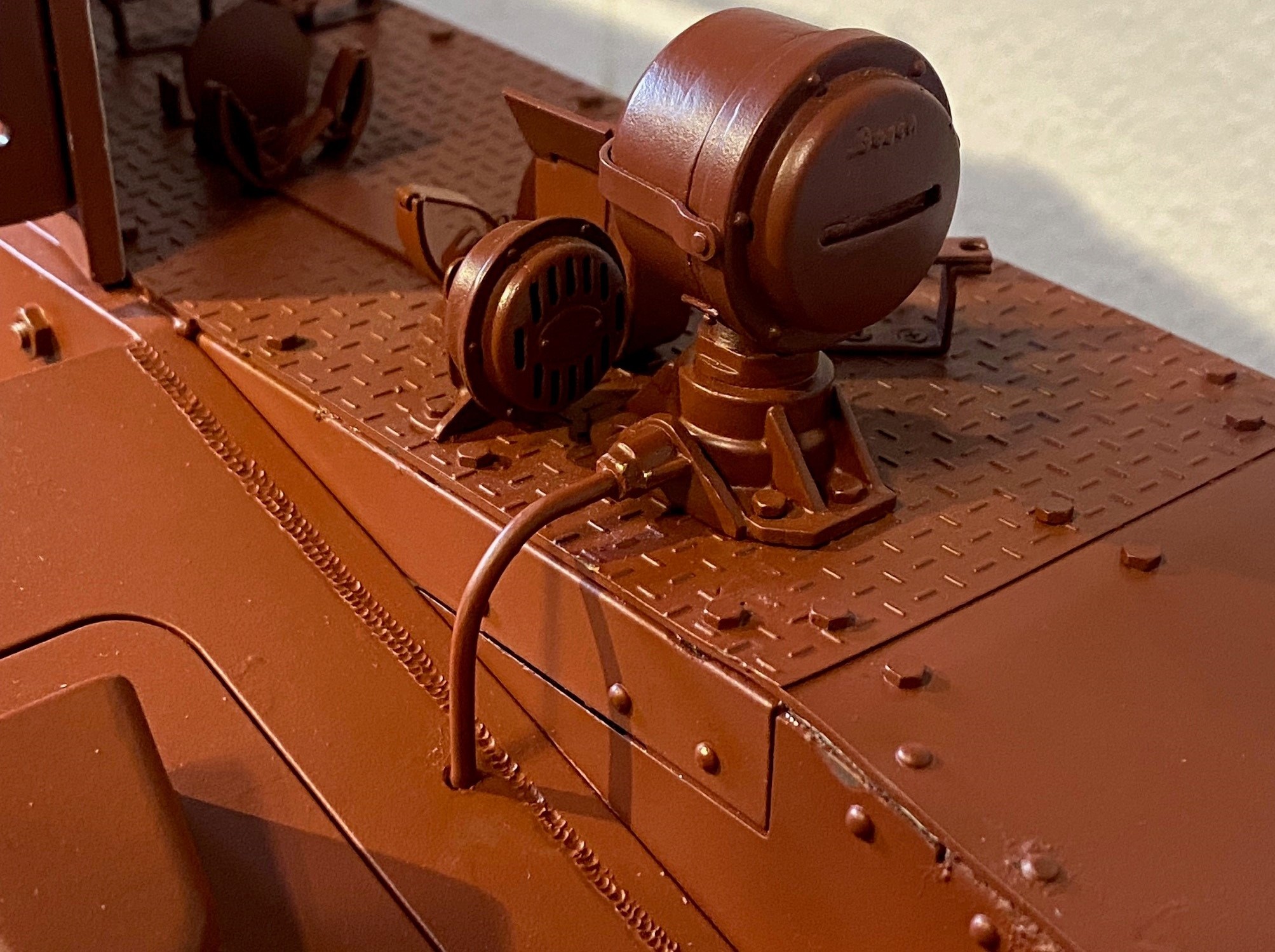

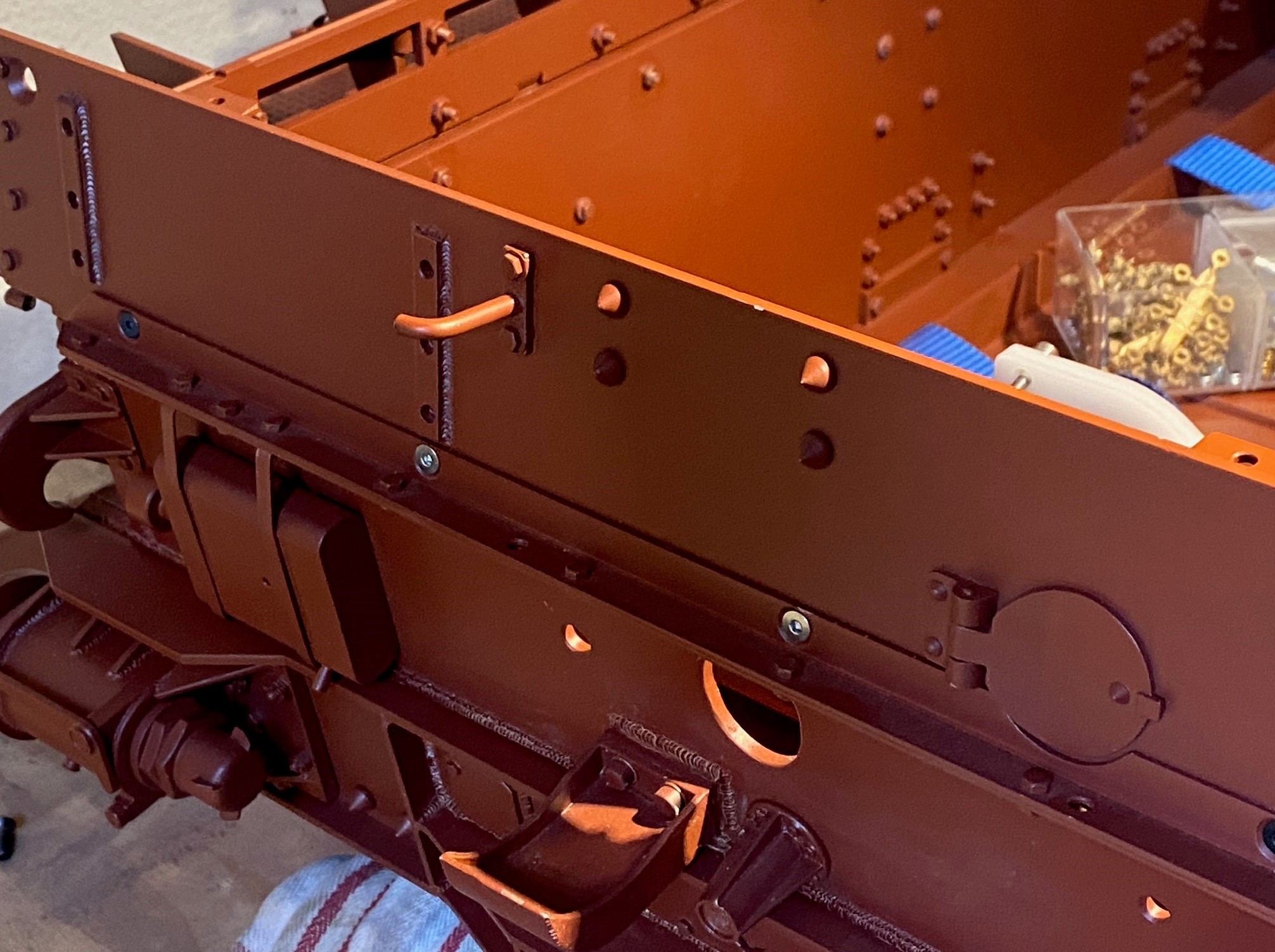

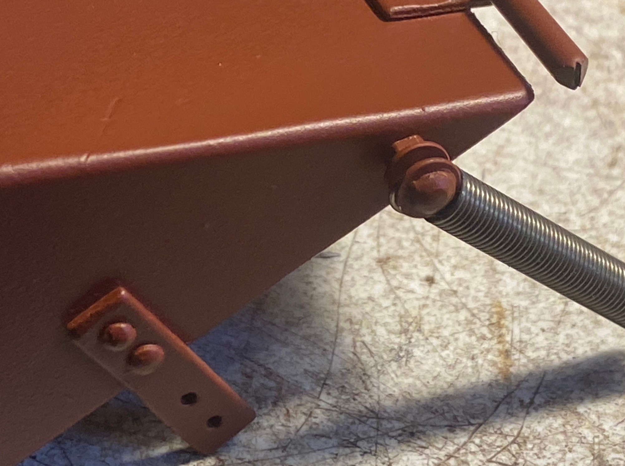

thanks for your comments!! Slowly it looks like a Panzer IV. Also done the holders for the springs of the mud guards, mounted the side plates and done the holders for the mud guards on the side. Also the fake cable for the head lamp is on.
Regards Martin

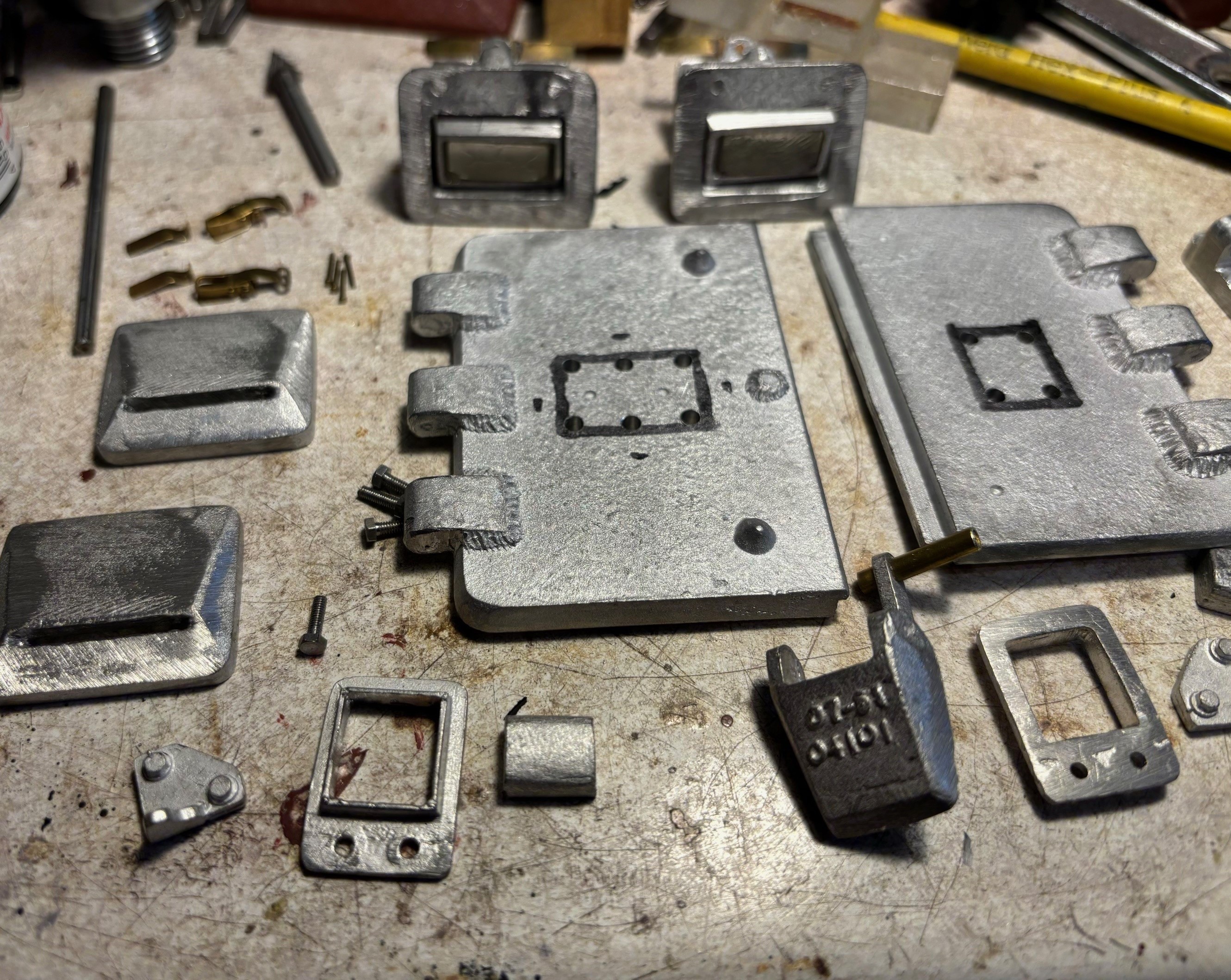

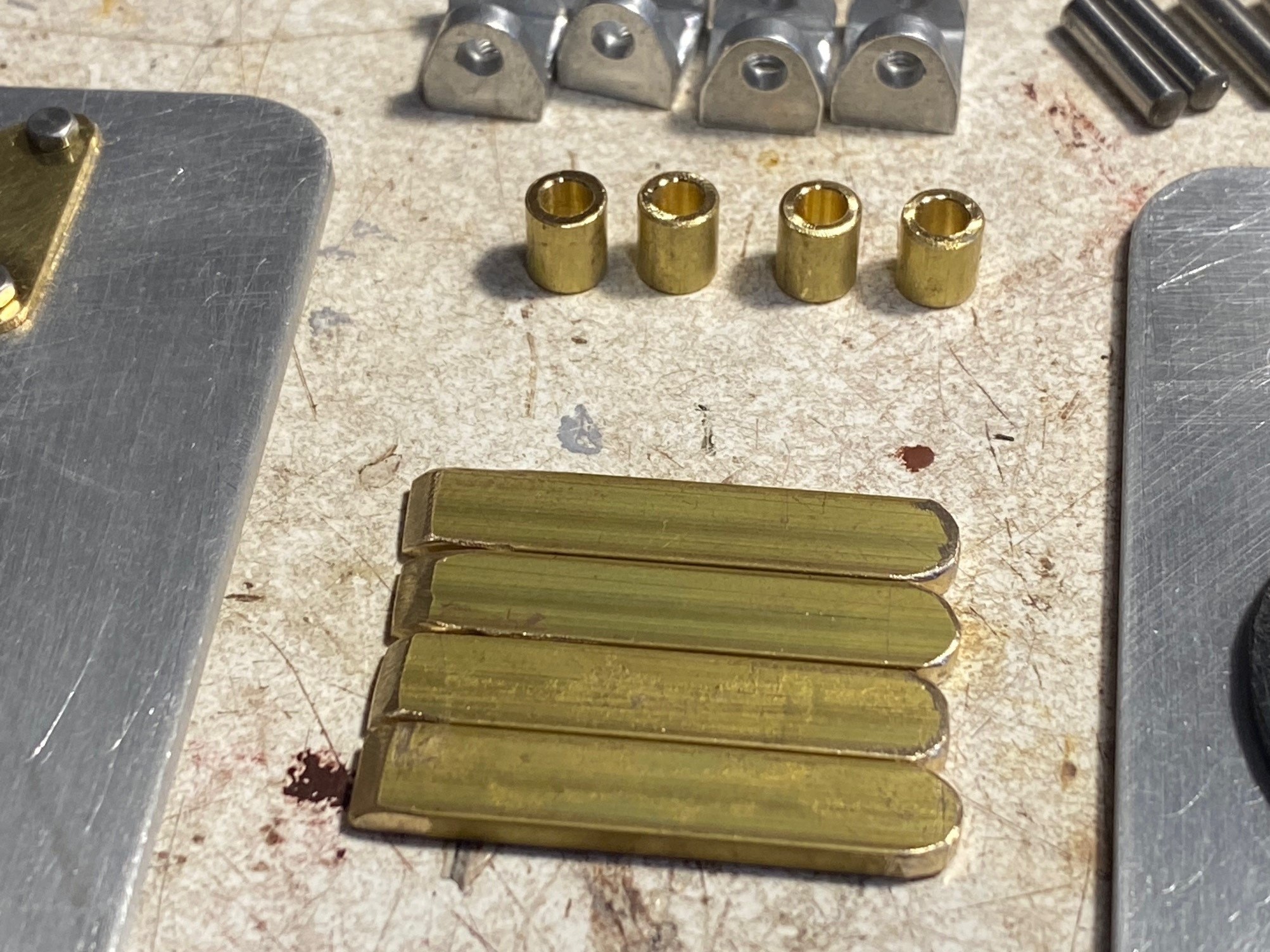

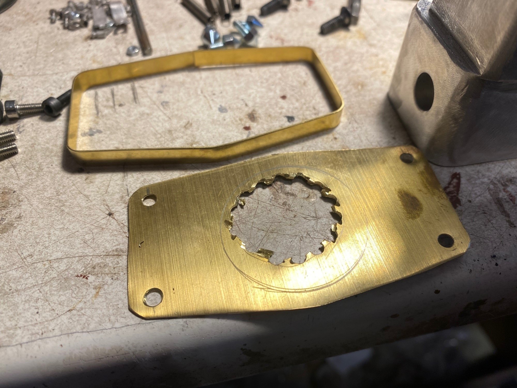

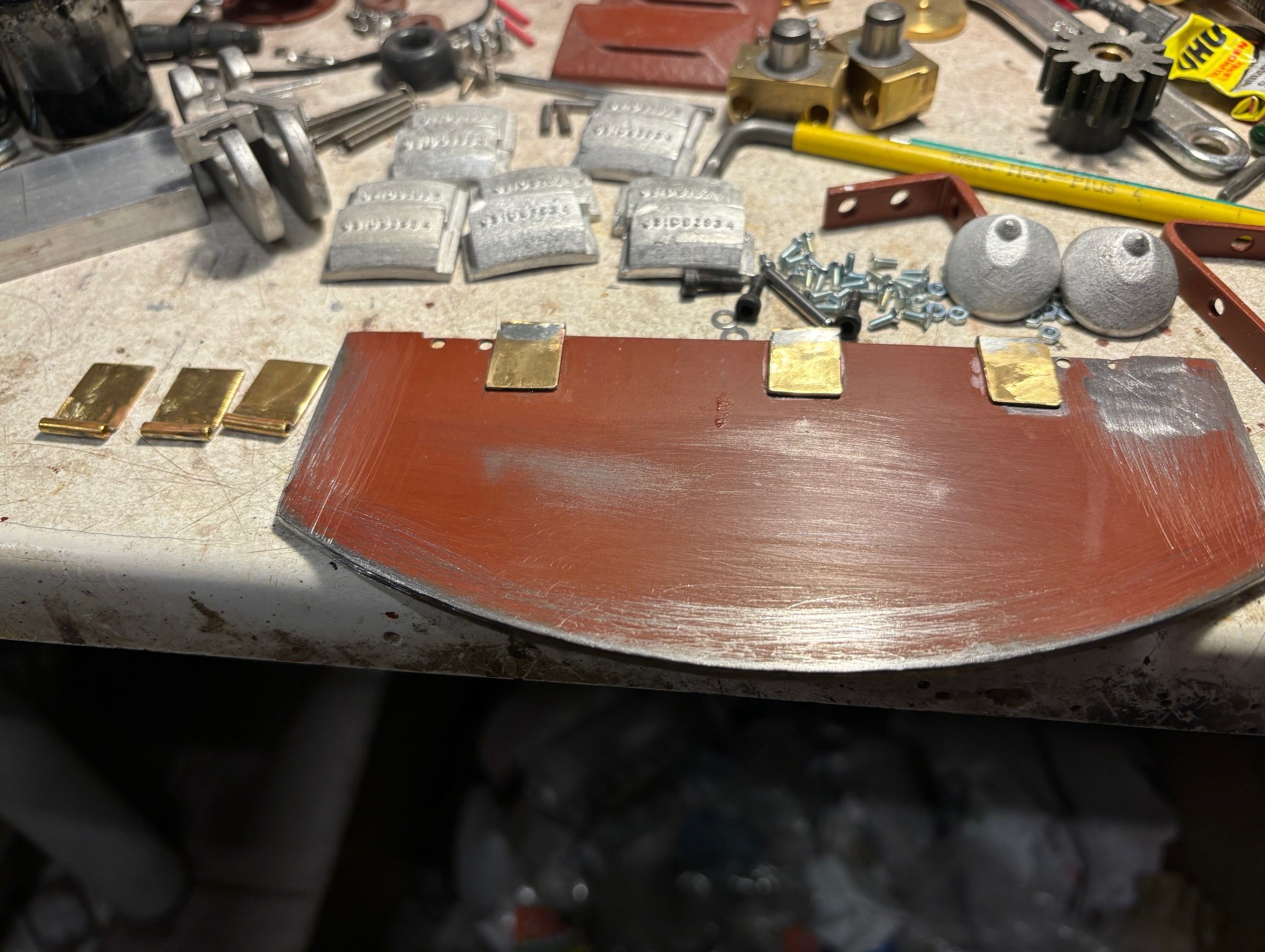

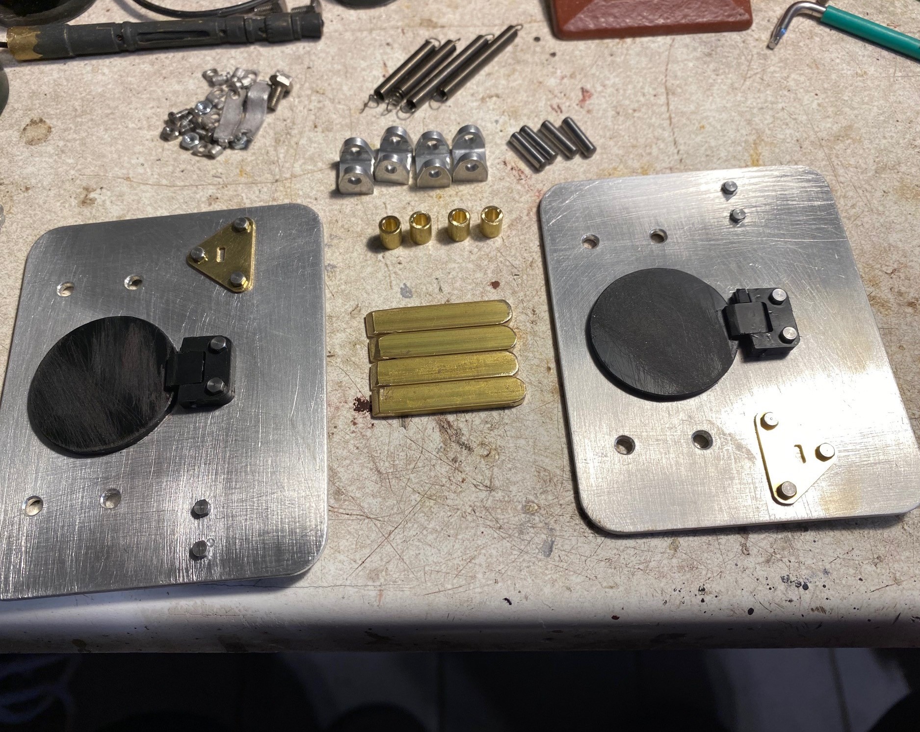

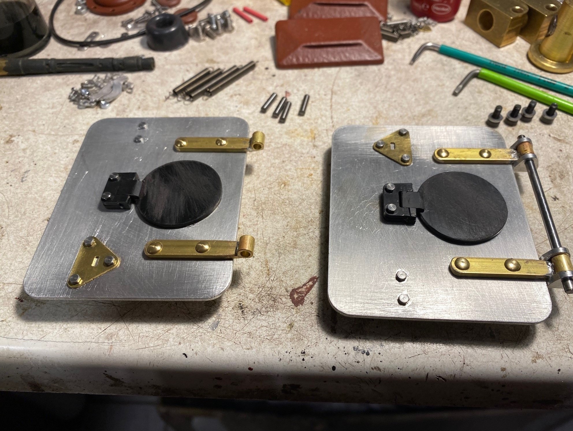

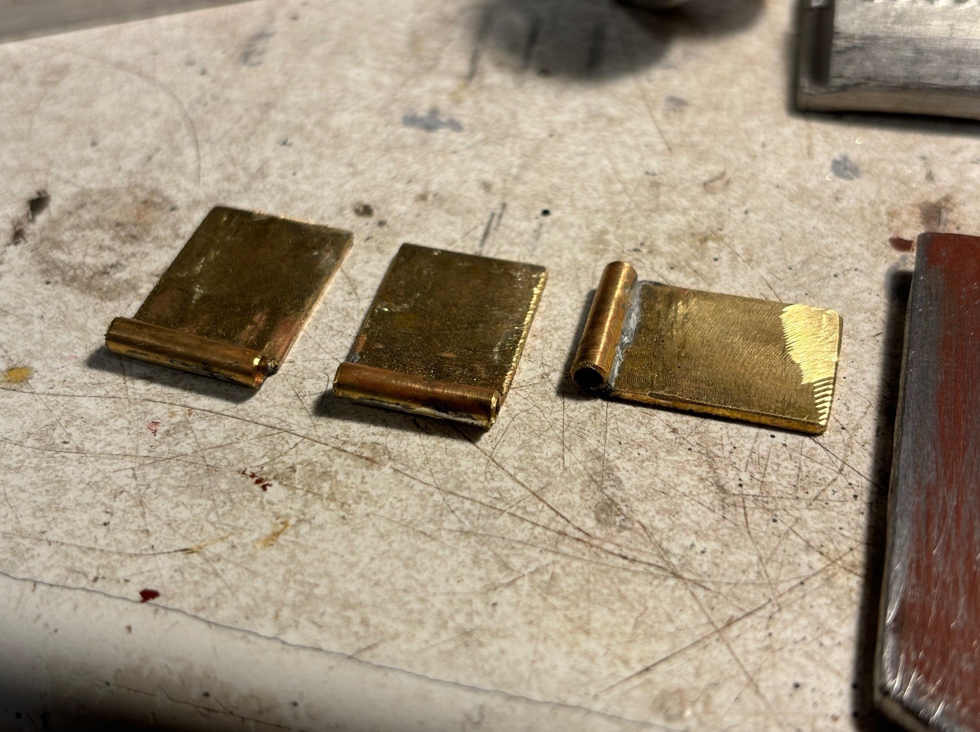

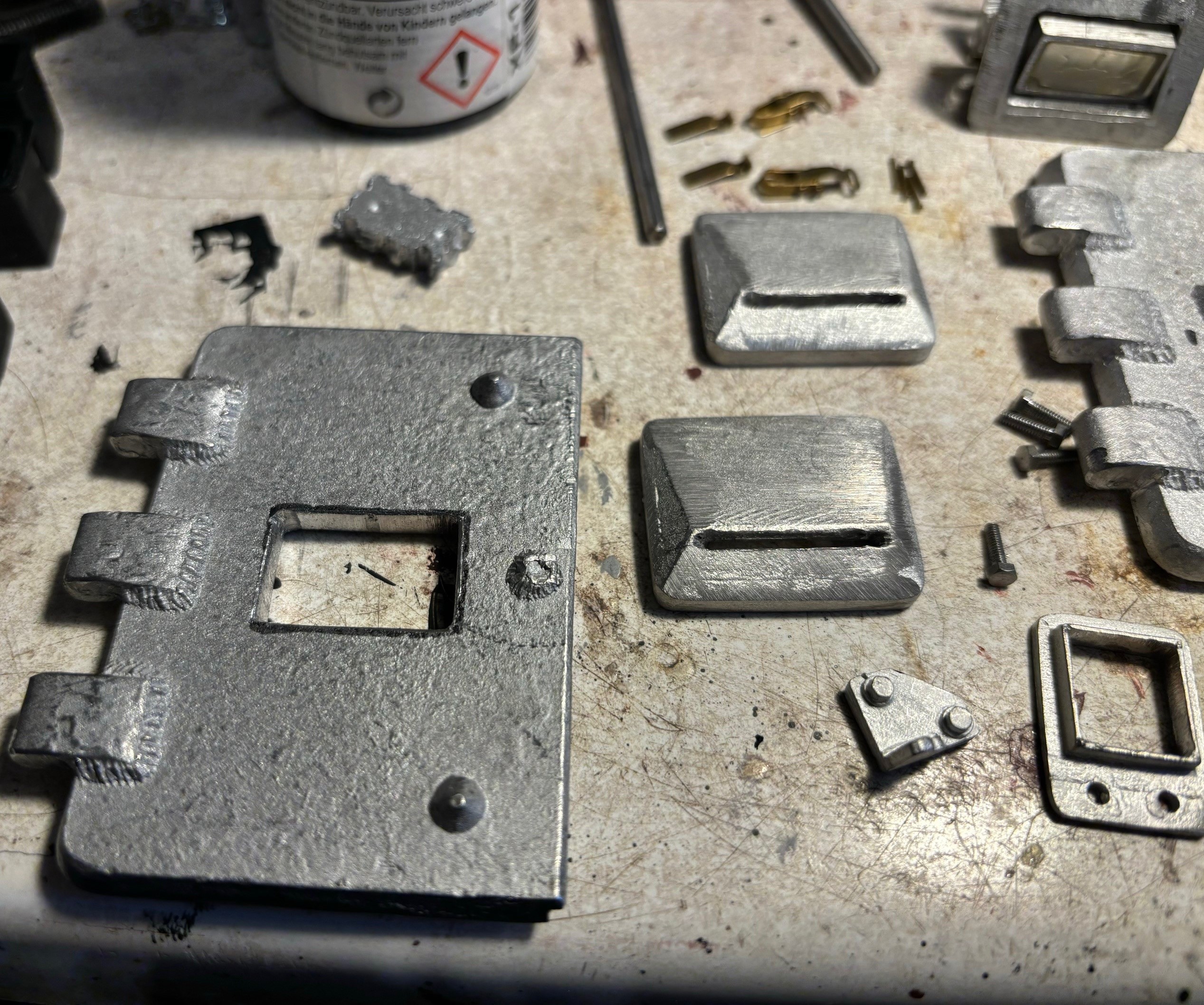

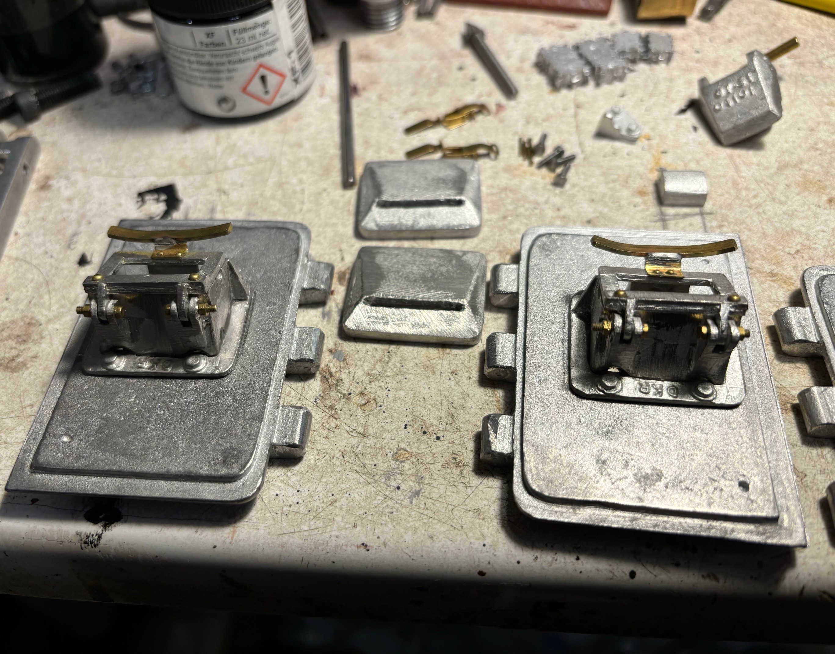

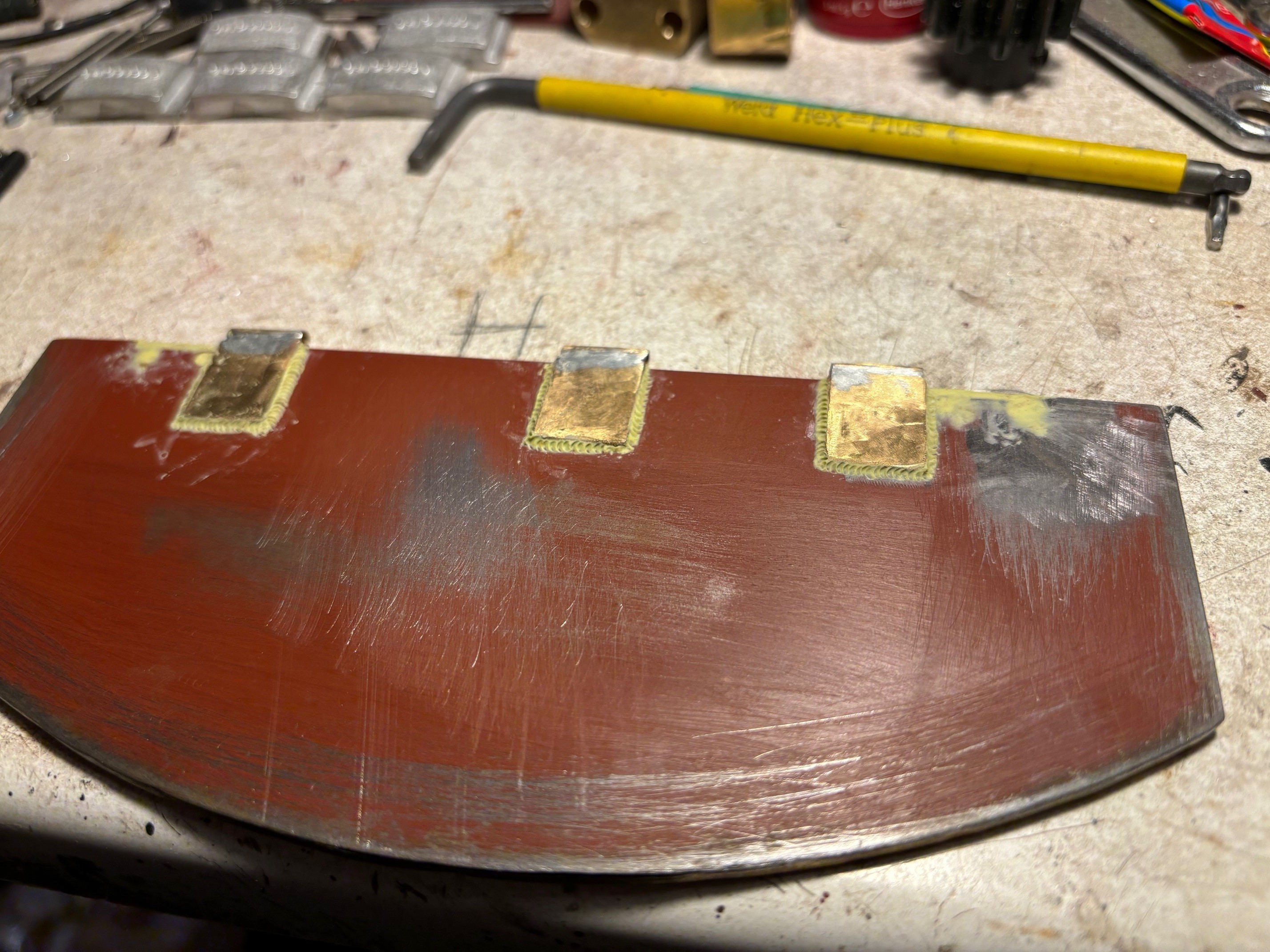

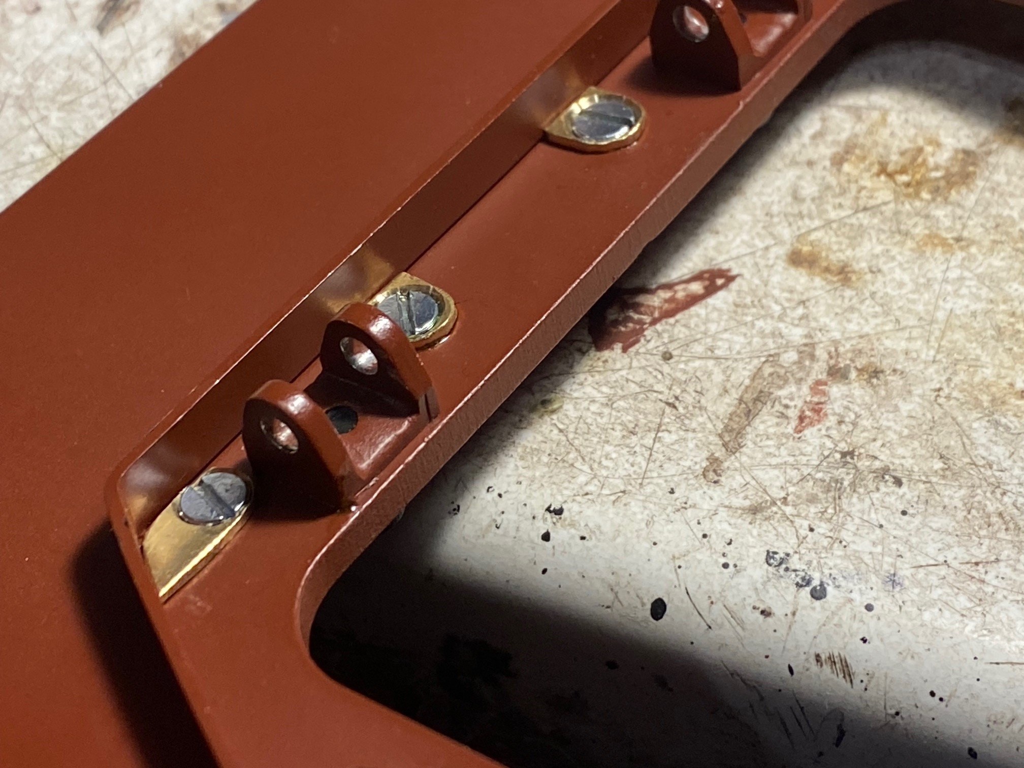

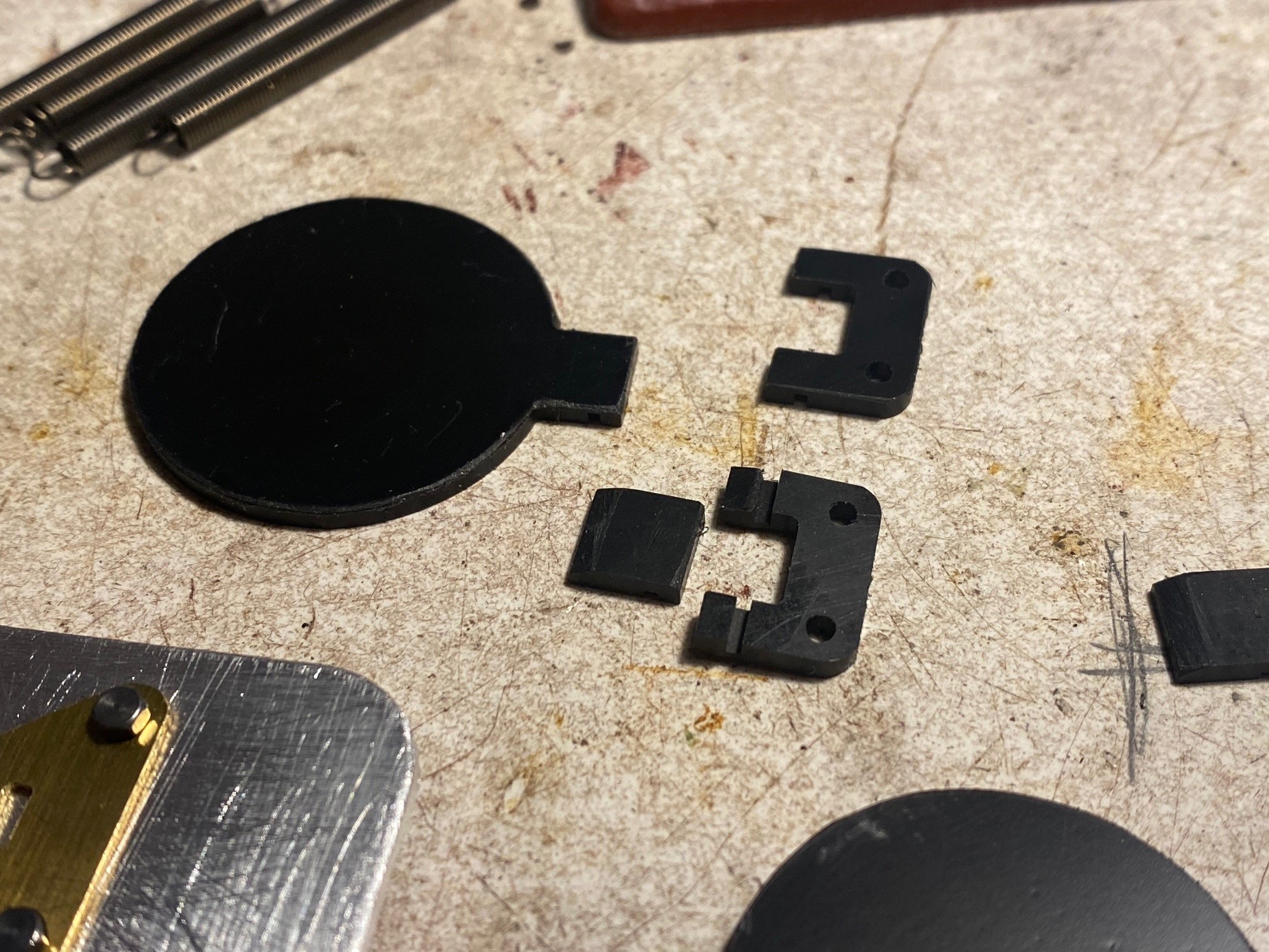

The next are the covers for the driver and the radio operator. I had built some covers onto the covers with hinges and self made hinges for the big covers, because they are missing. With some brass tubes and a small flat bar it is no big thing to solder them.
Regards Martin

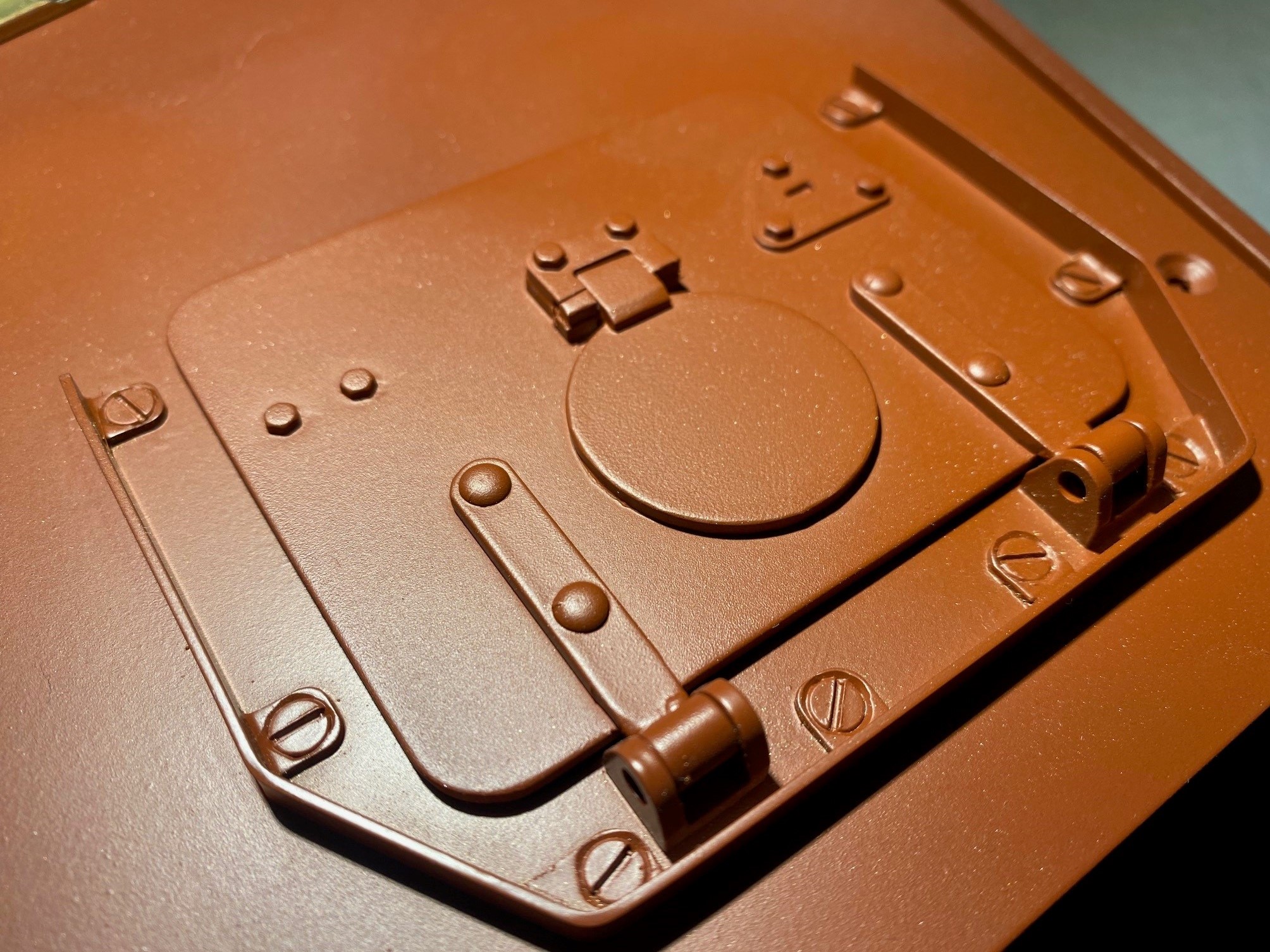

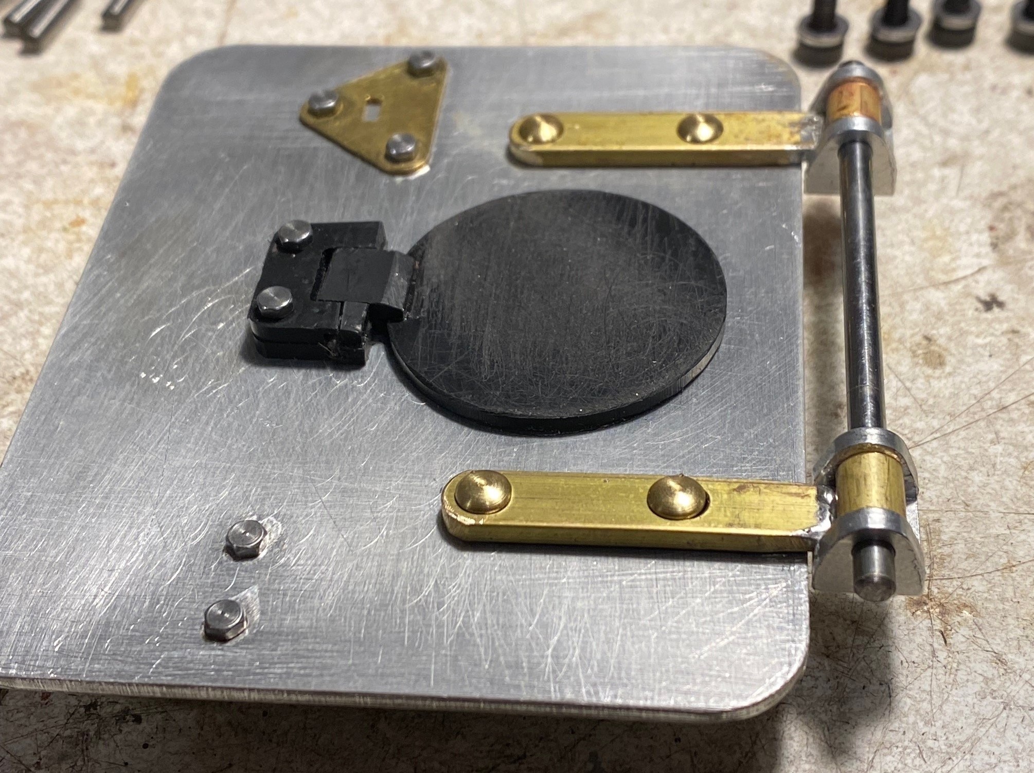

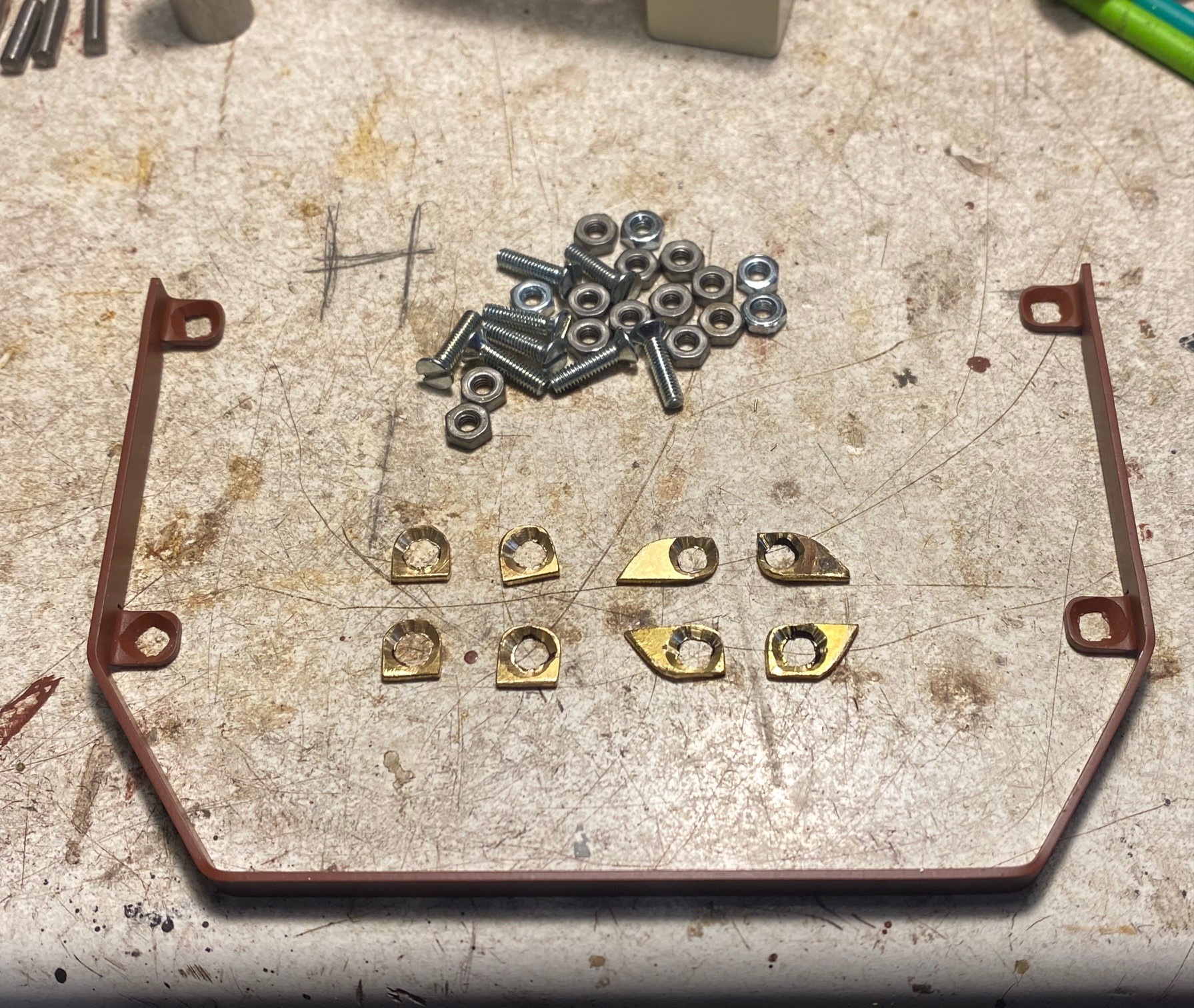

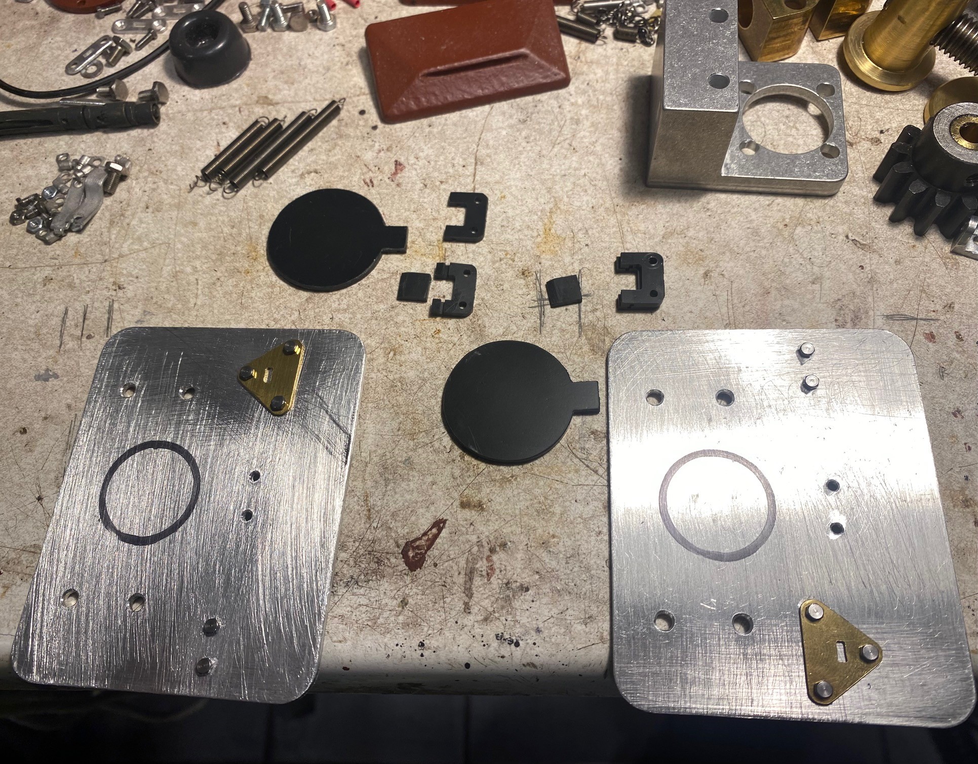

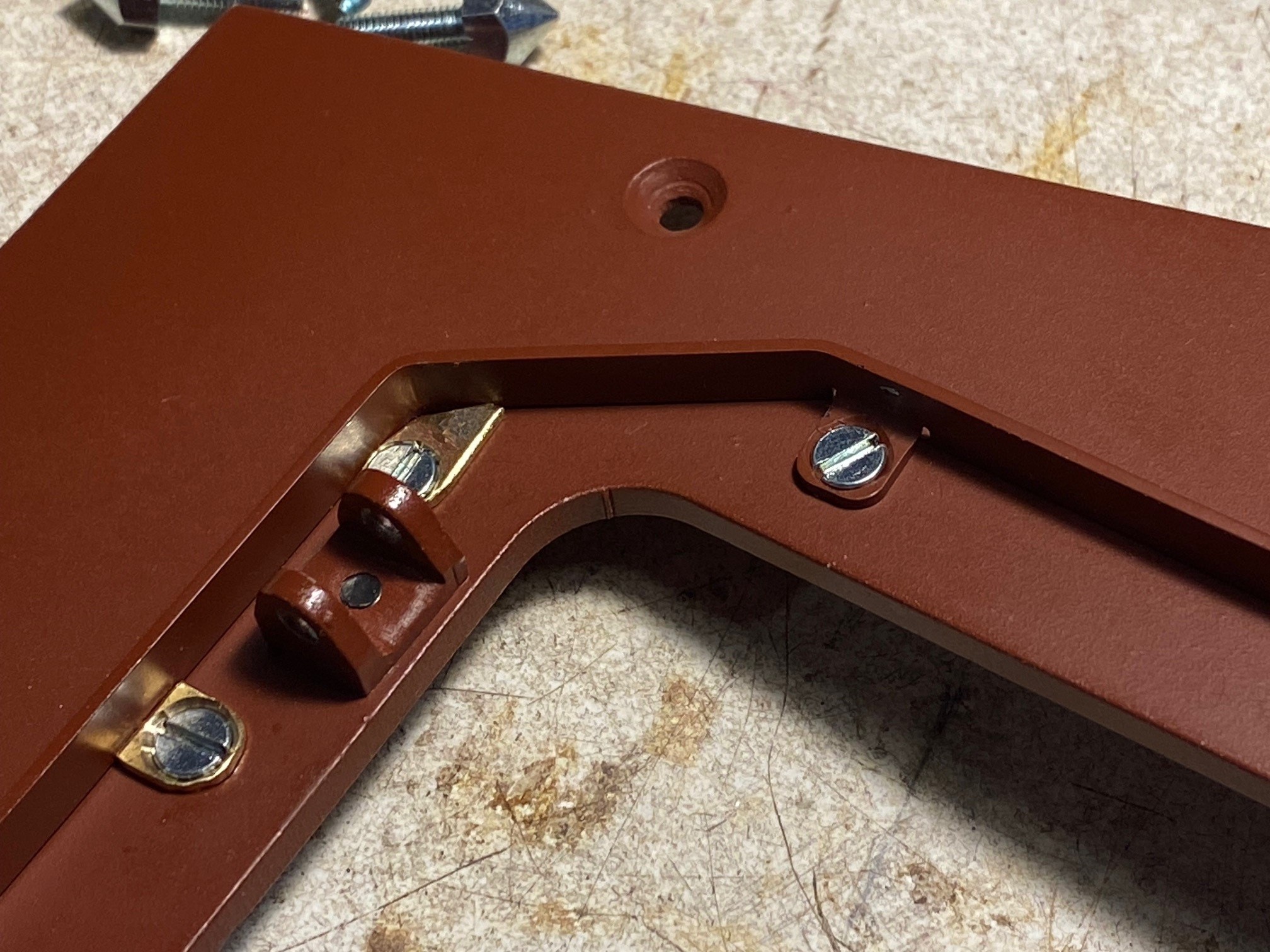

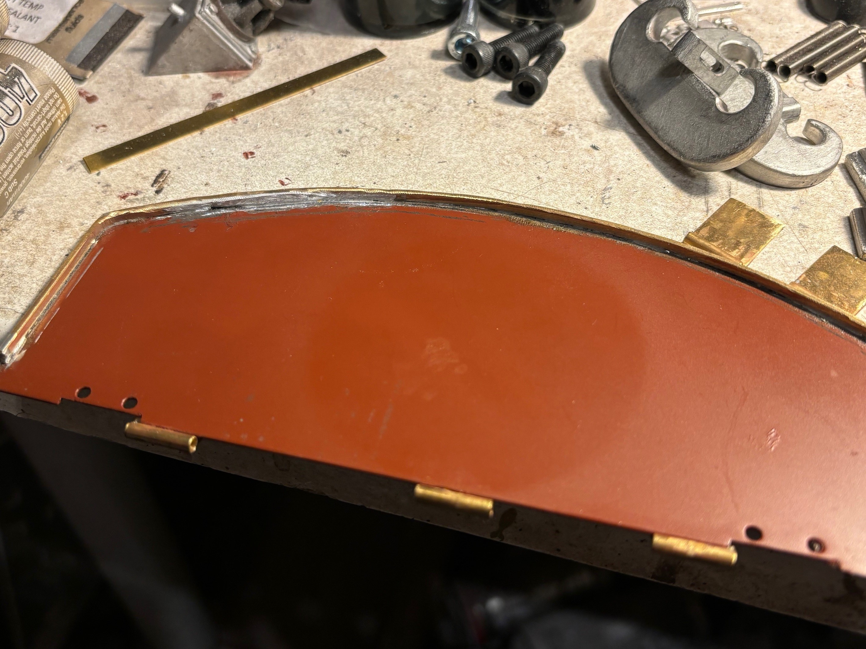

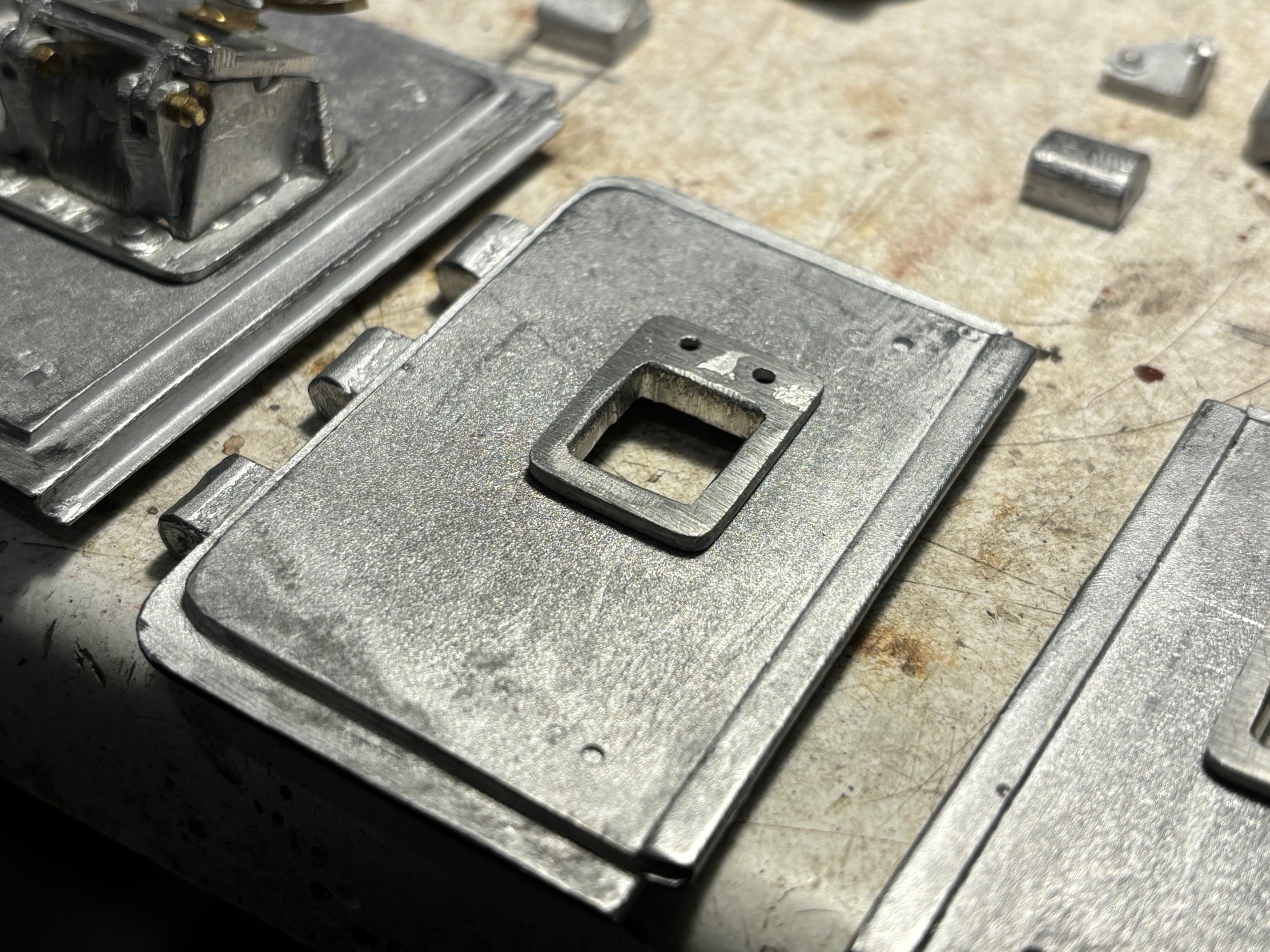

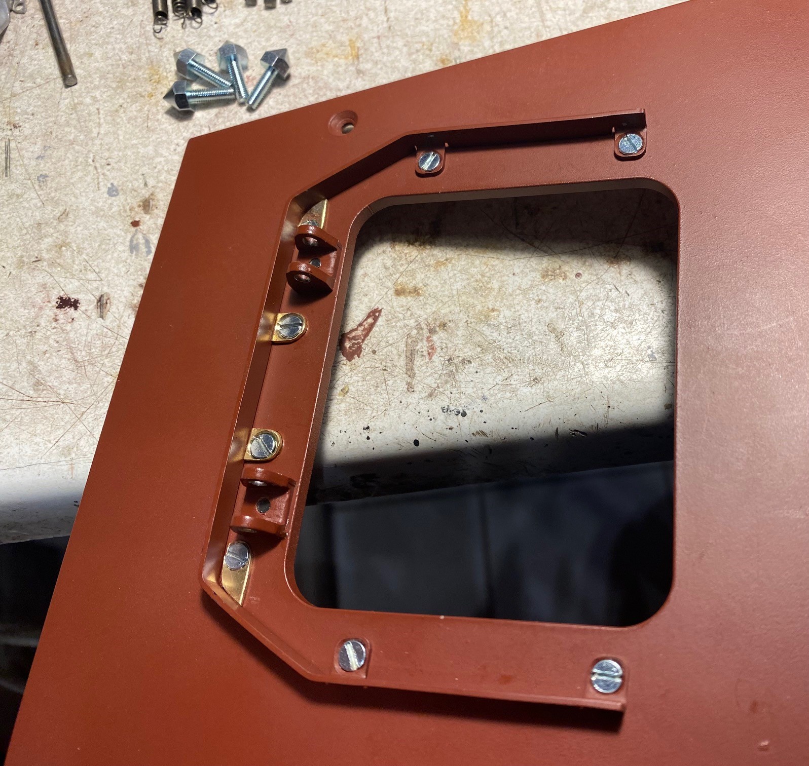

Now the next is to make the second parts of the hinges and the frame around the covers.

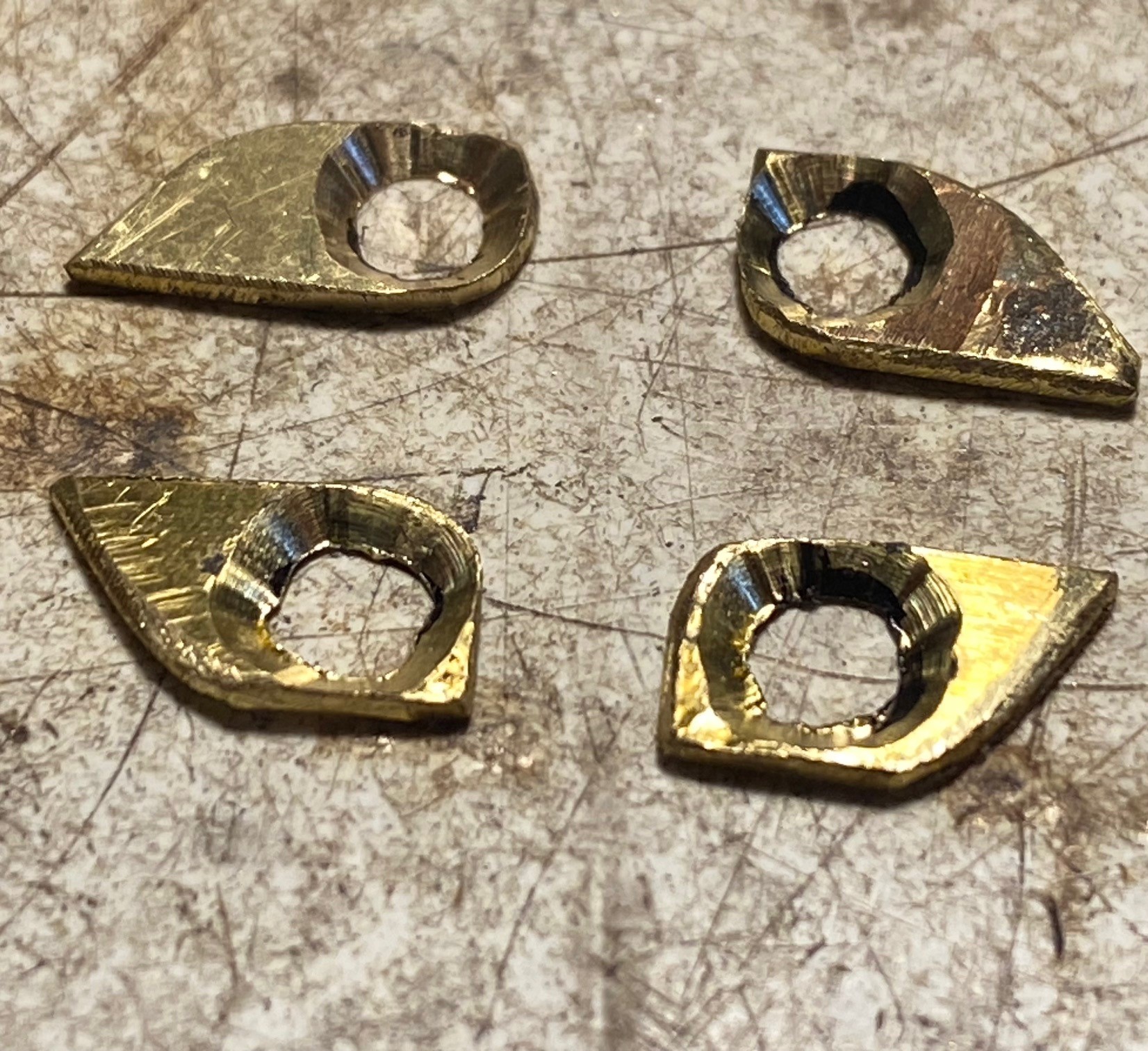

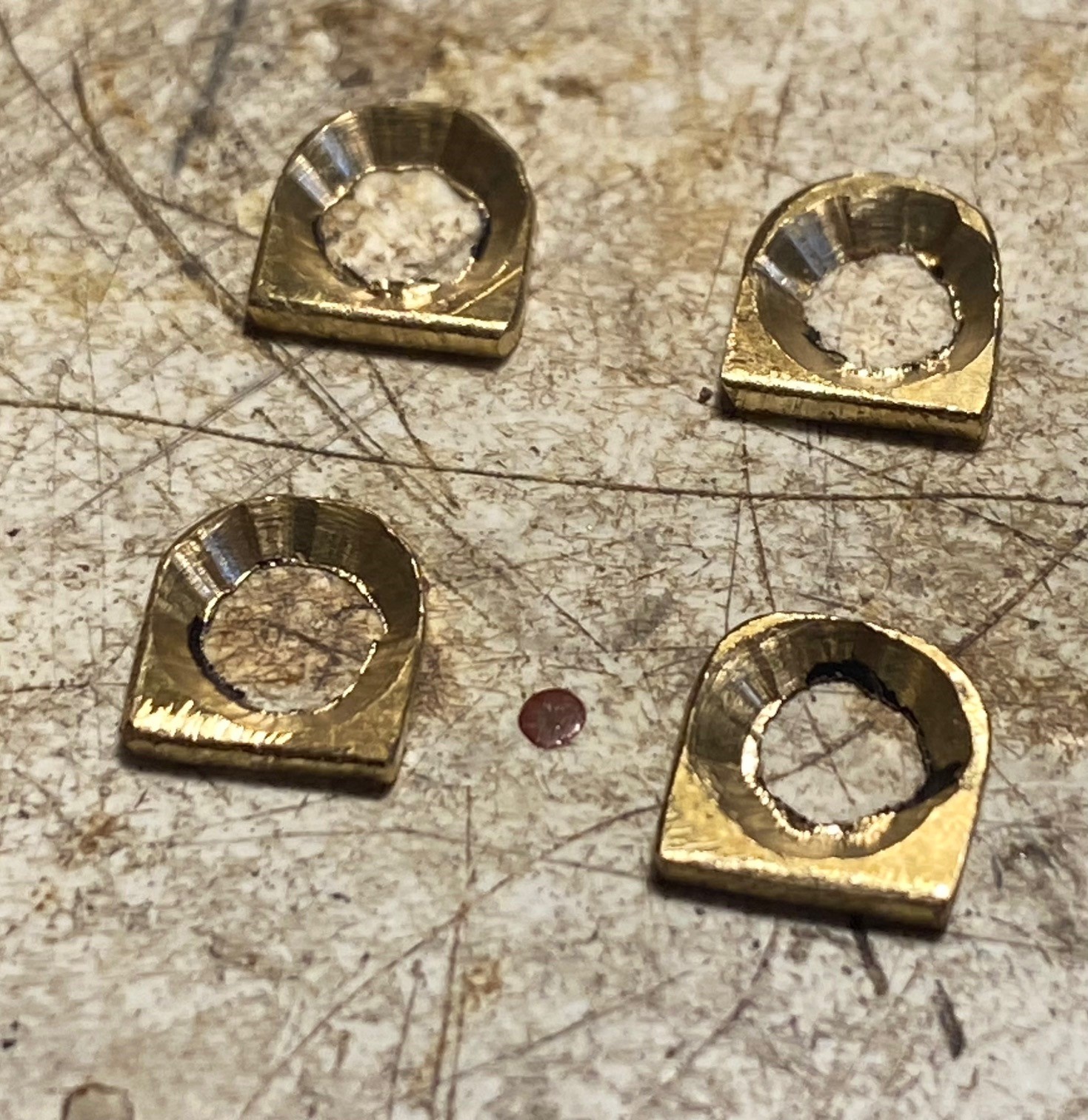

It is very hard to make such small parts consisting of a hole and a counter sunk for M2,5 in sheet of 1mm. :roll: :roll: :roll: These are the additional holders for the frame.
Regards Martin

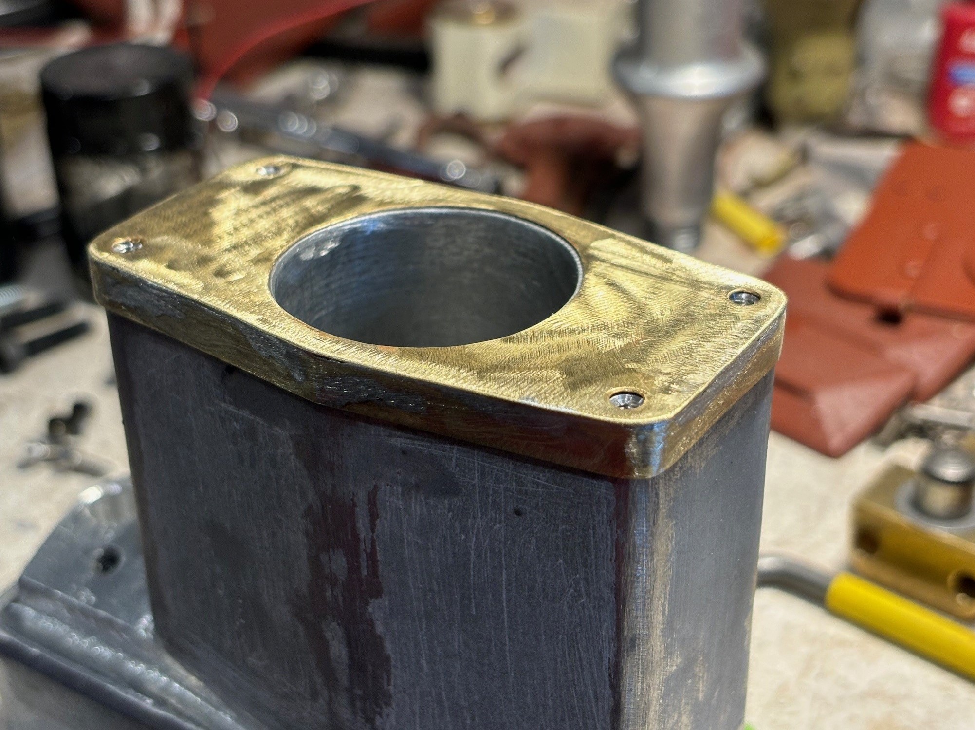

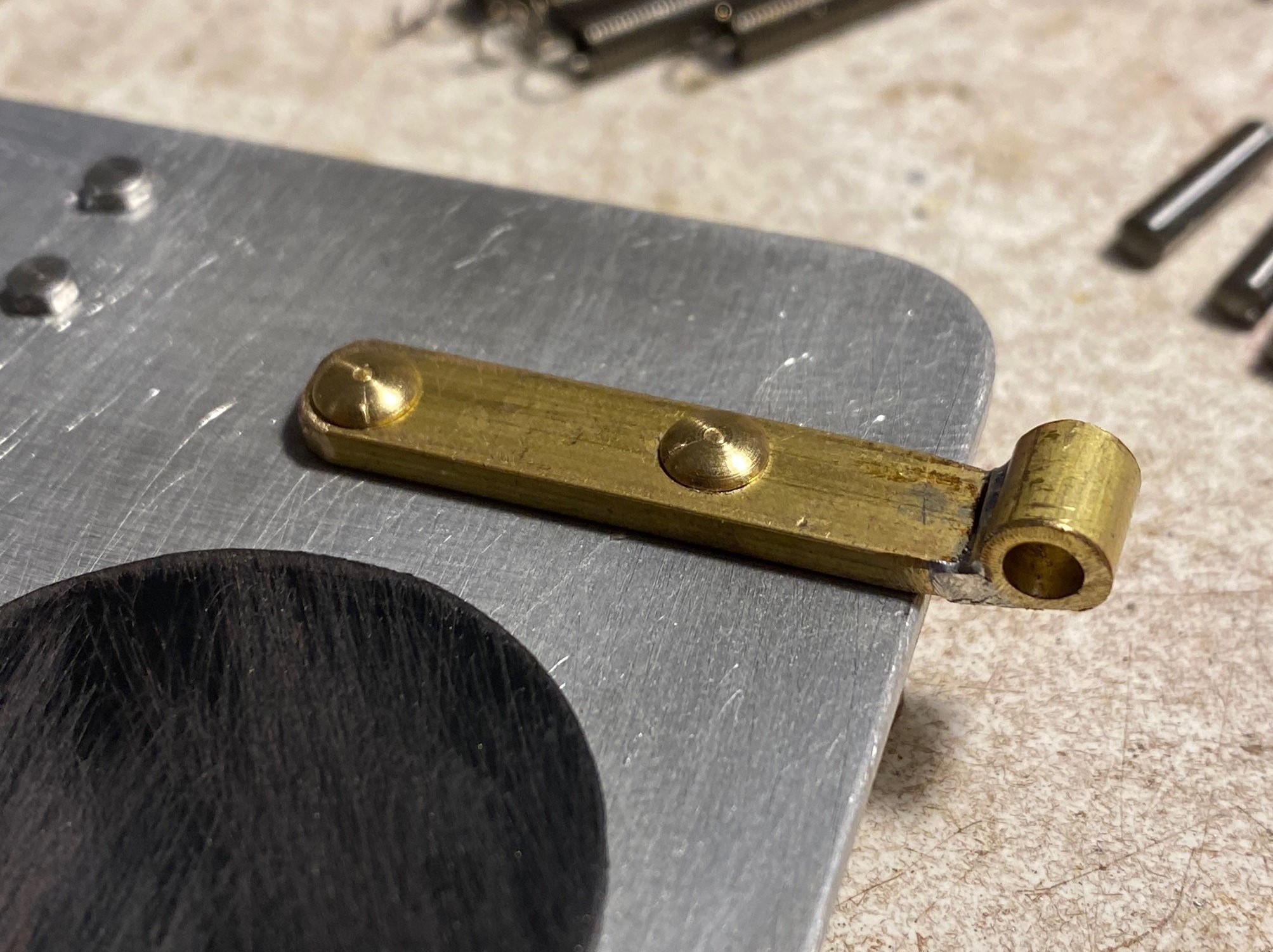

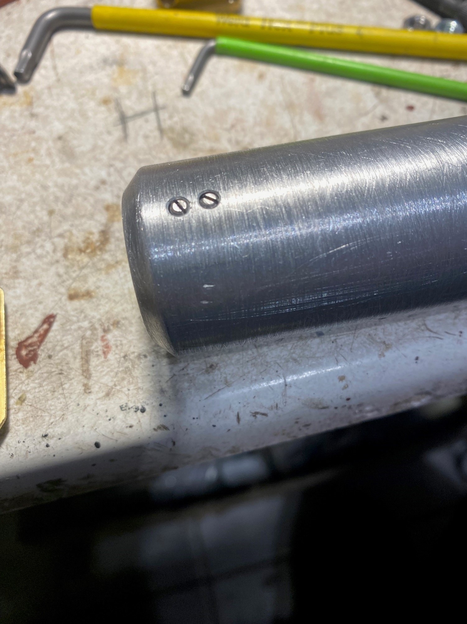

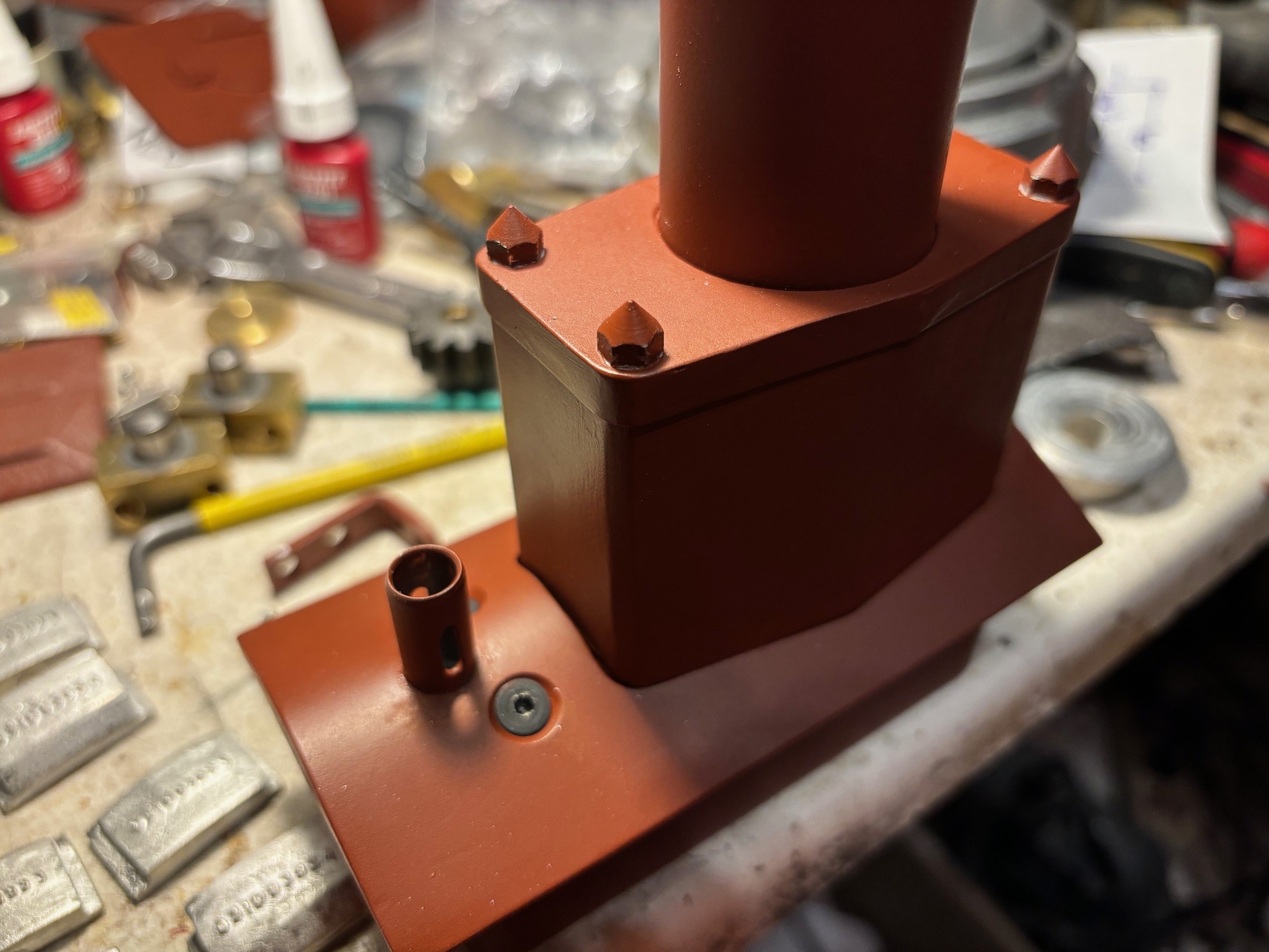

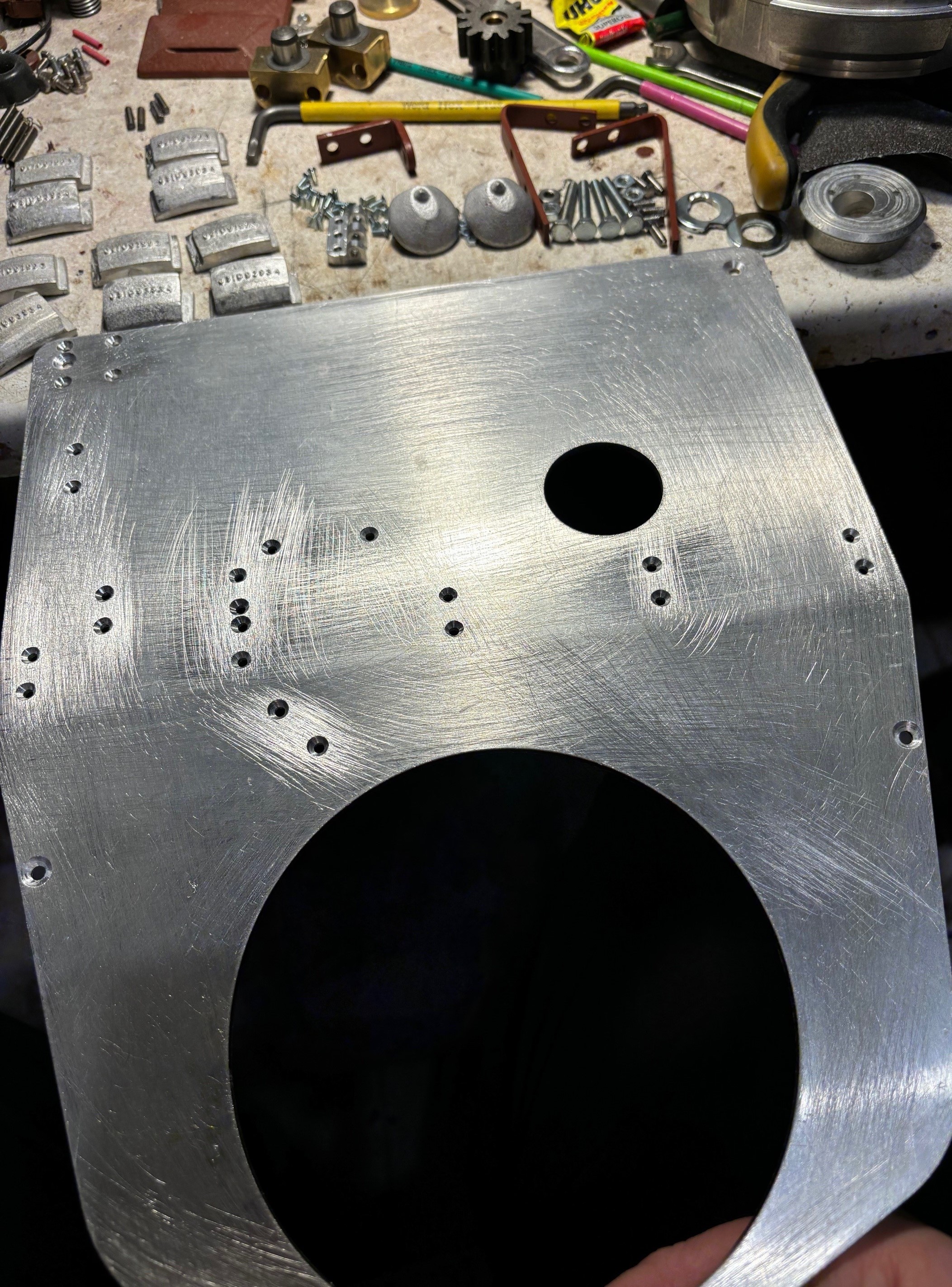

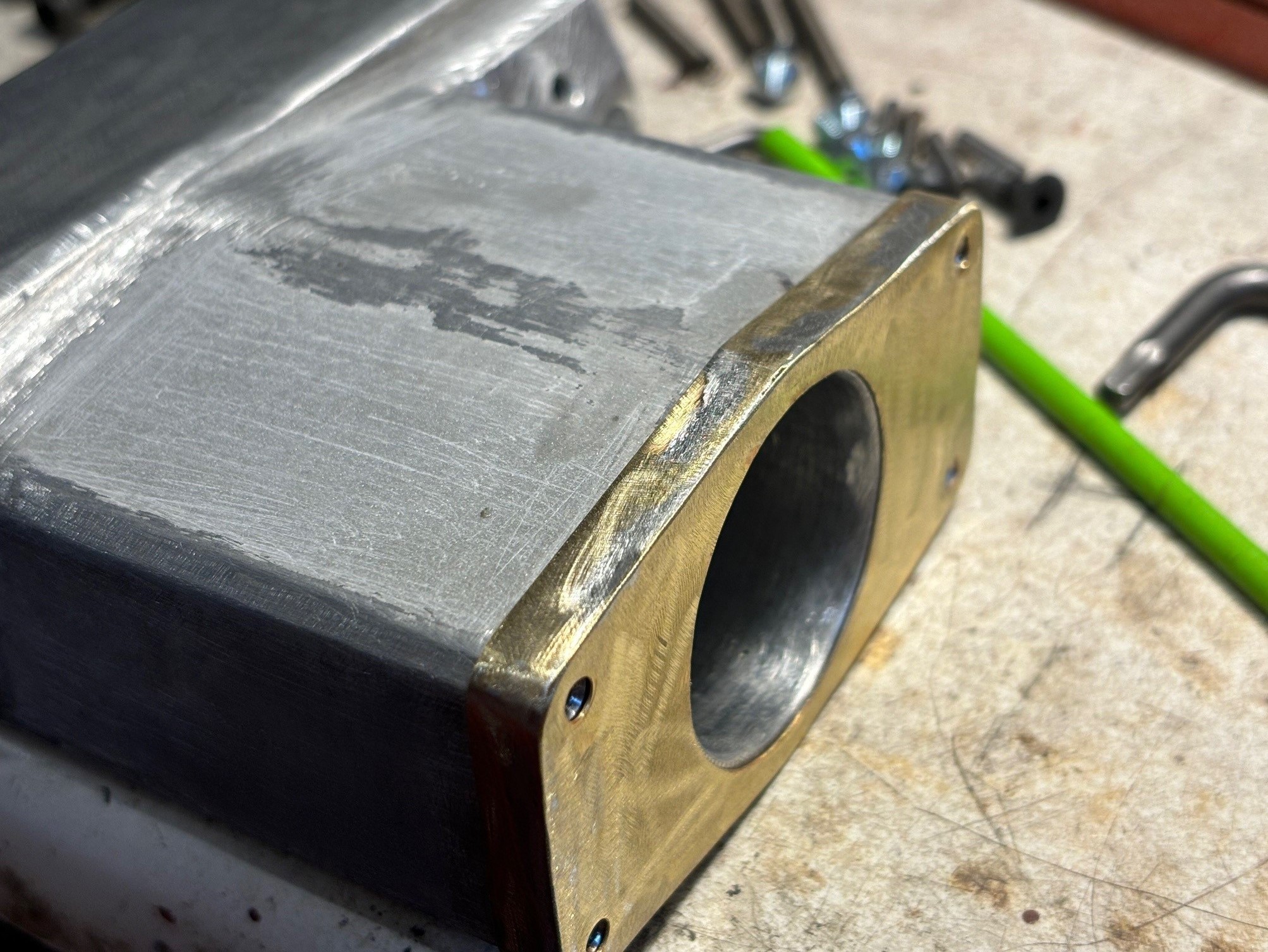

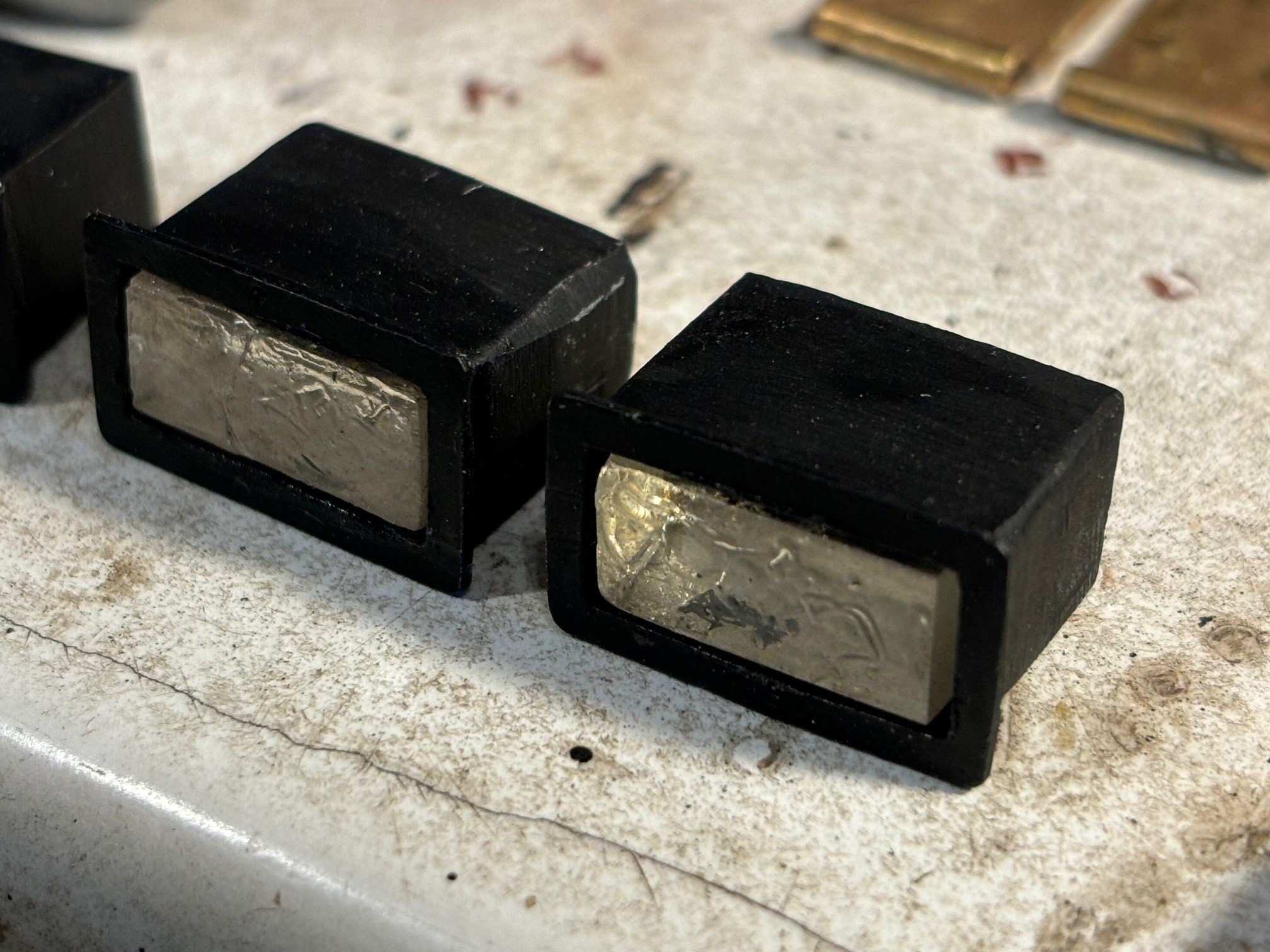

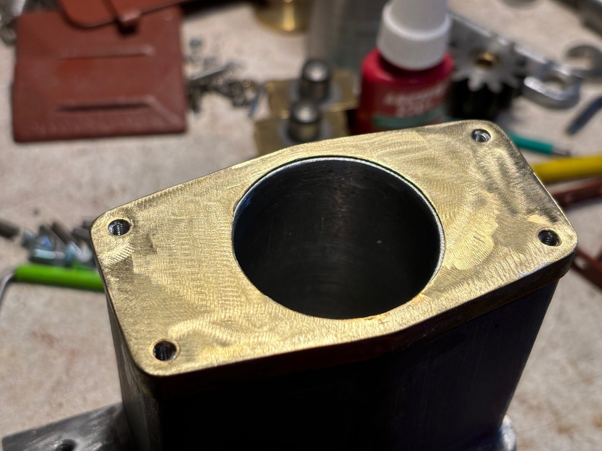

Now i am working on the barrel. The cannon got some set screws for holding the bearing inside - like the real one. The rear part of the gun barrel got a cover made from brass and soldered to the small flat bar around - it's a very tricky job to solder that. :P :P
Regards Martin

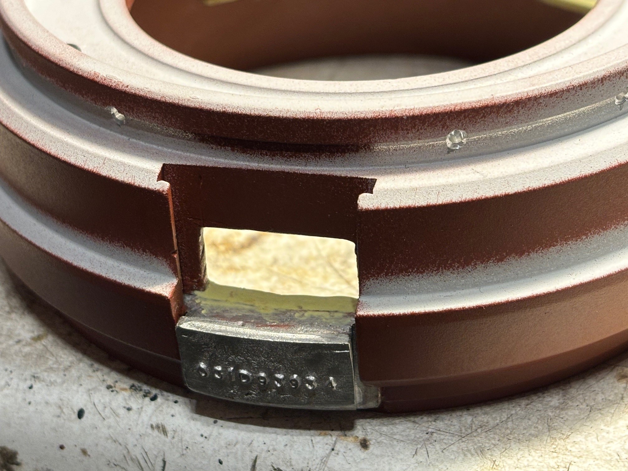

Hi Chris, thanks for the nice word.

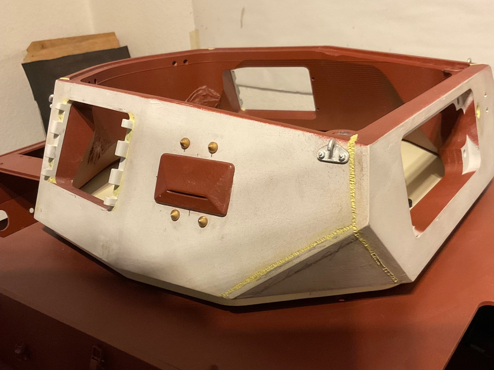

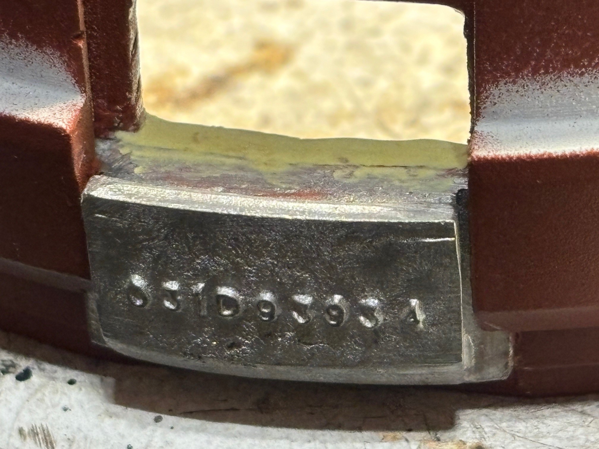

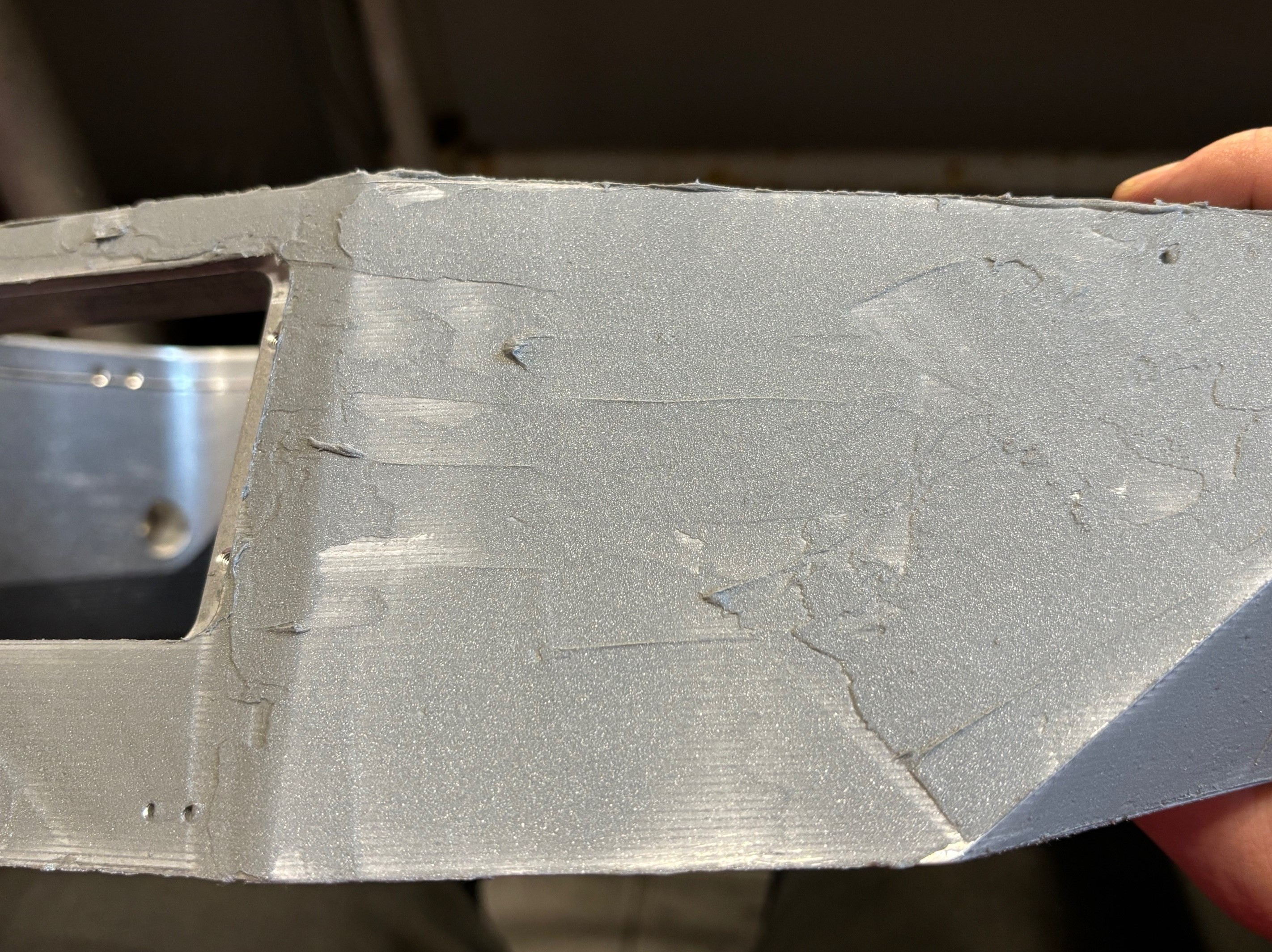

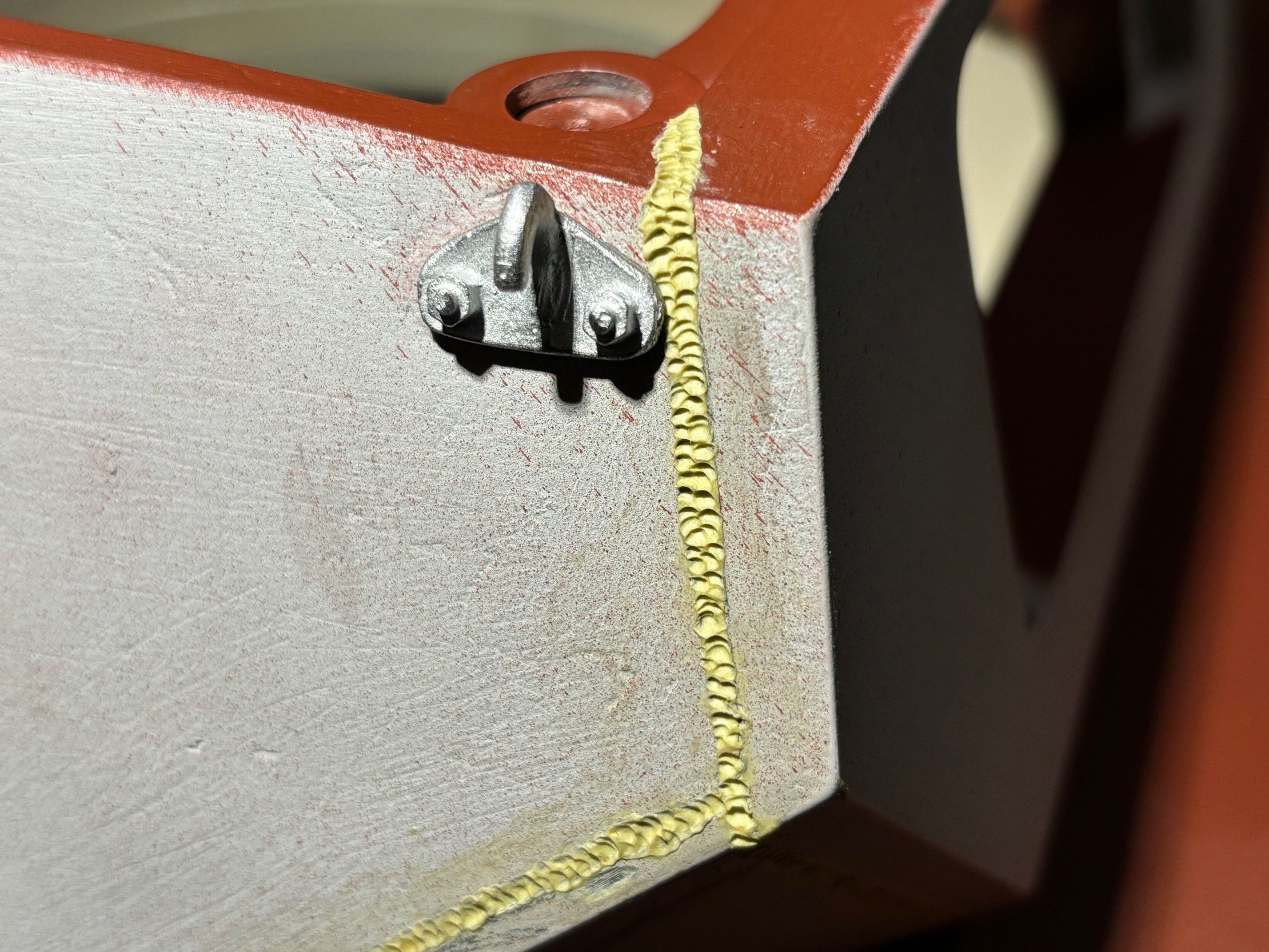

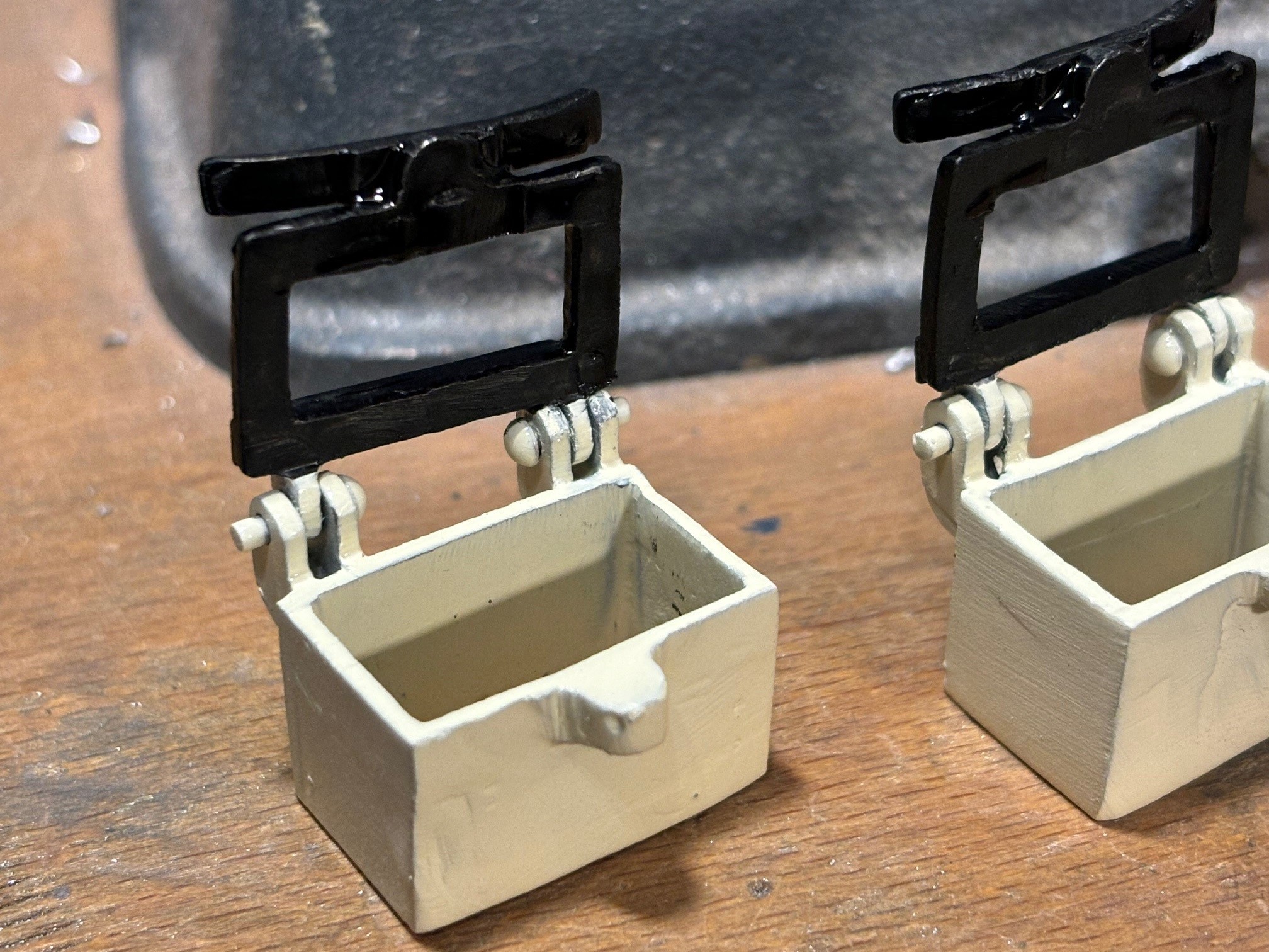

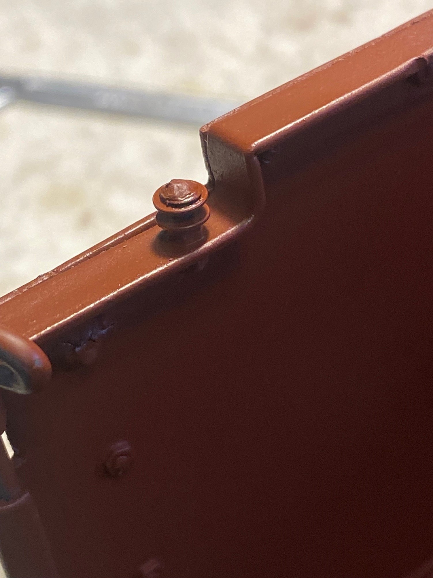

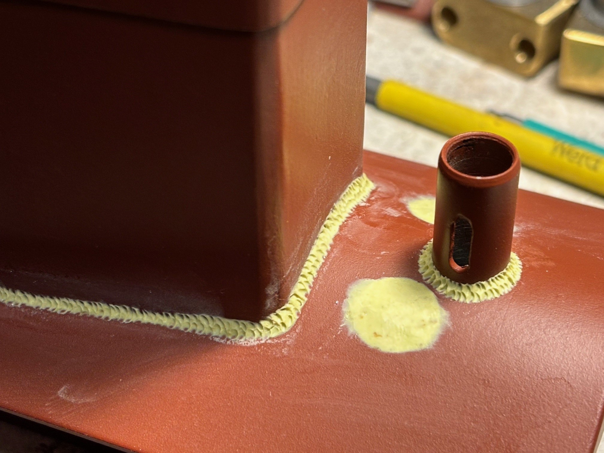

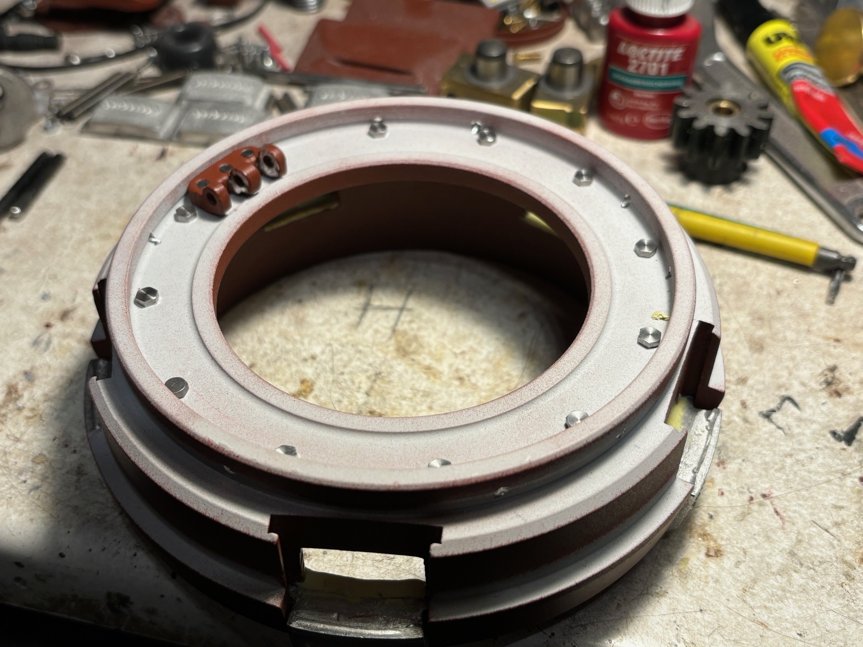

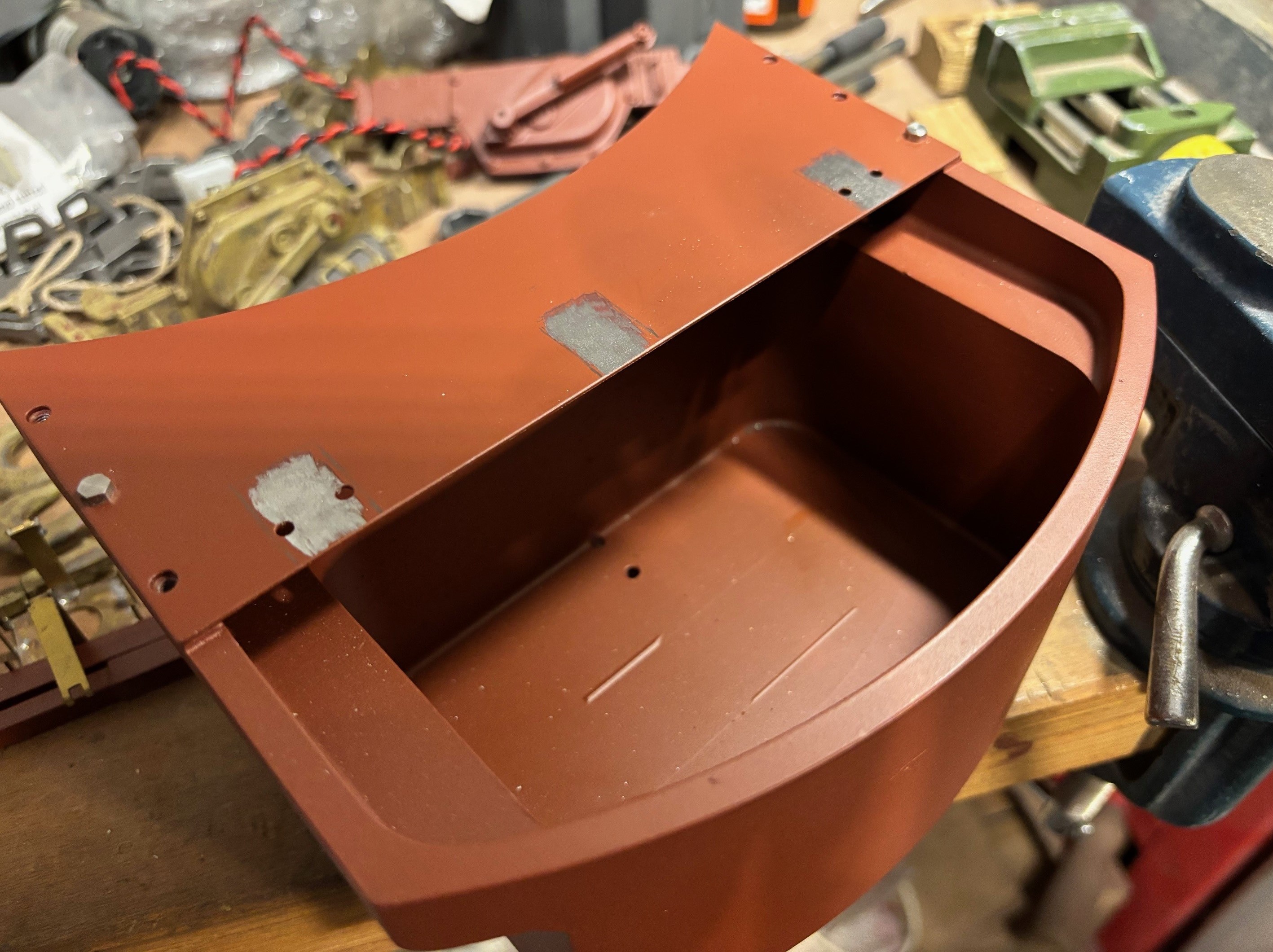

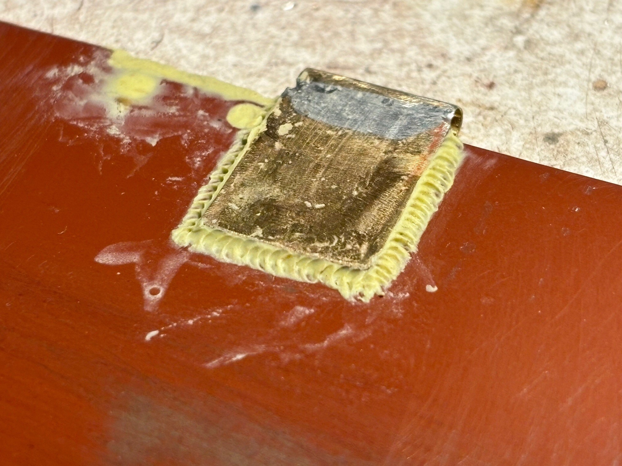

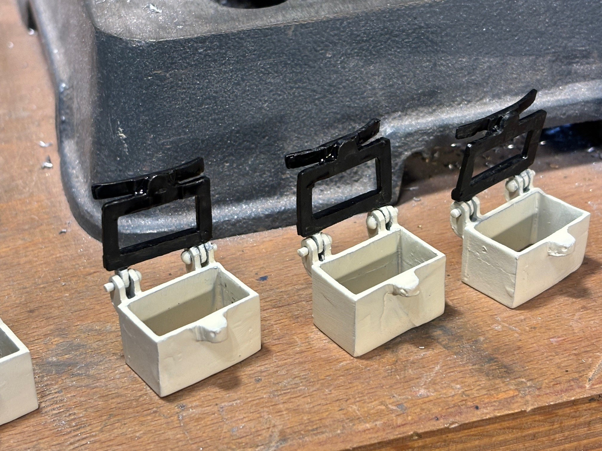

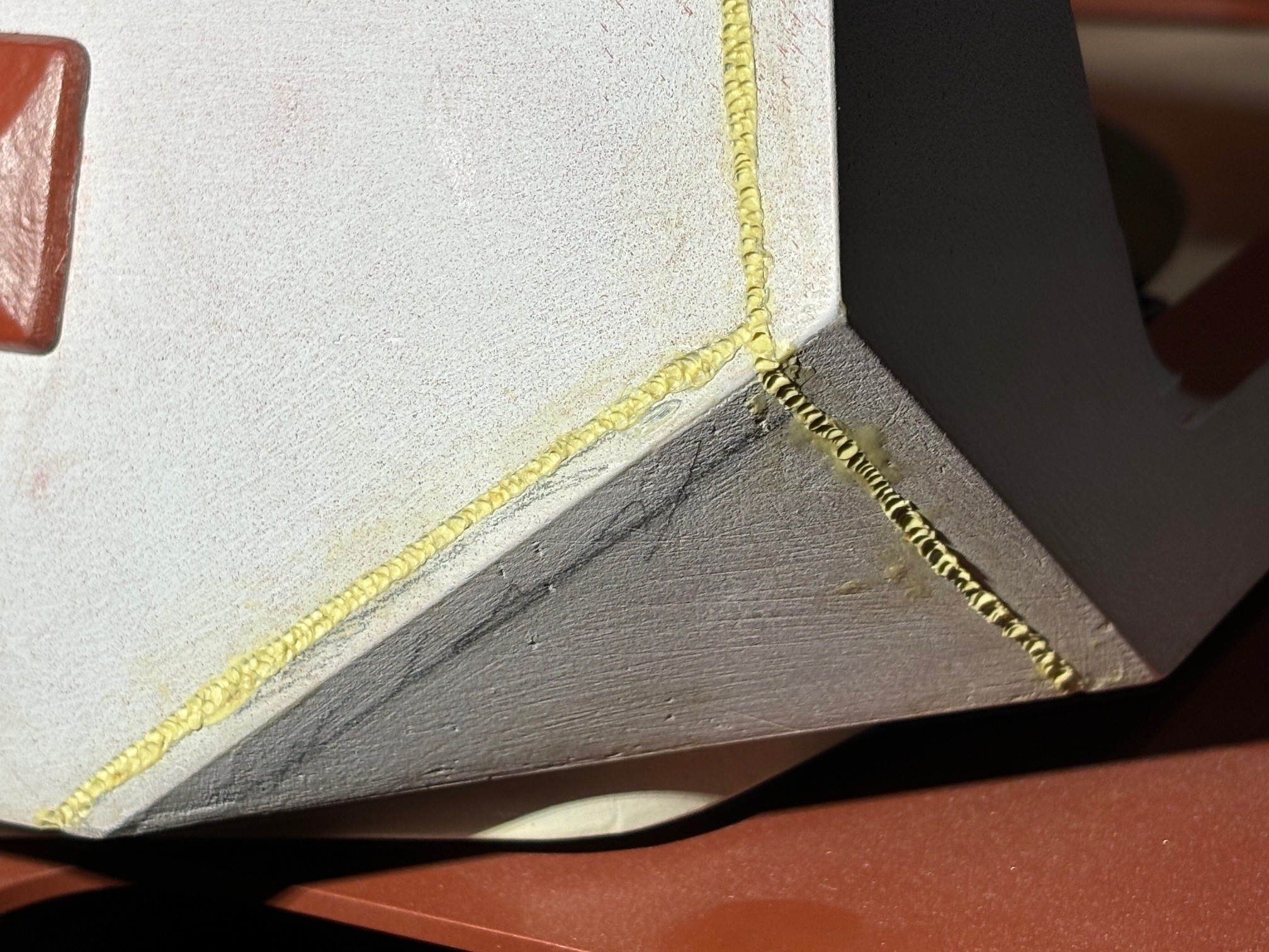

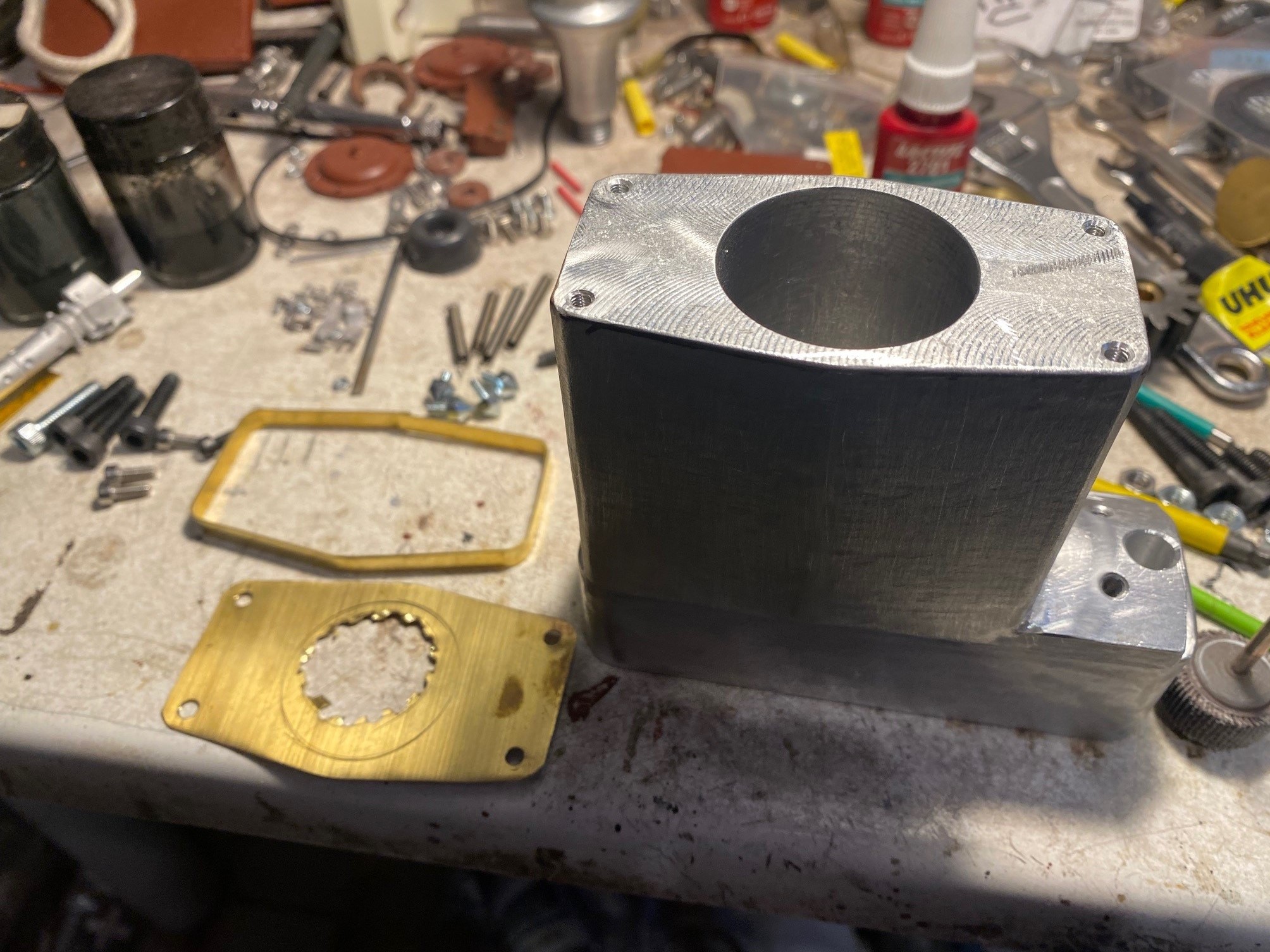

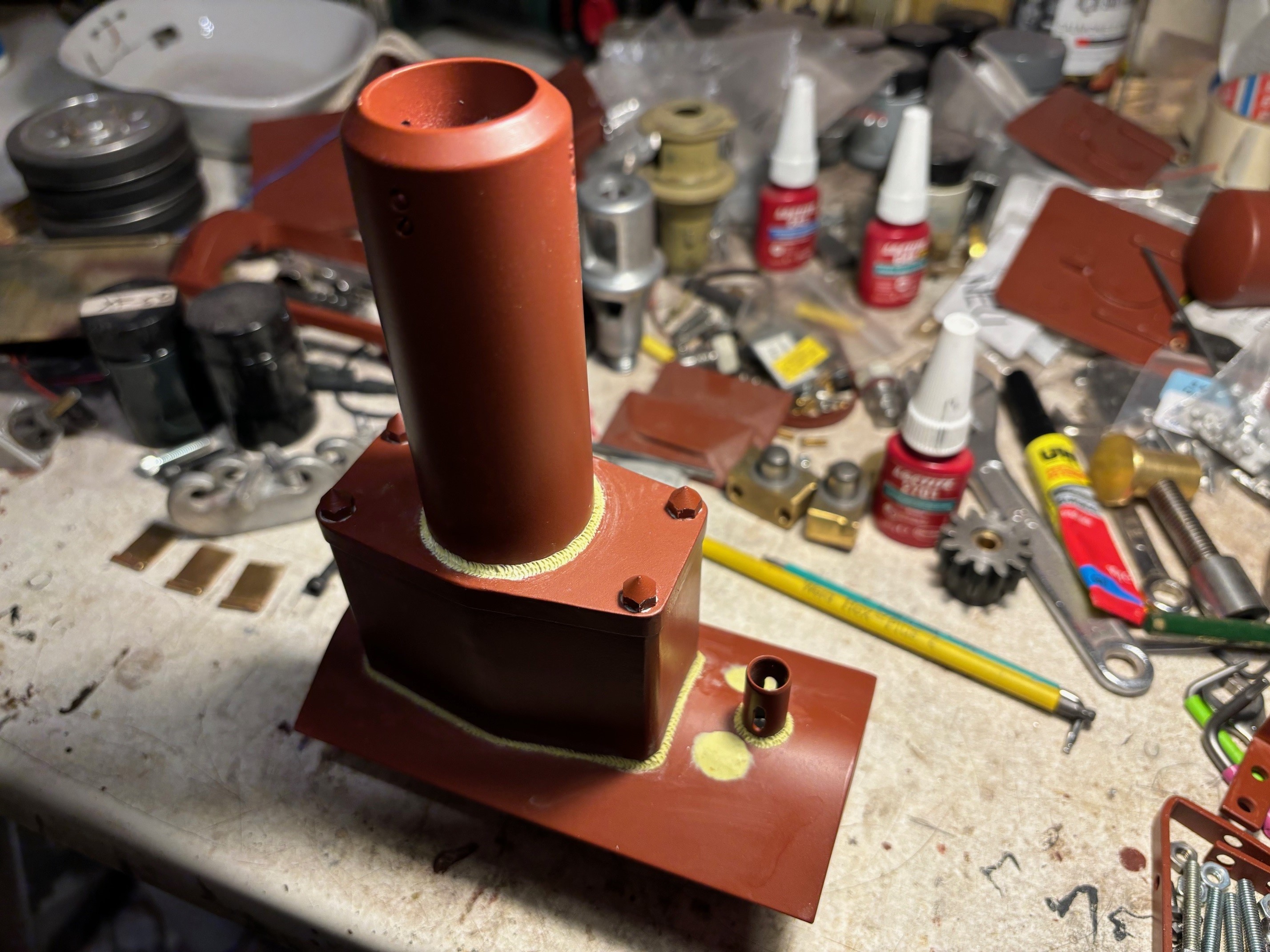

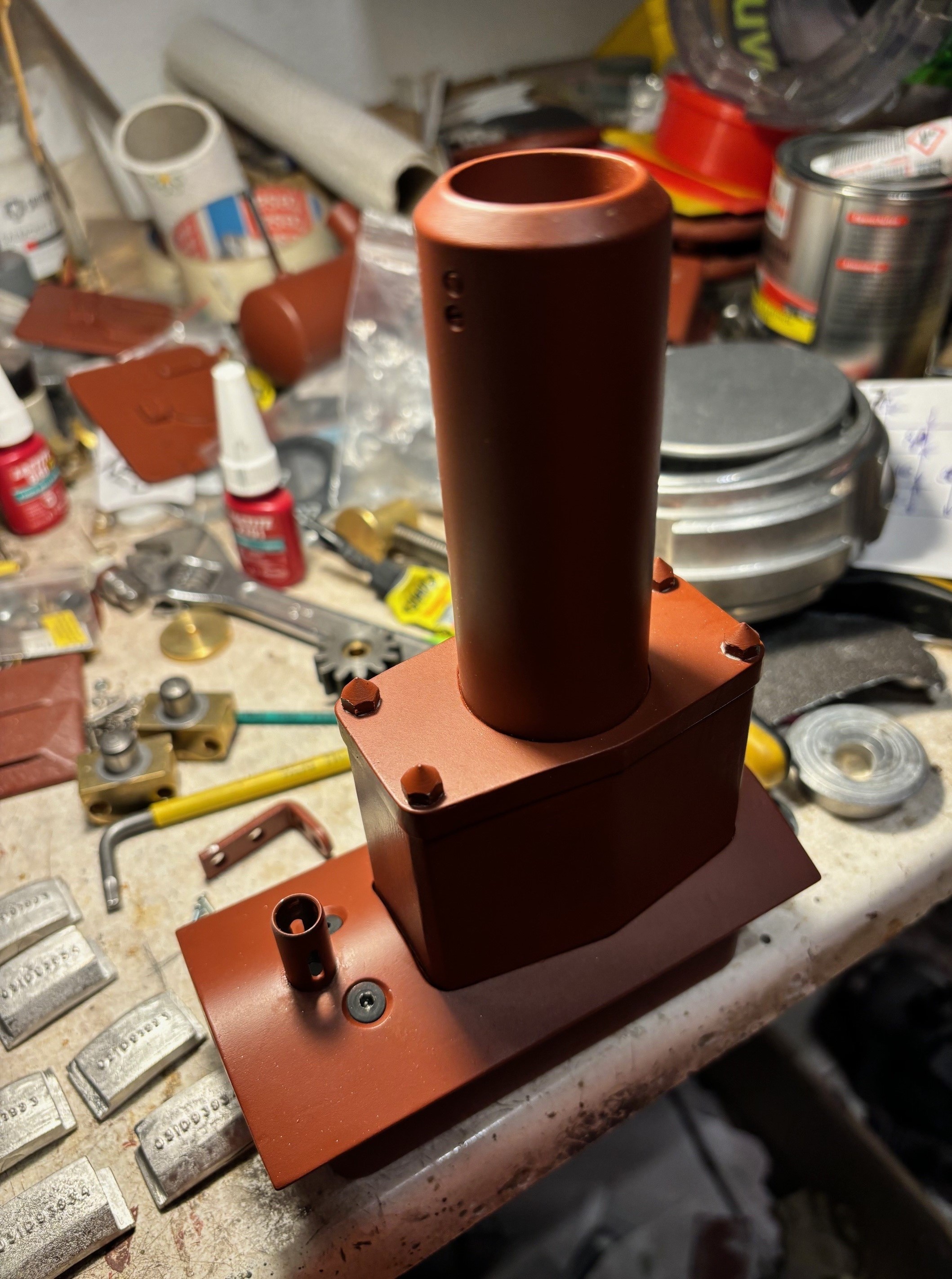

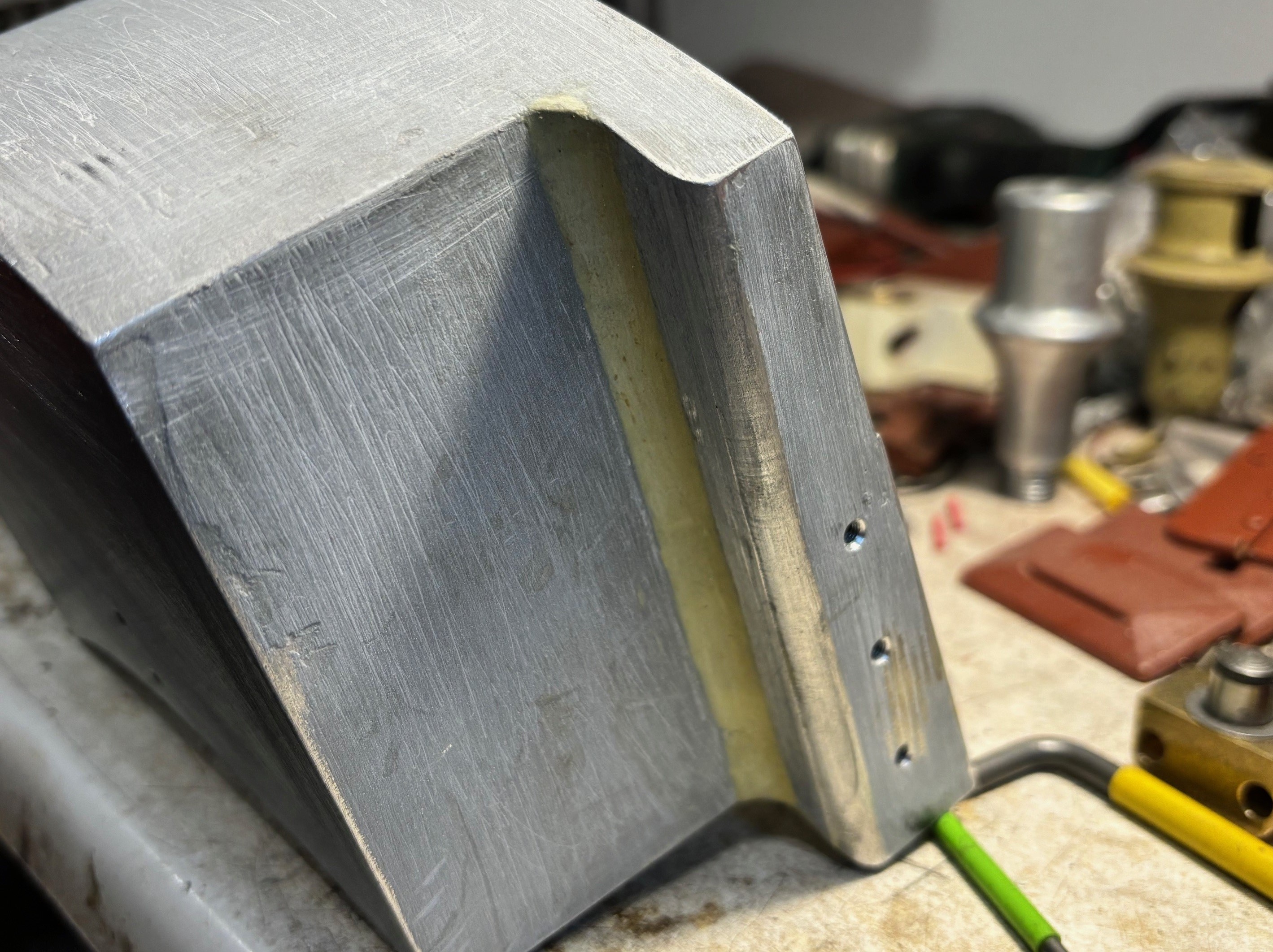

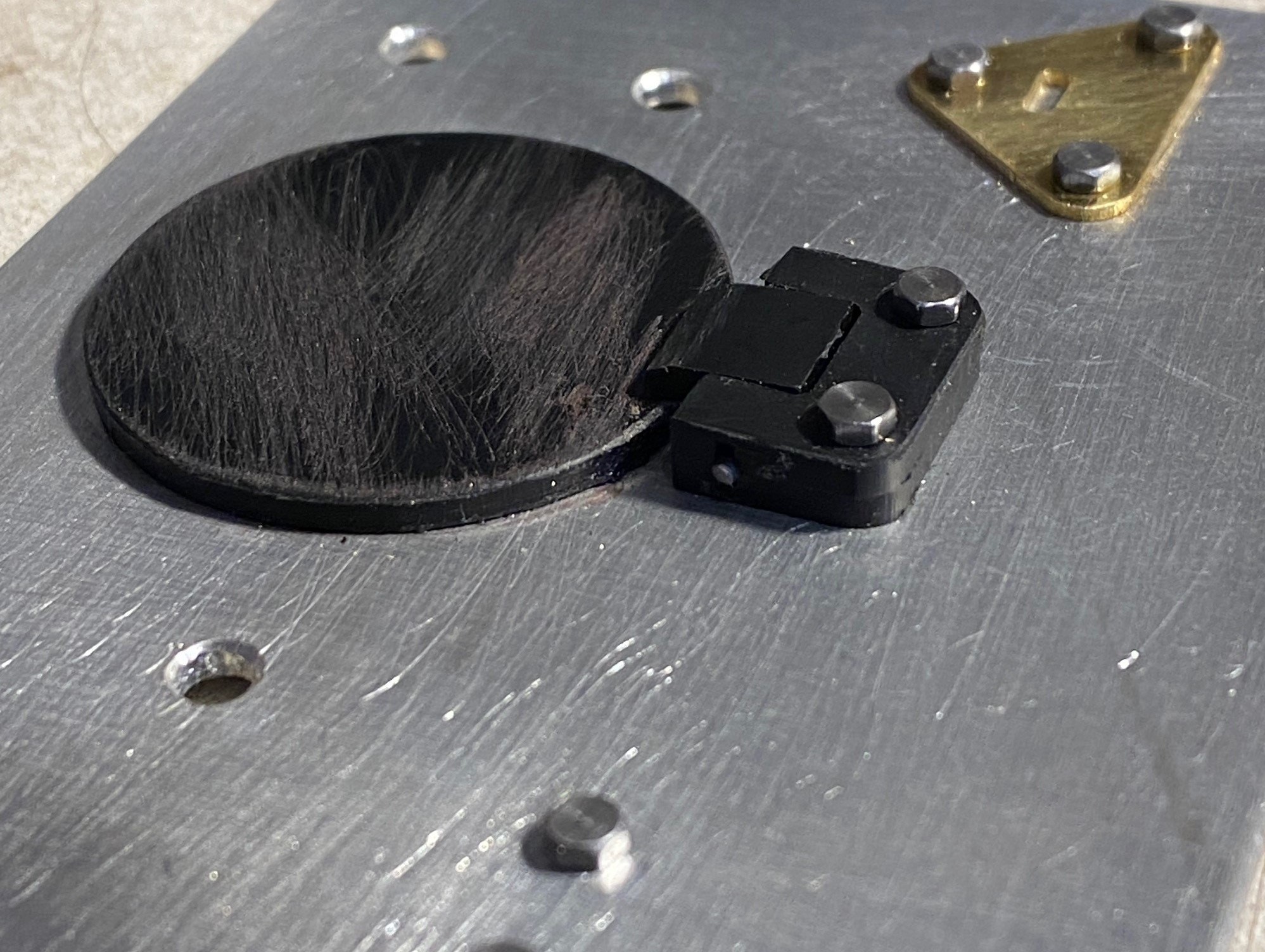

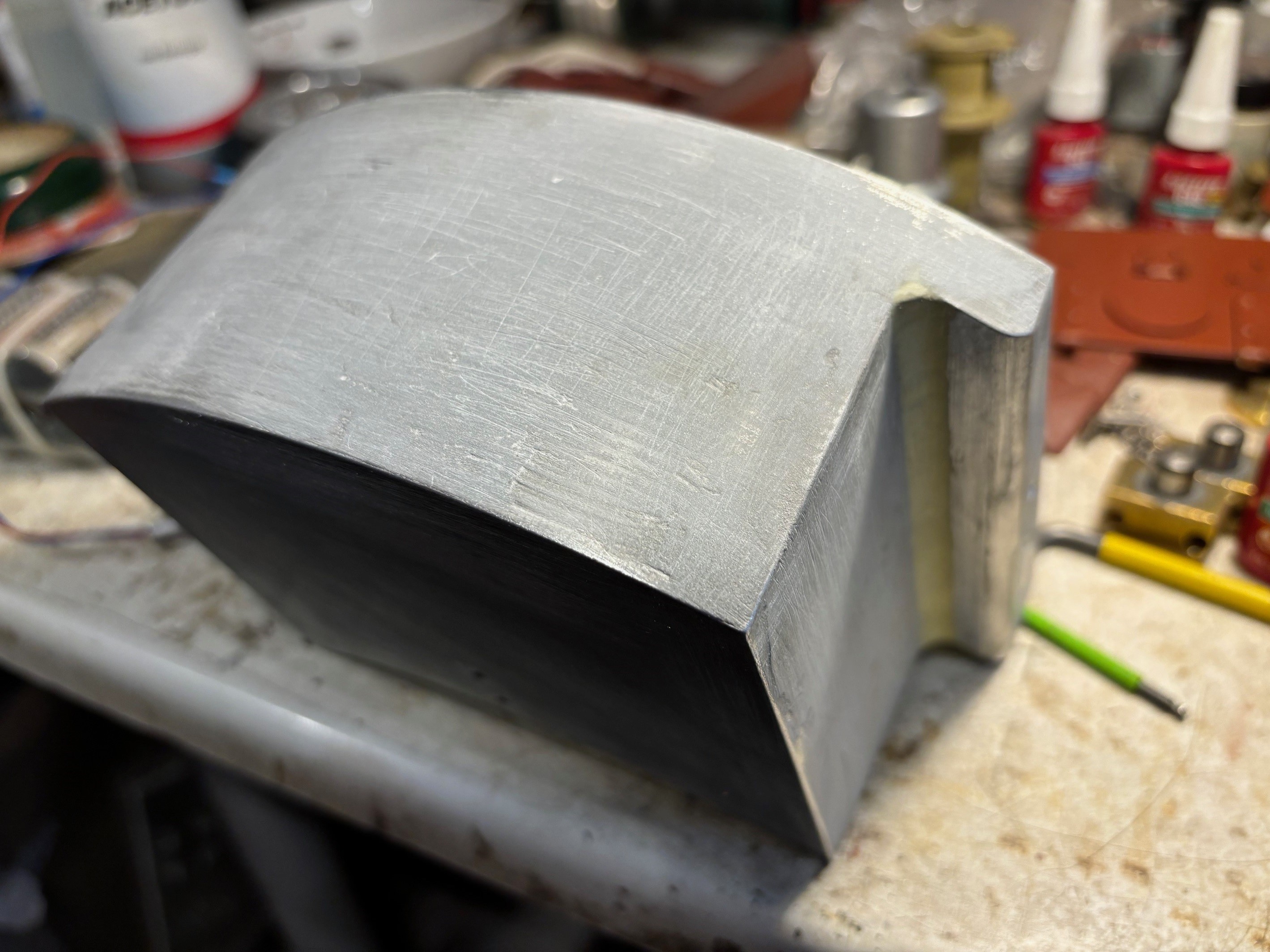

The next is the turret with the Rommel - Kiste. I use a 2-component aluminium based filler to conceal the milled grooves.
The lid of the Rommel - Kiste got 3 new hinges made by me.
Regards Martin

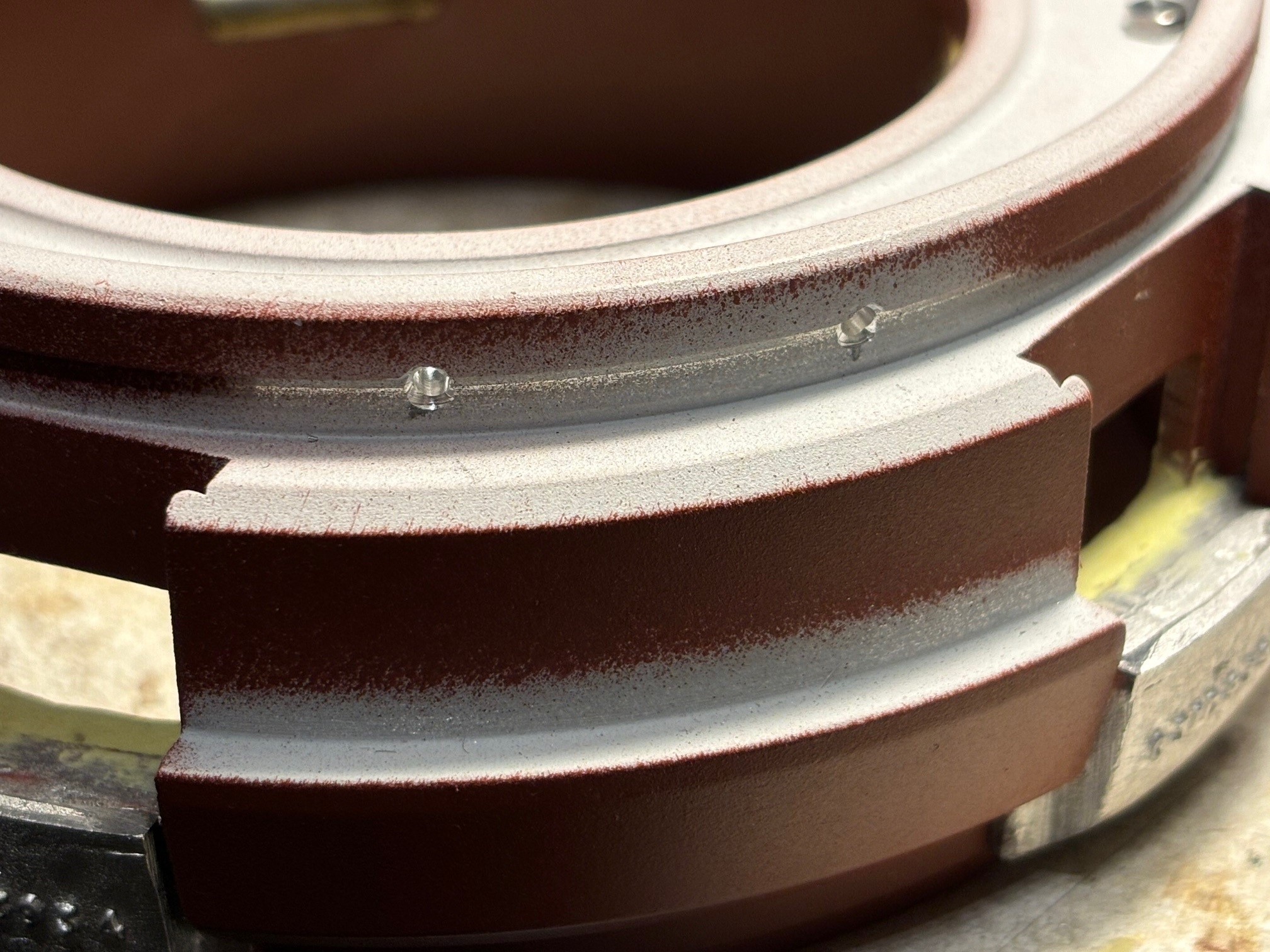

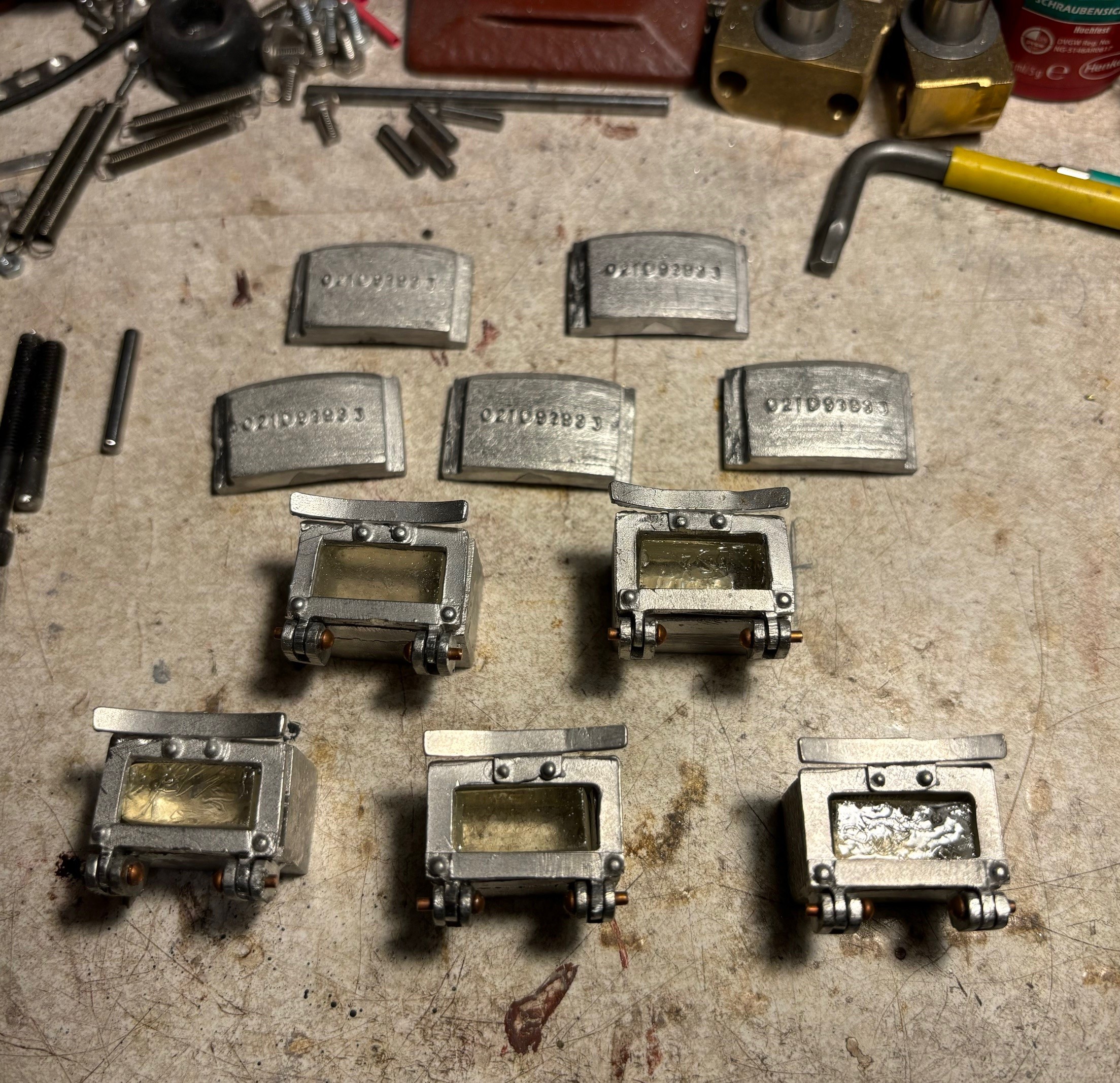

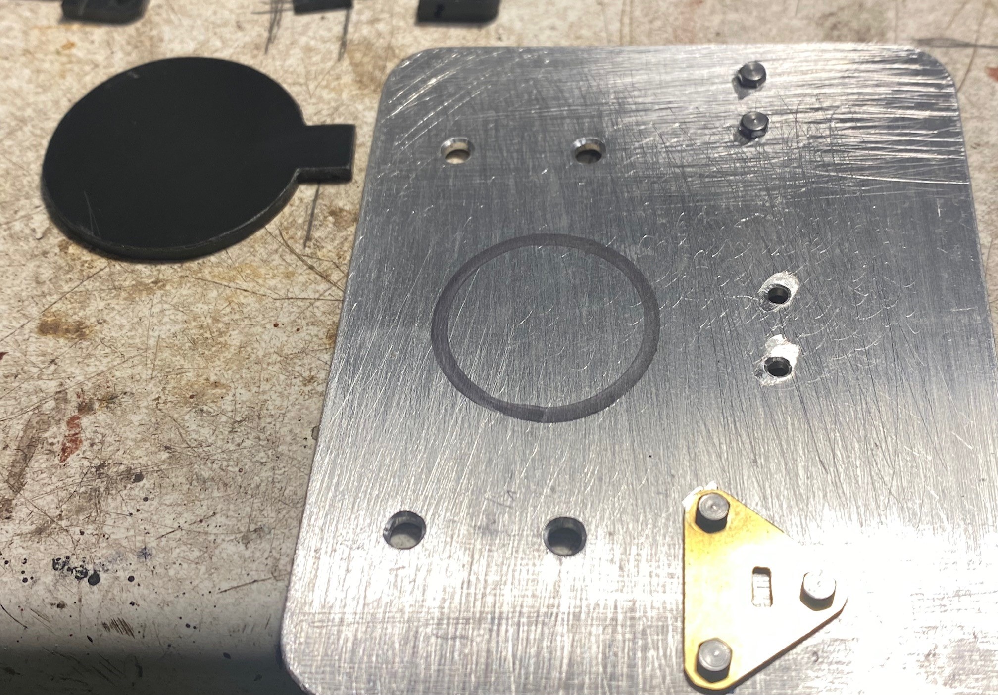

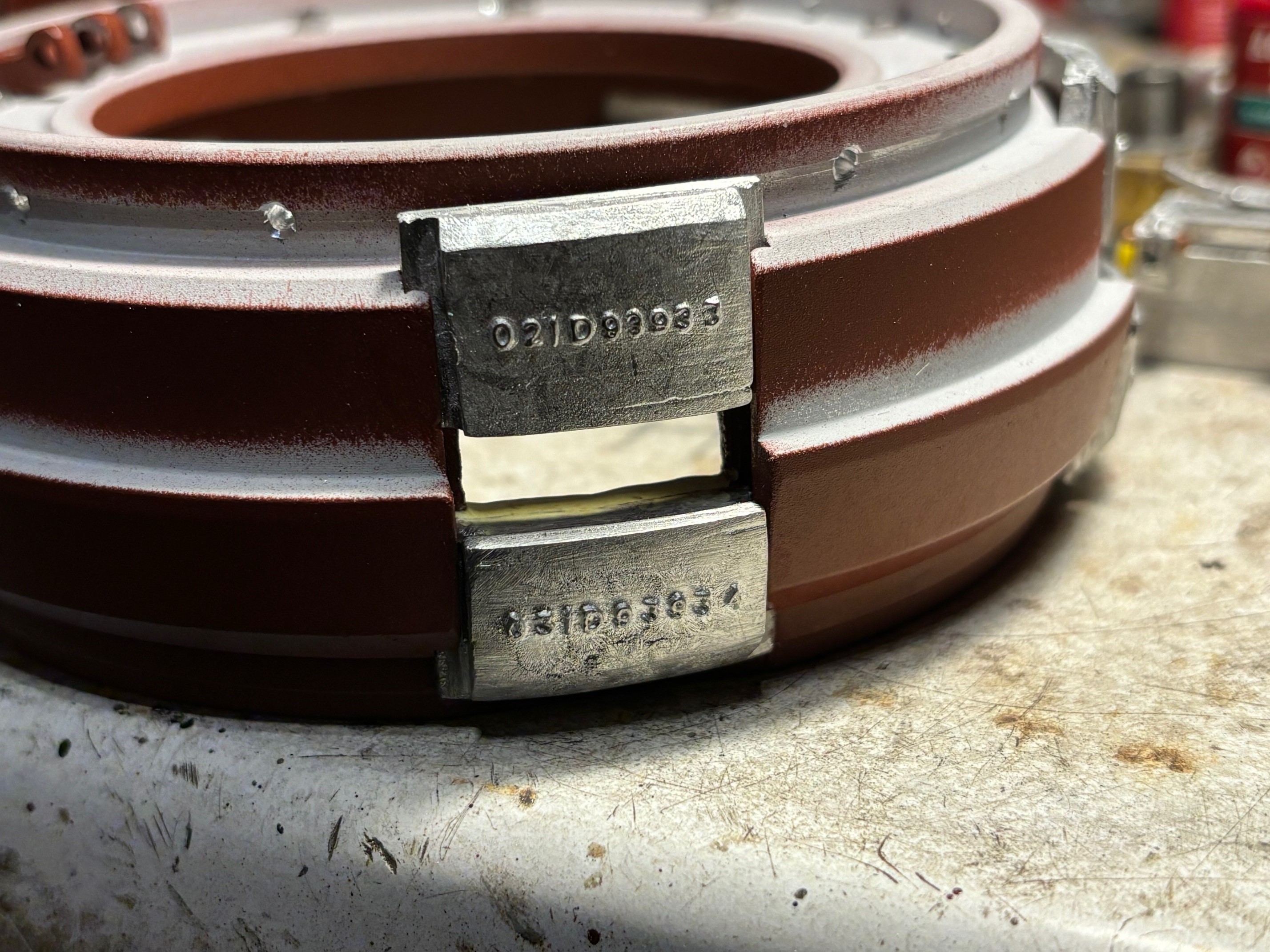

Now the next part is the cupola with all openings for the vision ports with the clear resin inserts.
Regards Martin

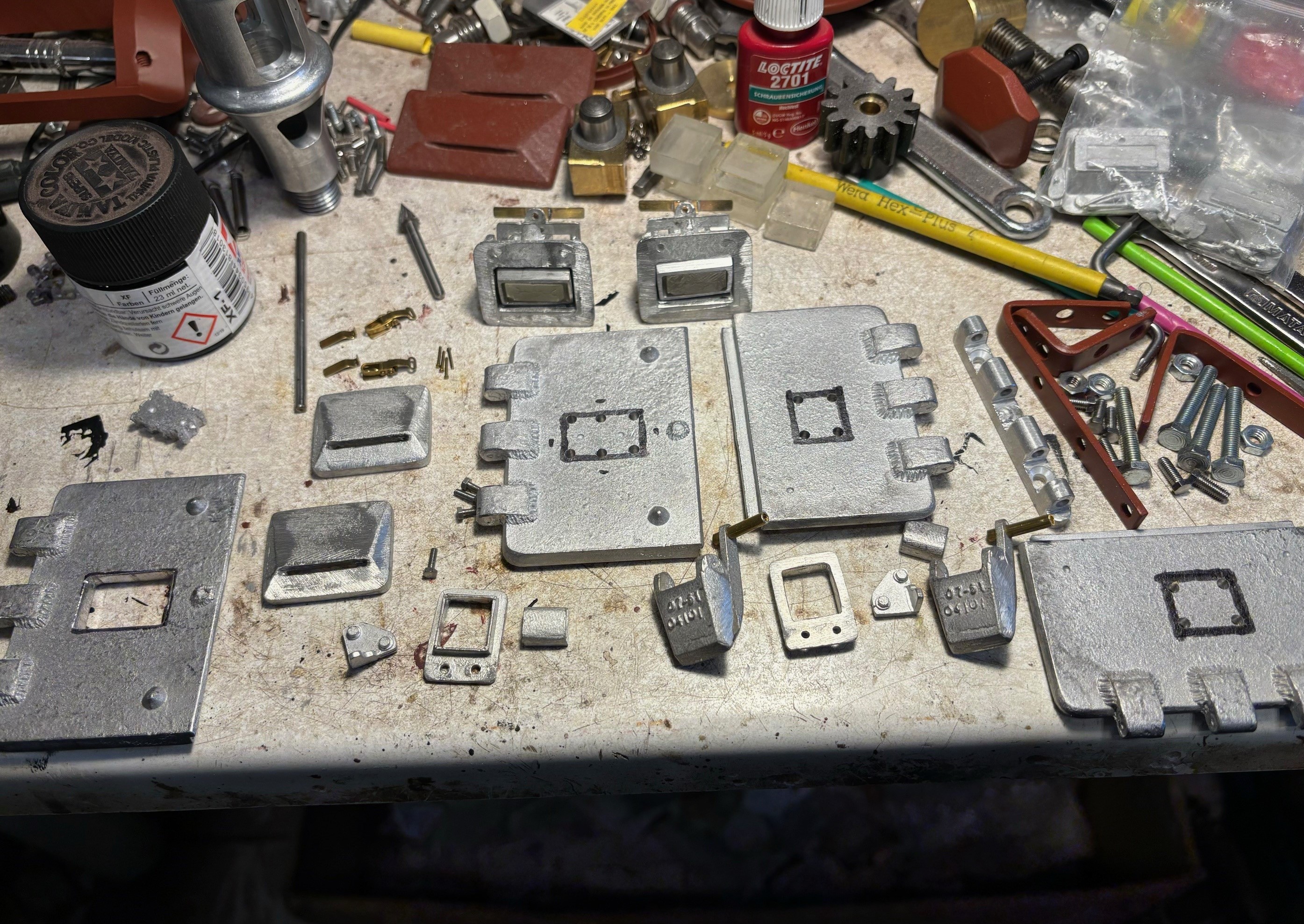

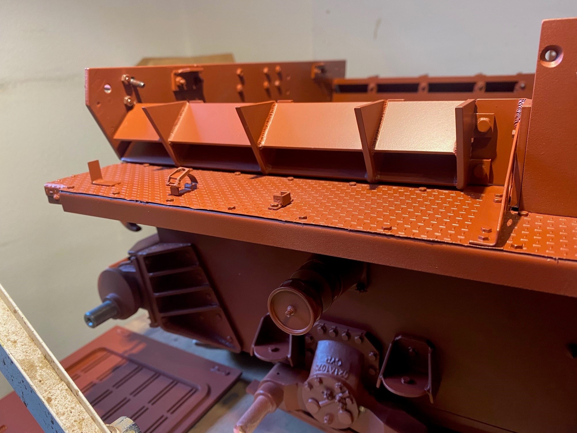

The next are the vision ports and the side doors with all details in it.
Regards Martin

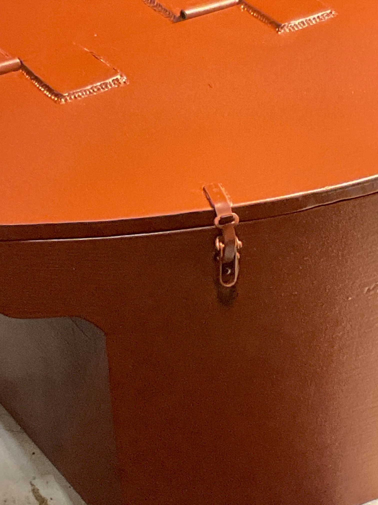

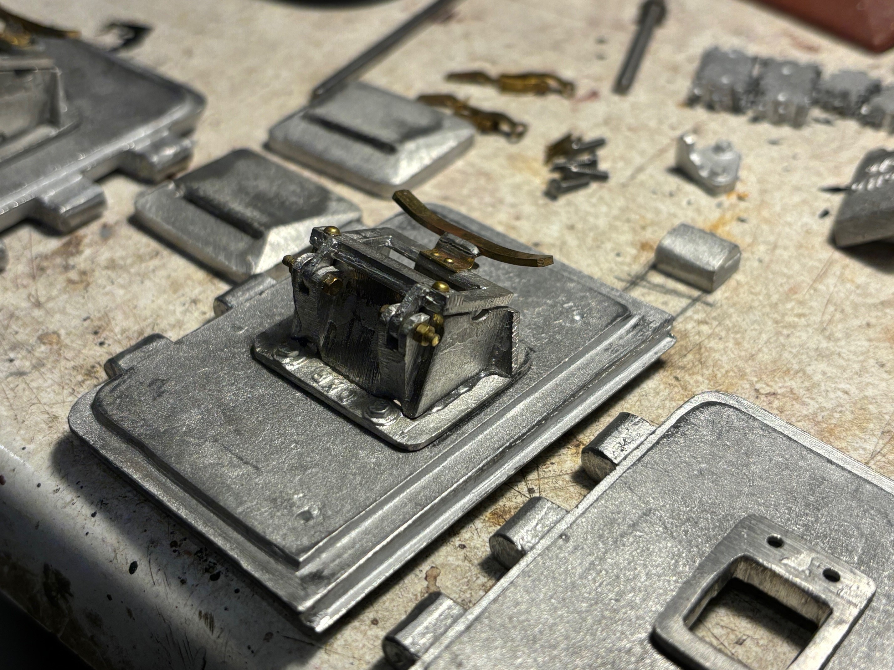

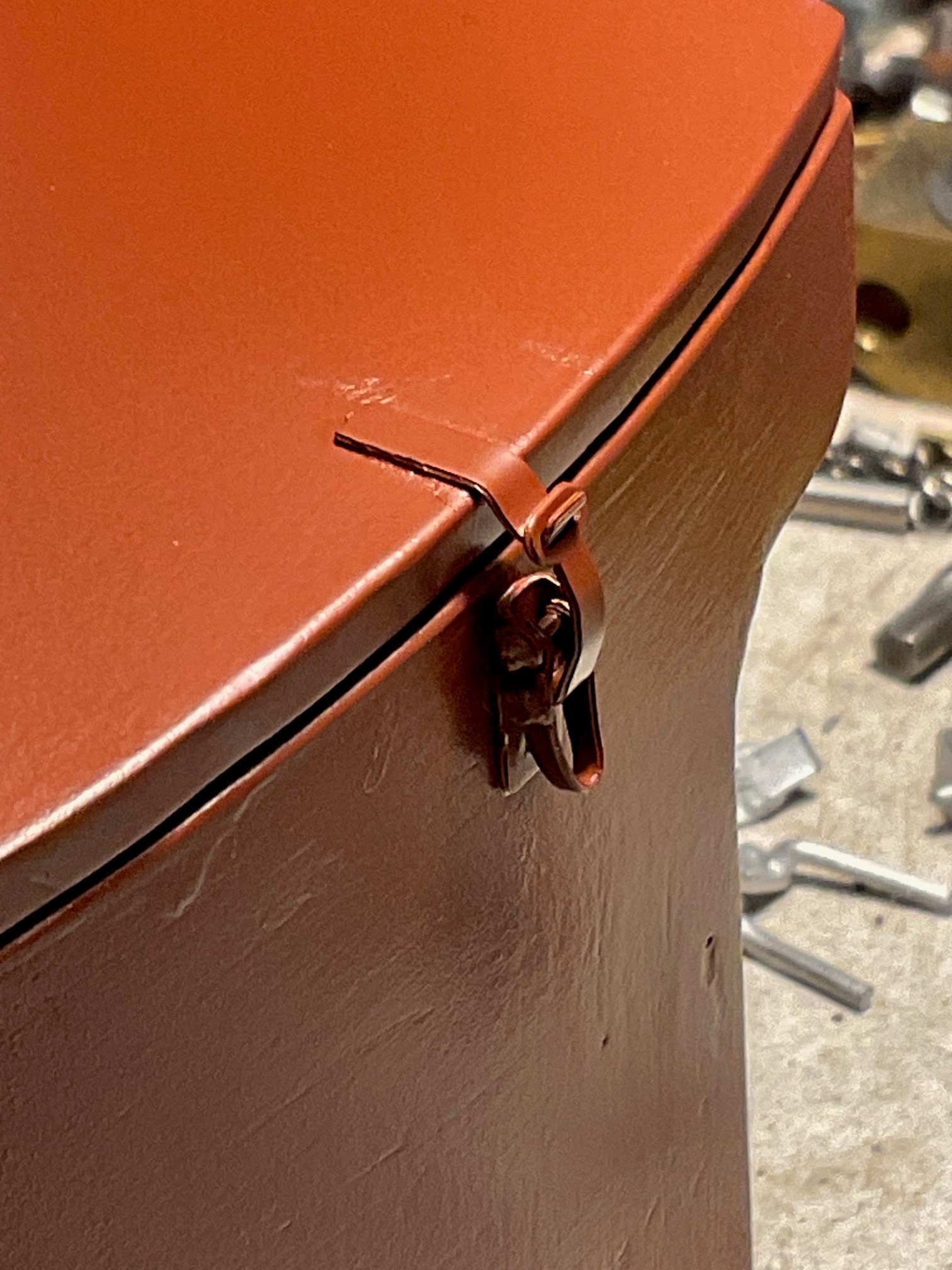

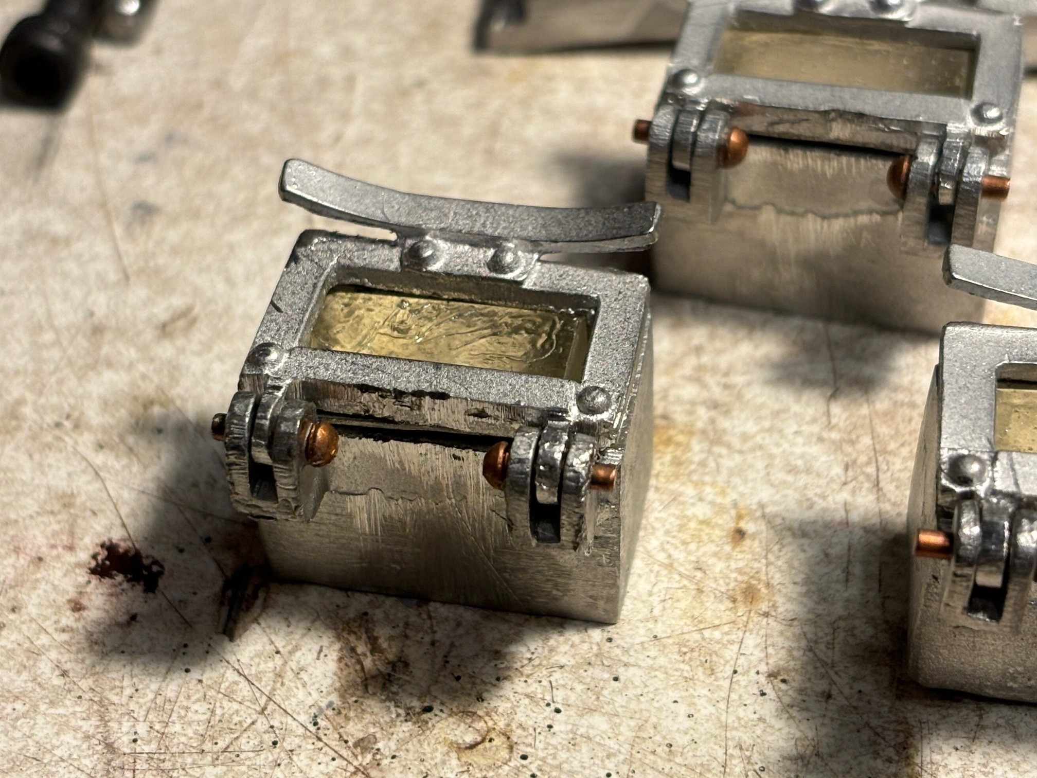

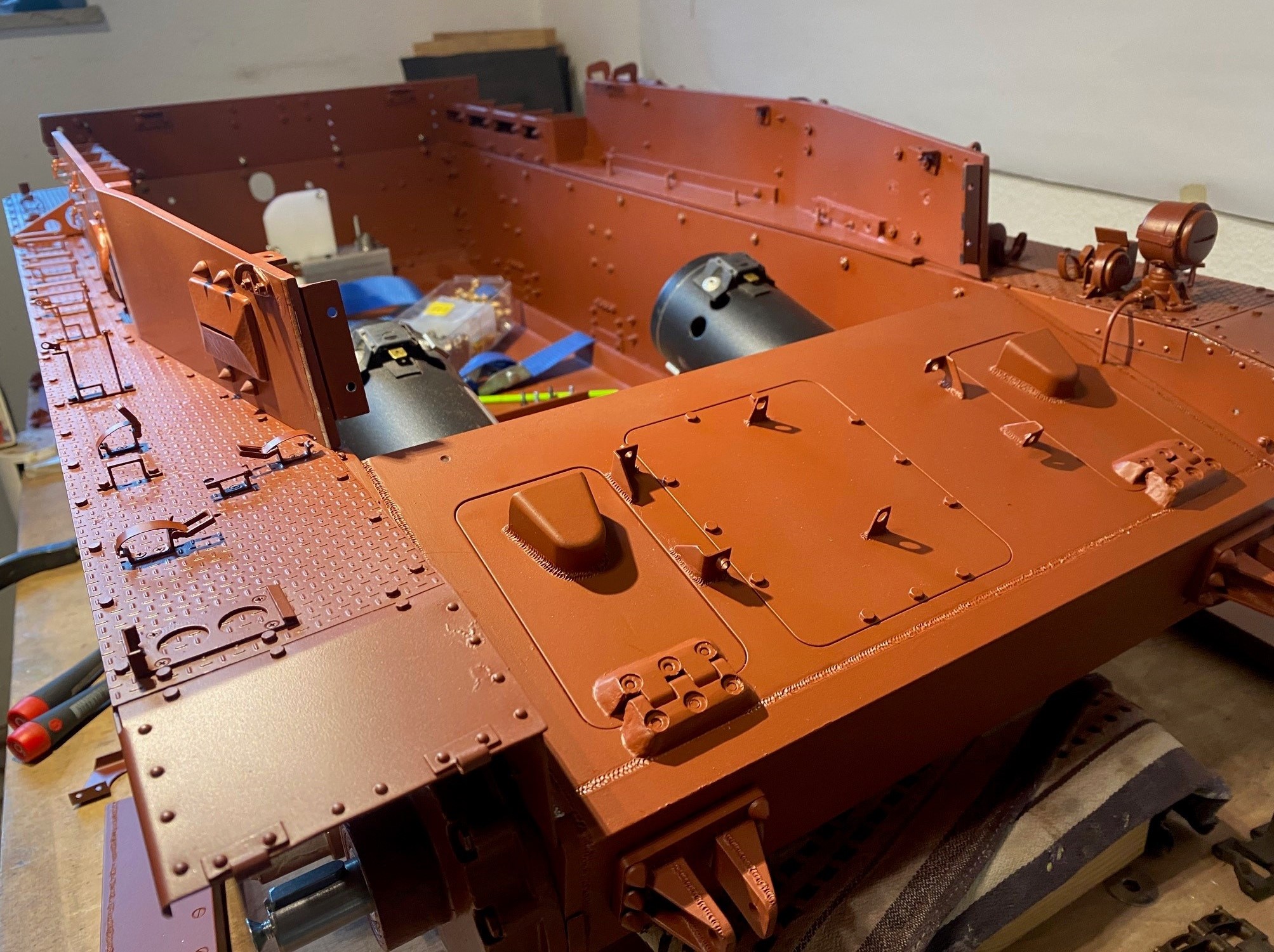

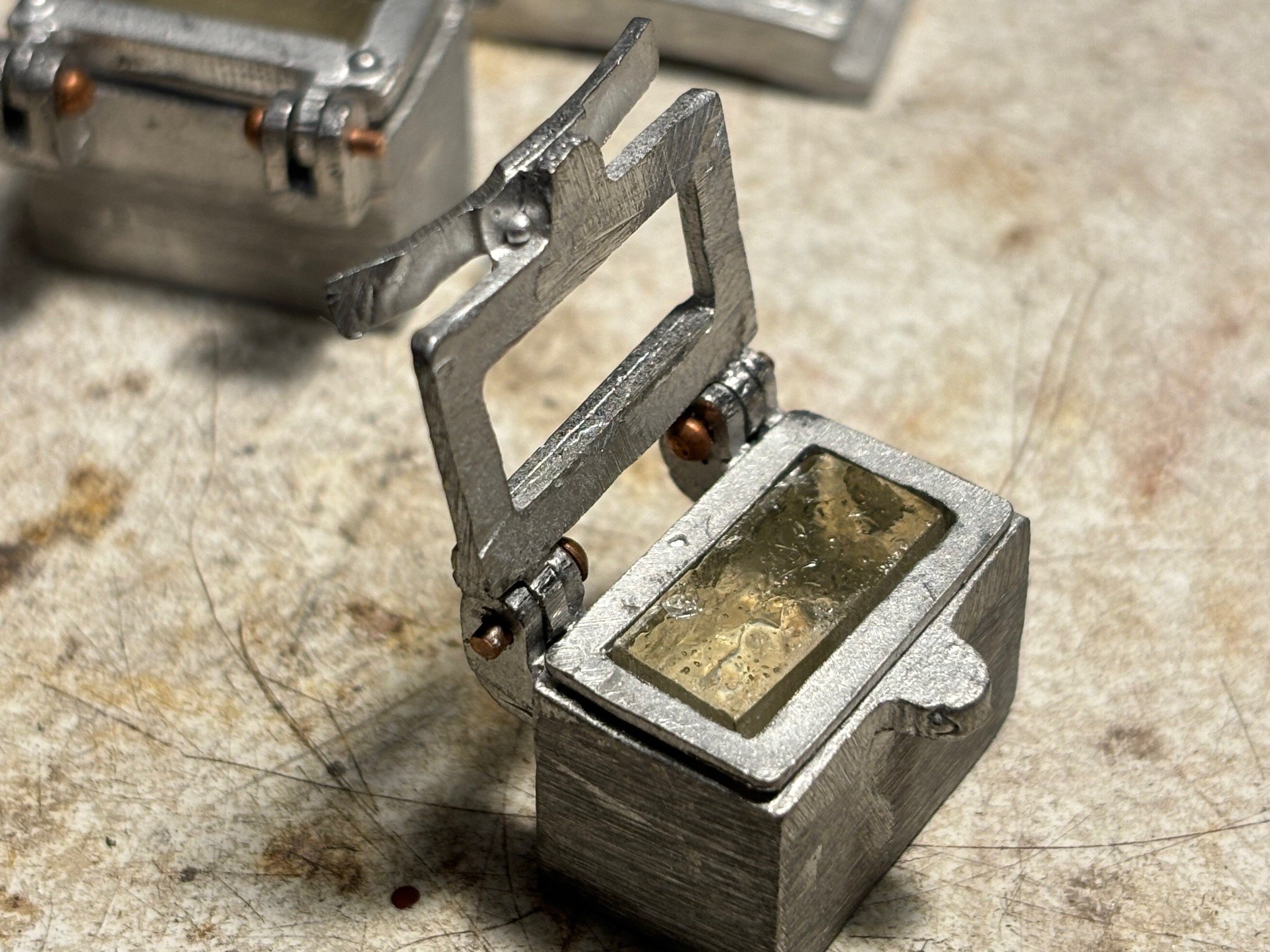

here are some more brass soldered parts from the Rommel Kiste
Regards Martin

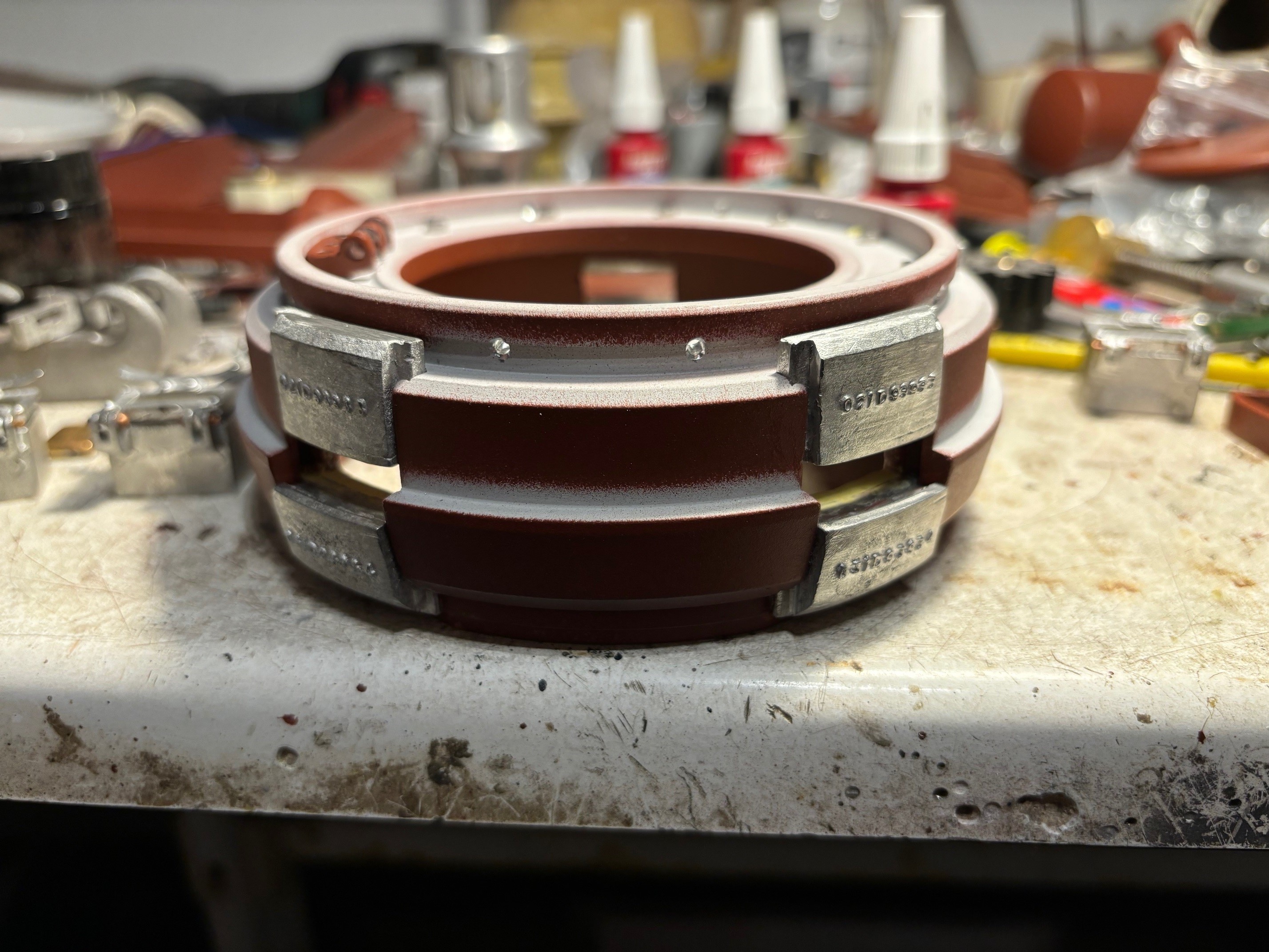

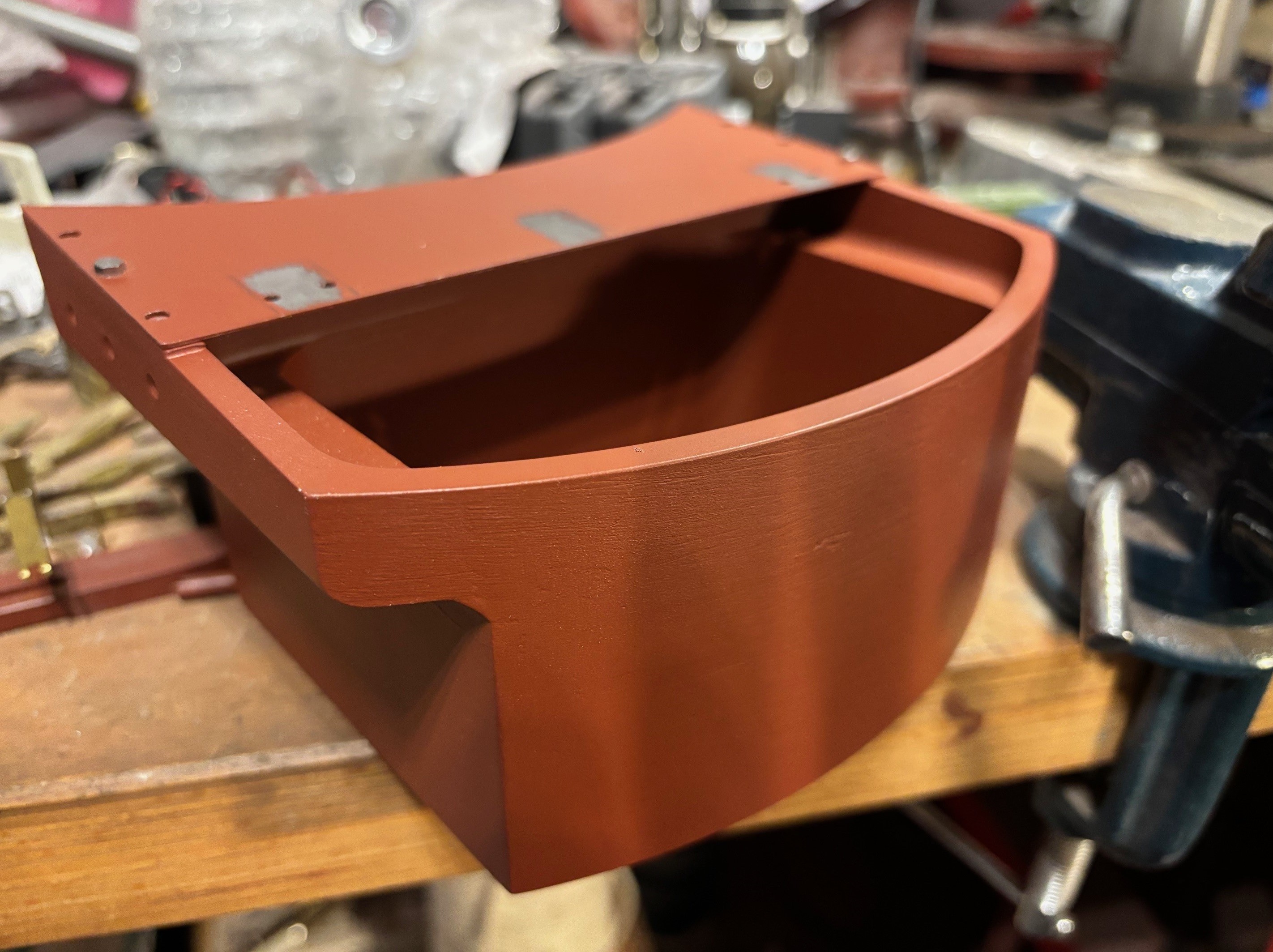

Next some more done on the cannon and the turret
Regards Martin
