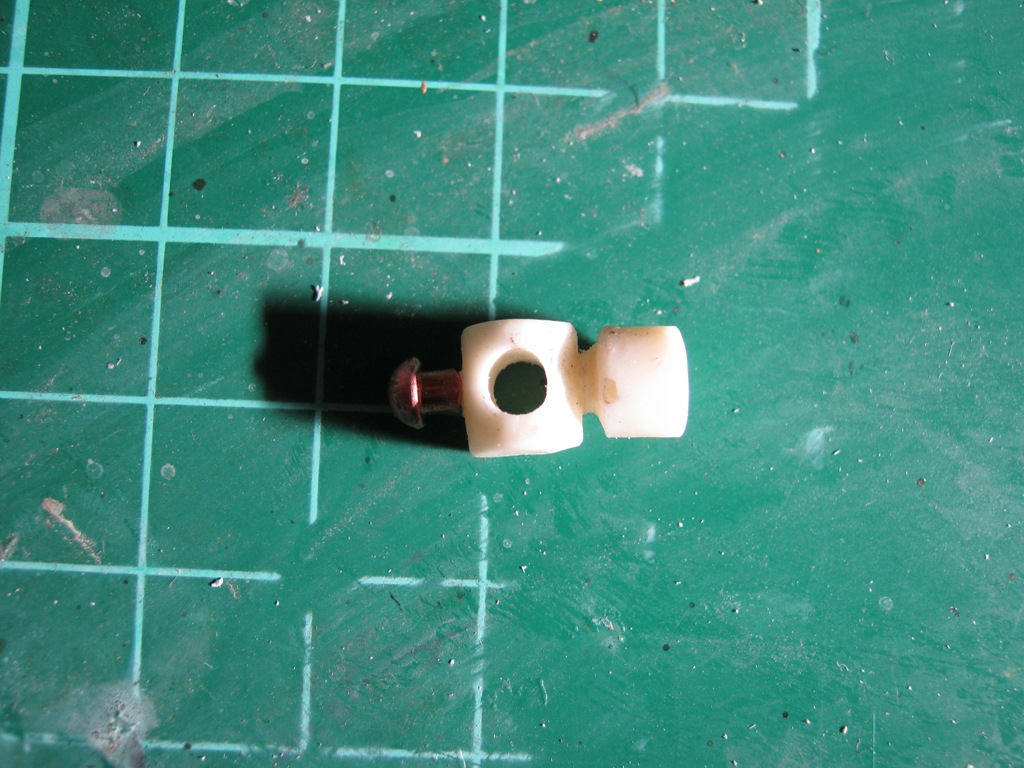

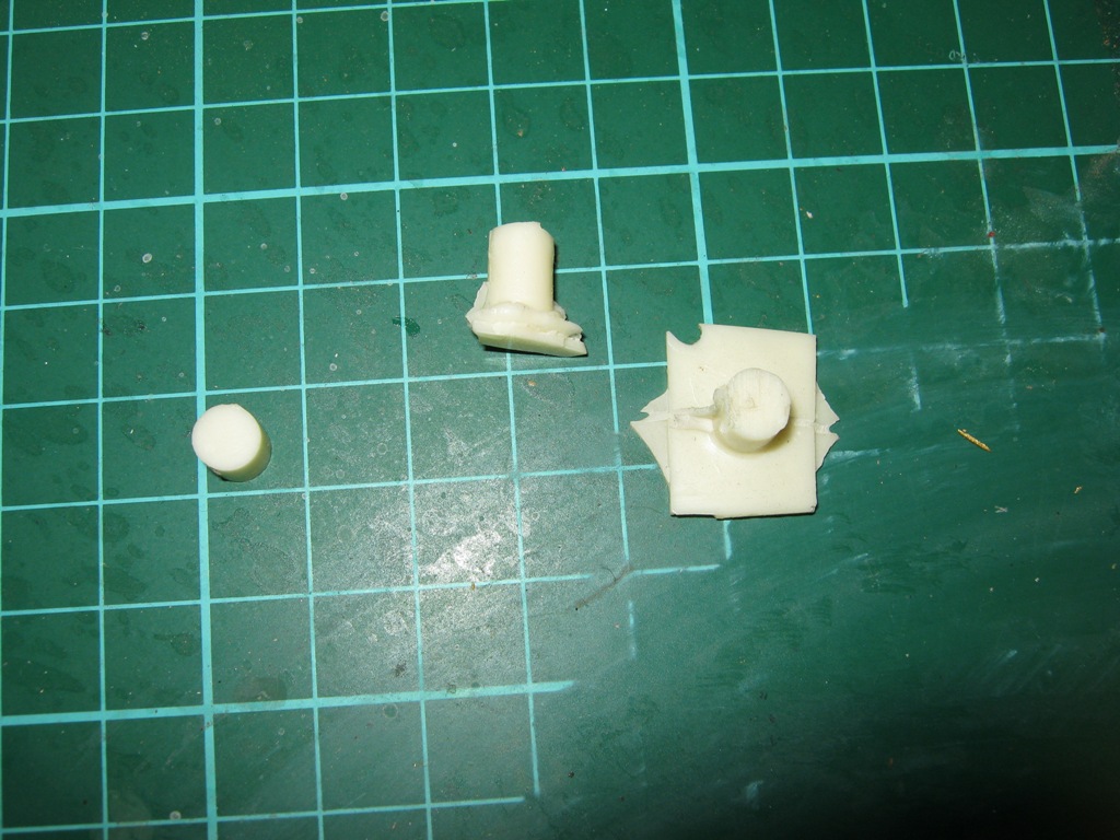

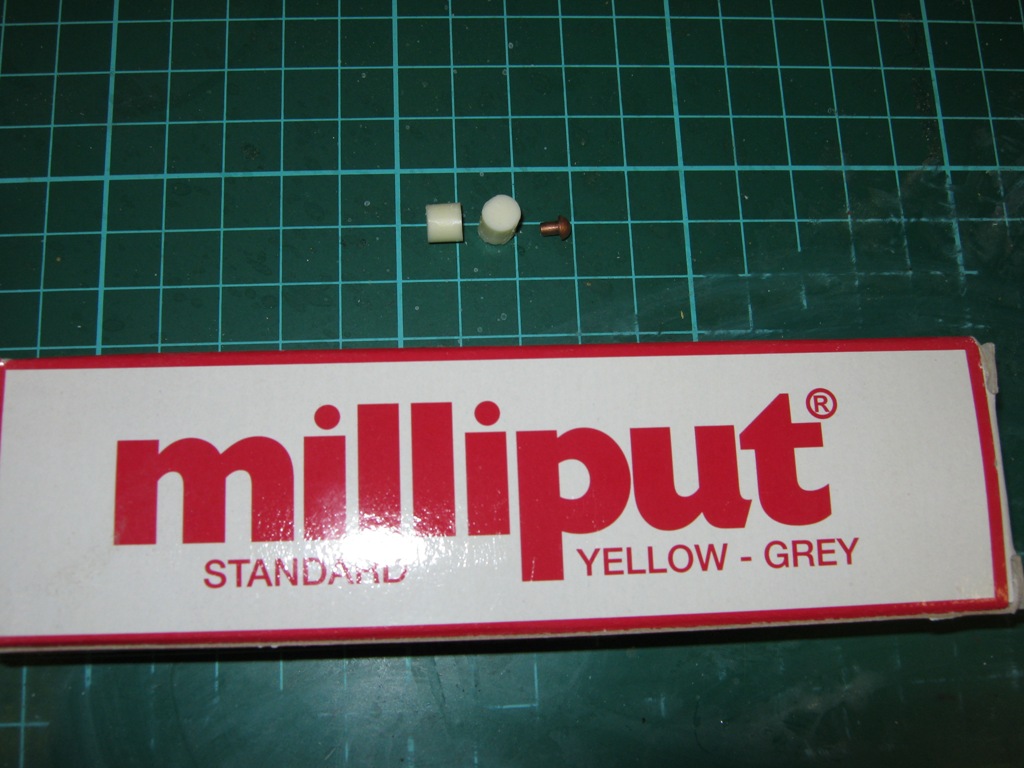

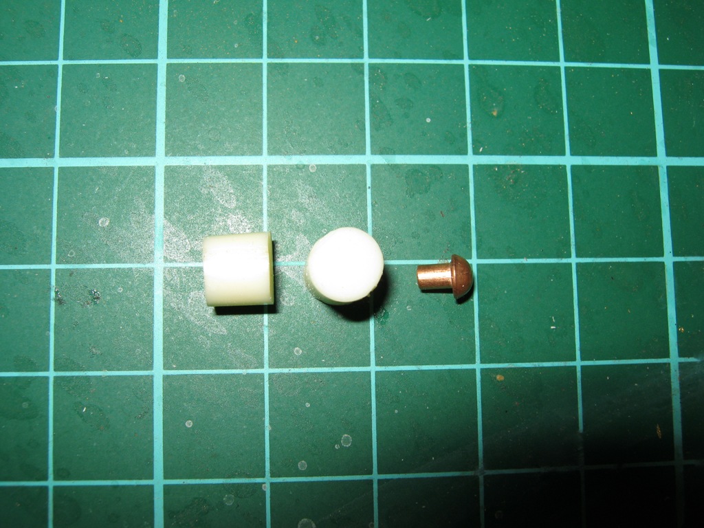

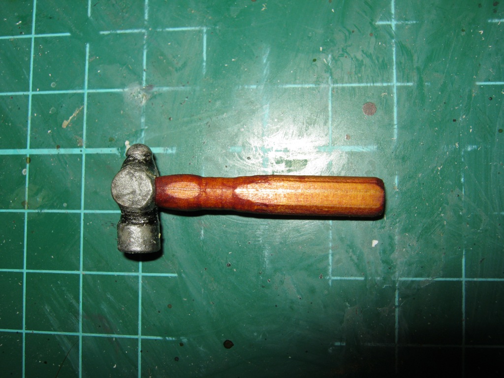

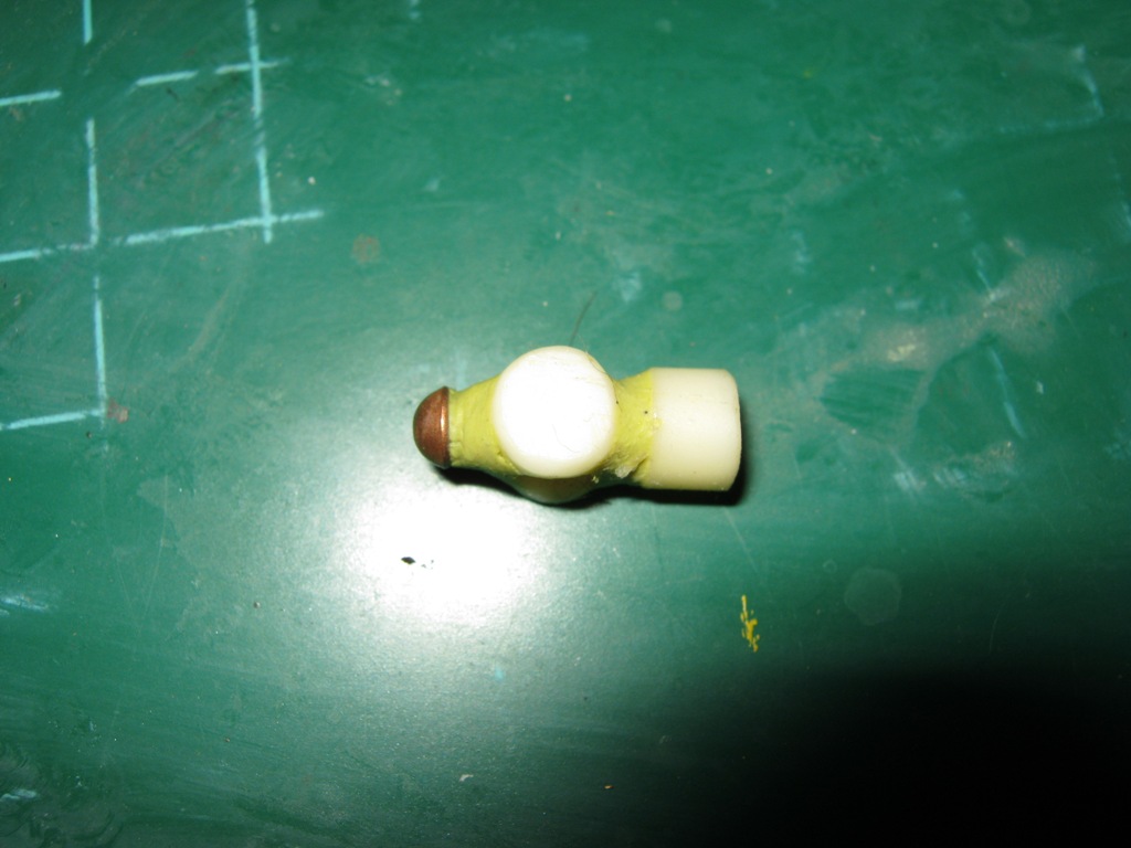

Thanks for the comments. Don't be put off by what you see on here :) I have no machinery to work with, apart from a pillar drill and that's why you will see a lot of plastic in my parts, because its easier to work with. You can do it, but sometimes it takes a rethink.
A few years ago I wanted a 1/6th engineers ball hammer and couldn't find one anywhere, so I decided to make one myself. All I had was some bits and bats in a box from plastic casings.
for some reason, don't ask me why! I arranged them like this
then I thought, hmmm, add some milliput
A bit of wooden dowel, then paint and Ended up with this!
Paul. :wink:

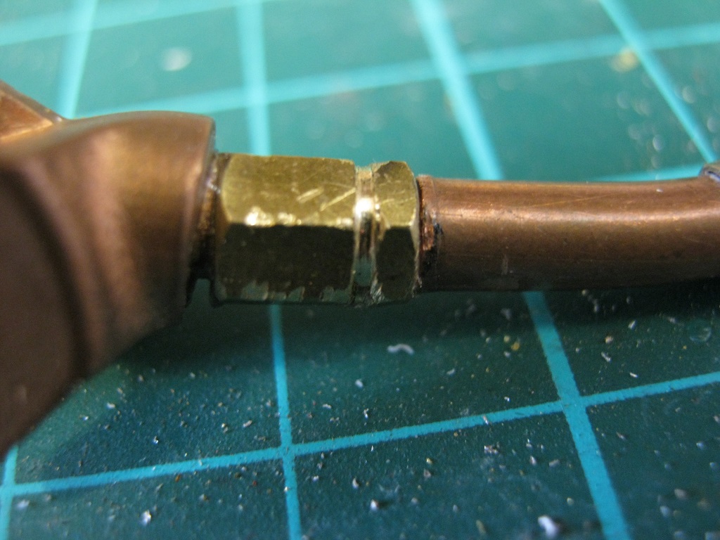

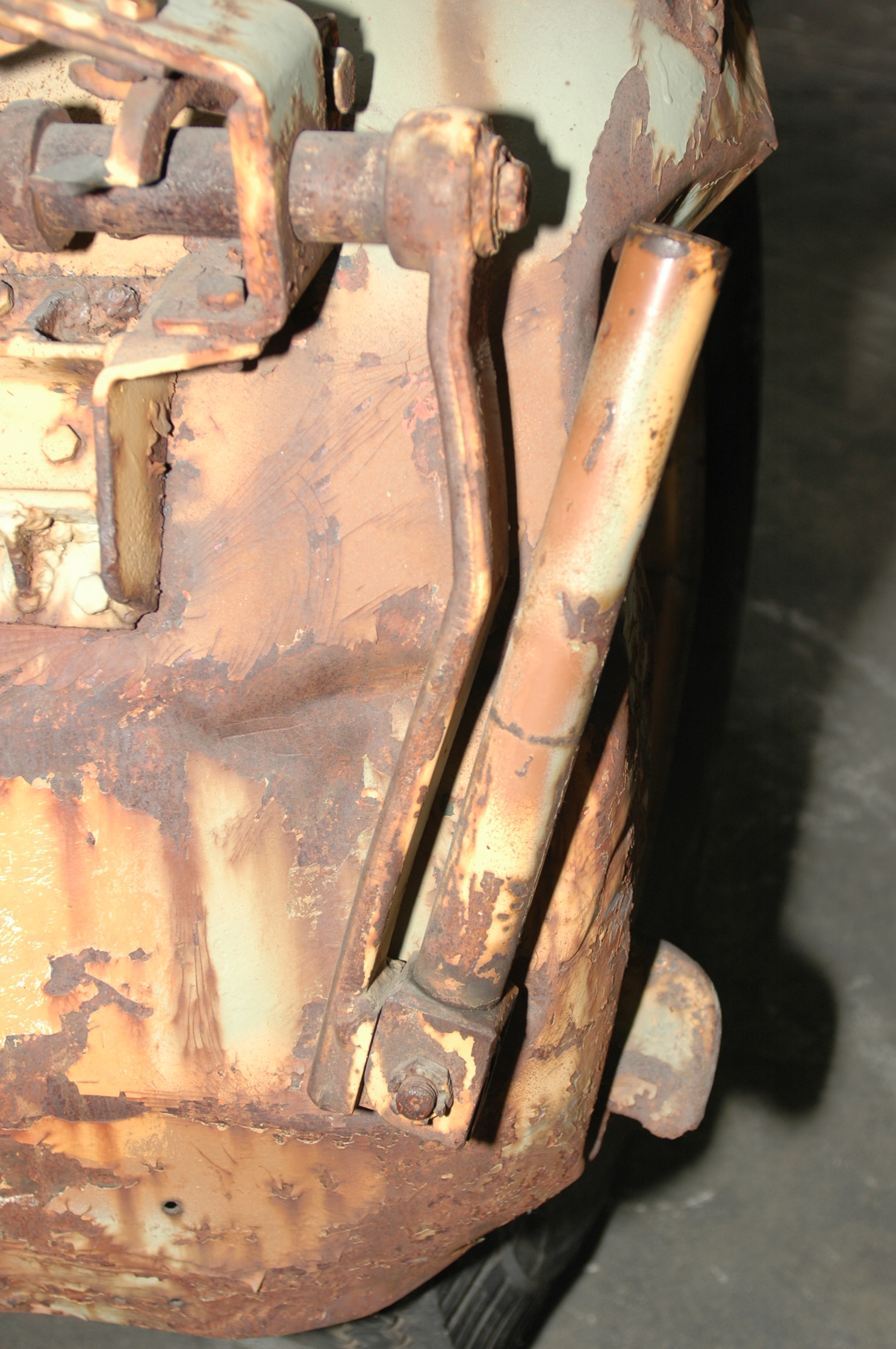

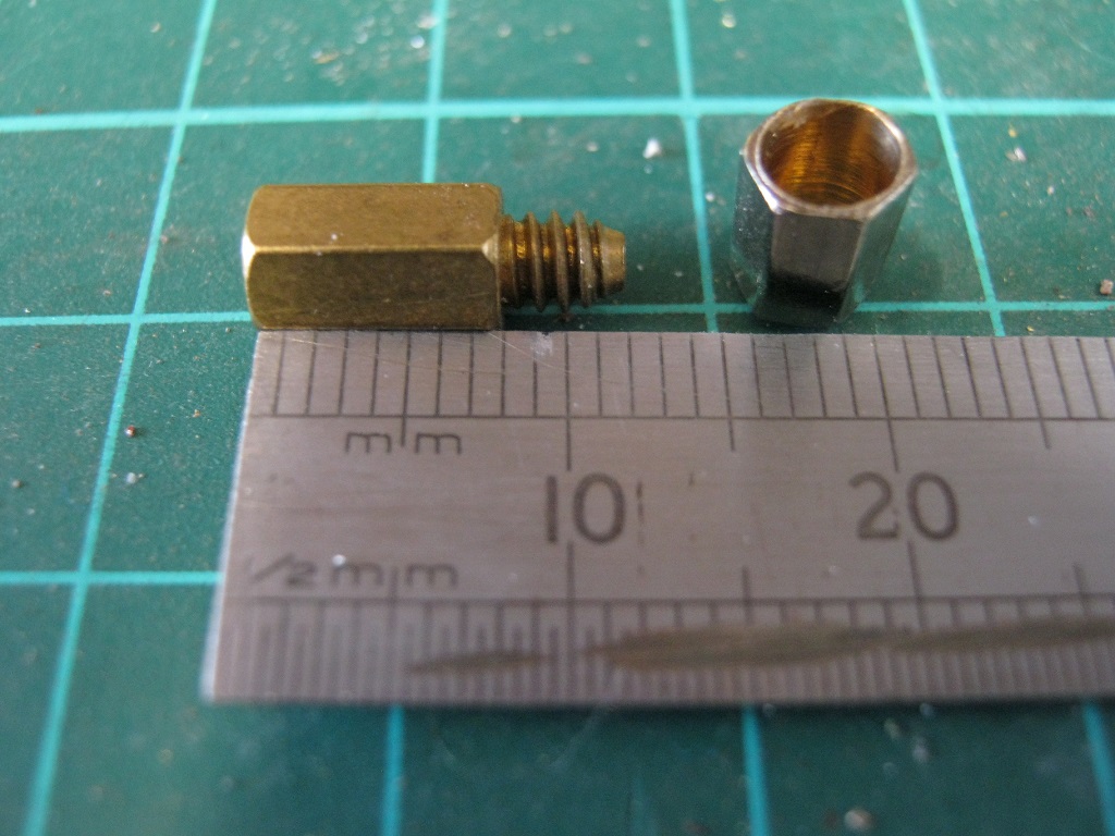

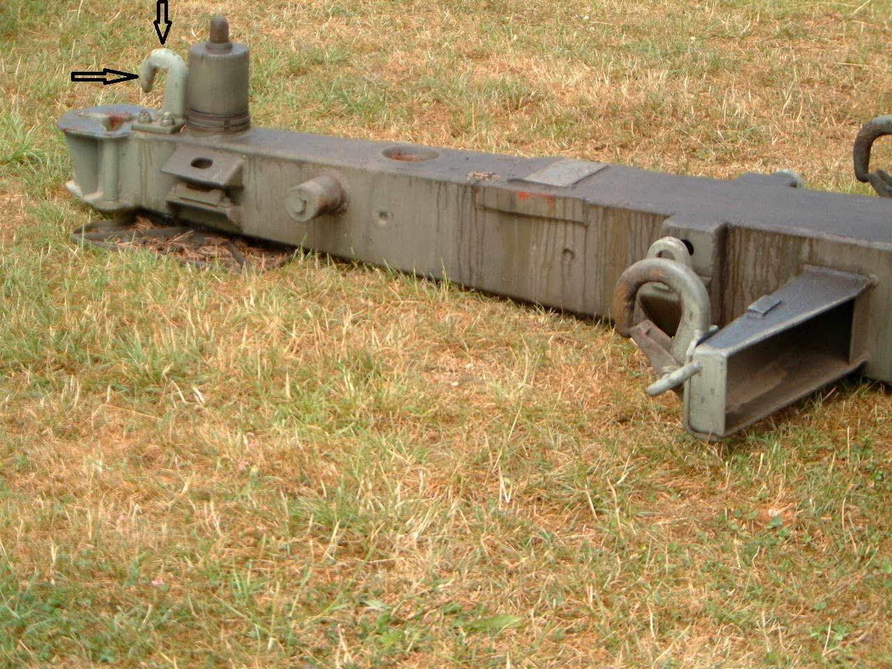

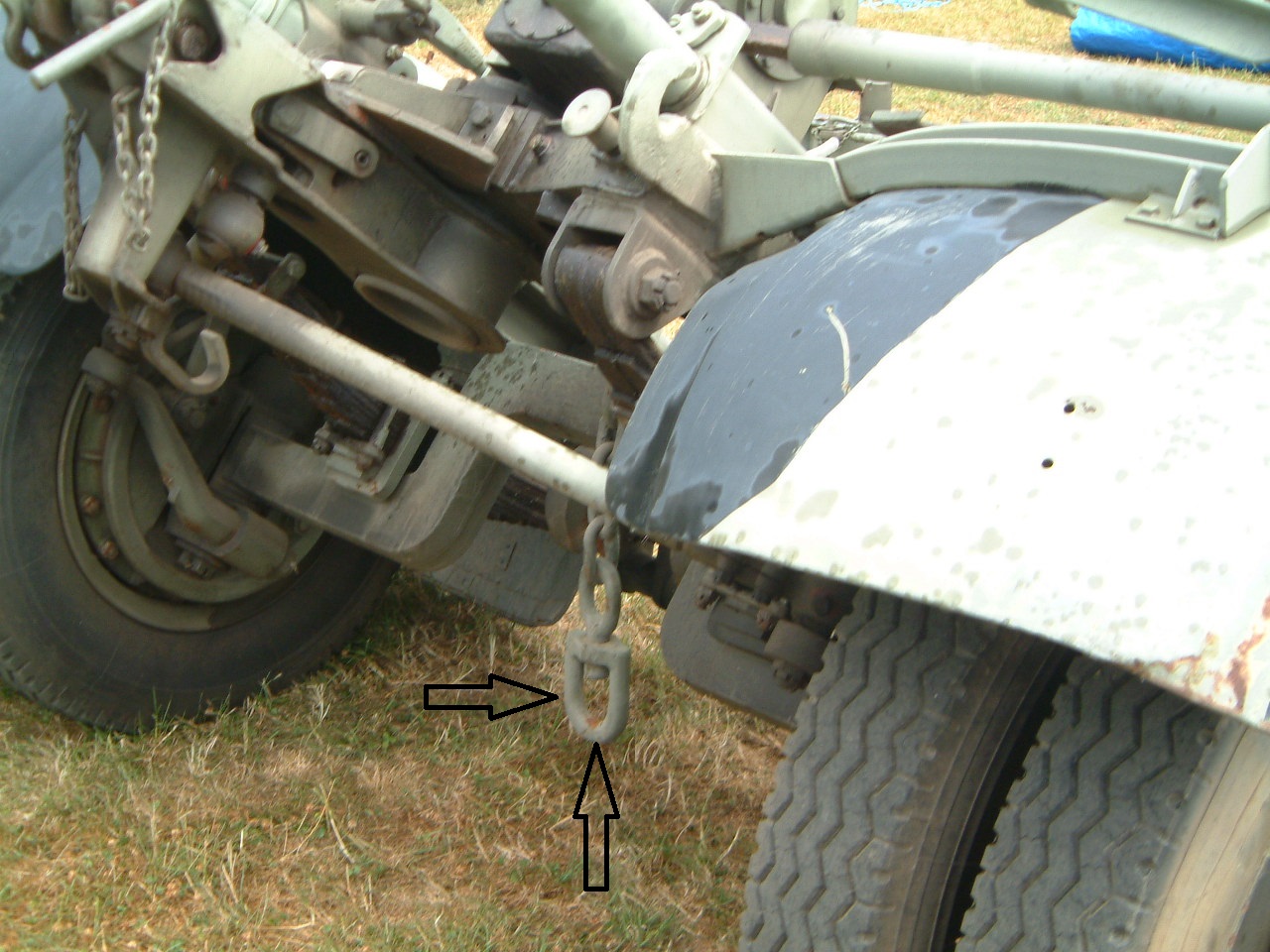

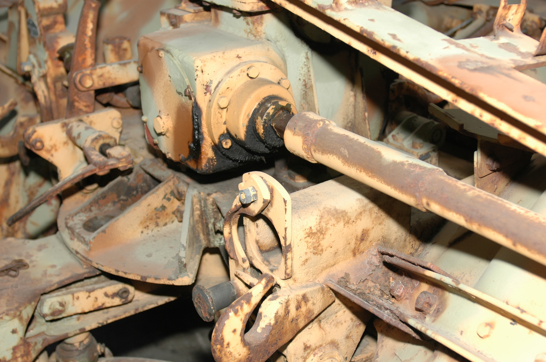

I couldn't add the photo in the PM so to answer the question on the chain, huck and hose connectors, here are some photos.
The hose connectors, I am not sure which ones you mean. if its the ones in the photos below, I used computer motherboard pegs/spacers. Most computer outlets will have some, they come in brass or metal.
Drill it out to the size you want, then spin it in a drill/dremel and use a file or hacksaw blade to cut a groove to make it look like two nuts together.
if its these connectors,
You will need to speak to Rolf Mönke and see his post here http://www.armortek.co.uk/Forum3b/viewt ... 3&start=30
hope that helps.
Paul. :wink:

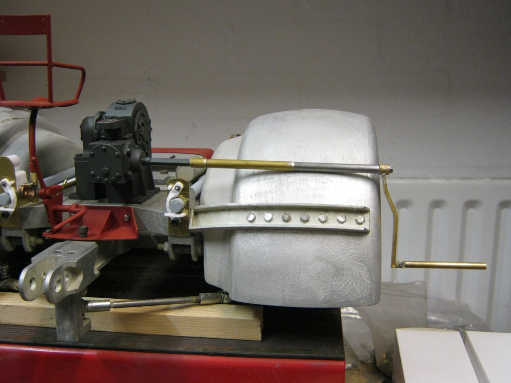

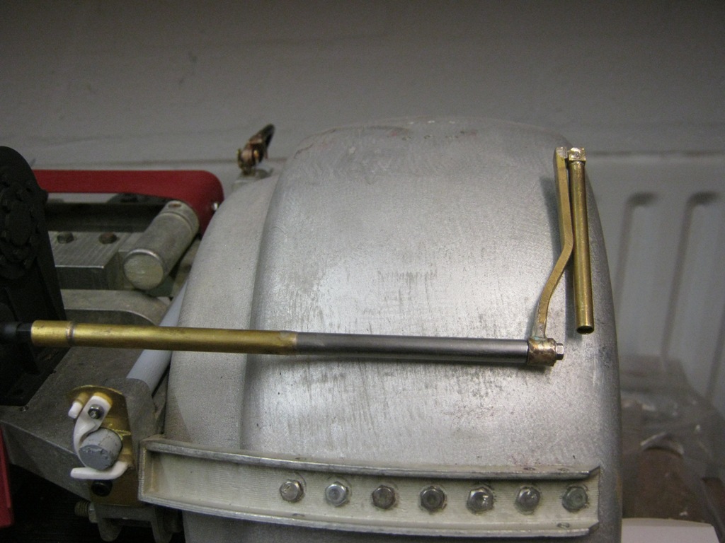

Not too much progress this time. I was hoping to have it finished by the open day, but it not looking likely. ill just have to bring it as is :shock: :lol:
