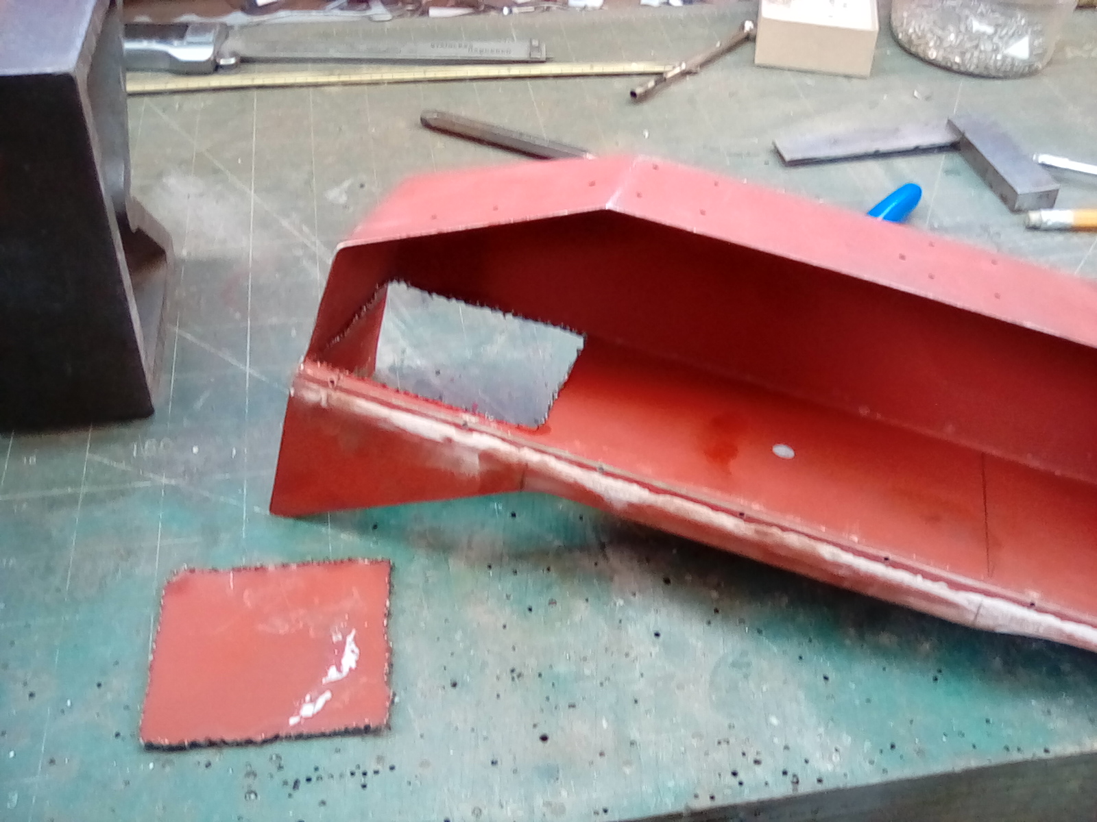

Ready for the plate to be cut

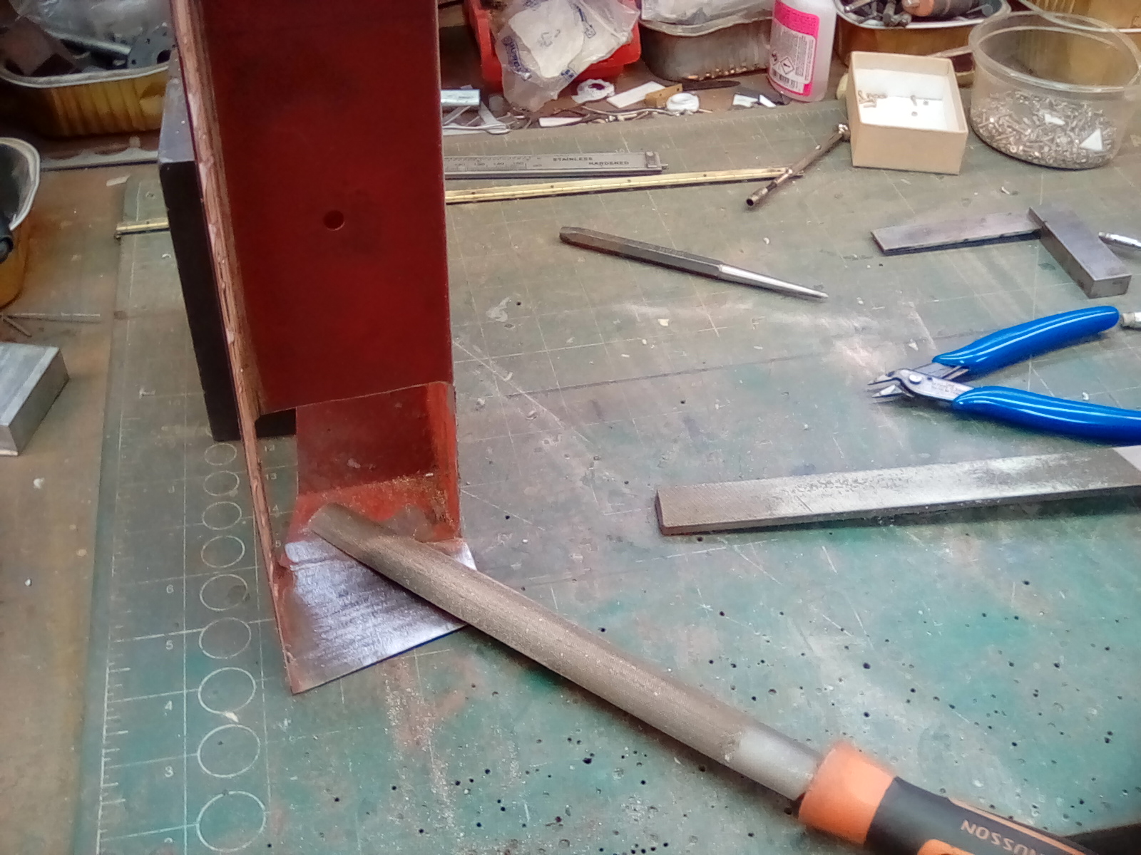

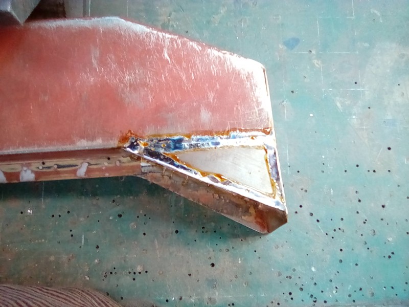

Fitting the extension piece, file and fit file and fit
Fitted and ready for soldering

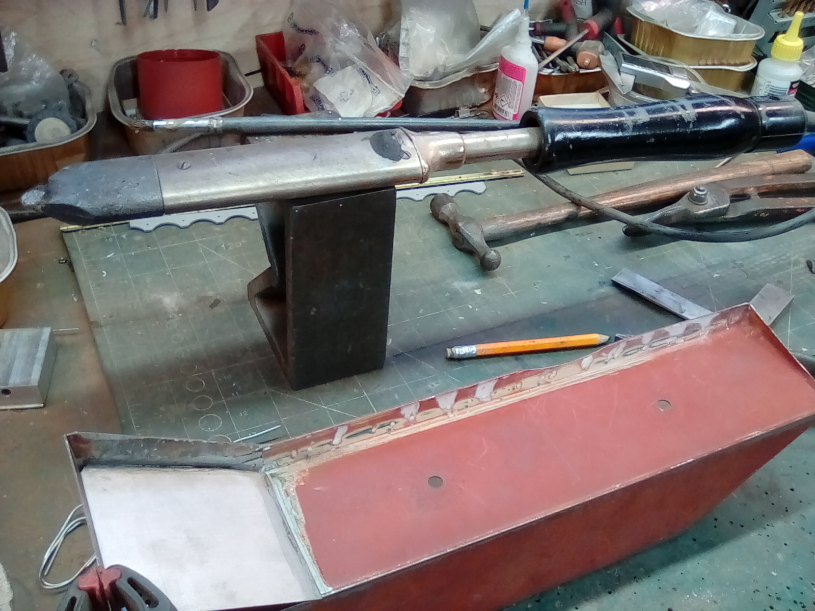

Old sparky warming up
The rear that's against the turret will need some gentle tidying, I can just about get a weld bead using a filler rod but there's no point.

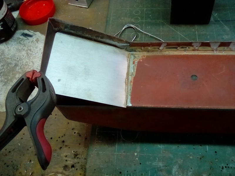

Getting the bottom plate to fit nicely

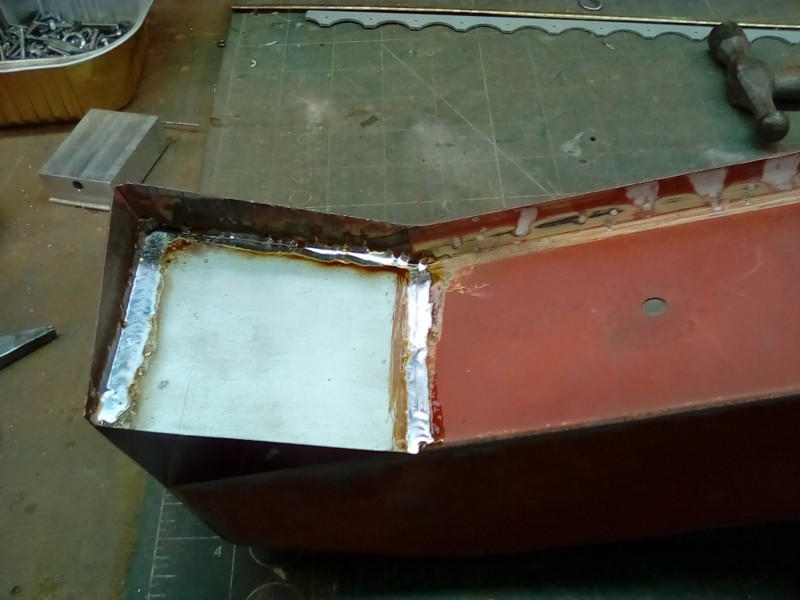

Tacking the corners so it will not move whilst old sparky does his business

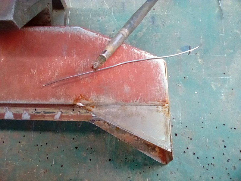

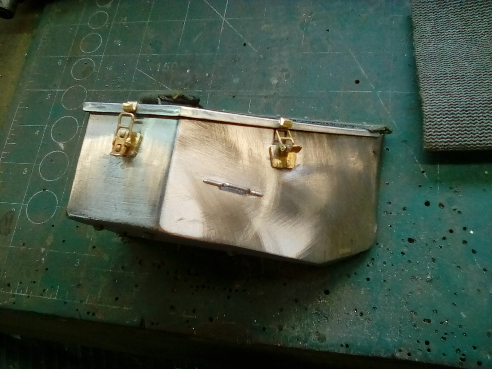

You can scrape the excess solder off but the more you remove the weaker it will become, this is the out of sight underneath section so only needs a gentle tidy up

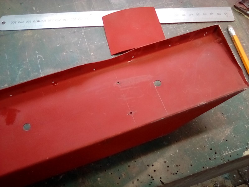

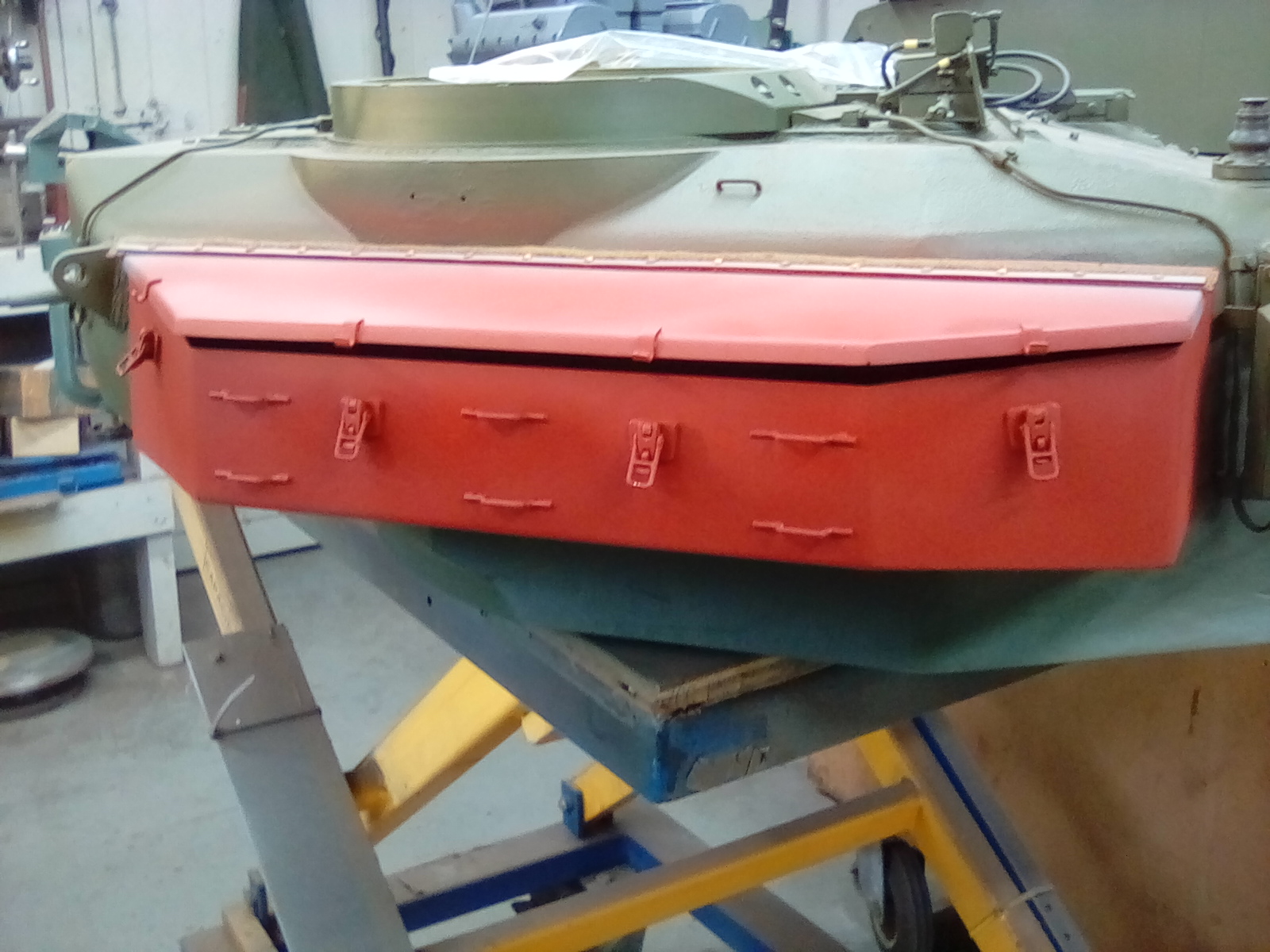

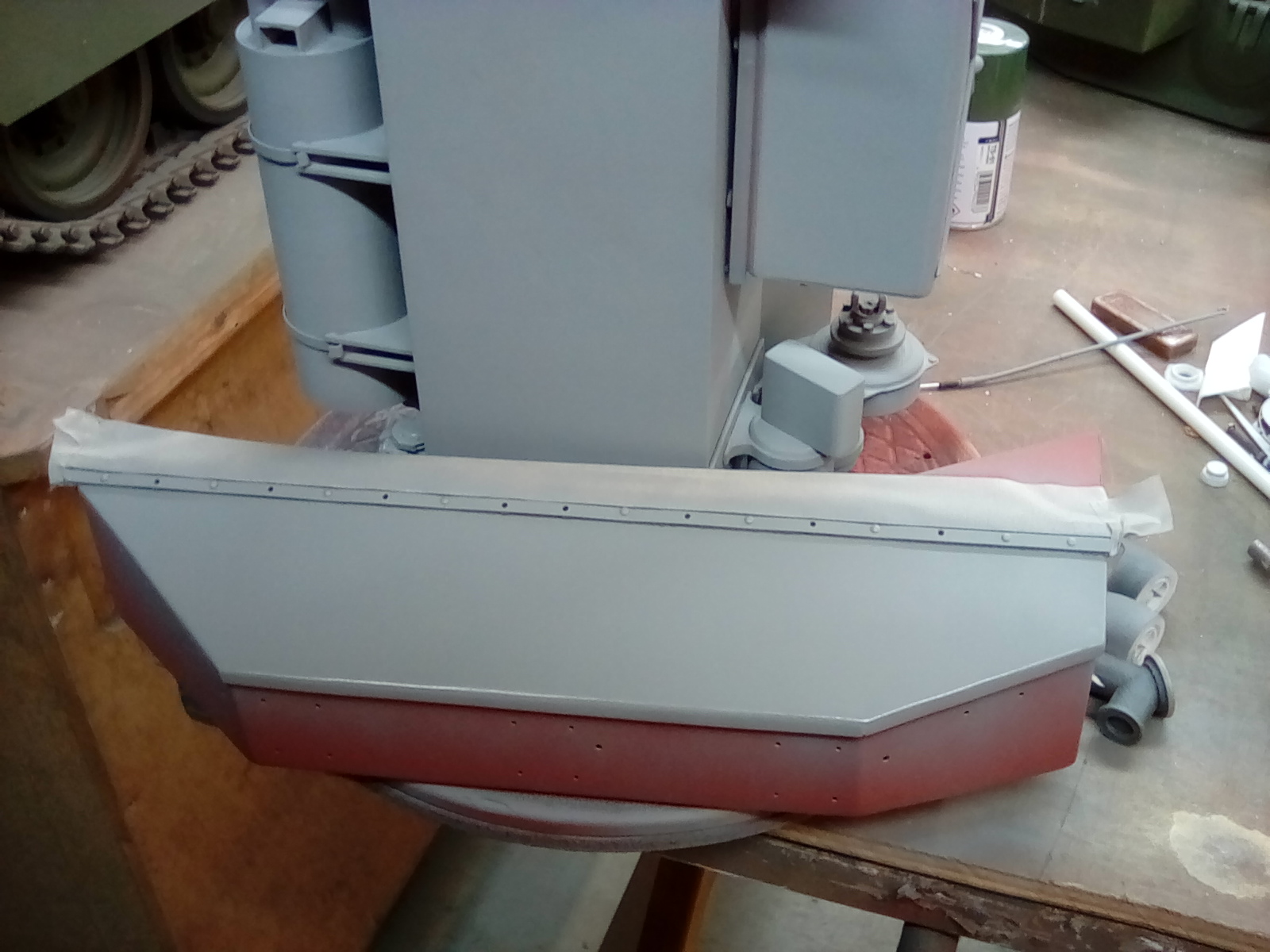

After a quick dusting of red oxide
I'm happy with that
I'm happy with that

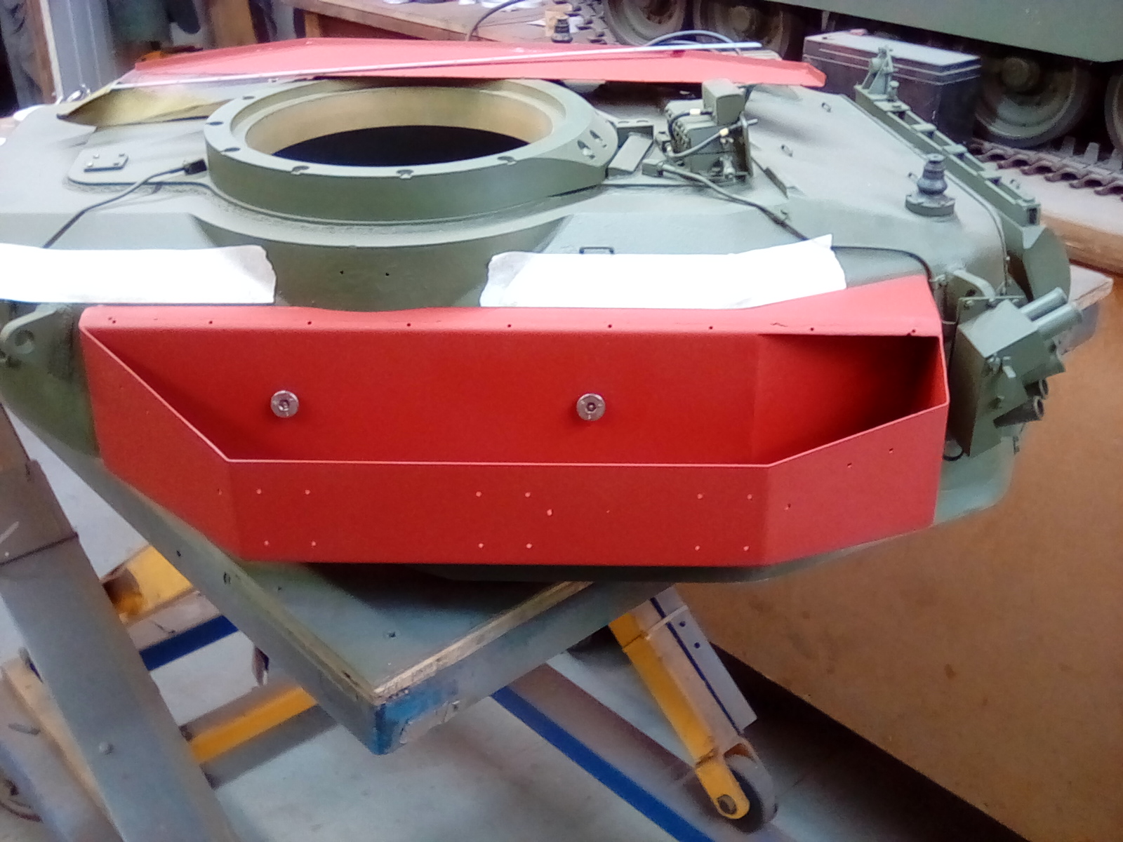

I've fabricated the radius piece that was designed to clear the turret cupola protrusion

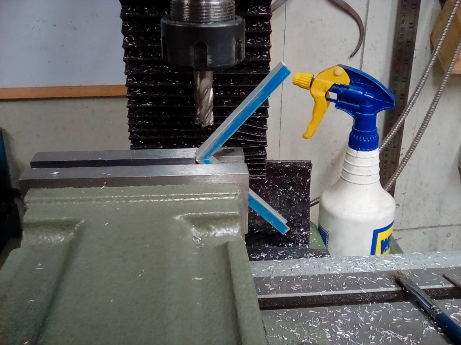

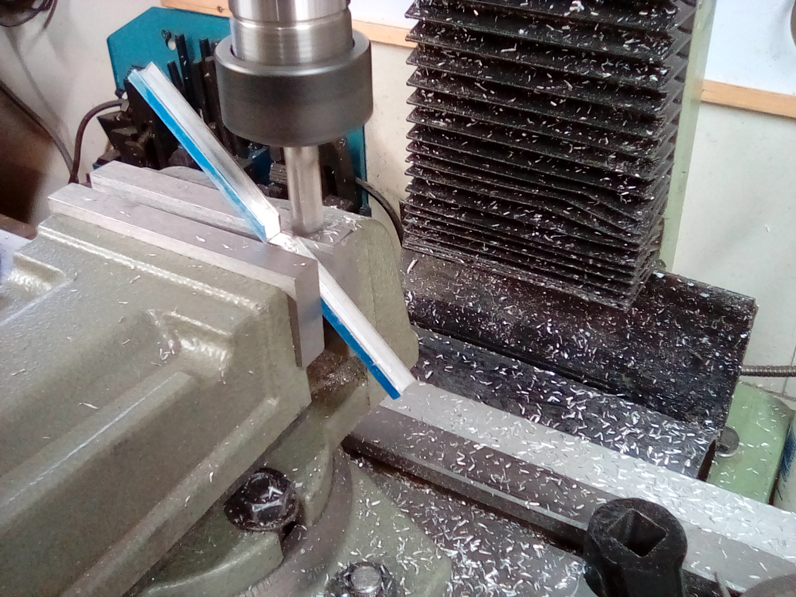

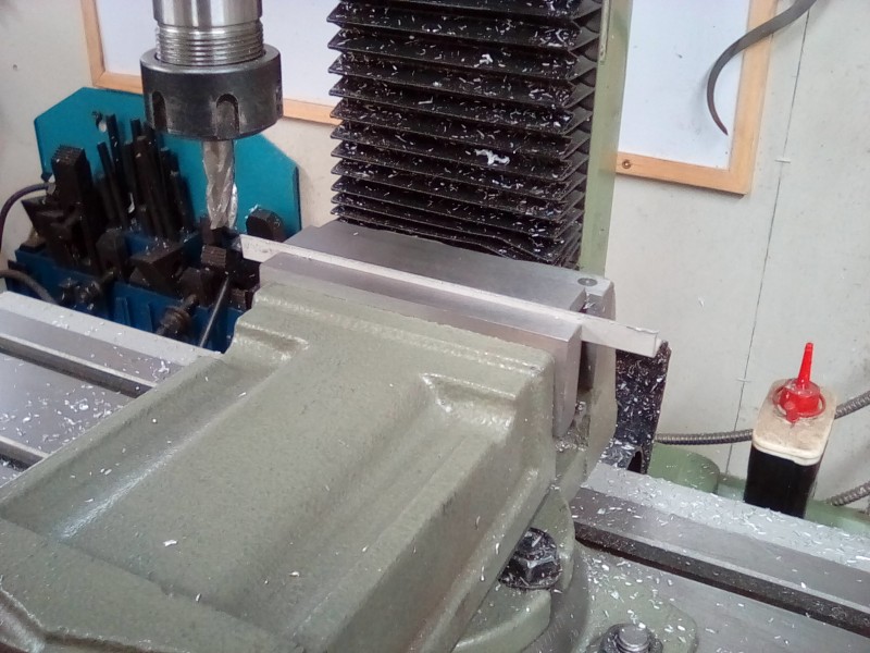

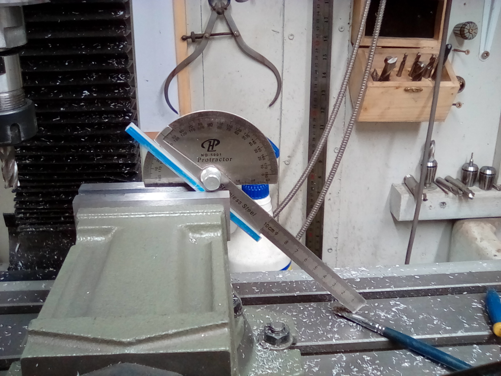

Milling down
Milling down
Those 90° cut outs again, so easy with the mill

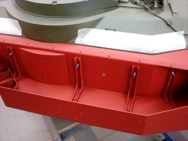

Re: Mr Dawe's Centurion.

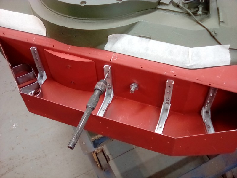

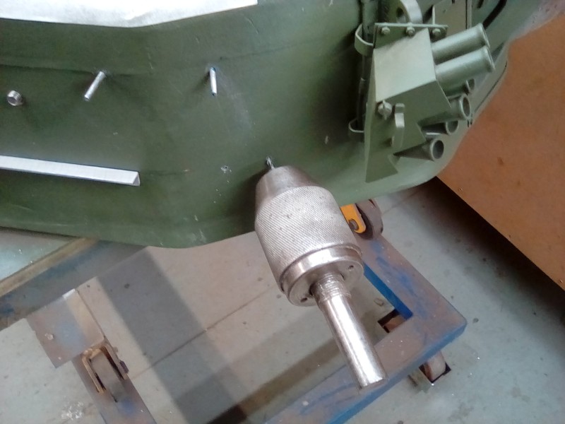

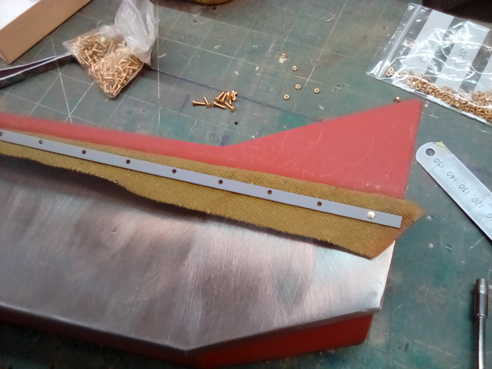

Bolting the stiffeners in position , there are around 50 nut and bolts sets in the long bin.
I presume the three sectioned stowage piece fitted to the left hand side of the long bin is for those thermos flasks?
Would anyone have pics of the thermos perchance? A 3d printed set would look great stowed in the bin.

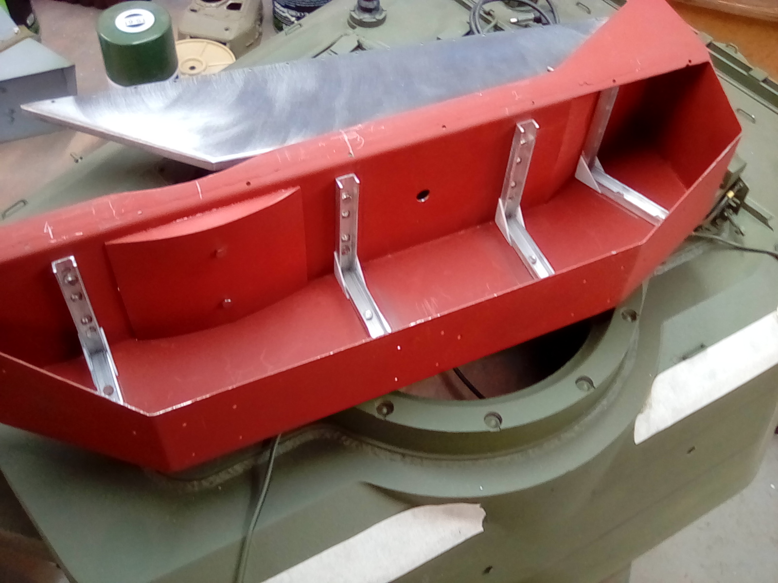

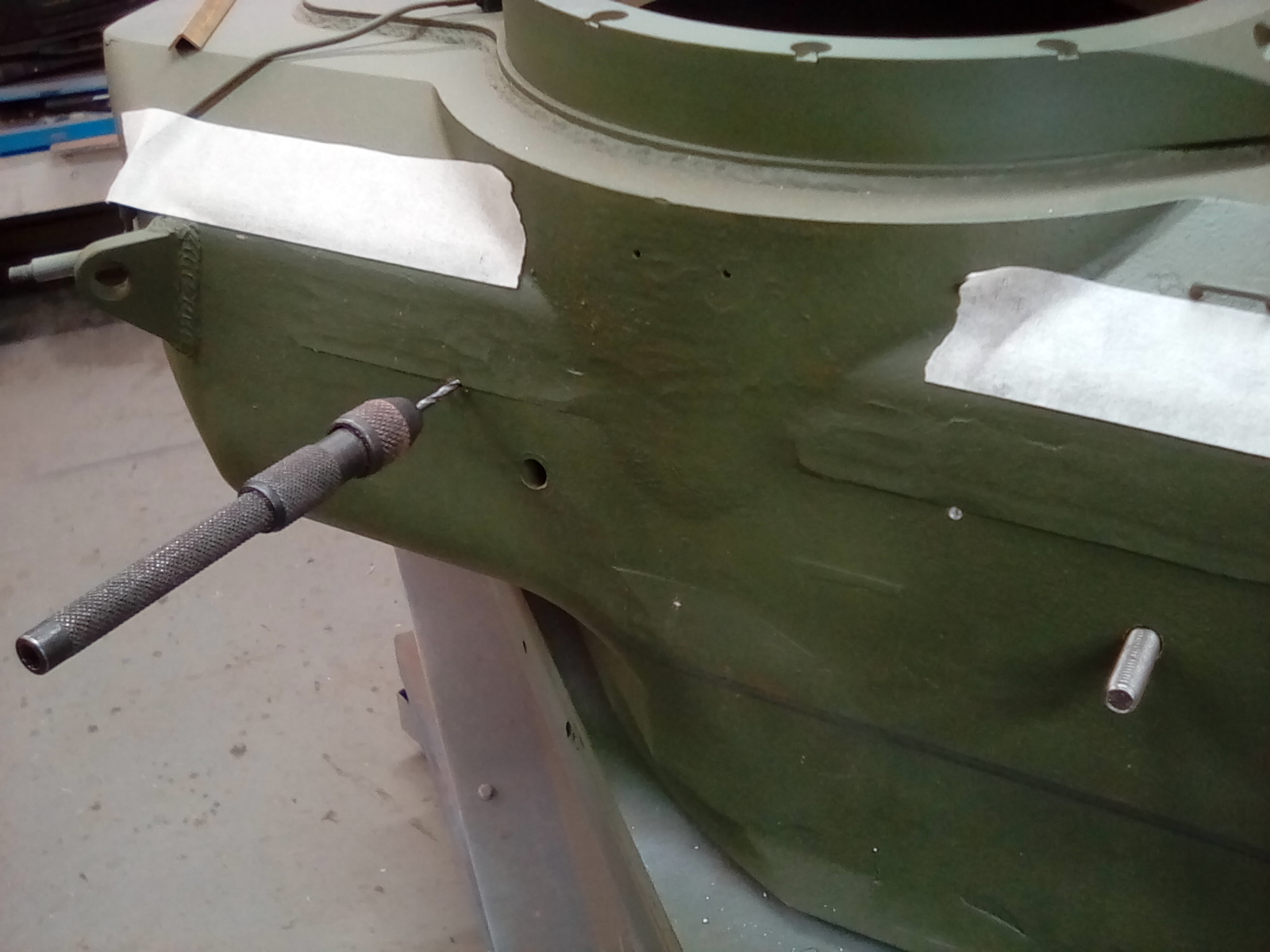

Careful mounting of the stiffeners, if they are just slightly out they will look pants

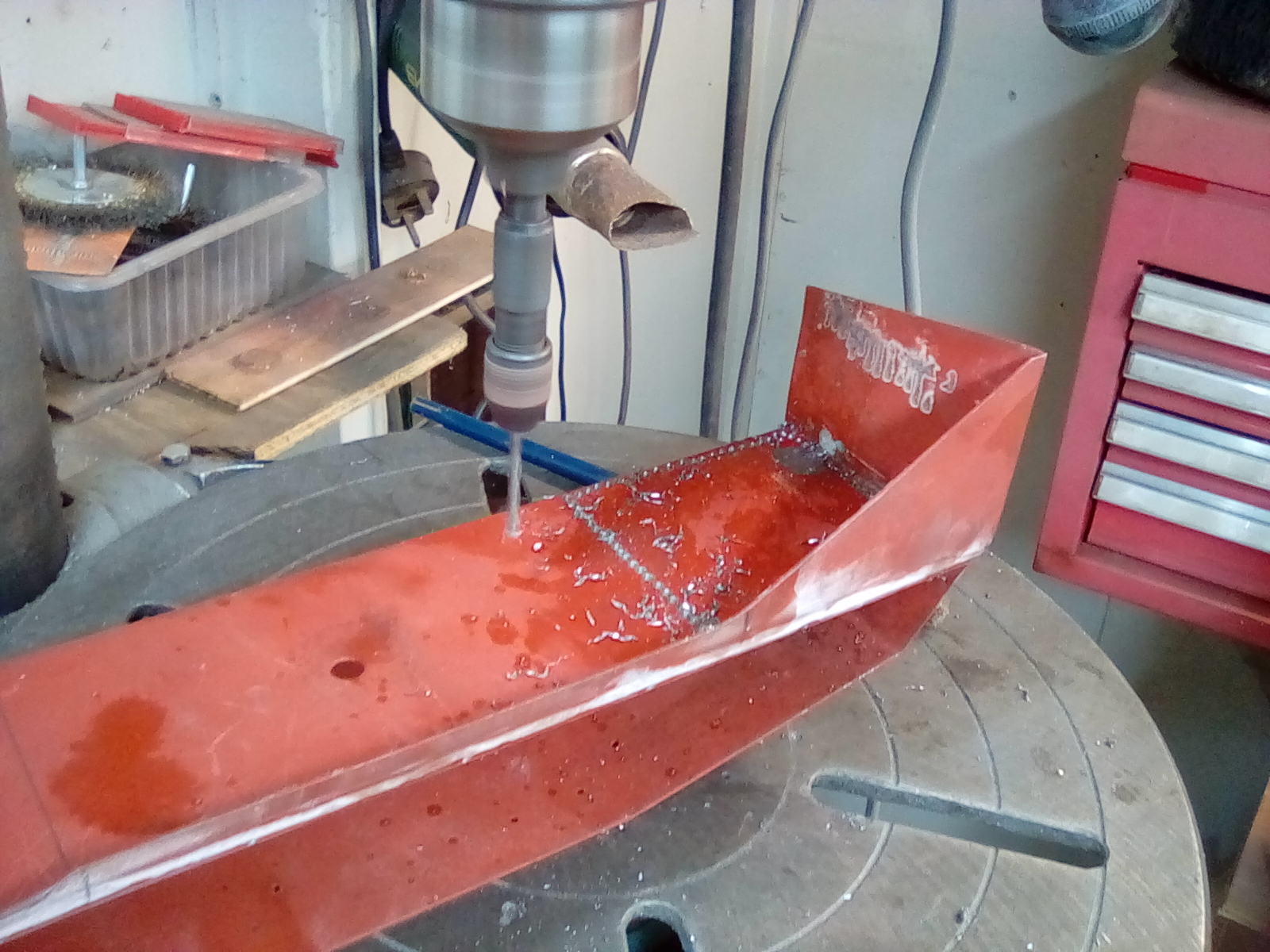

Here's a tip, make yourself a drill bit extension to get to those hard to reach places
Bolts everywhere
Bolts everywhere

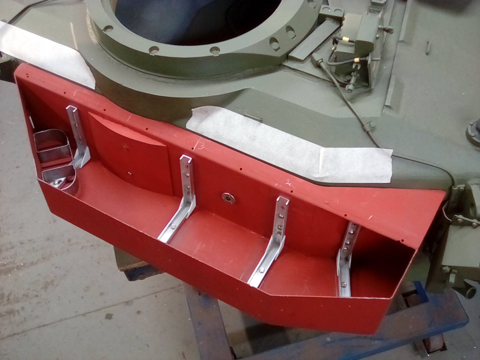

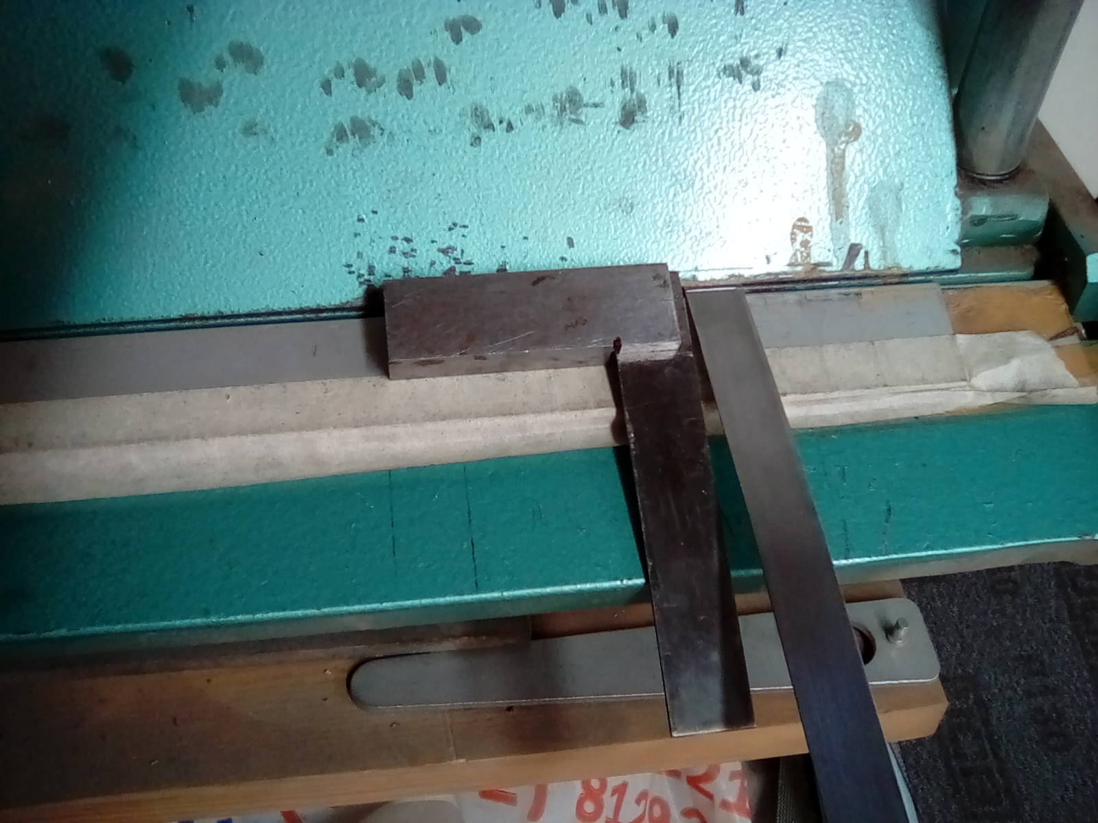

Here's a tip, hold one side of the Gillbows or snips in the vice to help get a nice straight cut
Best use a square to check before you bend the work piece

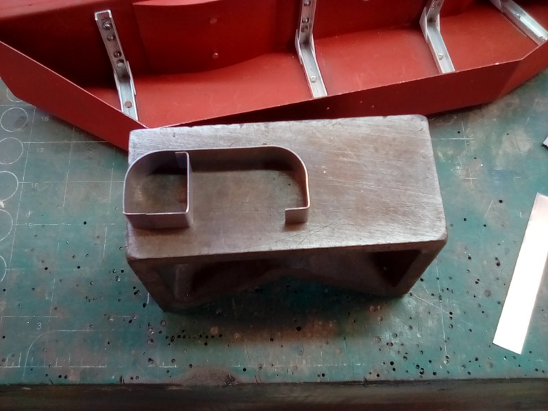

Tricky to make this piece but worth the effort
The stowage piece lives here

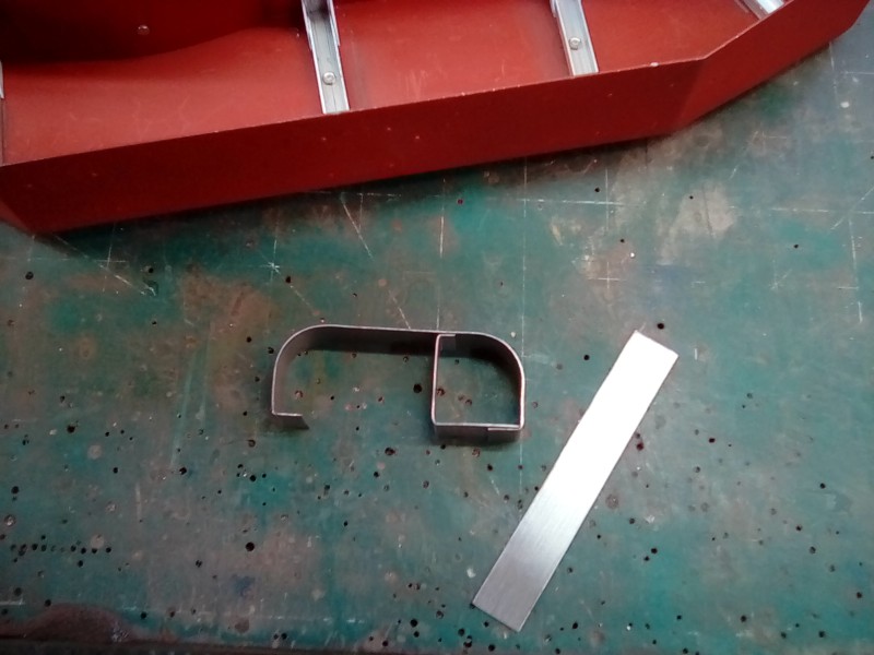

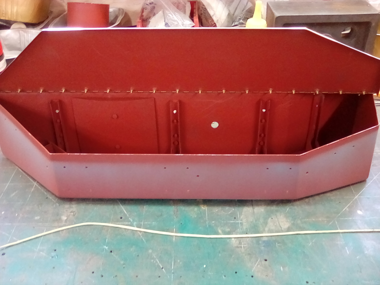

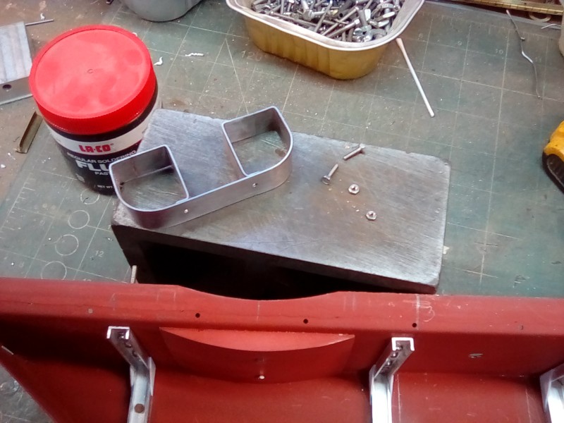

Nearly done with the internal stowage piece, it's all now soft soldered together
Marking through ready to drill and tap the mounts
I'm now ready to temporary mount the bin , then off it comes again for the angle iron support for the bottom section

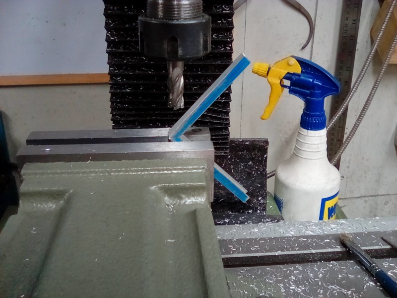

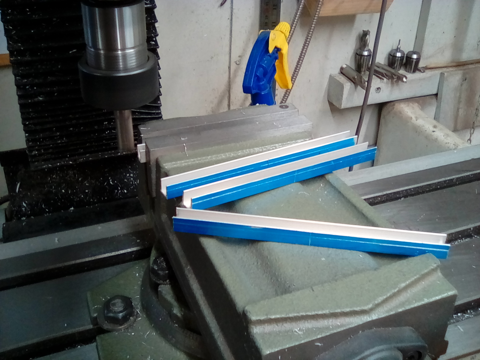

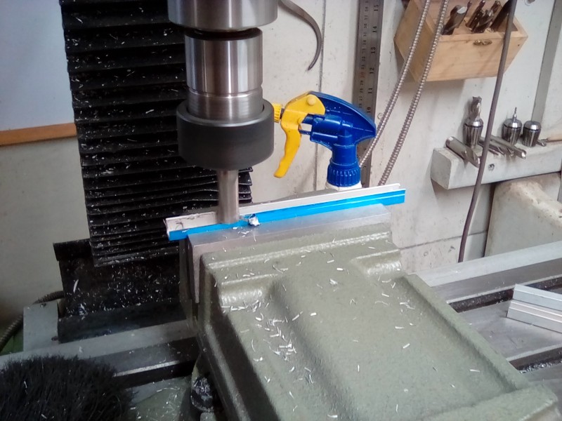

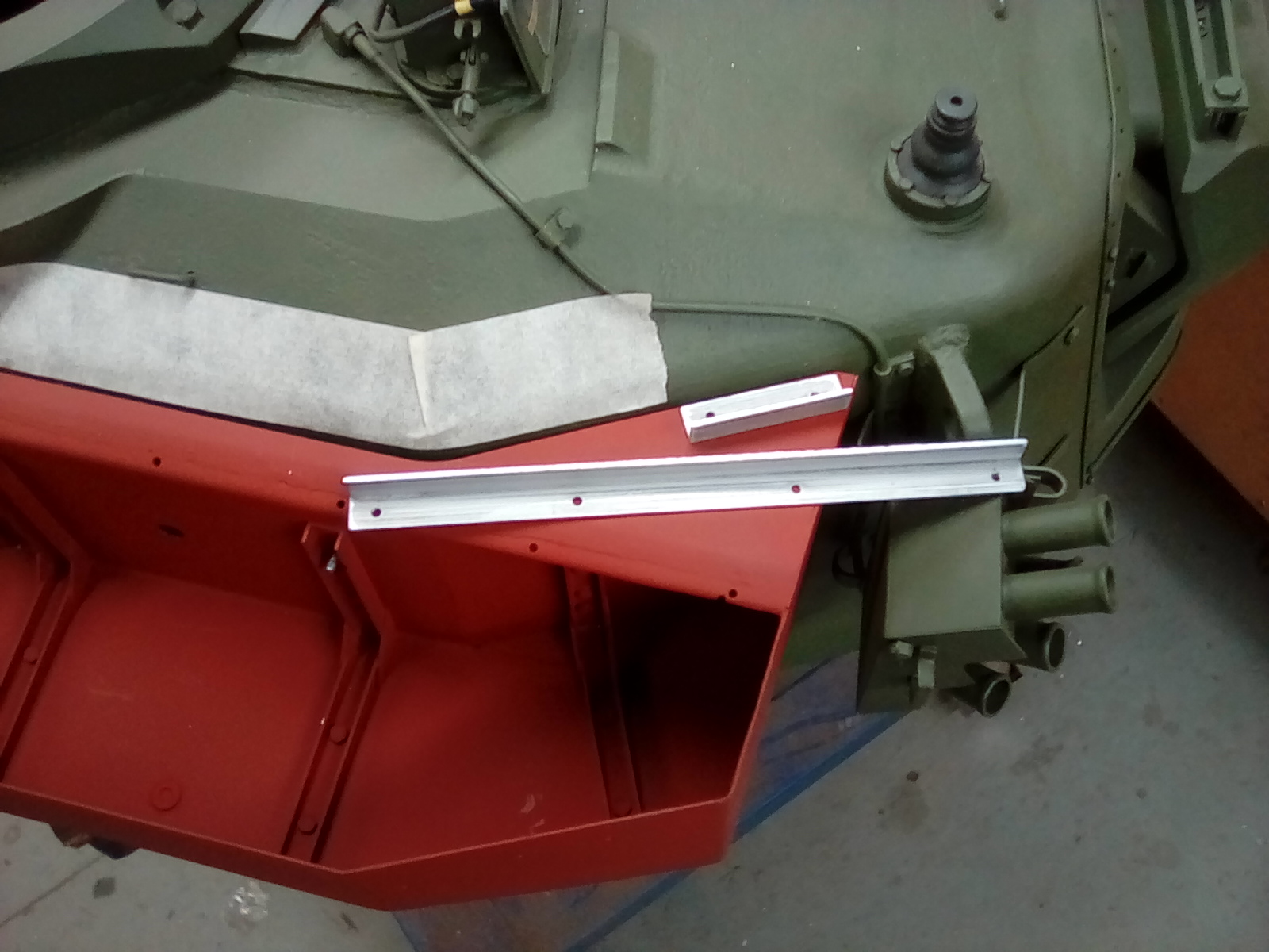

Milling down the equal angle pieces

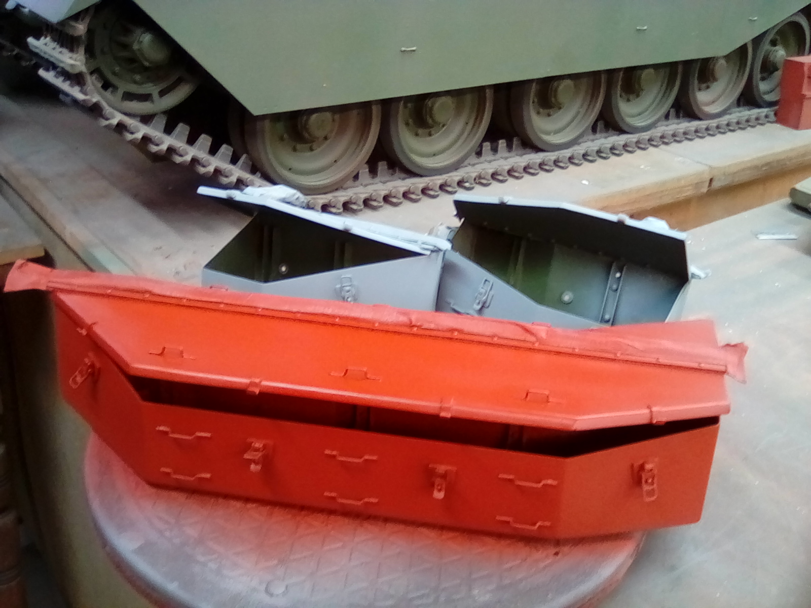

Example of the coffin bin

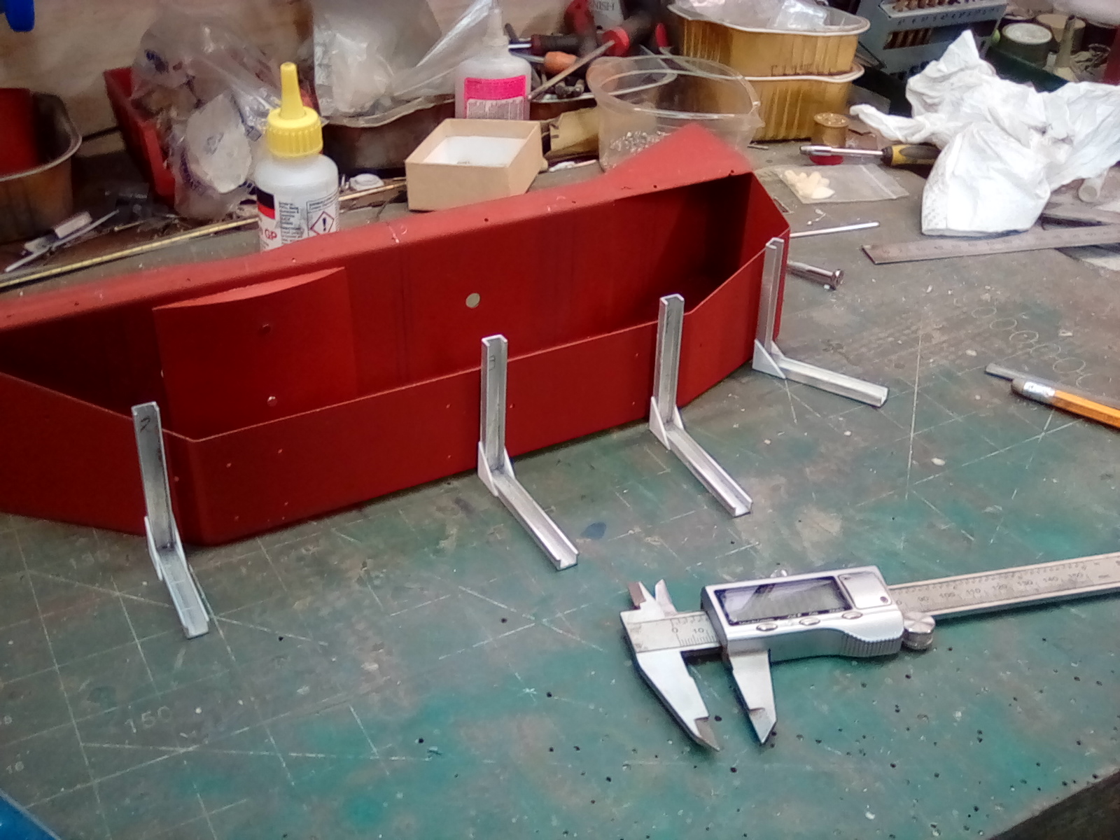

Bottom brackets made

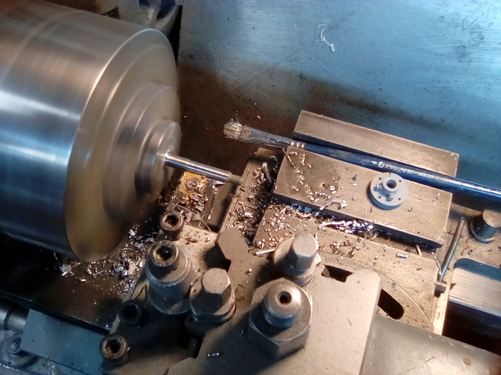

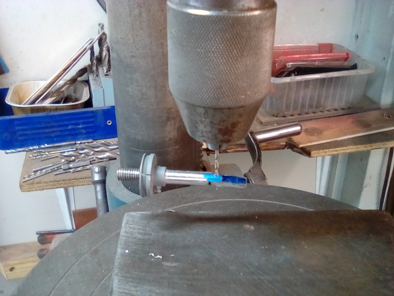

How to hold those drill bits less than 2 mm
Angle iron bottom supports bolted in place
Same as the small bins just more of it
A few more rivet bolts to make and then the soldered furniture to fit

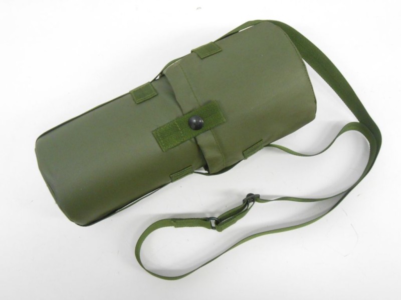

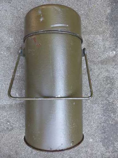

Possibly WW11 issuse but still in service for our Centurion?
FYC M FE GB Thermos Flask 1.jpeg (45.84 KiB) Viewed 959 times

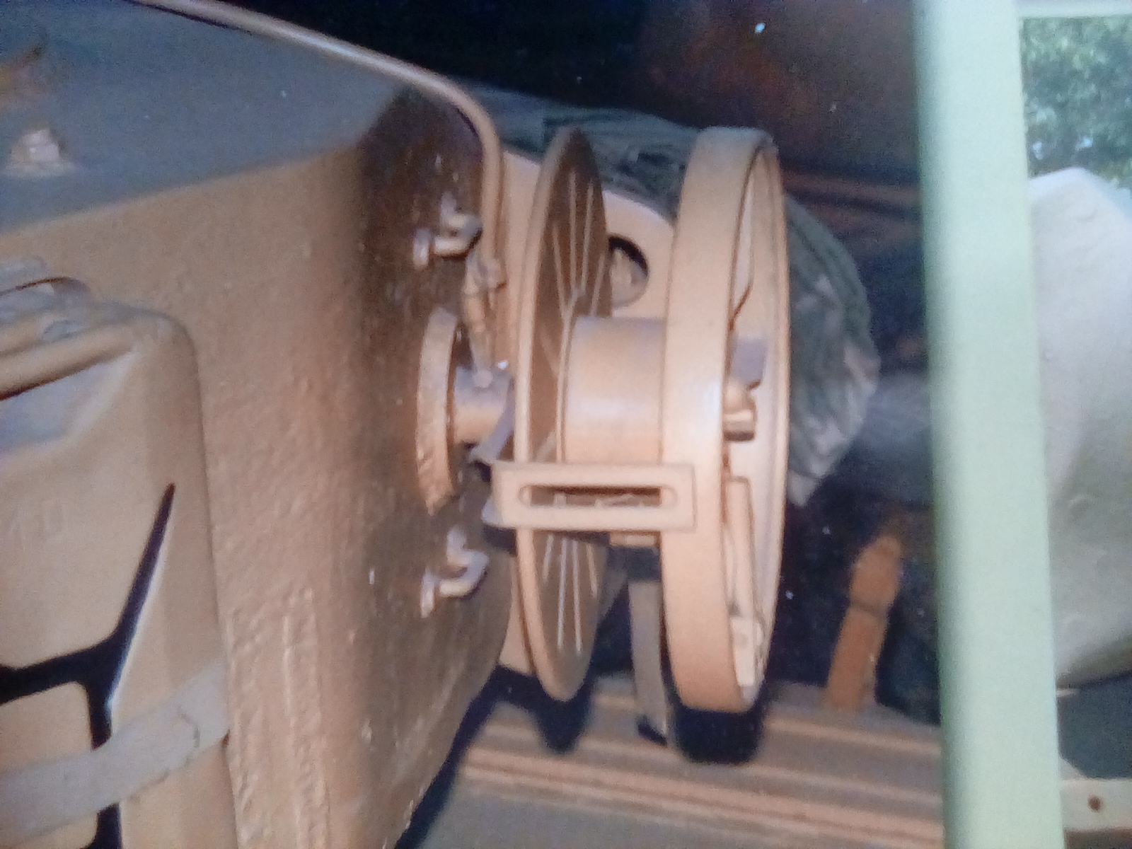

Crew thermos for hot drinks or hot food, is this the one for the big bin?
One man thermos insulated pouch

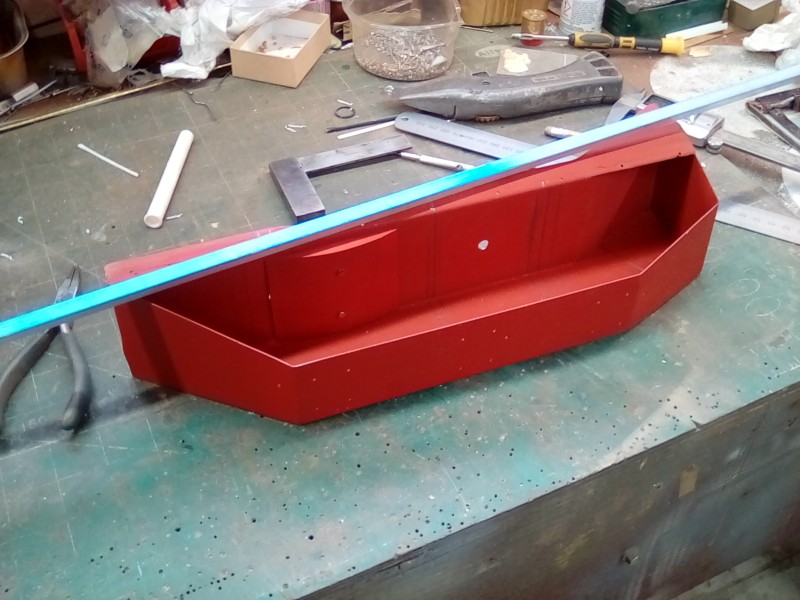

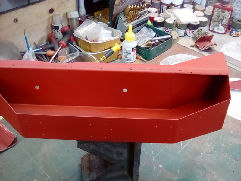

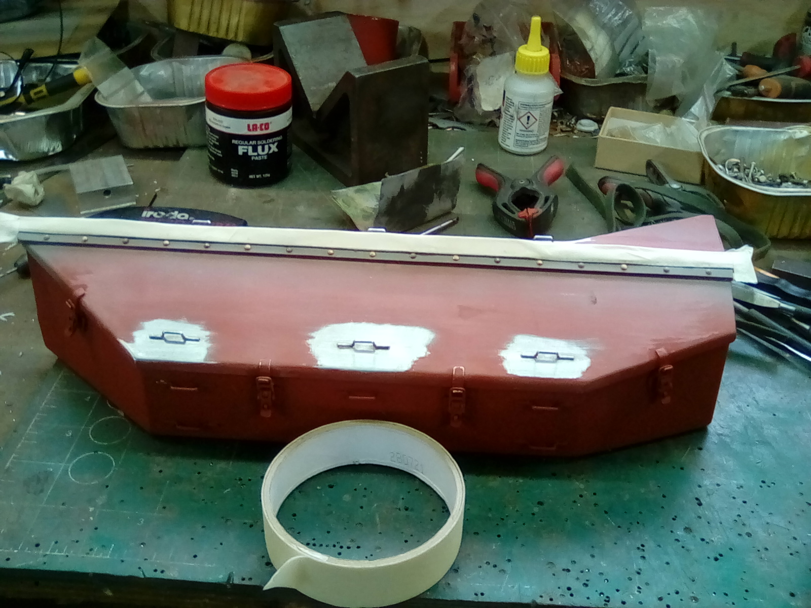

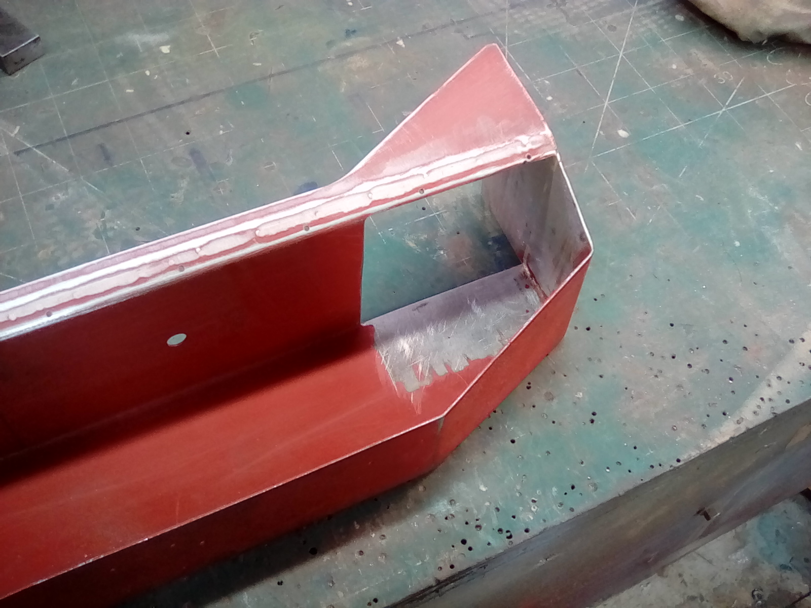

Just about all done in there just the bulge weld bead to add in milliput
Not my favorite job but it goes with the territory

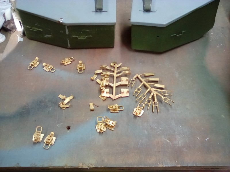

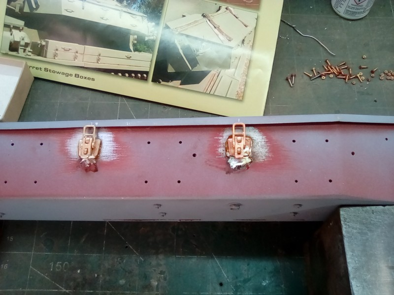

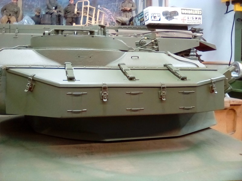

The latches must be perfectly aligned
The original bin fixing holes now filled this side

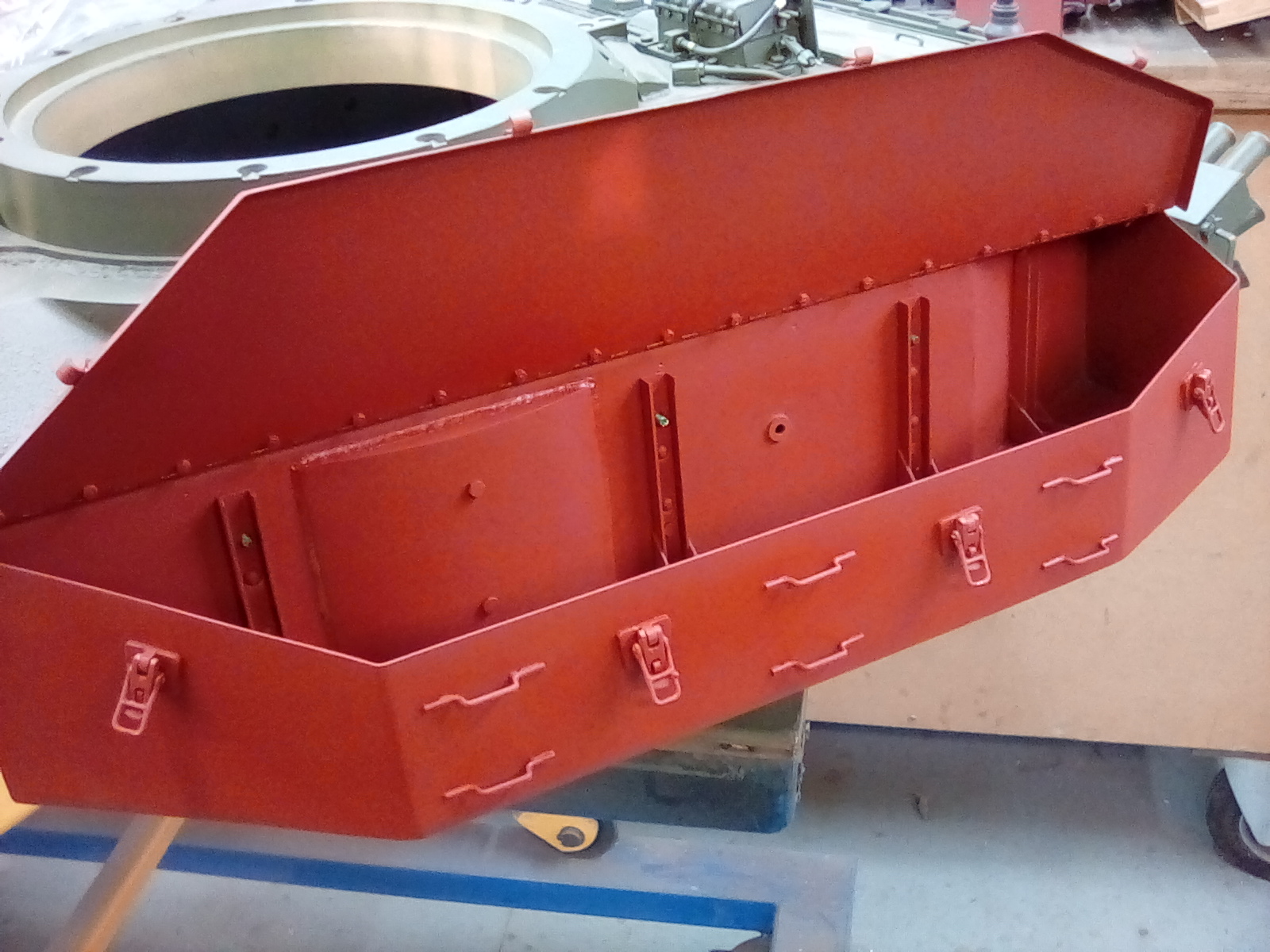

All done with soft solder

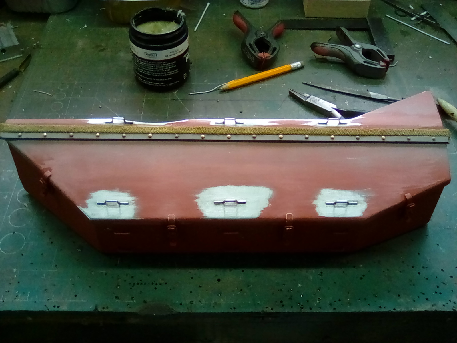

Using a scrapper to remove the unwanted solder is the correct method

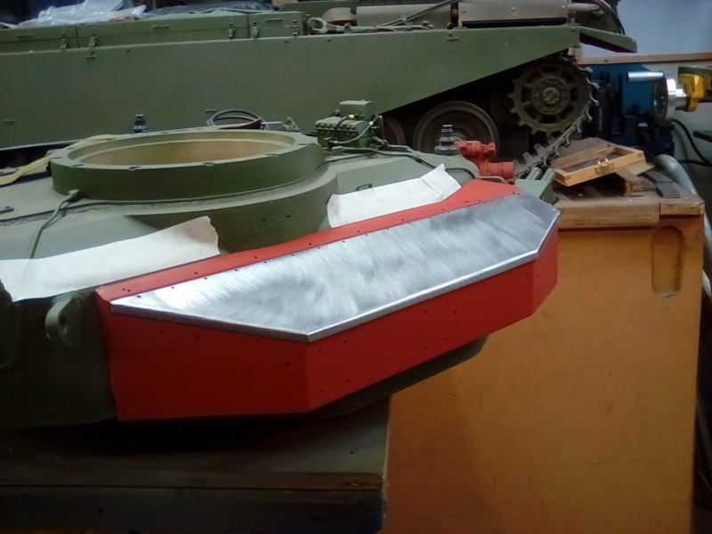

A dusting of red oxide to check the finish
Nothing standing out finish wise so I'm happy to now move into the camo net strap fixings and the tricky webbing

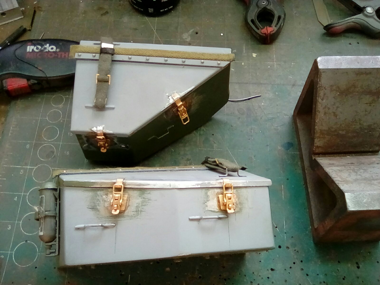

Well but for some minor snagging and the webbing strapping these bins are done, they can sit over the weekend to cure the paint.

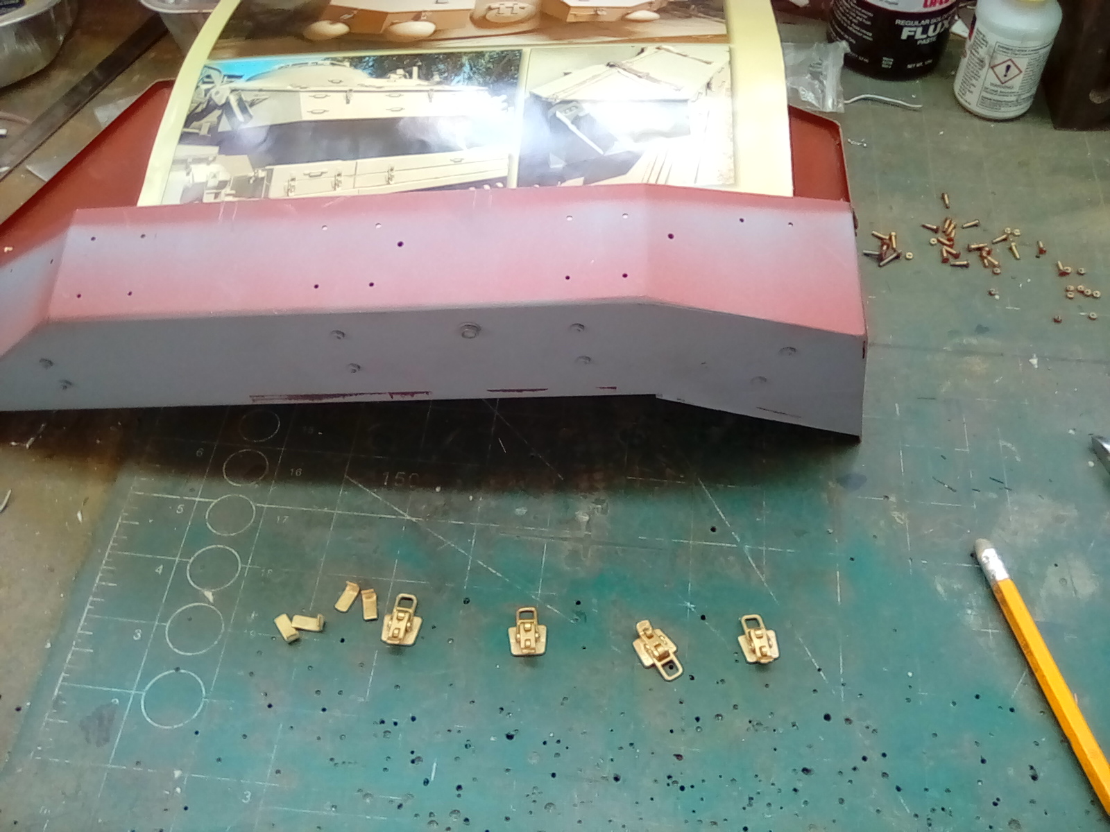

I've removed the light dusting of red oxide prior to soldering the catches and the strap anchors

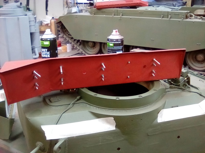

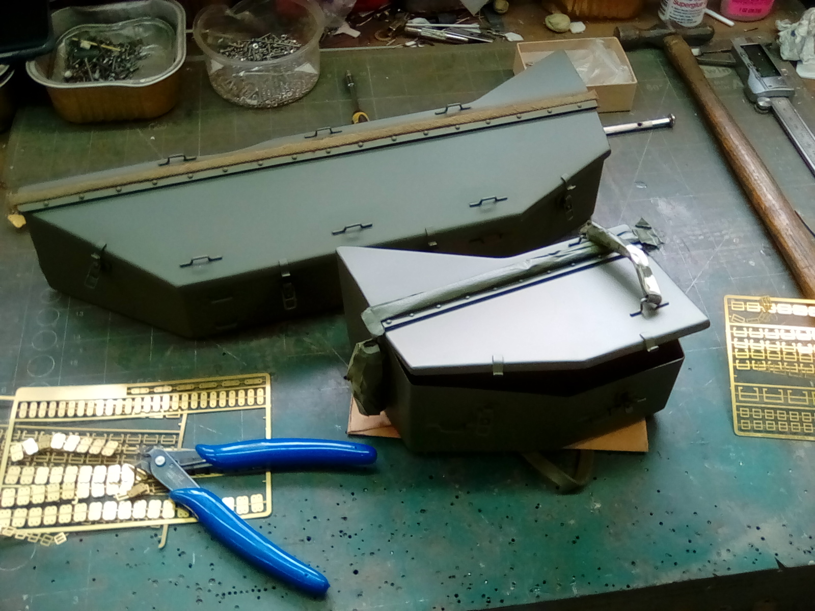

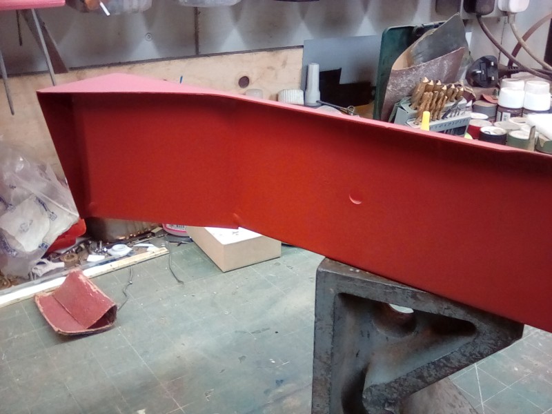

I decided to remove the short bins paint back to the next fold rather than flattening back
Cleaned up and rubbed down

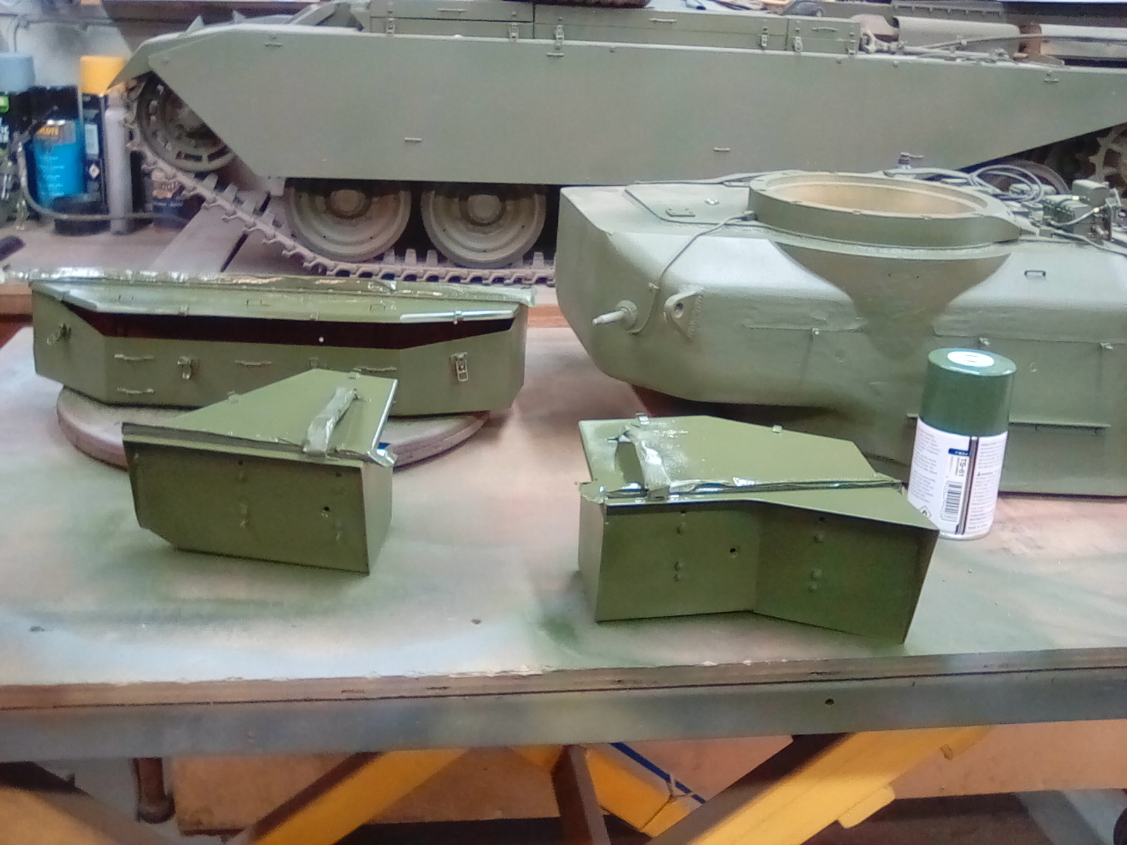

A good couple of applications of primer before some top coat

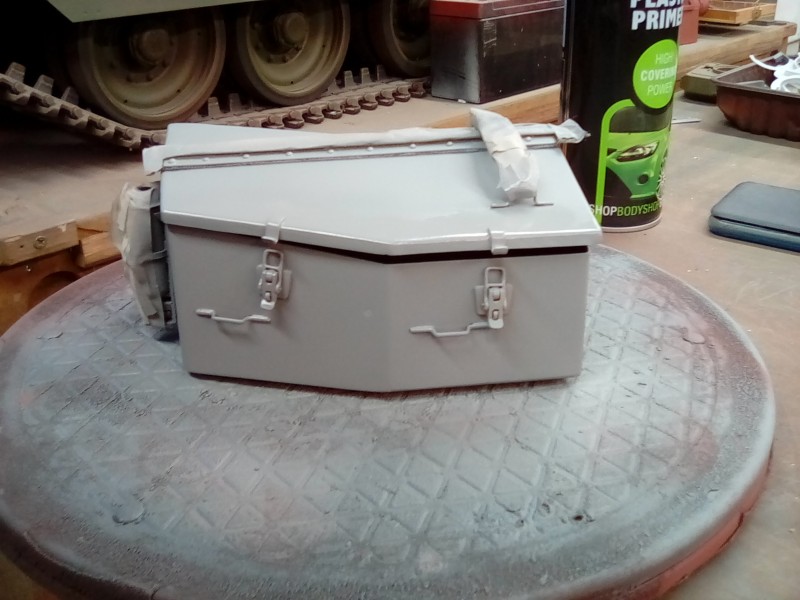

If you can't get a good finish with the Tamiya TS range of paint your in the wrong hobby

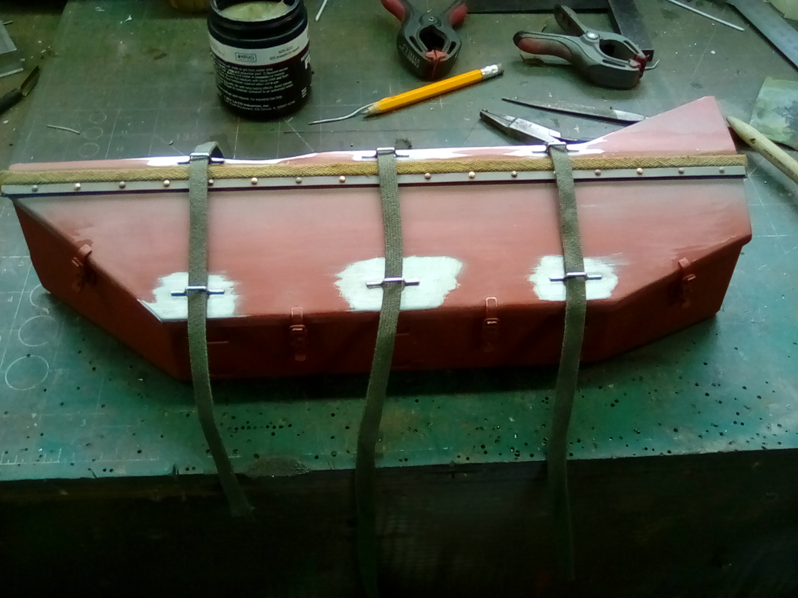

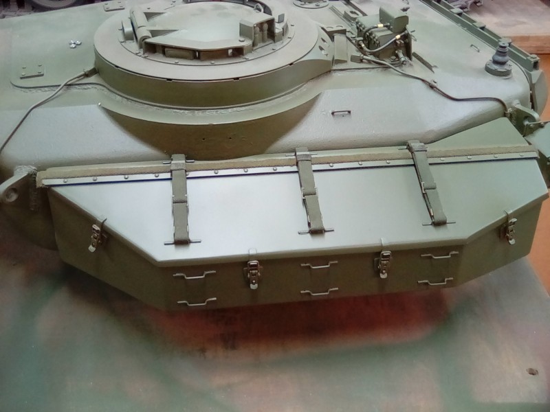

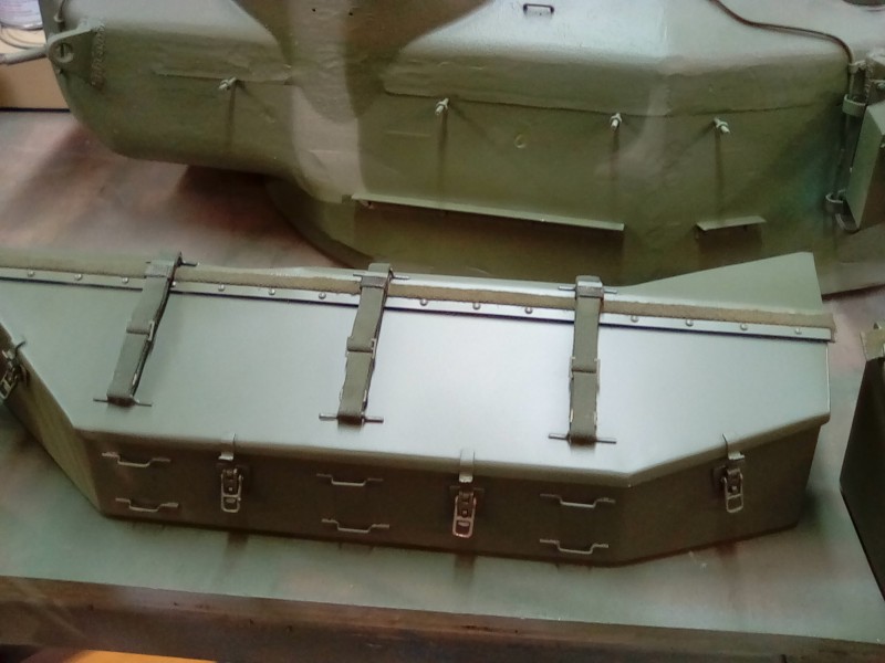

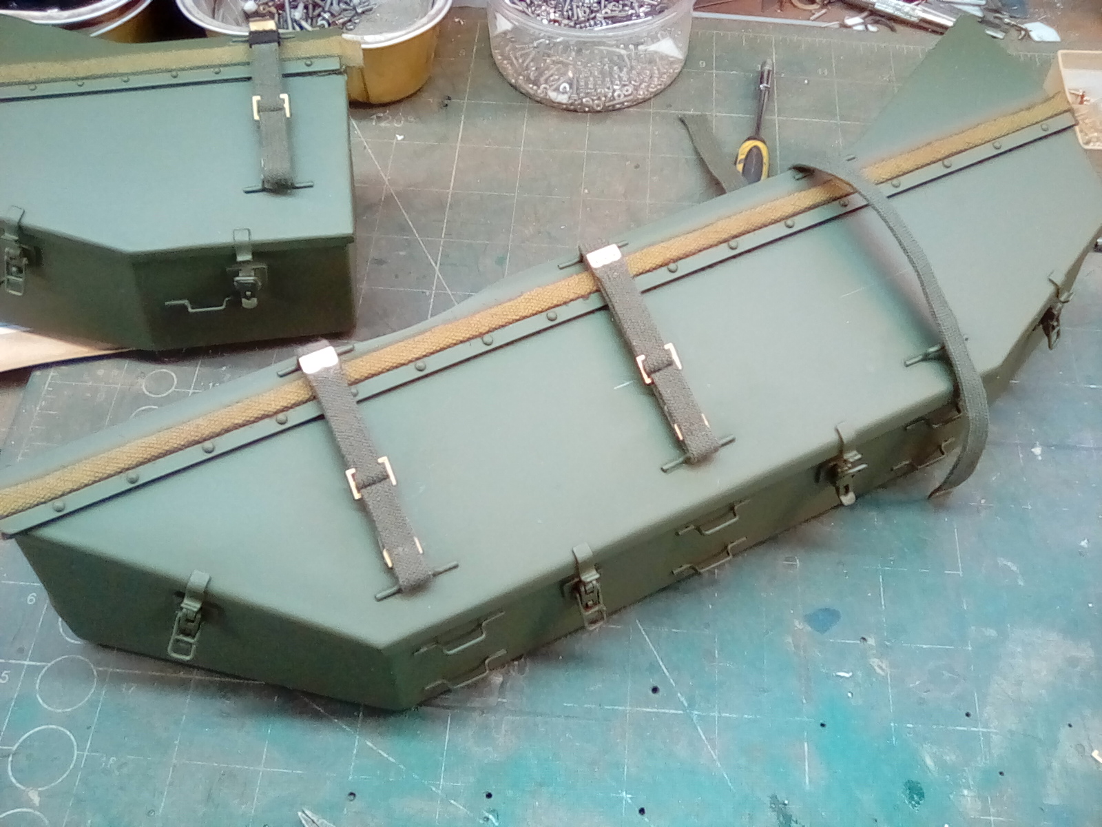

I shall try again lol. The webbing straps are now fitted to the long bin.
I'm using Armorpax superb strap ends and buckles
Off we go
Off we go
Tricky work getting all three straps the same length and aligned
There's a lot going on with that long bin
All done except for the fire extinguishers which should be here any day now

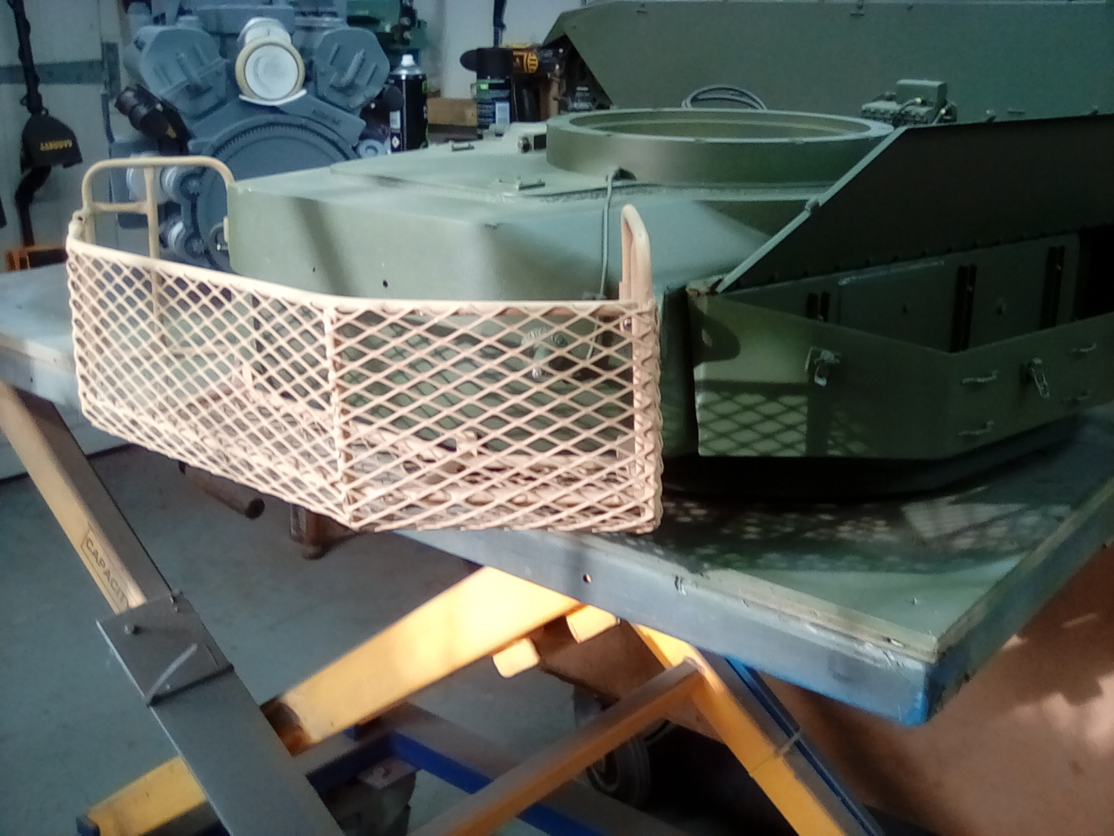

Lots done although it doesn't look like it.

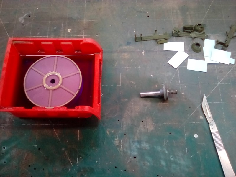

I have to start thinking about the turret basket.

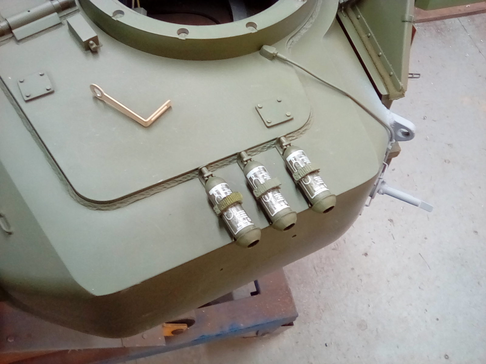

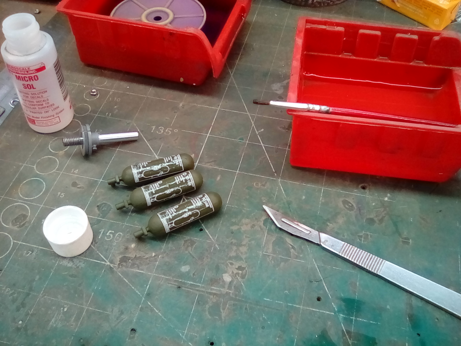

Armorpax extinguishers

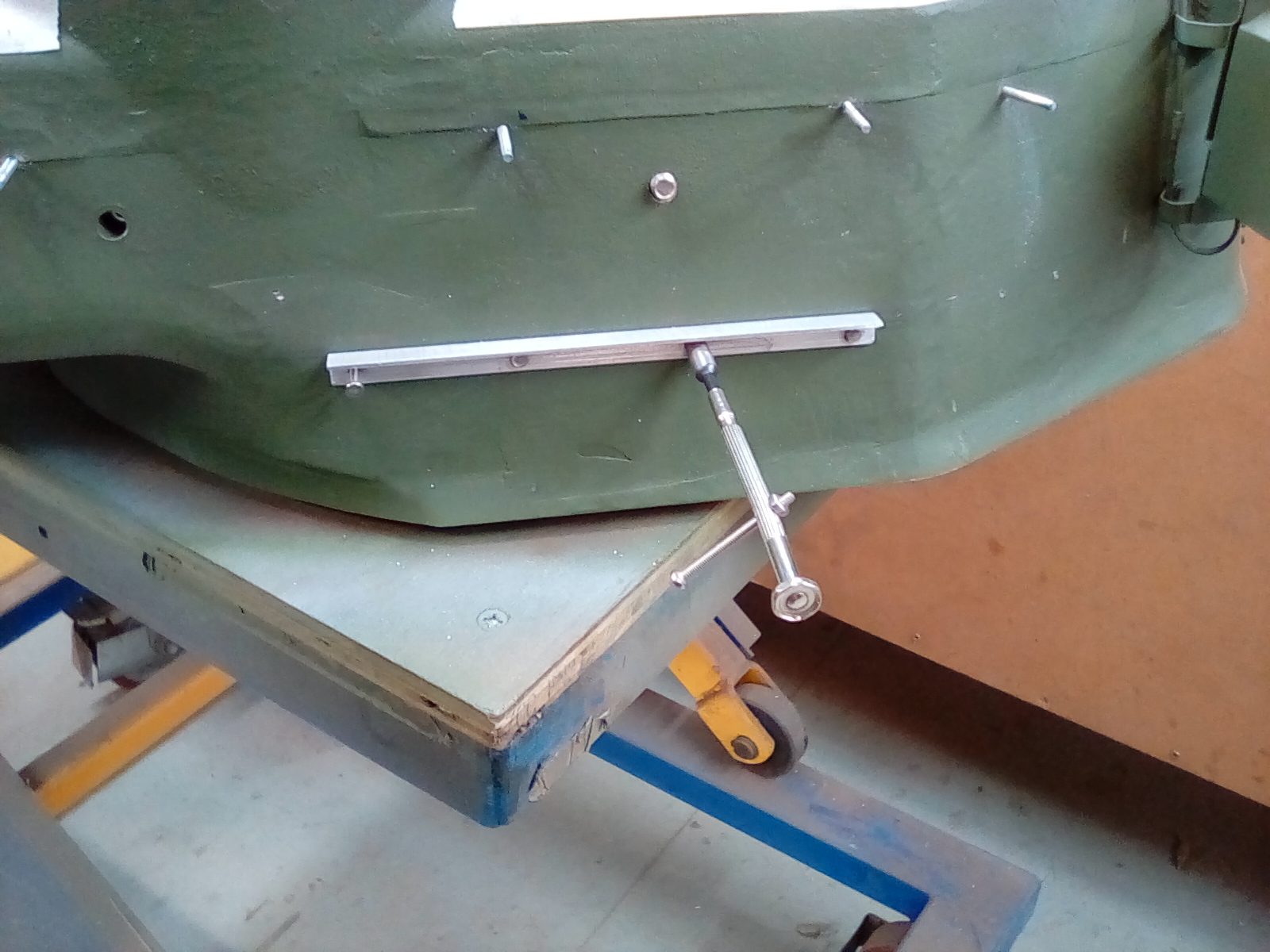

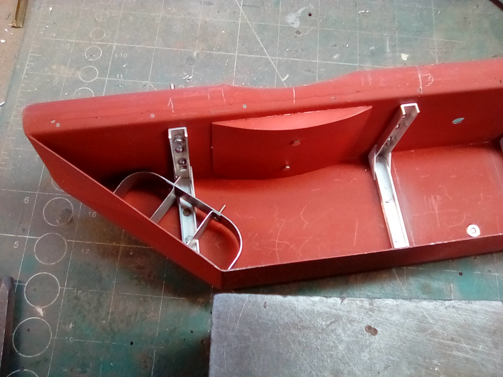

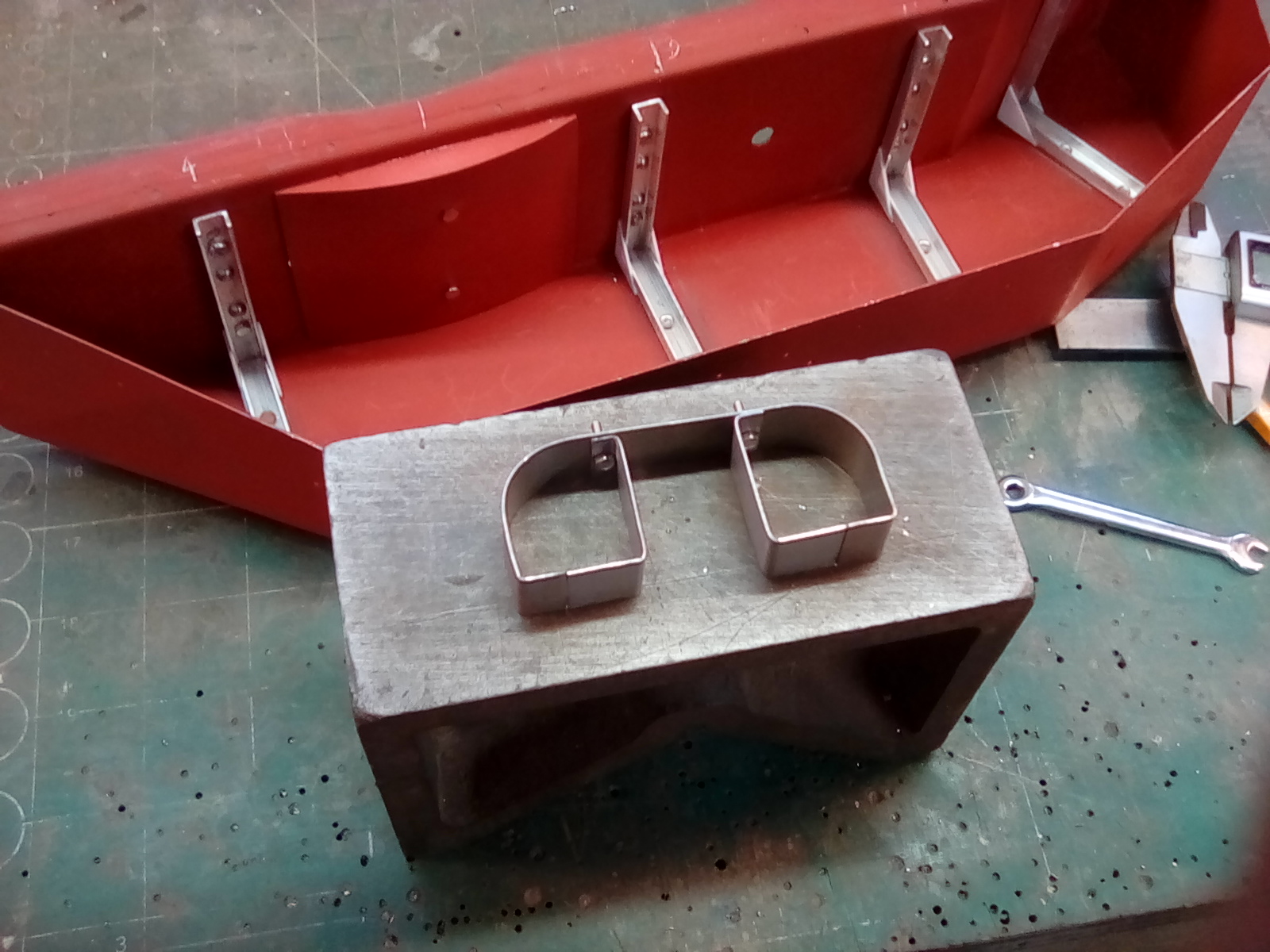

Secret belt and braces mounts for the stowage bins

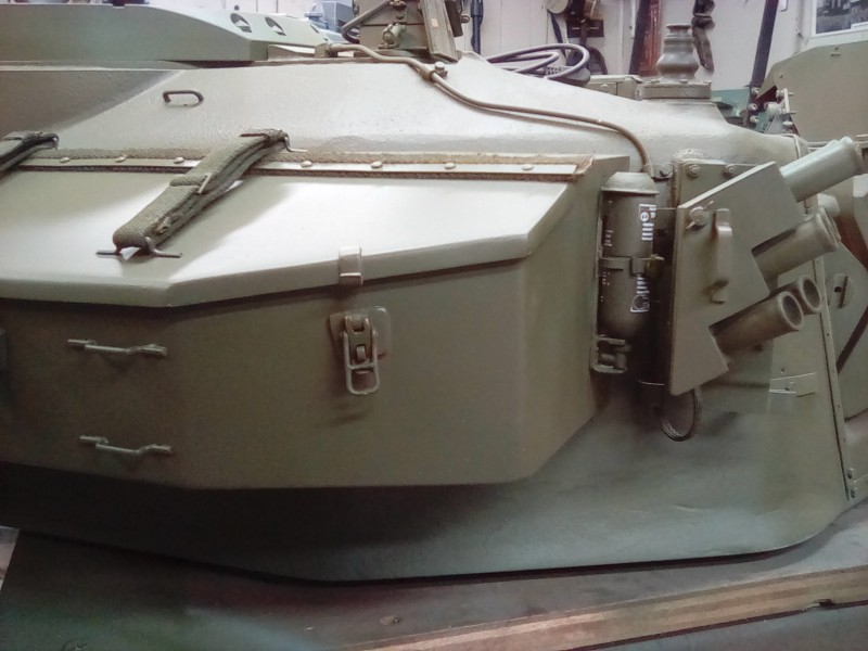

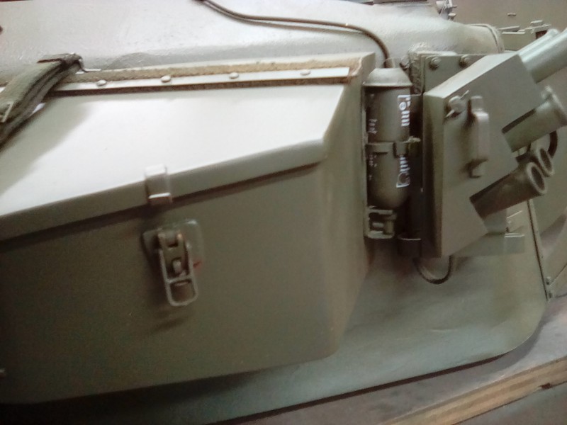

Fire extinguisher stowage reference photo
Reference photo
Reference photo

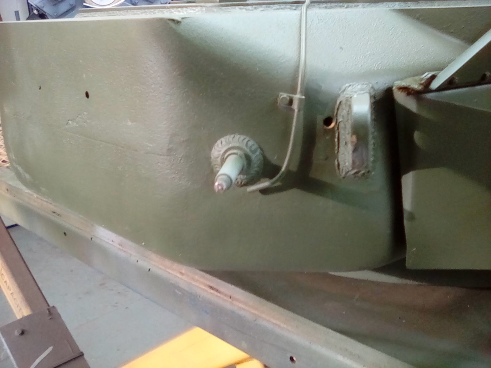

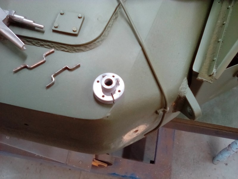

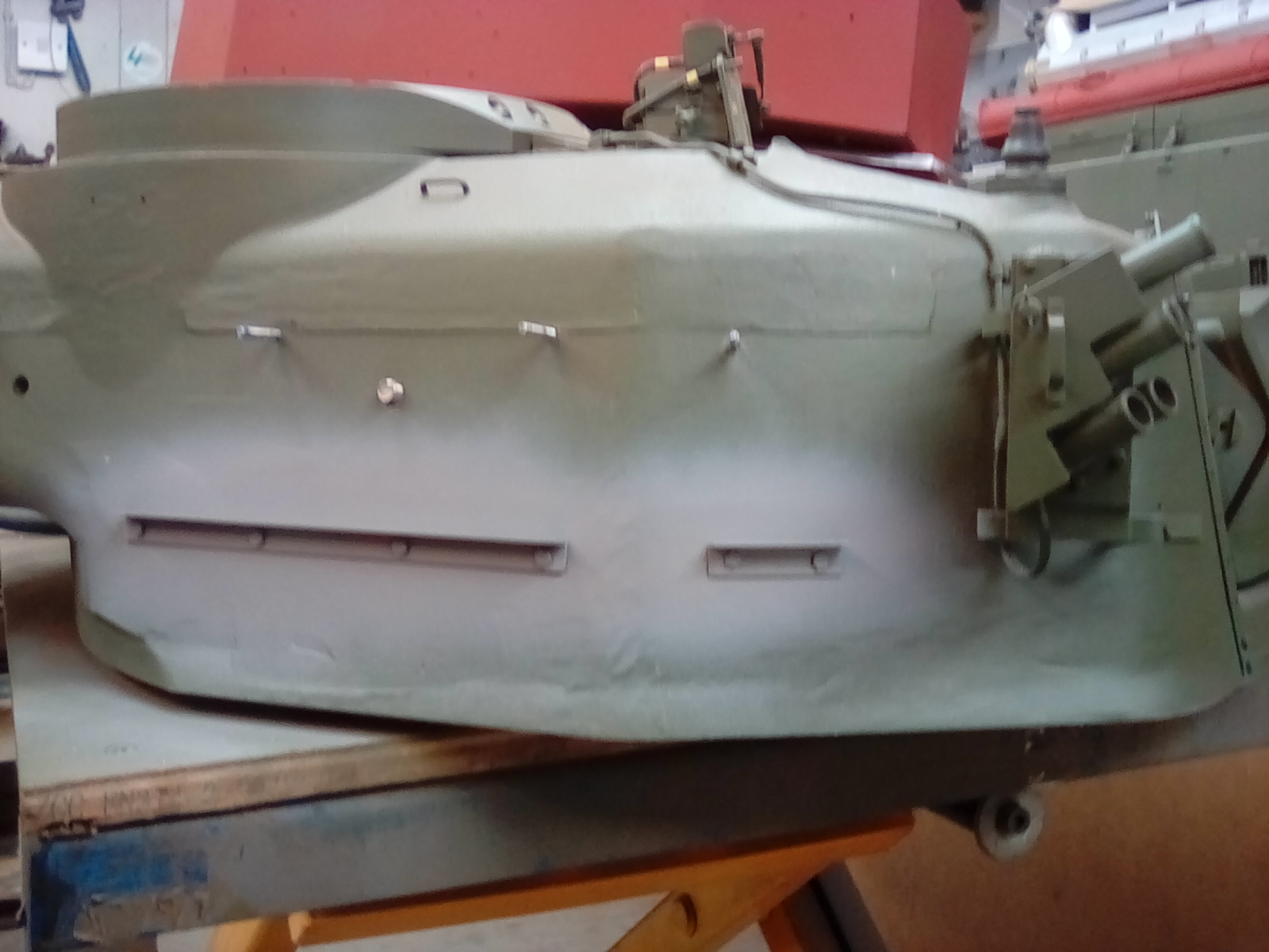

Umm some work required here

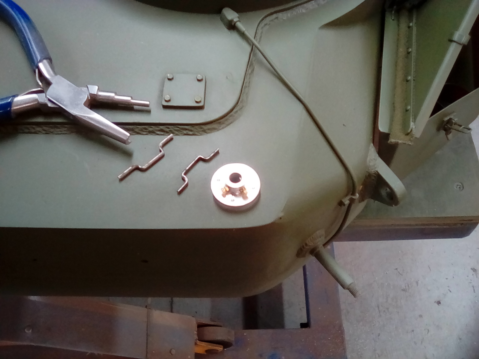

Best get the don 10 real out the way now, and tidy this area
The 2 the down fittings bent up ready

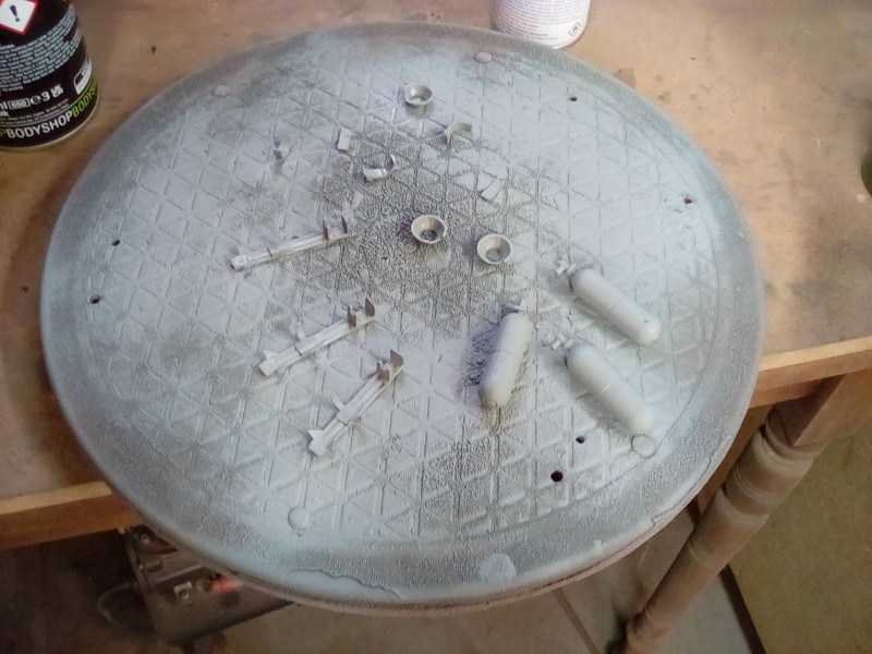

Lots of top coat to give a nice slippery surface for the decals to slide
I'm using Rolls Royce wheel fittings for this piece
Who would of thought there was so much detail in this tiny piece

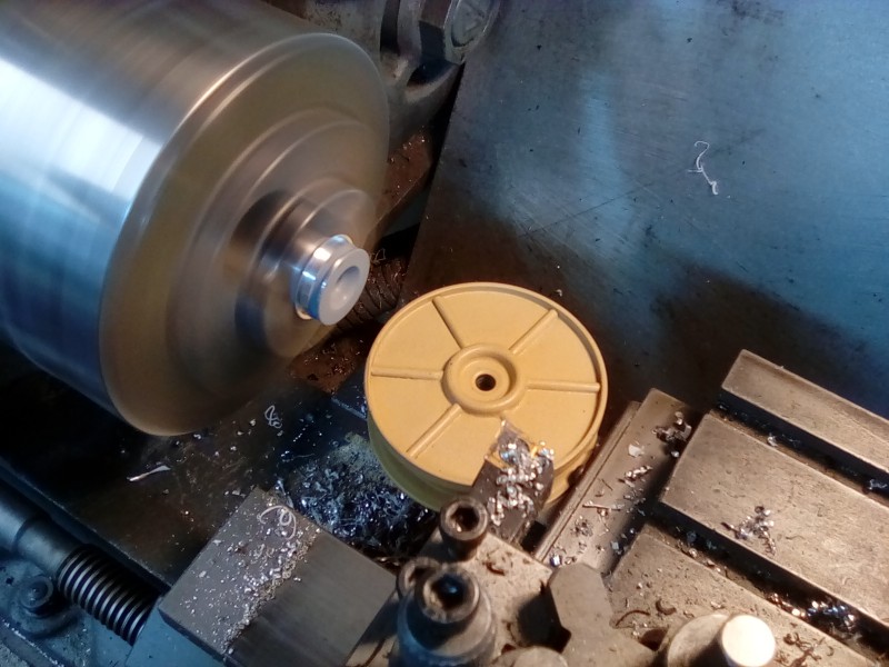

Adapting the kit spindle to fit , this involves turing it down and making an extension piece
Paint stripping
Paint stripping
I'm working on the other jobs to do as each stage of the fire extinguishers has time to cure
Use a reference to get the decals mounted correctly
Nearly done with these , if you rush each assembly stage you will mess these up
See the folded in winding handle?
Cutting the groove
Cutting the groove
A tip, super glue the small piece in place before you drill, then drill as one and it will be a perfect fit, then use some heat to remove the cyno and pin the joint

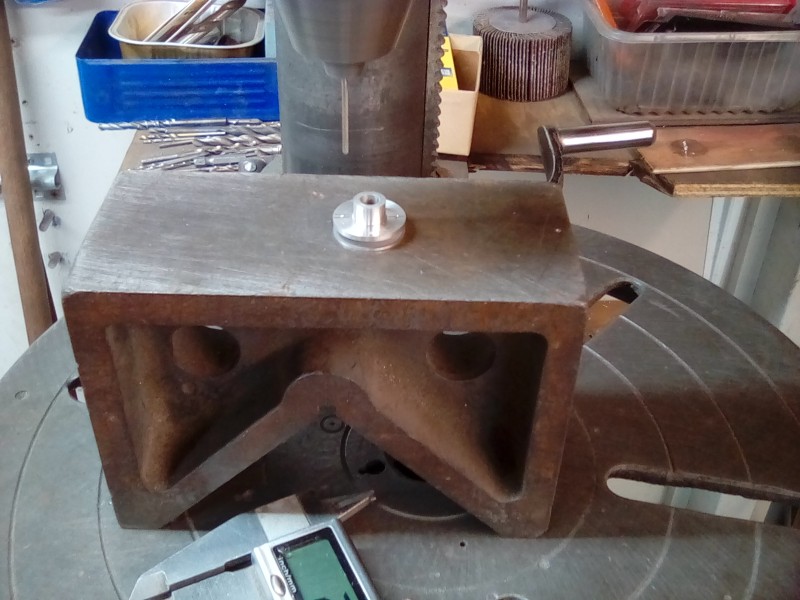

I'm happy with the don 10 spindle mount

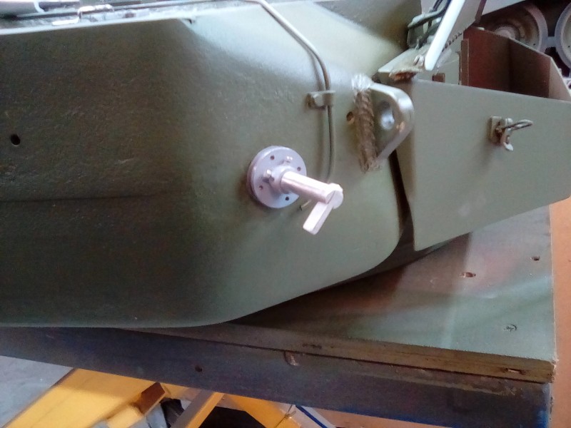

Working latch works
Working latch works
Fire extinguisher mounted in the most awkward place but it is protected in there.
That weld bead on the lifting eye needs replacing, it's rough and the weld vee is upside down.
