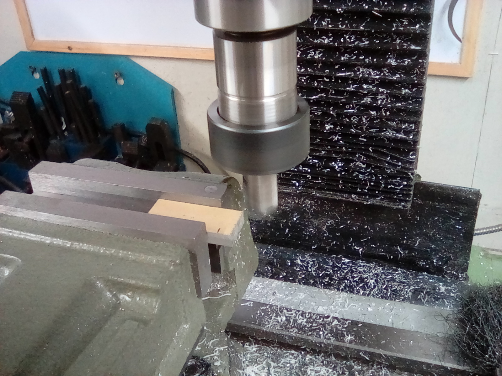

I'm using the mill to shape the hatch pad cores

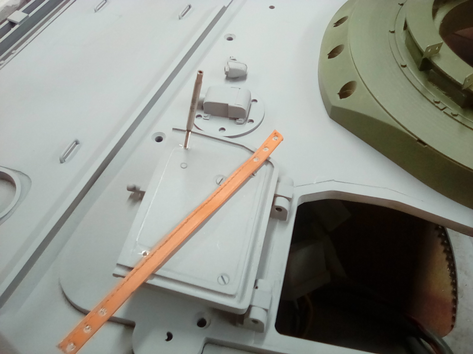

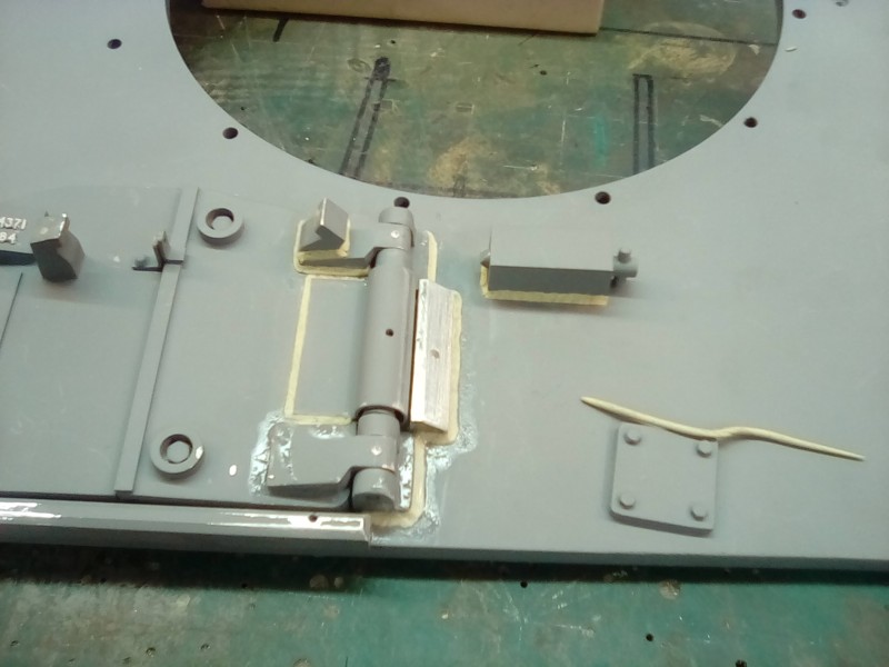

I've joined the weather strip , this will be hidden later
Relief for this side only as the turret inner surface is in the way
That's the correct height for the weather strip

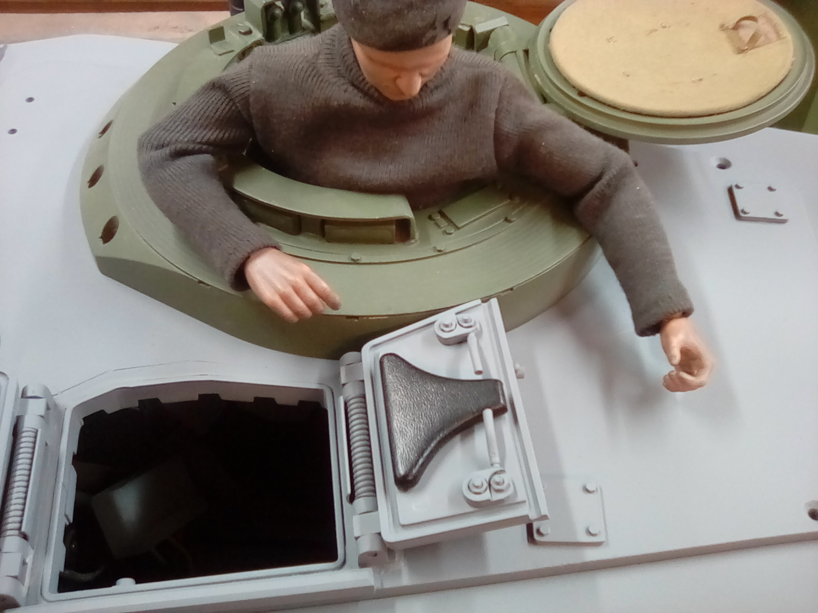

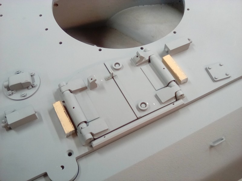

Re: Mr Dawe's Centurion.
Nearly there with the loaders hatch and associated.

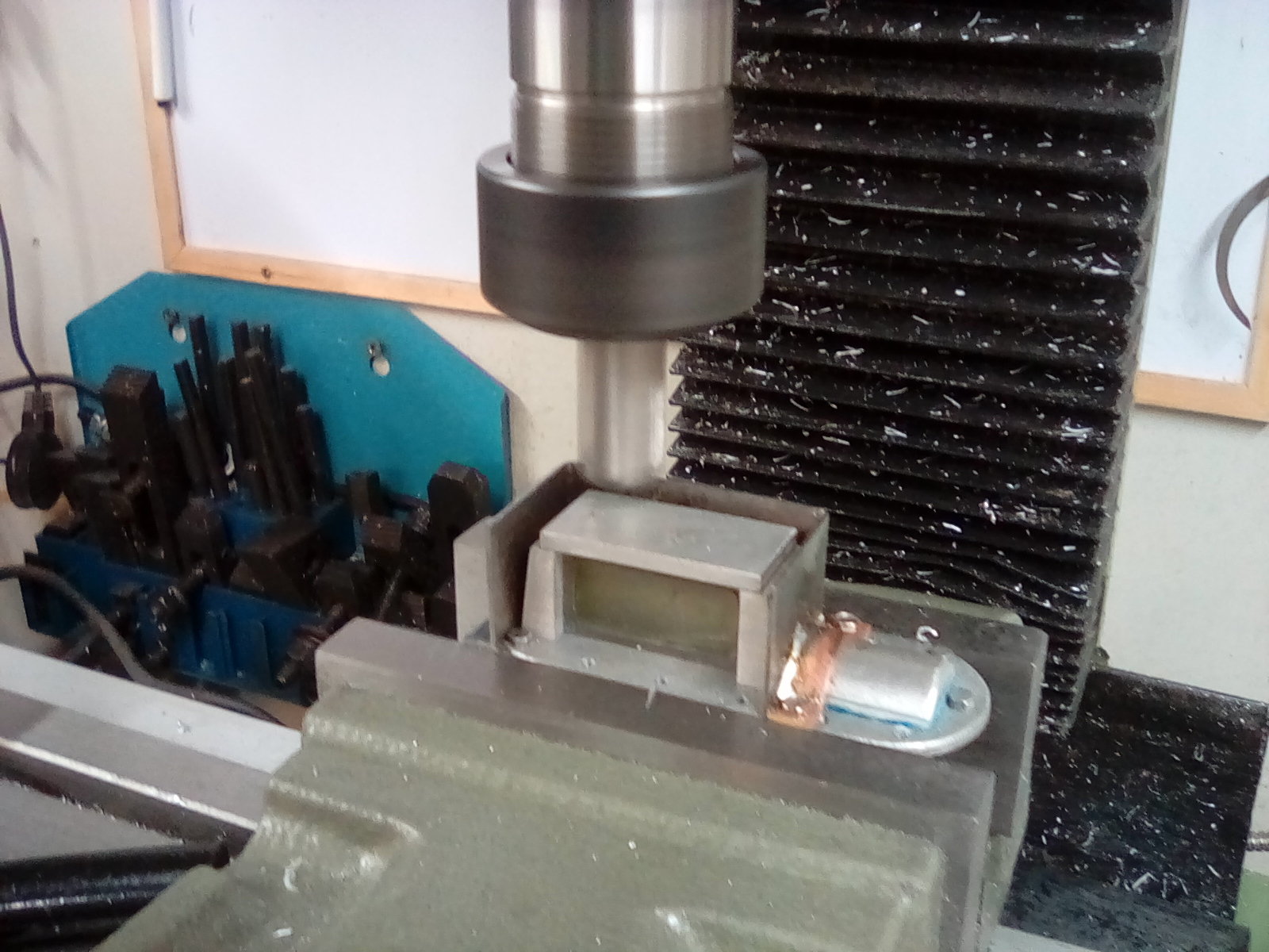

Milling all those angled slots

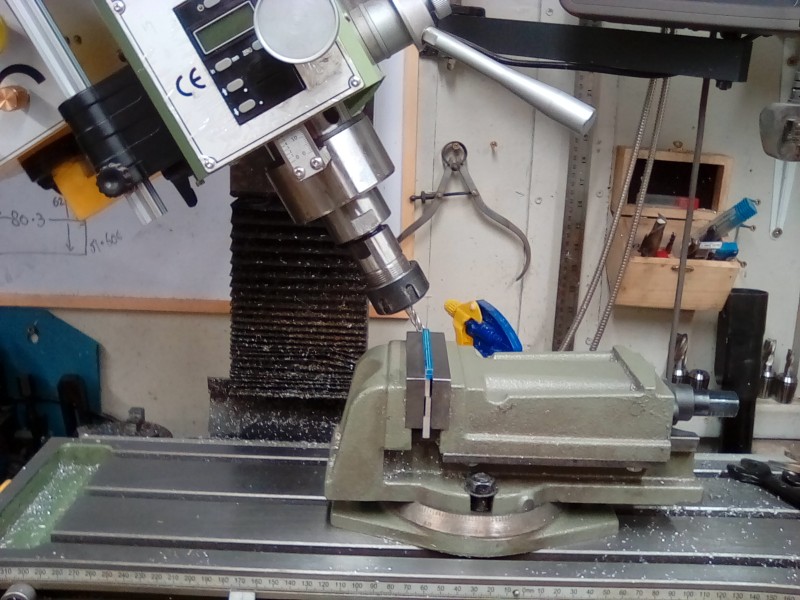

Good old hacksaw
Good old hacksaw
Roughing down
Roughing down
That's the first time I've used this feature on this mill

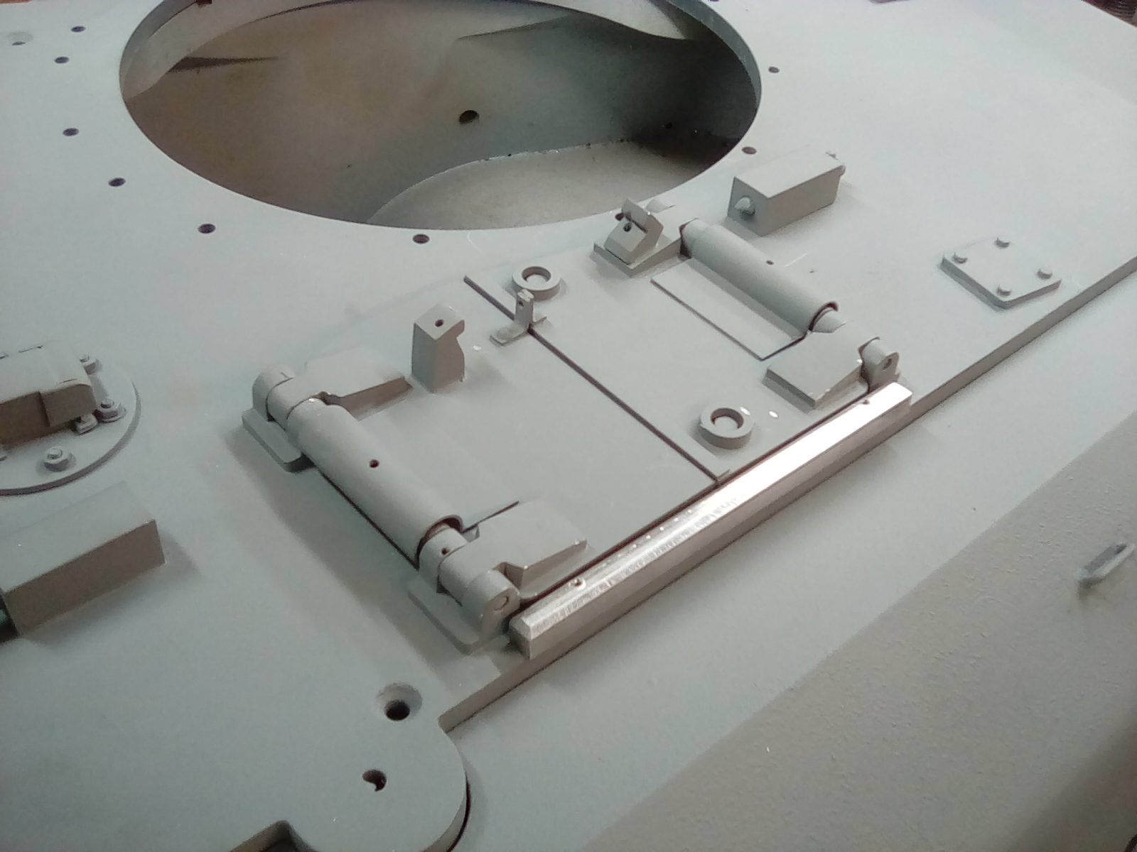

And for the patient purists, the loaders hatch but for top coat is finished.

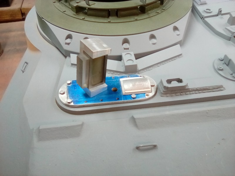

This block supports the scissor sight

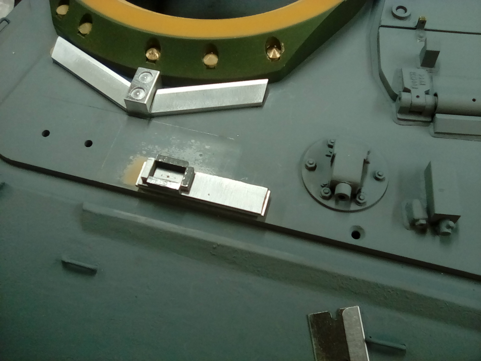

Just fantastic.
I look forward to every instalment.

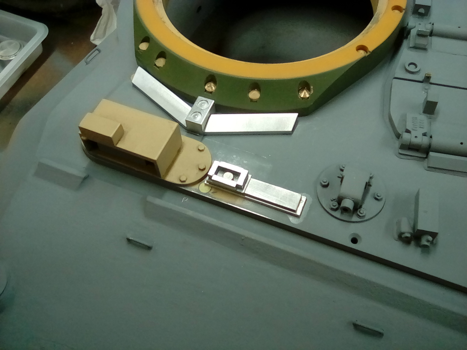

Here's another for you Kevin.

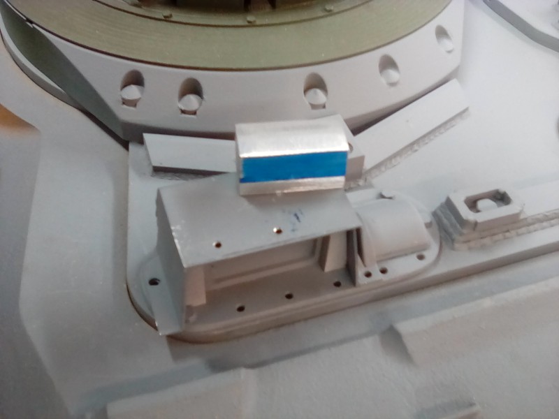

Have no idea what this piece is for?
This piece has an m3 right through it
Lots of m2 fixings from below
Milliput weld beads
Milliput weld beads
There that strange mount thingy is done

I think I have enough material to make The inner sight casting

That 'strange mounty thing' is the coolant header tank and filling point for the sight elevation control arm cooling system (or whatever its correct nomenclature is!). The elevation bracket pivots from the turret roof and is connected to the armament by a link bar. The link bar is a tube which is connected via piping to the coolant reservoir. It is to keep expansion/contraction of the link rod to a minimum due to variations in temperature and hence, minimise alterations to the armament-range gear relationship. Only applicable to Centurion :D tanks equipped with the RG.
Mike

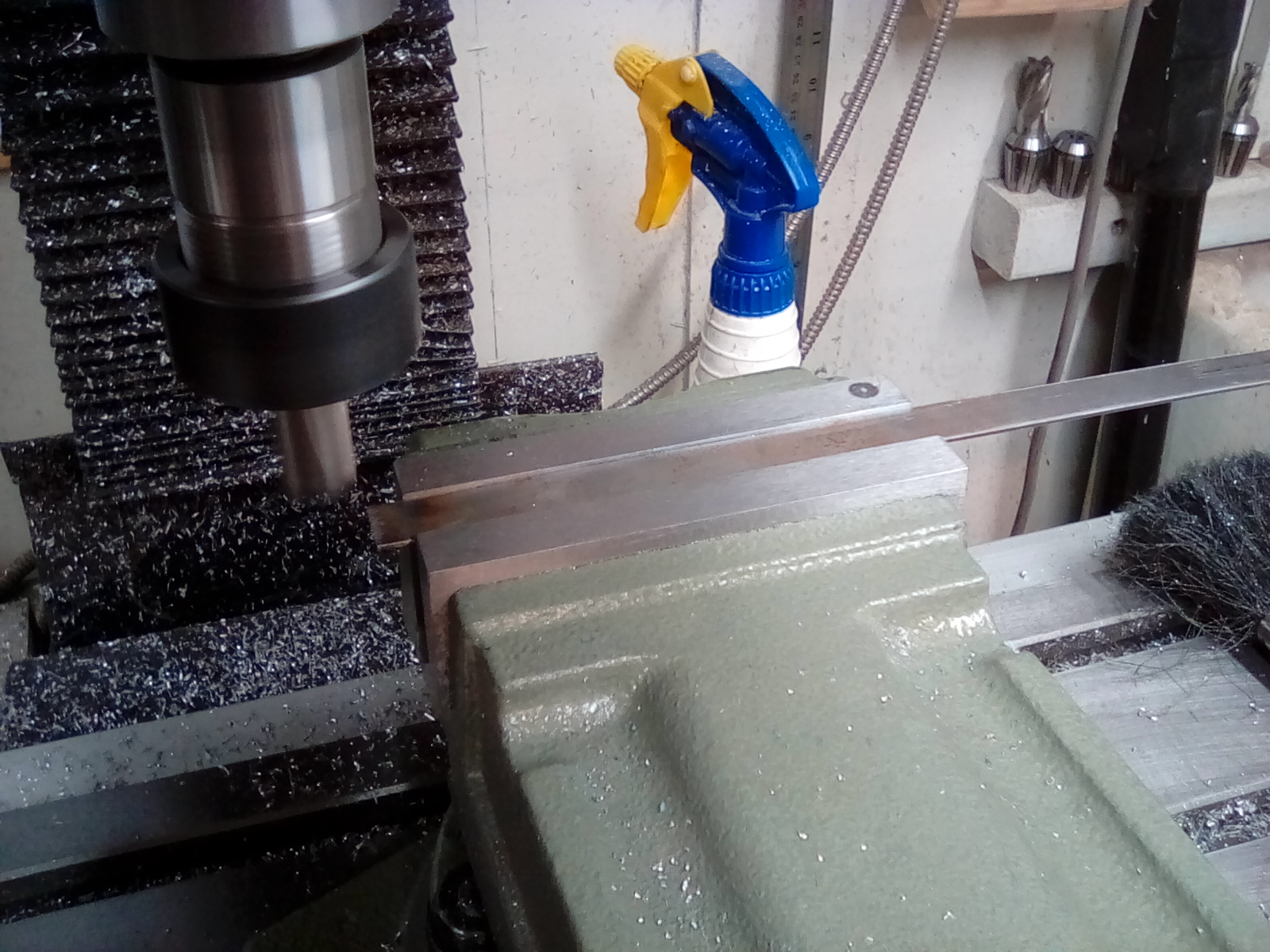

M2 counter sink are very strong in stainless
All bolted together
All bolted together

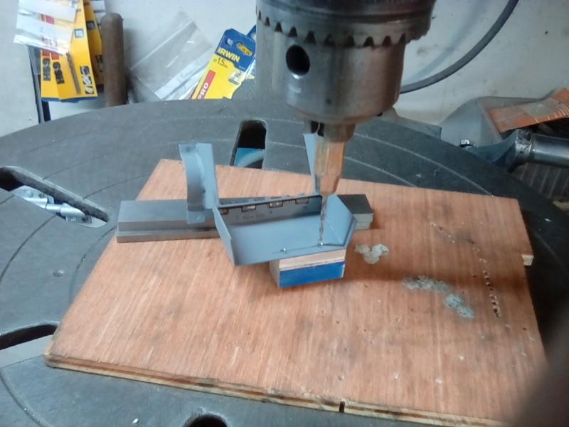

Cutting out the cover sides
All marked out
All marked out
Sketchy but very quick

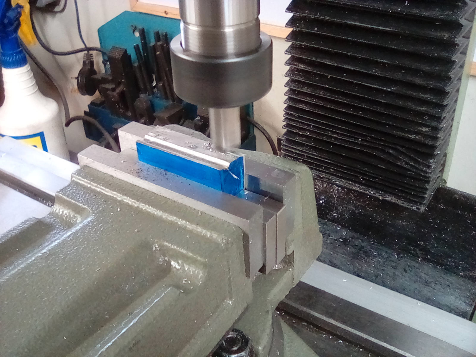

Tricky little piece coming up

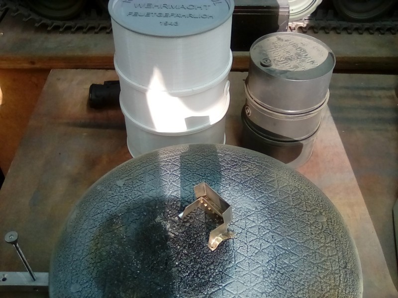

Soft solder is fine for these parts

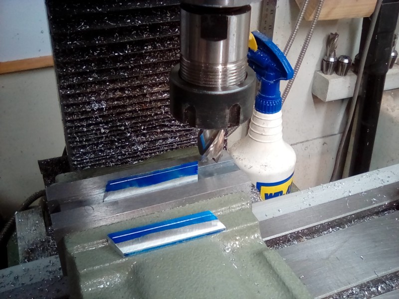

I'm getting very brave with the mill

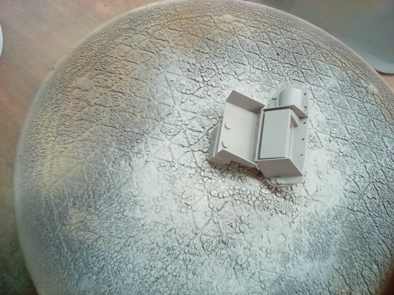

Just had to get some paint on the work to check the finish

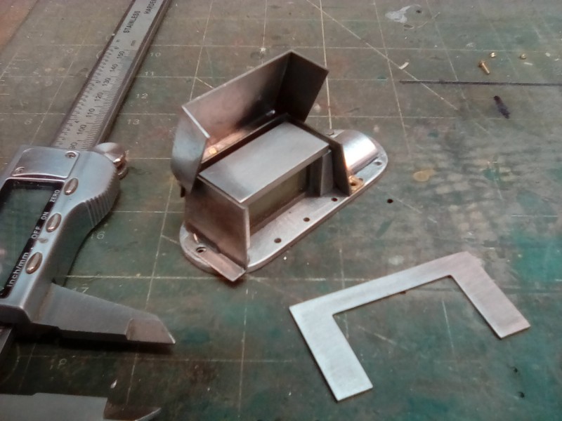

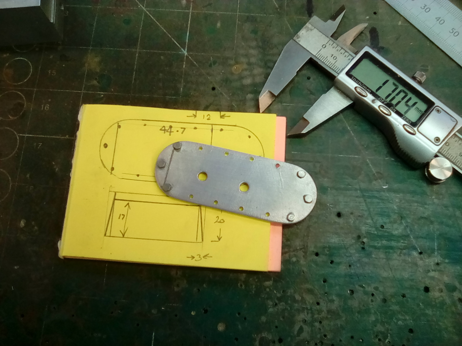

The wiper motor enclosure

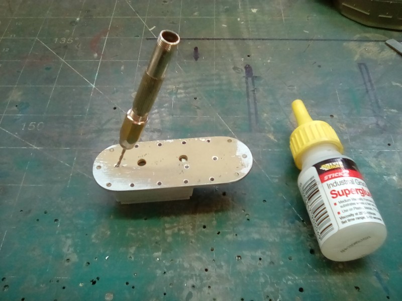

For the boss, how the bond and bolt method can speed up the job

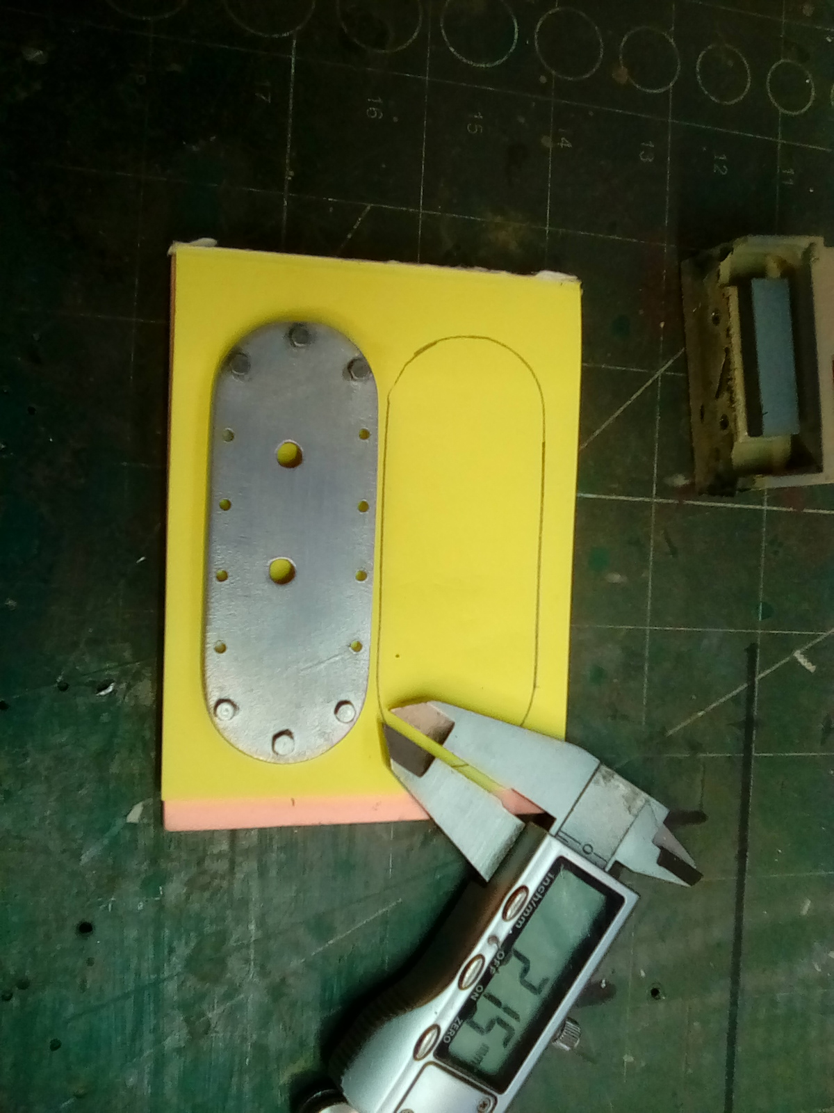

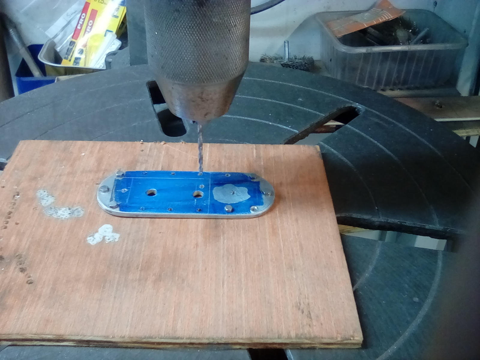

Mark out and drill the fixing hole positions in the plate with your tapping size drill bit.
Bond your part exactly where you want it
Use the tapping size drill bit as a guide for an accurate hole, open up the plate holes with a clearance drill bit before you fix.
Snap the bonded part off the work,  then tap away, clean away the hard cyno from both surfaces.
Bobs your uncle a perfectly placed and fixed part
