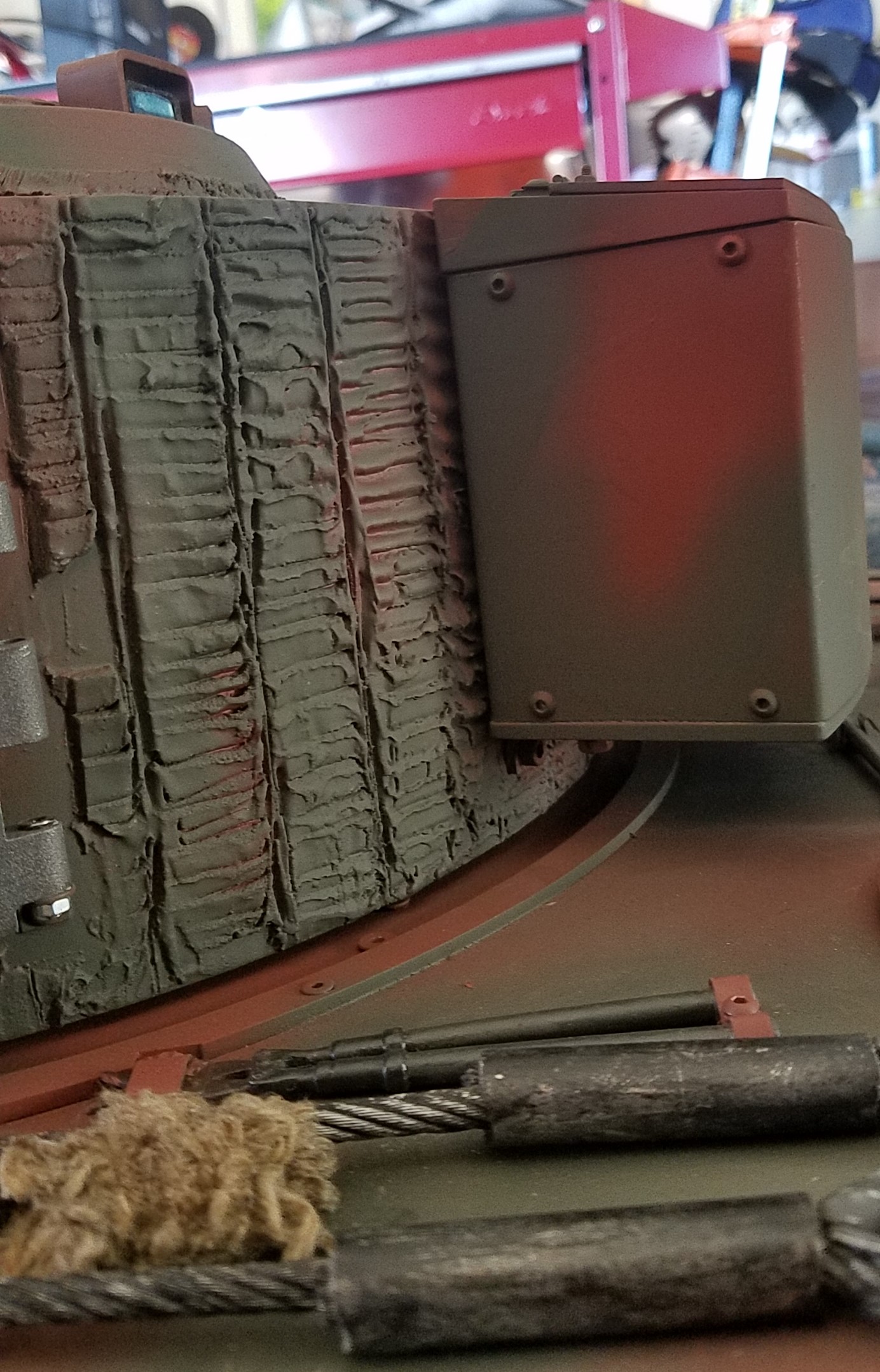

Weathering and Zimmerit: Brian's 2017 NO. 10 LATE TIGER 1 BUILD
I am painting the exhaust pipes and testing new modeling clay for the zim.

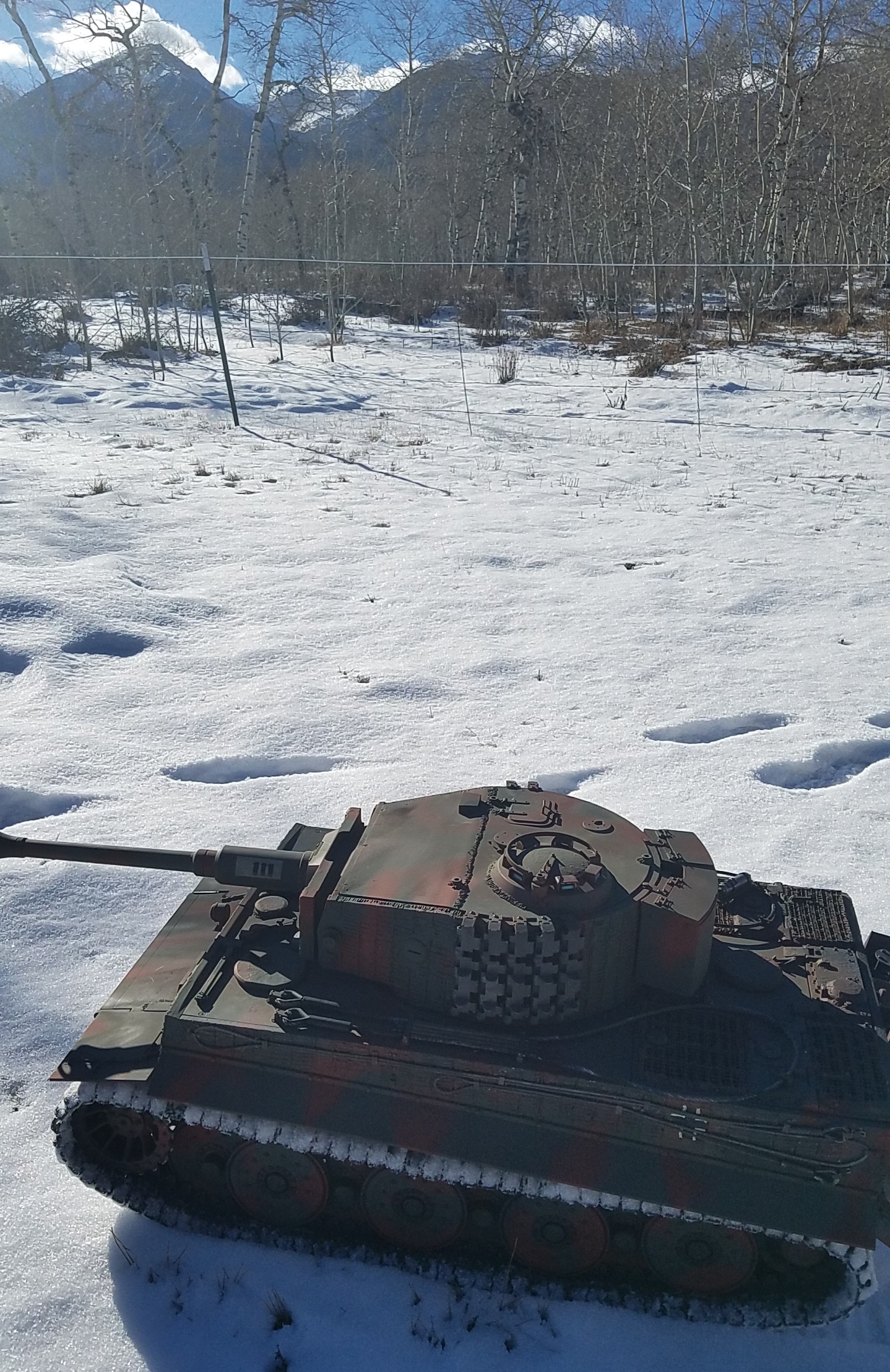

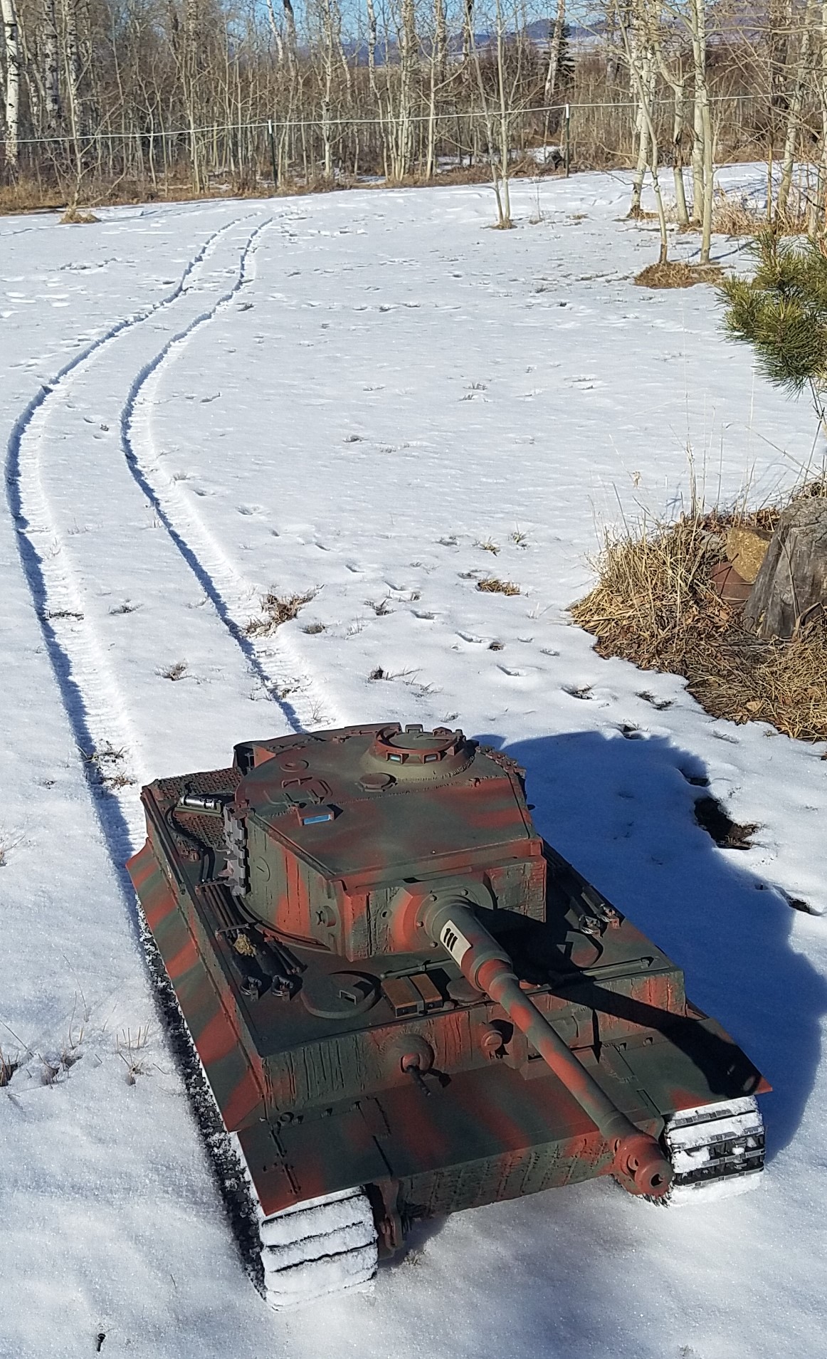

Re: Brian's 2017 NO. 10 LATE TIGER 1 BUILD
Looks great!
I mounted all of my parts before applying zimmerit. If I had to do it again, I would NOT apply zim to the turret area where you hang the extra track links.
I sent you a couple of emails with videos attached of the tank in the snow. Once I aligned the tracks and tightened them, it works great in the snow, even on a side slope. I was still careful to not pick up any gravel or other debris that might block the running gear.
Cheers... Tom
Cheers... Tom

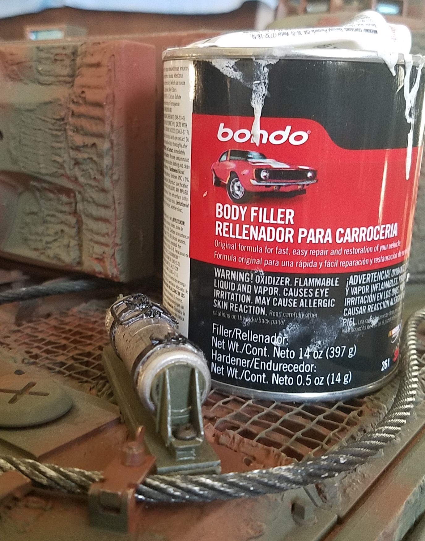

That's looking good. What's the name of the product you are using?
Your son does a better job than me!
I considered using tile adhesive but I happened to have some automotive body putty (Bondo or NAPA body filler) laying around, so I used it. With the amount of hardener I mixed with the base, I had about 20 minutes to work with it before it became unworkable.
So, I applied about a 4 x 6 inch square area at a time. The thickness varies from about 1/8 to 1/4 inch.
How long does it take for the tile adhesive to set up? Is it a water based product (easy to clean up) or other?
Tom
Tom
- Brian Ostlind
- Posts: 1466
- Location: Oregon, USA
- Has liked: 975 times
- Been liked: 2068 times
Yes it is water based and takes a couple hours to dry. I wiped it off after the first attempt with a wet rag and re did it.
