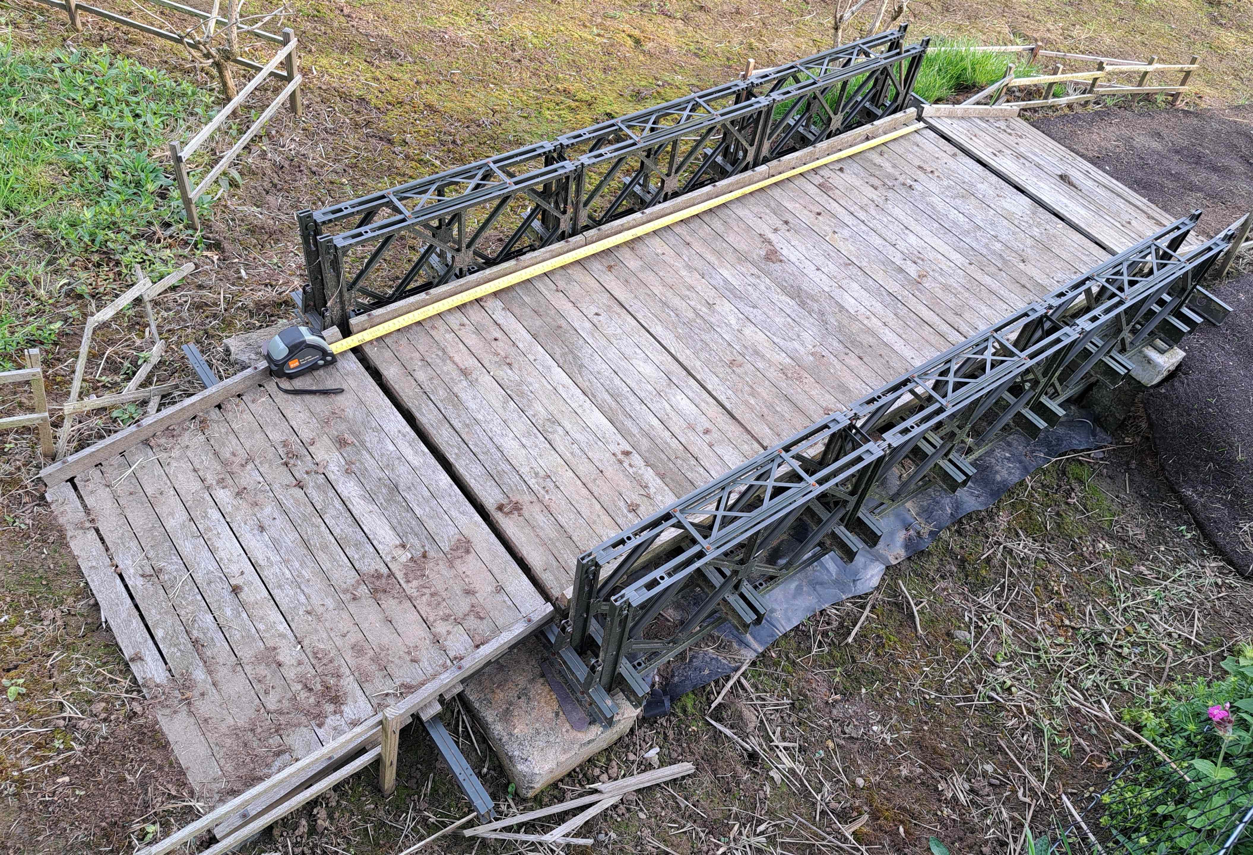

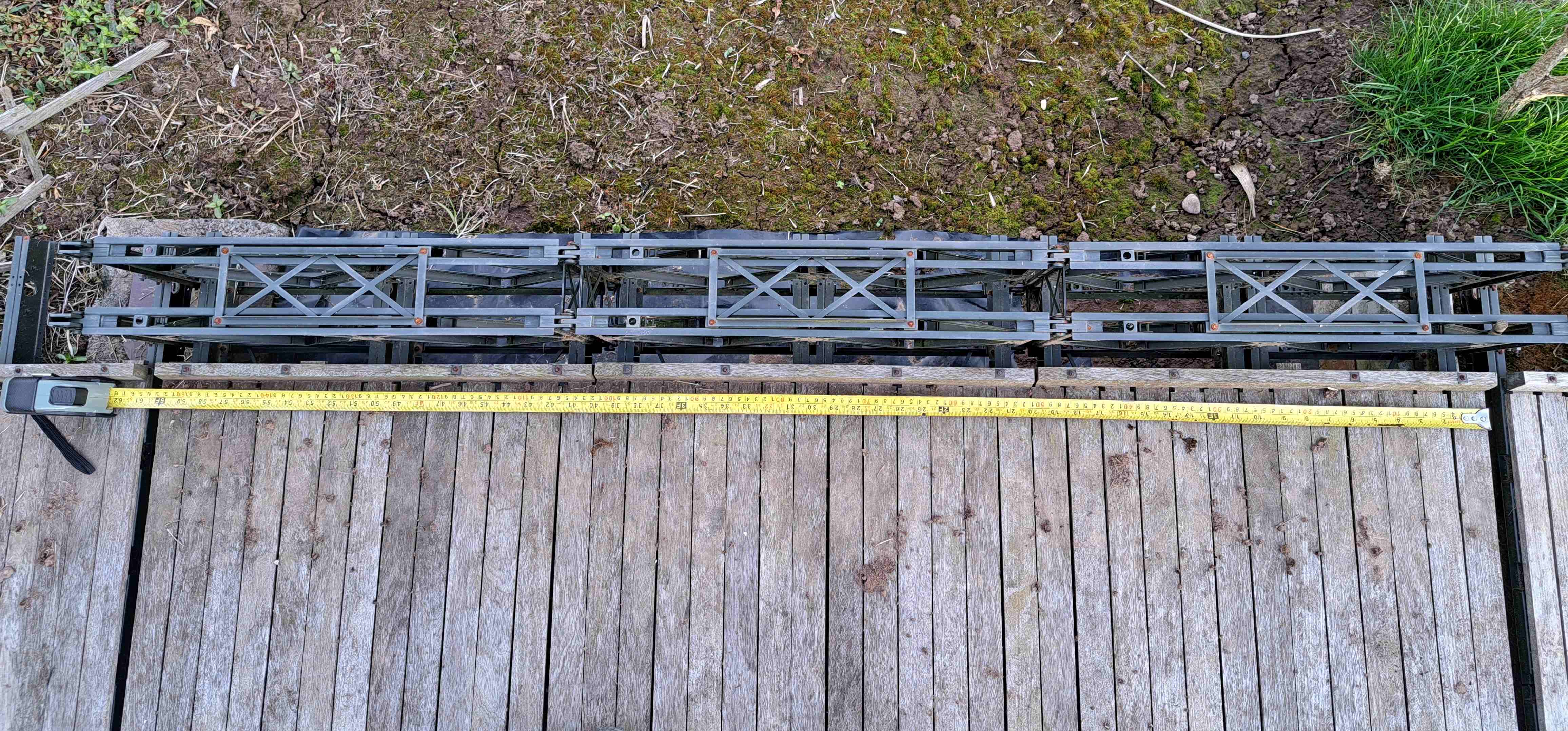

Hi Mark.
I hope the attached helps with your decision. My three panel effort is 5', as you can see from the tape measure. hope this helps.
5' excluding the ramps.
view of complete 3 panel bridge.
I have added the wooden ribands instead of the kit provided metal ones, so far no damage :-D

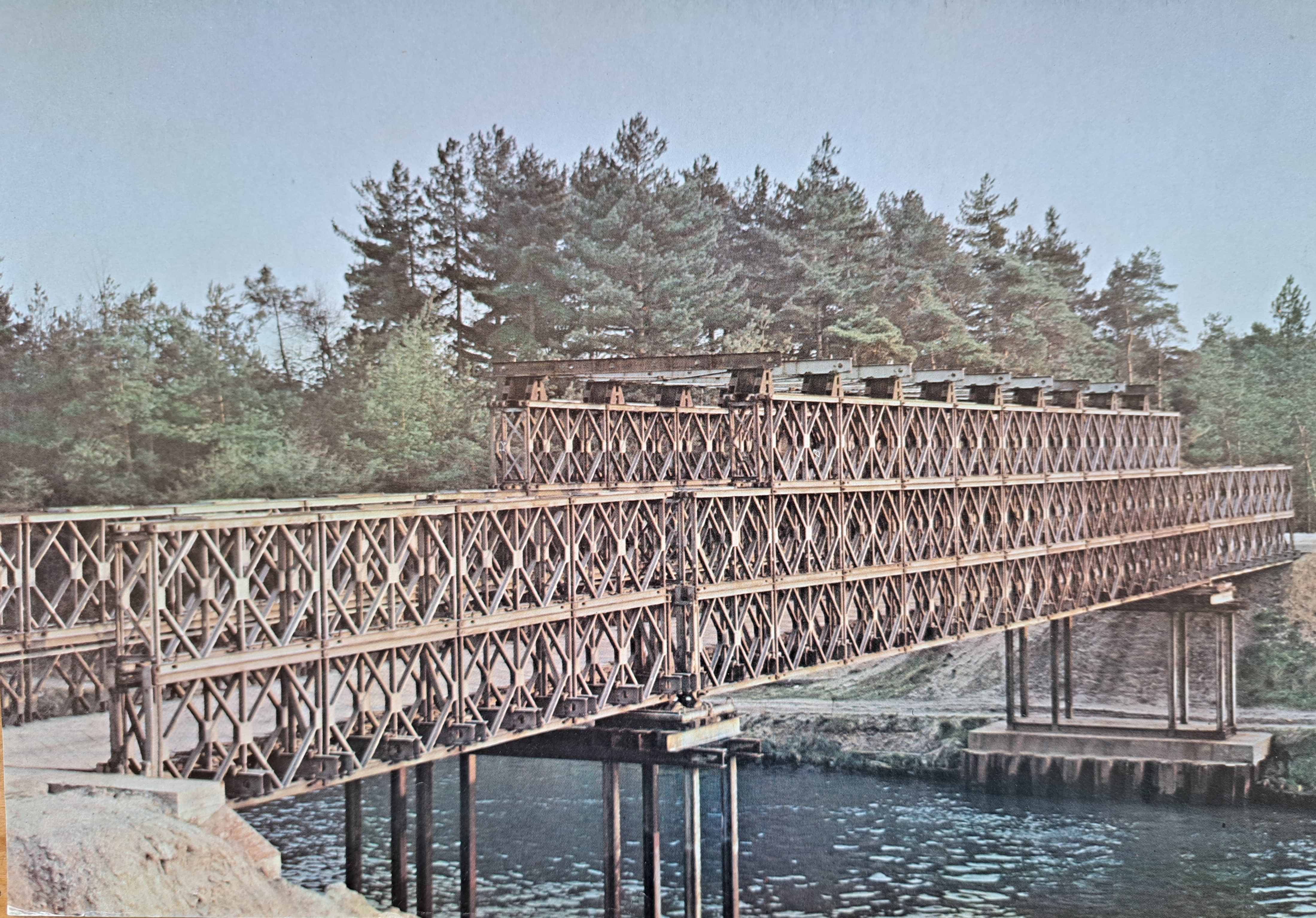

Of course you could be absolutely sure you At model will cross without any worries:-
What would the quote be for this, I wonder?

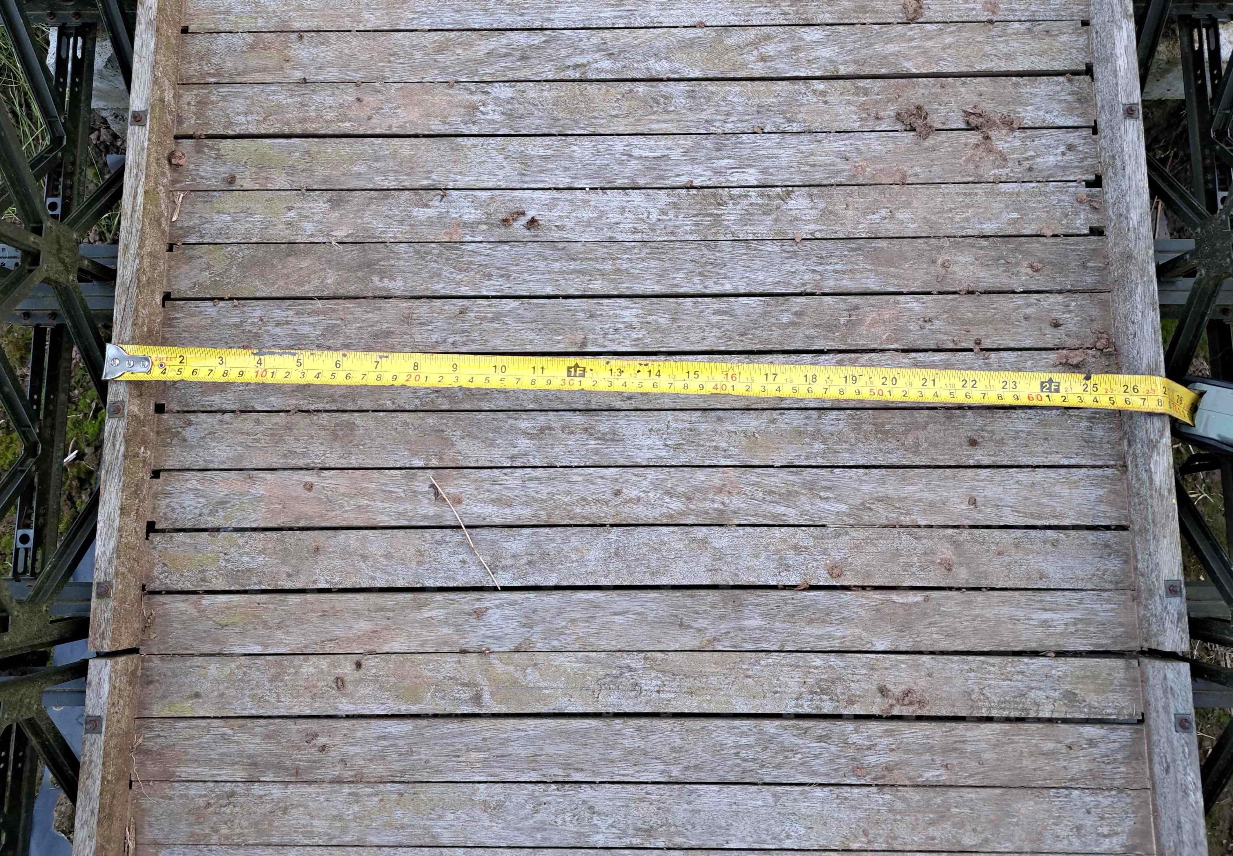

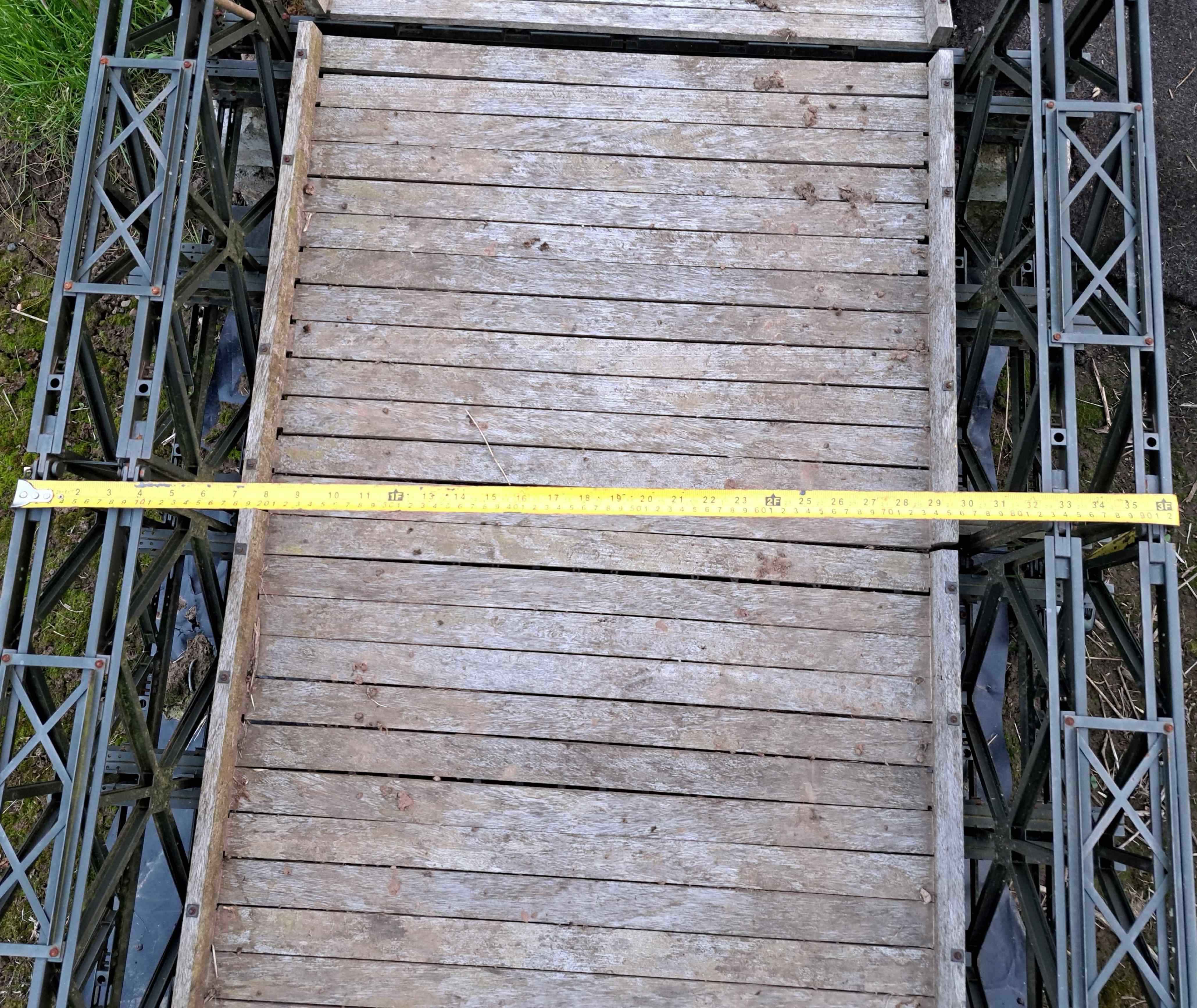

Hi Paul.
Hope this helps:-

Charles
Very much obliged, its a lot bigger than I expected.

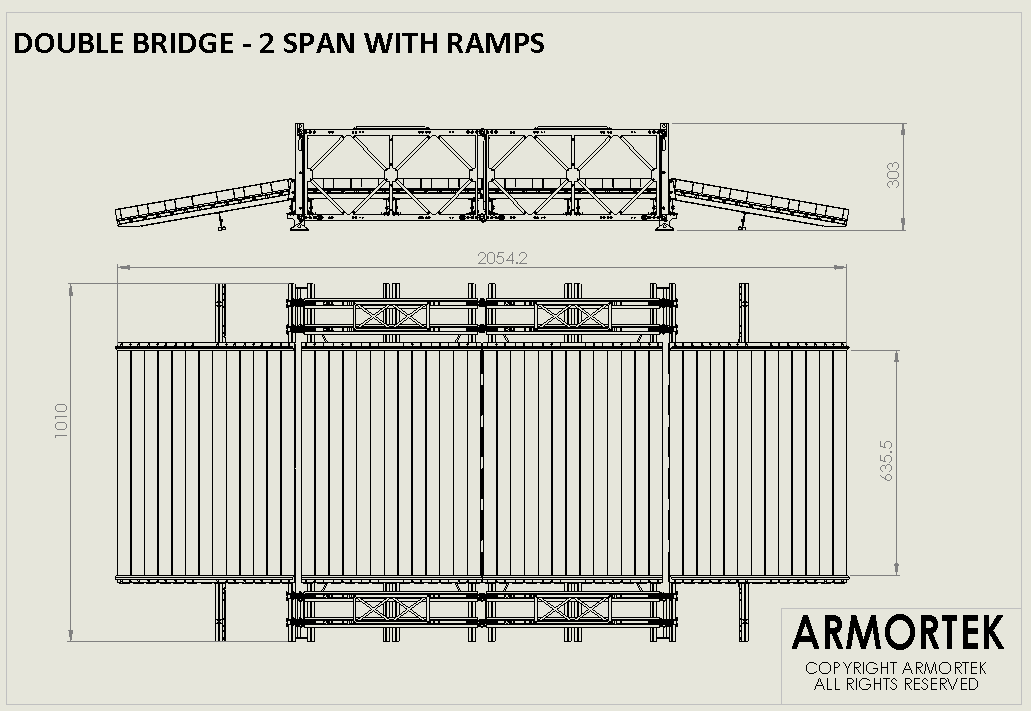

DIMENSIONS - all in mm
