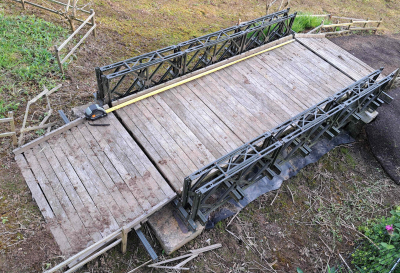

A question for anyone who knows or has built an Armortek Bailey, what is the actual length of the two panel bridge with and without ramps. I thought the actual Bailey panels were ten feet, so I'm thinking twenty inches for each panel if in scale. Am I thinking correctly? Just trying to calculate how many panels I need for a backyard layout.

Hi Mark.
I hope the attached helps with your decision. My three panel effort is 5', as you can see from the tape measure. hope this helps.
I have added the wooden ribands instead of the kit provided metal ones, so far no damage
Of course you could be absolutely sure you At model will cross without any worries:-
