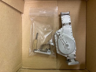

Does anyone recognise this jack. It came with the kit when I purchased it and I would like to know its origin so that I might find out how to put it all together and fix it to the tank.
Many thanks
Brian Ostlind
Posts: 1466
Location: Oregon, USA
Has liked: 975 times
Been liked: 2068 times
Re: KT 2019 #29
Post by Brian Ostlind »
Looks like an old sixth scale icons piece from Mike stannnard. I may have the instruction sheet that came with mine. I’ll take a look.
Michael Allen
Posts: 119
Joined: Sun Oct 09, 2022 3:53 pm
Has liked: 1039 times
Been liked: 79 times
Re: KT 2019 #29
Post by Michael Allen »
That would be great.
Many thanks for your time Brian

Michael Allen
Posts: 119
Re: KT 2019 #29
Just shows just how much you know your subject Brian. It’s definitely the right Jack. Have you fitted one to one of your tanks?
