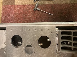

I'm not sure what you mean by "wing". Any chance you can provide the part number and pictures of the area ?

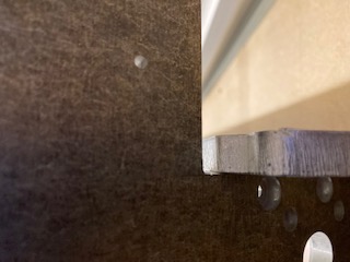

5mm sounds more than expected.

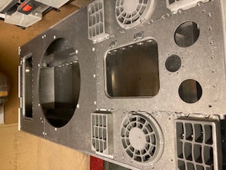

The cutouts in the rear side plate where the rear plate tung slots in file the rounded corners more square it will give you more room to aline the plates hope this helps Dale

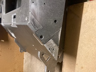

Reasonably pleased with my first attempt at getting this put together.
